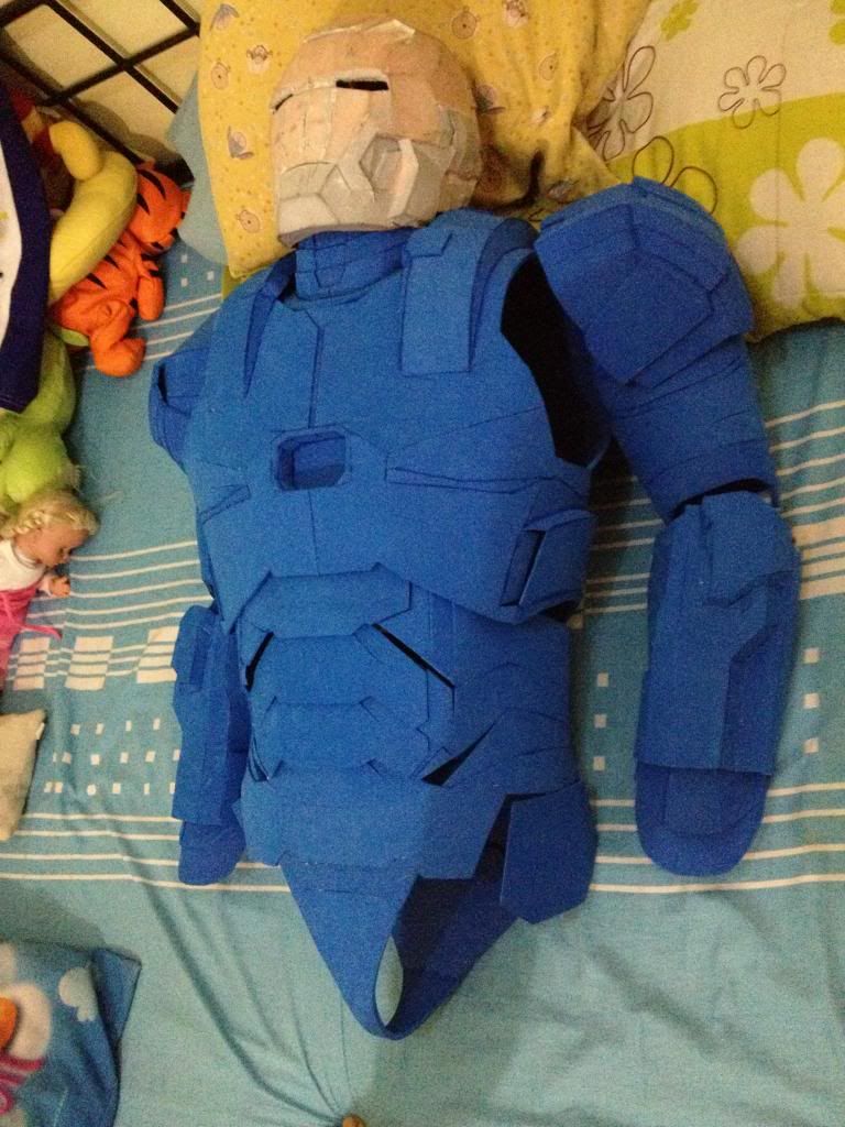

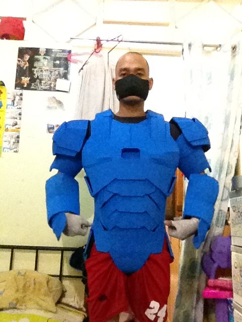

That looks awesome mate :). How did you attach the hip plates? Looks like elastic or something to the inside of the hip of the cod/lower torso? That's what I thought of doing but unfortunately I had to add a spacer to one side of the abs/lower torso to get it to fit just right, which means one hip plate doesn't fit properly lol...I'm still pondering a way around that.
Re: Jackieisrockin's IM3 Iron Patriot Pepakura Files! Check out page 66!
its just a tape. but my plan is to put a velcro in the cod and hip plate. so that it can be detachable
