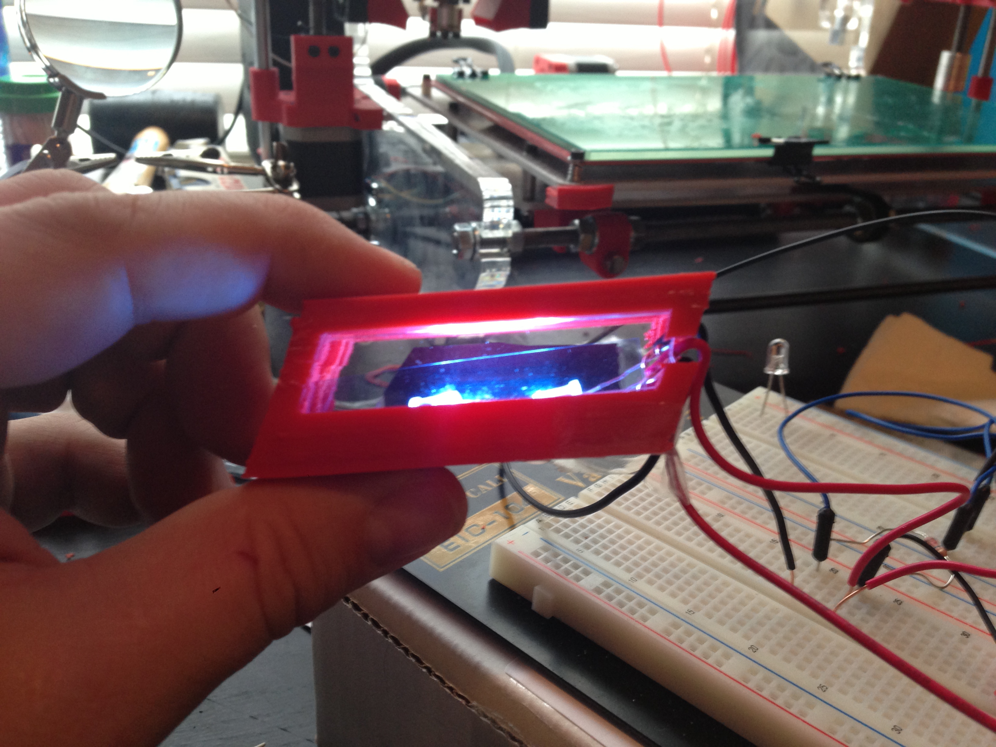

More proof of concept pictures. I put some tint on the inside lens.
I have to get more pictures but I think the tinting might work. Especially if I increase the depth of the case to hide the LEDs better from the inside.
Progress!!

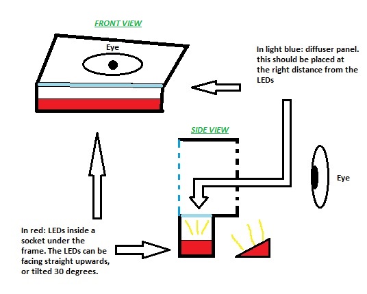

That's a pretty sweet suit. The print seemed to almost work last night, I'll check the fit of the parts and review the model tonight. It looked like he molded the eye frame? I don't really have that option in the small condo I have at the moment, plus I'd have to break the mold up into at least two pieces anyway. I'm still messing around trying to get the best model. I did lengthen and widen it, don't want to go too wide yet until I get the light shining properly to make sure it gives a good glow. Now that I know the tinting should work, I'm trying to get an even glow from the eyes - clear plexiglass, even etched doesn't catch it properly so you have light but there are still hotspots from the LEDs. I'm almost thinking to do two sets of plexi inside - one tight snug on the LEDs sideways to give the even glow and then clear to see through.
__________
LED | | LED
_ tinted plexi to eye
| white/frosted plexi or similar to diffuse the light
- the clear plexi
Testing out new ideas as I go.

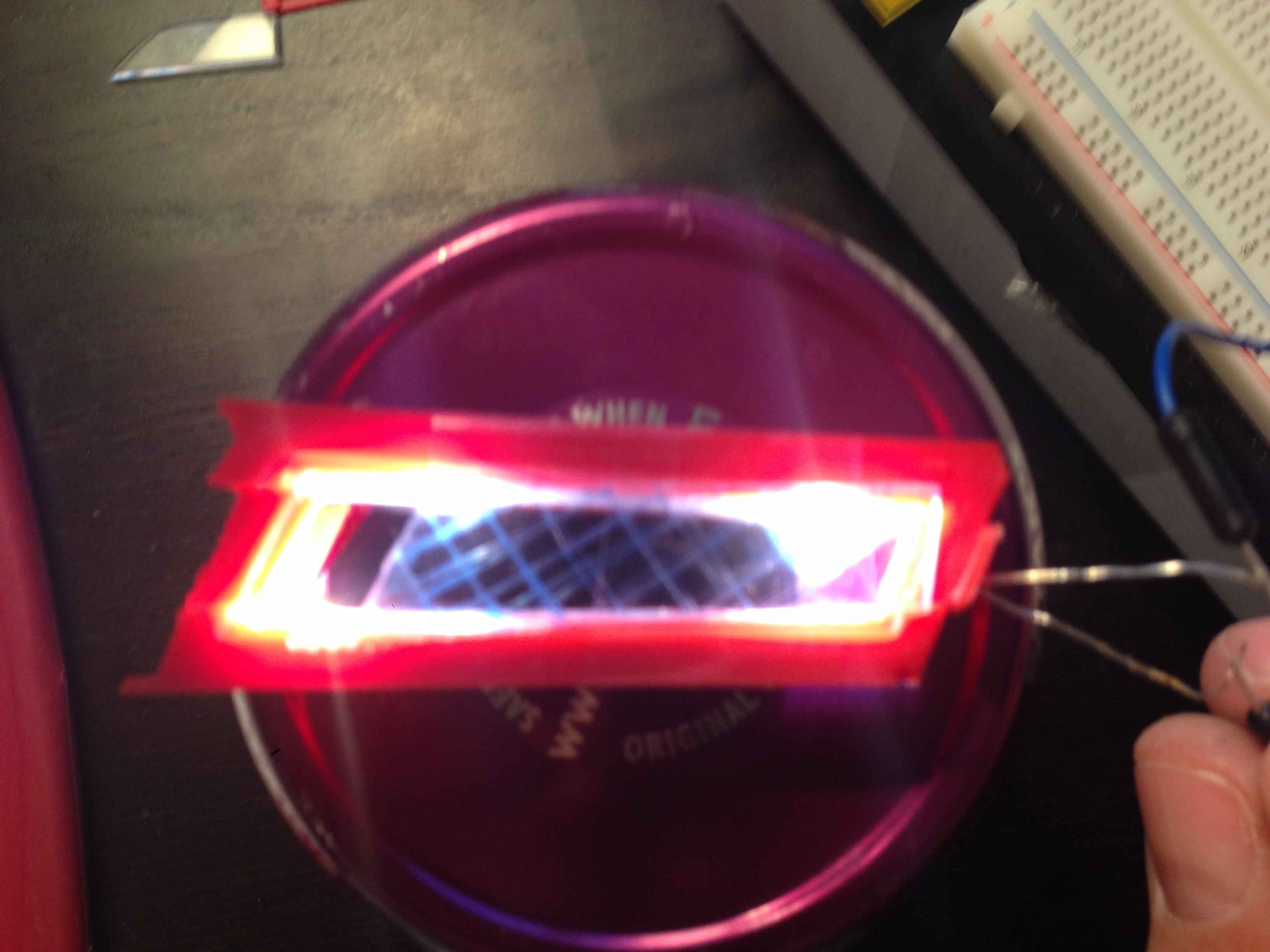

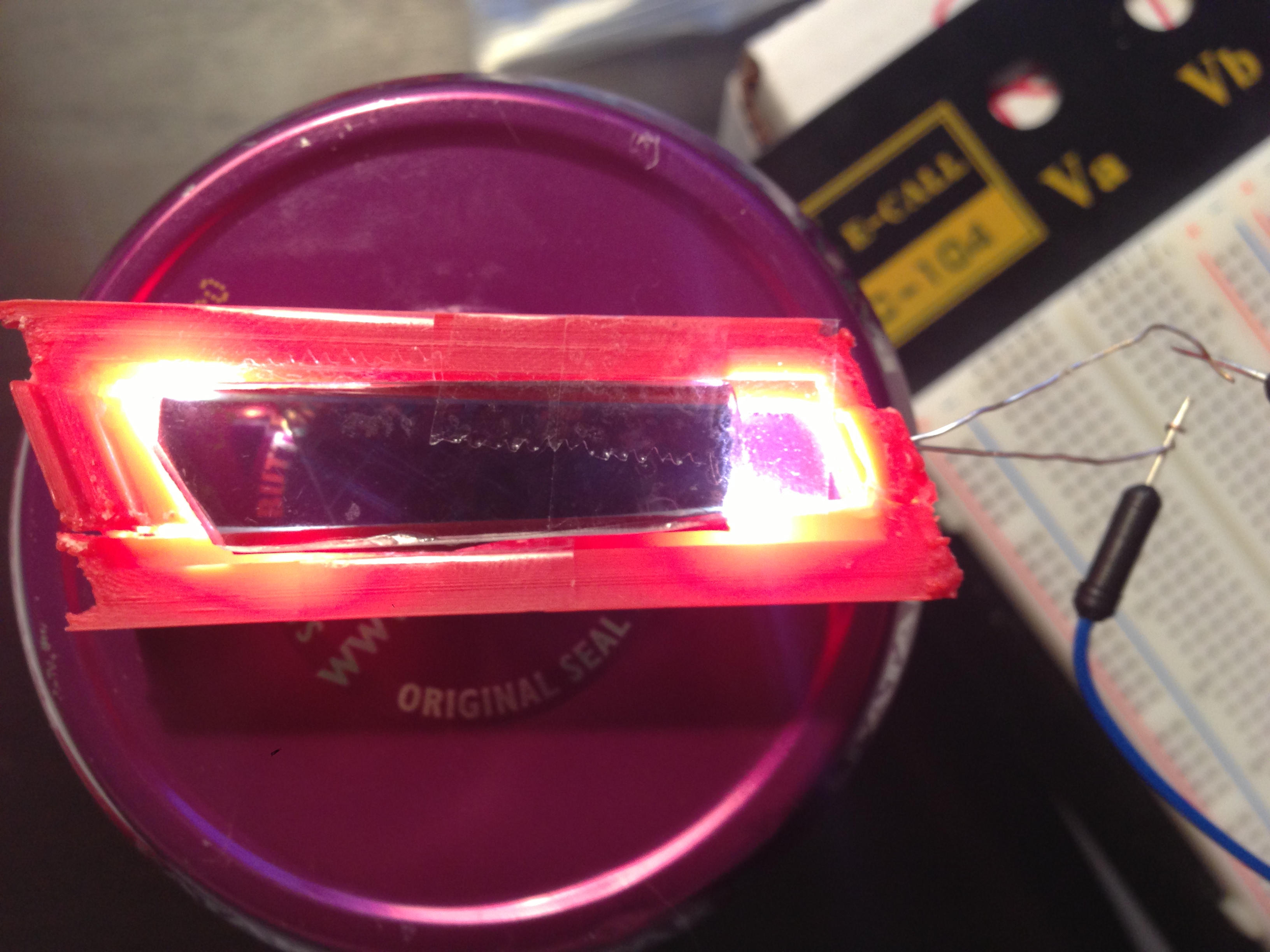

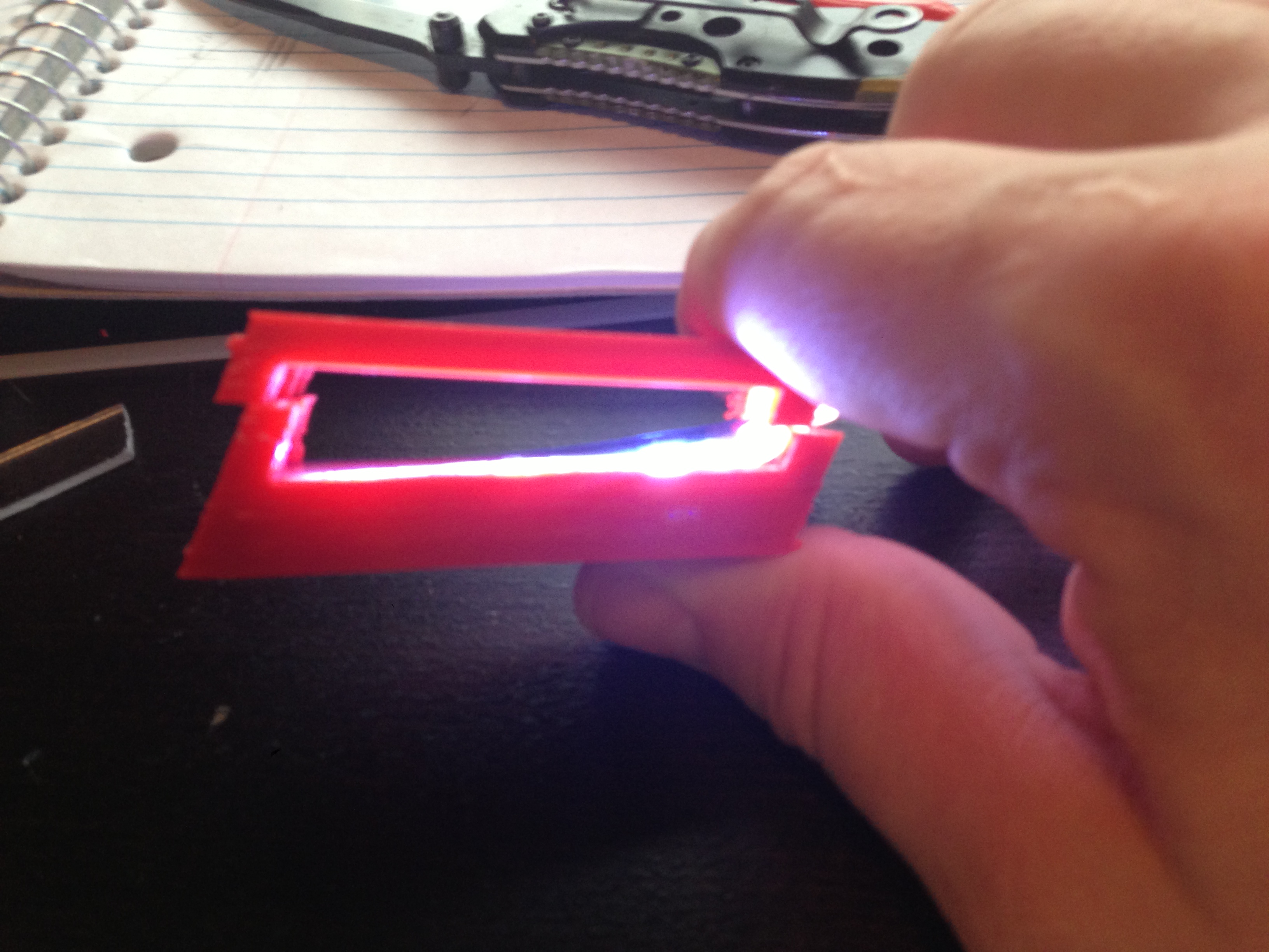

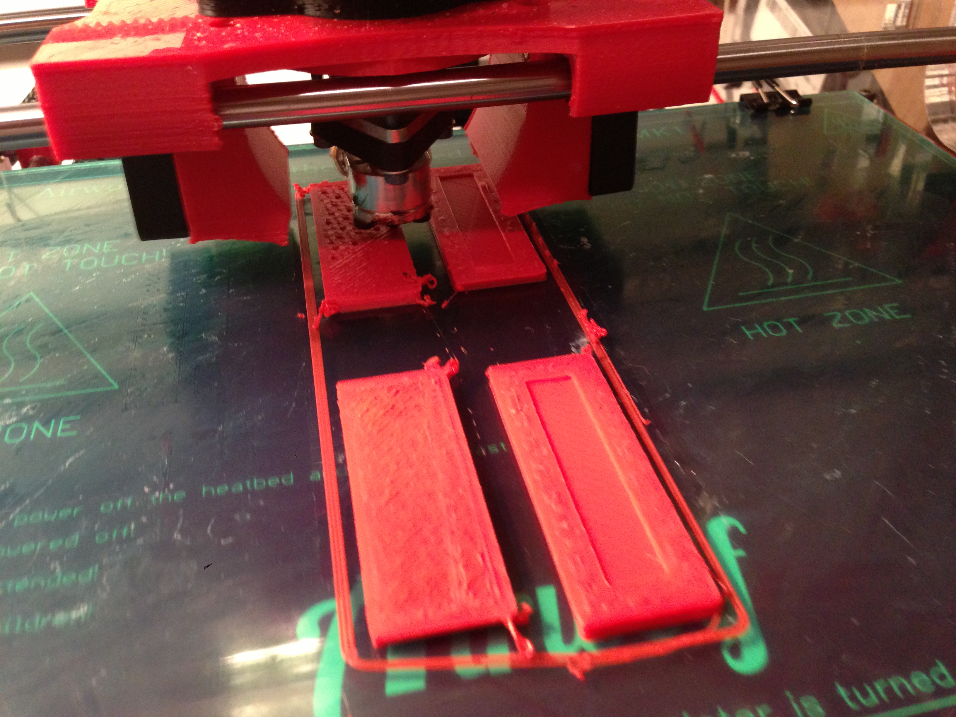

So I messed around with it a bit more - the 3d model didn't print smoothly - hiccuped 1/2 way through so the pieces don't fully line up. I had deepened the groove and it worked to block the lights from the eyes very well. It still isn't diffusing the way that I want it too so I tried a couple things, 1 piece of quick tie cut to length (not bad) and a small strip of printed glow in the dark blue - THAT did what I wanted. plus it's cool. But I think it's still not bright enough. I'm going to try to use 4 lights in the LED strip and see if that works. If it doesn't I'm going to try the other, more expensive, surface mount ones. Those are going to be harder to work with a require a much high power supply (12v vs 4.5v) but are much much brighter. But the concept works - the tint, even just on one side works to cut the glare especially when the lights themselves are below the vision line. If I have to I can tint on both sides of the lenses.
Prognosis is very very good. :D

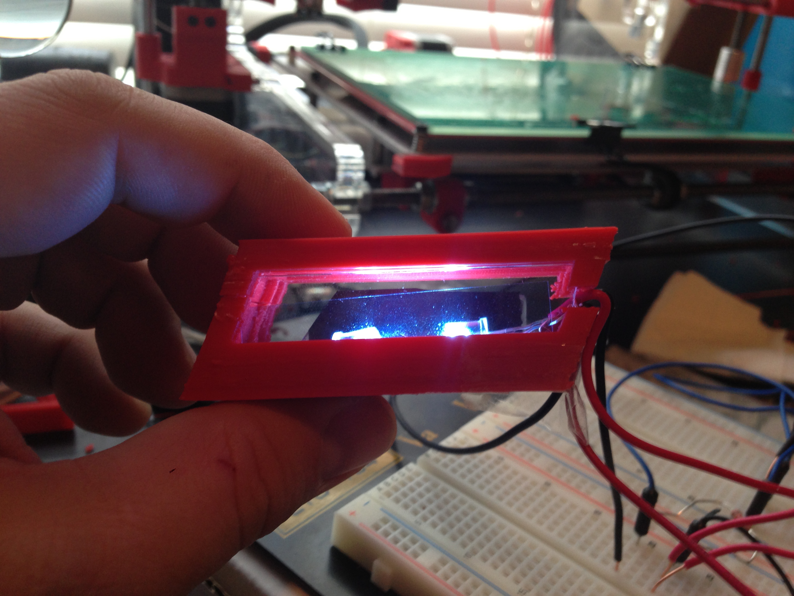

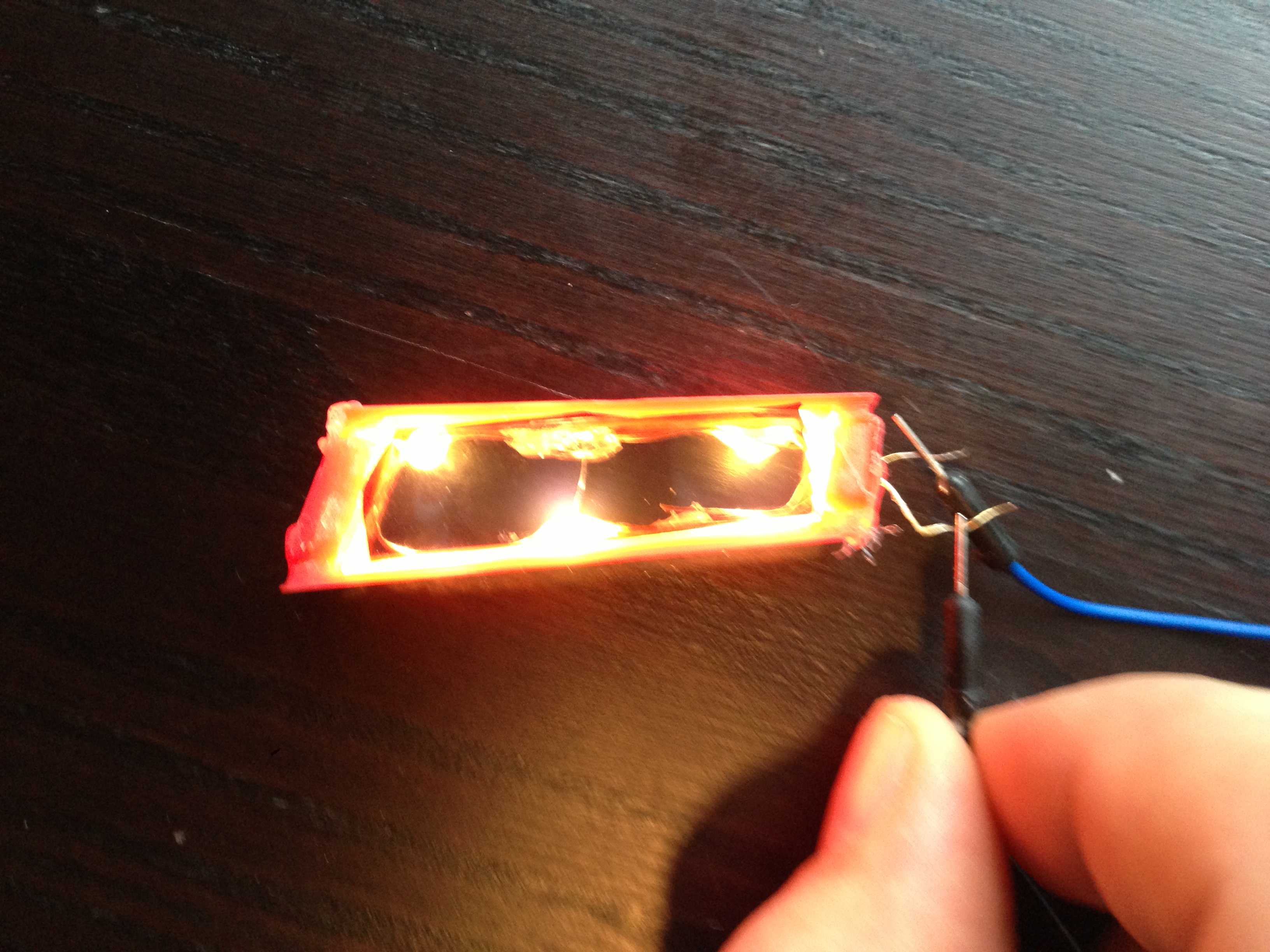

from the eye(in) side through the filter - it doesn't go all the way across that's why the ends are brighter but you can see that the bottom left corner light is blocked very well.
From the front, slight blue tint (even with the bad iphone camera) but it's not very bright. I don't know if adding a 4th will make a difference or if I'll have to go to the different LEDs.

I should have some updates tonight. I'm working on version 4 - changed the LEDs because the small string I don't think is bright enough. So I took a recommendation and widened the frame so that I have a lot more room. I'm also changing how I'm printing it and putting grooves inside the frame for the lenses and setting space to include a diffuser strip above the lights - hopefully of glow in the dark blue :D. I think it should work out the way I want. I had some difficulty slicing the model last night and had to get to bed so couldn't fix it. I'll do that tonight and print it off and hopefully post some more pictures.
it's getting much closer to having a final frame version. after that it'll be testing which LED's would work best and still keep the price down. Still have to work out the wiring scheme out and how that will work. If you have suggestions please feel free to post them. This is my first time doing something like this so I don't mind advice :D

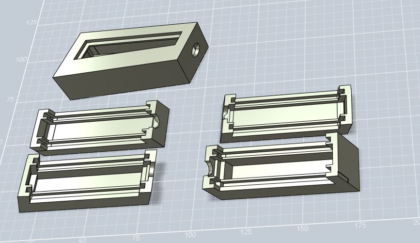

Thought I'd give you a shot of the model I've been working on the the last couple days. It's printing right now.
Can't wait.
I try to post it here. Hopefully, this time is gonna work.
I've just seen your model and WOW :cool
That's pretty much exactly how I planned them :d there's been some tweaking but everything looks like it's going to work the way I want it too. should have some pictures up in a bit, I'm assembling and testing it now.

Back to the drawing board. The current design isn't working to reflect the light from the LED's the way I think it needs to so the eyes aren't glowing the way they should. It looks cool and all but not the way it should. There are a couple more things I'll try before I go back to redesigning the frame. I still the concept is sound though.
