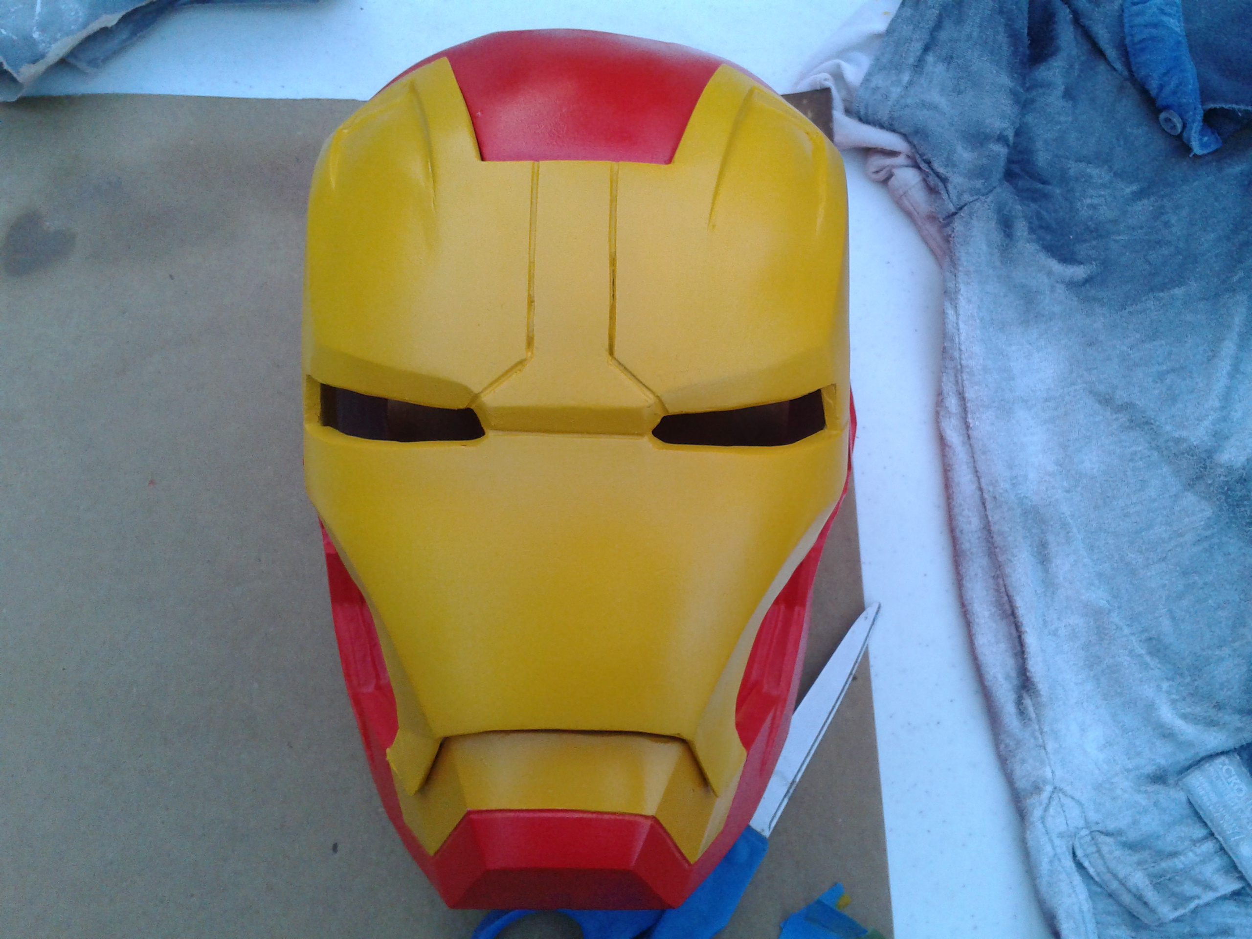

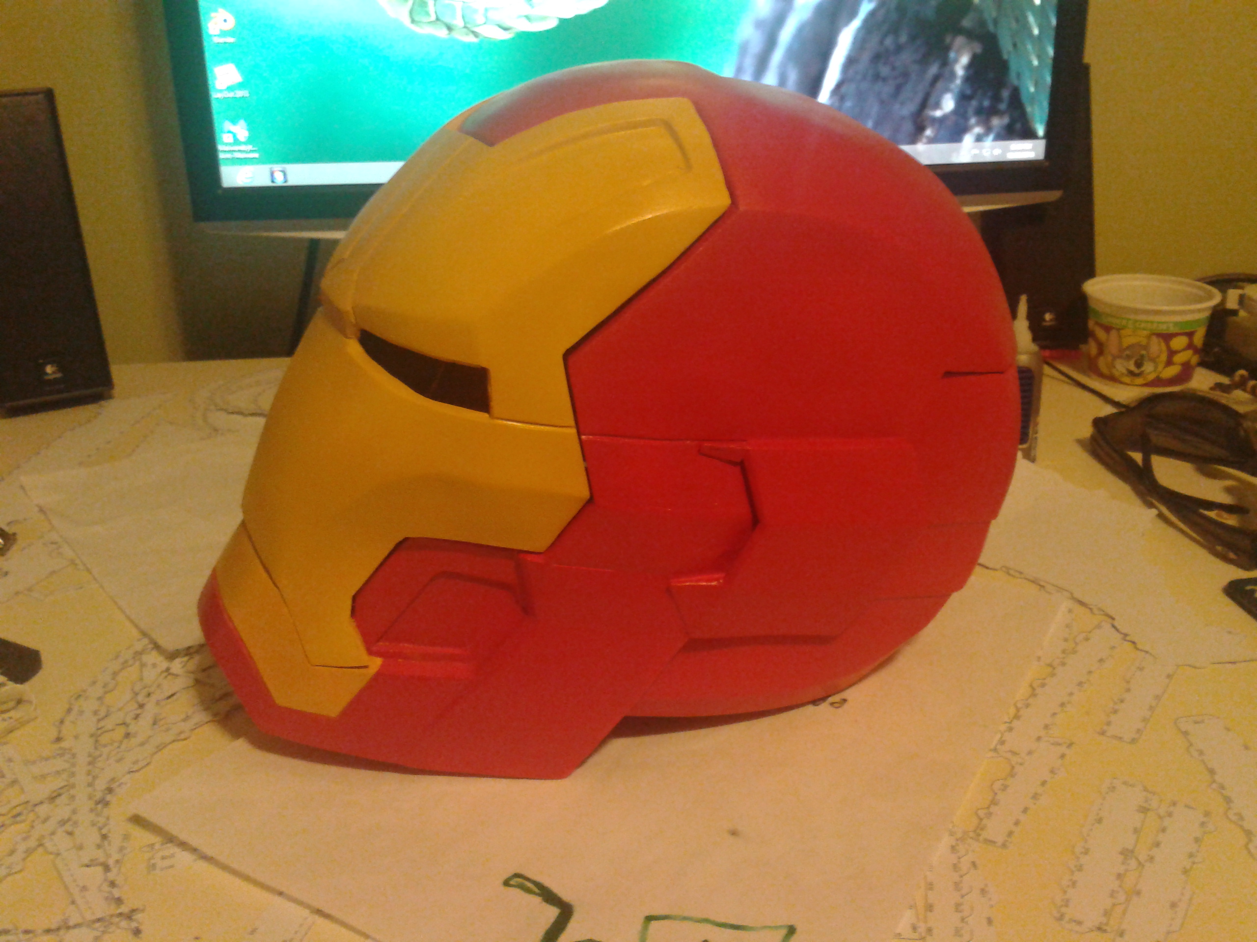

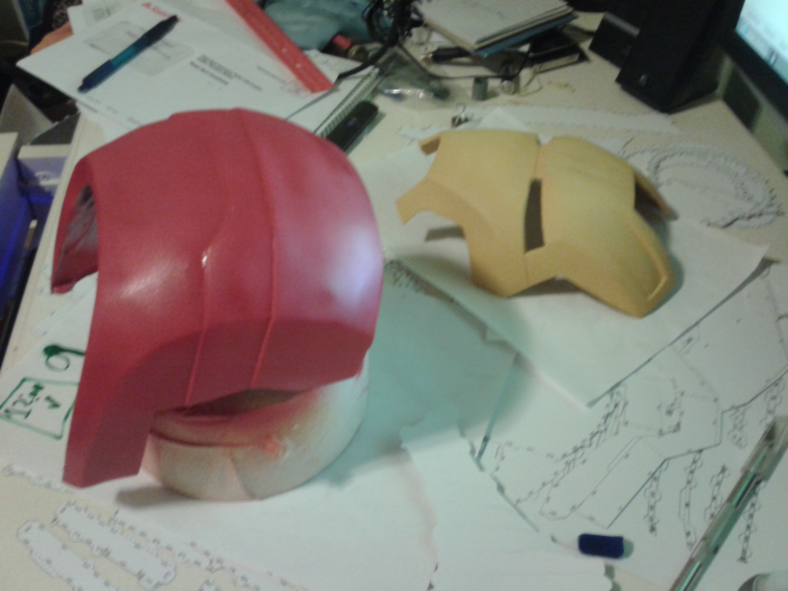

Finishing up one for my son for his Halloween costume. Thanks so much gimpee!!!

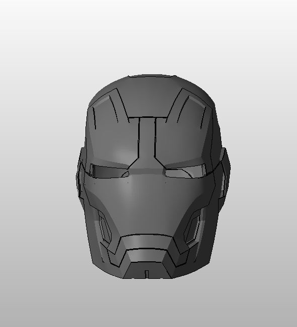

MARK 42/43 HELMET FILES READY FOR 3D Print! - FREE, thanks to devildog12
, links added to the first post.
