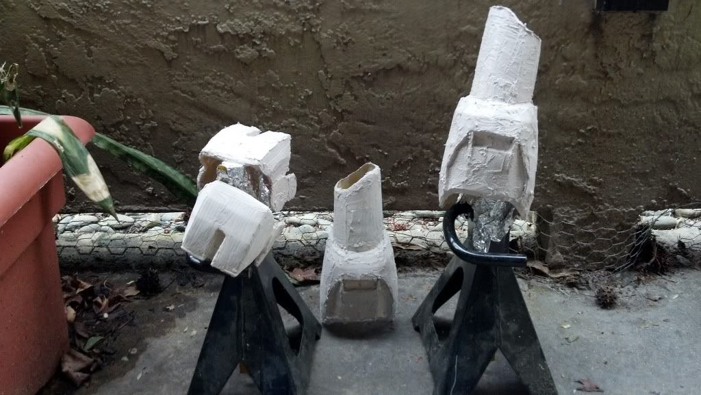

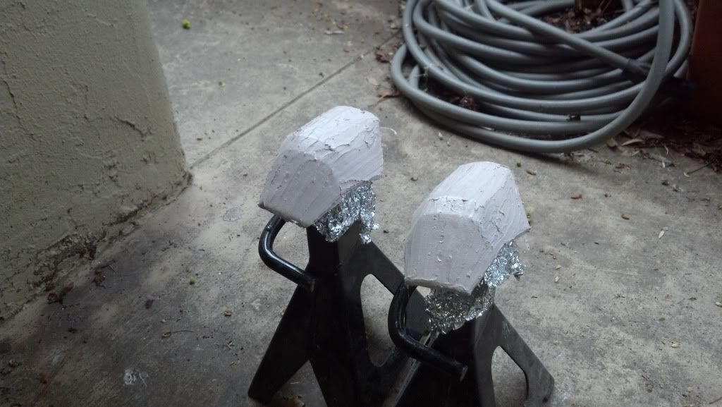

I have a update, I was able to do some bondo work today.
and here they are sanded

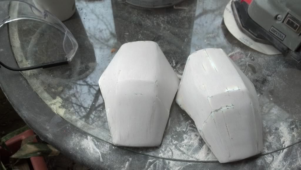

I was able to get the shoulders started too
and here they are starting to be sanded
I wasnt able to finish sanding the shoulders today, but i will tomorrow. I also sprayed the first coat of plasti-dip on the abs and belt.
I probably should have put something behind them before I sprayed, you can see where I did it lol
Well thats it for now. I will have more updated soon!

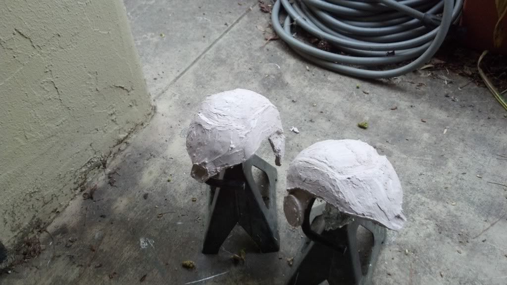

Well, since you asked, it looks like you put the bondo on pretty thick. It will cure still but you loose a lot of the details in the pep. My advise would be to use thinner coats and build up little by little. This way you keep the details without having to re-sculpt them.
Thanks I will try that on the next piece and let you know how it works out!

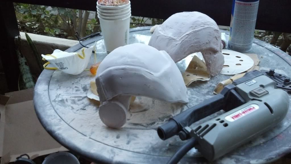

Here is a small update and a question. I got a few more pieces Bondoed and I did notice that using less was a lot better thanks again for that tip! Here is a pic of what i got done today.

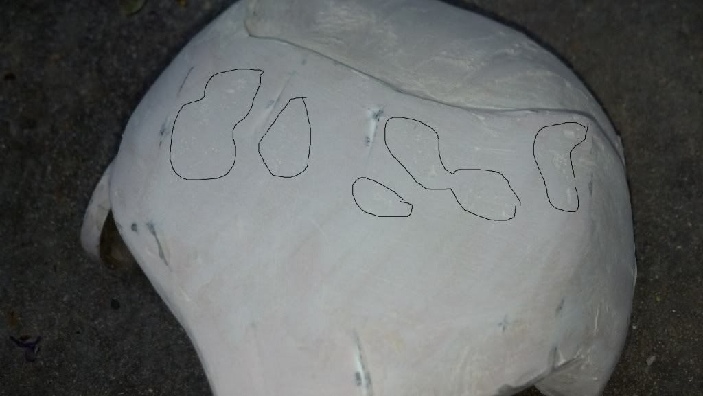

As for my question, what are you guys using to fill in the little holes left in the piece after sanding? I tried putting another layer of bondo but they seem to just appeared in different places. Here is a pic of what I'm talking about.
I circled the holes I'm talking in the lower half for the shoulder as I did not sand the upper part in this pic. I tried to just sand them out but then it leaves a small divot in its place.
Thanks for your help!

Use bondo glazing and spot putty. Air dries in about 15 minutes. Great stuff for filling littles holes.

those are too big for a spot putty (ONLY use a 1 part spot putty for pinholes). You have to still use regular filler and use a "block" for those spots. You have to use a better filler IMO. Go find an auto supply place and look for 'Evercoat Lite Weight' body filler (that's the name, and it's $20 for a gallon and get a blue hardener). Also get a dark gray primer to "mist" the surface before you sand the areas to identify spots.
Thank you sir, I will definitely look in to that! Before I read that I did pick up some spot putty though. I will try it on the small pinholes and see how it works out.
Again thanks for the tips! I appreciate them a lot!

Also, from the pics you posted it looks like you have too much 'texture' left when applying the bondo. You should smooth out the bondo while applying it. If you start with a smooth surface then you have to do a lot less sanding and there will be a lot fewer pinholes in your work. If your bondo starts to get 'clumpy' then you should not use it anymore. If you didn't have enough time to work with it then you are either using too much hardener or you are mixing too much bondo at once.
Once you get it pretty smooth a filler primer does a good job at covering the smallest imperfections on the surface.
You are exactly right. I started sanding them and that texture is causing a lot more work. I'm still learning and hopefully by the time I do the helm ill have it right! Thanks again everyone for the tips and input! Its really helping me out!

Looks great man. You are in sanding hell right now but keep it up. If you don't already have one grab a mouse sander. Makes the job a 100xs easier
