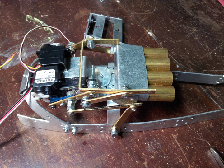

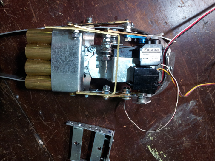

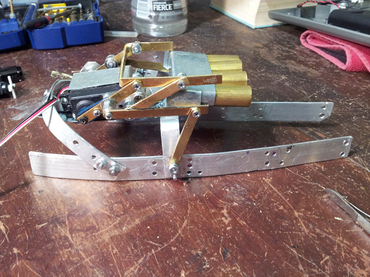

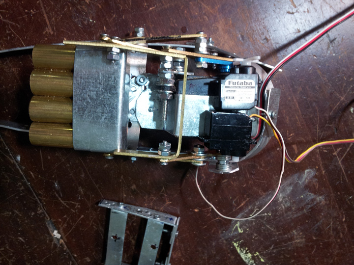

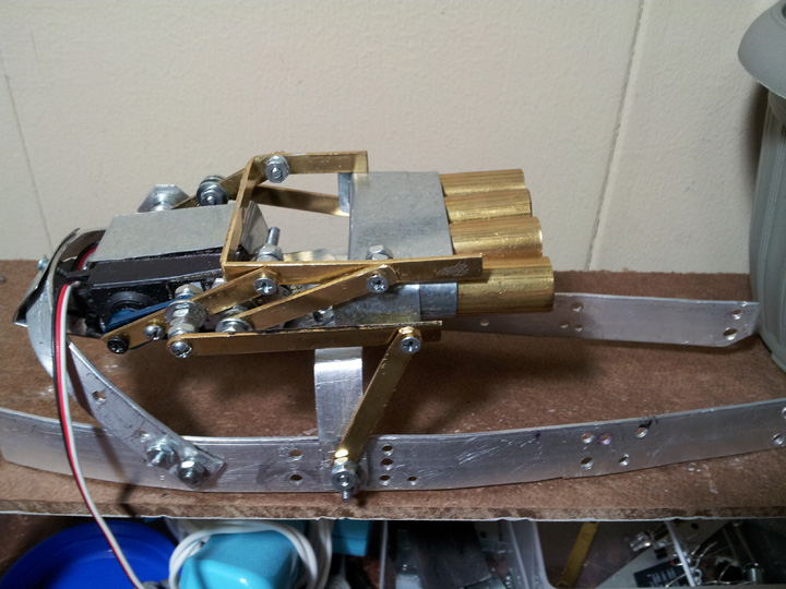

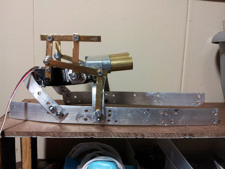

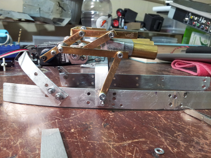

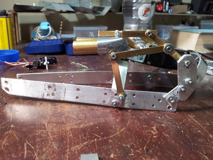

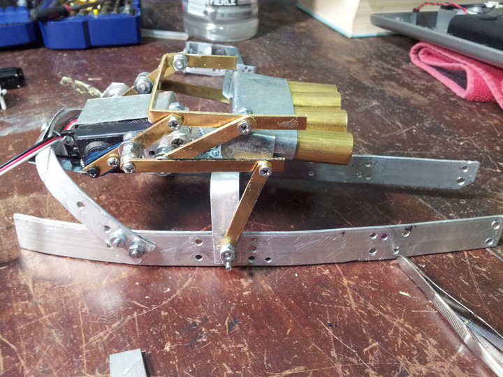

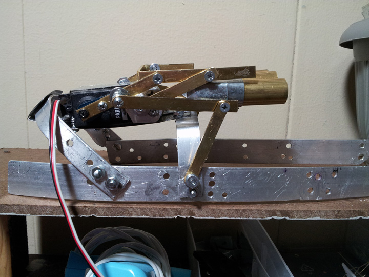

Progress on reworking that brass lift/mount for the right forearm ... sorry the desk is so messy, lots of stuff goin’ on right now. I’ll get some better photos and videos up soon.
Looks like two micro servos will perfectly replace the single standard, so… that’s what I’m gonna do. I’ve been having a problem with the lift not staying centered and it’s because the mechanism only lifts from one side, so it goes a little wonky. I like the high-torque micros by Futaba; so quick, can’t wait to see it finished.
I’m pretty sure this lower profile lift mount will be just what I needed… it’s crazy how every time I think I’ve made it as compact as possible, I will immediately realize how to improve it. I’m going to stop here on this one though, except the servo swap and a little metal trimming.
20141122_011122.jpg20141122_010850.jpg20141122_005327.jpg20141122_005315.jpg20141122_005245.jpg20141122_005150.jpg20141122_011138.jpg
Hopefully it won’t take too long to finish the forearm completely… thanks for the juice, lol

Question: Dont they sell a dual-sided servo?
Something like this:
It would lift both sides at once, wouldnt it?
well, how bout that... ya learn something new everyday! I will def look into these and check the sizes; would make life much easier. Thanks man!

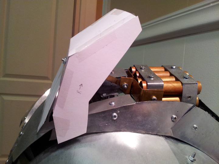

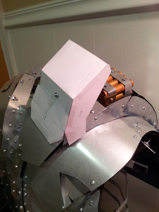

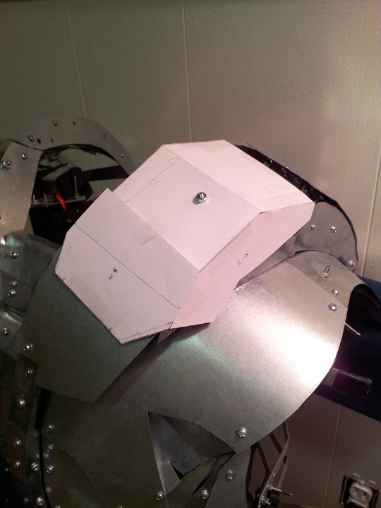

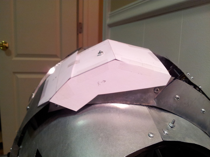

Here’s some progress on the right shoulder missile. Now it tucks nicely inside the harness and still has good enough clearance when engaged. My batteries were pretty low, so the servo is moving a little slower than usual in the video.
I’m working on a cover for the pod on cardstock (pretty excited about it). It will have three moving parts; the one you see in the video, a sliding section for the front, and an articulating piece to cover the opening in the back (much like the one in the left shoulder video).
My camera was dying so please excuse the focus, I didn’t have time to review what I was recording or get a shot from the back, but I’m very happy with how it looks.
