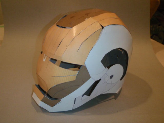

After 2 hours:
I once said in someone's thread, using superglue for pepakura is not recommended.
Well, I was wrong!!!!
However, i used thicker cardboard, instead of stock card.
I don't use the flaps, so let's call it speed-building-pepakura style :cool
I am planning to mix it with the foam, especially for the sides.

After 1 hour of work
I am pretty satisfied with the build so far.
It is actually quite sturdy.
The ear, intake above the ear and jaw will be added by using foam (that's why I call this hybrid)
I am still thinking about alternative to fiberglass, but definitely using resin still.

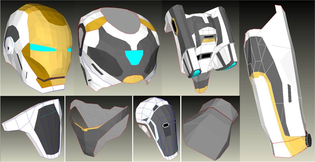

I finished the upgrade of the pep files, I called it v3.
Thanks to omarbou1, I also made a new handplate based on mk42 with a little bit of adjustment.

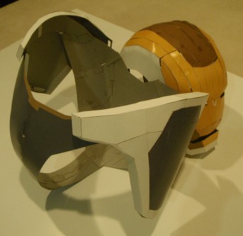

Cod is temporarily taped.
Without the hips, it really looks like bikini's bottom.
I was afraid that it won't fit, so I changed the scale a bit bigger.
It turned out it is a bit bigger.
I probably keep it.
Next is hip

Cod and hips are (almost) done.
Faceplate is secured to the helmet, for resin and FB later.
I cut the lower chin a bit, so my head can actually go in, without the back plate being separate.
...must ....add.....foam
I already cut the shoulders and jetpack!!!
