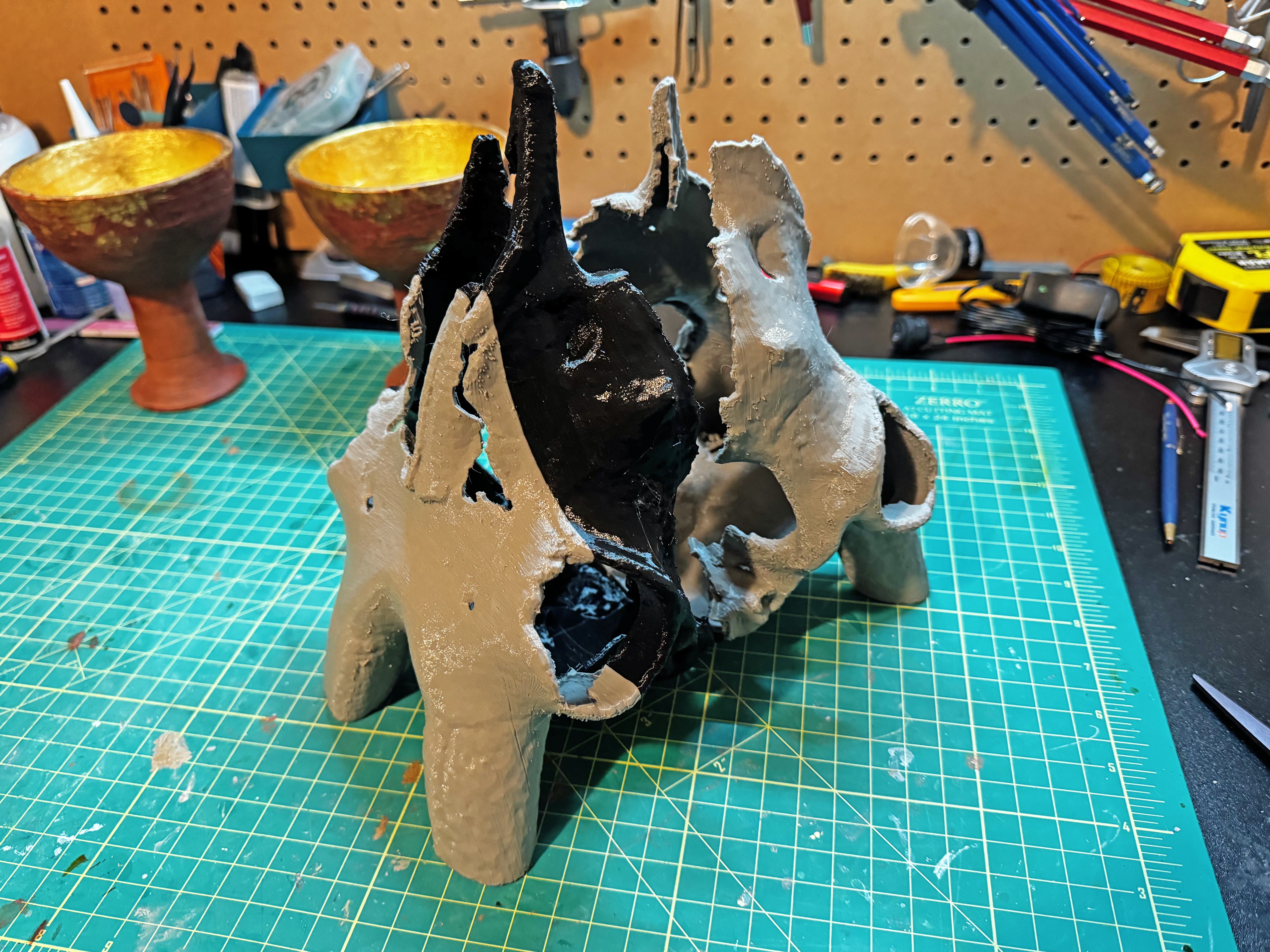

The first test print is done. It's about 75% of the final. 1/2 of the final version is printing now. I have a new printer coming soon. In the meantime, this project should use up most of the material I have spooled up for my old one. The detail is OK but it is s-l-o-w.

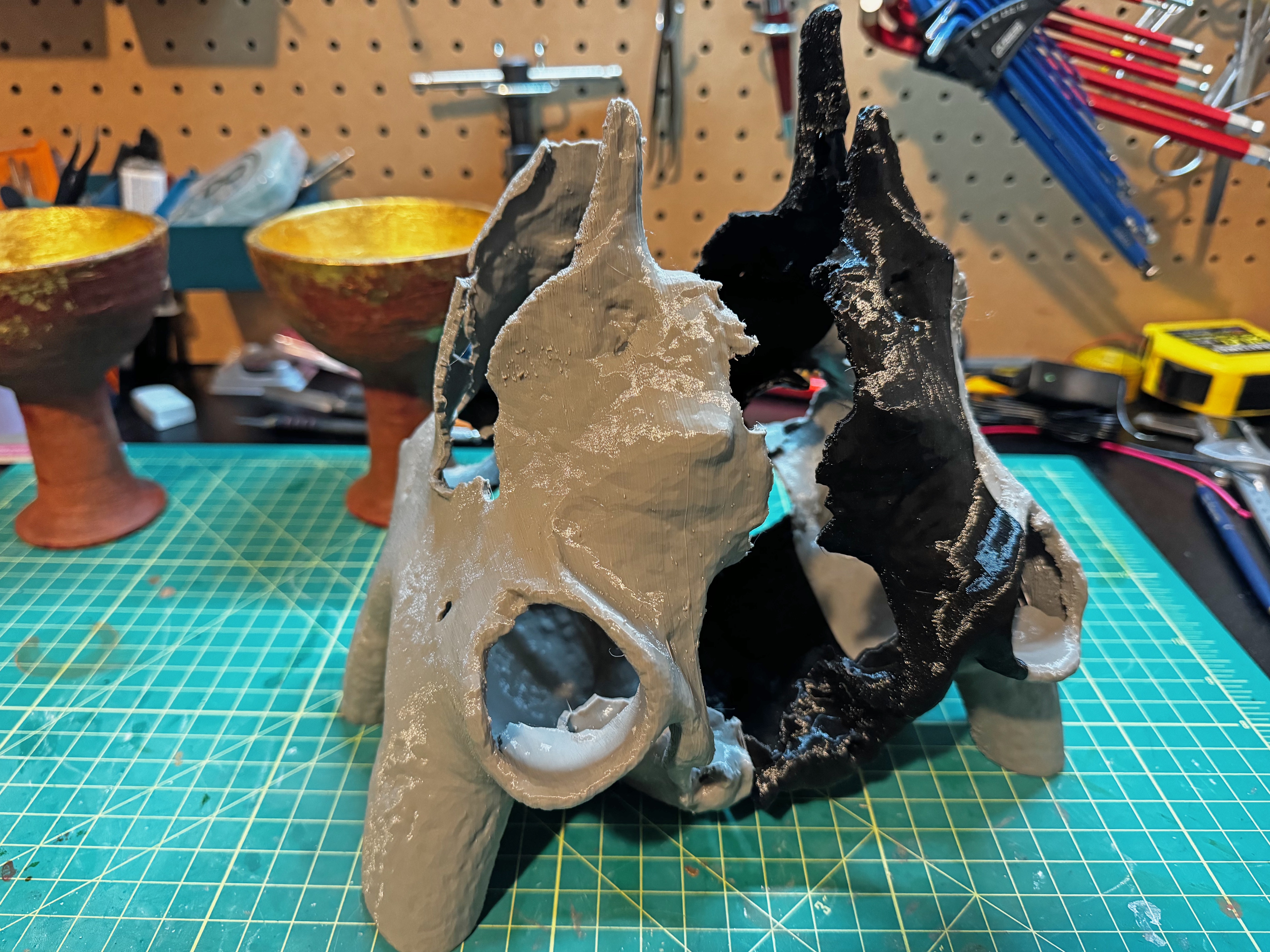

One side is printed. The different colors are because I'm using up all the spooled PLA for this old printer. Anyway, this project started because I got a headpiece from RelicMaker. After I spent forever adding an antiqued finish to it (the piece he produces looks beautiful, newer & is probably closer to the finish of the actual prop) I wanted some way to display the headpiece that lived up to the quality of the RelicMaker casting.
As you can see, there will be lots of sculpting over the 3D print. Then my favorite part, painting. I also need to add about 1cm of height to the horns. As it is, each half of the cradle maxes out my build plate. Anyway, the other half is going to take another 40 hours to print, so I'll have plenty of time to tinker with this side.

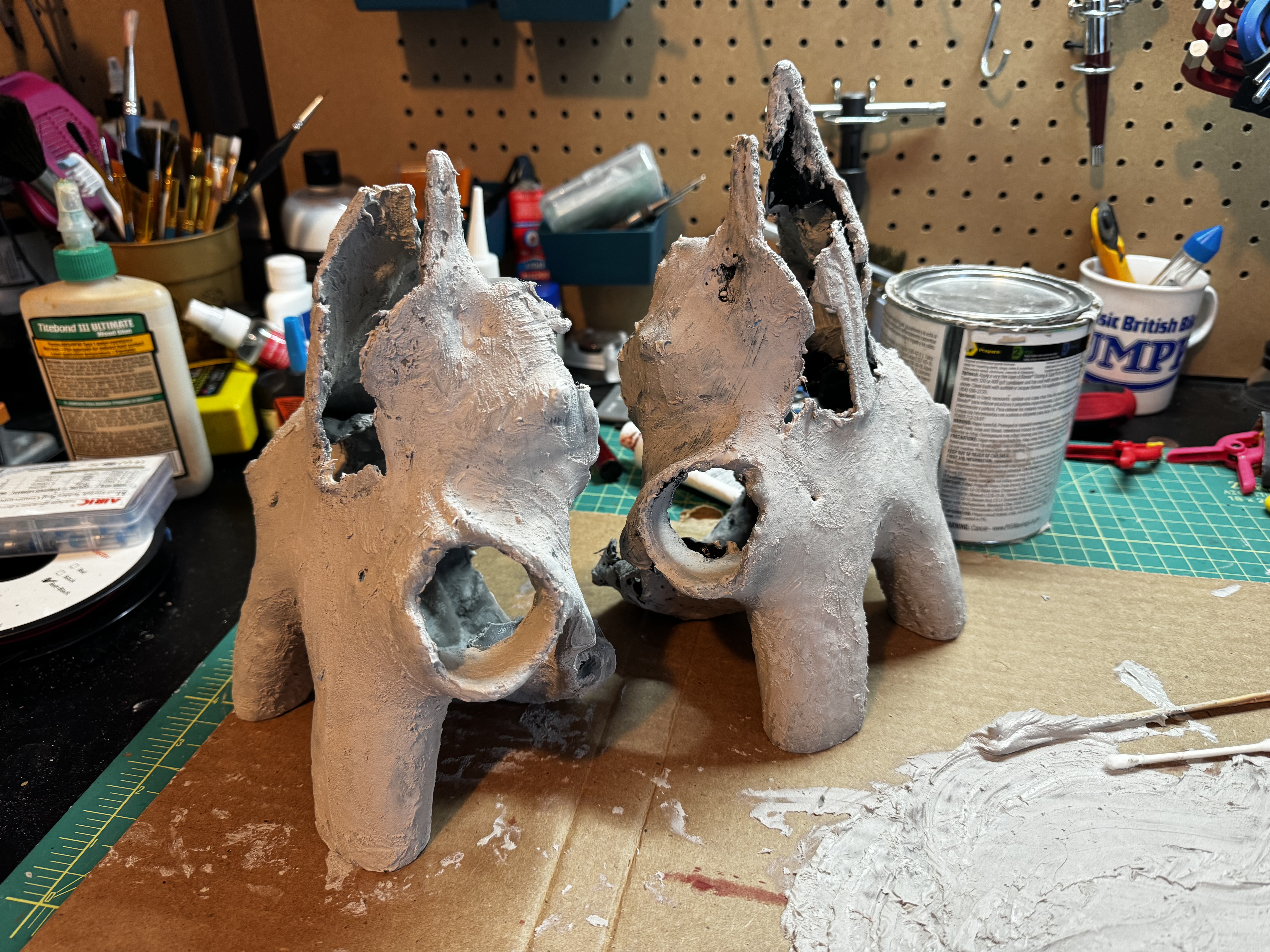

I'm finally getting back to this. Between work and finally getting COVID, I haven't had much time for projects. I've just finished the "smear Bondo all over it" phase. Next is the "cram epoxy putty into everything that shouldn't look hollow" phase. Then I get to start the sanding, paining and detailing. I found a realistic-ish looking LED candle to use in place of anything that might melt the PLA.

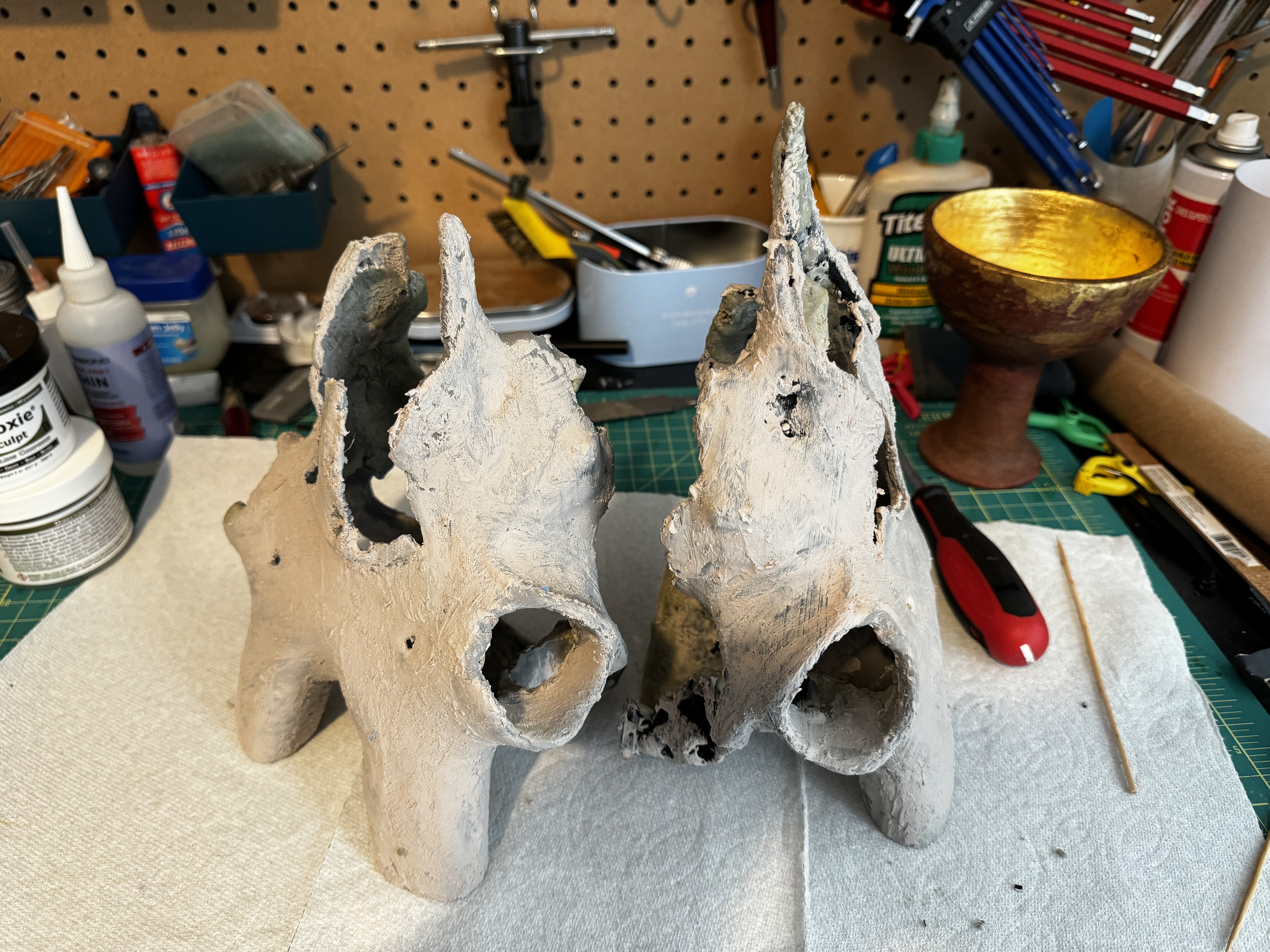

I got a bit more sculpting done, mostly just bulking up the spots where the bone is too thin looking. I’ll do this off & on for the next few days. I’m also using expanding foam to fill in the horns & other voids that should be solid. Anyway, I should be sanding & painting soon.

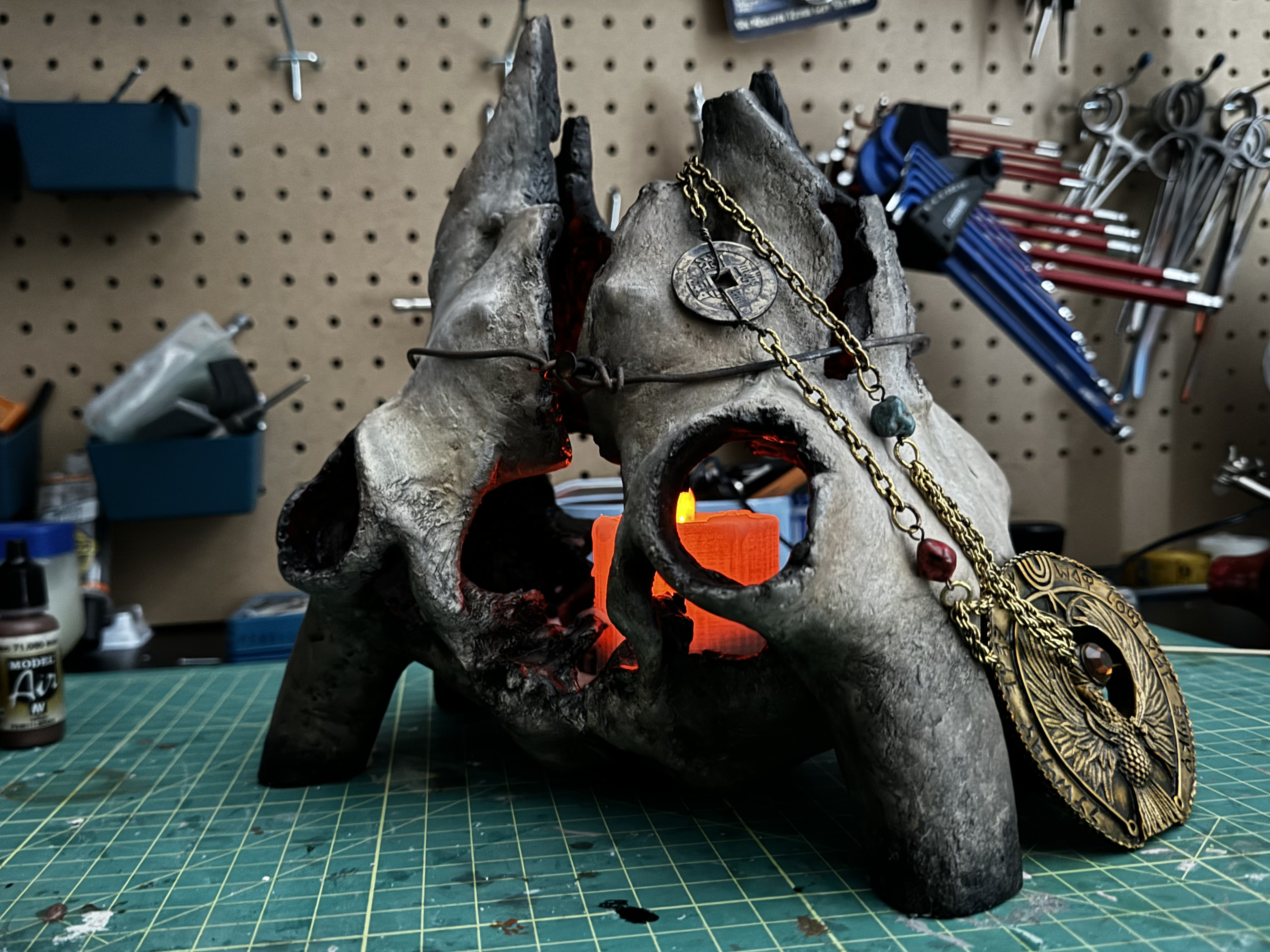

I finally got a solid weekend's worth of work done on this thing. I like the way it turned out. The candle isn't quite as orange as the pictures make it look. I blame LED lights...
I did lots of Bondo-sculpting over the 3D print to get a cool bone texture. I also filled any voids and generally thickened up all the bones.
The paint is several layers thick. The whole thing was sealed with a sandable primer that is pretty forgiving. I used a combination of underpainting, glazes and washes to get the bone and char effects.

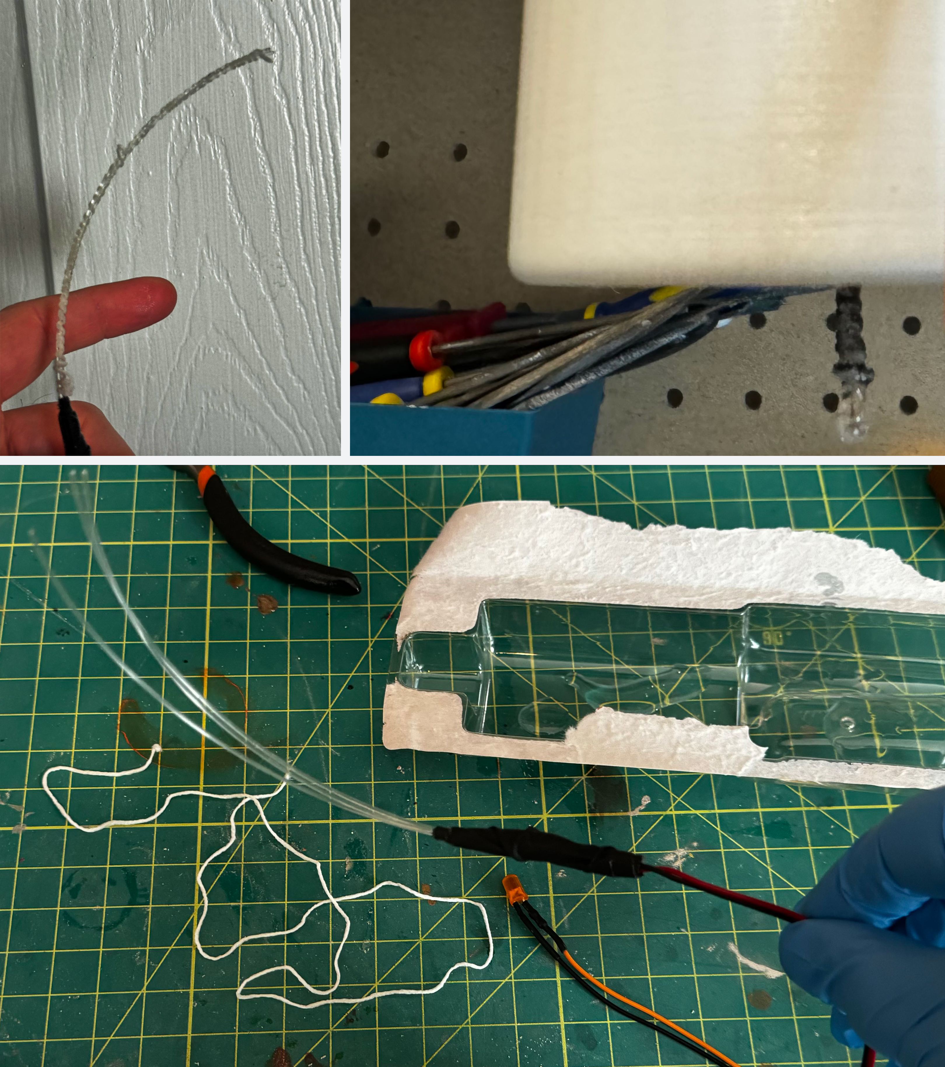

The candle is also 3D printed. I filled the inside with pillow stuffing and orange LED Lights. The flame is a "flickering" LED inside a 3D printed "flame" shape. I light-blocked the base of the candle and then painted it with a very thin coat of pearl white. There is a "pool" of melted wax at the top that is just epoxy. Originally I build a cool fiber optic wick for the canadle. It had a flame built-up out of dripped epoxy. It was cool looking, but it wasn't bright enough.
This was a fun project, I think that I got pretty close to the original prop. I do have little horn extensions that I had planned to add to the bottom of all four horns. They would make it a little more accurate, but even harder to fit on a shelf. Anyway, there are two or three in Marion's bar, maybe this is a perfect match for one of the other ones. One change I did make was to soften the line between the horns and the skull. On screen the line looks great, in person it was super distracting.
