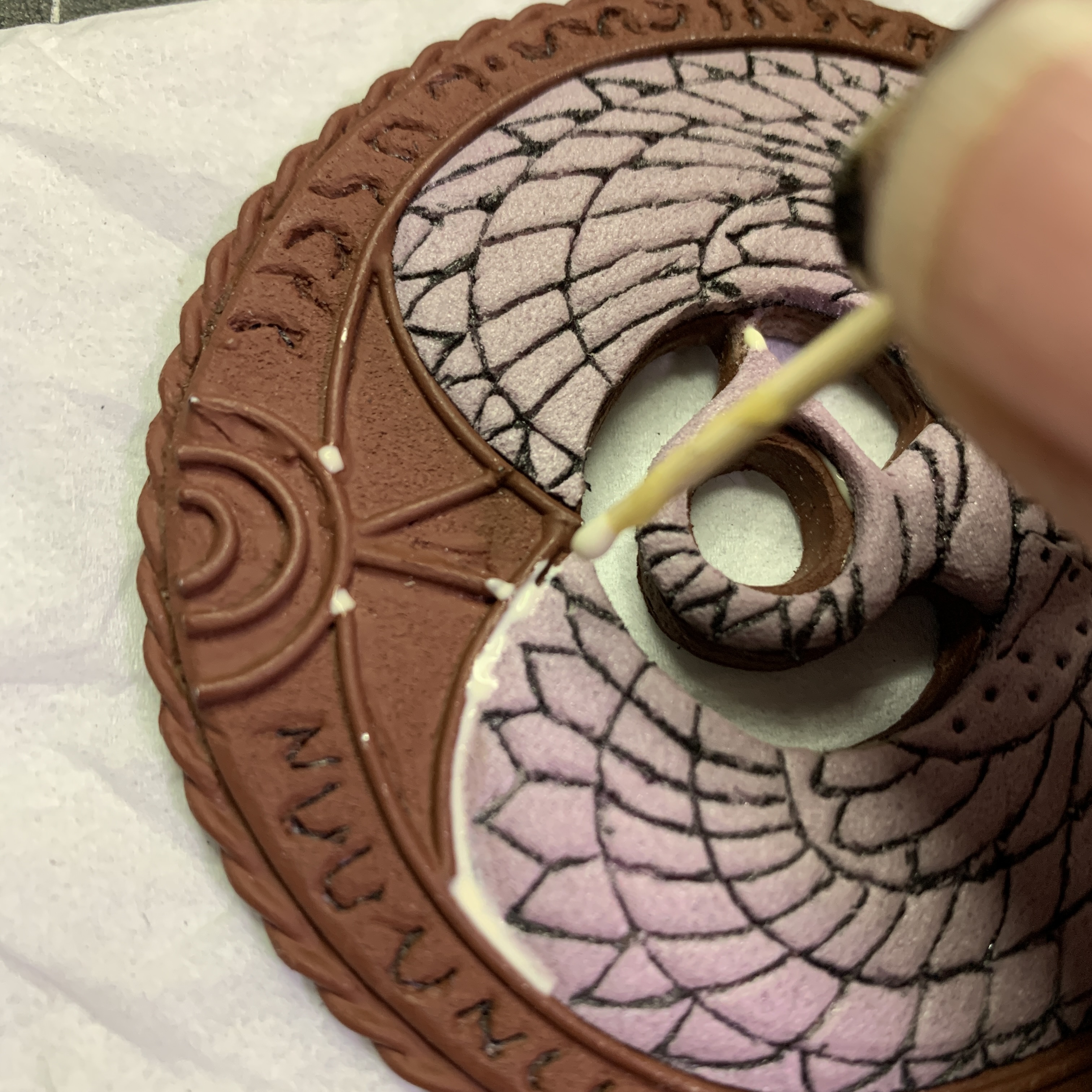

Step 25: Stone Work
While the headpiece was drying with another coat of black I spent a little time using CA glue to anchor the eye-rings.
