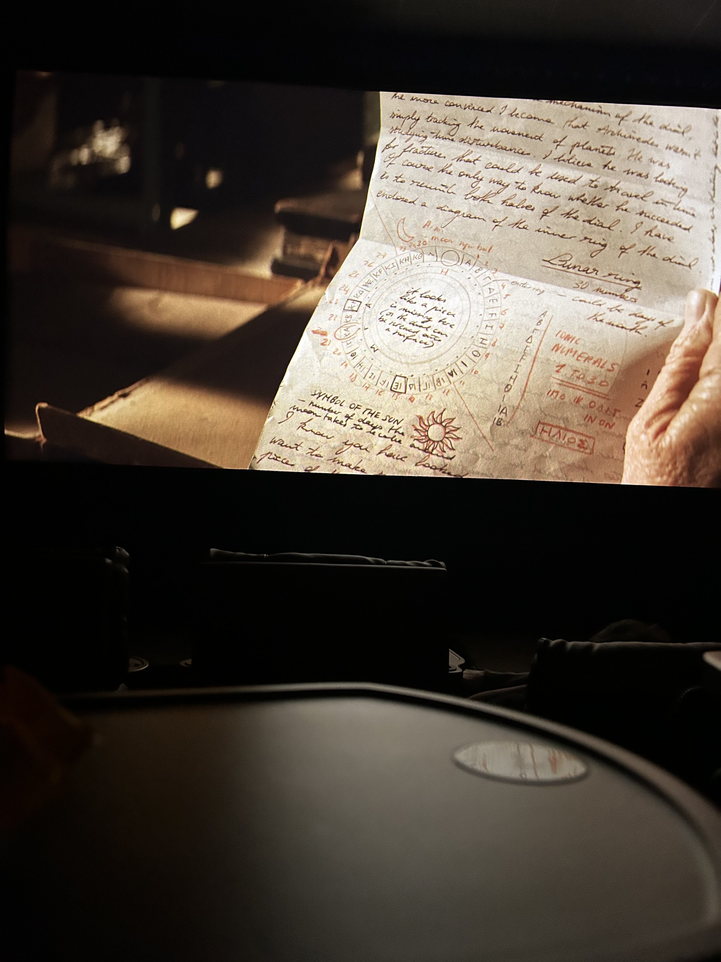

Ok here's a first attempt at one of the paper props so more work is needed the first one has the blue rectangles missing as it looks like there were draw in a blue pencil crayon so you can do the same also not crossed out the one number but with the other one i've added them in photoshop, however don't think the font is 100% right but it's close

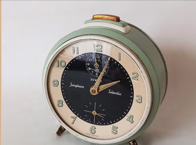

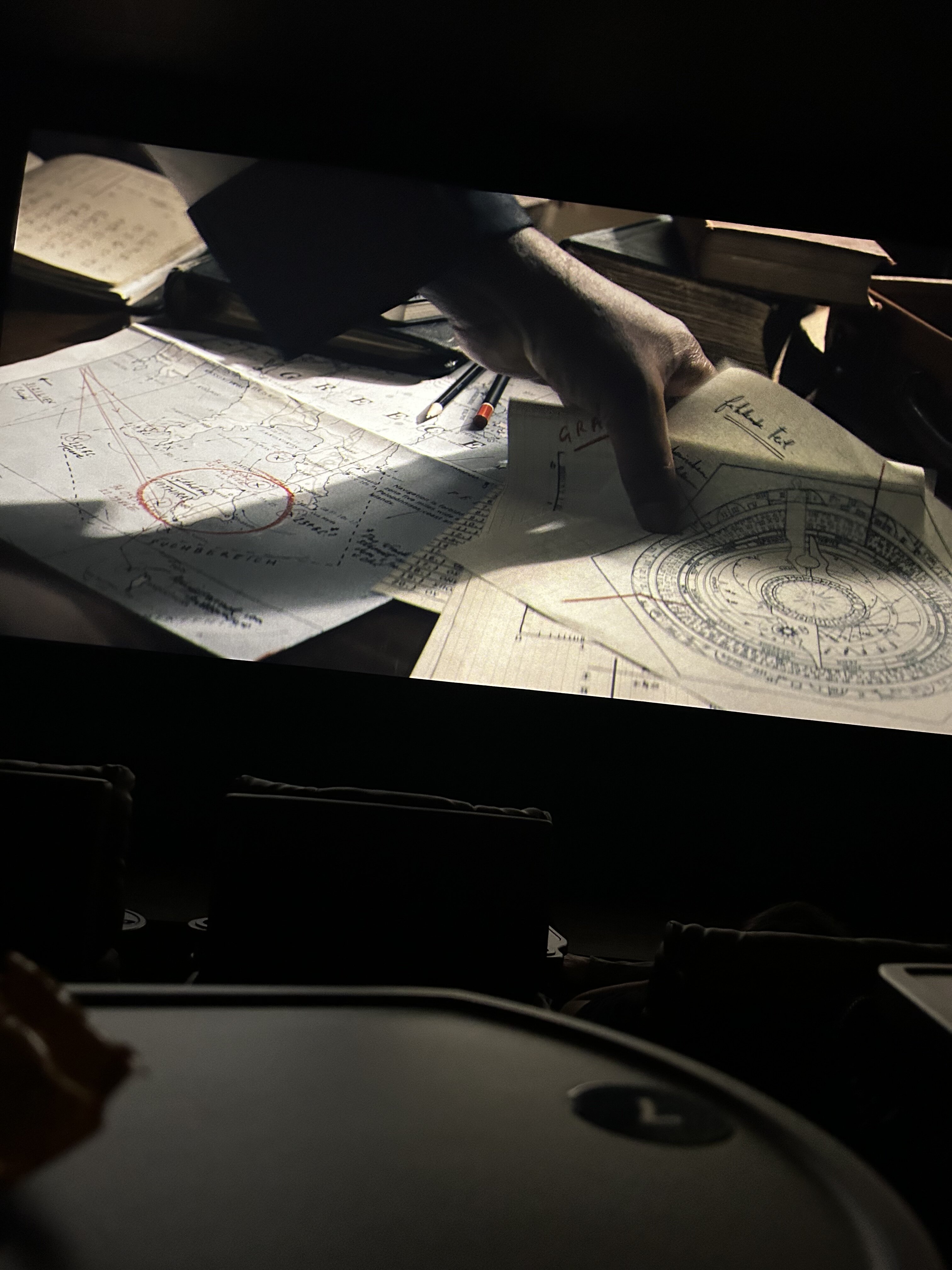

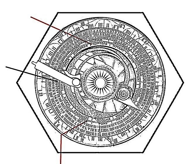

Ok this one needs some work including the text being put on but i can't figure out what the text says or what font it might be ? anyone have any idea

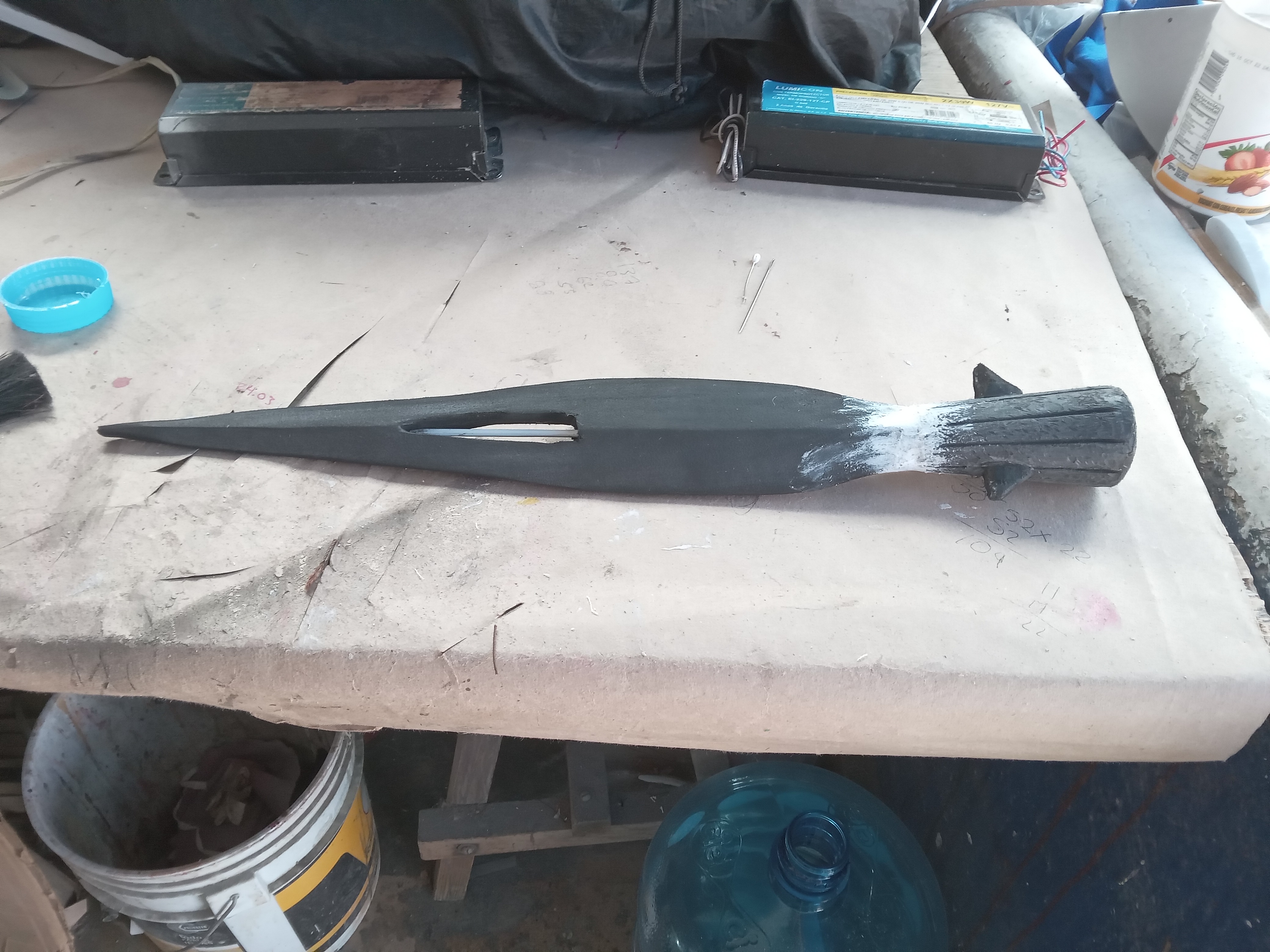

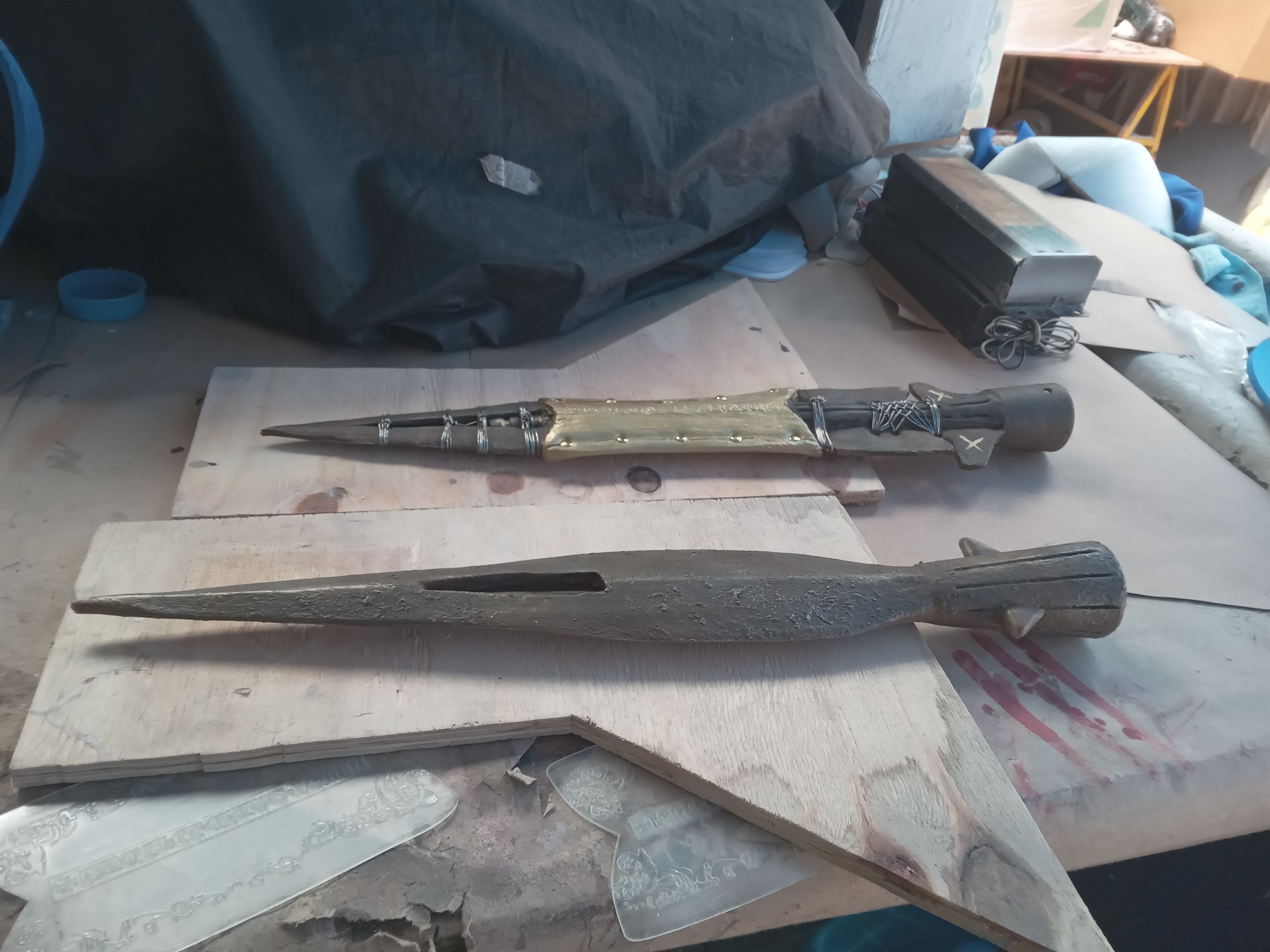

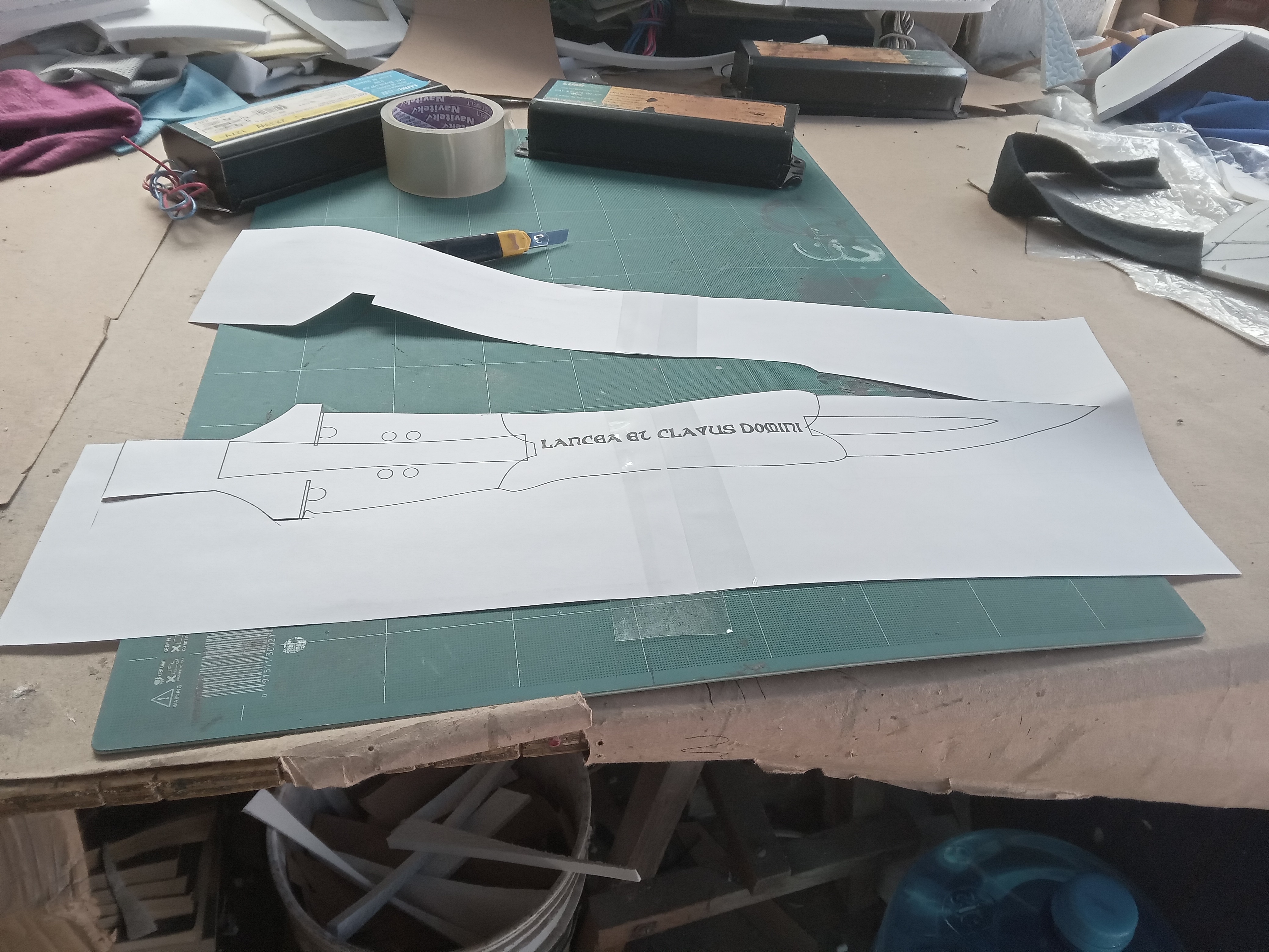

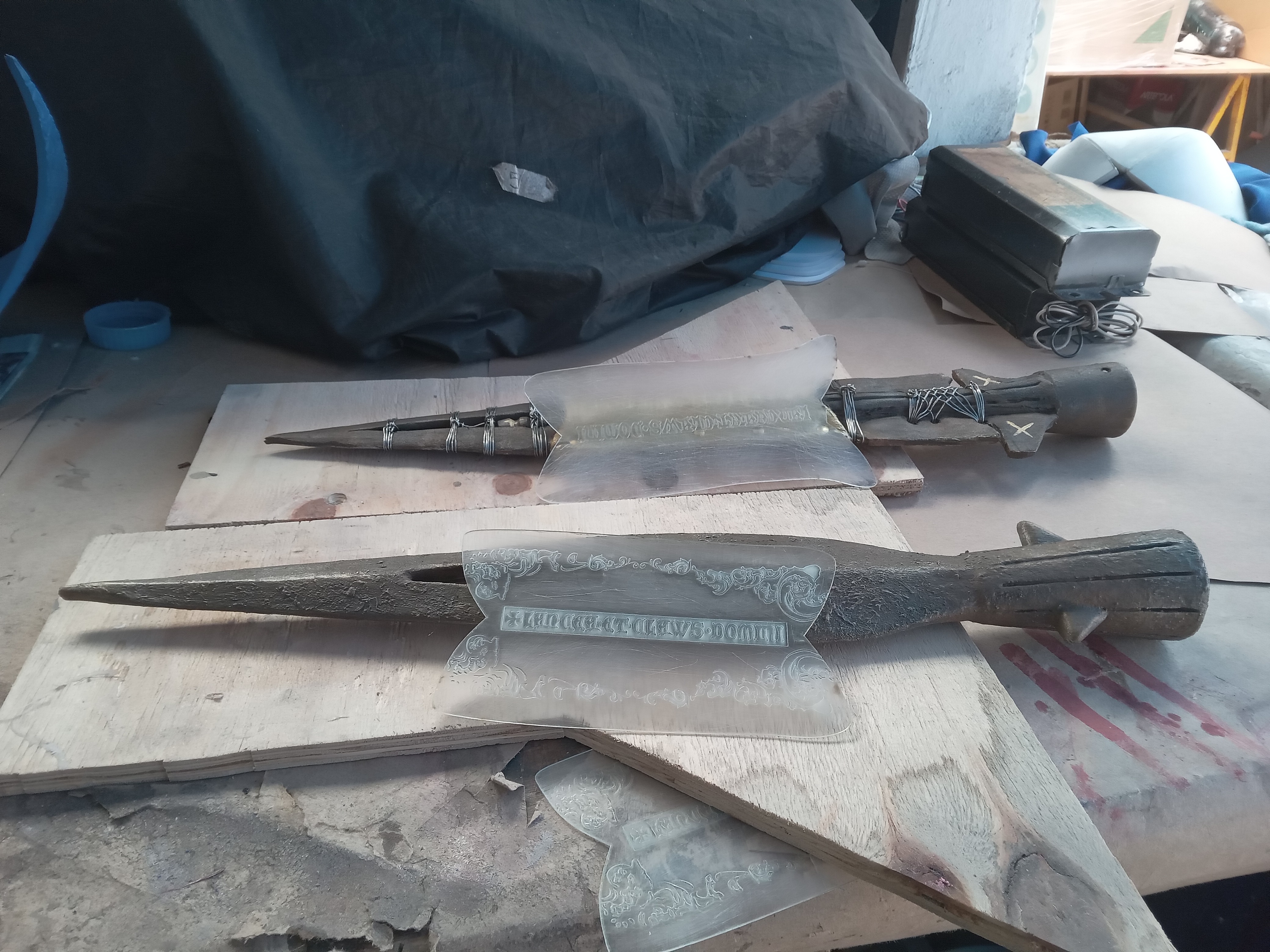

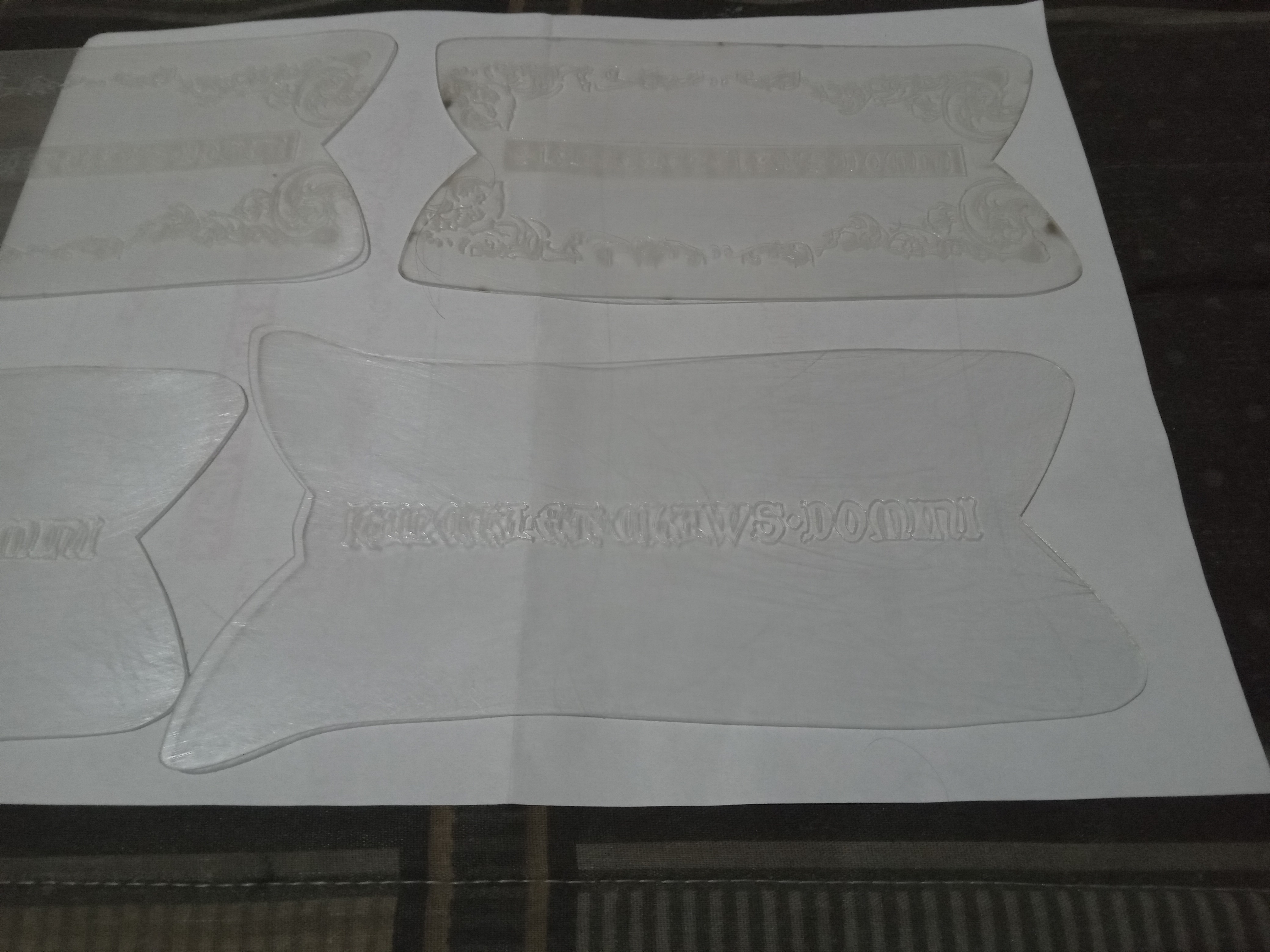

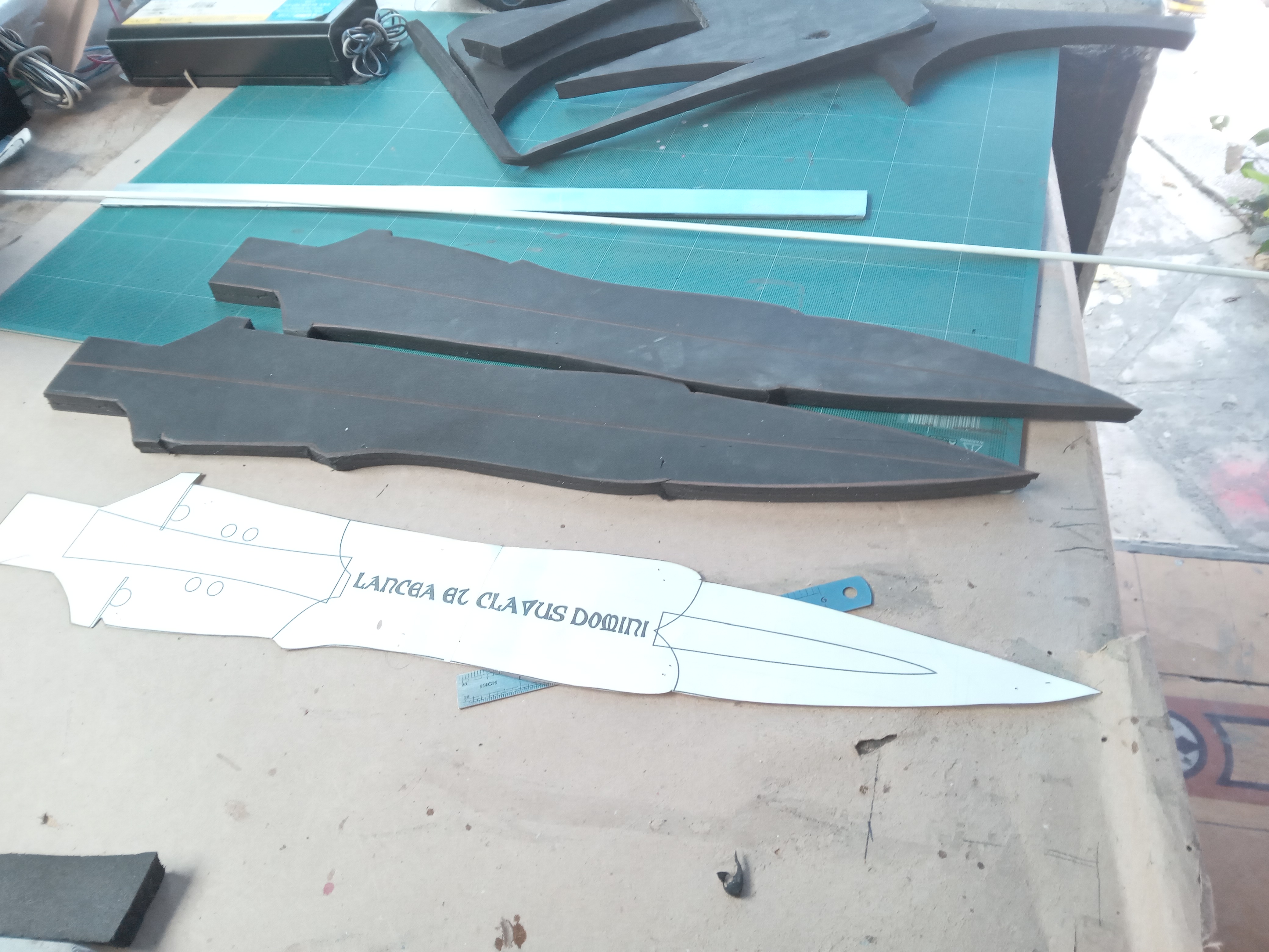

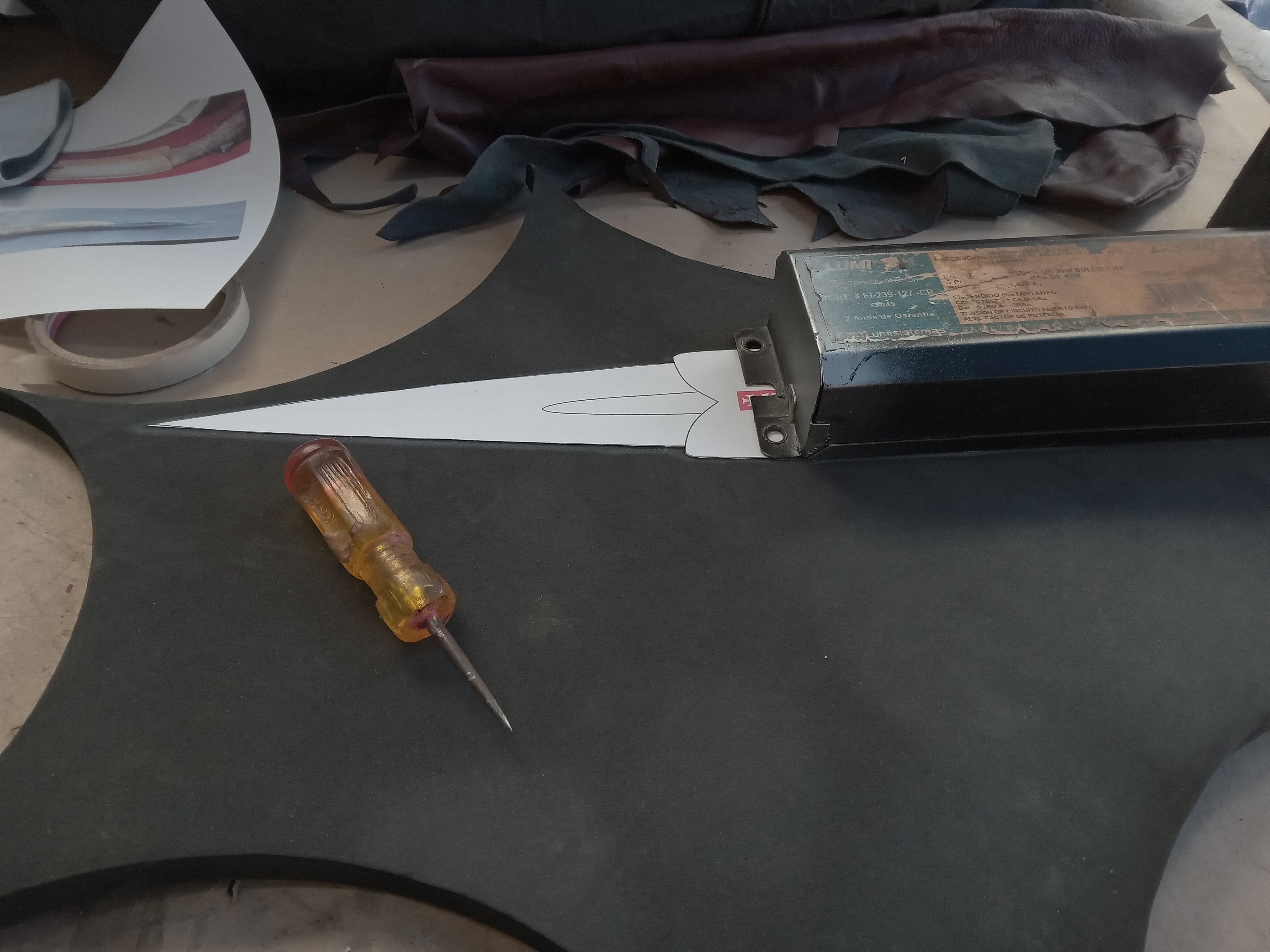

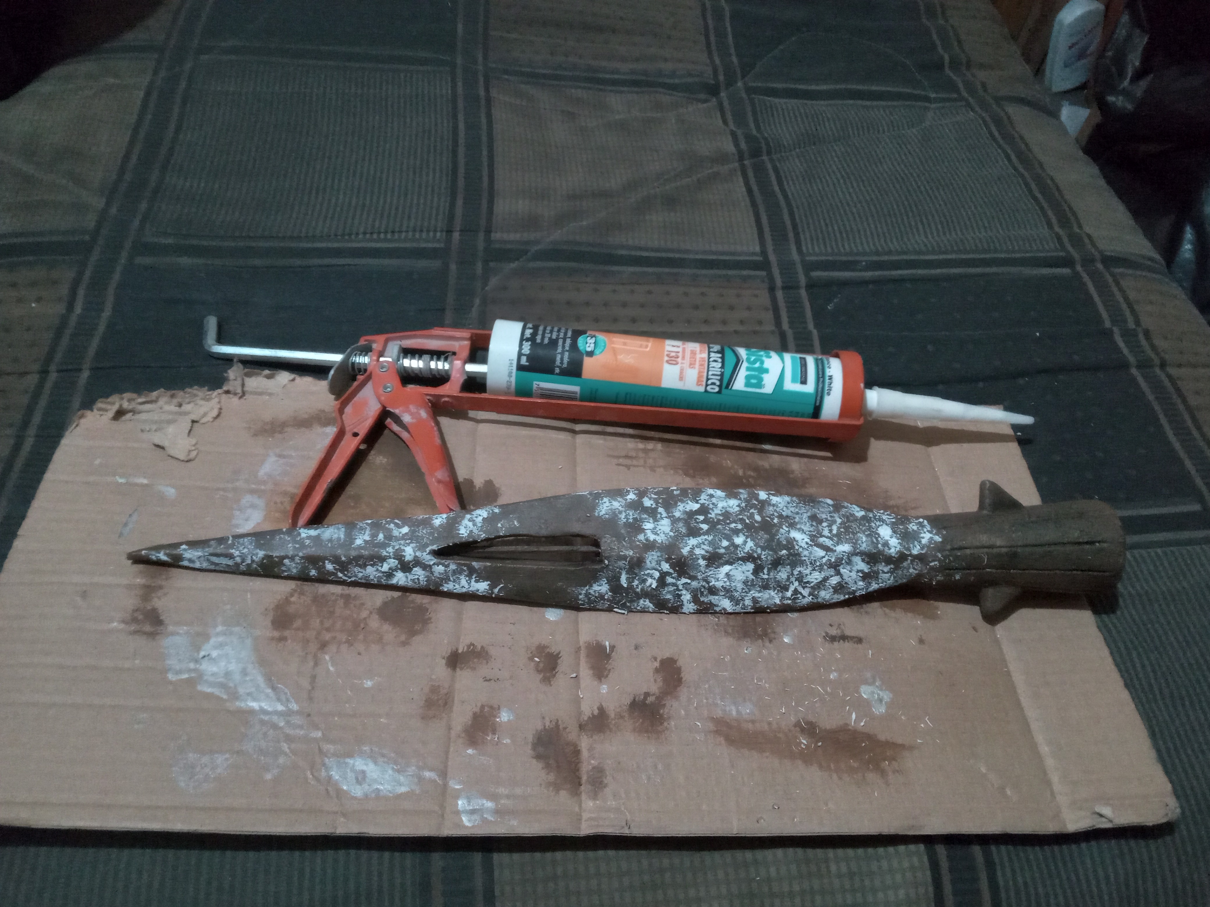

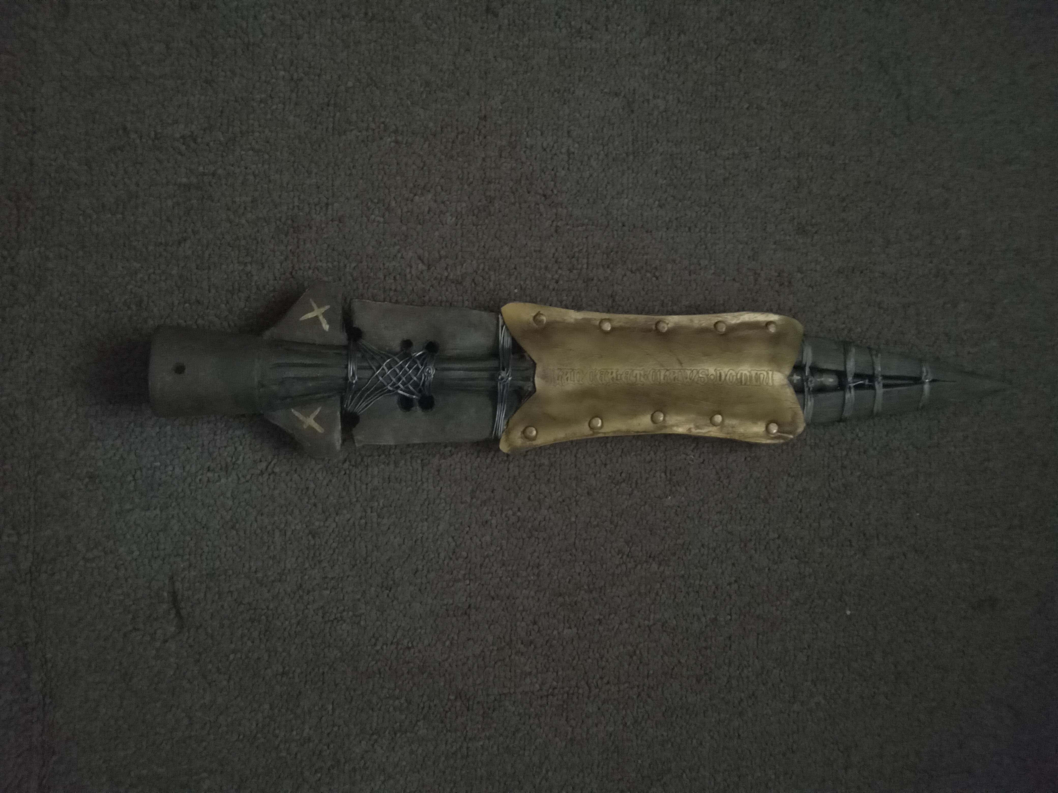

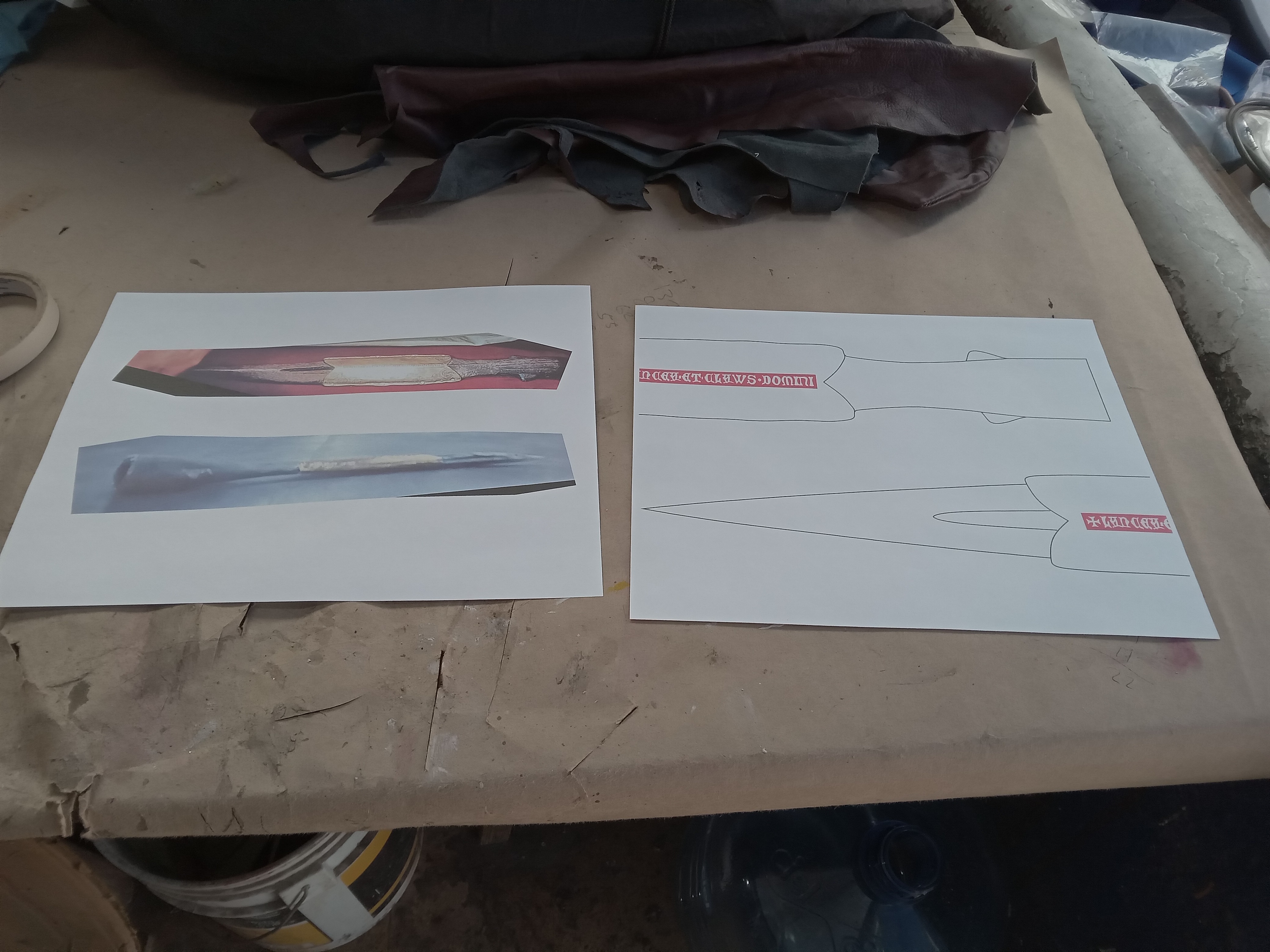

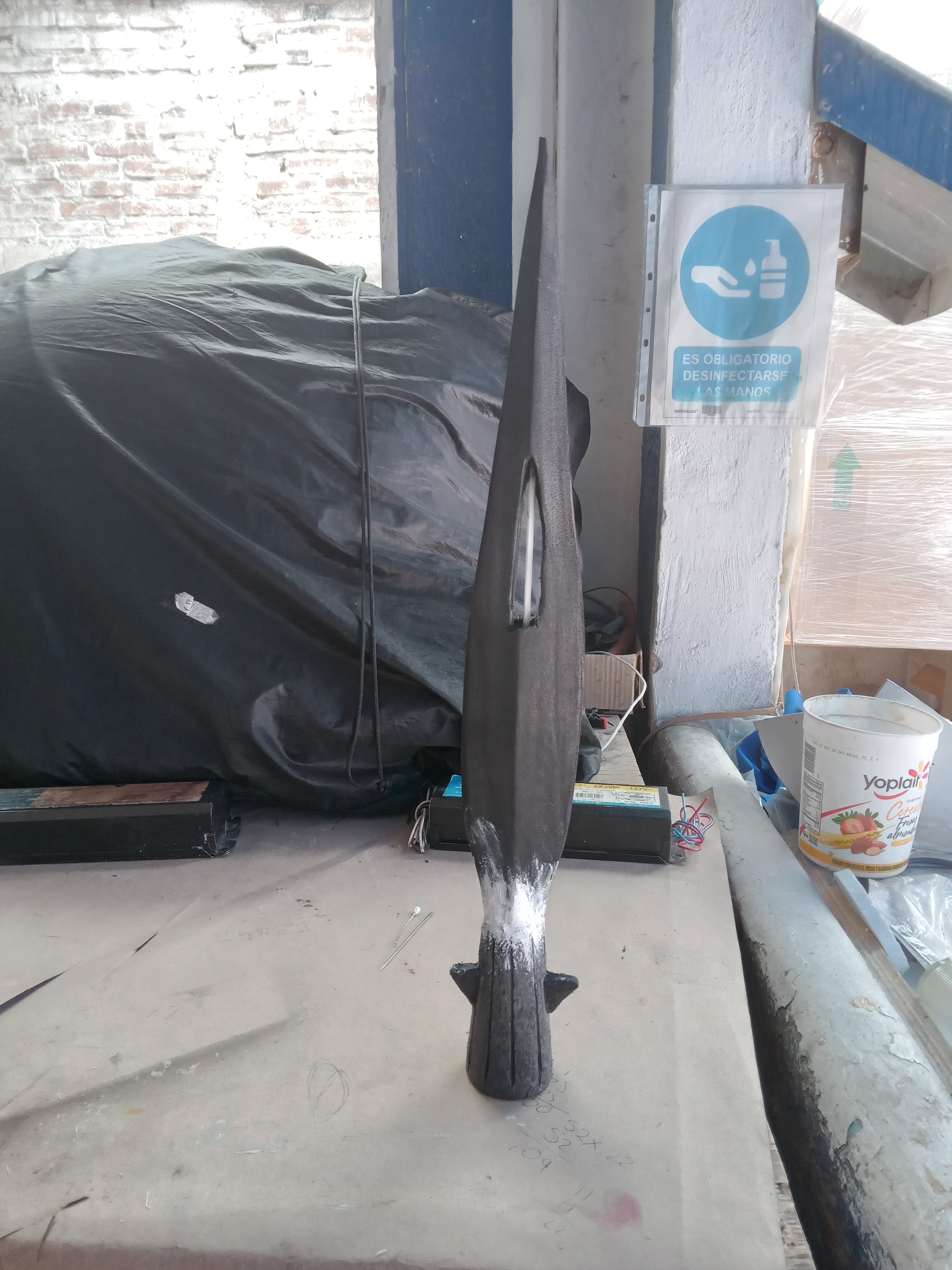

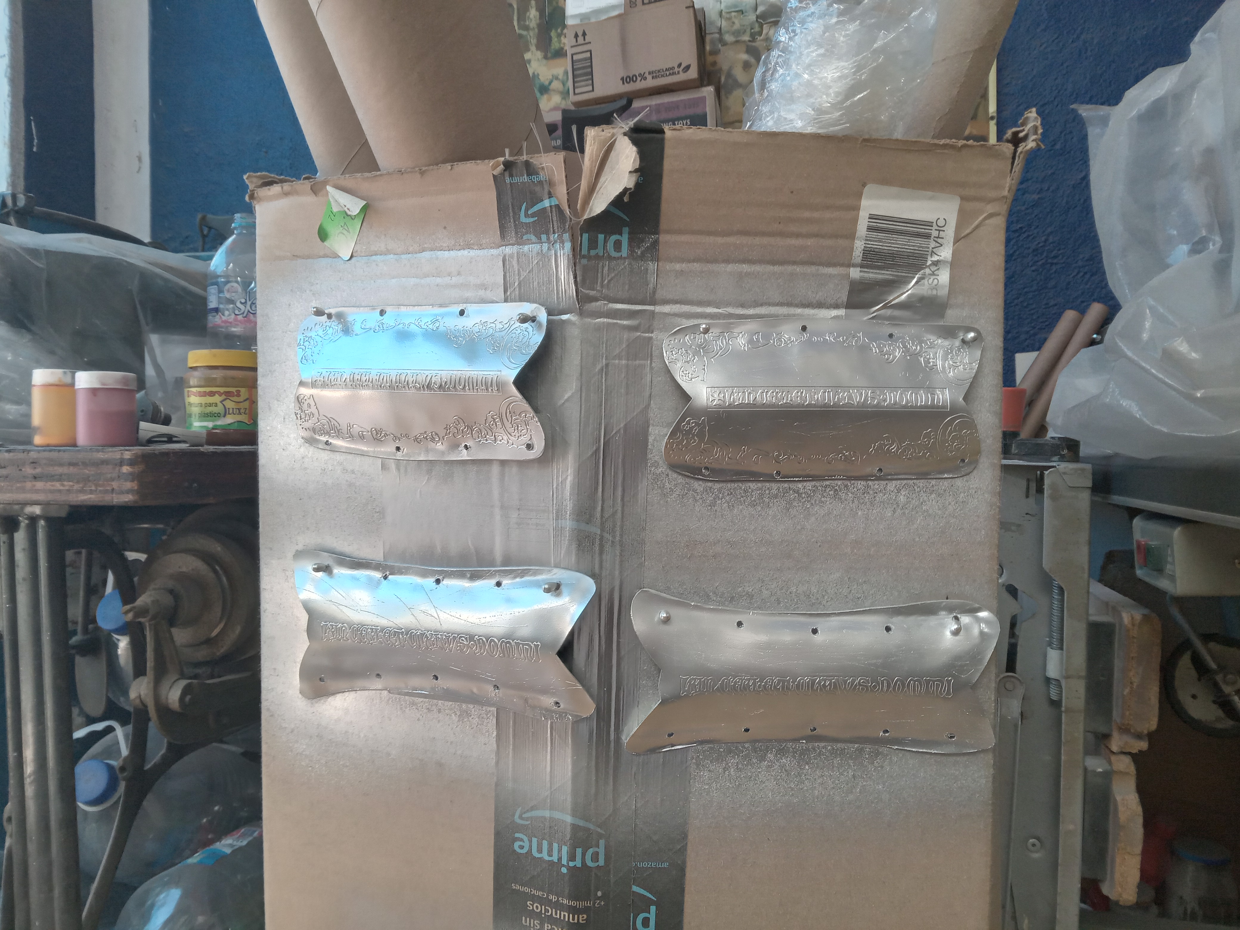

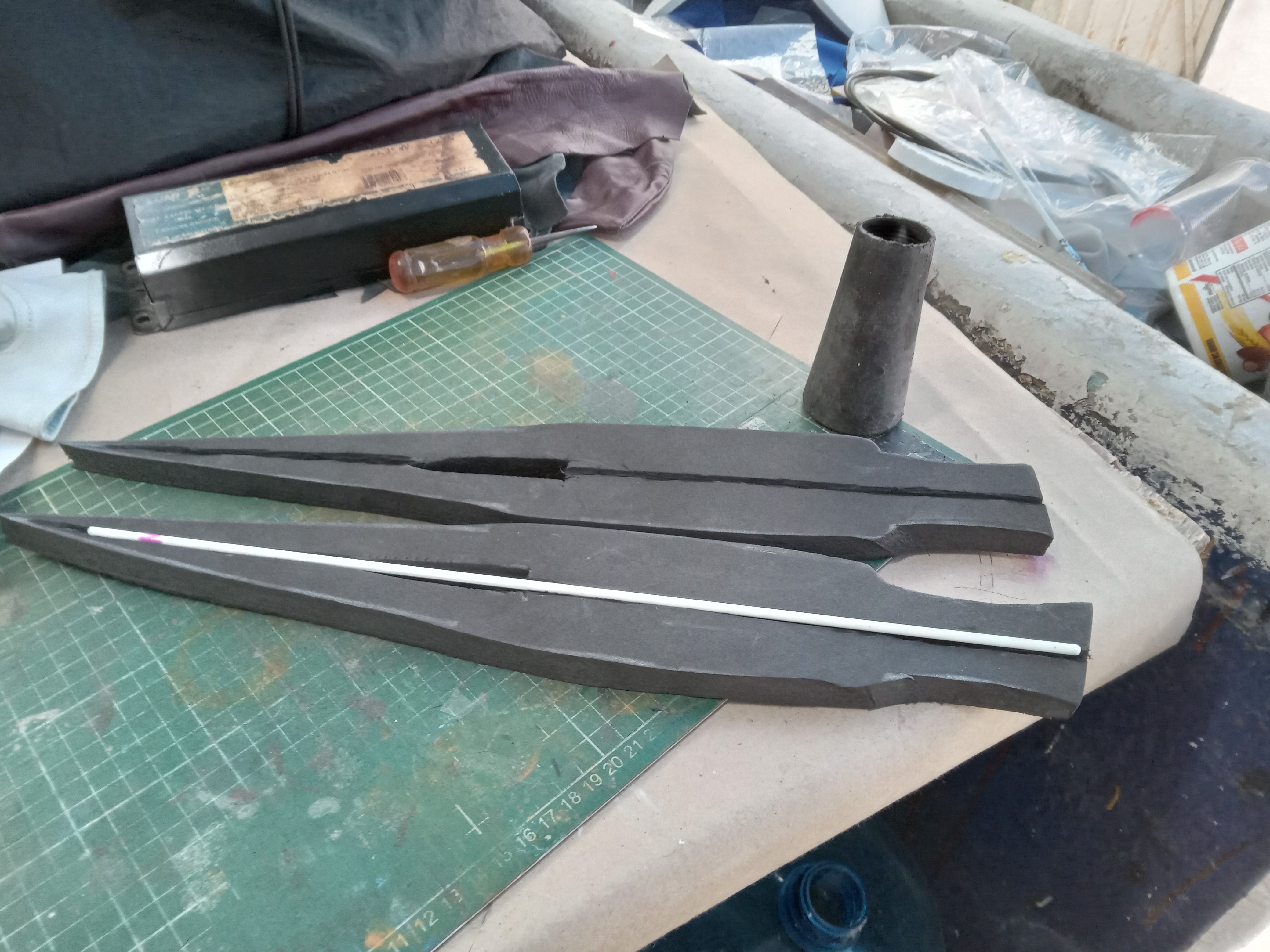

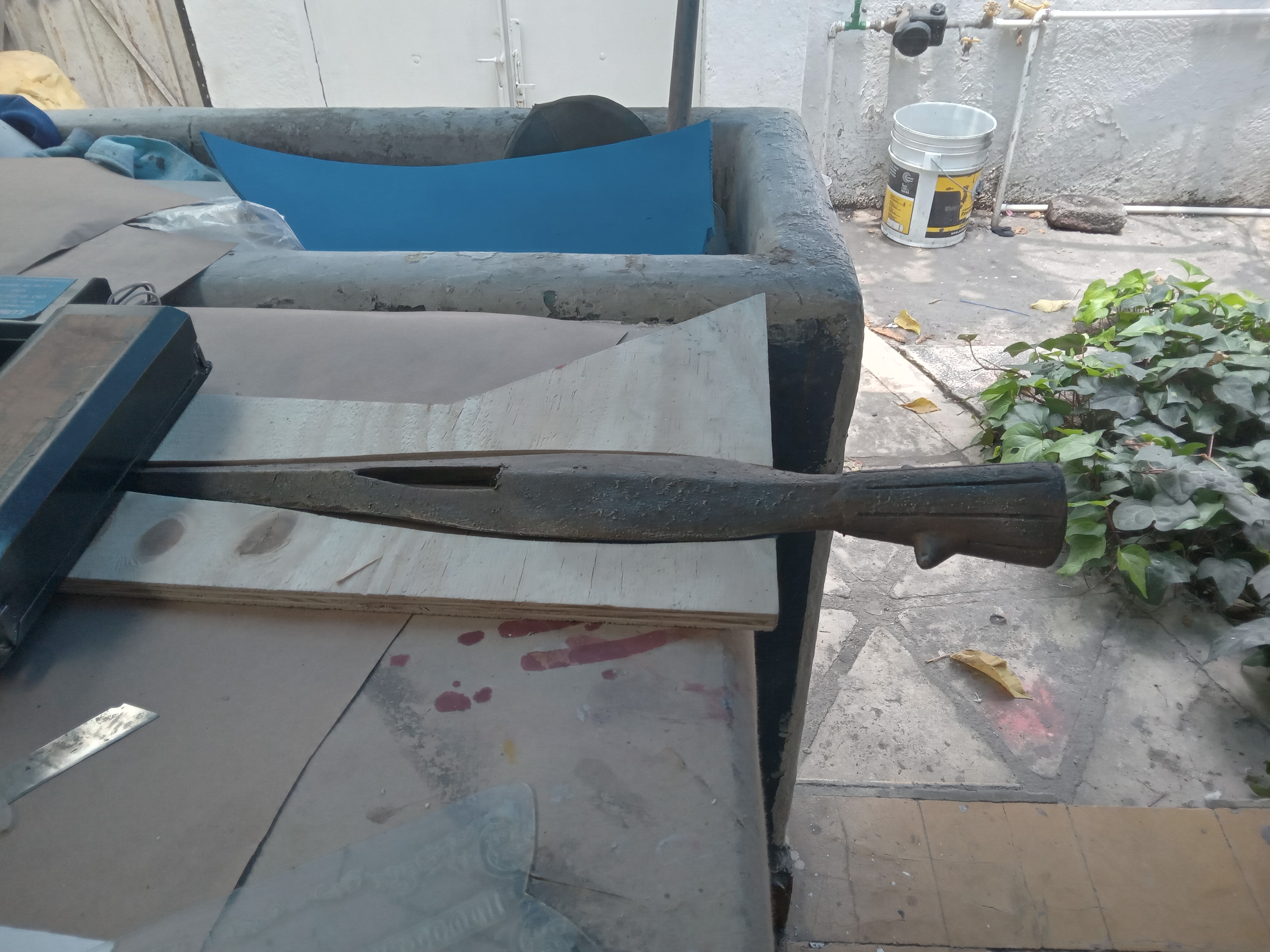

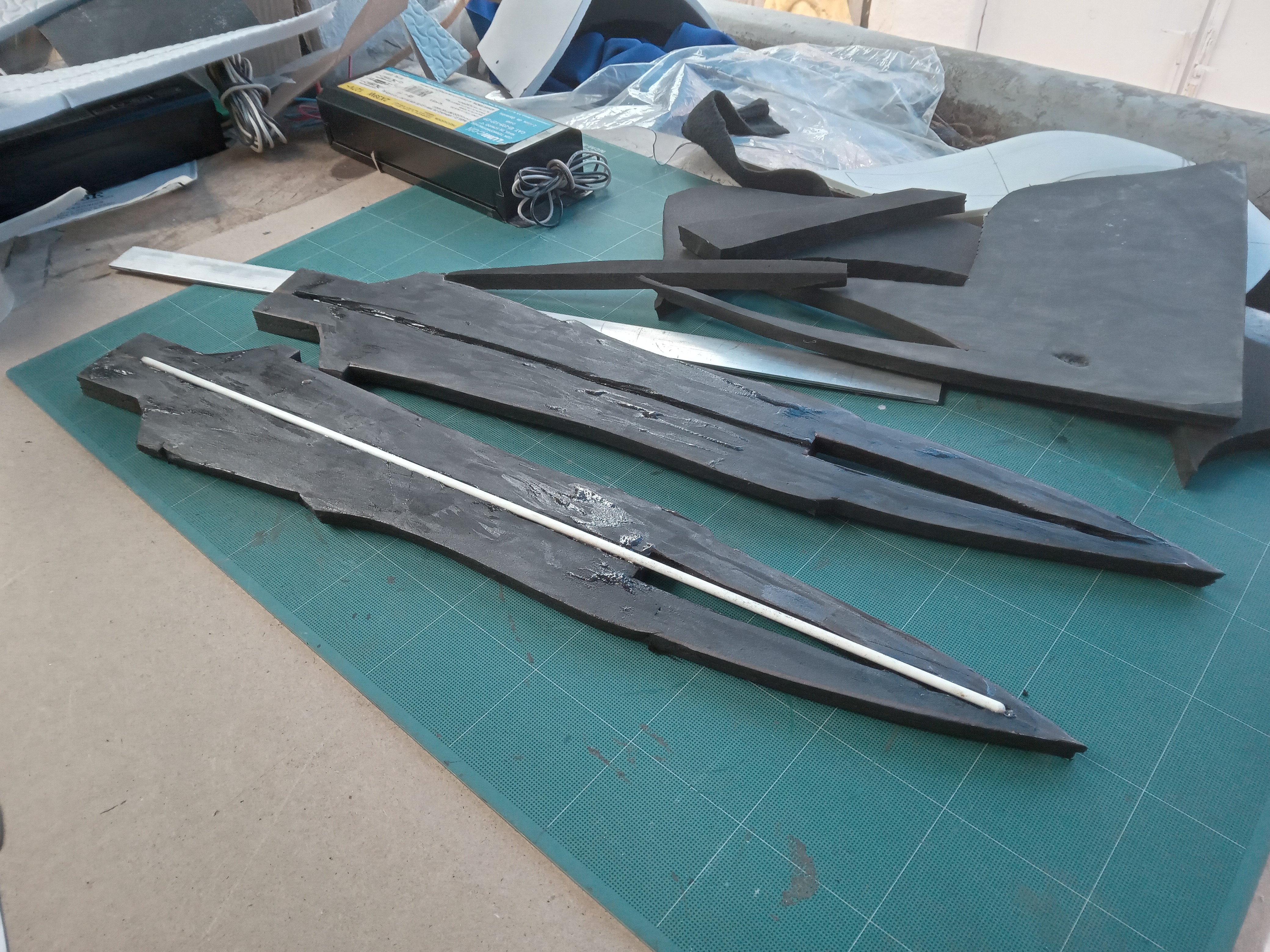

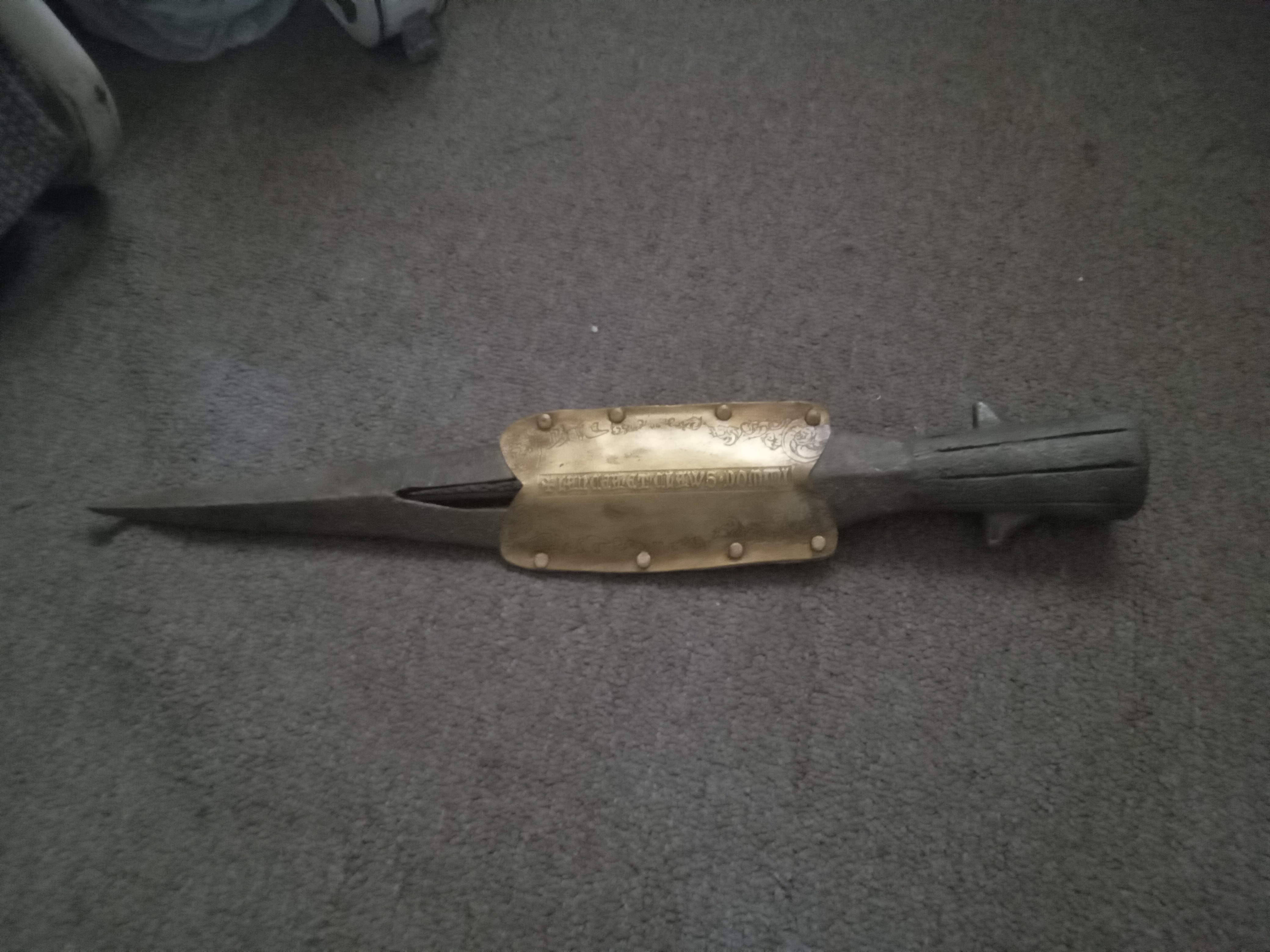

I also decided to make the Dial of Destiny version spear, just like the previous one, it is made of EVA Foam with a fiberglass rod structure, the stem tube is a thread cone and the golden applications are made of 20-gauge PET-G laser engraved and then heated and formed on the spear, painted and riveted with brass clasps.
I share photos and PDF files of the size and engravings.
