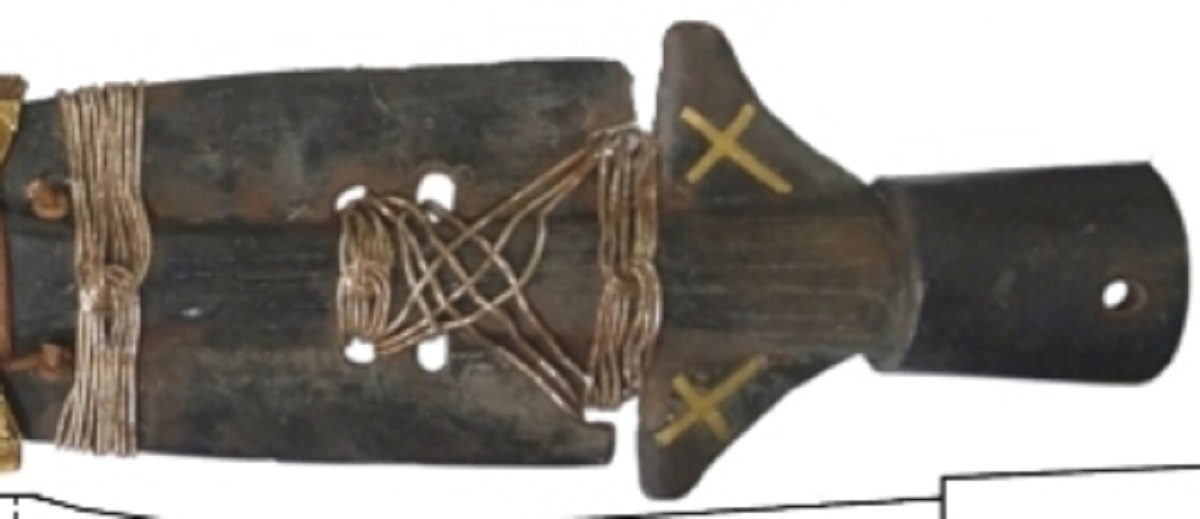

There are a few differences on the spear head. No wire and the attachment to the shaft is a little different, however --this is certainly a great base to work off of. Thank you for sharing the template. The blade cover is a lot different as far as the face goes. The style and pattern of the cover appear to be identical.View attachment 1726929
Probably how Indy noticed it was a fake so fast. Lol

Looks like the overall length of the spear with the covering is good. Just need to modify the other side to the shaft attachment. There's a lot different on that side but easily modifiable off the template given to us for sure.
A typical Indy part for sure. They took the original and tweaked it to be unique to the film. Looks like they simplified it in this case.
Agreed. Looks much more ancient. I like it!

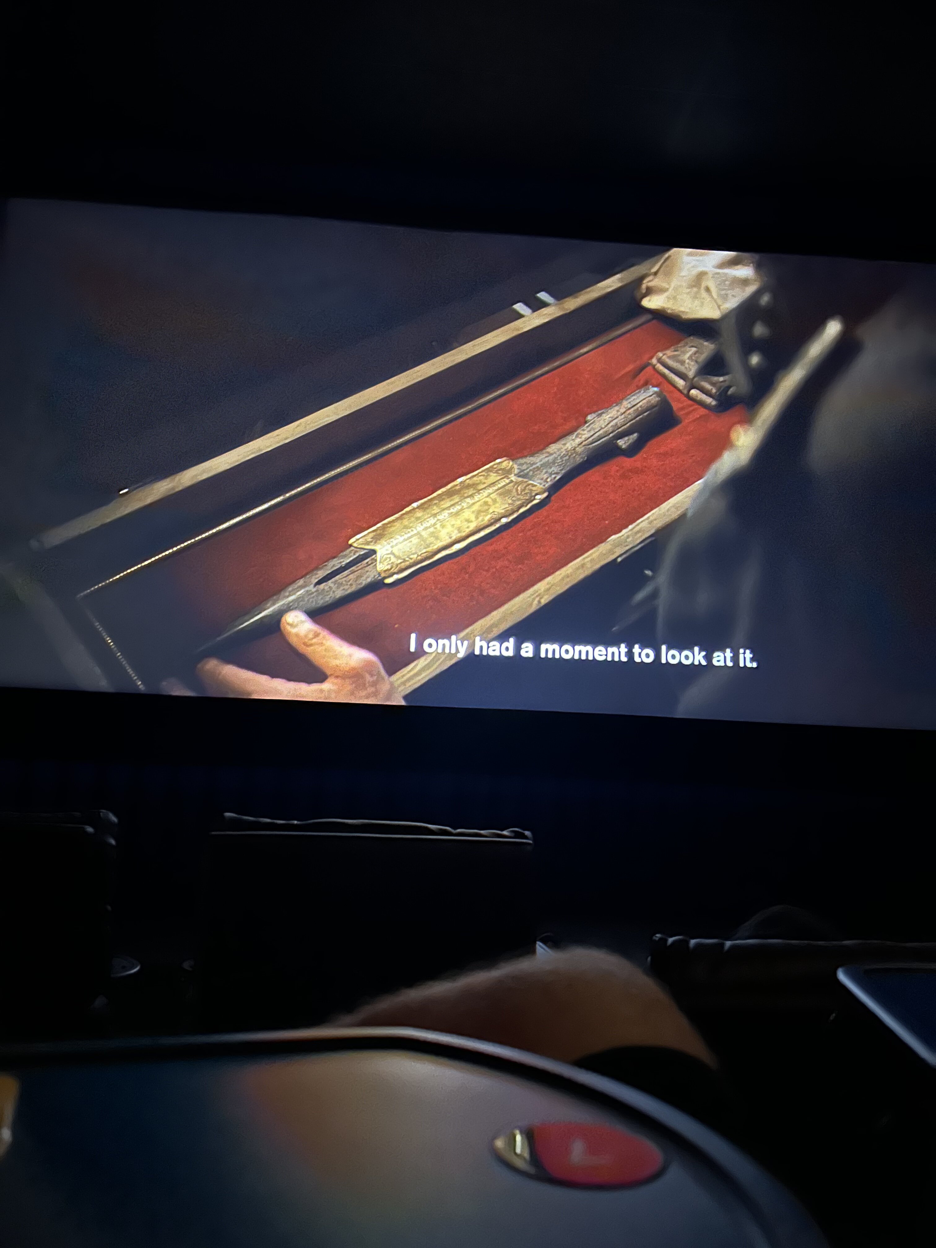

Ok- so if you go off of the scaled picture with Madds hand covering the shroud part of the blade, Its the same length as the tip and base. My hands measure 8 inches from wrist to middle finger tip. I'm also 6'3 and wear an XL glove so I understand my hands are larger than some others.
Going off that, the spear would be 24 inches long. I think that's wrong, but I do believe it's possible he has a 6-inch span bringing the spear to be 18 inches long. To me, that sounds more believable.
The template doesn't have a measurement guide, so we have to make our own.

So, going off that scaled picture template, looks like I was really close with the 18-inch-long dimensions. Normal printers won't help so I'm going to try and revise the template into 6-inch-long pieces.

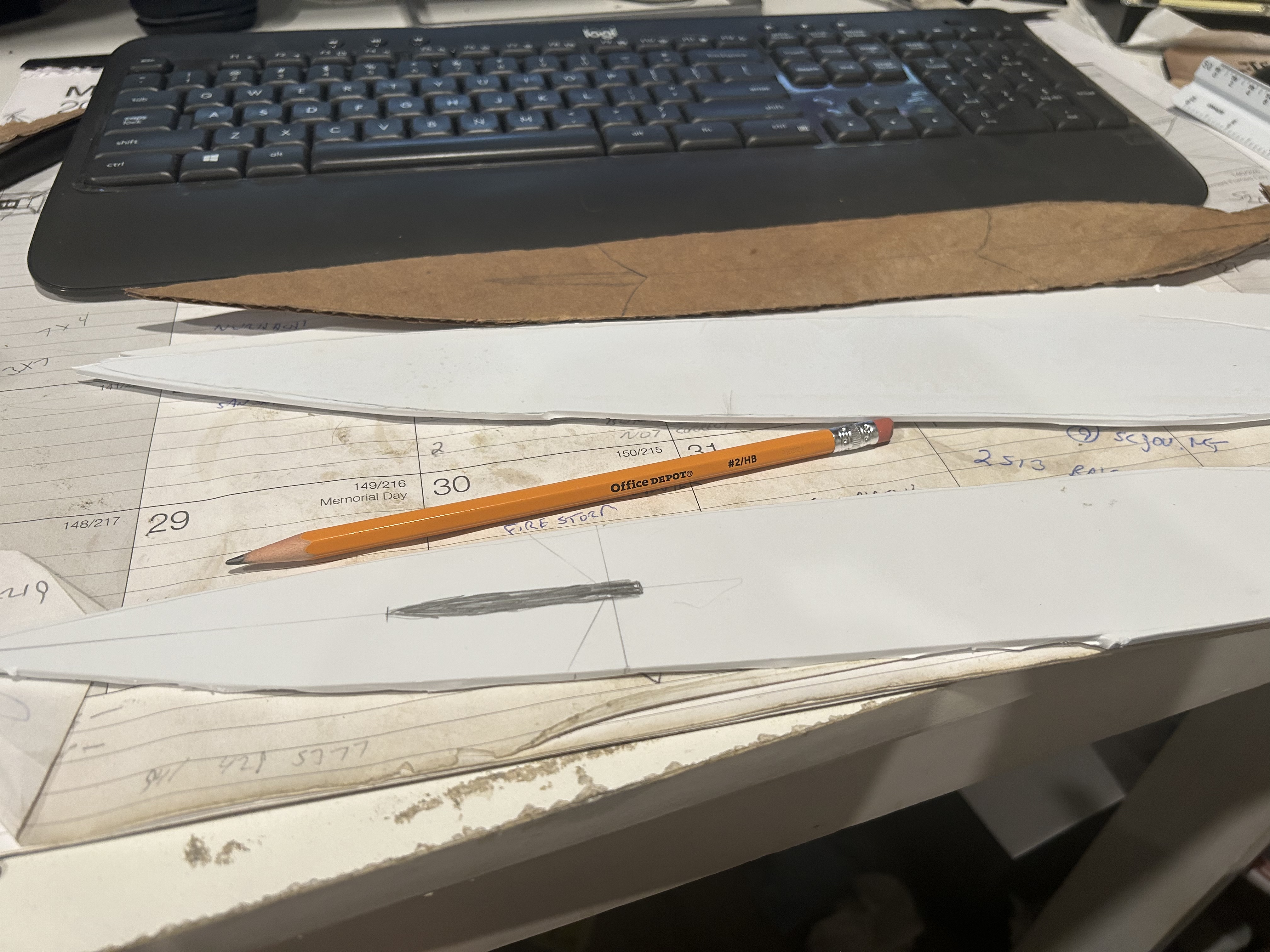

I just cut a cardboard template. It really appears to my eyes the shroud over the spear is leather. Also, not as free flowing as the spear template above but looks to wrap the flow of the blade more uniformly. Also spotting the blade itself to be asymmetrical. My plan is to make the blade out of styrene. Then wrap it with a piece of leather and rivets or whatever they are. First steps first :p

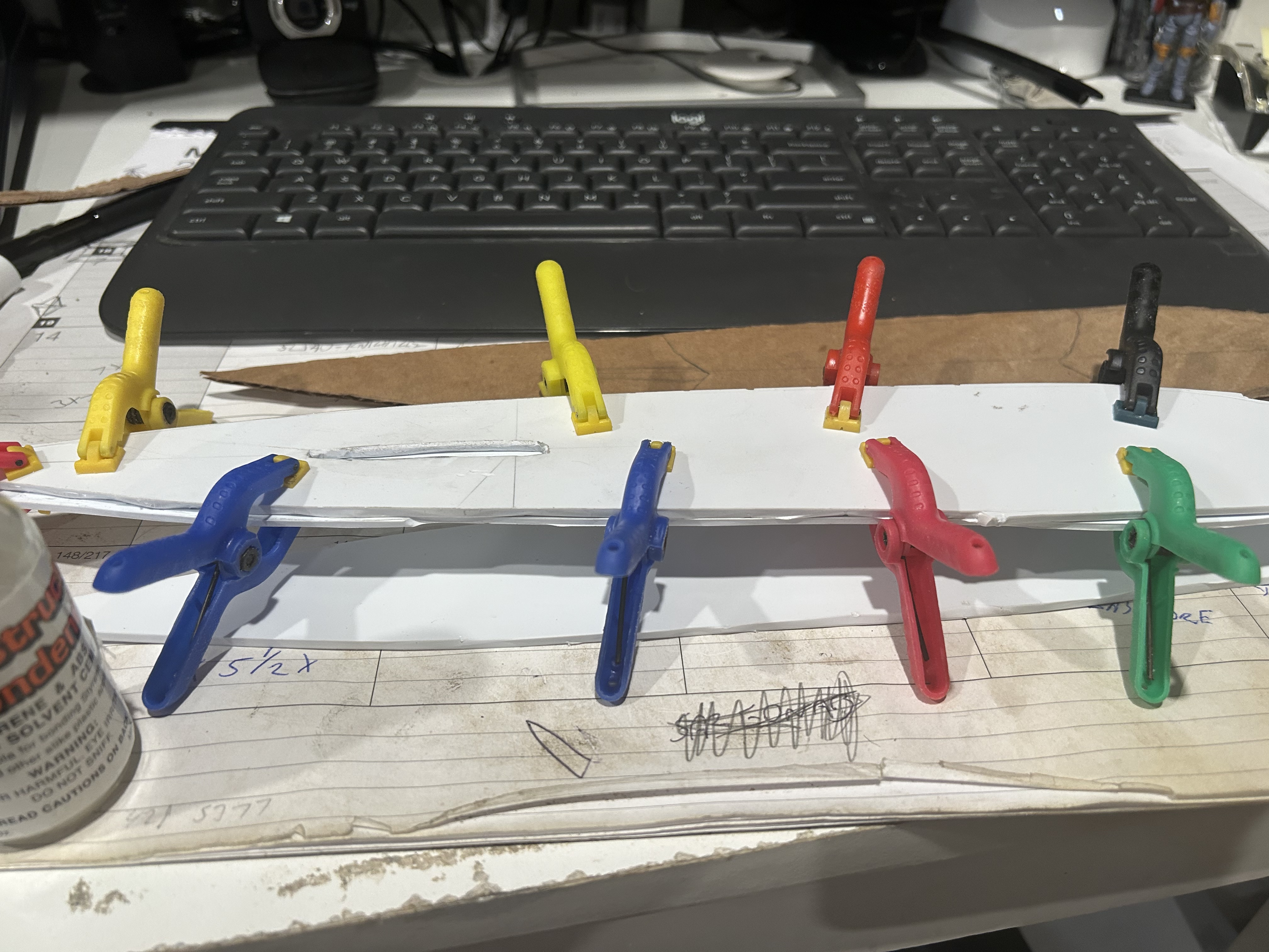

Started my spear head. I’m using styrene. 2 pieces 3mm 1 piece 2mm. Total of 7mm thick not counting the leather shroud that will be tackled after. I haven’t started the cup the holds to the spear itself just yet but left meat on the bone to adhere to once I do. Stacking styrene is easy. Make sure to leave plenty of excess and do not cut true precise numbers. Especially when you stack to shape like I’m doing. Be sure to cut outside the lines and then file or grind to get home.
All clamped up and I will let it sit a couple days to lock in nicely before I start shaping.
View attachment 1727677View attachment 1727678View attachment 1727679View attachment 1727680View attachment 1727681 All clamped up and I will let it sit a couple days to lock in nicely before I start shaping.

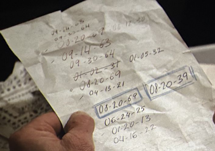

Ok here's a first attempt at one of the paper props so more work is needed the first one has the blue rectangles missing as it looks like there were draw in a blue pencil crayon so you can do the same also not crossed out the one number but with the other one i've added them in photoshop, however don't think the font is 100% right but it's close
