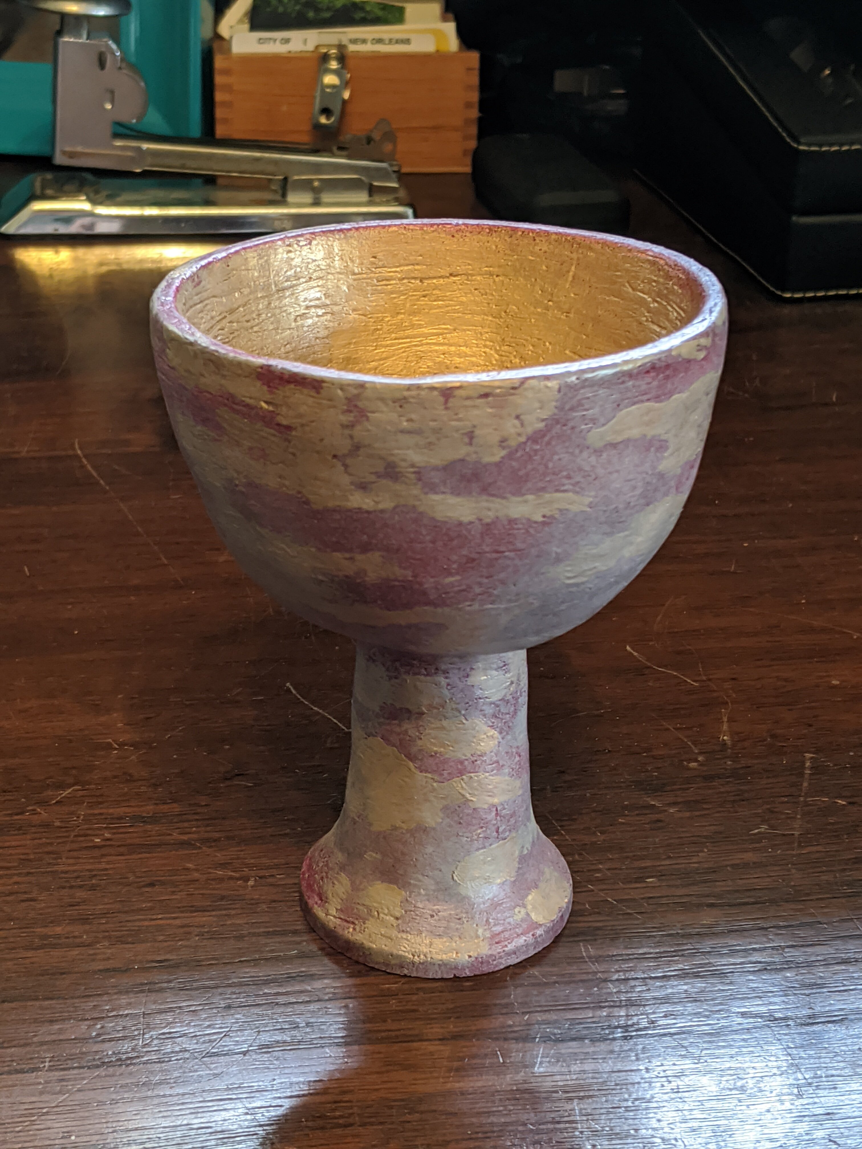

I just printed one off myself and in the process of looking for the exact same techniques found these two videos. I plan on trying gold leaf myself which i haven't used in 20ish years.
I printed in one piece and did bondo putty reduced with acetone to hide the vertical seam line and fill some layer lines, which in hindsight was a total waste of time. Because I applied acrylic paste horizontally with a dollar store chip brush to give a more "hand thrown" clay look, which dries hard and is easily sandable.
Its currently sitting on my work bench taunting me with a base coat of probably a too bright red terracotta.

This is basically the order I did. I used Liquid Leaf rather than standard gold leaf. For the grey layer I used grey spray paint and sprayed it from far away, and let the cards fall where they may.

Its a gold paint that simulates gold leaf. its technically copper based, but the color is good. With a project like the grail, being able to paint the gold shapes directly, rather than painting the shapes in glue, is quite useful.

I also remembered that I gave the whole cup a wash of diluted gray acrylic paint as the final coat.
so it was a burgundy spray paint layer, a dusting of gray spray paint, gold leaf paint, then gray acrylic wash.

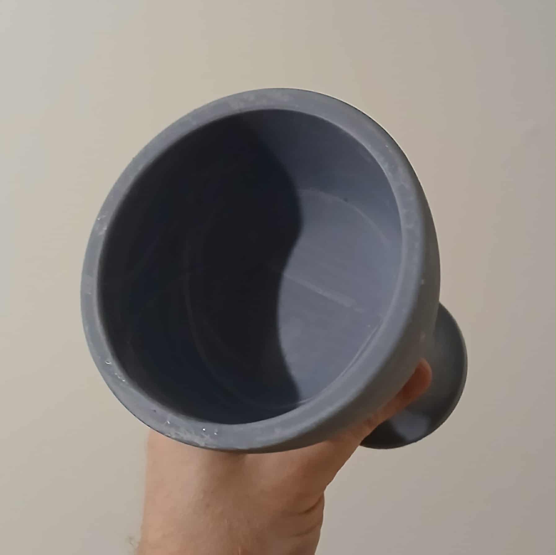

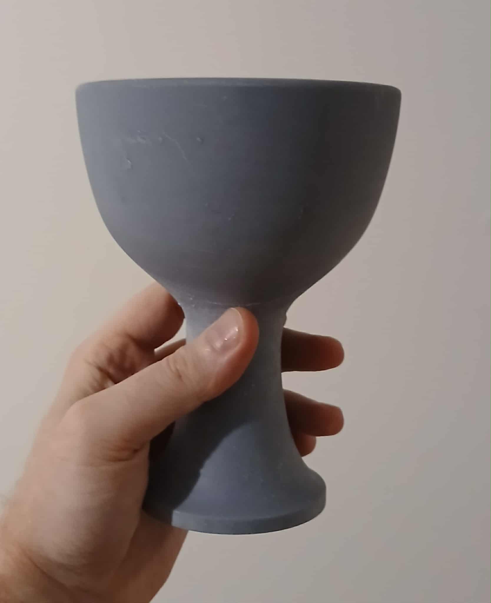

Wanted to share a couple pics of the grail print (just got around to picking it up this weekend):
Have to do a bit of clean up before I apply the acrylic burgundy paint I'm using as the base colour, but it feels great in the hand and being a solid resin print has a bit of heft to it which is nice.
