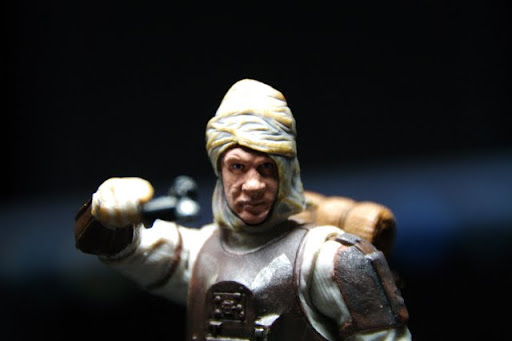

I took these just now with a 250mm about 3 inches from the figure.
the light source is a compact fluorescent about 4 inches above.
no ps was used.
  1. just shoot like you would a full sized subject... i.e. frame the subject not the figure
  2. single light source looks more natural
  3. 'zoom macro' lens as opposed to 'macro' lens will help with the depth of field effects like in the first shot
  4. low angles help
    dengar was standing on the edge of a desk, and i'm on the floor with the most of the camera below the desk shooting up.
good luck

Great pics !!! :thumbsup
But don´t you mean 3 feet insted of "3 inches from the figure"?
And dang, those action figures really came a long way, with those ball joints. That pic makes me want to go and pick up a dengar now, with all those other bounty hounters, build an SD backdrop and recreate the classic ESB scene...

it's an 18 - 250 zoom macro. so I can get under three inches away at full zoom.
when I saw the sculpt I had to have it

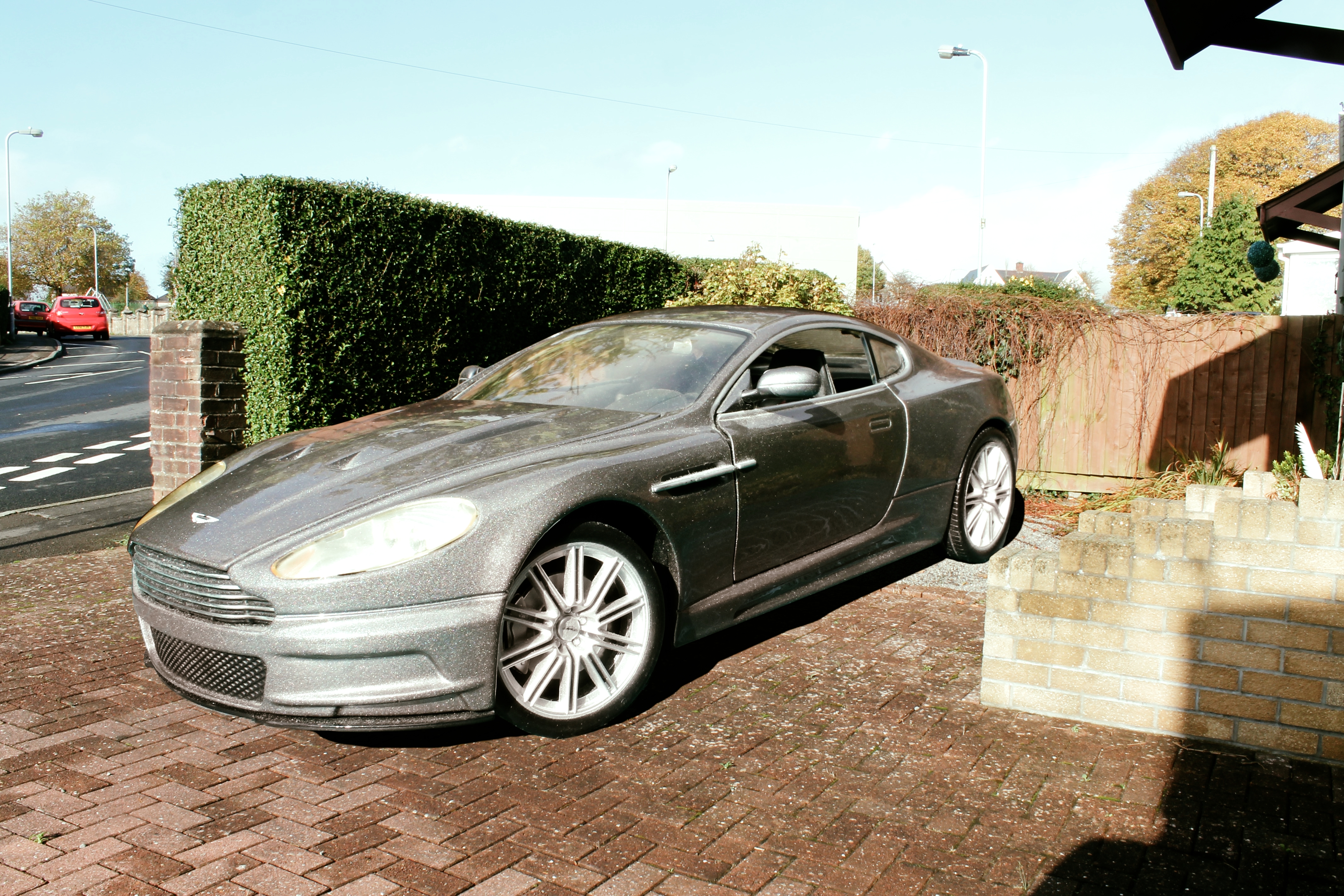

If you are photographing your miniature against a real background and want it to blend in, you need to measure the angle of the camera for the background and the duplicate that in your miniature shot. For example this shot I did of a 1/18th scale Aston Martin in a real garden. I measured the angle of the camera for the real shot standing up (I am 5' 10" tall) then measured the scale height and made sure I got the camera the correct scale height and scale distance in relation to the model car. I removed the green screen support where I raised the car up and voila.
