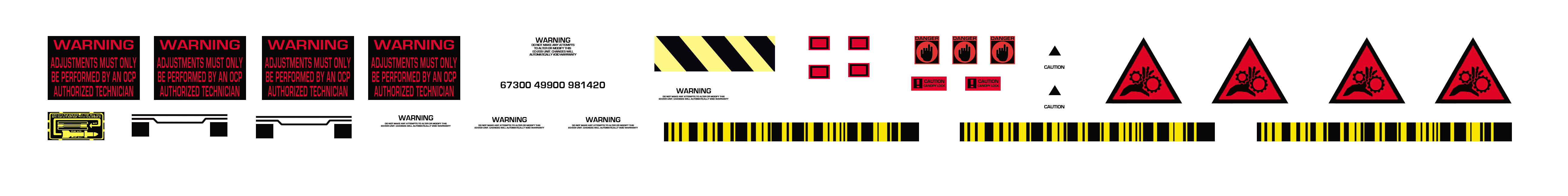

As for making upgrade kits for this model, i will trade a set of 4 resin leg brakes for a set of decals ;)
Keith.

Thanks,
I've just brought the decal thing up with the people at jbot.ca - they've produced and are selling a decal sheet I made for the Millennium Falcon and I've let them know that this is available as well. I'll let you know if they will take it on.
Thanks everyone.
Talisen, yes, please let me know if the decals become available. I don't have a printer or anything, so i can't make print out the decals myself.
Keith.
