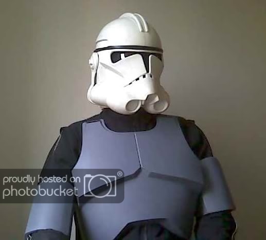

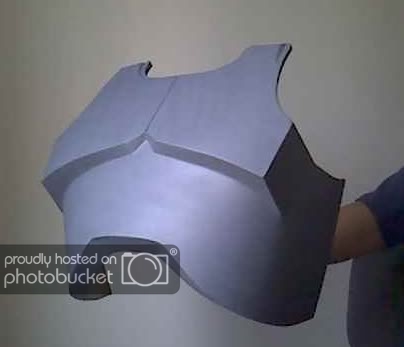

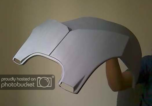

UPDATE! :) Parts after bondo, sanding and primer
Fit test :love

Nice work on this scratch build! Its refreshing to see original work. Your attention to accuracy is commendable. The only thing I would say is the pectoral region seems to be lacking in curvature in comparison to the CG model. Also, the length between the top edge of the pec to the bottom fold seems to be a bit short. Still, this is great work, can't wait to see this completed.
Re: Homemade Clone Trooper Armor
Thanks for your comment! I tried to achieve the best accuracy with the lowest number of planes. The paper has it's limits ;)

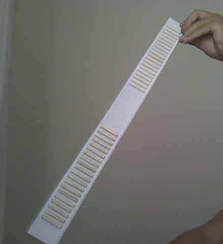

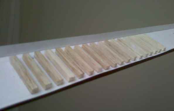

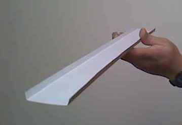

Continuing my unorthodox methods, I'd like to show you my idea about how I'm making flexible shoulder straps:
First, I made a base mold with (guess what?) paper

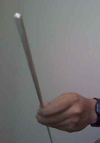

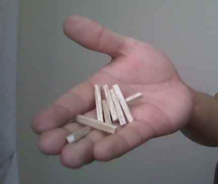

Then I used balsa wooden stick (4mmx4mm)
I cut into small pieces
And glued it on the paper

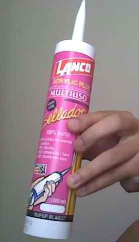

I will fill the mold with this (white sealer)
I will add plastic straps to reinforce it, and wait 1 or 2 weeks to dry.
Do you think this technic will work?
^_^

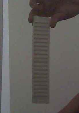

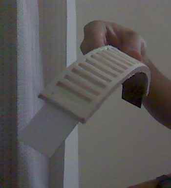

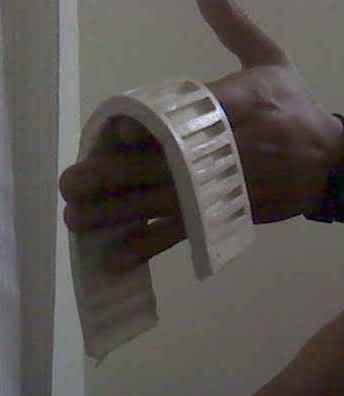

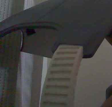

Here's a little update about the shoulder straps... Not as good as I was expecting, and not as good as steelblitz's ones (not even close)
Flexible homemade shoulder straps
maybe too flexible :p
I will use a plastic strap to reinforce it

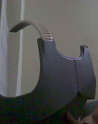

At least it fits
Maybe later I will replace or remake them ^_^
...I really miss mi camera

color me stunned blue ... this is turning out really good ... not bad for a shoulder strap made from caulking ... you did a great job on it .... never would have thought of that one myself ... your armor is great ... gotta tell ya i kinda like the black look of it ... keep it up
Clever idea with the straps. You could also put something in the silicone while it was wet for strength, like screen door mesh.
That's a great idea! Thanks :thumbsup

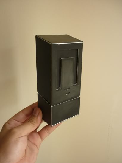

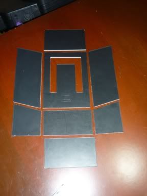

UPDATE
Belt box templates
Result
I have to sand it and paint it with primer
