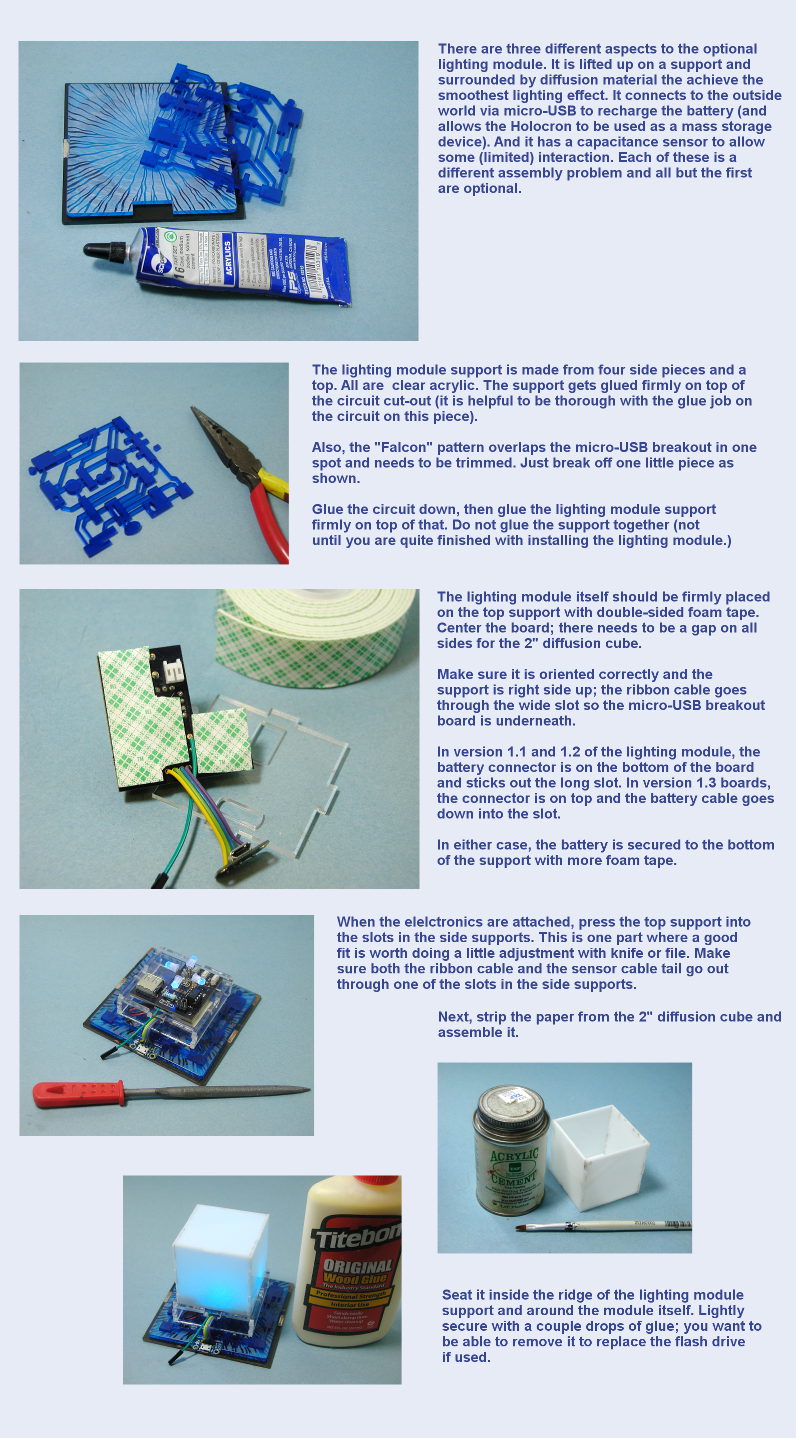

Mine didn't come with a diffuser block, looks like the white walls in the instruction plans? I read and under the impression you don't use the white diffuser block anymore right?

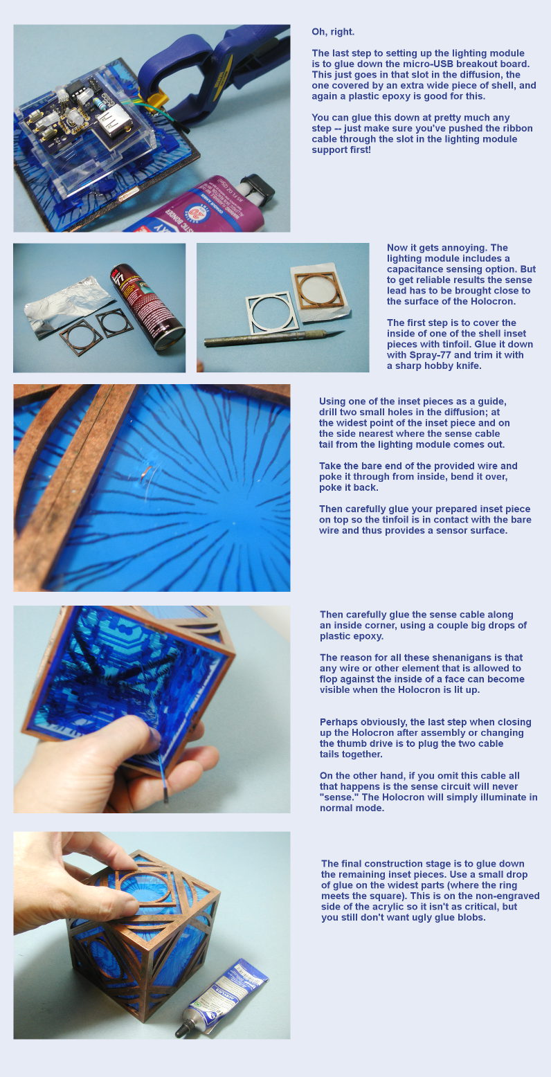

Also, do you mind explaining to me the blue sensor wire? Does that get glued to the top plate inside the holocron? What is the purpose of this wire?
Also, when not on display, do you recommend putting the holocron upside down so it turns off?
I was fooling around with the electronics last night, what a wicked setup!!
Nomuse, quick question I'm fooling around with the electronics today. If I plug the battery in she lights right up
Does the circuit go into sleep mode? Or do u have to turn the holocron upside down to shut it off?
Also is it cool to charge this with a cell phone charger u plug into the wall or should it be charged with USB into the computer?
Also last question of the day I swear! Lol
How long does it take to charge the battery?

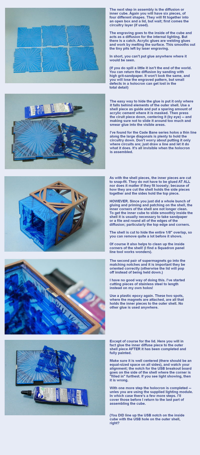

Did some sanding today
Ive learned the hard way... using the same epoxy I used on assembling the cage. It left big stains on the blue acrylic.... use very little dabs of epoxy or yours will look like this..
It really can't be seen when illuminated, but while it's just sitting there static it looks horrible... live and learn I guess
Entirely my fault for not having the instructions ready to go already. I'll replace the damaged parts at my cost. Here's the next page (hopefully it loads up on first try this time):
The final pages on installing and working with the lighting module are going up as soon as I can complete them -- be patient with your kits and I'll try to make sure everything is properly explained.

And the last two pages of instructions. I'll also post these to the first page of this thread. Next -- a video explaining the various features of a completed Holocron...
