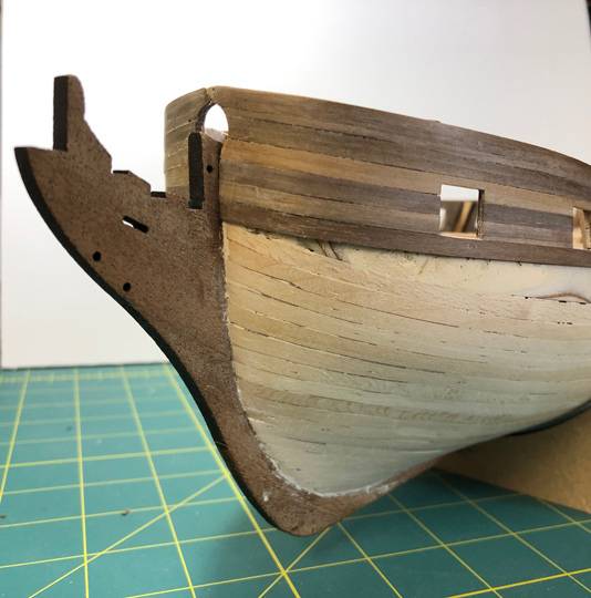

Planking the hull...again.

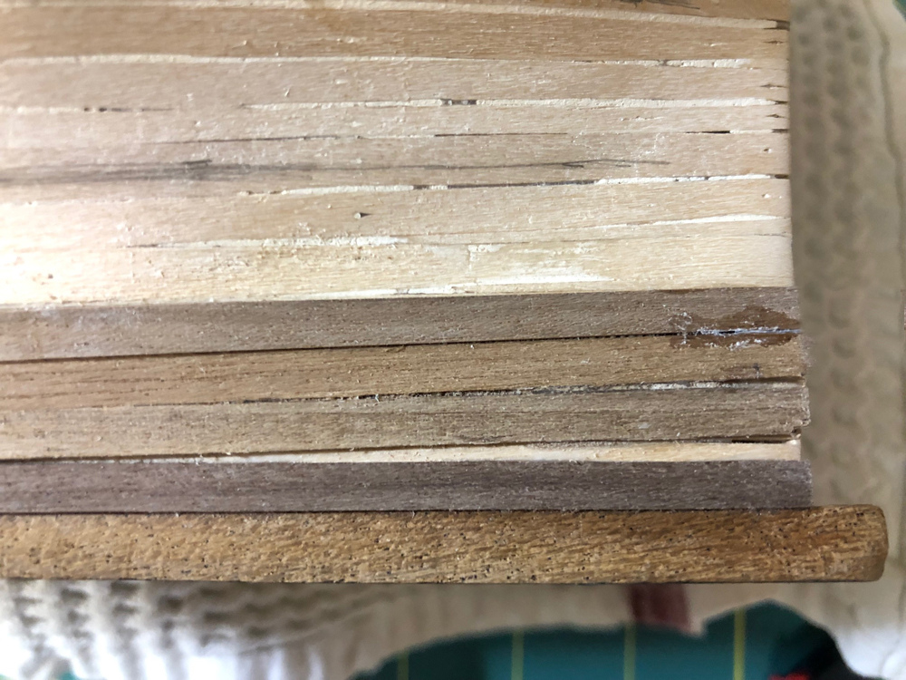

Victory's HMS Pegasus model calls for the hull to be planked a second time. The reason for this is how the model is constructed. The first planking of the hull with the limewood strip brings the hull flush with the bulwark which is constructed from ply material. So now that the bulwarks are even with the limewood hull planks, it's time to apply a second layer of hull planking from the top of the bulwarks all the way to the keel. This layer will be fashioned from 1mm X 4mm walnut strip - so smaller stock than what was used for the 1st planking. This is good and bad. It's good because it will definitely be more pliable and easier to bend around all of the complex curves, but it's bad in that with smaller stock and the greater surface area, the number of 2nd layer hull planks will be double the number of 1st layer planks I placed.
But at least these will be seen in the end, right? Kind of. Some of them. The vast majority of the hull is ultimately covered in copper sheathing, actually and above that an additional layer of extra thick planking will be placed in one specific strip - called the wale. So maybe 15% of what I'm about to embark on will actually be visible when it's all said and done? At any rate - time to get on with it.
Once again, the instructions are devoid of a lot of specific detail regarding how to accomplish this, but I've decided to start from the top and work my way down. This topmost plank, or series of planks running fore to aft has a name: the sheer strake.

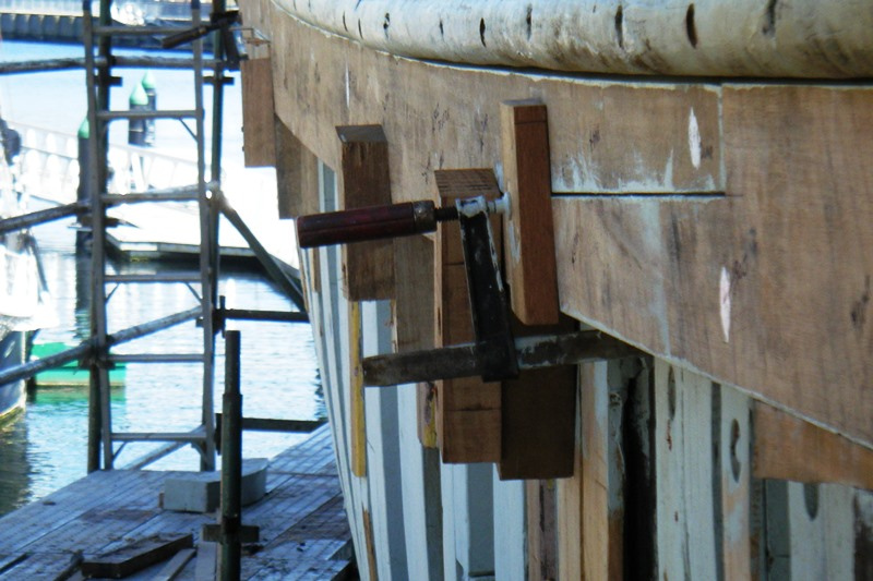

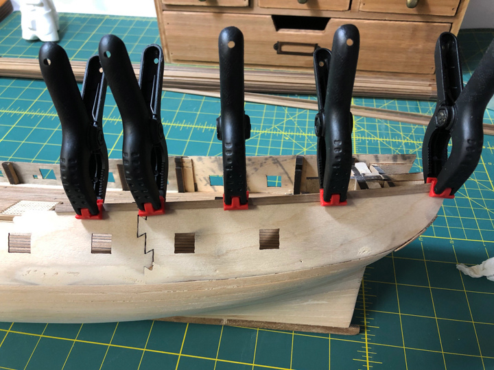

Here's a sheer strake being placed on a wooden ship temporarily secured with a number of clamps.

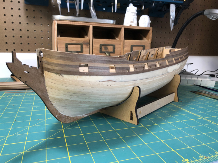

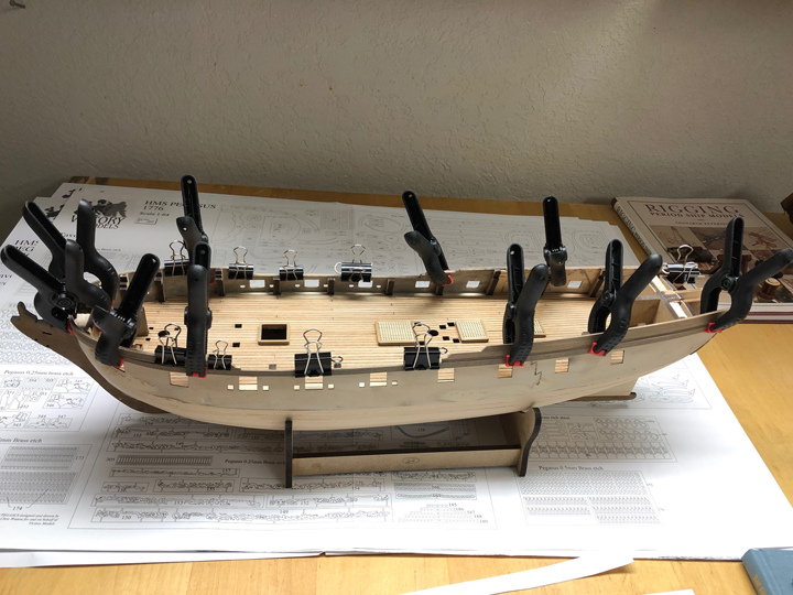

And here is the Pegasus undergoing the similar process affixing the sheer strake to the uppermost edge of the bulwarks.

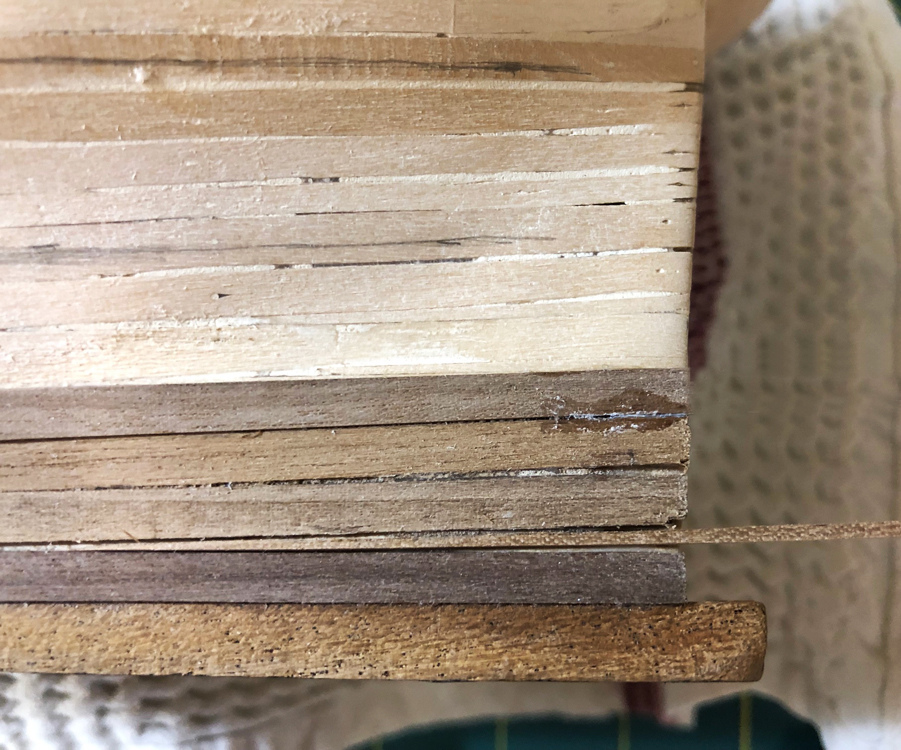

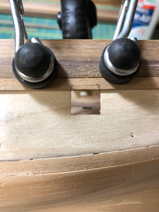

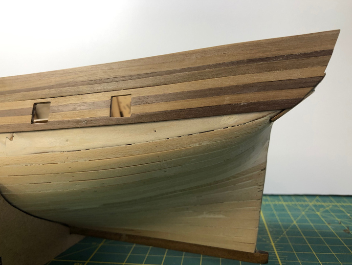

The same process of applying the planks was used for the second layer with one major exception: No pins can be placed through the plank because I don't want to leave holes in the wood as this will all be ultimately visible. So extra time and care must be taken to soak the planks in hot water, conform them to the hull, let them take shape, and then reapply them with white glue and clamps only - no pins.
Once the sheer strake was placed, I then had a nice straight edge to continue working downward, plank by plank utilizing a variety of different clamps.

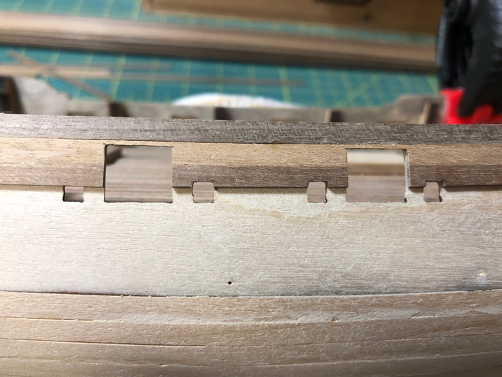

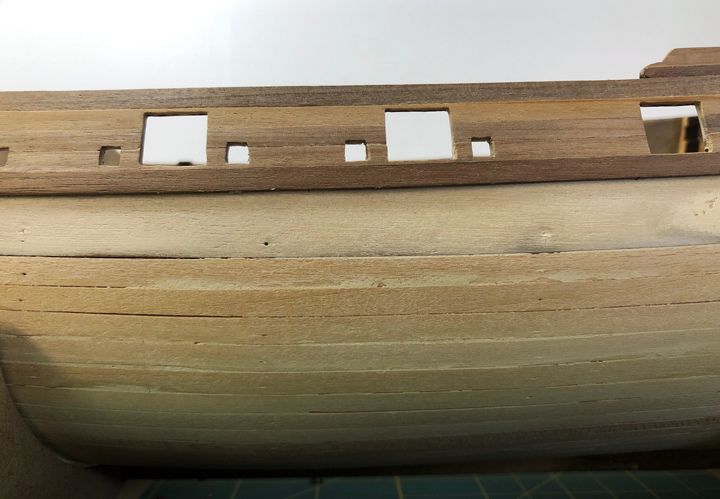

This process was continued until I hit the tops of the gun ports. I think everyone can see the tedium I am about to encounter at this point: Planking around the gun and sweep ports. Before encountering the gun ports and sweep ports, I measured and recorded the dimensions of every single one. No, they are not perfectly uniform...of course. Then, after the first strake encountered the gun ports, I just ran it right across them. After this strake was set, however, I drew on the dimensions of the ports as detailed in my measurements.
Then using a combination of an X-acto blade and some very small files, the ports were cut into the hull planking.
This definitely got more tricky around the smaller sweep ports which are about 3.5mm square, but patience and persistence paid off.
Then it's a matter of rinse and repeat, working downward, one strake at a time, first the port side and then the starboard.
I will say this - if reading this post is as exciting as watching grass grow, I can attest that placing these planks is akin to listening to it grow. Yeah - getting that sheer strake on was kind of sexy, but the appeal wore off pretty fast after that. This is some slow going, my dudes.

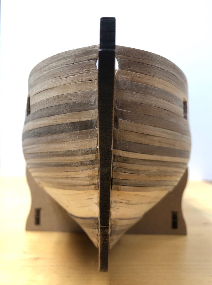

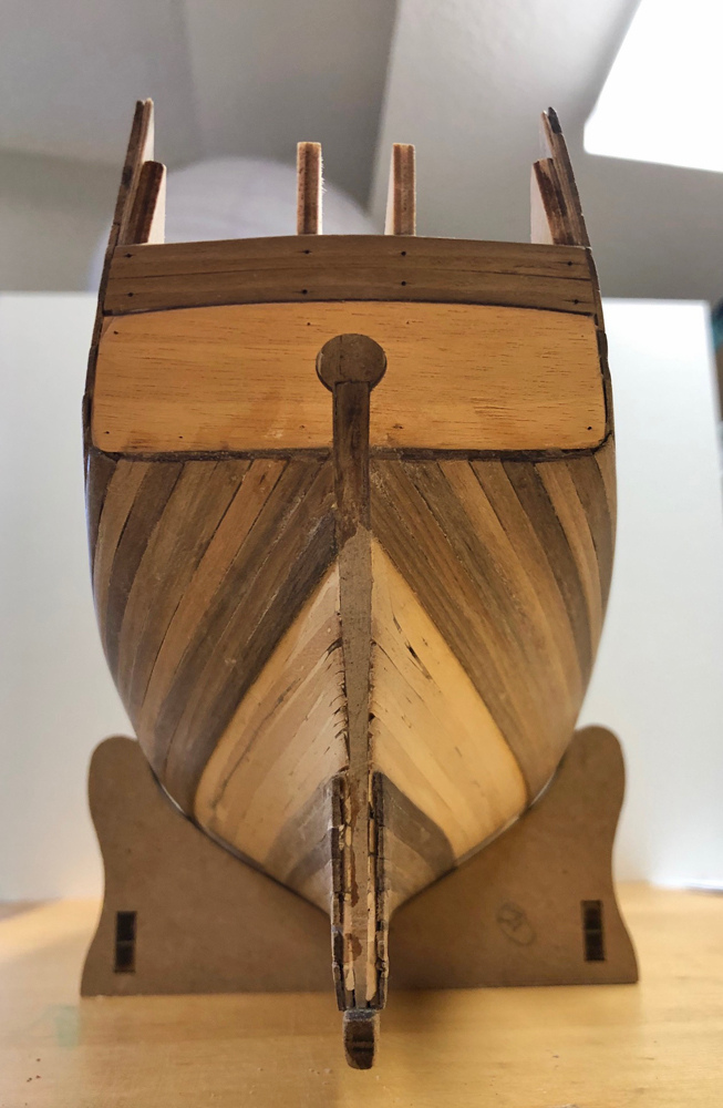

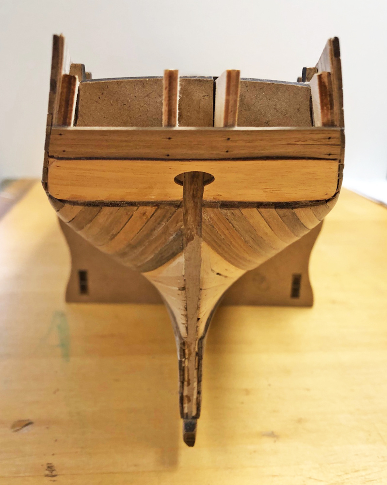

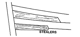

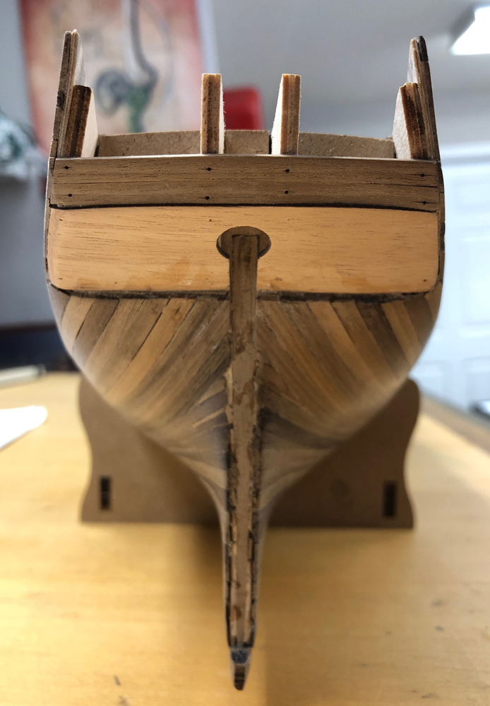

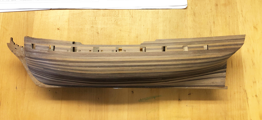

As with the first layer of planking, I noted that toward the stern, the strakes want to separate naturally, which results in triangular voids.
This is precisely what happens in real ships as well. The solution is something called a stealer which is a wedge shaped short plank to be placed within the opening left by the strakes.
Now, purists will balk at my attempt to fashion stealers at the stern. Mine are not accurately shaped, but are rather fashioned from more simple triangular shapes of planking. To which I reply, 1) This is all going to be buried underneath copper cladding and no one will ever see it and 2) If you're a wooden ship model purist, you've no business here, so go back from where you came and let me be.

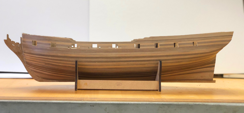

Carrying along in this fashion, by God, some progress was made, although the end is still many, many hours away.
By my calculations, I should be able to make the final push on the 2nd planking during my next session. I've got her in my sights now.

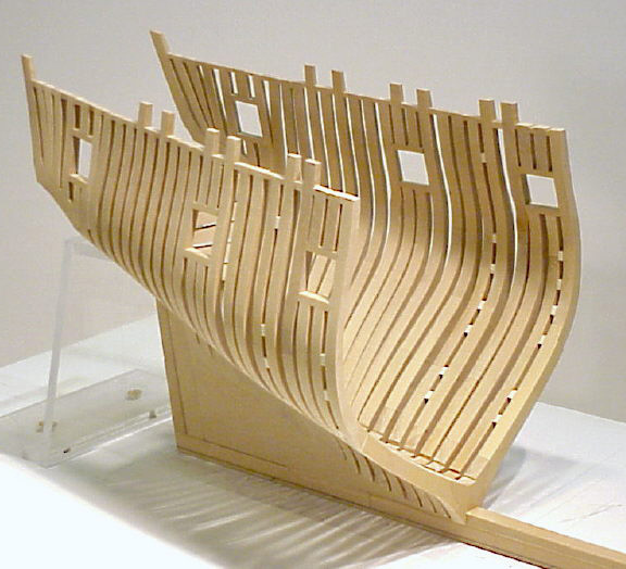

The tome you are looking at, entitled Building the Swan Class Sloop Pegasus 1777, The Fully Framed Model by Dr. Greg Herbert is a book dedicated to one of the greatest acts of scratch building I've ever witnessed. This book documents a 10-year journey Dr. Herbert took building a 1:48 scale replica of the HMS Pegasus piece by piece. Ten. Years. He and master modeler David Antscherl developed blueprints from the original drafting plans for literally every single piece of the Pegasus, and then constructed it from scratch.
This book photo-documents his progress in excruciating detail. At one point Dr. Herbert comments on how, after a solid year of building the individual frames, he realized that some subtle initial errors had compounded upon themselves resulting in some flaws with the hull. So he scraps the entire thing and starts over entirely. This man is a monk. This man is my Yoda.
One night, reading this book in bed, I happened upon the foreward (which no, I didn't read first like I should have) and learned that he, LIKE ME, is a veterinarian. I had a freak out and woke up Ishmael (my wife) AND Starbuck (the dog) to tell them. I got a, "That's nice, shut up, please," in response, which, you know - was fair since it was like 2:00 AM. The next day, I reached out to Dr. Herbert and we've been corresponding via email since. He has been incredibly gracious. He and Mr. Antscherl have their own company called Admiralty Models.

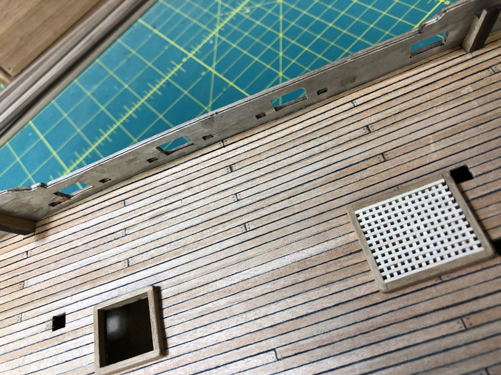

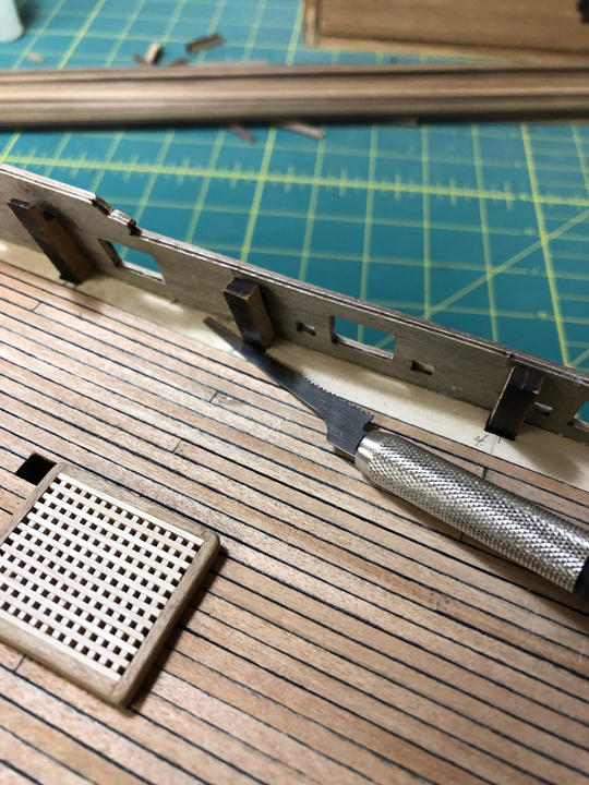

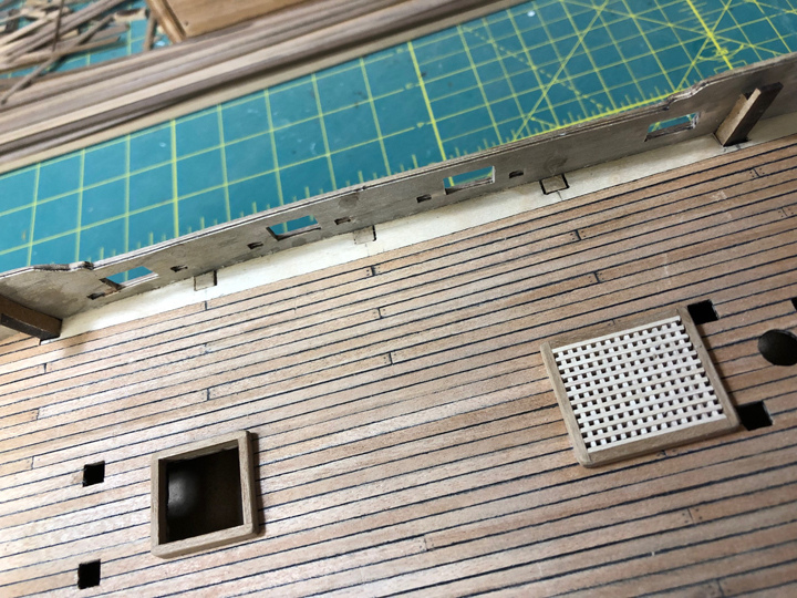

Having planked the outside of the bulwarks I could now remove the uppermost portion of frames #5, 6 and 7 along the waist of the Pegasus. This may seem like a tiny moment, but has been one I've really been looking forward to.
You can see in this photo that the deck also features some finished hatches which I've not discussed yet, but will in a future installment.
With the upper frame extensions gone, the full extent of remaining deck planking to be completed can be seen.
The 4-butt shifting pattern was continued all the way to the perimeter, with the last plank (also known as the waterway) trimmed to fit the arced outside line of the bulwark.
The deck was then painted with two thin coats of polyurethane to seal it.

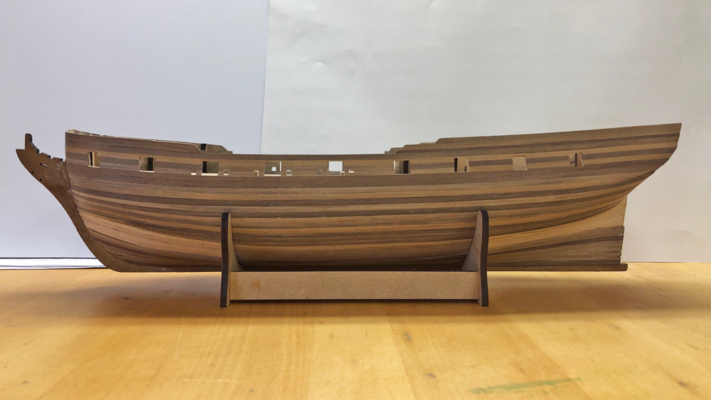

Next up were the final walnut strakes to the hull. In the long run, it's not much, but it sure felt good to place them and get the entire hull sanded down as smooth and as shapely as I could make her.
There is still much work to do on the exterior of the hull, and my planking days are long from finished. I need to plank the interior of the bullwarks along the ship's waist next. And after that I need to add something called the 'wale' which is a belt of three black planks to the exterior. Further, I need to decide if and how to treat the exterior. Do I stain it? Oil it? Polyurethane it? Leave it alone entirely? I need to do a bit more research and see what is in vogue for such things. But at the end of the last building session, I could finally put her in her cradle and have her fit tight, knowing that the long days of trimming, soaking, bending and gluing a seemingly endless sea of strakes is behind me.
Post Script: After completing the 2nd planking of the hull exterior, I may have tucked little Pegasus under my arm like a football and carried her around the house for a couple hours, holding her up to the various light coming through different windows or from different lamps, looking at her and rubbing her sweet smooth lines. Ishmael asked me if I was going to bring her to bed with us that night. I'm not saying I did, but I'm also not saying that she didn't look warm and cozy resting on a velvet pillow on the nightstand by our bed the next morning...
