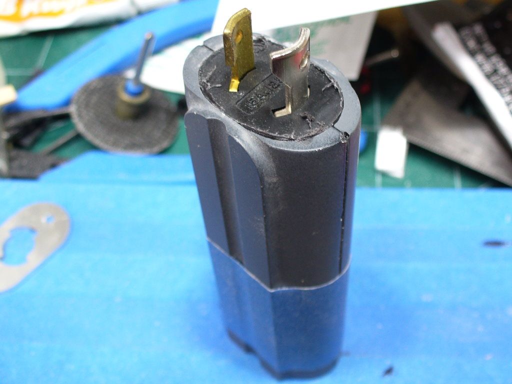

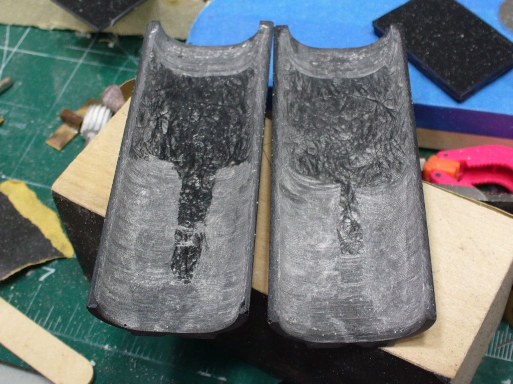

I tried but I just couldn't bend a brass tube to form the grip, it was a miserable failure. So I made it in fiberglass. Then I started fitting the twist plug.

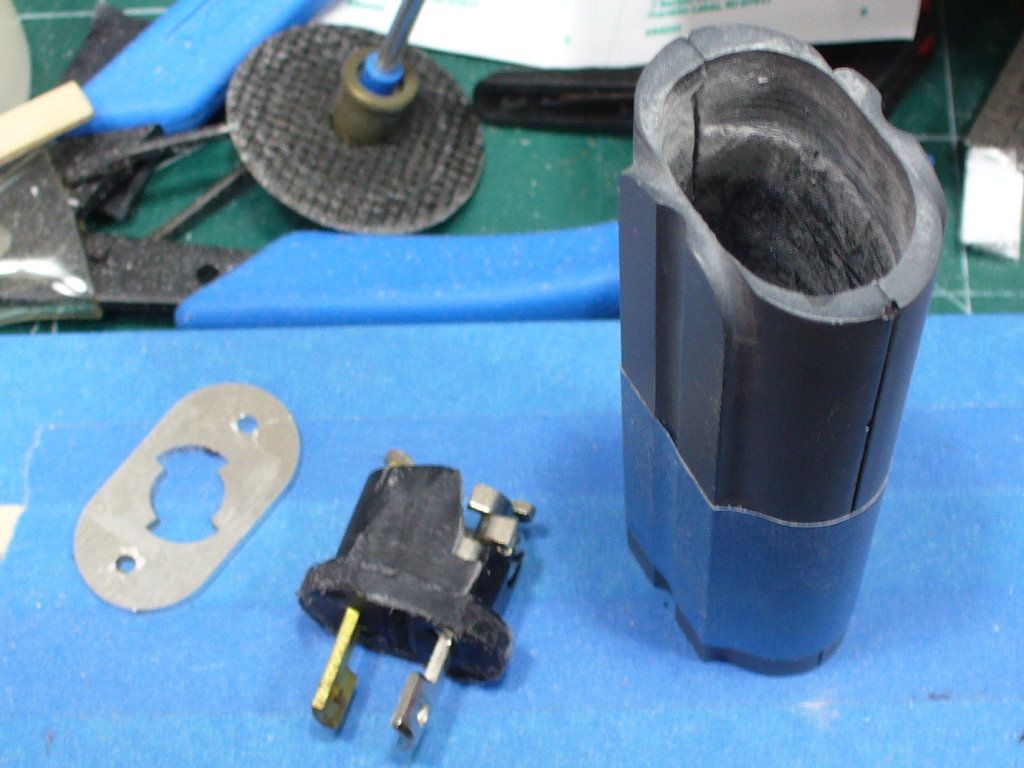

I ground out the inside to fit the plug and the batteries.

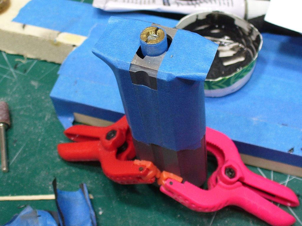

I attached a long machine screw to the bottom of the plug, and used the butt plate to keep it centered while the epoxy set.

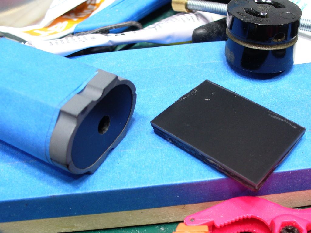

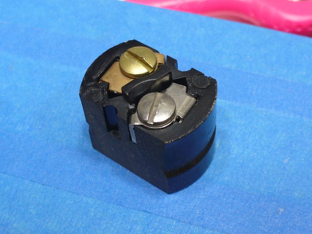

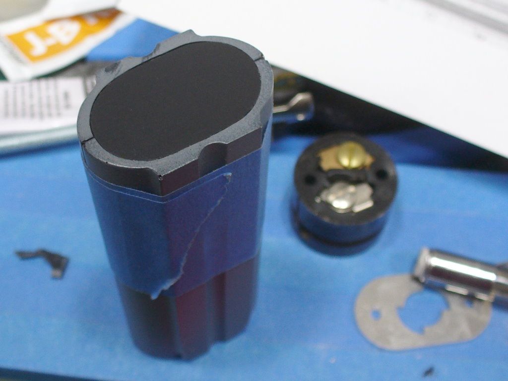

I also started the bottom battery cap. I shaped a piece of black styrene to fit inside the grip.
I glued three layers of styrene together, making a piece 3/16 inch thick. This will be the cap, cut to match the outer shape of the grip. The piece cut to fit inside will be glued to this one.
While working on that I shifted the inner knob just enough to make the spring and ball fly across the shop, never to be seen again. Fortunately I have replacements on hand.

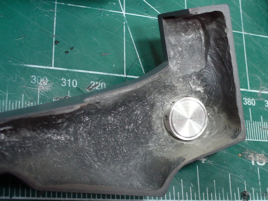

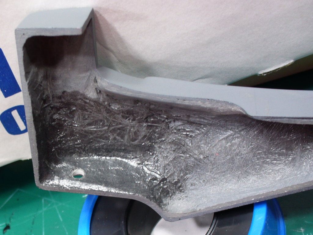

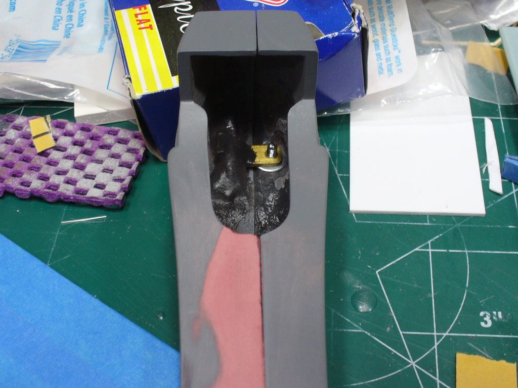

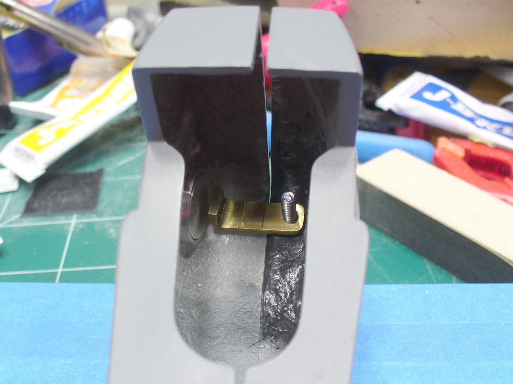

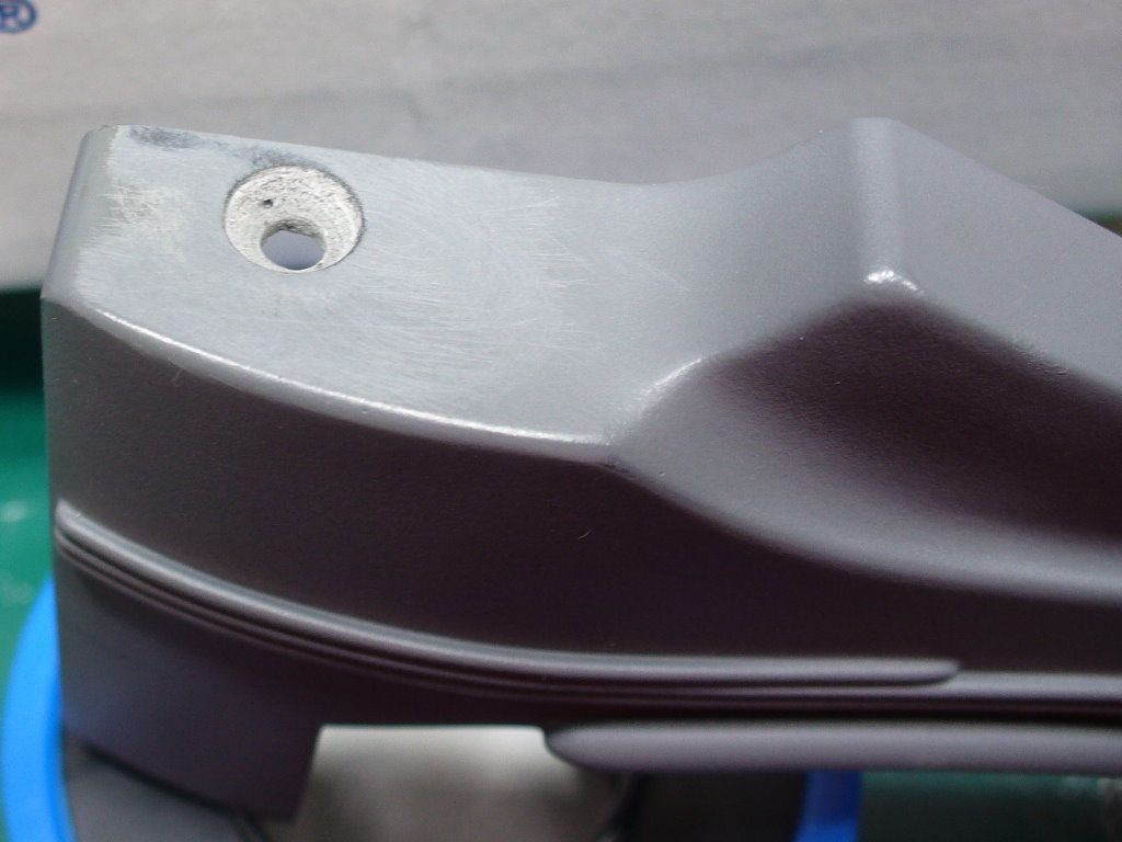

I also drilled out for the bottom screw. I first built up some epoxy on the inside to thicken it.
I then drilled through some brass bar and tapped it for a 4-40 screw. I bent the end to help anchor it when it's epoxied into the shell.

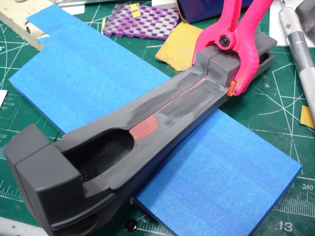

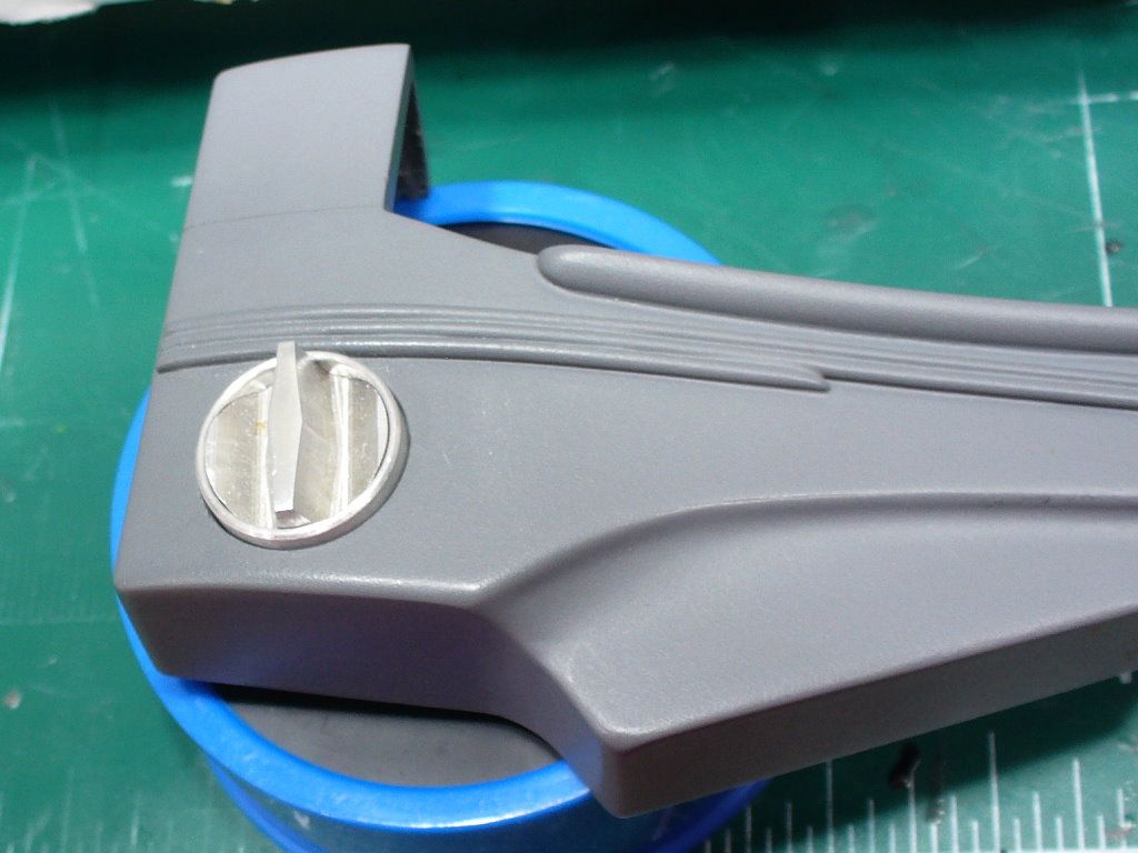

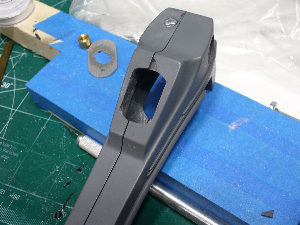

The grip still needs to have the seams cleaned up, but it's now done. So I started on the twist socket for the P2. I sanded the sides of the socket flat on my disc sander.
I sized it to be slightly narrower than the grip.
I marked the P2 for the socket, and made a rough cutout.
With the socket attached to the grip, I tacked it into the P2 with some epoxy on the left shell half. Once I'm sure it's in position, I'll secure it with some PC7 epoxy paste.
