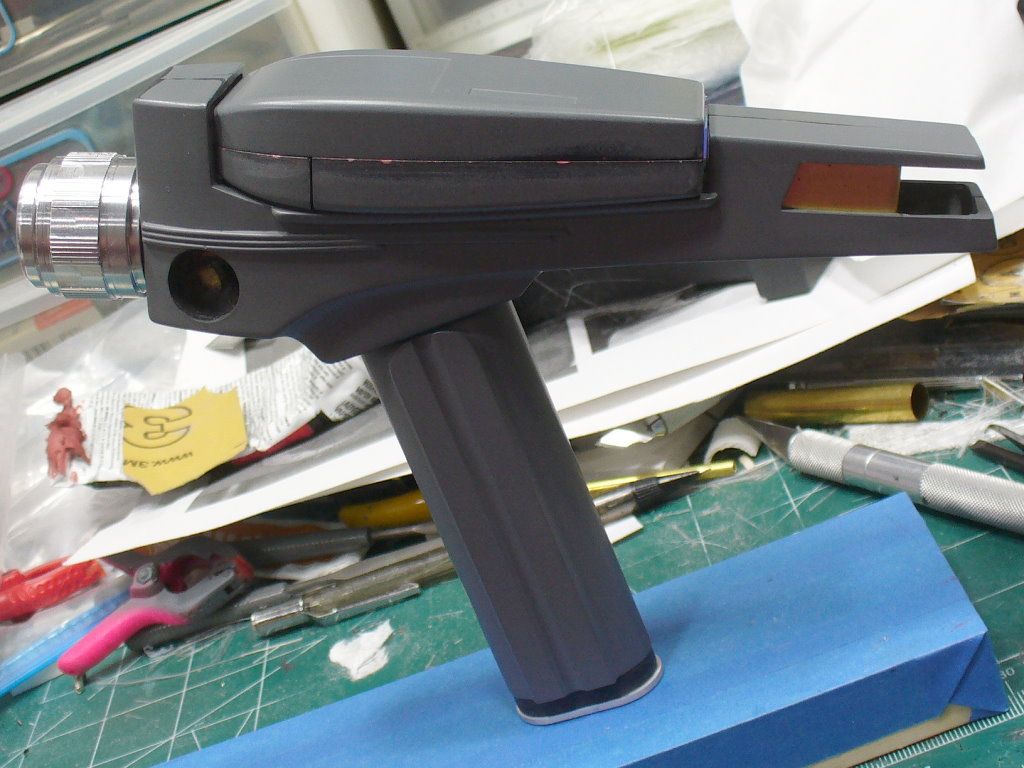

Hero Phaser Scratchbuild

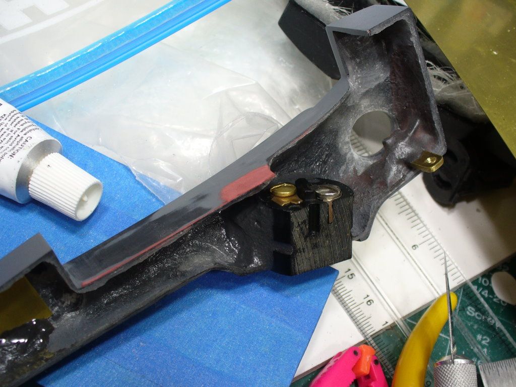

I packed the gap behind the socket with PC7. It takes 24 hours to set, but it's hard as steel.

Well that's figurative, but it does contain steel and it's very tough. I don't think it's conductive. I like it because it's a thick paste so it doesn't run, and it gives you plenty of time to work it into place and clean up the excess. I also used it to secure the twist plug in the grip, and on the brass screw tab in the front of the shell.

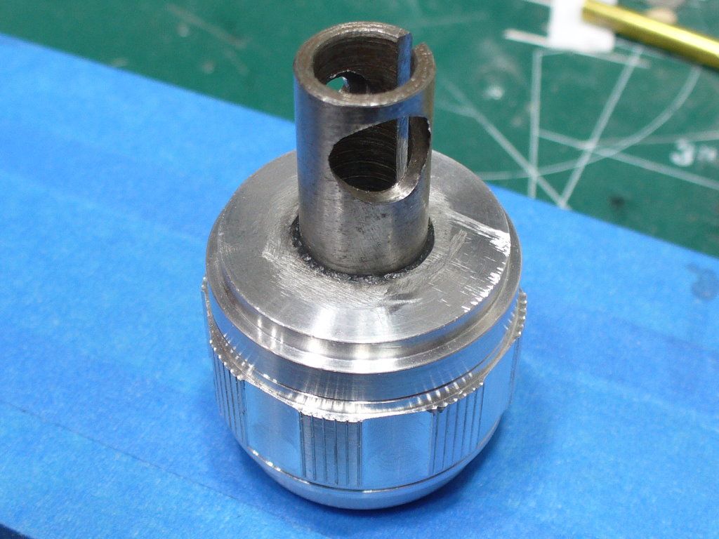

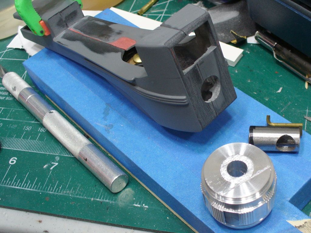

I have to modify the nozzle for a hero build, I started by cutting off the short mounting shaft on the band saw.
Then epoxied in a new longer mounting tube.
This tube is drilled for a screw. Thank you Junkman for the tube.

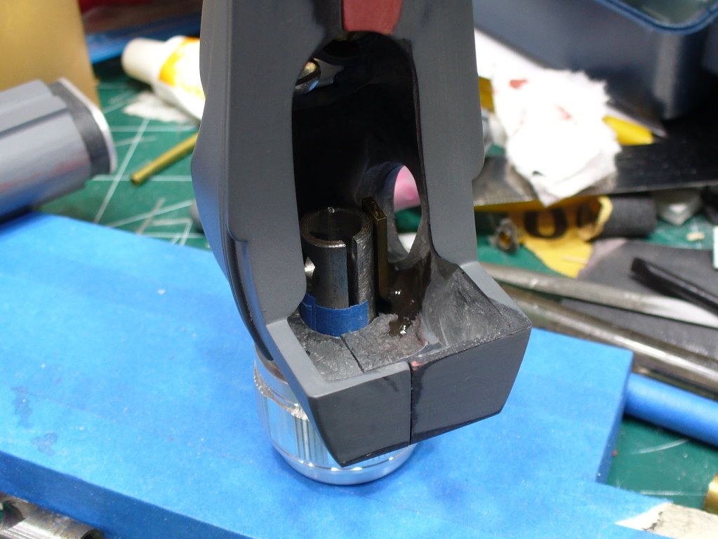

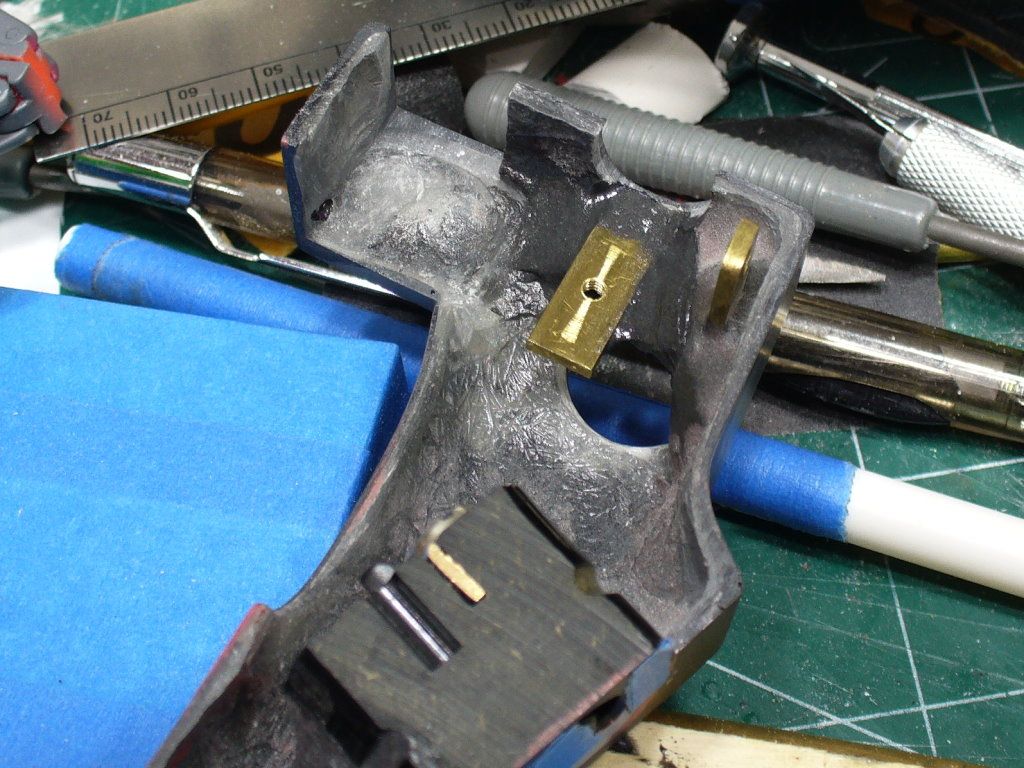

The nozzle mount is a piece of brass bar drilled and tapped for the mounting screw. It was tacked in with JB Quik.
Then I secured it with PC7.
