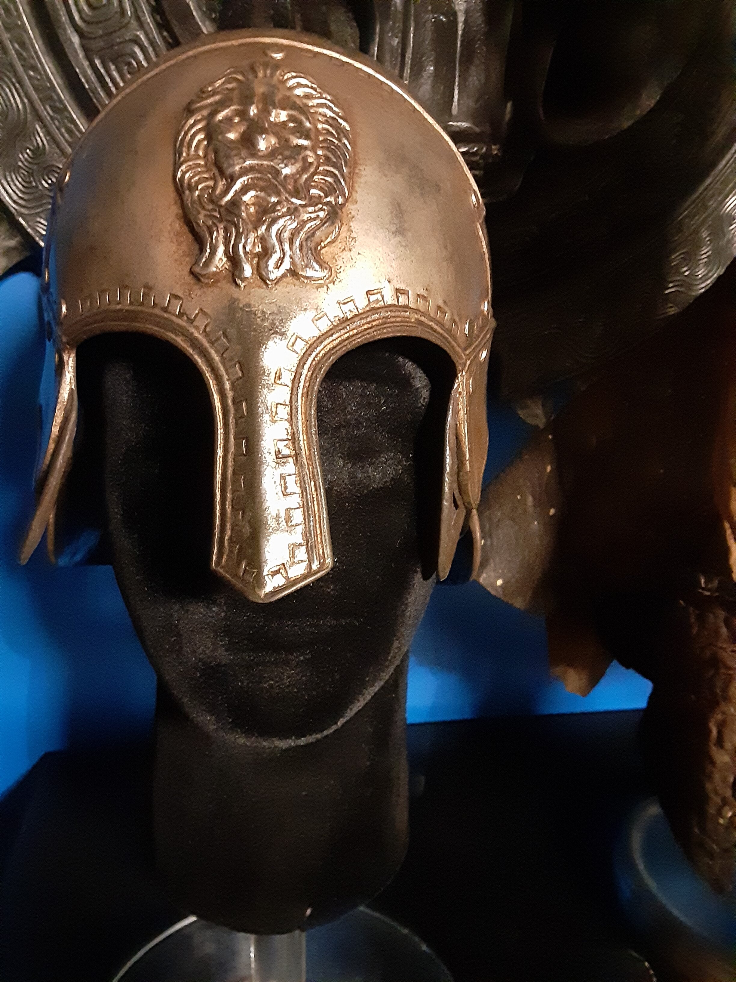

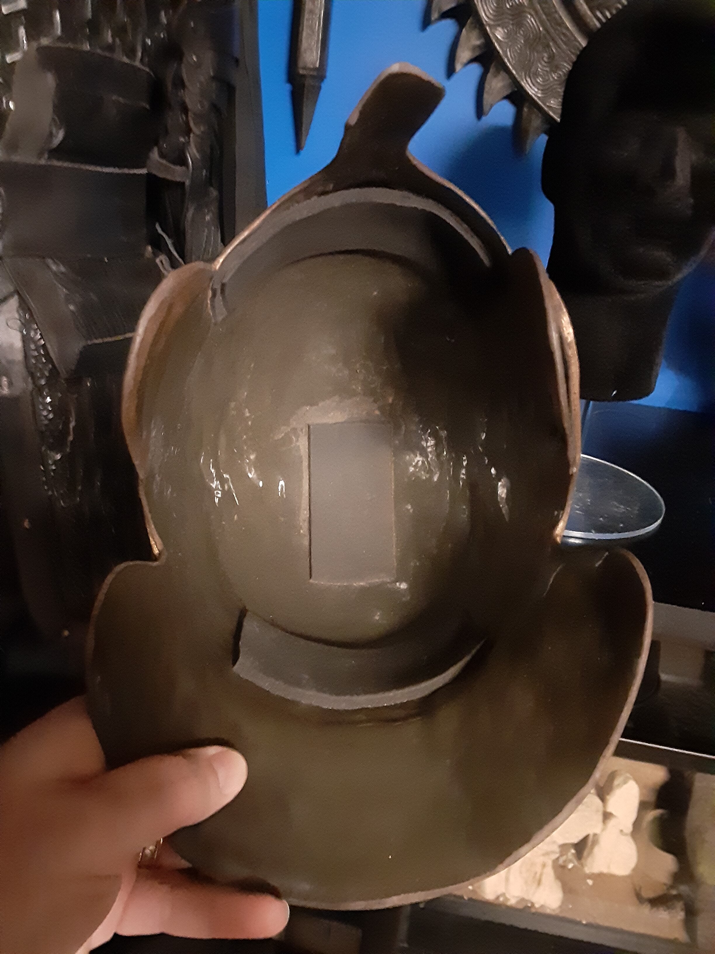

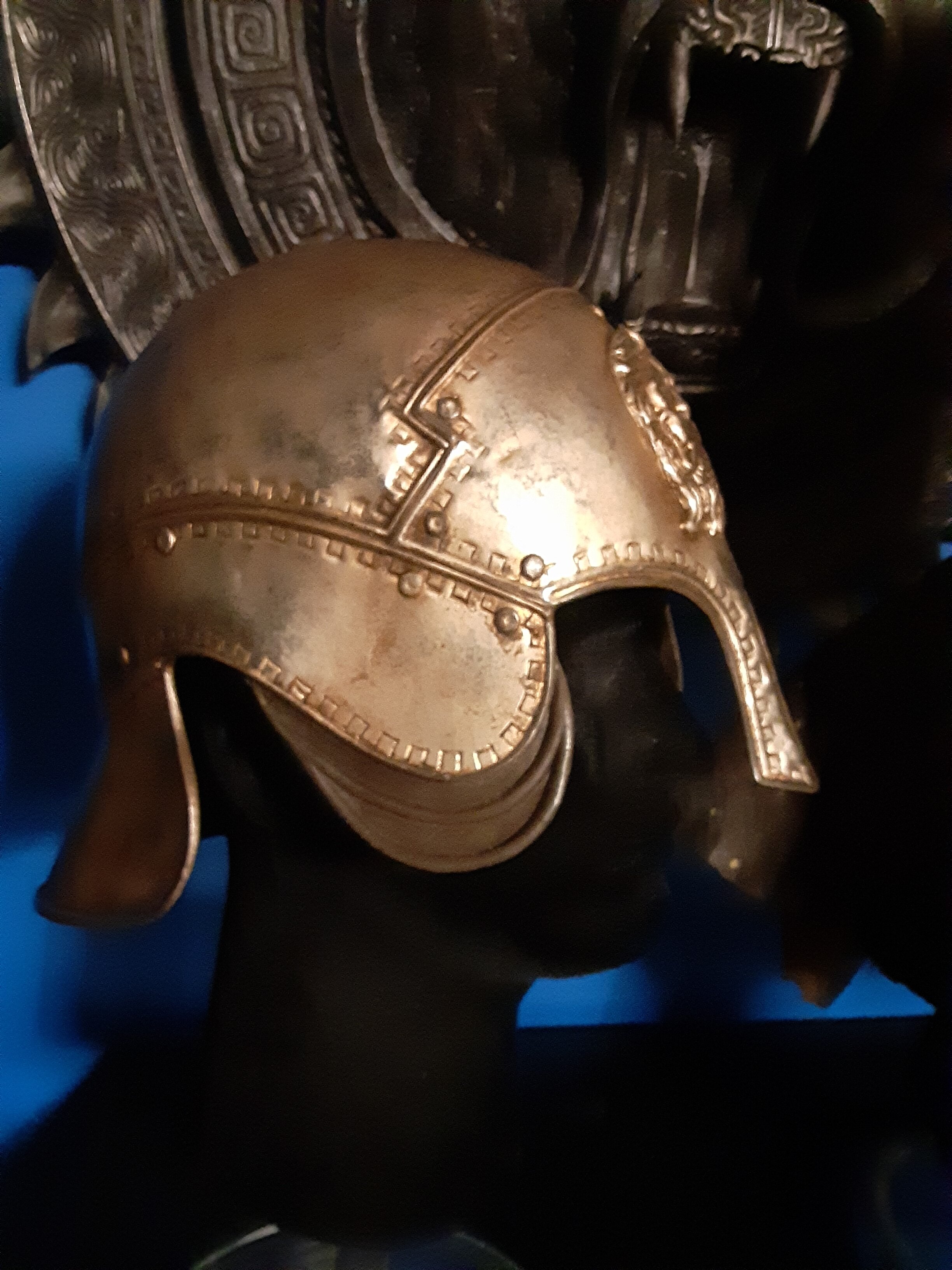

I recently got in a Thracian archer's helmet from the movie Hercules. It looks great but has slight warping to where it doesn't sit perfectly on the head. 'What would you guys recommend for attempting to fix this? I want to keep the paint looking good and the foam padding undamaged.

I own one of these helmets. I believe it's polyurea sprayed into a mold. Truck bed liner. Durable as hell. It's how a crapton of armor is done these days. Most of the marvel costumes use some. A heat gun should do nicely for reshaping. Start with a blow dryer, because it's so much more gentle. If that doesn't produce enough heat then use a heat gun but go slow!
