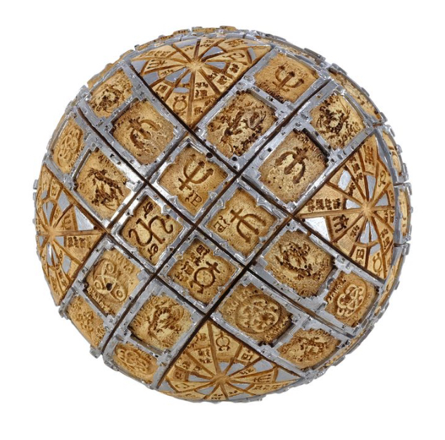

Hi guys, I've posted the whole process of the Puzzle ball and how I built it. I had two attempts at this and one was drastically different than the other. Both used magnets but found the first time that there was one position that two magnets opposed each other and pop there goes one of the pieces. Some re-engineering was needed and I was able to correct it. The second attempt was less detailed than the first in terms of metal where I ended up molding the frames. I'll post those pics soon.
