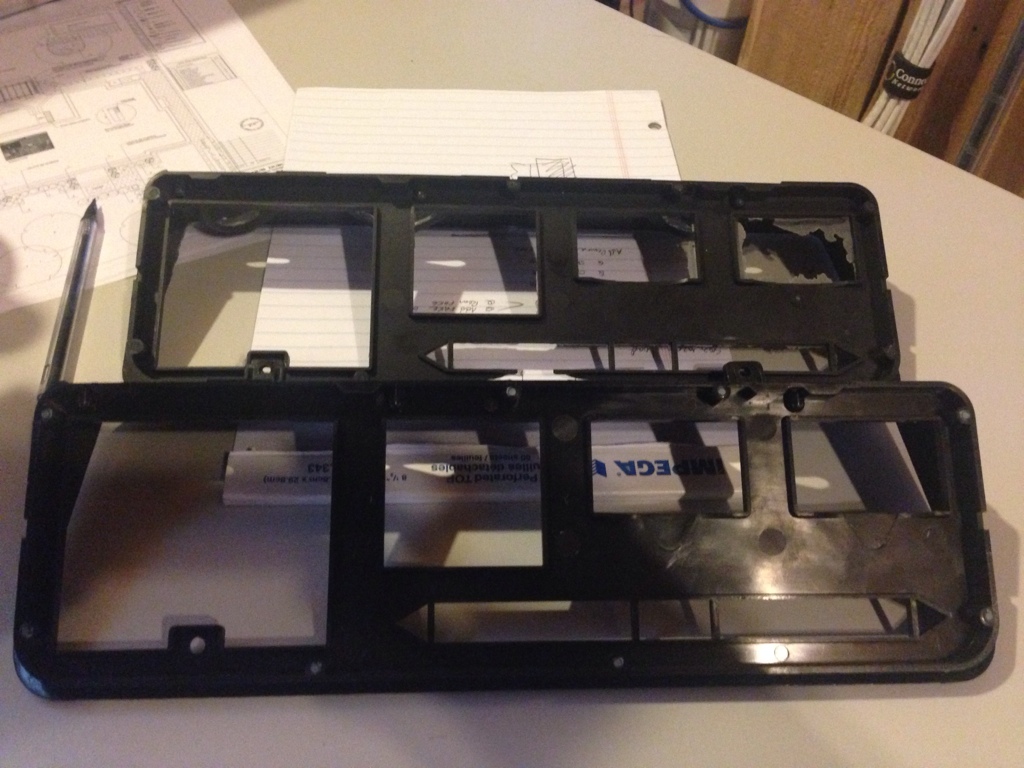

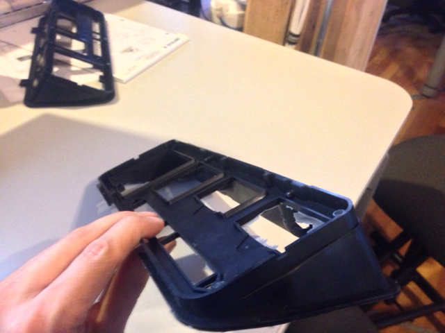

Demolded my first cast this morning guys! I'm super happy with the result!

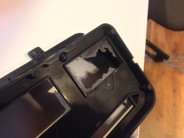

You can remove the flashing with your nails! A few small air bubbles on the top lips that will go against the HIC box .. so no worries there .. it's the price to pay for the 2 parts mold! :) I'll still be really picky of what I send to you guys so no worries there.
I still need to cast a complete set to evaluate final cost!
Basically ...

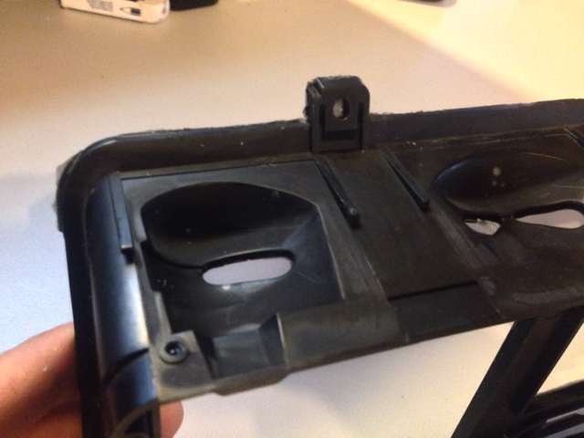

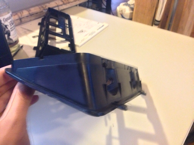

A 2 parts mould will create a cast piece which has details on the inside and the outside, it's an exact repro. But I need a longer curing time resin, which is more in terms of hours.
No more slush cast. Heavier to ship, more resin and longer to cast!
Anyway .. I need another mold to be more efficient! :)
Hope that helps!
