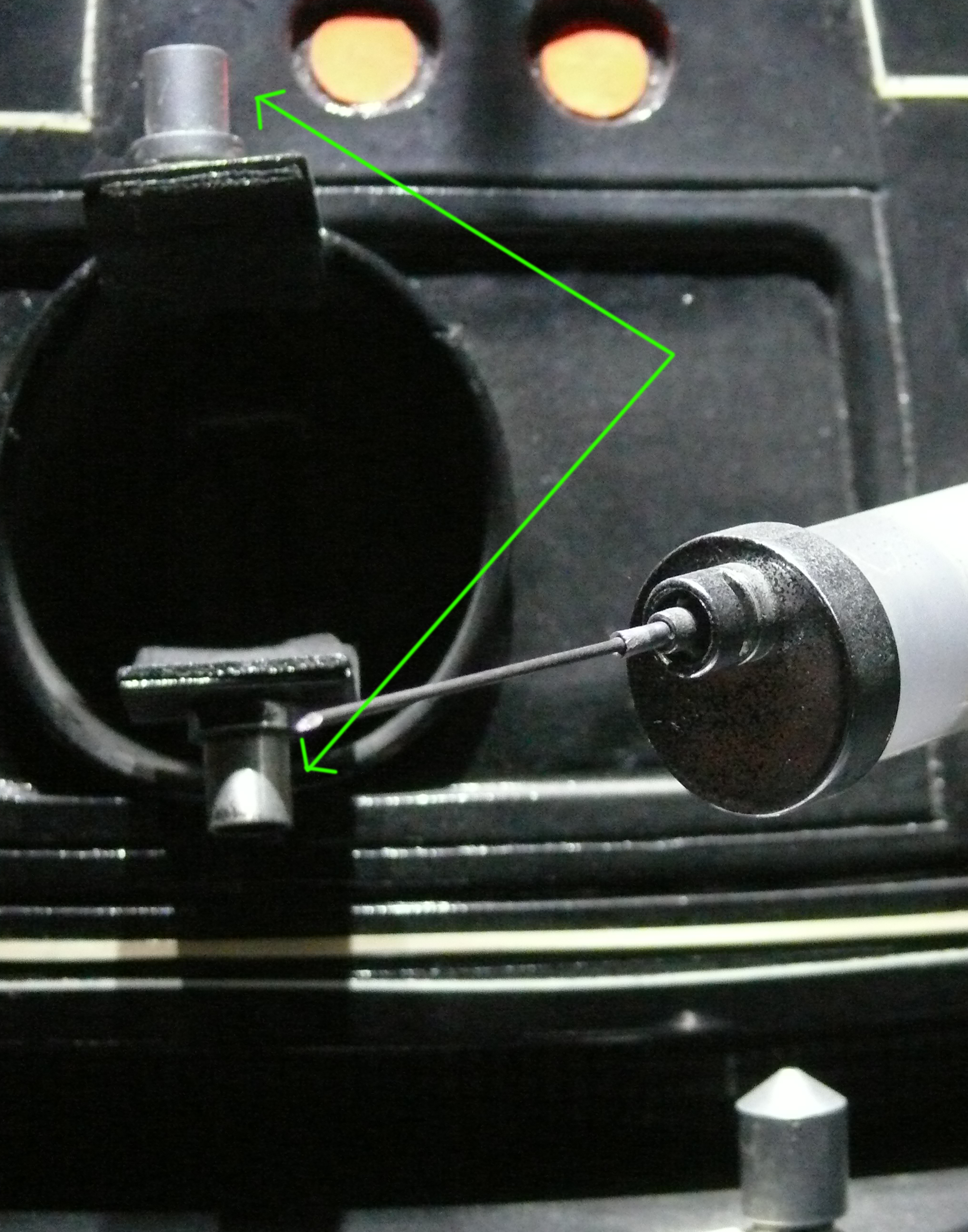

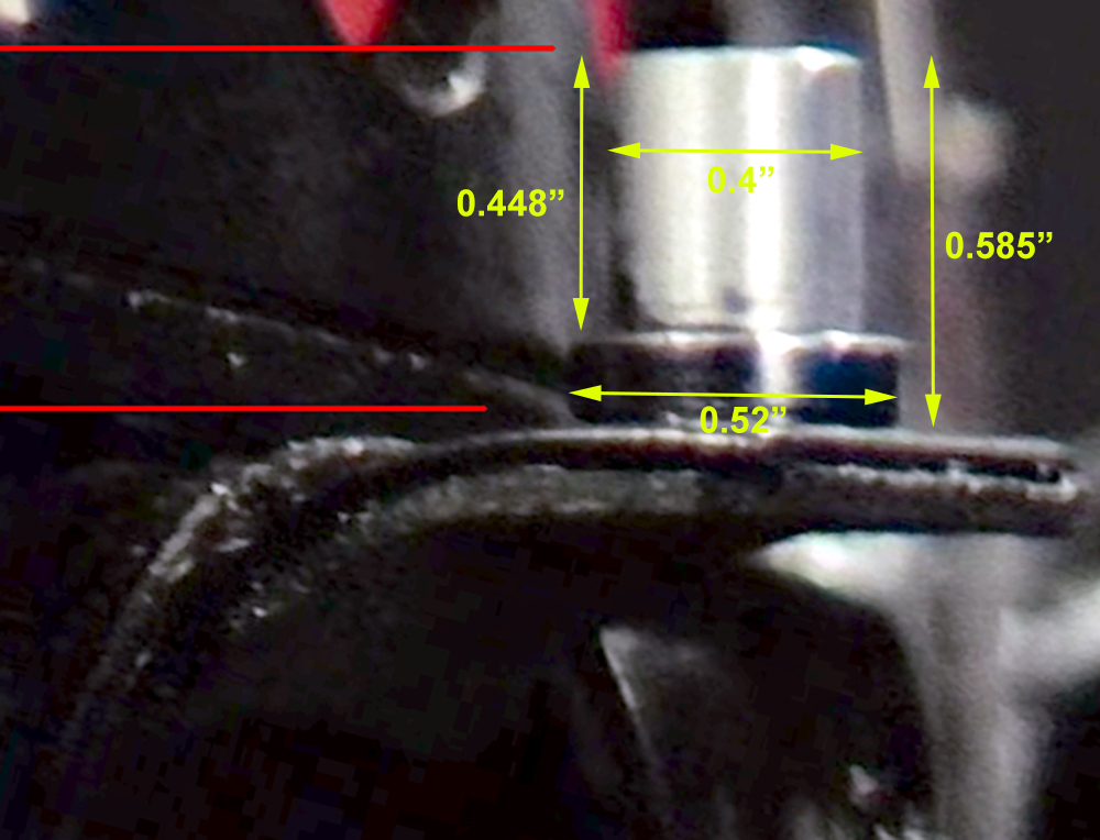

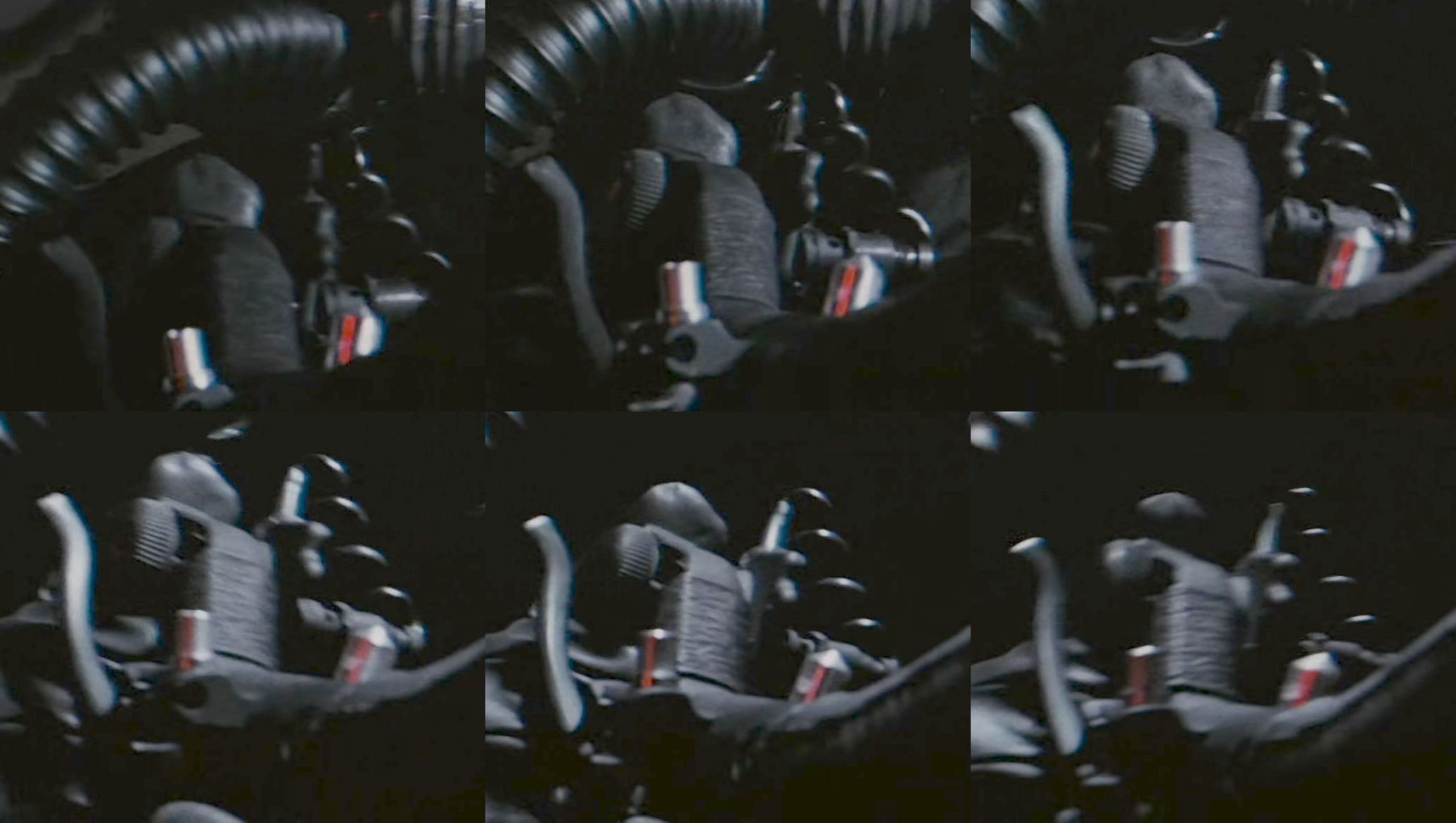

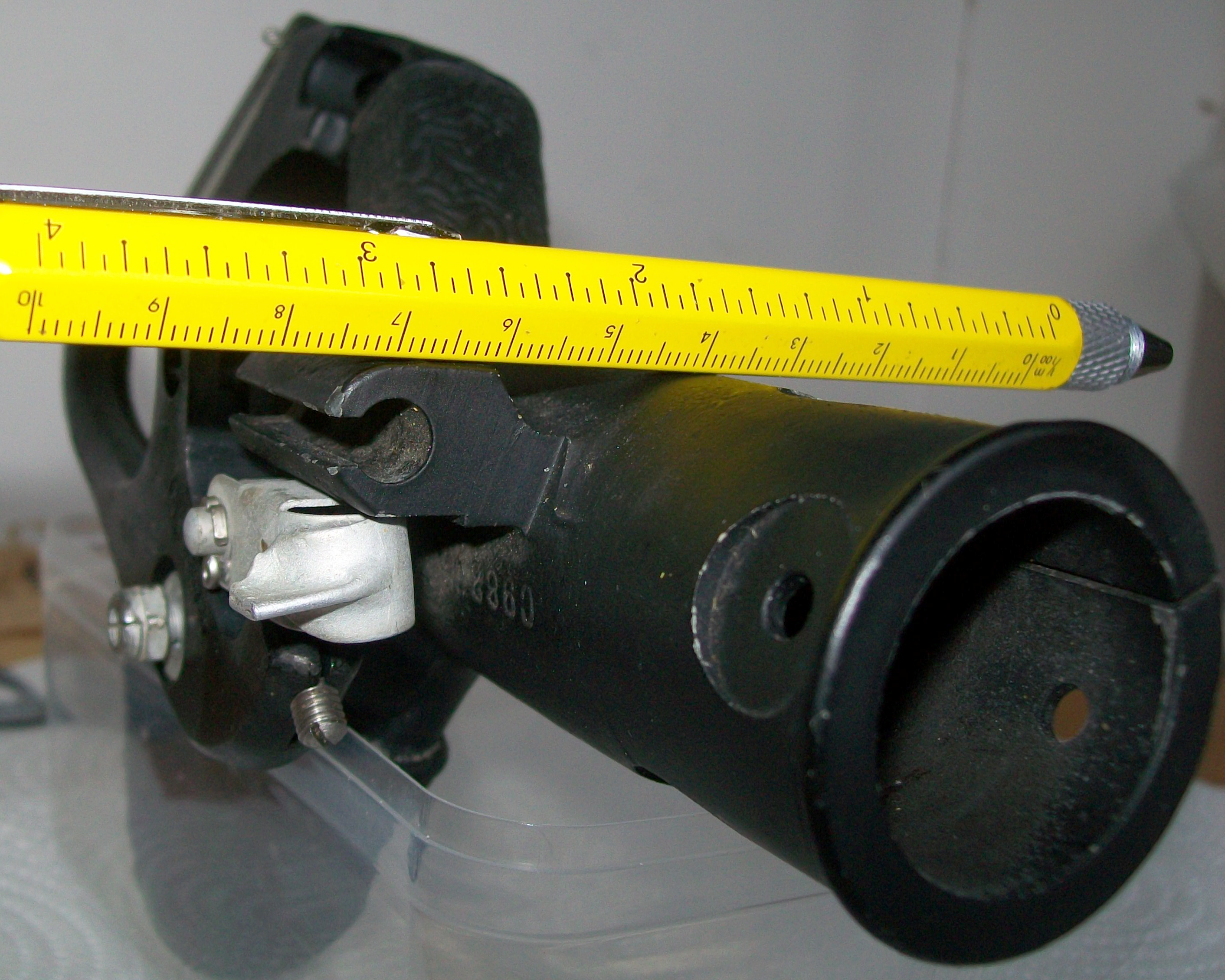

Others should chime in here with their measurements, but this is what I get:
From this image of yours, where we have the known Michell speed control vane knob with a diameter of 0.5 inch, I determined the diameter of the narrower portion of the 'top hat' to be 0.4".
Then, using this image, I use the 0.4" diameter of the narrow portion as a calibrator to get the other dimensions.

Again, others should chime in, but this is a start...

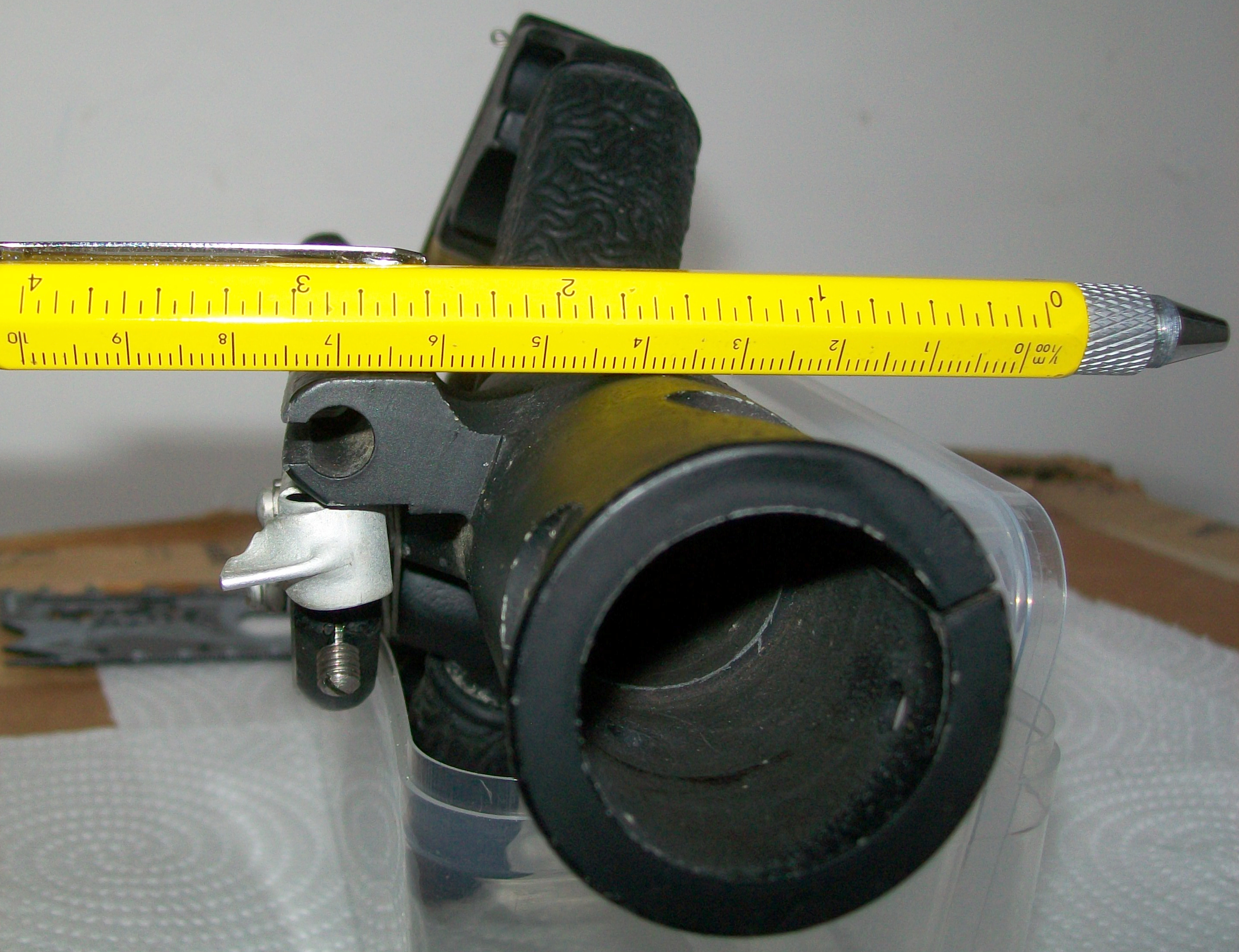

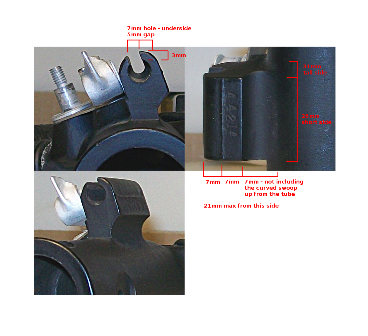

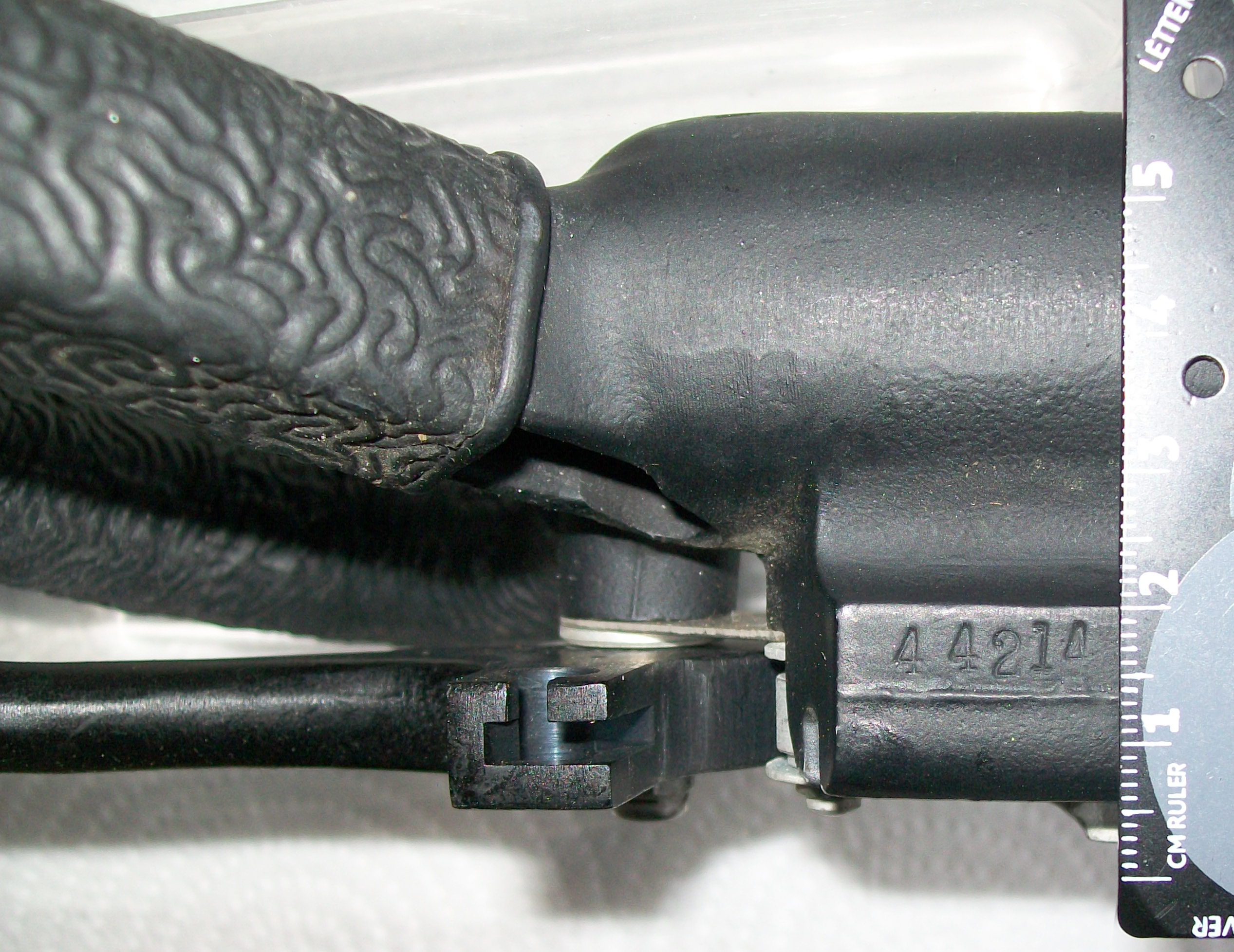

Some pics to show the size and space available for the tophat part that sits on top of the Tie controls. This particular tophat looks like it has a metalic base, as apposed to the black and grey base on the others.
I think the sizings here pretty much fall into line with 3DImpact's findinigs but some cross-checking would be good to be sure.

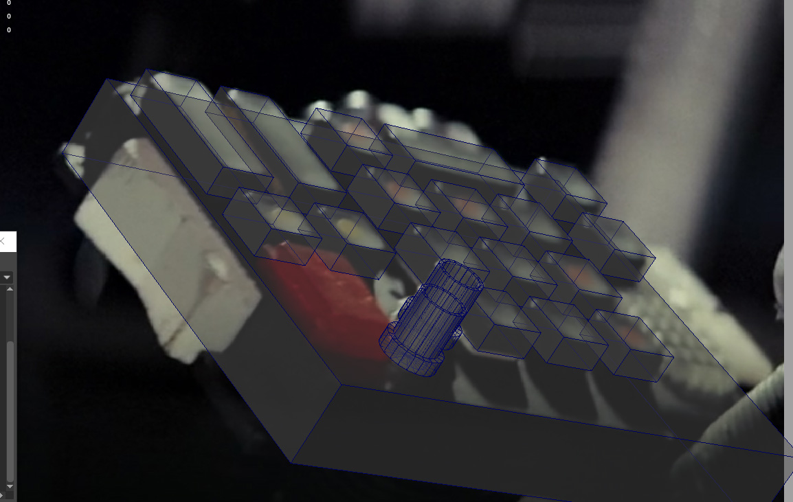

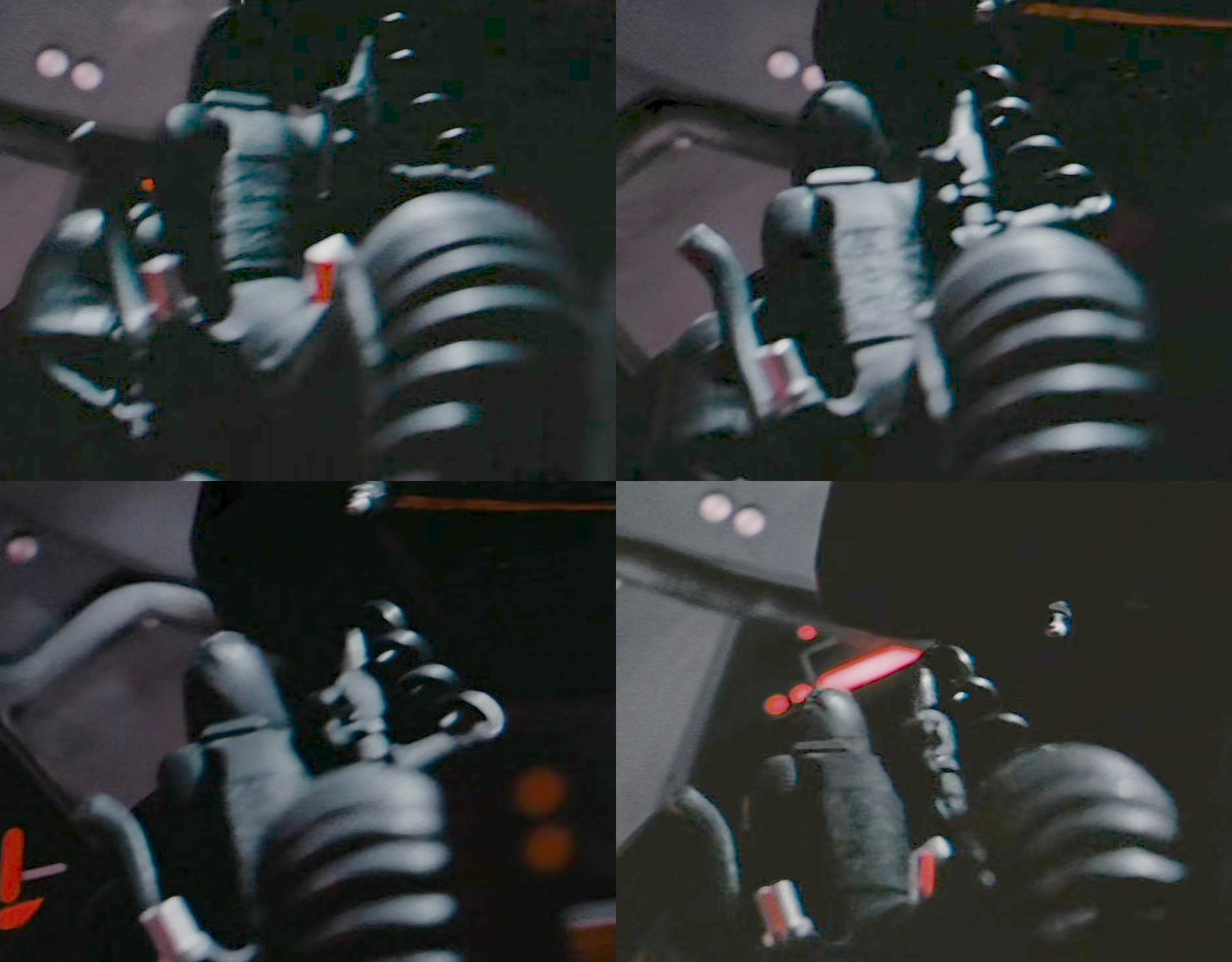

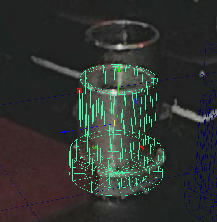

Hey guys,

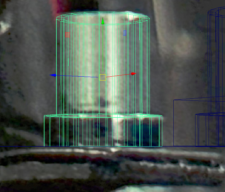

I was able to work on modelling, persp matching the small top hat tube today :)
I have a calculator matching the Xwing controls so that was pretty easy and the result should be pretty accurate in size thanks to that :)
size based on the calculator:
proportions based on the good references from the interogation droid!
my final size for those is 12mm diameter and 13.5mm high :) a bit smaller than what Dan found above but I think the calculator match is a quite accurate method to get the size for those :)

Hey guys,

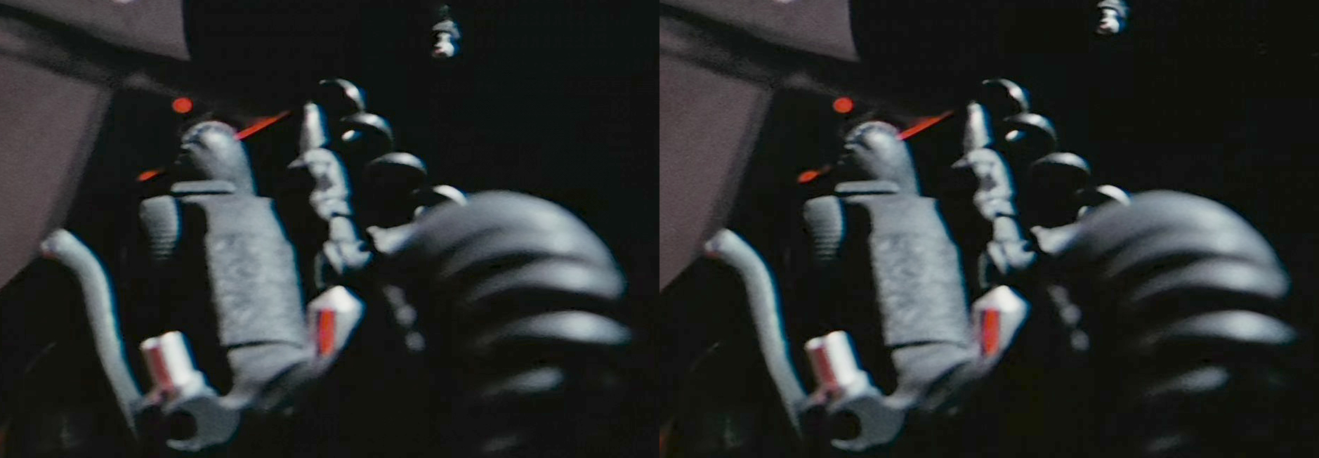

hey guys,

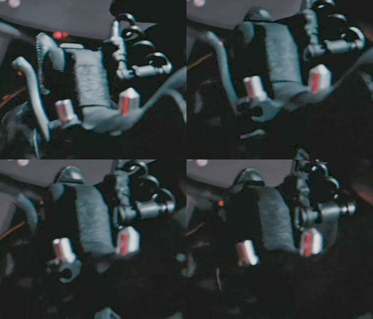

the top hat tube greeblies are added to my website now, 4.25€ a piece, I hope that's ok, it's based on the actual time it took me to machine them today, I did 32 of those, will do more if needed!
so, from what I can count, there are 2 of those on the Falcon gun controls, or looking at Dan's replica, maybe 3 with one on the other side!:
two of those on the Xwing controls:
and I can count 8 of those on the interogation droid:

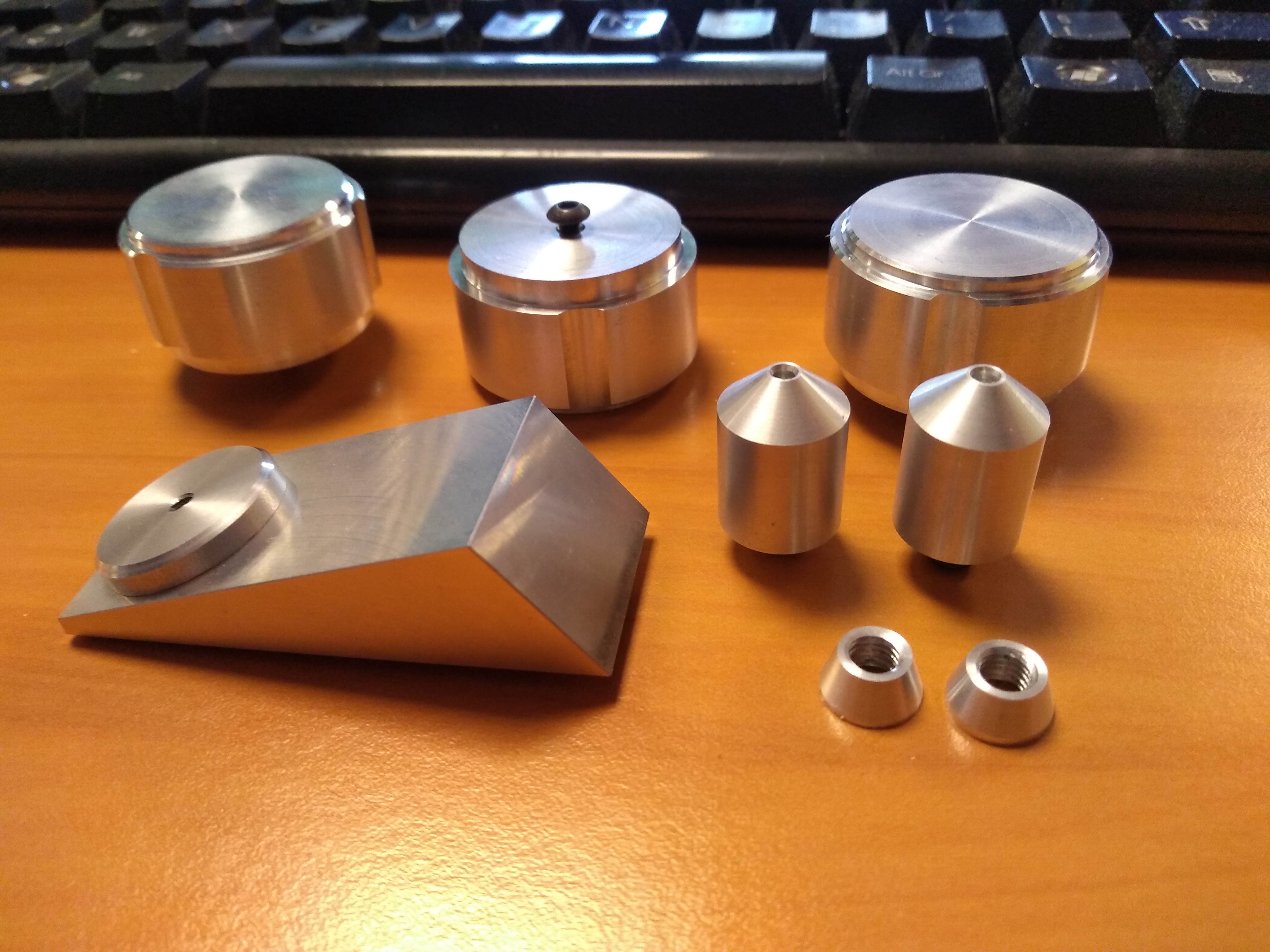

hey there :)

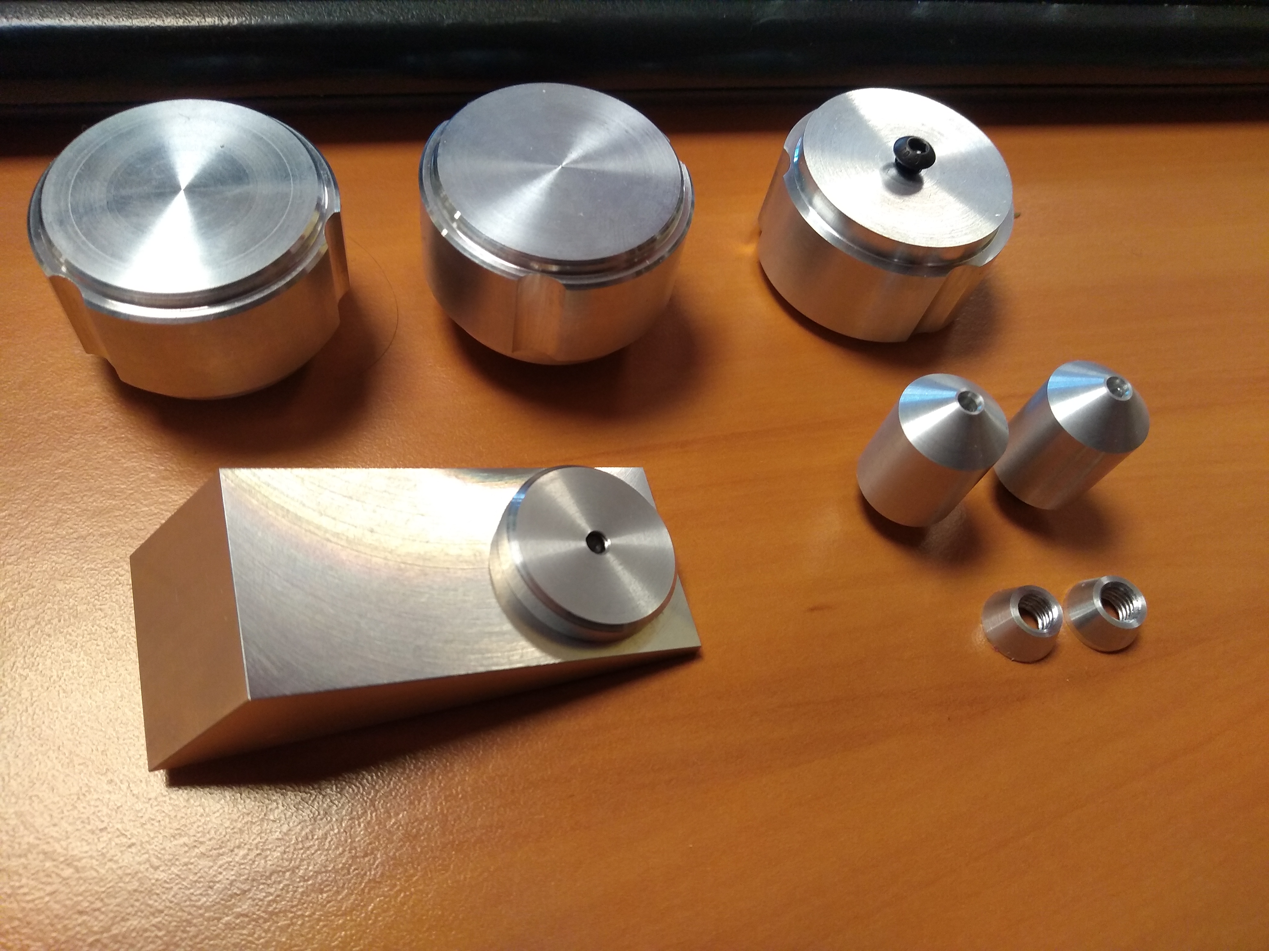

new batch available, now with 4 flutes and a set screw on one side (purely decorative)
a couple 3 fluted knobs left in stock in case anyone wants them at some point... they are slightly cheaper than the 4 flutes ones!
cheers
Oh, nice work on the 4-fluted versions! I guess I'll have to get a couple of those.

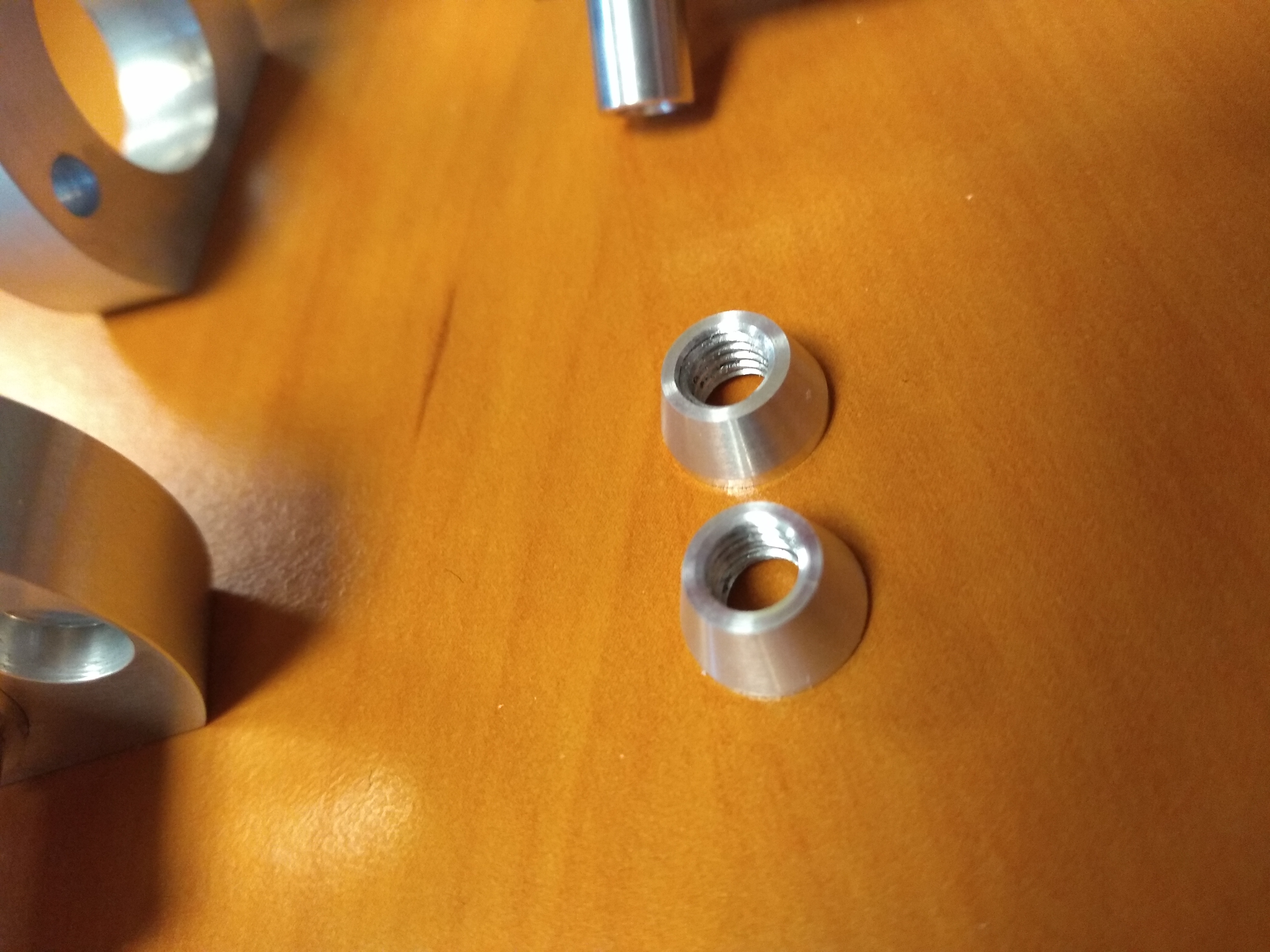

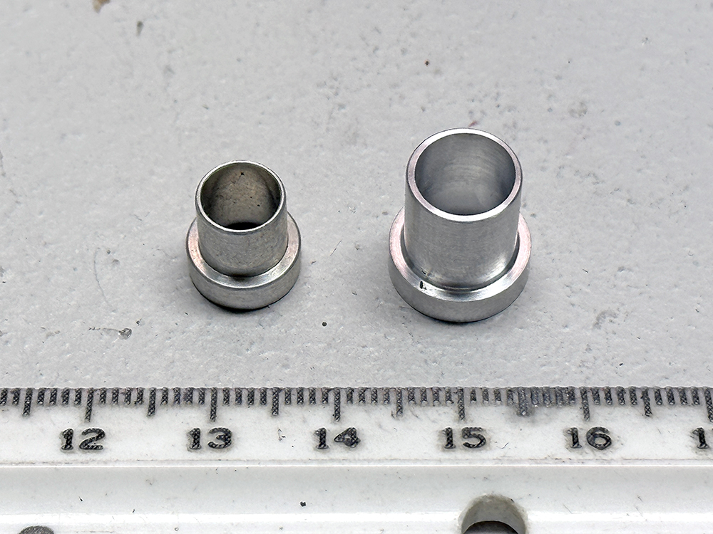

In the mean time, here's a comparison between the previous best guess on the 'top hat' found part (hydraulic fitting, on the left) versus your machined versions (on the right) from measurements from reference images:
Dan
Dan
Thank you for the comparison, quite different! Looking forward to see it on your final prop :)
