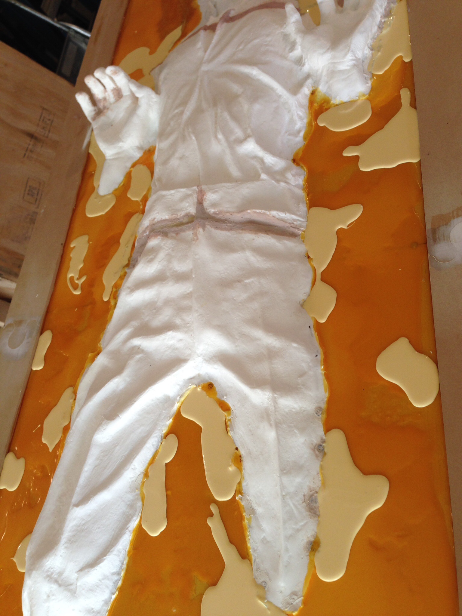

Thank you for the Rondo tip. If I need to apply that, I'll look into it. Right now, the glue layering is working well to provide texturing. Maybe those who've finished can tell me if the glue dries hard enough to paint over or if something needs to go over the glue. I have discovered a few tips for successful glue texturing
Tips for Glue Layering
1) Use TiteBond Wood Glue - This has a short work time and dries relatively quickly
2) Use shallow/thin coats - I started with a thin coat over all the wood mounting board. I applied in small areas and used a spatula to spread it around. This dried within a day and provided a good foundation for further coats. The rest I've done in small (6-8") areas and I always use a putty knife to feather the edges and give it an organic look. Here are a couple before and after spreading pictures. The left shows the pools just squeezed from the bottle and the right is the spread out areas.
3) Use a fan. I have a floor fan that blows on setting 1 (slow) and oscillates over the entire construction. The layers dry within 6-8 hours so I can do some glue in the morning and it's dry when I get home from work and can do some at night and it's dry by morning. I don't let each one completely dry so there will hopefully be some curing benefits.
So far, things are going well, and I hope to be done with my Carbonite in the next day or two. After that, I'll be sanding the seams and getting ready to use some automotive primer on the whole thing and cover the panel holes with cut sheets for support.
Thanks to everyone who's gone before and added their tips and tricks.
