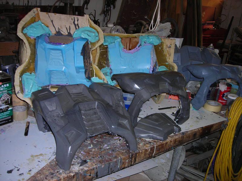

I finished the first pull from the torso molds yesterday. Here it is:
And a wider shot with the masters in the background:
As usual, the first casting is way too thick and heavy. I'll be making more pulls today and laying them up with some fiberglass to make them thinner and lighter and just a bit stronger. Then I'll be pouring some foam inside to bulk them up a bit more.
Then I'll experiment with cold-casting a set.
Next piece will be the boots. More on that soonest. Comments appreciated, and let me know if you'd like a copy of the torso armor.

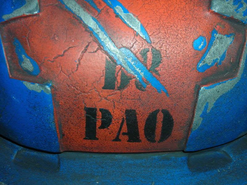

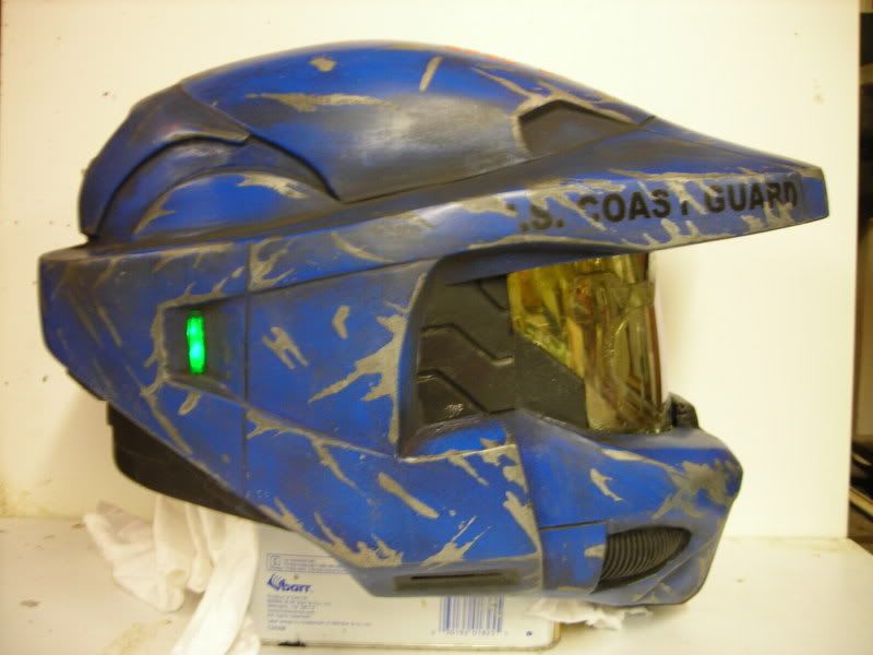

So it's time for me to go to sea for a few months (my day job) and I won't be updating for a little while. I figured before I go I should post a few more images.
First is a helmet I painted up for my girlfriend. She's a US Coast Guard officer and made a joke that she should wear a helmet to the office some days. I figured I'd make sure she had one if she needed it.
The interior is fully padded and upholstered and includes cooling fans ducted to blow fresh air on the visor for de-fogging. I didn't get any interior shots yet.
I laminated the visor using a slow-set epoxy, but ended up getting bubbles in between the two layers. I guess I didn't use enough clamps:

Your doing an incredible job with that suit. That Helmet for the GF is beautiful as well, brilliant detailing.
Re: HALOween 2008 Master Chief Costume Progress
Beautiful work! Great job on the helmet for the GF! I like the cracking paint and weathering.

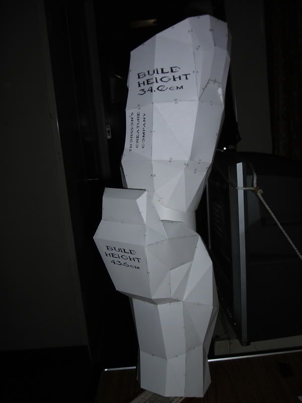

I'm in South Korea, so today I decided to make the quest to find the internet and check in for a few minutes. While I've been out on the ship I have been making some progress, however small. I brought a ream of cardstock and some glue along and now I've got a bunch of paper models done. Here's some pics.
First, the HD bicep armor:
Then the AR:
Finally (because I'd run out of hi-res models to build) I made low res versions of the thigh and calf so I'll know exactly what size to build them in whenever someone makes high resolution versions.
Now I've uploaded the hi-res forearms so I've got something to do on the next leg of the voyage.
