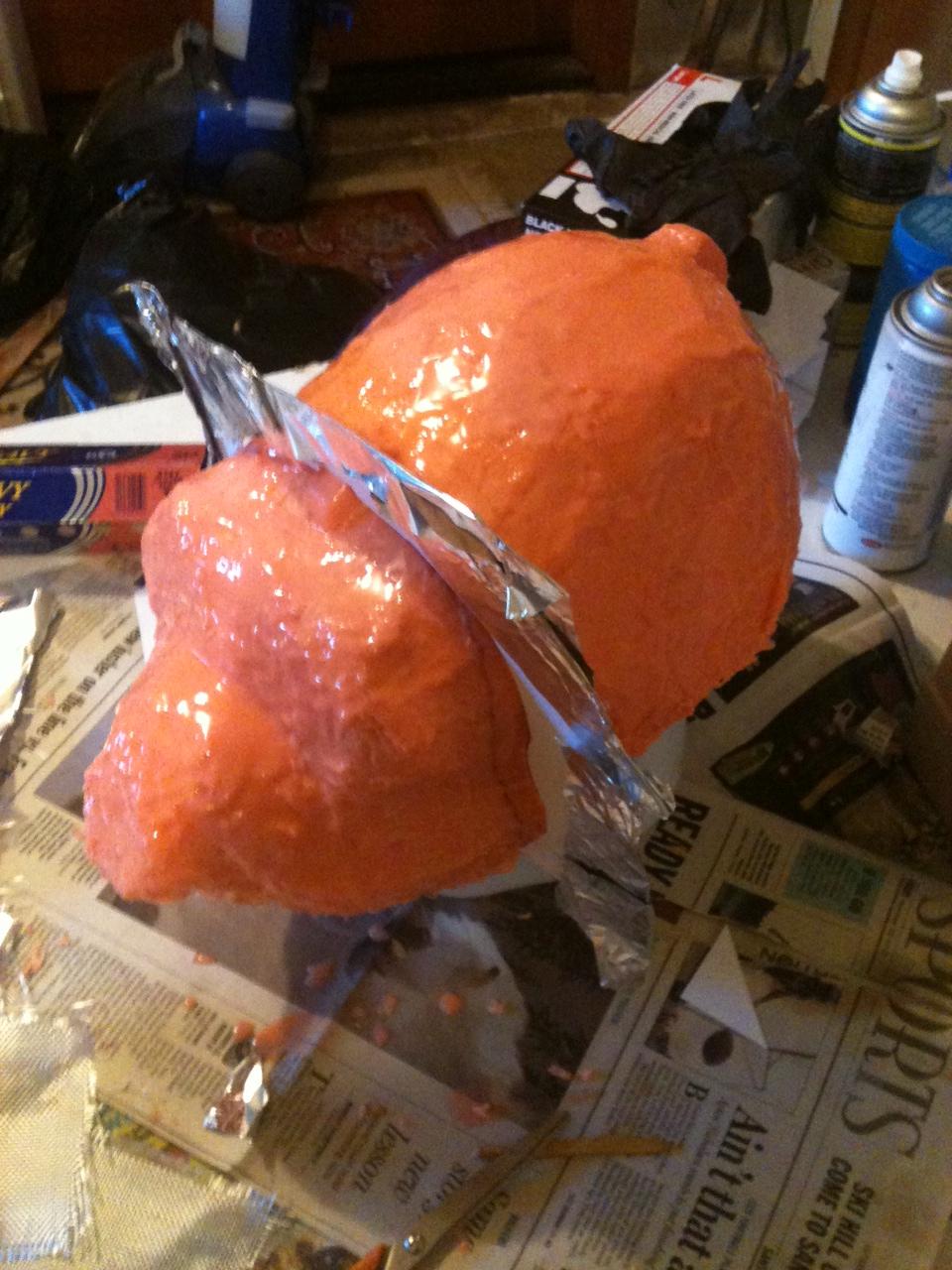

I've gotten the mold to a pretty good thickness, I think.
I have some worries though. The surface is very rough, due to the nature of the silicone. There are a lot of areas that look like they could hook the mother mold, and make it impossible to separate. Stuff like this and this.
I understand some people add on a last layer (without any thickener in it) to smooth stuff out, but I was wondering if there was some other way, because I feel like it's just going to dribble off the sides and not fix the issue. Or should I not even worry about it?
Edit: maybe it's stringy because I'm adding too much thickener...
Re: Half Life 2 civil protection WIP build - first costume, have questions
No, you're doing fine in terms of thickness. I had a different problem, I didn't add thickener and instead ended up with a bunch of drip marks that I had to press into the mother mold every time.
Do add however registration marks!! They help tremendously in the aligning process. That way you line up big chunks of material first to your mother mold instead of all the tiny features.
Now, as far as trapping the mold, don't worry too much about that... that's the part where the silicone flexibility comes in handy. Just make sure you don't have any silicone "handles".
I made a "test" mother mold out of plaster first, and that turned out fine. Then switched it to fiberglass.

Regarding this, is I added a few registration marks (molded from an ice cube tray)--one in the front as you can see in the picture, and then two in the back. I didn't add more because, again, I was afraid they might make it difficult or impossible to remove the mother mold. Is there some way I can be "mathematically" certain that they won't? Some rule I can use for placement of these keys?
Make sure that the faces of the marks end up being at least parallel to the mother mold pull direction. I'm assuming you're making a two piece mother mold, right? It'll help if your registration marks are beveled, dome shaped, trapezoidal, tapered, etc. and otherwise not straight - Exactly like your ice cube tray marks :D . I'd place maybe two on each side, on the highest points, so on the cheek bone and on the temple/ear.

I don't think your "overhangs" are bad enough to really worry about, like Diegator said what you want to avoid is having a really deep undercut that will lock the mother mold down. Basically you want to avoid concave shapes. That said, you may have problems with minor warping due to the little parts not fitting exactly 100% into their nooks and having them press inward. If I were you, I would put 1 or 2 coats of thinned silicone on top of what you have, and then you should be ready to rock and roll. If you do have any little drip strings, don't hesitate to cut those off with an Xacto.
As far as registration keys, I tend to err on the side of overkill when it comes to mold making after a few very expensive mistakes of my own.

Do I need to add mold release or anything similar between my silicone mold and my mother mold? It seems like the fiberglass and resin would stick to the silicone, is that not so?
EDIT: vvvvv good to know, thanks!
Almost nothing sticks to silicone, except other silicone. You don't need to put a barrier or release between the two.

I found it very helpful if you add a layer of bondo over your fiberglass mother mold, simply because you'll most likely end up with sharp pointy and painful bits, and since you'll be handling the mold quite a bit during slush casting, it may lead to some painful results.
Also, if you think your mother mold is the right thickness, add another layer, just in case. I've never been satisfied with how thin my mother molds turn out, and I've made them thicker and thicker every time. It's mostly from lack of patience, really.
What are the disadvantages of it being too thin? Just bendy/not strong enough?
Pretty much. and in some cases it may crack. This was true for me specially around the registration marks.

Couple more layers of fiberglass and I'm done with the shell. Next up is to drill holes to make it ready to be screwed together. Then I'll crack it open and see how the mold looks on the inside! (If it's screwed up somehow I'll probably go into exile and live in a cave)
