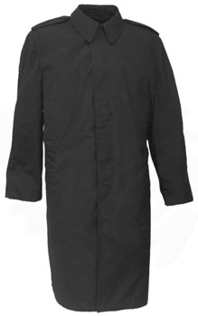

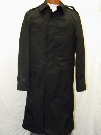

U.S. Army Trench Coat - $31.98 | U.S. Army Rain Coat - $47.99
#1 0021.jpg #2 us-genuine-issue-trench-coat-rain-coat-black-mcguire-army-navy-military-surplus.jpg
With that said, I am certainly interested to see what kind of Motorcycle jackets you found. However I am fairly happy with my findings and I think these would be most certainly suitable. But remember... if you're cosplaying a Civil Protection cop, you might want to opt for a BDU over these jackets with weather in mind. If you're hitting up a convention in the cooler fall, winter or cooler spring times, these might be up your alley. Just keep that in mind because you might be burning up with all this AND a vest on the top of it.
I may get one of these if I change my mind. The prices are pretty reasonable, can't go wrong with Military Surplus for the cost. Thanks for the ideas all the same!
Too long. They're actually like a 3/4 length trench coat. Not bad, but it wouldn't exactly be canon.
(I actually have one of those. They're nice.)
If you go to #1 website U.S. Army Trench Coat - $31.98 they sell them extra short too. But I don't know if that would be any closer to being thigh length which is appropriate for Civil Protection. It's certainly difficult to find one that has a silver zipper with split tails on either sides. I'm practically convinced this is something that has to be tailored.
Well it might, but you'll shrink the arms too. That's really a fitment thing. I mean hey, it might work, who knows. I gotta go pick up dogtag silencers, I'll see if they have any. Mine is a 42L, I'll try the shortest 42 they have.

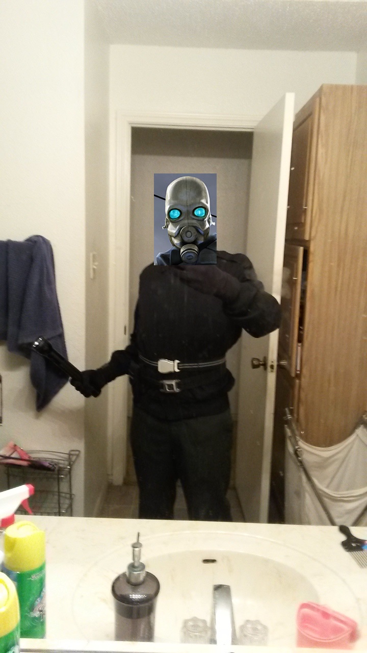

Hello all.

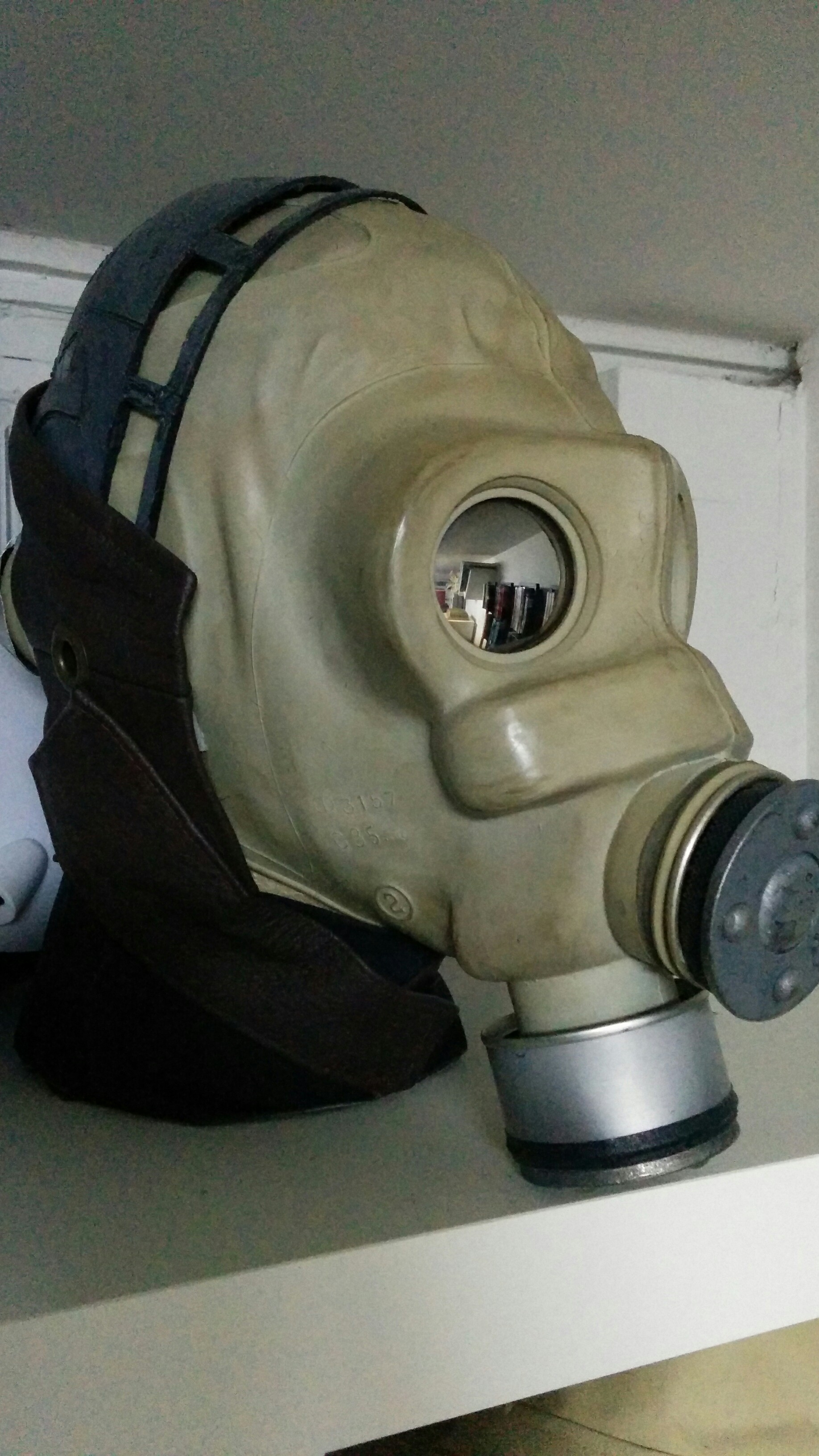

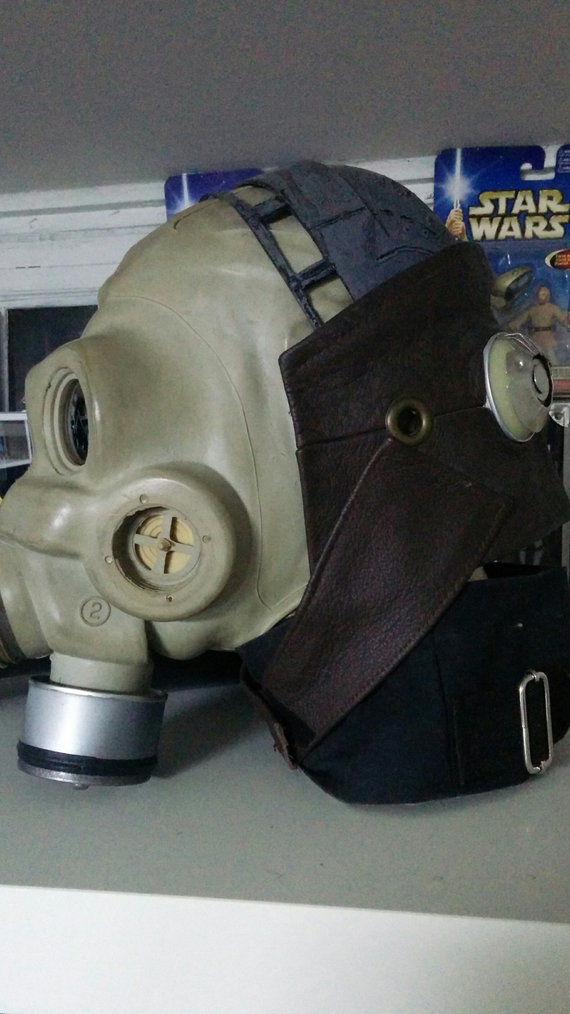

Did a Combine Civil Protection costume a few years ago.
I went with one of the actual Soviet gasmasks and just modified it. It's far from perfect, but the final product looks decent, I think.
I cut away the back of the mask and used a cheap plastic German helmet replica for the back of the metal "skull cap" portion (I melted the lines and details into it, then painted multiple coats of grey and silver and watered down black to fill in the details). I replaced the clear lenses with oval shaped cutouts from a pair of mirrored sunglasses. I used plastic clasps that I glued and sewed to both the rubber mask and the plastic skull cap sections to hold it all together. In retrospect it was unnecessary to have them so they could be undone; since it's rubber you can still fit your head into the mask without taking it apart.
The brown neck/collar part was sewn using real leather, and brass grommets. The grommets were nice because they actually allow you to hear while wearing the mask and line up almost perfectly with your ears. There was a fabric collar beneath that with a single fasten, which helped hide the seams and wires.
Used a small cat food tin to make the lower gas mask filter larger, with large industrial bolts and rubber "feet" glued on top for both.
The "headphones" I made by cutting the intricate pieces out of aluminum pop cans and half of a glow in the dark rubber ball (I never got the antenna parts done, so those are missing).
I bought an Optimus Prime voice changer helmet and stripped out the electronics for the Combine voice, and I wired the speaker from the Optimus Prime helmet into the front "snout" using a small grill to space it out so that it wasn't muffled by the industrial bolt on the front. Distorted feedback was a major problem, because the mic was only a few inches away from the speaker, I tried to fix that by putting a bunch of foam between the two to isolate things, but if I were to wear the costume again I'd probably try replacing the mic with a military throat mic or something, or figure out a better way to isolate the them.
The vest was custom made, sewn from rubberized black fabric material and the individual sections padded with foam, and coat hanger to give shape the "bomb disposal" neck part.
The under jacket was an army surplus mandarin collar coat (chosen for its length below the vest and lack of lower pockets, with the upper ones concealed by the vest), the white shoulder pads were vinyl.
Belts were made using regular webbing belt material with custom metal non-functional buckles over top of functional plastic clips.
Walkie talkie was the shell of an off the shelf walkie talkie with an iPod inside plugged into the speaker playing Combine radio dispatch chatter (too quietly to be heard at the noisy con). The smaller walkie talkie/locator thing on the opposite side of the belt was missing from my costume).
Pants were black army, with cargo pockets removed and light reflective strips sewn on (matching light reflective strips on the upper arms and for the square in the center of the vest).
Boots were off the shelf Soviet military surplus (which seem like a fair guess at what inspired Valve, given the Eastern European setting of the game and the Soviet gas mask source).
It was a very uncomfortable costume and I could only wear the mask for 5 minutes at a time, largely because of the added foam I used to try to isolate the voice changer. If I were to wear it again I'd try to add some fans/ice packs. At least there's plenty of spare pockets for ice packs..
Sorry, not the best photo of the full costume; some parts of the mask weren't adjusted properly:

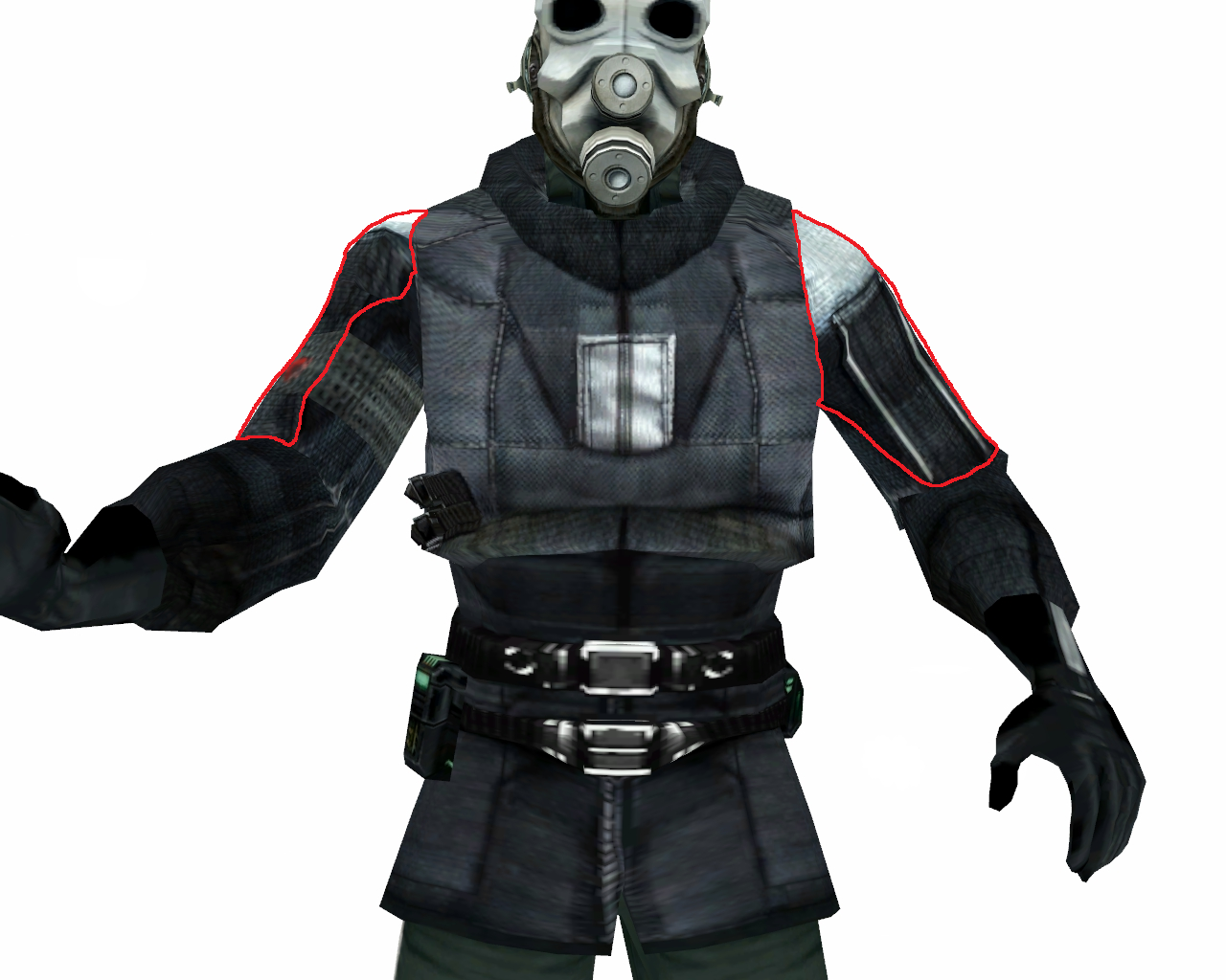

Now that you're speaking about the arms, I'm sure you've looked at the Civil Protection model just as much or more than I have. When looking closely, you'll get the hint that not only does the CP unit have a longer black undercoat and ballistic vest, you'll also notice that he has these 'ballistic shoulder-guards'. Essentially from the shoulder down to the elbow, it's only about halfway covering the outer circumference of his biceps/triceps area.
In my personal opinion, although it's hard to tell because of the low resolution model CP model with the shoulder-guards then when comparing it to rebels with the ballistic vest without the 'shoulder-guards' on the rebels, but it seems that there may be at least two different layers.
Here, let me just use one of your older screenshots and outline it in MS Paint to explain...
So as you can see, if you look closely, you'll notice that the whole arm sleeve isn't one piece. It's actually atleast two pieces or layers. One inner sleeve which is typical to any coat/shirt for example. However from the white shoulder, down the outer bicep/tricep area and to the elbow is a ballistic 'shoulder-guard' or 'arm-guard' so to say.
I wanted to bring this to your attention before you go any further, so you had some additional ideas. Actually now that you made me think of it... I might be going about my own costume abit differently now. I feel it would be easier for you to simply purchase a jacket or coat for example, and then cut/paint/craft the shoulder-guard/arm-guard into place ontop of it to keep your budget low and minimize having to fabricate more than necessary from scratch.
So it's up to you. Just saying that it would be easier to get a simple black BDU jacket, and then stitching on some kind of canvas arm-guards over the shoulders where it is necessary.
Also, I wouldn't beat yourself up too much in regards to the undercoat. Because there seems to be some odd inconsistencies when you look at how it's actually on the model. In some areas it looks like it's by itself. Others it looks like the undercoat AND vest are one piece. But as we all know, the rebels from Half Life salvaged the vest portion, leaving the undercoat behind in their attire.
As always, food for thought...
Yep, the arms definitely have a padded area from around the elbow up. I was thinking I'd cut out a piece of fabric and sew it onto the arms there with some batting in between the two layers to give it that look. I was also going to use reflective piping for those white stripes. Haven't found a good reflective fabric for the shoulders though. For the chest reflector, I'm gonna be using one of those tapes mentioned earlier (I bought the exact same two by coincidence :p).

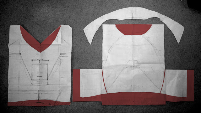

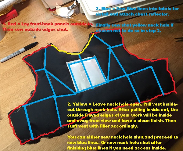

I made this:
It's not perfect or finished, but if I can get the back looking good it'll serve as a decent placeholder until I learn how to actually sew.
Just threw this together quick to help clean up the outside edges. Overall, everything else looks great so far.
I'm no tailor, but I know at least this one important step. Make sure you initially lay the vest flat, with all surfaces outside-in first. The point of this is that after you sew the outside edges together, you pull the vest inside out.
What does this do? This takes all the extra material and frayed edges and pulls them inside of the vest. This leaves a clean finished appearance,. because all the unsightly frayed edges go inside the vest and out of view. Trust me, when you do it, you'll feel 100 times better that you did. This is the same technique that's used to sew pillows shut.
Don't believe me? Go look at a throw pillow if you have one on your couch. You'll see that about 90% of the pillow has clean uniform edges, however there must always be that small 10% spot which is used to pull the pillow inside out and stuffed. This small 10% spot is unavoidable, but if you're clean with your work, it'll be barely noticeable.
I have suggested that you leave that small 10% spot open by the neck. Why? Because you'll be sewing your neck collar there anyways and it'll be mostly used to meet those two edges together and will be out of sight.
Food for thought as always. All the same, great work! You got the idea.
