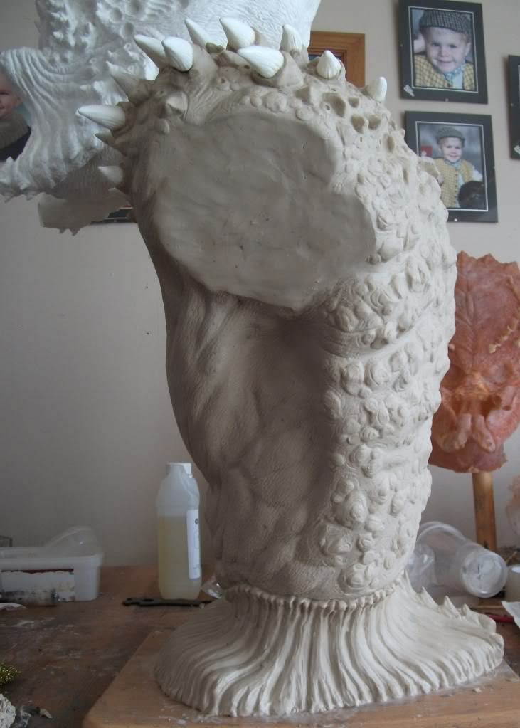

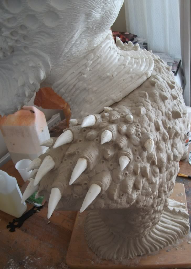

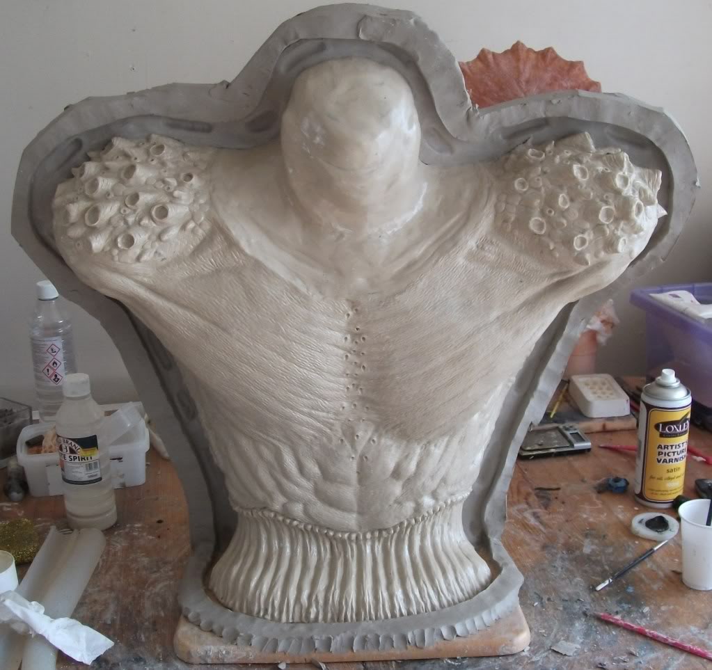

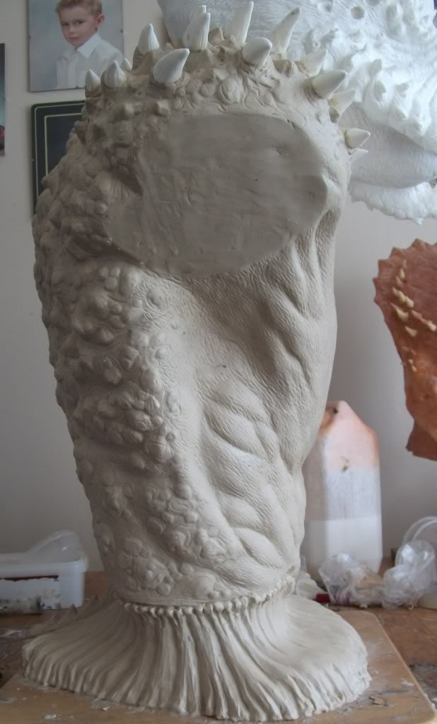

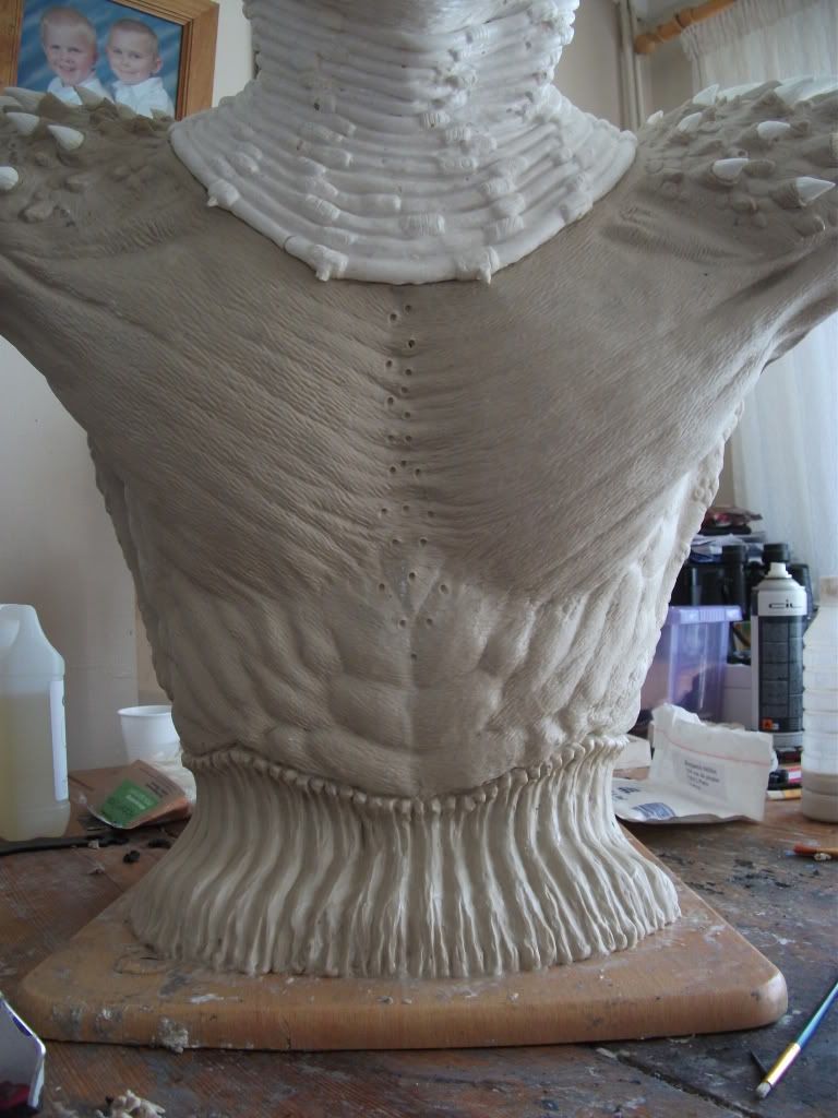

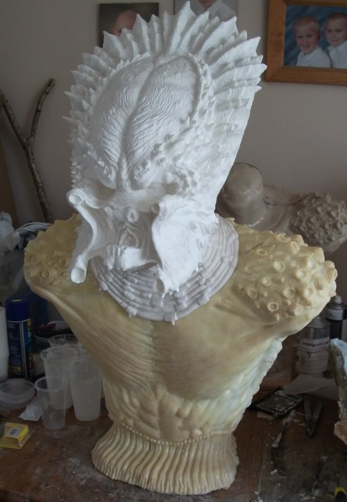

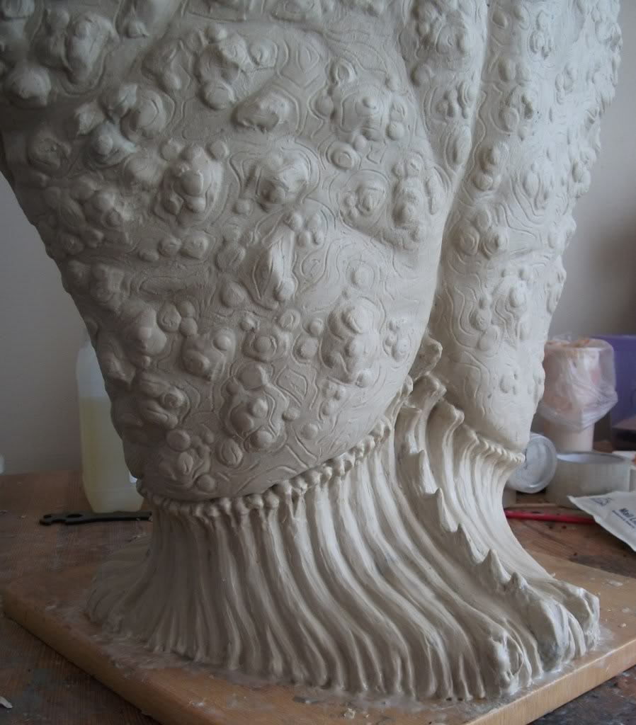

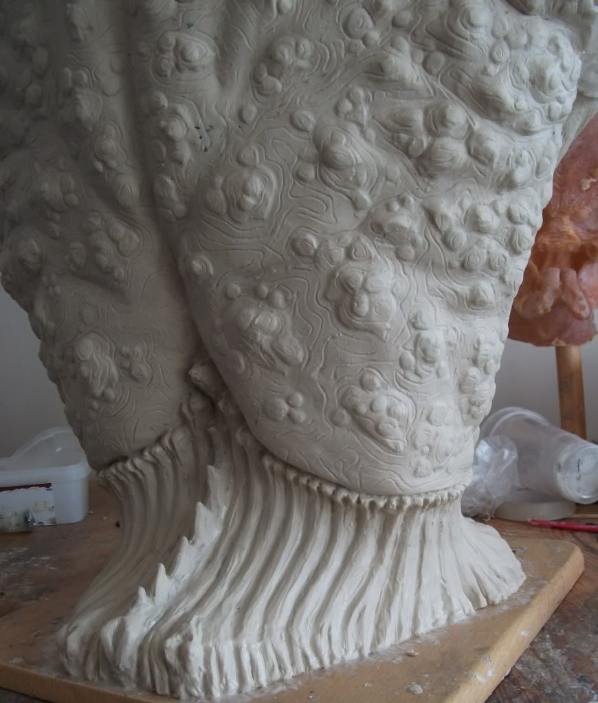

Alost finished now, have done something with the base, blended some more and added quill holes
Cheers

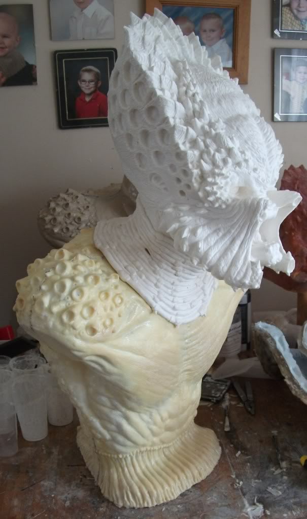

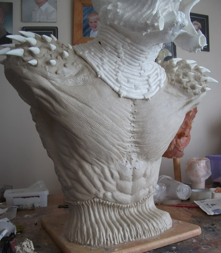

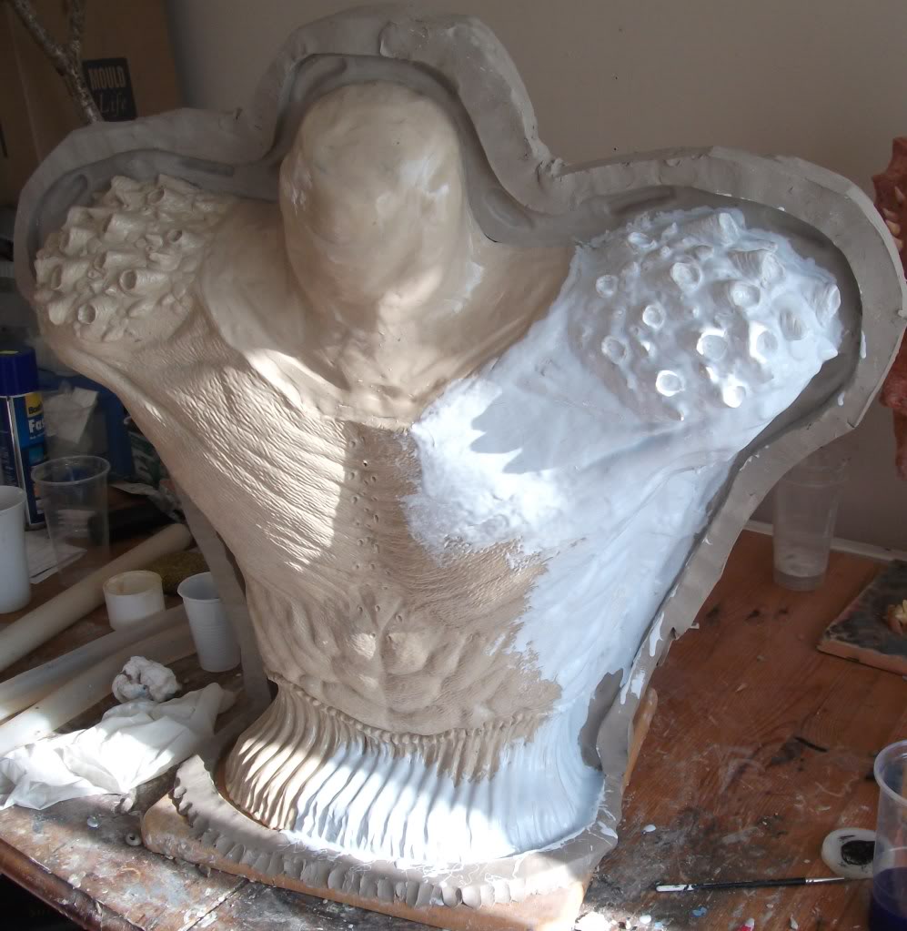

I got the moulding done and the first cast is out.
I took as many pics as I could during the moulding process so you can see how I did it but there are a couple of gaps (as you will see) as sometimes I am in no position to take pics I'm afraid.
First of all, I removed the shoulder spikes, mainly to save on silicone as the silicone in those areas would have to be much thicker but also as it will give me more customization options later on. I will be able to change the horns if I want to.
Also, if I sculpt any armour, I will be able to leave the horns out.

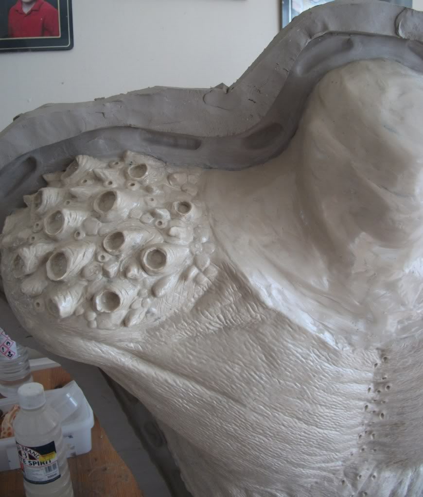

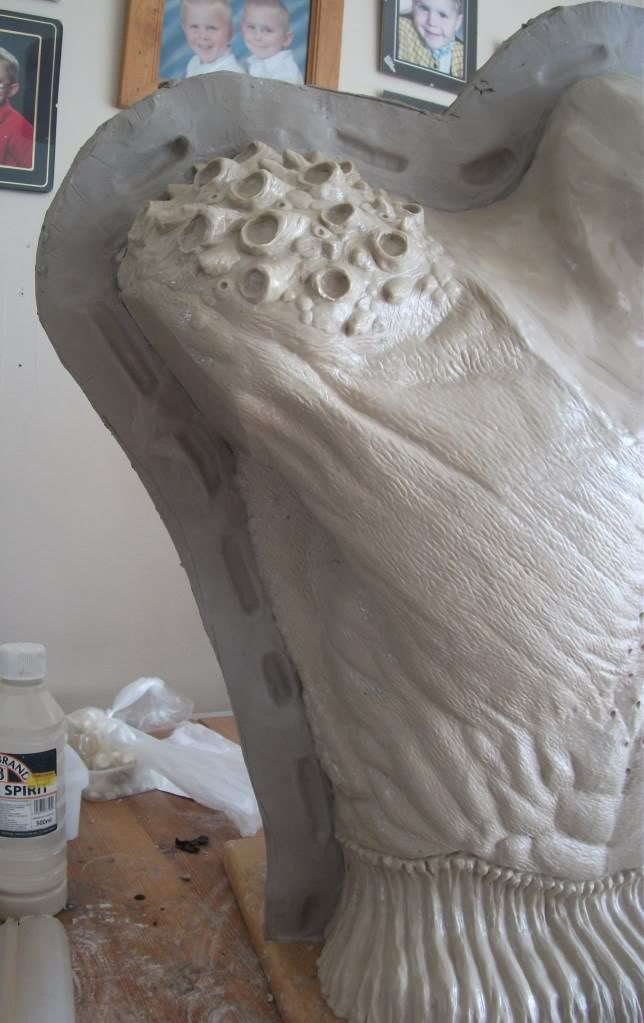

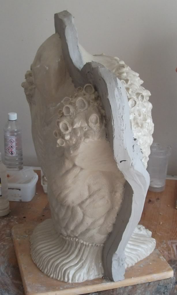

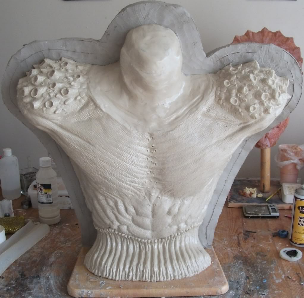

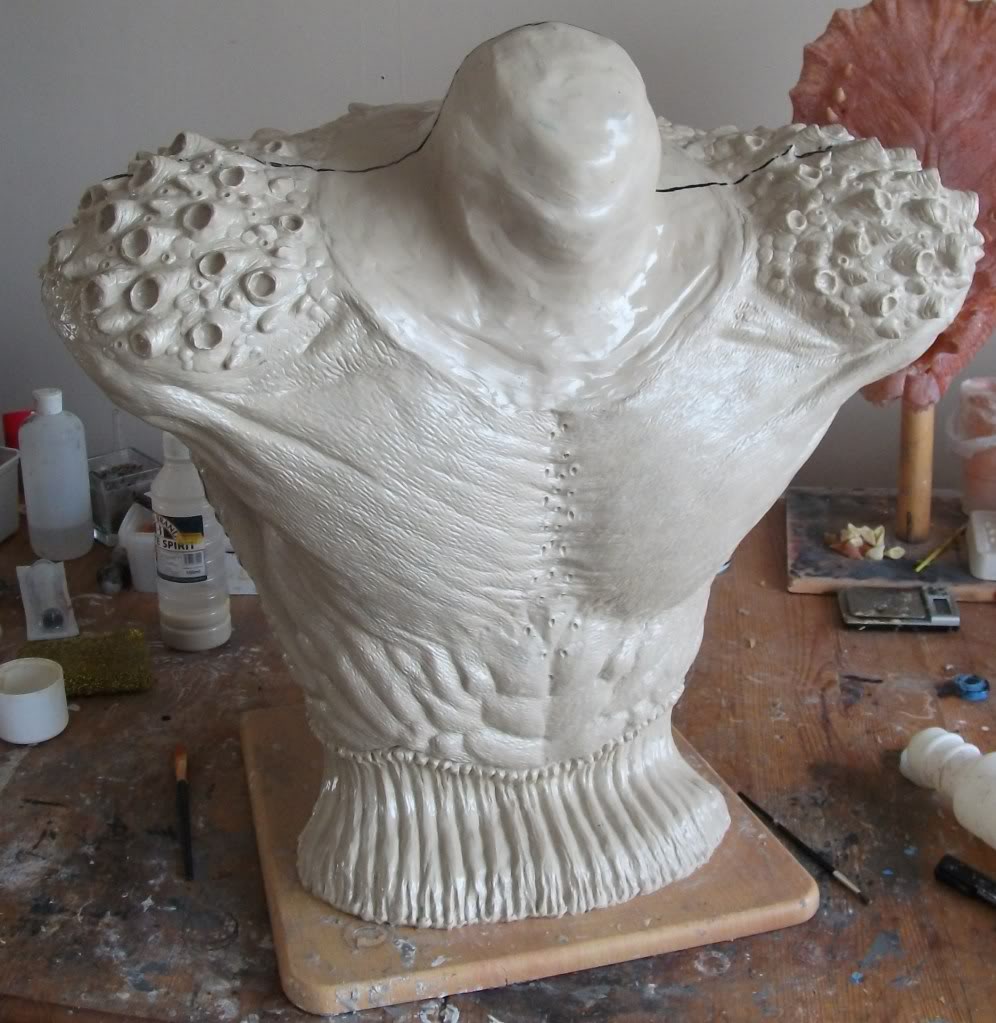

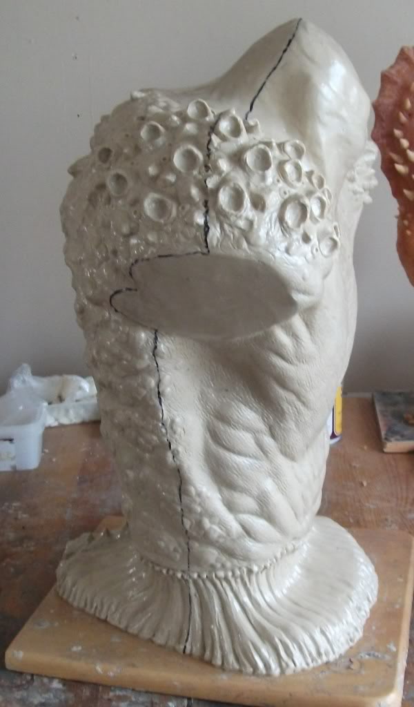

I then drew a line with a black marker

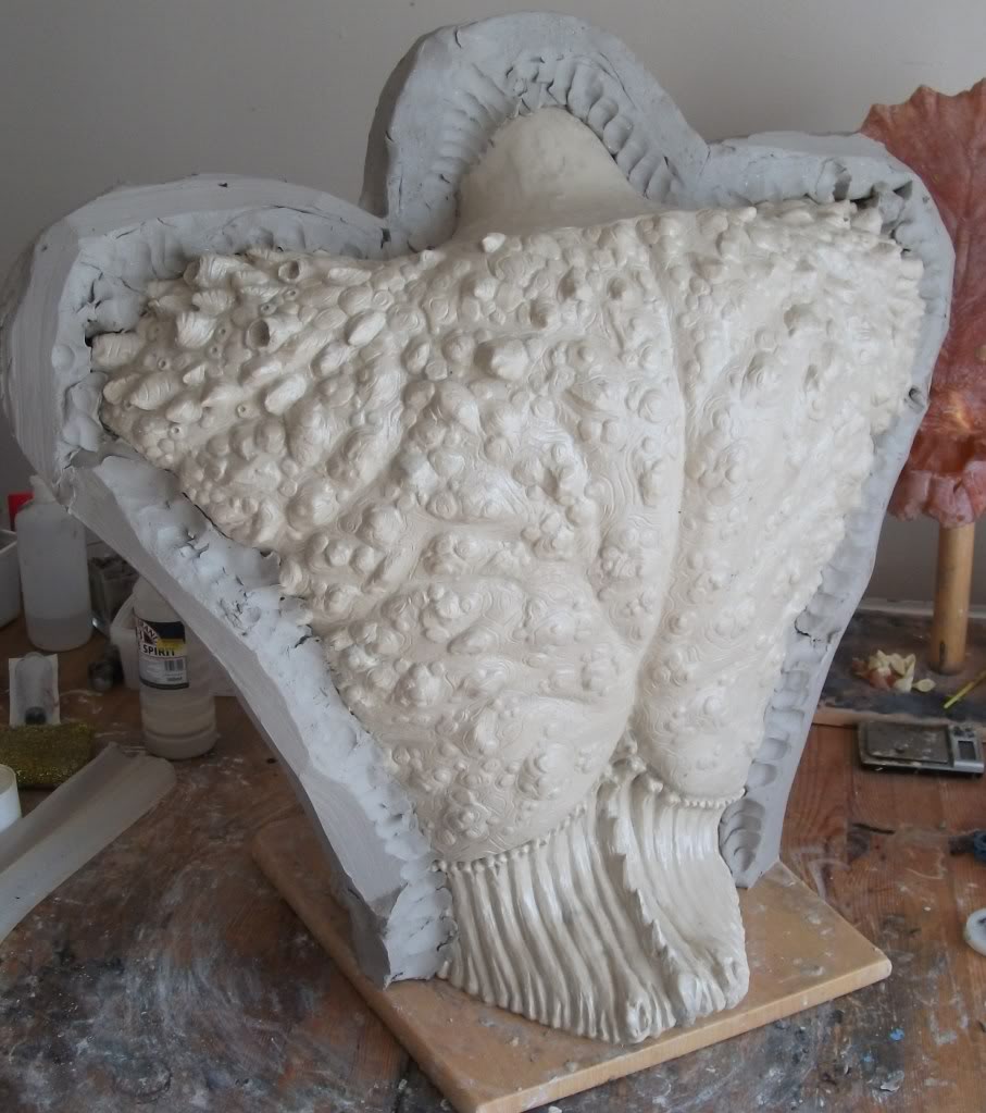

I then started to add the wed clay dividing walls
Then I made some key points
Then I added a containment barrier

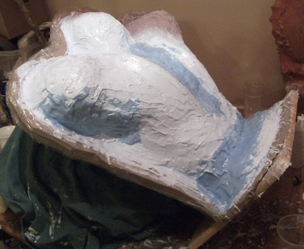

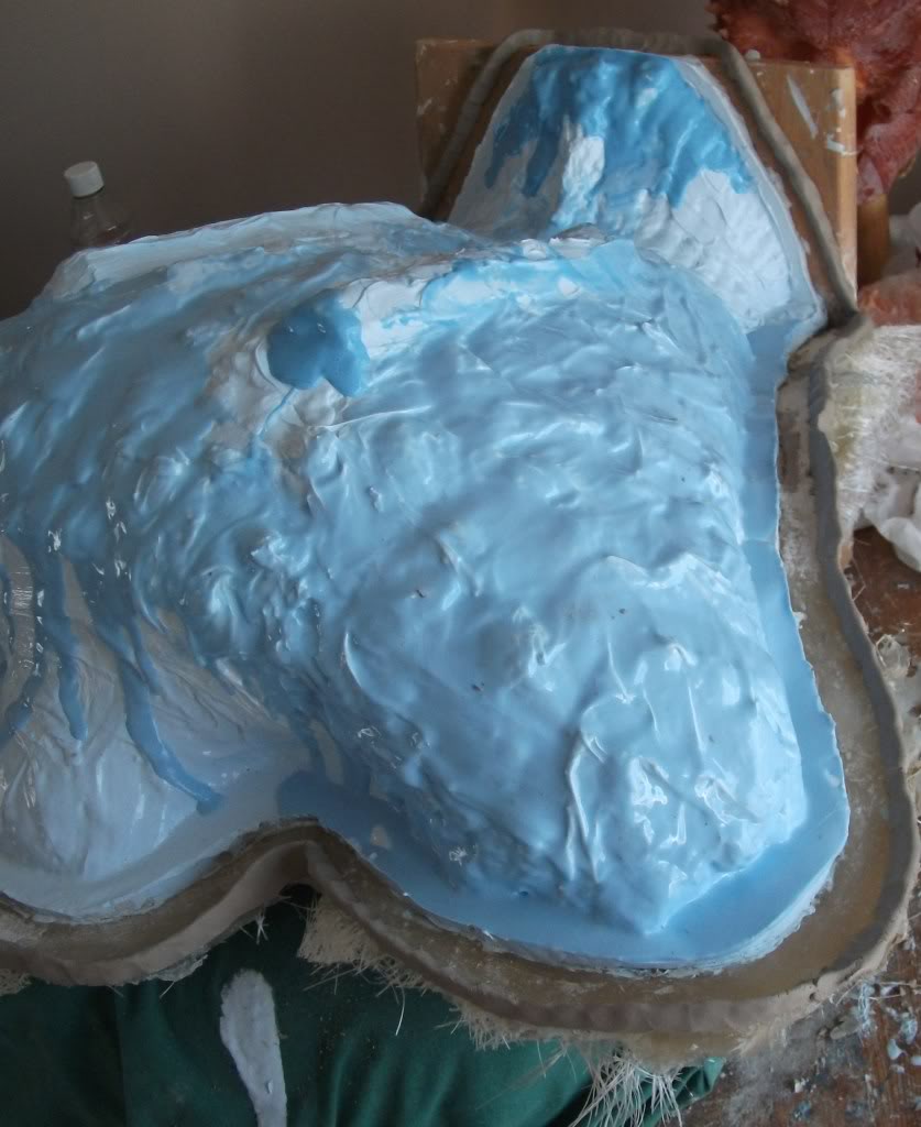

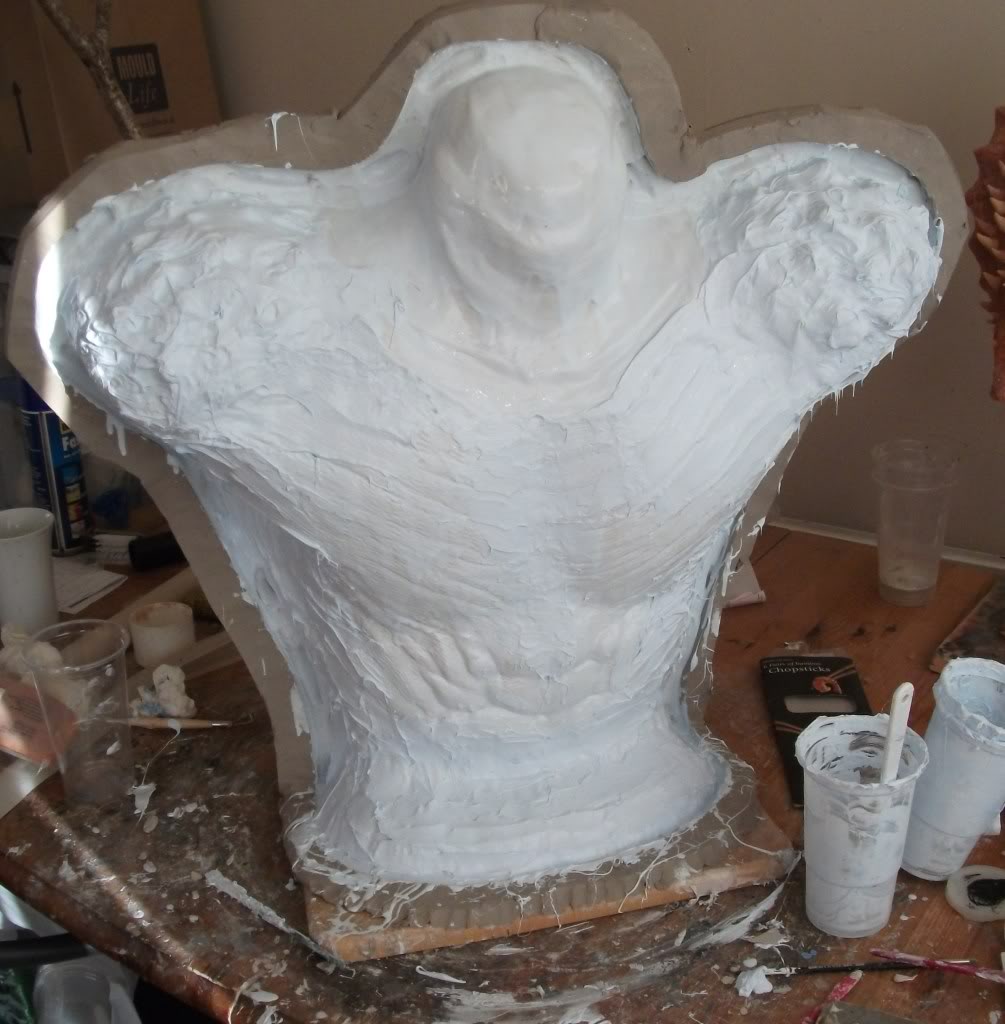

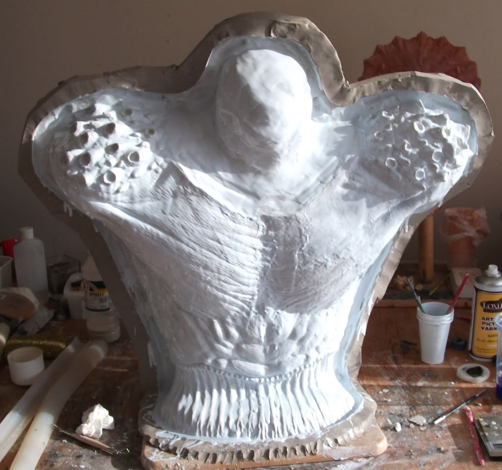

Then I painted on a detail coat of silicone with a very small paintbrush making sure I got all the nooks and crannies.
I then added some thixo to the mix and added a few more layers
This is where there are some images missing

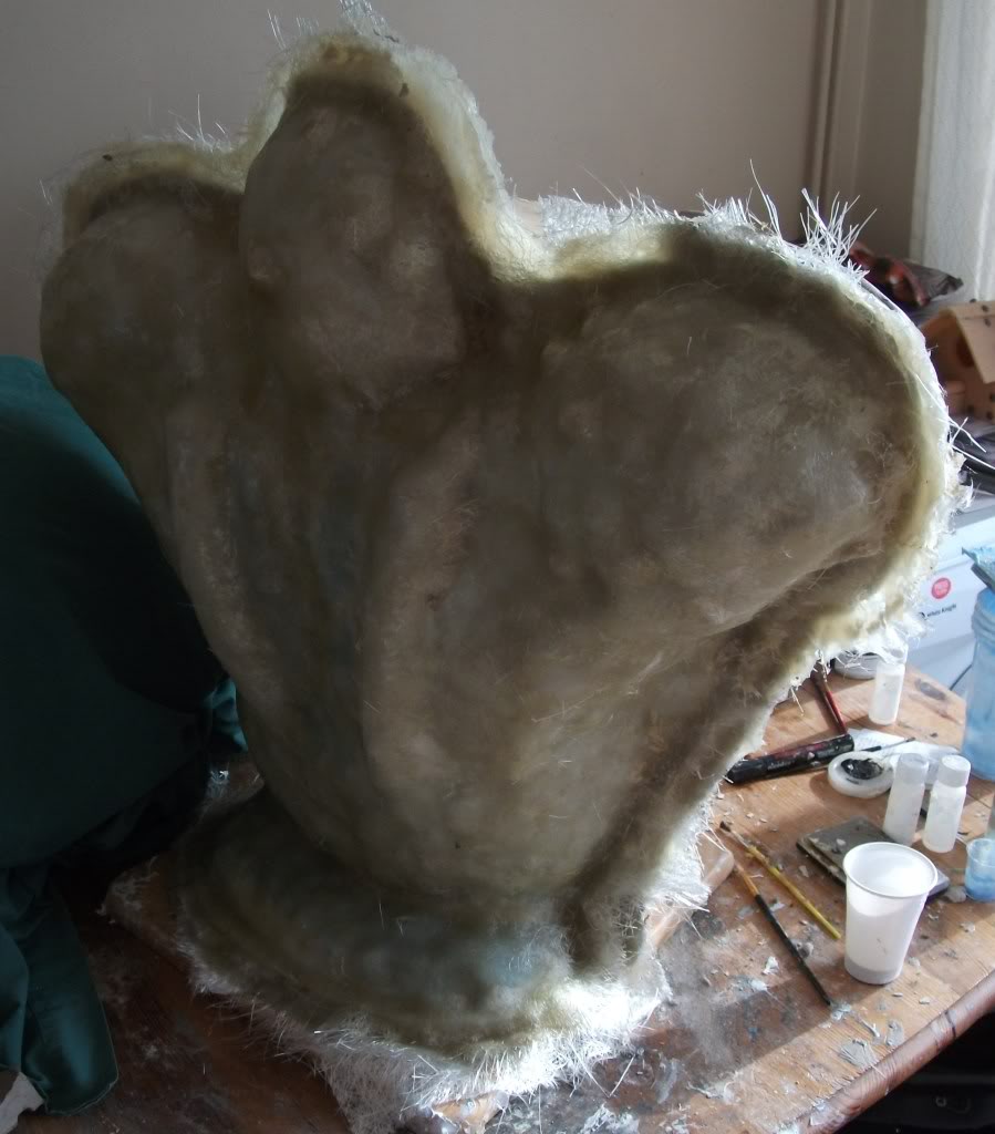

Basicaly, I removed the containment barrier put in place for the silicone and fibreglassed the whole thing as the mother/jacket mould

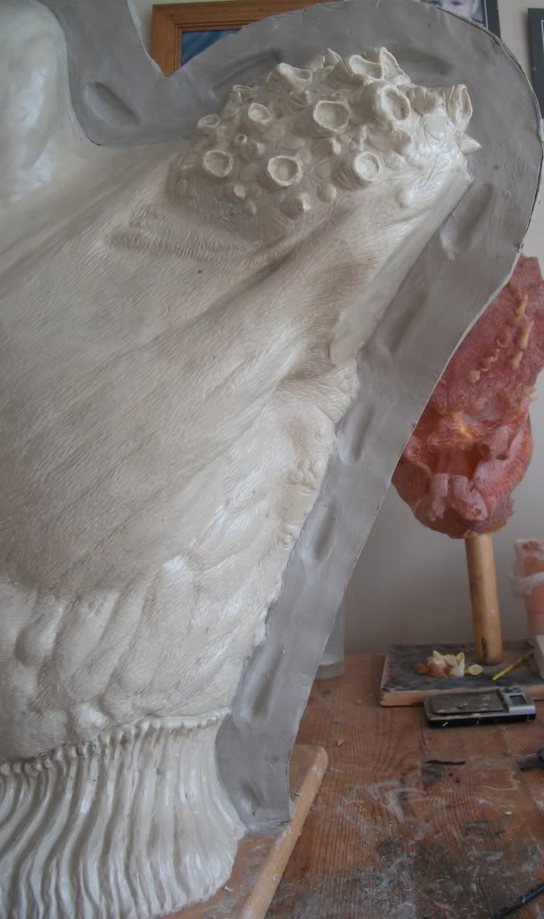

removed the dividing walls alltogether and put a new containment barrier for the silicone over the now fibreglass divider

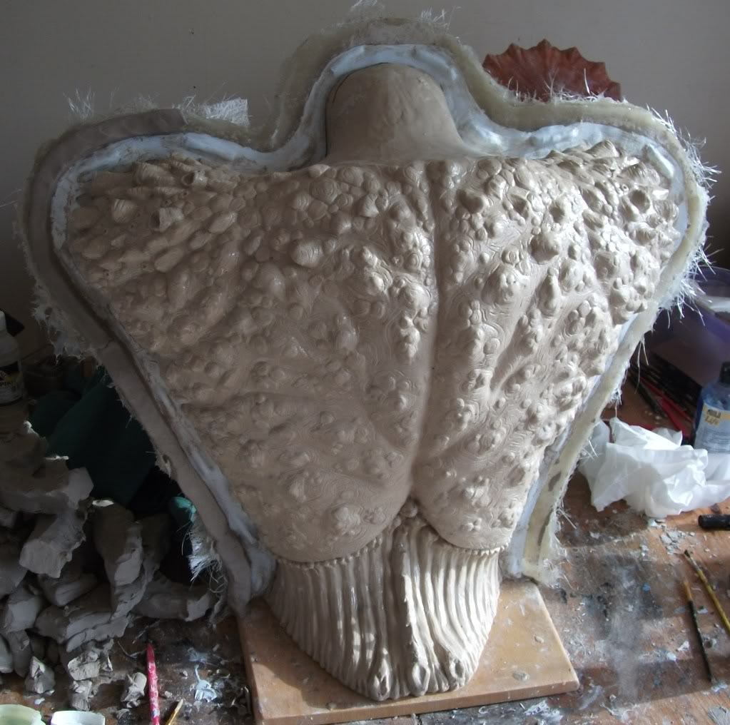

then repeated the process for the back

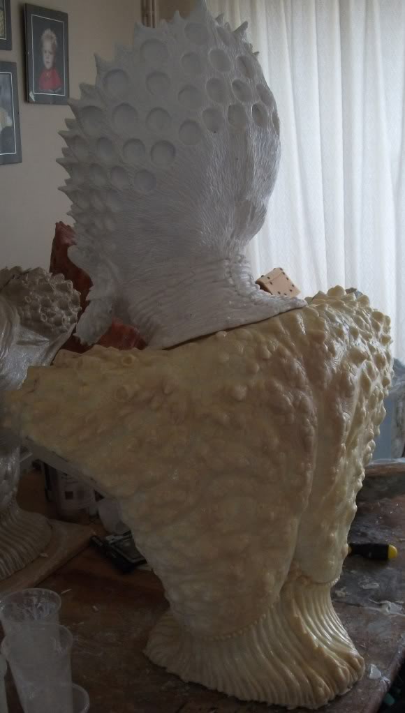

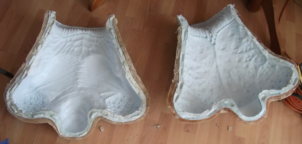

and heres the finished mould

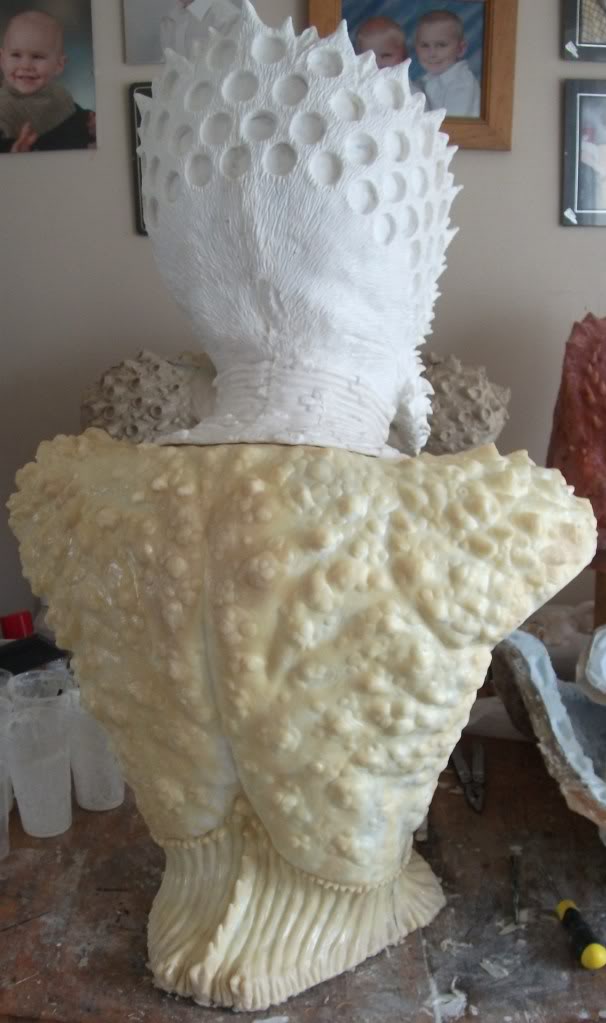

and heres the first cast
Cant wait to get stuck in with some paint!

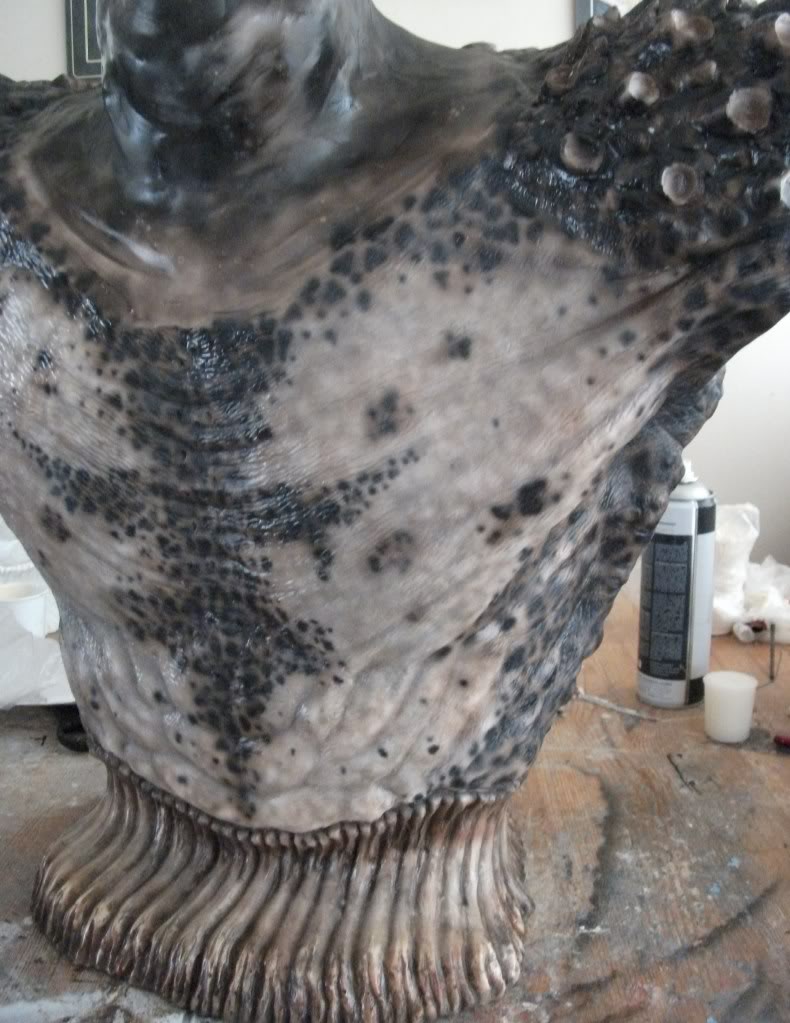

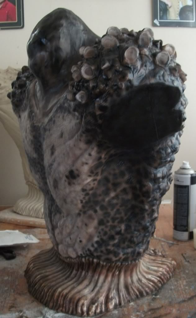

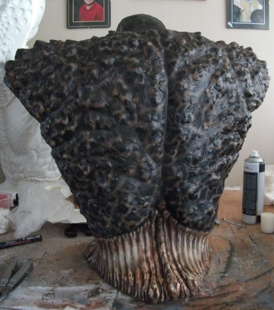

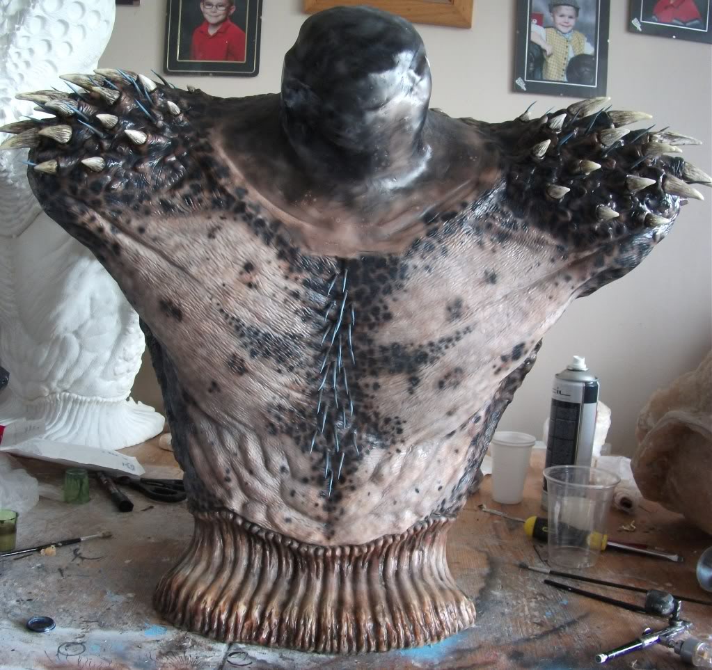

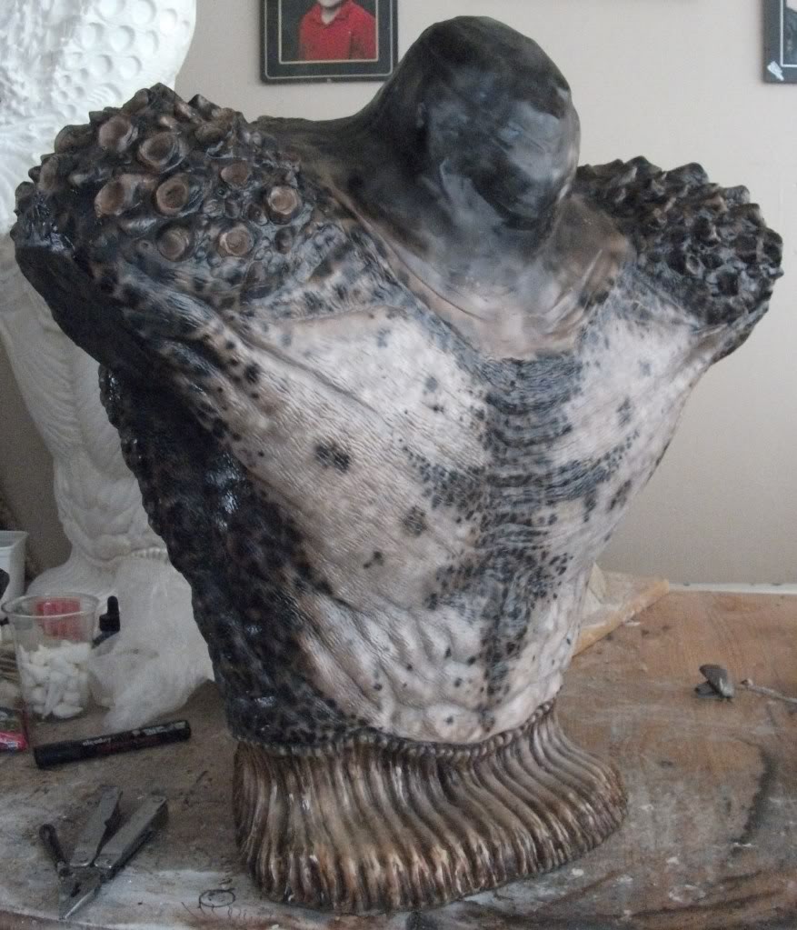

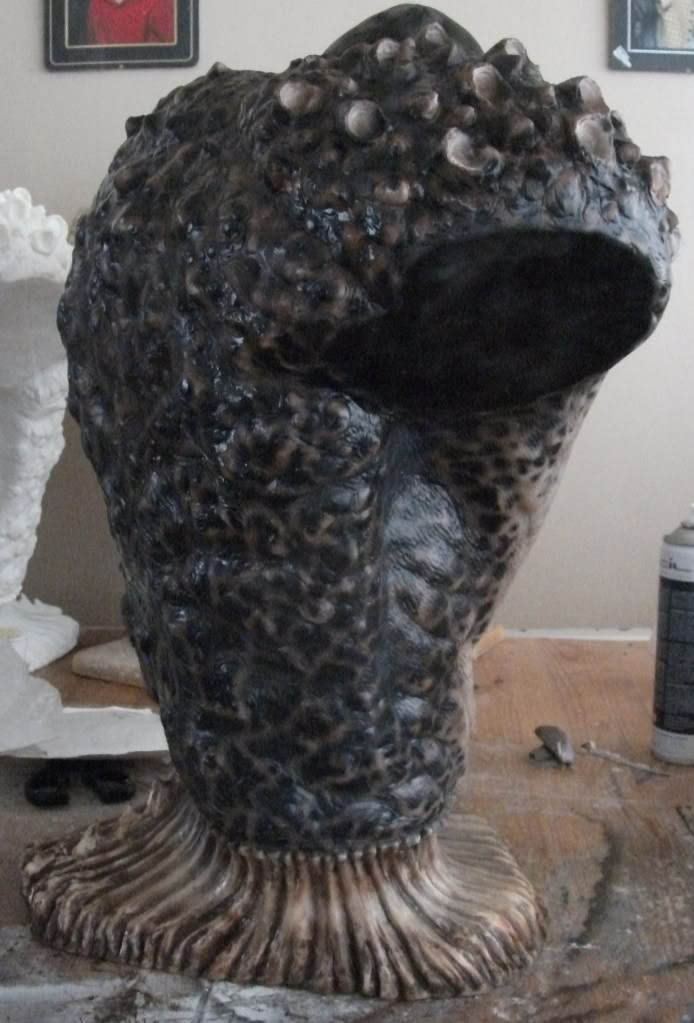

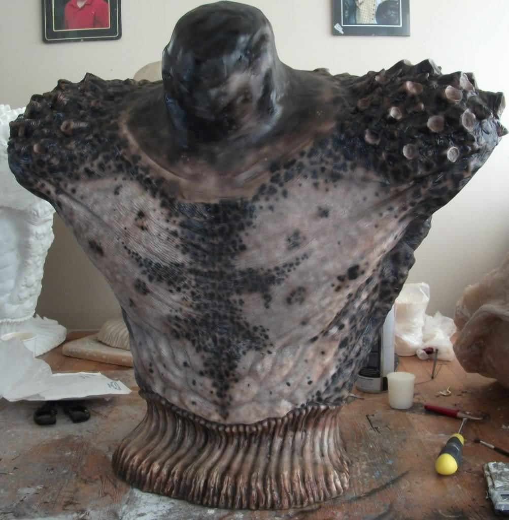

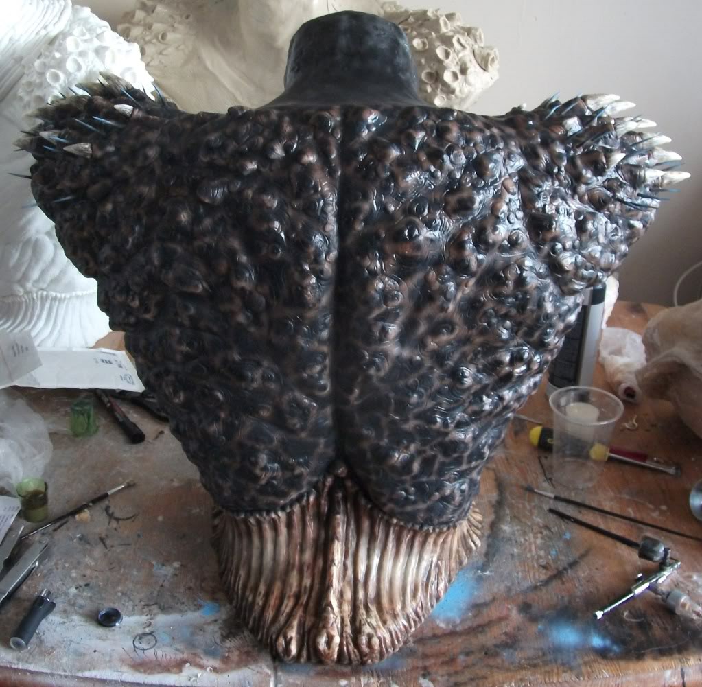

well I finaly got around to slinging some paint on him lol
Still got to do the horns and quills but it's basically finished.
Hopefully i'll be able to finish him off and reunite it with the head soon.
I'll post some pics tommorrow with the horns and quills done.
Cheers
Cheers fellas.....@ Colm...I plan on making a skin once I get a workshop.....which is taking much longer than I would like lol.

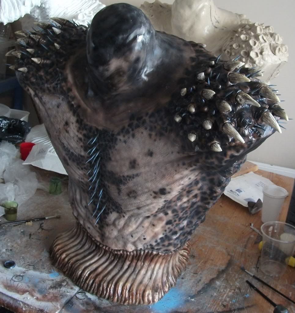

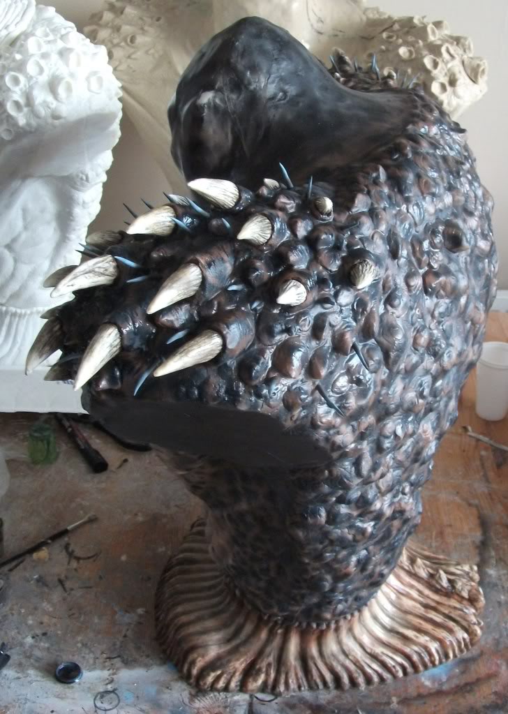

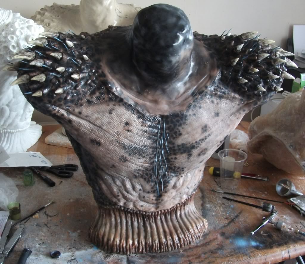

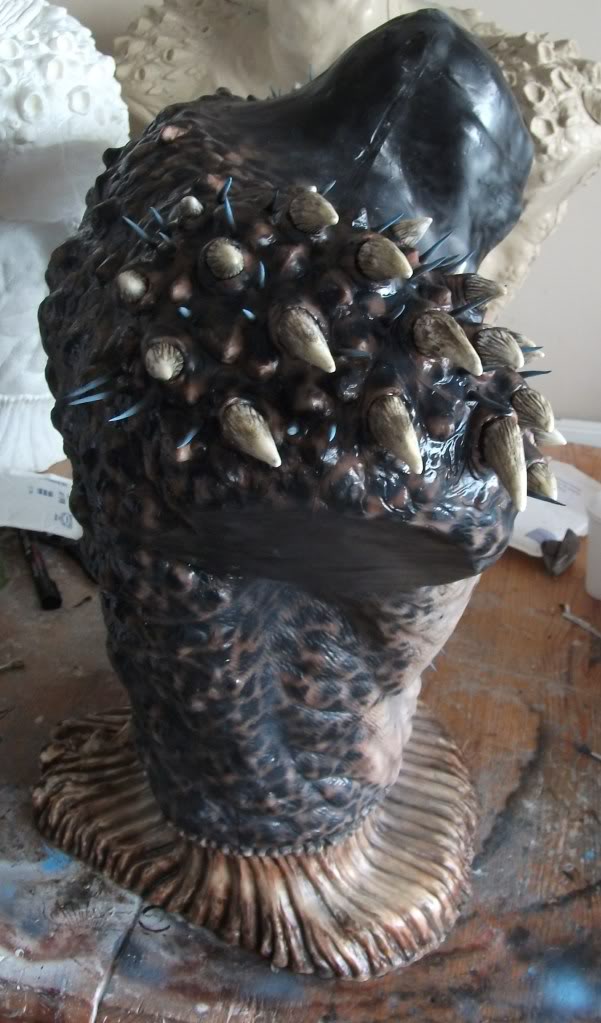

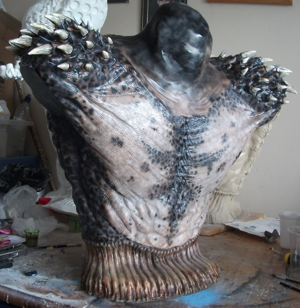

Heres pics with horns and quills added
Should have some pics with a head on it at the weekend.
Cheers again
