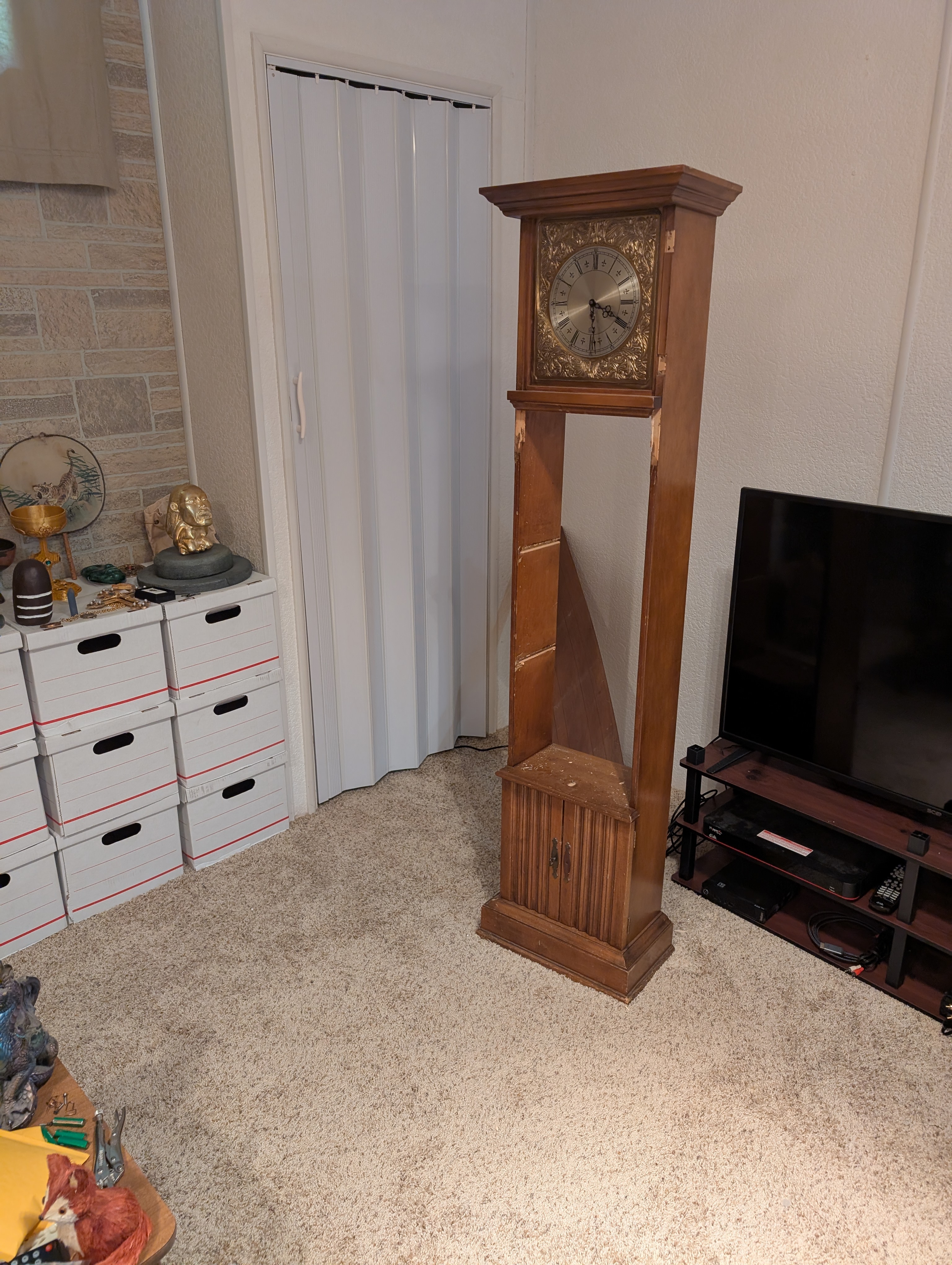

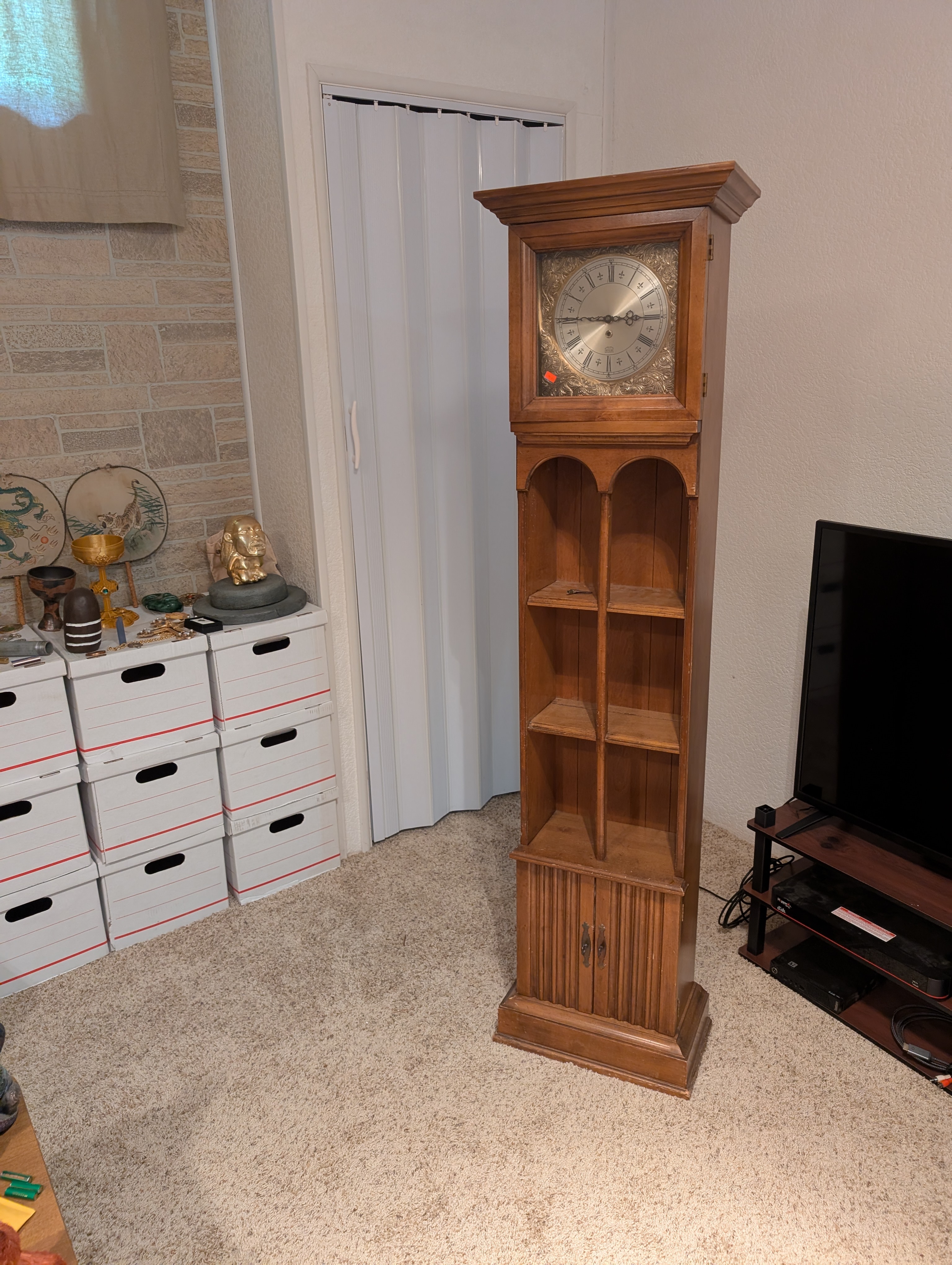

I will be making (over some time, not a quick build) a Haunted Clock inspired by the Haunted Mansion.
I am starting with a real Grandfather clock, so I'm not just printing a massive build on my printer.
I will print the accent pieces and the bottom base to add to the existing clock. I'll print a glow-in-the-dark face with the correct 13 hour design.
I plan on using an Arduino to creatively do 25 hours, instead of 24. This is intricate since having it point to the correct hours and minutes will not be in the same place as a 24 hour clock. It will have special sounds at 13 o'clock. Midnight. I plan to have an audio on/off switch so it's not just maniacally laughing every night at midnight.
My clock will be a bit different, as I'm keeping certain components from the original clock.
