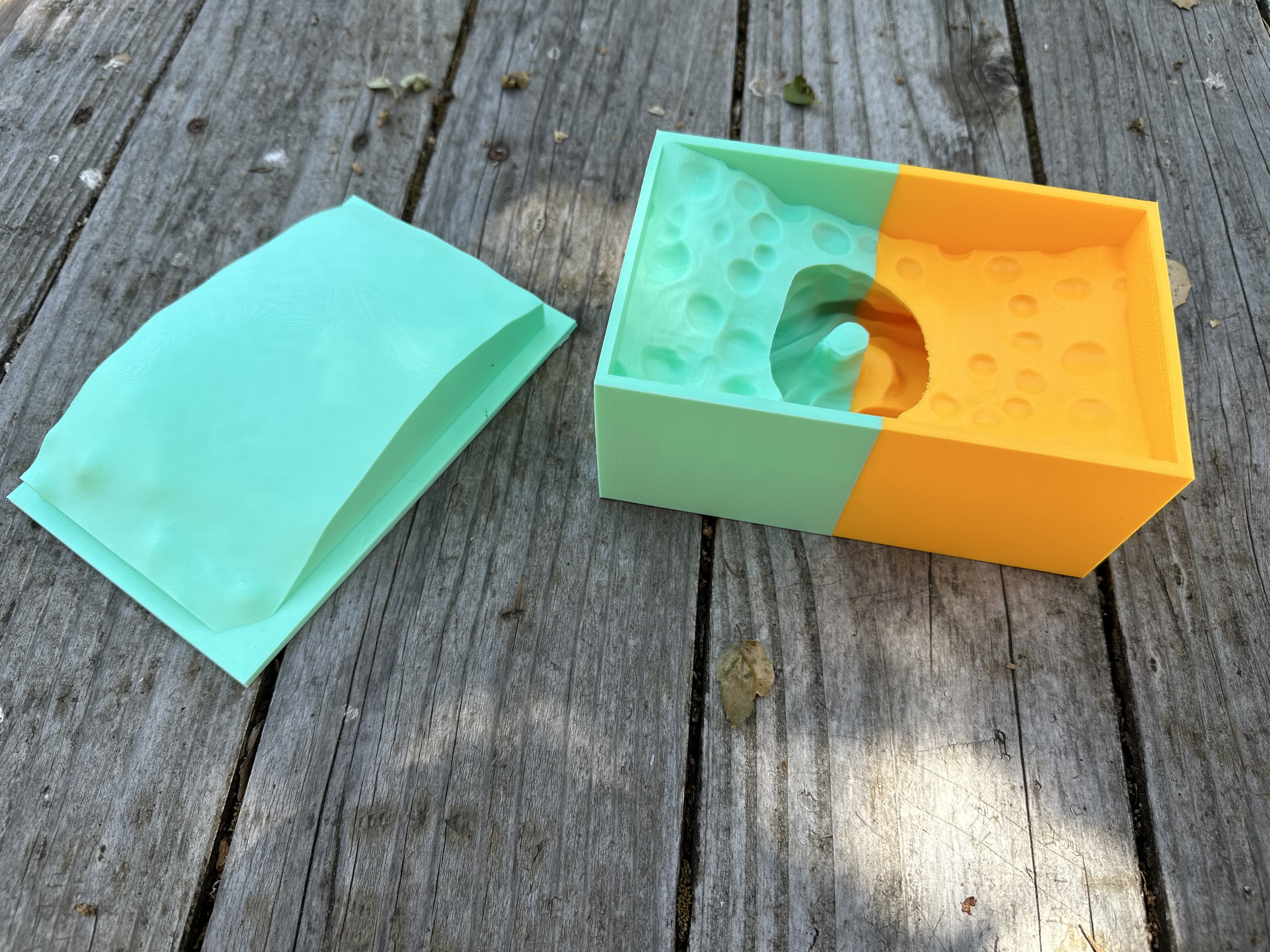

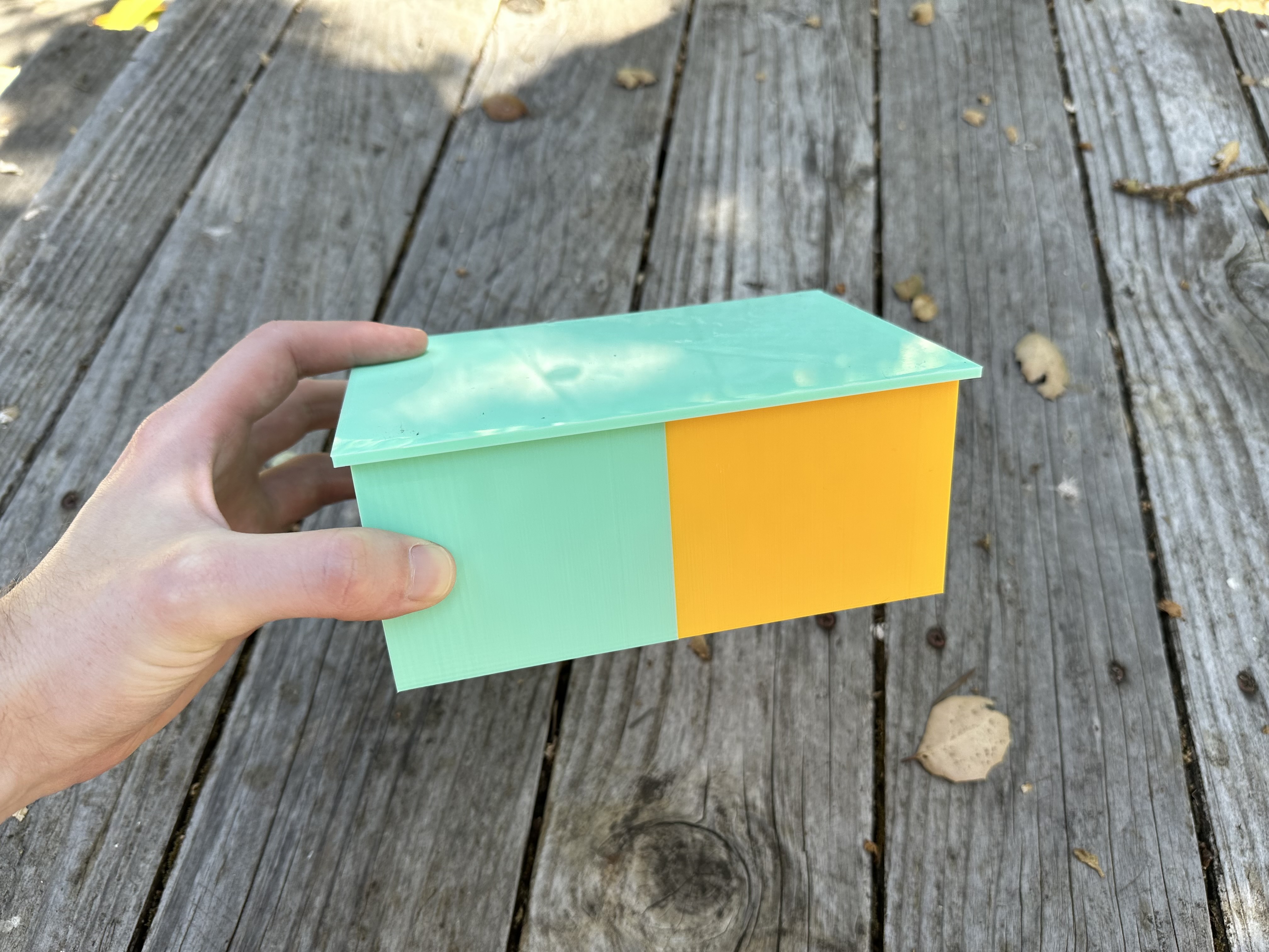

The test actually went really smoothly. There was no issue with mechanical lock despite the print lines. What do you guys think about the material choice? Does it look like it would be good for the whole mask?
Fantastic! I think that is a good consistency, but it's your mask, so what do you think? I really like the frills. How does the surface look? Do the print lines detract from the detail in the silicone skin? Silicone seems to pick up every detail!
I would suggest printing another mold section with one of the antennas and see if that can be pulled out or whether you will need a parting line. I expect it to be fine, but worth checking.
I would also tint/color the next silicone test. Getting the color right took me some practice. I use Silc Pig from Smooth-On, but there are other options. It just takes a small amount of color.
I plan to print my first test mold this weekend for a project. Seeing your success really gives me hope!

I never actually ended up using it. I took a little break on the project, then I realized that mold wouldn't be a very good test of how the actual mold will be set up, and would be a waste of a lot of silicone. So I'm doing another small test, but with an SLA resin mold this time and a TPU core.
The reason for the TPU core is because I realized I had created some self-trapping geometry in the mold design to allow space for the servos in the antennae. Printing part of the core in TPU allows it to flex in and out of the cavity, but I don't know if it'll inhibit the silicone. Printing with TPU was surprisingly easy, and you can see in this little proof of concept how easily it springs back into shape after flexing.
Anyway, to answer your question, I was pretty happy with my first proof of concept for a 3D printed mold (the blue box). Zbrush's booleans have been my guardian angel on this project because they're so reliable, even with insanely complex geometry. I'd say go for it and post the results.
