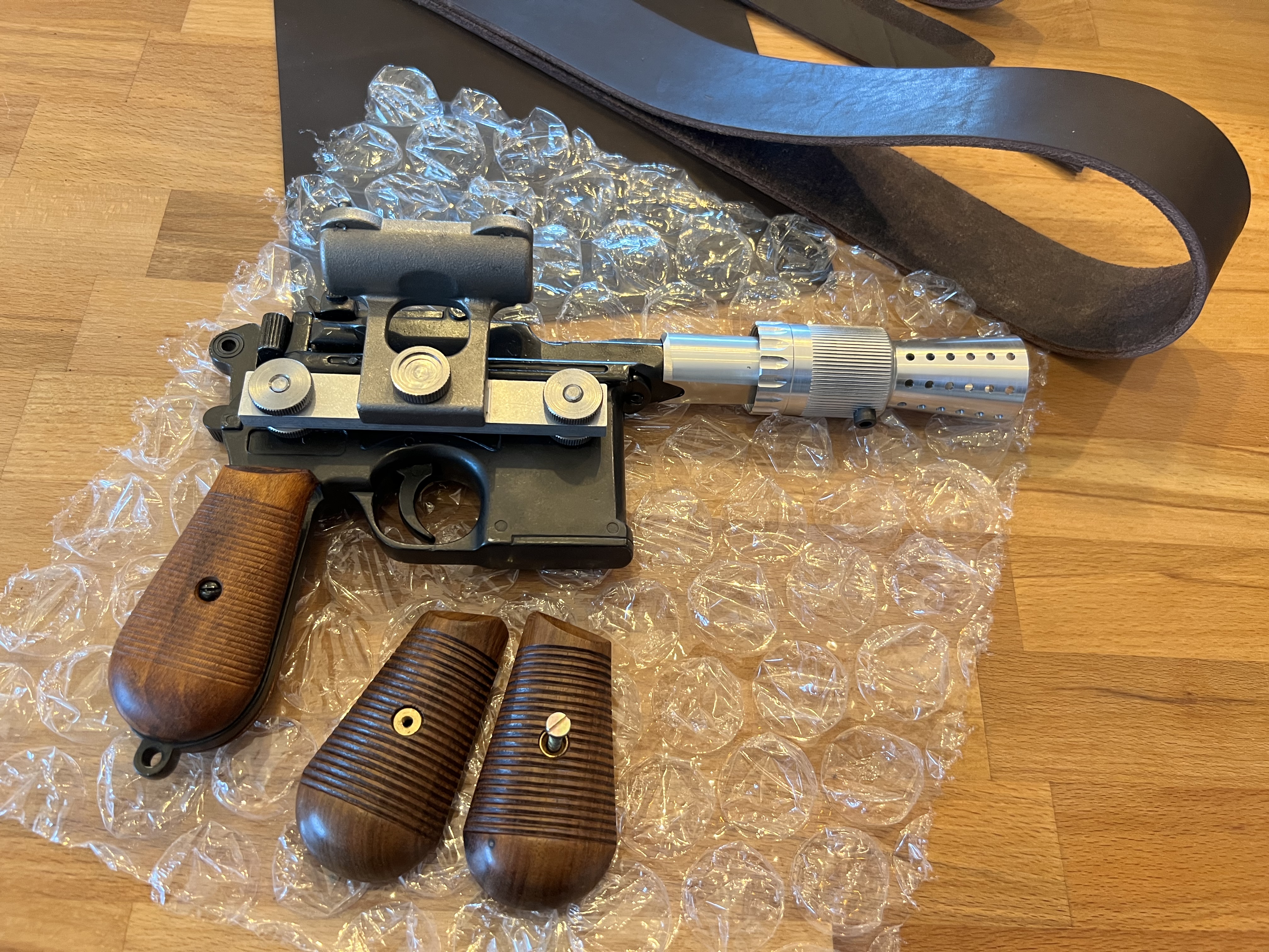

After some research and printing a blaster with my 3D-Printer I bought a Set from Blaster Factory. I think it’s the best for the buck. The package arrived today. Fastest shipping from the US ever. A week before I got a call from FEDex, about my package and that I‘m not allowed to ship weapons of mass destruction from the US to Germany. The hole ghostbusters proton gun Desaster again ;)
Important the customs “HS Code: 95030081 - Spielzeugwaffen” for importing that kind of thing into Germany. The officers will open the package.
Here the half assembled Blaster with real wooden replica grip shells for a Mauser C96 and some leather strips for the holster, from EBay.
It’s a Denix Mauser full metal replica pistol with good weight and wooden grips from Spain. Buying the pistol from Spain directly and the parts separate isn’t cheaper, I had to find out and the Blaster came mostly assembled.
First step, changing the grips… isn’t so easy :) The Denix construction differs here from the original. But the size is the same. I was nervous, because I read the Denix is smaller then an original Mauser, but not the grips! I have to grind of the thing in the middle and drill a hole for the “real” screw. I will also define the lanyard ring eye more with a file (picture of a real one).
Will look nice:
I think I will put the Denix grips on my 3D printed blaster and give it away.
For the next steps with the blaster I will mostly follow Boba Debt description: “Denix Mauser Accurizing Services for ALL Blaster Versions” Link but I will do it myself and skip the magazine details for example all together.
The “milling marks“ I think I will do just with my drill press. Will look accurate to a real Mauser, wich are really badly milled.

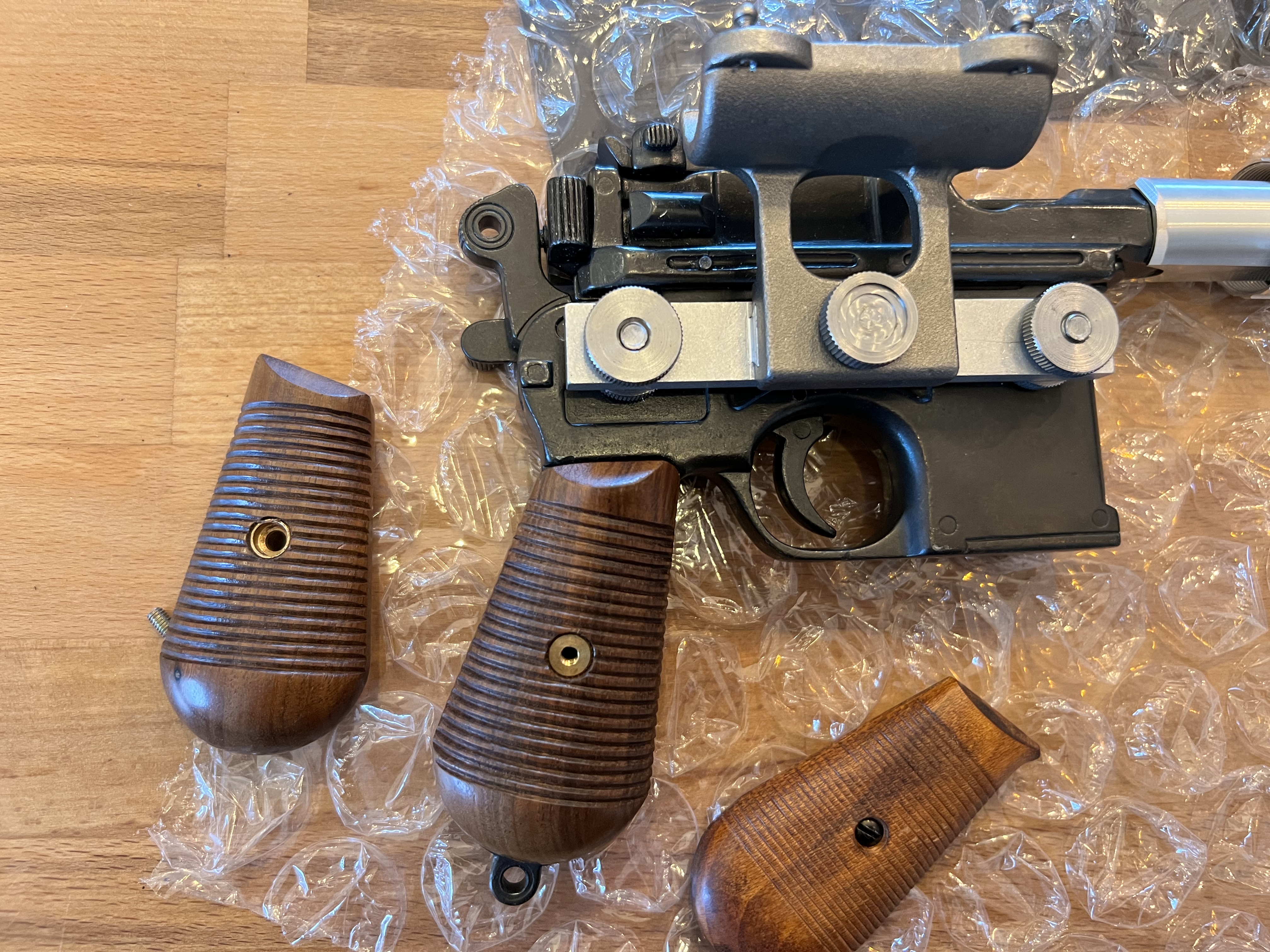

Little update on: How to put real Mauser grips on a Denix C96 replika
I got “real” replika grips for a Mauser C96 for my Denix and after some little work it looks way better then the one’s coming with the Denix.
Don’t cut the middle grip thing out entirely like on a real Mauser C96. The Denix is just made from pot metal, not steel or iron. It needs every bit of reinforcement it can get.
The grips will not fit. I used a japanese saw and a small chisel for laying it in. It wasn’t so hard.
The former metal stud in the middle I cut down with a countersink and I just used a small metal file for the rest. Then a drill for making the hole bigger.

I was looking at the real movie blasters and the grips are different from mine. So I filed my walnut grips down a little bit and put some nice furniture wax on them and started the paintjob.
I own a little CNC. But I found a better way for having these milling marks on the side.
Just use a zylinder carbide rotary burr on this soft Denix replica’s.
