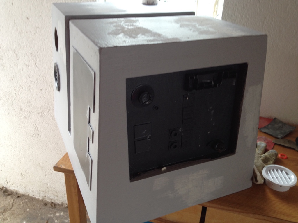

Looking good :) getting near the end now.

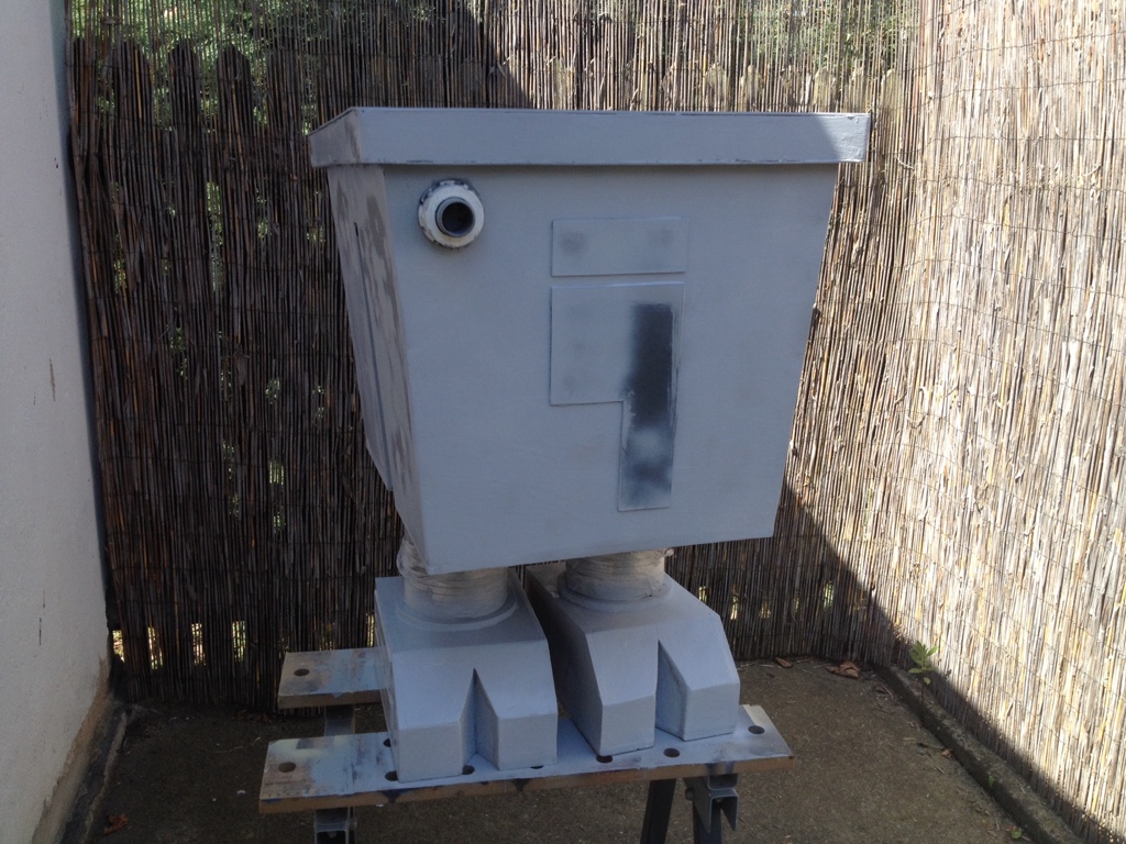

if you want it to look nice and clean then you will have to grain fill with a wood filler, it would be much quicker than multiple primer layers. That's why mine is very very distressed.
It tipping backwards isn't a problem if it's against a wall, but again that's why mine has the little stabilers at the back. Gonk.
Yes, just the colour is missing. I will see, how will it look when I sand it. It's not tipping that much so it won't be a problem.

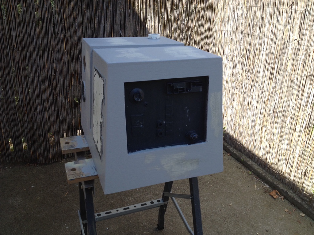

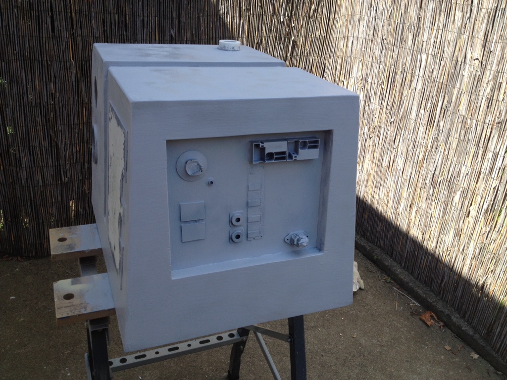

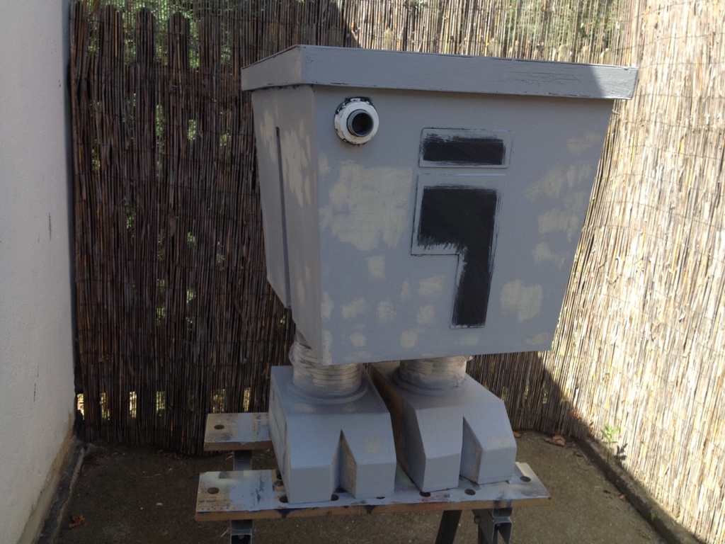

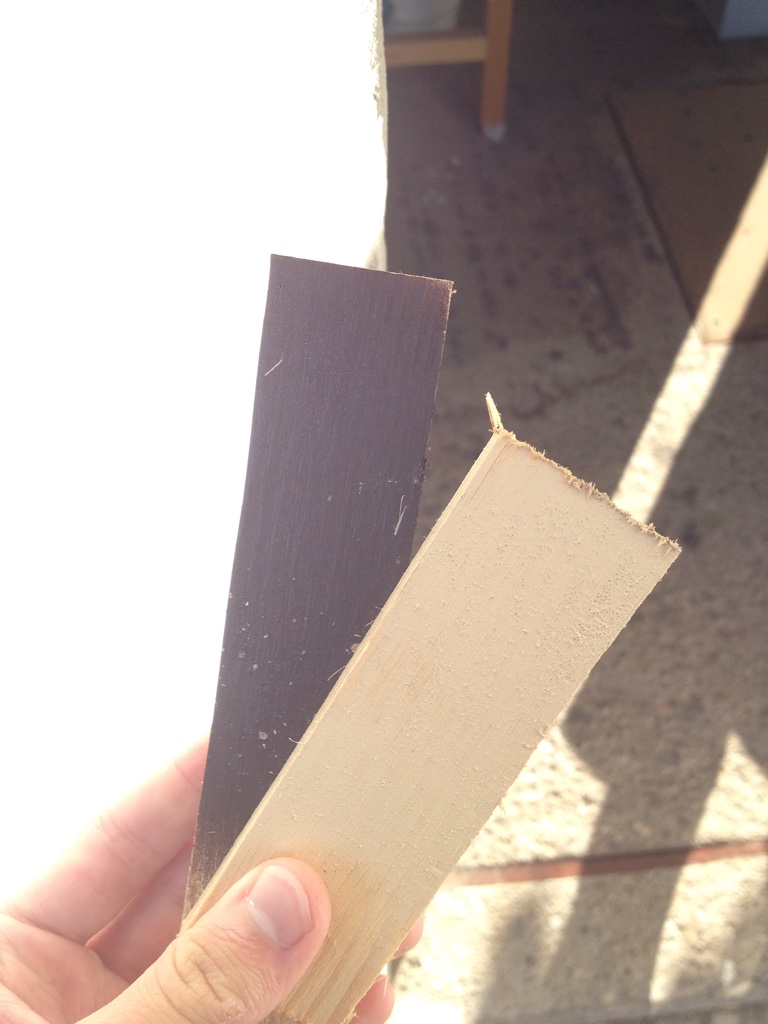

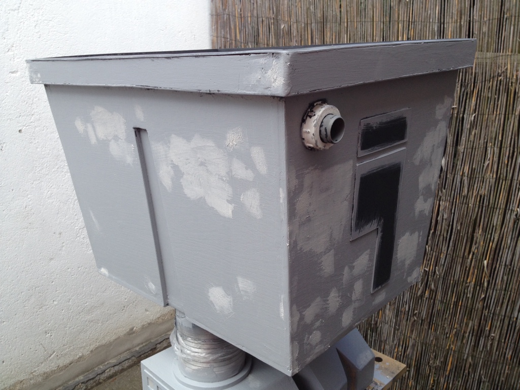

So the enamel didn't do what I expected and the grain is still visible. So, like spacebob wrote, I put bondo on the parts, where the grain could be clearly seen.
I will see, how does it look after sanding and probably incorporate it into the weathering...
So the enamel didn't do what I expected and the grain is still visible. So, like @spacebob wrote, I put bondo on the parts, where the grain could be clearly seen.
looking at the last picture i think you can pull it off with that texture. weather the heck out of it and i think that texture is going to help make it look old and beat up. i personally like the last 2 pictures
That is probably what I will do. I just bondoed the parts which screamed that they're wood. After sanding I will paint it and use the grain in weathering... Why make life more difficult? ;)

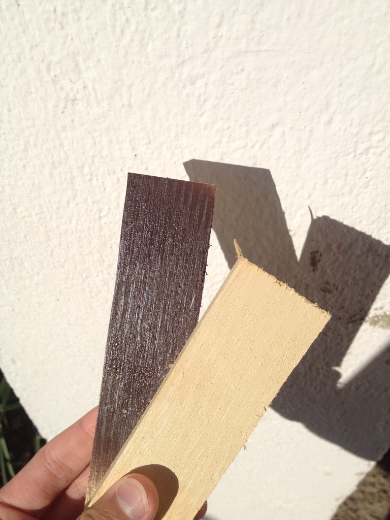

How about a couple of good thick layers of the lighter colour, then a thin layer of the darker colour. Then you can gently sand through the top coat till you get a good mix of the two, and free instant weathering at the same time if you go a little harsher on the edges/corners.
Always works for me :)
So jealous of this build. I've been wanting to start my own Gonk build but have been so busy with other projects that I haven't had the time to start.
I will definitely try it! Thanks :)

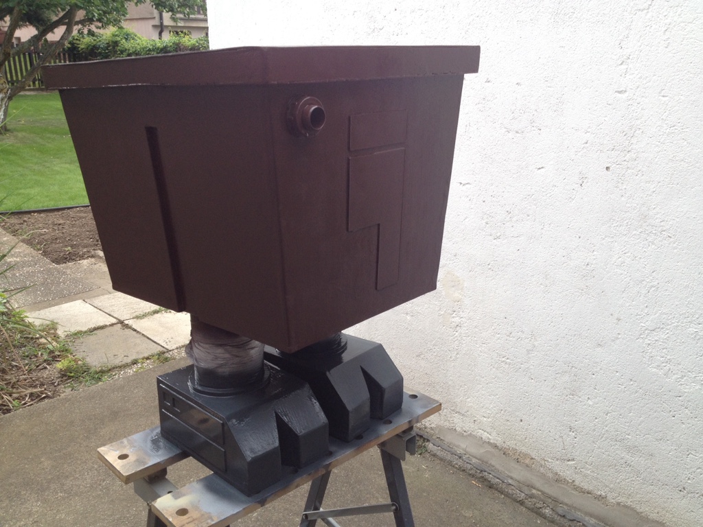

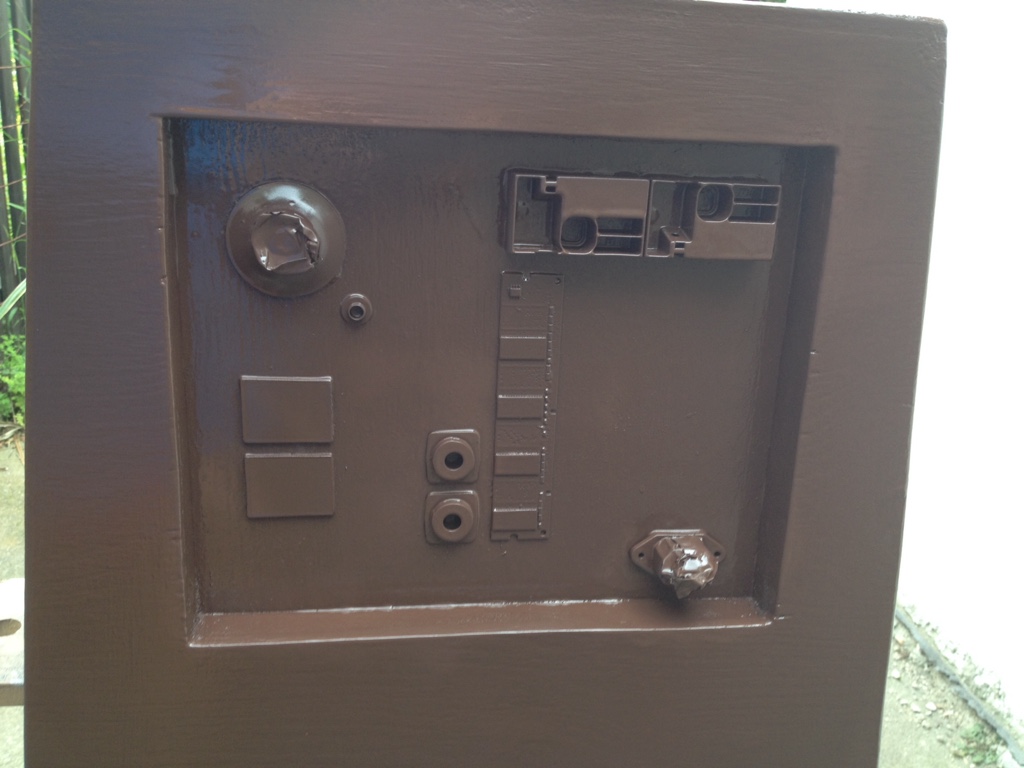

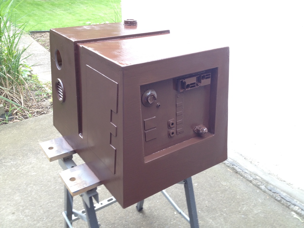

I was staring on the droid today for a few minutes and after this session I think that I want to paint him with the brown. So I went for brown "chocolate" color spray paint. Due to bad weather I couldn't paint him today.
Plus who doesn't want to have a chocolate Gonk droid?
