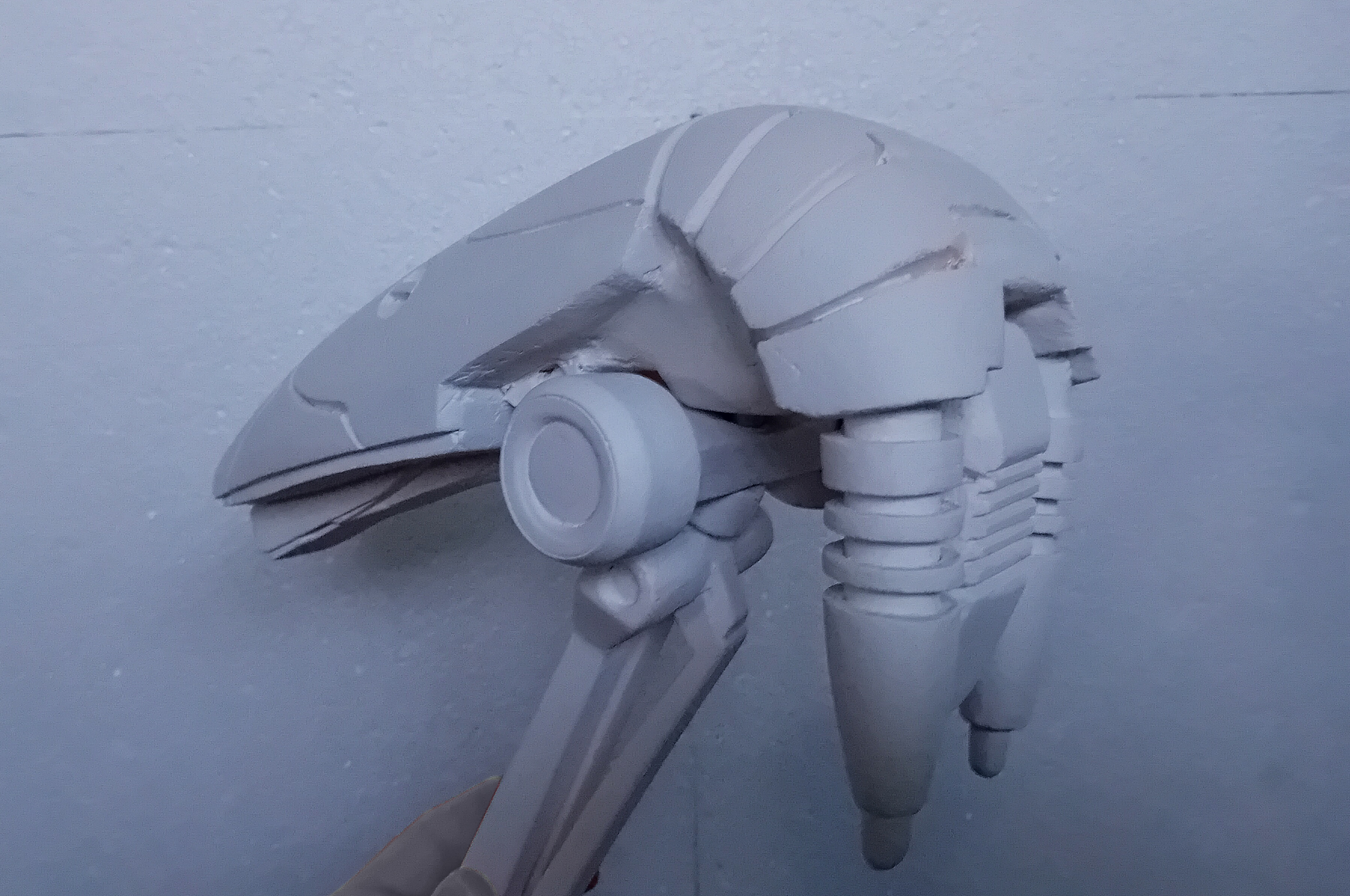

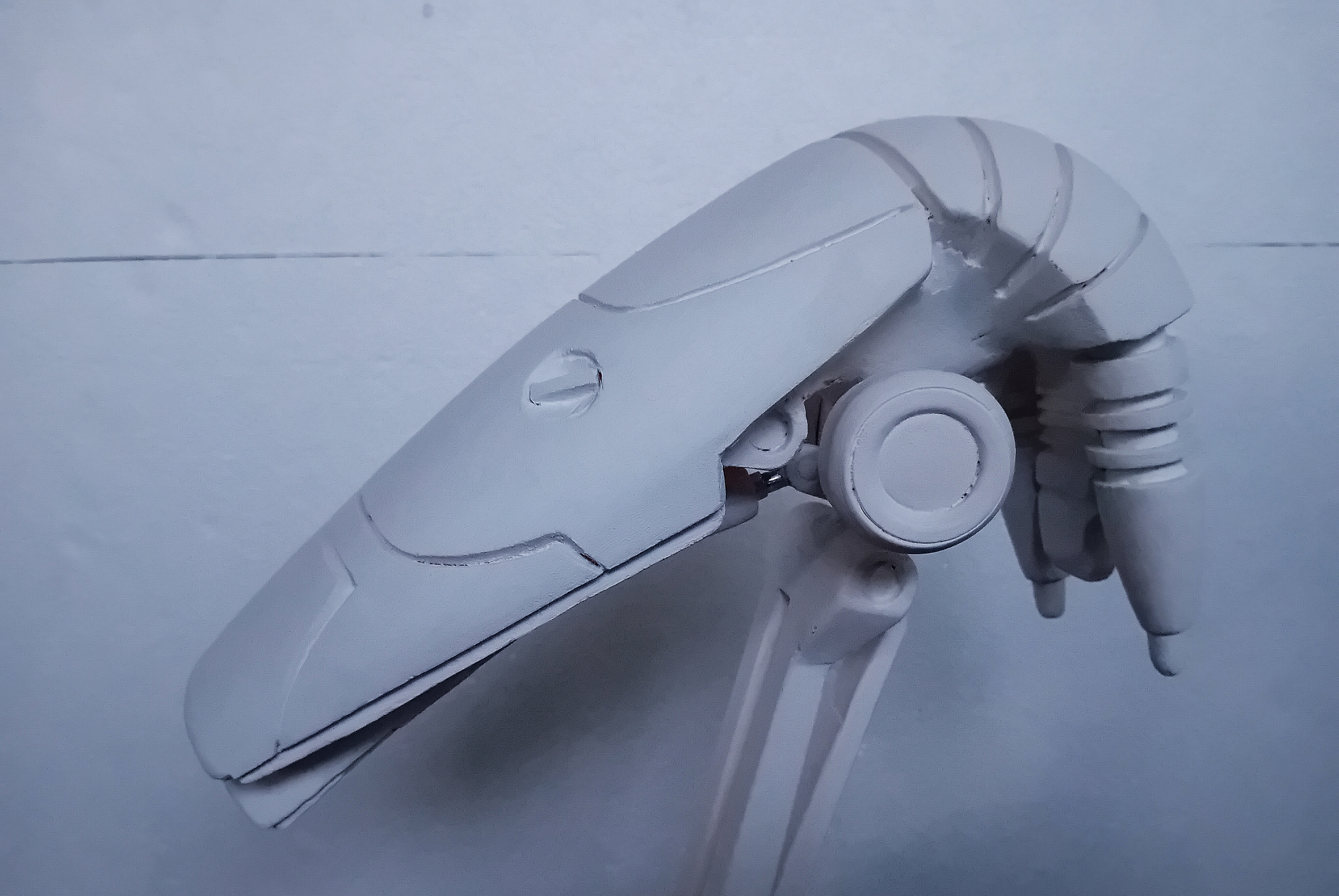

After looking around for week´s, i have decided to build my own Genosian Battle Droid, because al the figurines on the Marked ( from Sideshow and HotToys ) are far to small for my taste, so i started a week ago, and this is what i´ve got so far... i used Polyurethan Foam an Wood and some Aluminium tubes.
I struggled a little with the joint connection between the Head and the Neck, cause i have no idea what is between those round Ear thingys, if anybody know what´s going on in that area i would be very glad if you could tell me :) For the size reference i put a Red Bull can in of of those pictures, i really don´t know if this is even Life Size, but how tall is a Genosian Battle Droid really ? ...and are they any Resin Kit´s of Battle Droid´s ?

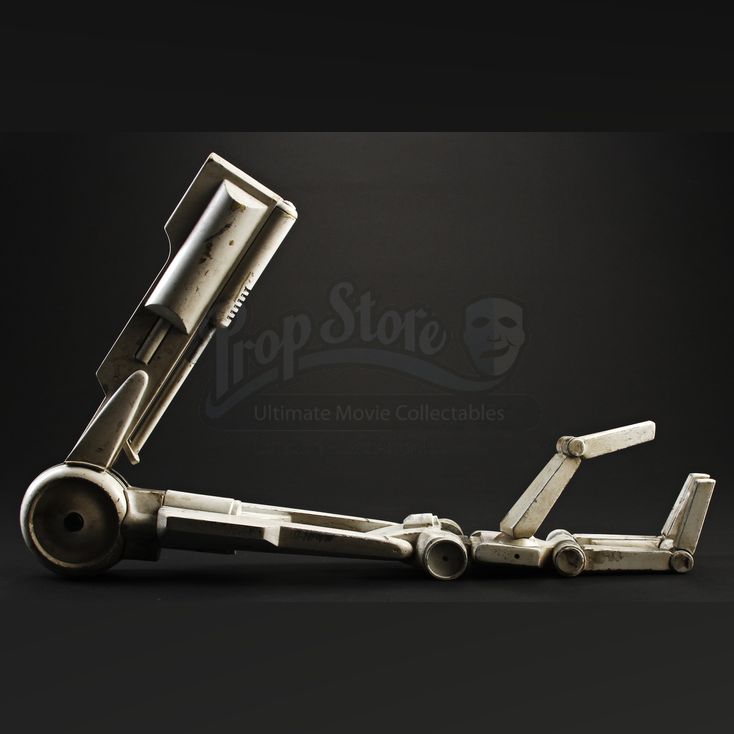

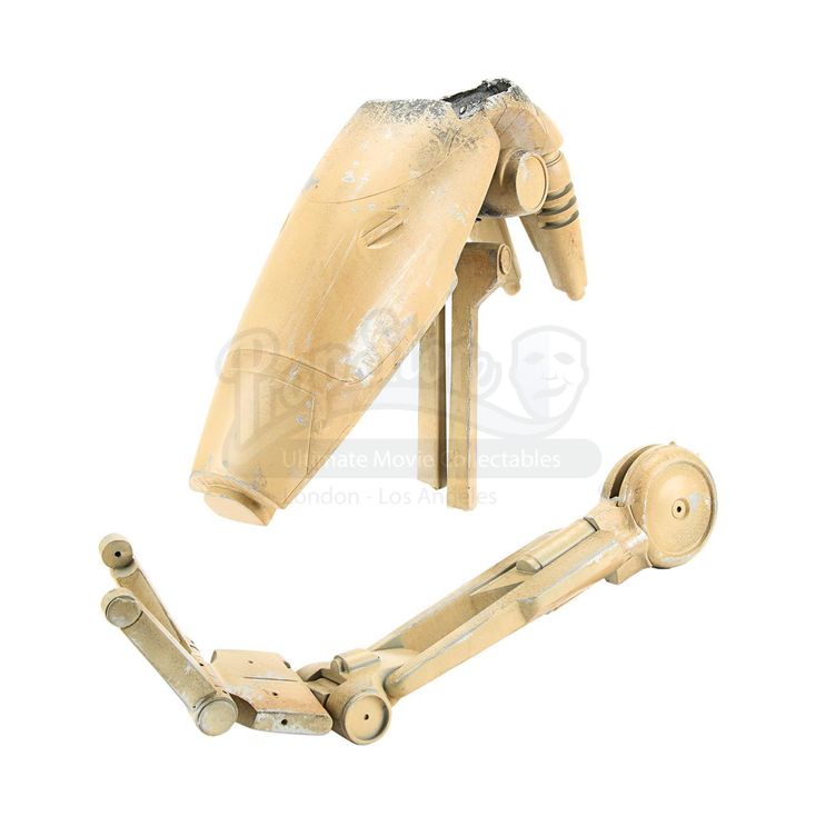

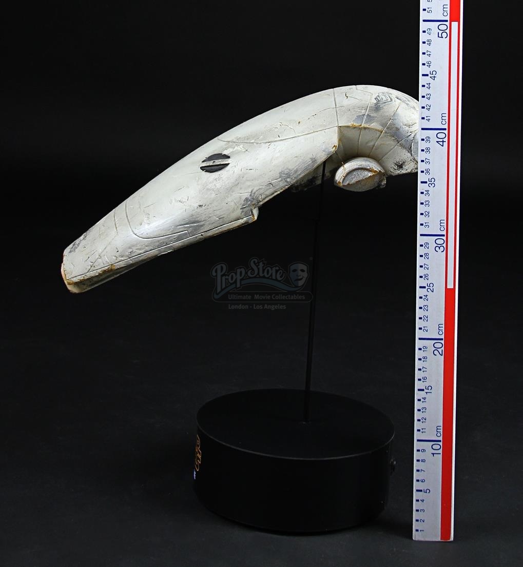

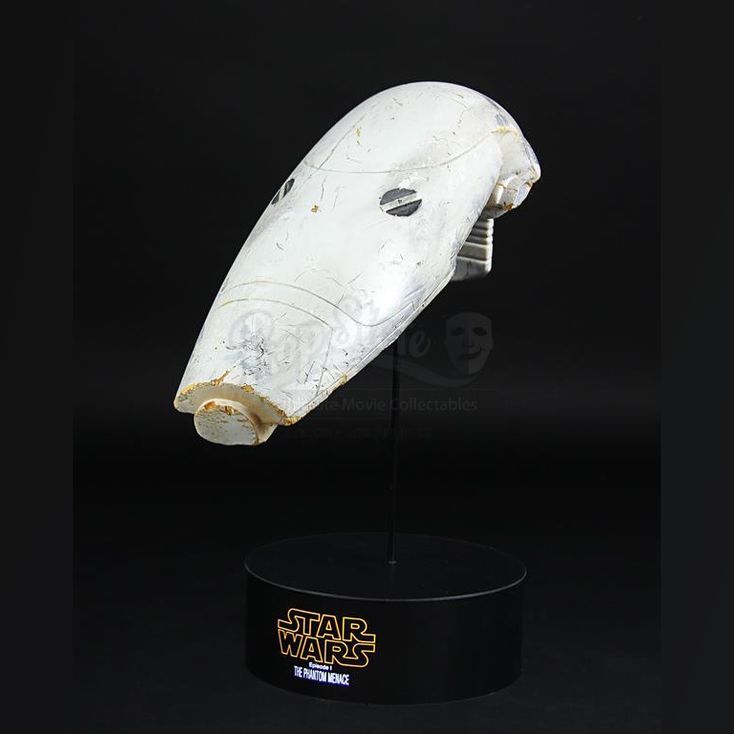

Here are some Prop Store pics. Hopefully they'll answer most of your questions, especially about size
It looks very good, though the back "dreadlock" look a little too thick.

Thank you very much for those reference links, there are so many different " versions " of those battle droids out there which makes it really hard to find the original " Real " one.

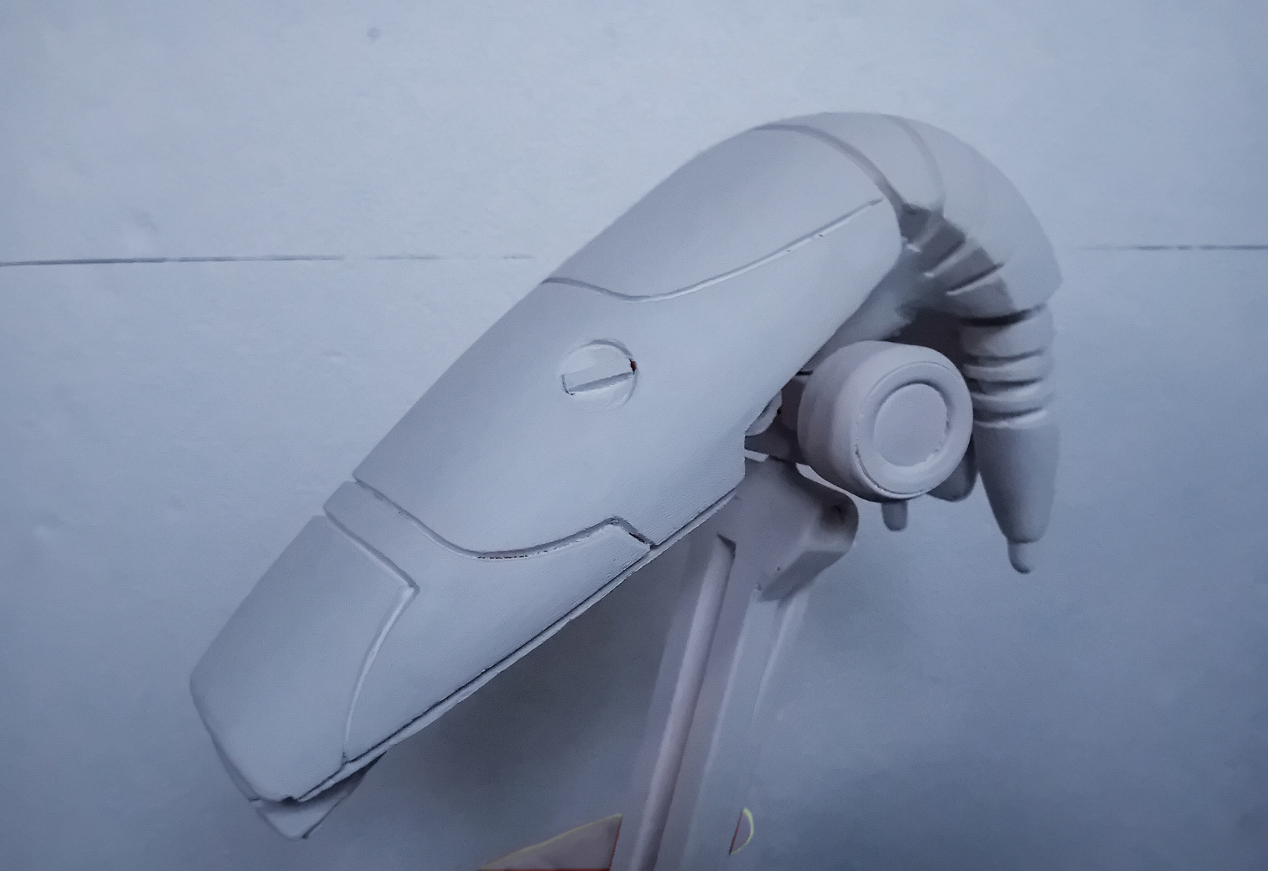

So here are the pictures after sanding and priming the surface of the Battle Droid, as you can see the " Ears " and the Dreadlock " section is still not quite right in terms of size and proportion...
The grey surface makes it a loot easier to estimate size and overall shape, and of course there are a lot of uneven sections in the surface, i don´t know if i will fix them right now, cause the effort that it will take me to correct those mishaps is huge...and this is only the Head, so i ´am right at the beginning of this project, and there is a lot more to come, but right now i work on the middle part of the torso, which is quite complex in shape, and easy to underestimate, ...which i did of course : )
Should i correct all the little dents in the surface ? ...or leave them as kind of " Battle Marks " ? ...any suggestions ?

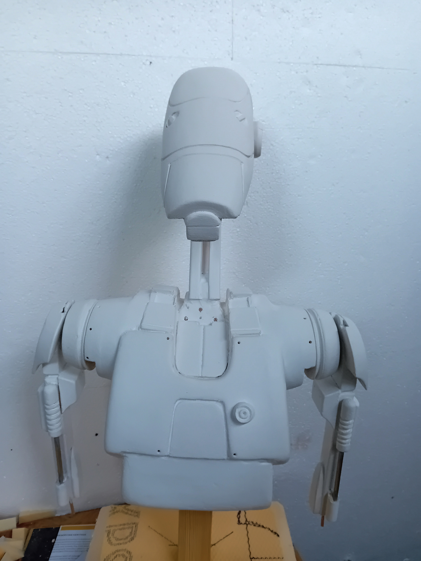

This Battle Droid build drives me insane...i never stumbled upon so many mechanical issues during a prop build like this one.

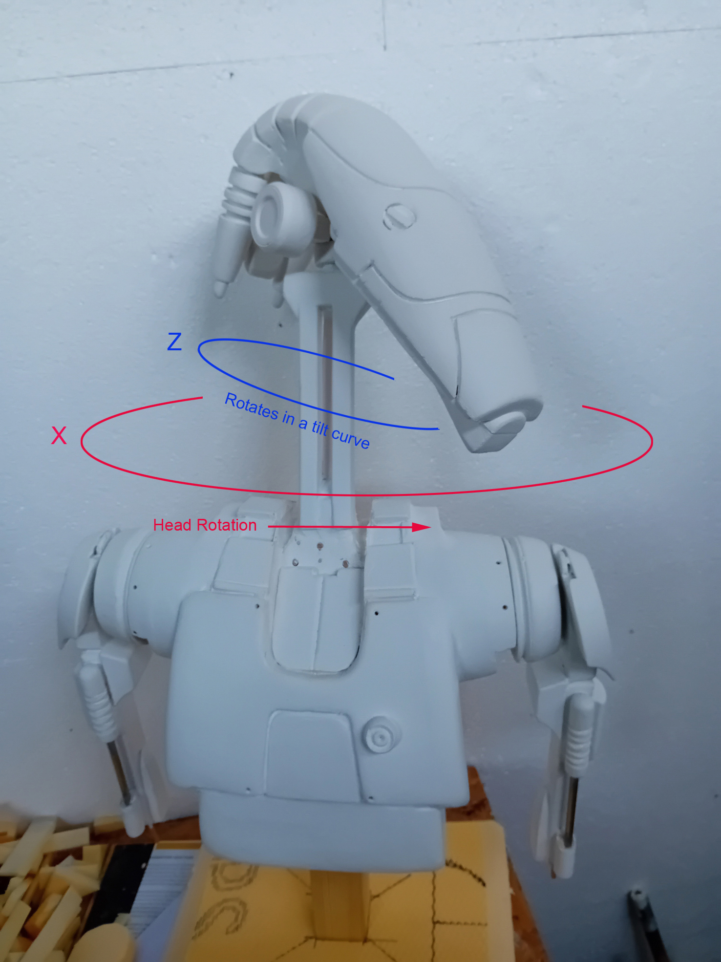

...as you can see here i have already begun with the middle section / torso, which created so many problem´s that needed to be solved, for example, how can you work with something that does not have one single straight line, to create a point of reference to work from ? ...not to mention that you can not fix this piece in any position, to sand glue or do anything else with it... so you have to hold it in your hand the whole time.
There is one thing that disturb´s me really, the mechanical parts that holds the Head in place, and the joints that allows him to move the head in the Z and X axis,...they just could not work that way like they do in the Movies, ...cause the Head, if he turns around the Y axis is forced to follow the movement of the space that the mechanics allow him to rotate right or left, but he makes a tilt with his head by around 15 - 20 degree´s around the Y axis, and roll´s his head...but in the Star Wars movie, no Battle Droid ever does that, so there must be an error in my construction itself... :)

As a reference for his Neck angle i have use some blueprints of a 3 side view,...and after adjusting that thing 2 times, i finally cut the neck off from the torso, cause i was not happy with the result...and glued it back together into a slightly different angle then it was before, ...like i said, when you don´t have a straight angle or line that you can use as a reference point, ...then you have to assume or guess, which can lead into an very unsatisfied domino effect, if there is an error in any measurement before...and that happen a lot during this build :(
Those 3 point´s in the area where the neck meet´s the torso, are wooden sticks, which i often use to hold the foam part´s together during the water based construction glue cures, ...later on i will use some ultra light filler for a smooth transition between the neck and the torso.
At this stage i have mounted the whole thing on a 4 by 4 timber beam, ...and i sadly realized that it will be a huge challenge to get the finished Droid able to stand on his own feet, without any support beam, maybe i even have have to install some counter weight´s in his body or his legs, i will see later on if all that is necessary or not, hopefully not...

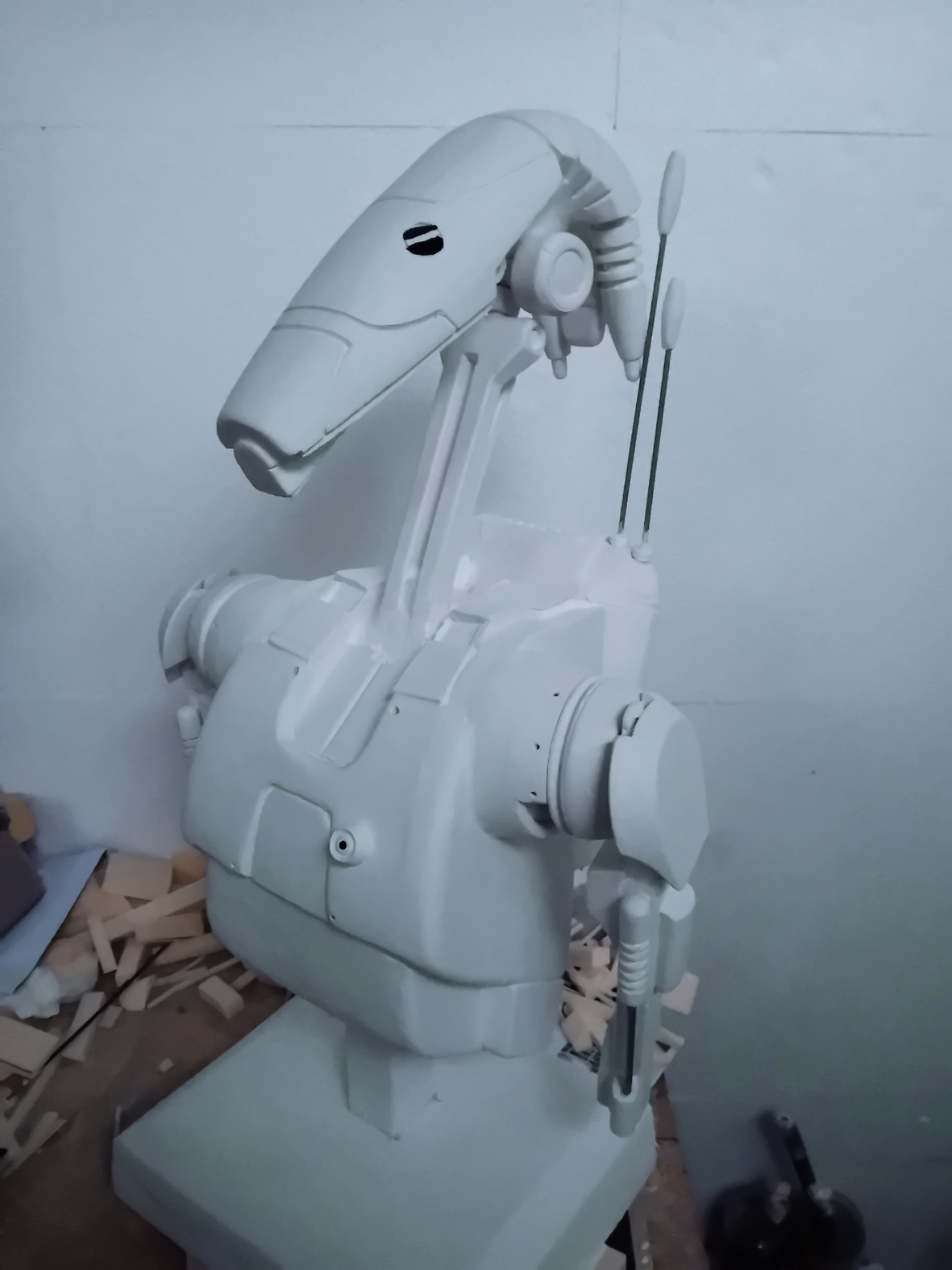

The Backpack...well,what can i say to that ? ...was surprisingly difficult to shape, since this is my very first " Robot " statue, i ´ am not used to work with high precision, but is that not one of the key elements a Robot stands for ?
It look´s like the Backpack is a little to small, ...not wide enough, and that leads to the interference with those antenna thingy´s...
The area where the Backpack and the body connect, seems still not quite right in shape and detail...
His Black eyes scared the crap out of me...better not give him any weapons : ( ...or legs :( ...or Energy :( Safety First, right ?
Since the Backpack is way of the right shape and proportion, it leaves me no choice but to start over and create a new one...
