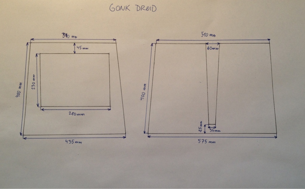

do you have blue prints?
Sure, here it is:
I used the blue prints of spacebob and changed them a little...

I thought I recognised those shapes, glad there's another gonk coming along.
please remember that the dimensions that I gave are for mine, I have tried to workout how big the real things are but in the end I said it should be just shorter than my artoo (I gave up).
Then I made it a little wider to accommodate the records.
To make it more accurate I would make the overall width narrower, or, make it taller and longer while leaving the width.
as I said on my thread the hole in the front of mine is too large (if you intend to run a lip around the edge).
Oh, and yes it is heavy :)

Hello, I think I made it a little taller and the front hole is a bit smaller than yours, even though I'm not going to make a lip.
Yes, it is heavy!
Just a question: how did you make the middle belt?

One more thing that is different on mine to the real prop...
On mine (and yours now) there is a rebate on the top connecting the two side rebates/flutes.
I did it this way because of the 1970s action figure is like that and I liked it.
On the real thing they don't connect and just stop at the top :)

what thickness plywood did you go with? it looks like 1/2"?

The plywood is 9 mm thick (I don't know in inches, Google says 0,354 in).

thank you, its funny here in the states we have say 1/2" plywood but it measures much smaller then 1/2". just like our construction material our 2x4 wood studs are advertised and sold as 2x4, yet they measure 1-1/2 by 3-1/2 lol
.354 is close to 3/8th plywood. if 3/8th is purchased its probably close to .354
