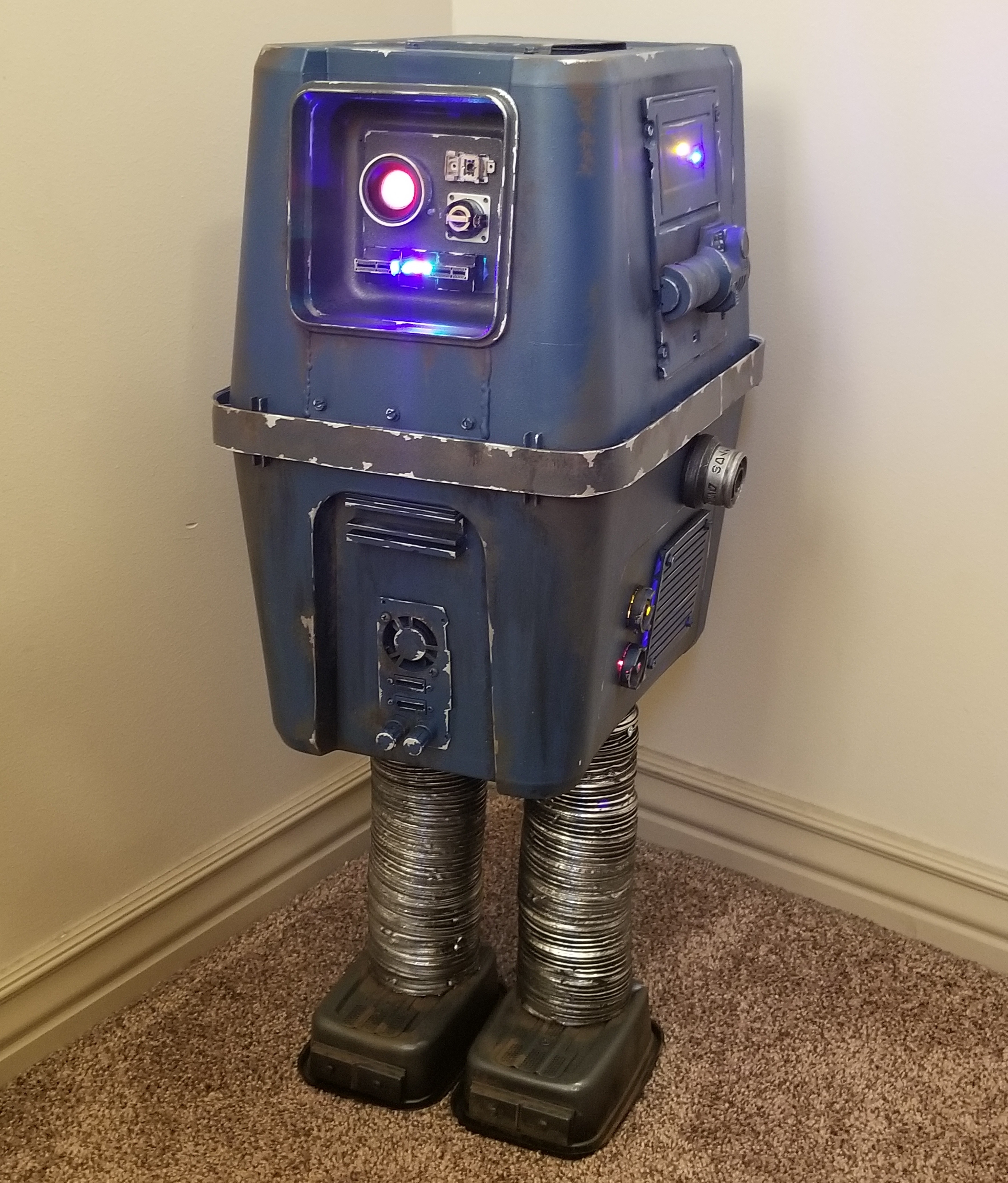

One of the Gonk Droid costumes I built for 12 year old kids in my neighborhood.
PKR shown w.i.p., not quite complete in this shot, some of the lights are not turned on and still needs finish work around the seam.

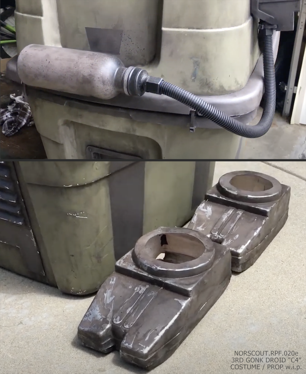

Some work in progress on my third Gonk Droid costume / prop. I'm calling this one "C4".
It's my own design, while clearly staying within an established Gonk Type Droid Platform.
Quick marker sketches I did at my workbench to figure out a graphic design for it.
First grime pass, no chips or scratches yet.
C4 is mostly complete, wearable and also on a stand, except I haven't had an easy time getting good lighting on this one in the studio.

The blue bar light is installed but the round "eye light" is not turned on in this image.

Curious about your feet?! Are they 3d printed?
Thanks Halliwax I used a vintage teal on PKR & leafy green on G3, with different colors on the mid seam strips.
I forget what I used on C4, it was several layers testing whatever spray cans I had on hand. I imagined C4 as a tan or brownish but didn't have the right spray colors. I hit it with an odd light green at first and didn't like it so I used some other layers and an old can of london fog.
The feet are deep pull vacuum formed. They got paper thin in a few spots but worked out well. I just glued .06 styrene strips to the thin spots for reinforcement.
