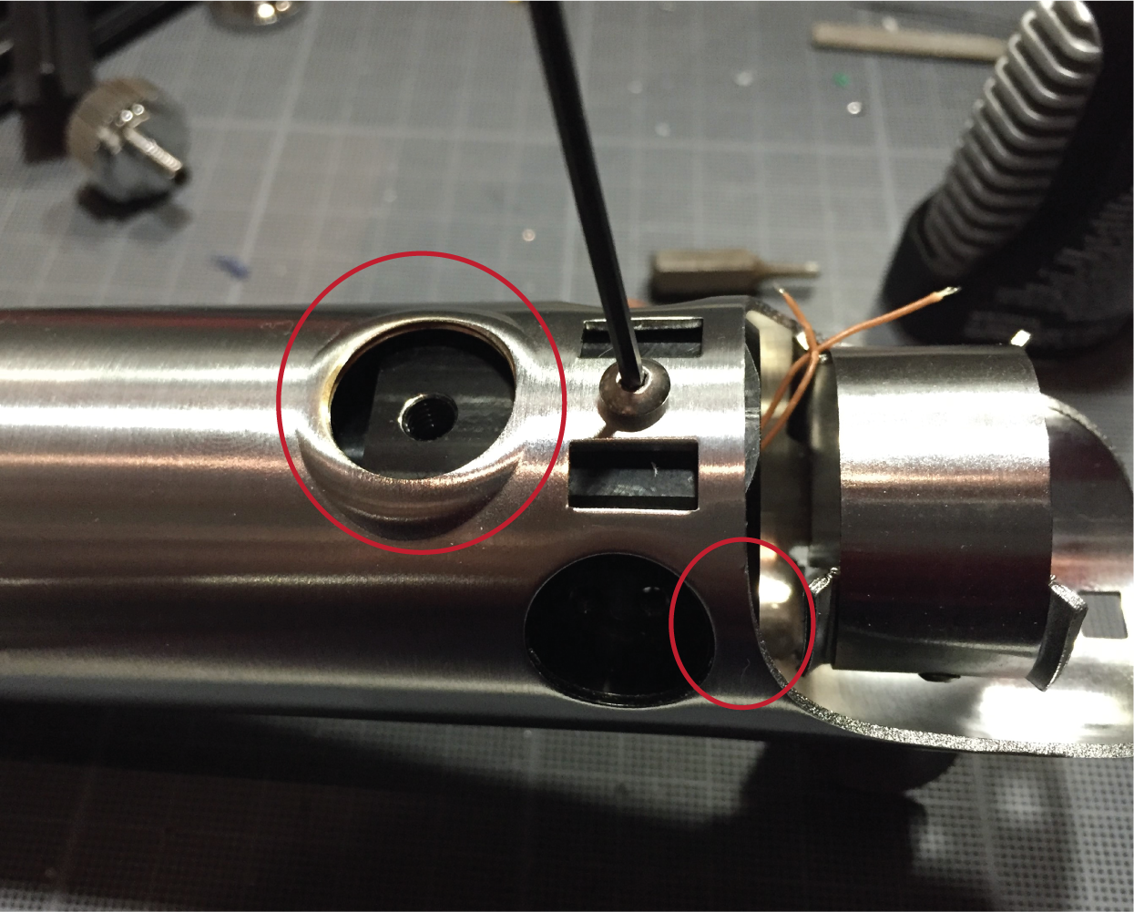

You know how some people have uppers that don't match the lowers? Is it possible that the factory sent out some Graflex 2.0 uppers in these orders? The upper looks suspiciously like the 2.0 as it uncannily features two identical design issues that can be seen in most photos.
First circle: Compared to vintage, the bulbous part under the eye and red button on the other side is not round - it's squished vertically.
Second circle: the distance between the hole and the leading edge is smaller than vintage, probably due to the cut on the profile (s compound curve) of the leading edge. Funnily enough, this is the opposite problem the current TGS prototype has.
These differences also exist on the renders in the first post of this thread, FWIW.
Its not possible. The end of the 2.0 is threaded to join the halves. The ends on Romans are slotted, like a true vintage, to work with the clamp in securing the two pieces. Good guess though!

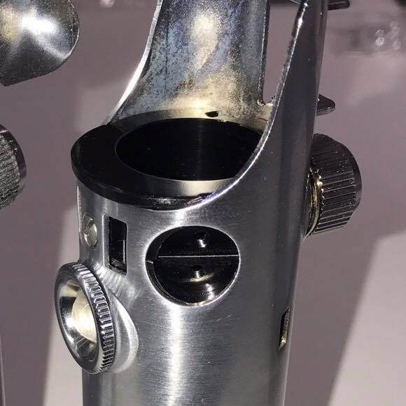

Apparently he was wrong. :) Same alignment issue as KR. The holes on your replica aren't aligned with vintage so anything that's designed for the latter isn't going to line up.
I have neither flash here in person yet, but to me, looking at photos with the flashes upright and in plane with the viewer, it also looks like the holes were punched round when the sheet was flat - this means when rolled into a tube, they're no longer round, but but elliptical, taller than they are wide. On vintage it looks like they were punched elliptical & wider to begin with, so when rolled they form a perfect circle as if the hole was drilled.
Just curous how how you know this if you don't have the flashes yet?
Photos, which I mentioned as the basis for the hypothesis. If I had the flashes here with me I'd give you measurements to the thousandth of an inch and tell you exactly what's wrong with absolute certainty instead of hypothesizing.
