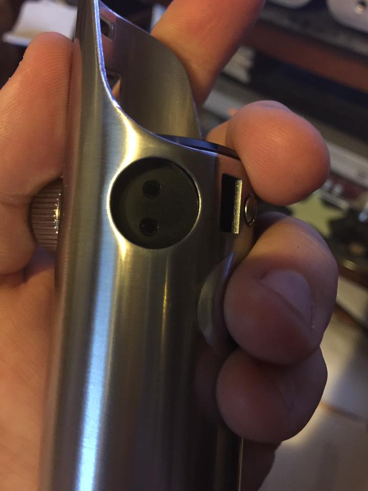

Hey! I've already spoken with Roman's and while the blade holder fits in his flash tube the brass pin cut or holes do not quite line up perfectly with the blade holder's.
Vintages line up perfect with ours.
The solution, I think, would be for us to make tailored blade holders for Roman's Flashes.
Yikes! This is disappointing news for those of us who plan to light them up. I received my flash from Roman yesterday and it's gorgeous, but now from a technical aspect seems like it's not quite going to cut it. To me it wouldn't make sense to buy a second, less accurate blade holder to accommodate the flash. Seems like the best options are to see if a different replica is a better fit, or bite the bullet and go authentic.
I may end up using Roman's as a static display piece.
Re: === G R A F L E X === Flashgun ... NOW SHIPPING!!!
You can always modify the original parts and light them up with sound without the possibility to attach a blade. That was what I was planning to do in the first place.
The big issue for blade use right now is that in addition to the SH part, no other existing blade holder is going to line up either. One with larger pockets like TGS will not show overlap issue, but pins will be offset. That would require filling the existing pin holes and tapping new ones, along with some paint to hide the re-work.
Decisions decisions...

How offset would the pins be? I have the deluxe TGS blade holder + short pins on the way, because I wanted a 1" blade adapter, not 7/8".
Obi-Shane posted this photo of the TGS blade holder in a thread on FB:
