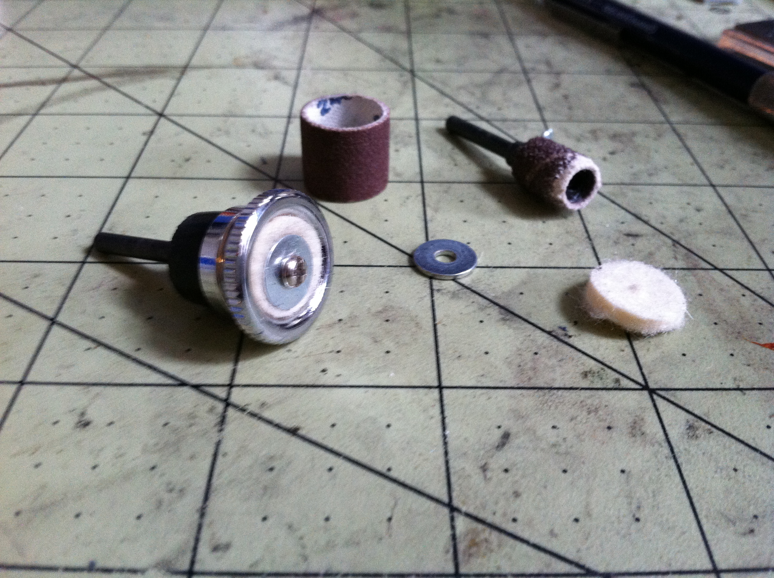

Also curious how others are grinding the knurling off their glass eye and keeping it smooth. Just go at it with a dremel?
IF i ever decide to make a TFA, then i would use my Lathe. ;)
Another easy way would be to use a drillpress and a handfile.
Is there a way of mounting the glass eye on the dremel so to use the dremel as a lathe then just use files? Others on the research thread have said they have used drills, I'll have to try when mine shows up --- Tracking says 'Out from Delivery' -- 1 or 2 hours mail the mail shows up, yay!

That doesnt work on a real or replica glass eye though, they dont have a threaded rod to stick in the drill like the 2.0 inaccurately has

Bolt, nut, eye bezel, rubber washer, nut. Stick on drill, spin and file.
Alternative... Jam it tightly onto a wooden dowel. Stick on drill, spin and file.

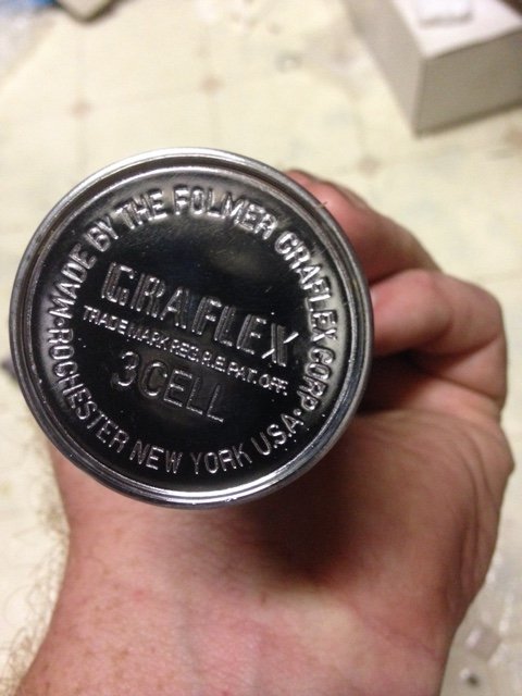

Wow, I can't see any real problems some have reported. My top and bottom match, not one shinier than the other. Rabbit ears straight up and down, not in an angled Y. Bottom stamped part is a little brighter than the top and bottom tubes but not near chrome, looks fine. The clamp bars and the red button are chrome like, and the clamp bars and surrounding area has an orange peel to the plating, only thing really wrong though I'm weathering mine so don't care. Lines cut into the clamp are rough, extra clamp was much cleaner -- extra clamp is much brighter - that looks more like chrome than any part on the Graflex, minus the red button housing. Really great job, haha, now time to play!!

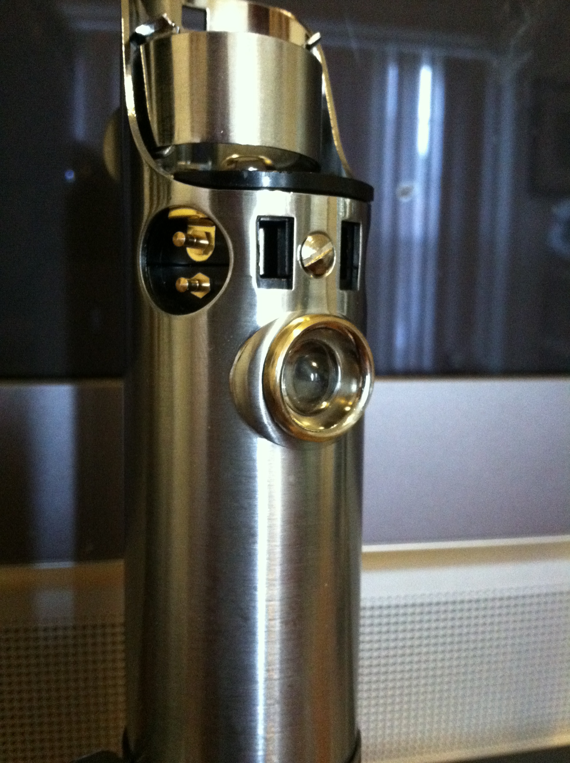

Ok, here's my dremel glass eye bezel setup. Rubber cylinder the sanding wheels fit on to was the perfect size to fit in the back of the glass eye bezel. I unscrewed the screw on the top, removed the washer, then had -- rubber cylinder, glass eye bezel, buffing disc, then washer. the buffing disc was too thick for the little screw at the end so I cut it in two with a serrated knife. I added a bevel to the edge also. Photos I've seen makes it look like a band of brass with nickel on either side, but Roman's eye bezel is showing all brass. I think it looks really good.

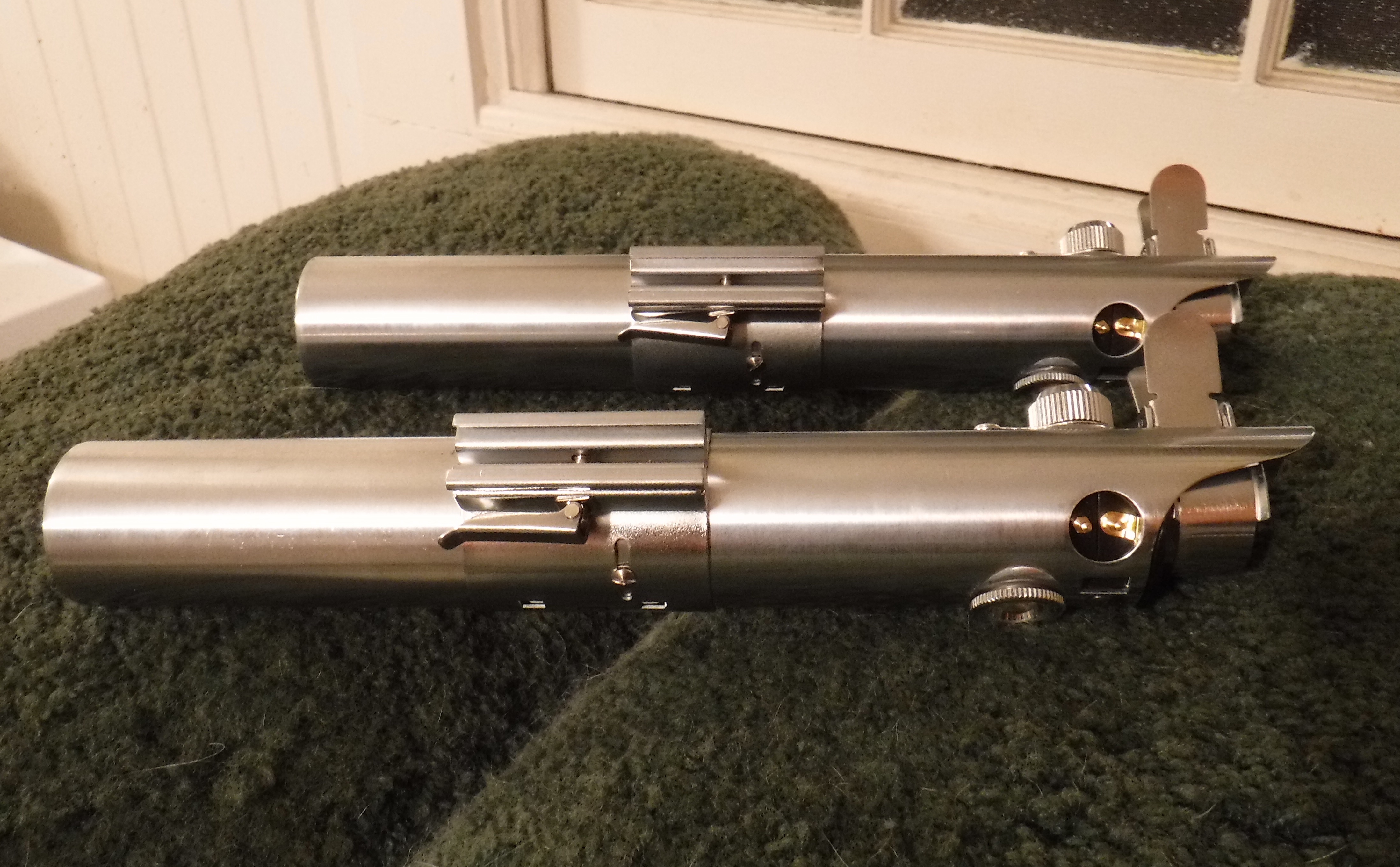

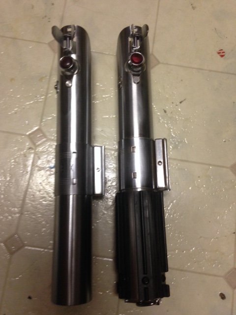

I have a custom saber shop v2 that I used to take some comparison photos. TCSS version is only an empty hilt and more for making a working saber. (Which I may do someday) it may be unfair to compare the two, (more like apples and oranges. ) however, romans graflex is far superior and will make a terrific and realistic prop.

A mini review: I have had several Graflexes, but haven't owned one for awhile. This replica feels heavier. Can't confirm, but it has a really pleasing heft that I like. Could be in my head. Mine does have a few small blemishes and plating imperfections (incl some orange peel on the clamp), but since I plan to "antique" mine a bit, it doesn't bother me. The shiny bottom is no big deal to me, but it IS shiny! I'm not sure why some are fussy about it though. It's an easy fix. The flash came with waaaaaay spread out bunny ears, but a few squeezes brought them closer to parallel easy-peasy, which I find more attractive.

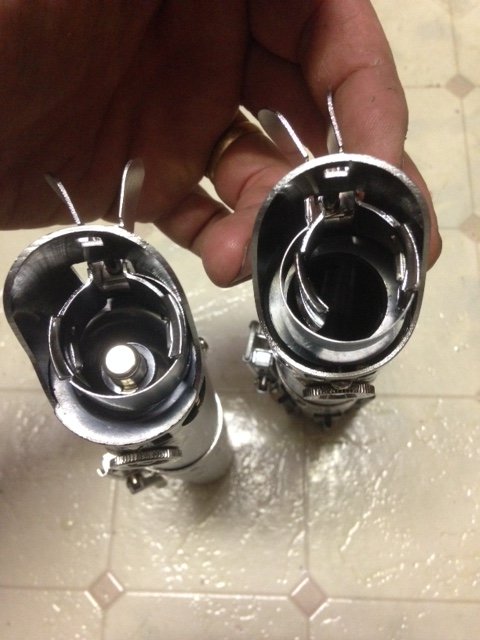

Here are my two babies :love

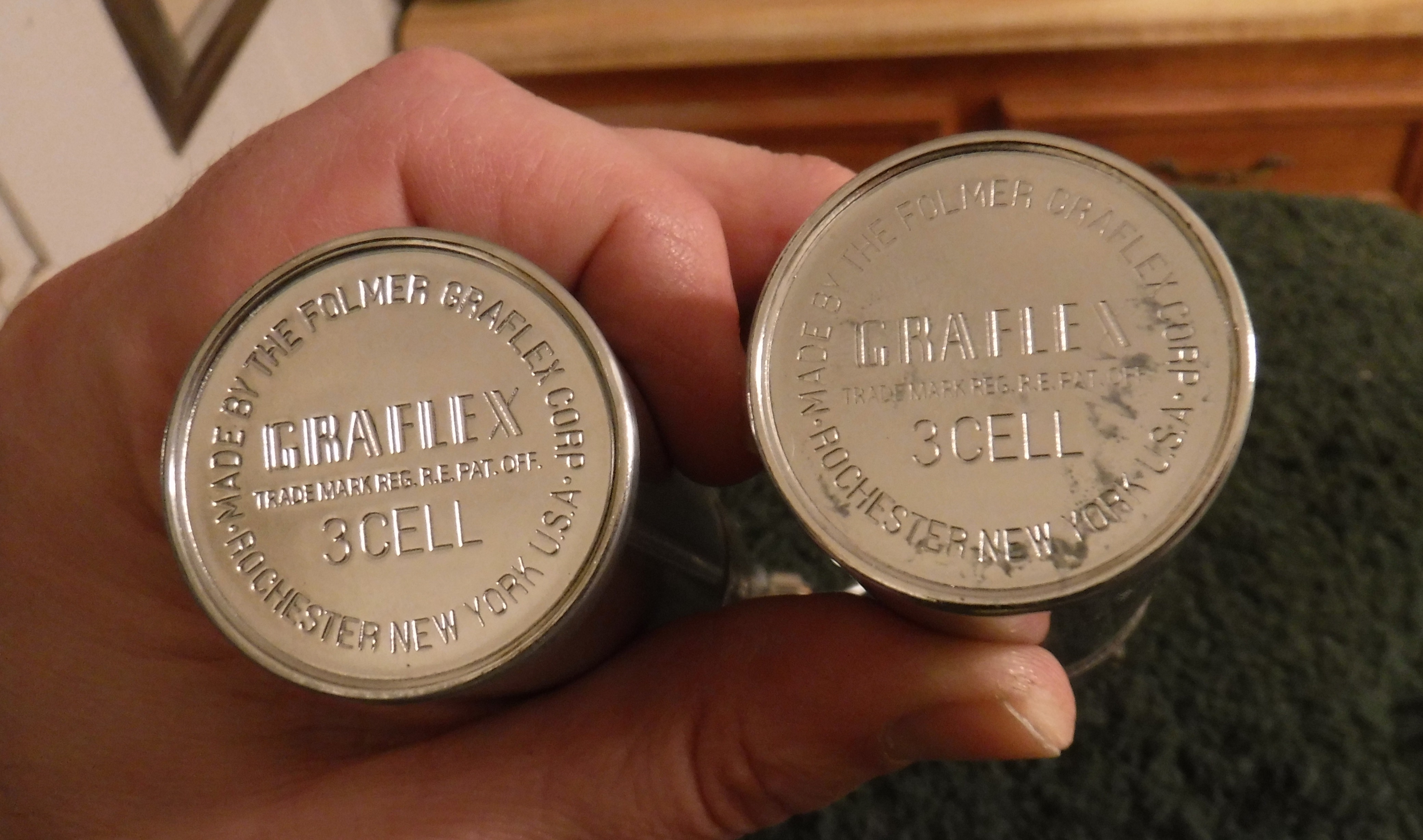

This one you can kinda see what others are talking about with the kinda ruffed texture on the clamp right by the handle. Honestly, this is my first time seeing it... & it's in the photo, & that's only cause it's in the glare of the lights. Seriously, a quick hit with a Brillo, or whatever, & it'll be gone.
Here you can see the one of mine with the finish problem, on the right. But, that's where the d-ring will go, so no one will see it. Aaaaannnd I'm thinking about ordering another 1 or 2 lower pieces & red button, for movie swapping purposes.

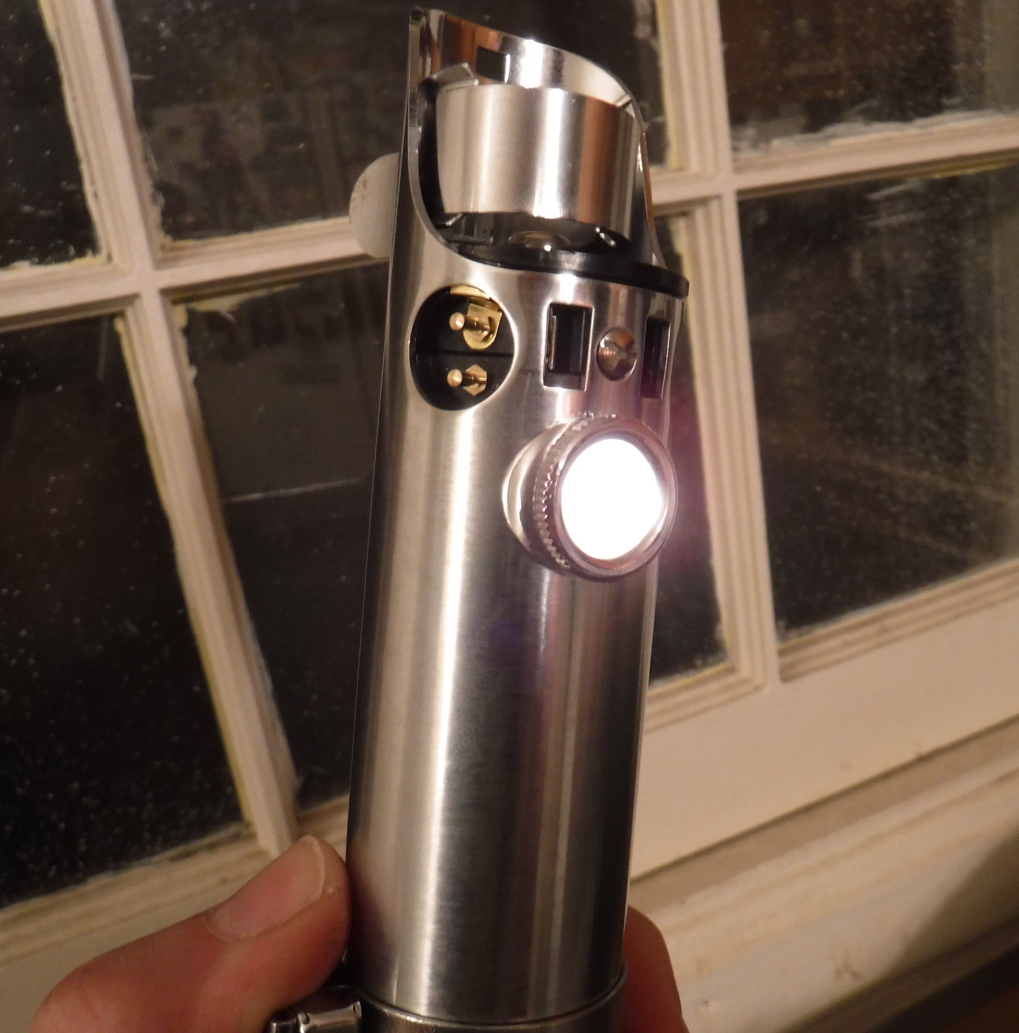

& I couldn't help myself. I had to throw batteries in one for giggles. Wish I had a flash bulb. I tell ya though, you could use this thing for a flashlight!
