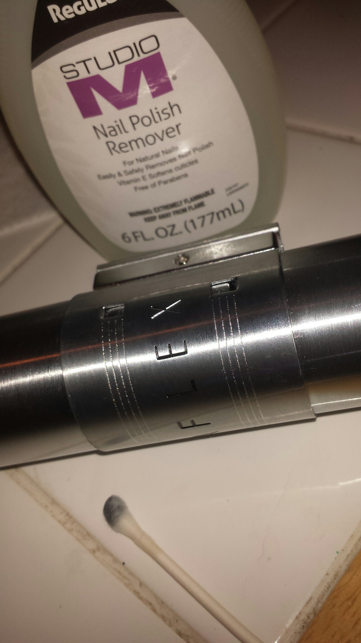

In case anyone was wondering.... yes the dark lettering on the Graflex logo will come off with acetone :)
So my suggestion worked? :)
Still not sure why you'd want to remove that... I think it's a fantastic touch, and had a hard time keeping it a secret. :D but I am glad you were able to remove it. :)
oh I thought it was great but I did it for screen accuracy cuz it was worn off by filming time. I think it was a great idea to give us an essentially brand new out of the box 1930's-1940's flashgun :). Roman you did a stupendous job on this project. The MPP will be as equally great I am sure.

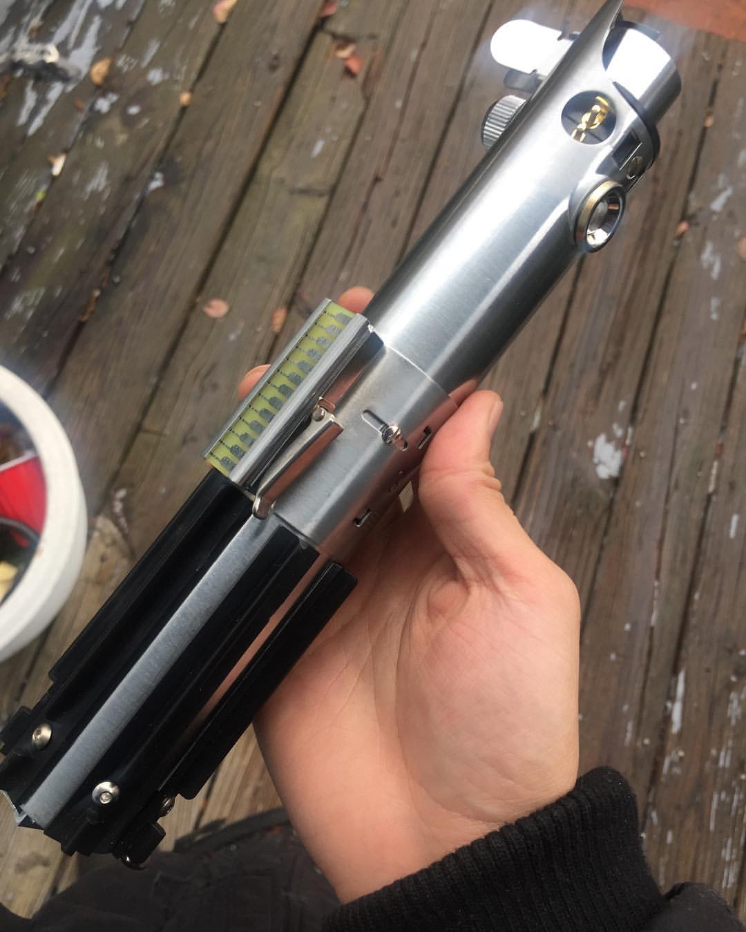

I freaking love this thing. I've got a couple parts OTW from wannawanga. TFA Clamp card, clamp cover, and belt clip.16113299_10158429414120157_8020971760938029848_o.jpg
Edit: Some build details:
-My glass eye unscrewed easily. I just popped it onto the rubber drum used for sanding wheels on my Dremel. Even though it was spinning, the filing wasn't even all the way around, so some parts became smooth faster. It took a while tbh.
-Red button is SUPER stuck.
-Cut the hex screws and epoxied them to the grips before attaching them.
-Used the paper grip template. I couldn't really figure out an easy way to use it so I cut out the sections where the grips go and aligned the first grip with the clamp.
-Same clamp finish issues as with others, but it doesn't matter since I'll be using a clamp cover.
-Aligned the Kobold with the clamp grip, then marked and drilled it. Screwed the hex screws right in.
The only problem I really found was that the band attached to the bunny ears was askew so it sagged a little on the right side. Since I don't plan on squeezing the bunny ears for any reason, I epoxied the side that was misaligned.
I can't wait for my other parts to arrive and I'm happy to finally get this. I popped some batteries in it just now and I love the weight. Also, this is kind of fun.
