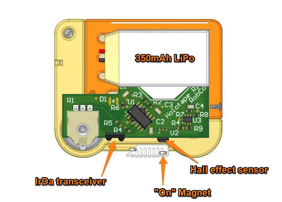

Today was more electronics. The Holotape circuit board. This is one of the last peripheral boards I need to do before starting on the motherboard.
I am sticking with the optical data transmission on the Holotape. Afterall, it is just cool that it uses actual optical data transmission.
Here is how it works for those who haven't read the earlier parts of the thread:
1) When you open the Holotape dust cover, a small magnet is moved in place over the Hall Effect Sensor.
2) The Hall Effect sensor triggers the one-shot circuit, which in turn powers up the Dual Timer Circuit for a period of 30 seconds.
3) The first portion of the timer circuit generates a 38KHz carrier signal, the same type used for Infrared TV remote controls.
4) The second portion of the timer circuit generates a variable pulse width signal. Controlled by the potentiometer.
5) The modulated timing signal is then transmitted out via the red LED.
6) After 30 seconds the Holotape is automatically powered down by the one-shot circuit to save battery life.
7) It can be re-triggered by closing/opening the dust cover.
On the Pip-Boy:
1) When inserted into the Pip-Boy a small detector switch will detect that a Holotape is present.
2) A second magnet inside will actually trigger the circuit upon insertion, just in case you forgot to open the dust cover. (The translucent cover won't stop the IR signal)
3) A 38KHz IR Demodulator chip on the Pip-Boy will decode the signal, and pass the pulse-width signal to the microcontroller.
4) The microcontroller converts the pulse width signal into a number, and this is compared to a set of ranges.
All of this means the Pip-Boy can have up to 12 different ID codes variably controlled. So you can remove the Holotape, and turn the knob on it to set it to some other tape configuration. (Game, Log, Audio, etc...)
Basically the Holotape becomes a very complicated remote control. It tells the Pip-Boy software what preprogrammed Holotape to load.
I did look at adding some actual two-way optical data communication using IrDa and a tiny Arduino, but the battery in this case wouldn't last very long, and the software would become much more complex.
So I could leave the pot on each tape in one position to permanently make it one 9f the game tapes, or a specifically marked personal log or like that?
Short answer:
Yes, that is the idea. You can set the potentiometer to one of 12 settings, and then program what setting is what in the PIp-Boy. By making it adjustable you won't have to have 12 separate (expensive) holotapes, you can just change the setting as you want.
Overly detailed answer:
Since the pot and timing circuit are analog, technically you could have hundreds of possible timing outputs. But in reality the position of the pot won't be that stable. So the idea is to mechanically put in 12 detents into the knob. (12 happened to work out to a nice even pattern around the small knob)
The detents help the pot settle on a number by mechanically holding it in position. Even then there will be some drift.
So if we are using 8-bit range of numbers that is a 0-255. Lets say the pot is set to half-way around. The output is ~128. The microcontroller might end up reading 128 exactly, but the number could drift on either side of 128. So we use every electrical engineers favorite word: Hysteresis. You compare the raw number you have to a range of numbers. If we device the 0-255 in 12, then the range is approximately +/- 10 on each side of the target number. Anything in that range is considered a valid input. Software compares the number to a set table, and calls up the correct command.
In the end the holotapes are going to just be another gee-wiz feature. I imagine having around three tapes that you can swap out and show off different programs.

So here is the question:Should I upgrade the Holotapes have two-way optical data communication?
Even if I don't do two-way communication, the MSP430 also makes IR remote control signal transmission quite simple, and very low power. So I may end up using it just because it is actually more foolproof than the Dual 555 timer circuit I have now.
I am sure two-way data would take more energy. However I think I can fit in a rechargeable battery into a tiny holotape.
As far a storing that data, I would add a flash chip. You can get up to 1Gb (125MB) of flash in a tiny package.
It seems like this sounds really cool, but could end up taking a heck of a lot of software work for what becomes bragging rights on where the actual data is stored.
