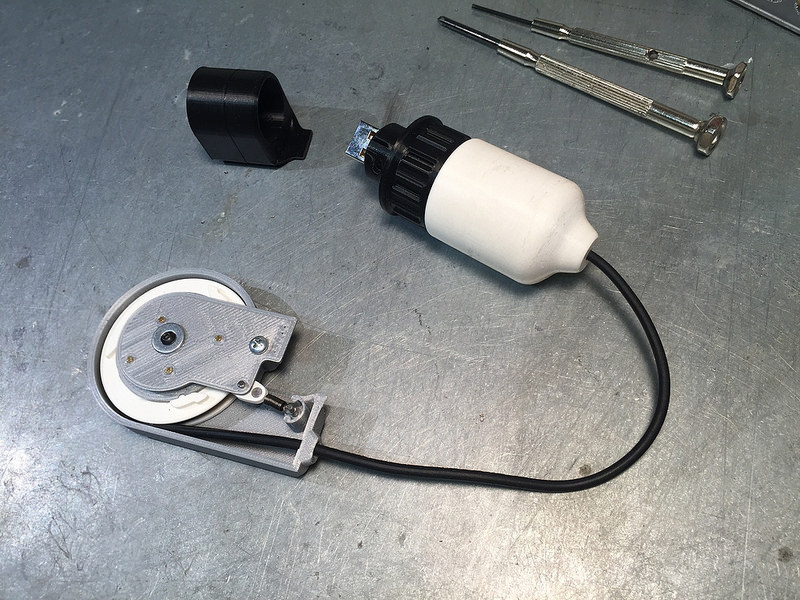

I redesigned the cable reel for the third time. This time I changed to a double sided reel, which prevents the cable from touching the non-moving side of the case.
I changed the pawl such that it has lower friction moving in the retraction direction. I reduced the number of catches to just three, however I may change this one last time as landing on a catch point right now is a bit difficult.
Without the slip ring in place a single spring can handle the load, and the cable return works perfectly. With the slip ring attached I have to double the spring. With the spring doubled, the whole thing works great. Thanks to loonitick for the double-spring idea. I still am going to try to find a thicker spring as loading two springs into that tiny spool is dangerous and nerve racking. If you let go for just a second the springs explode out and you could easily get cut or loose an eye if you're not wearing protection. I already have a permanent scar on my hand from flying metal, I don't want more.
