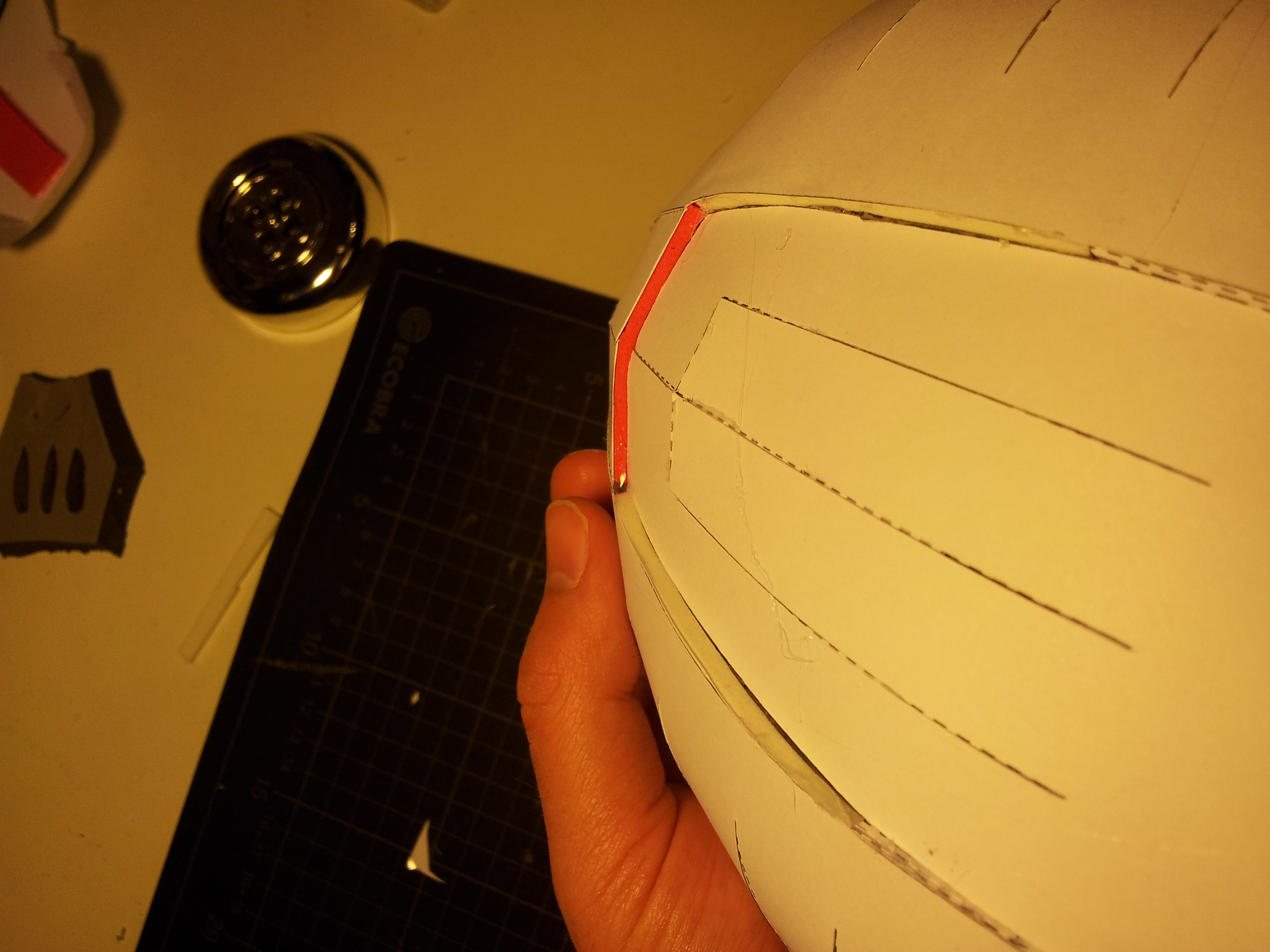

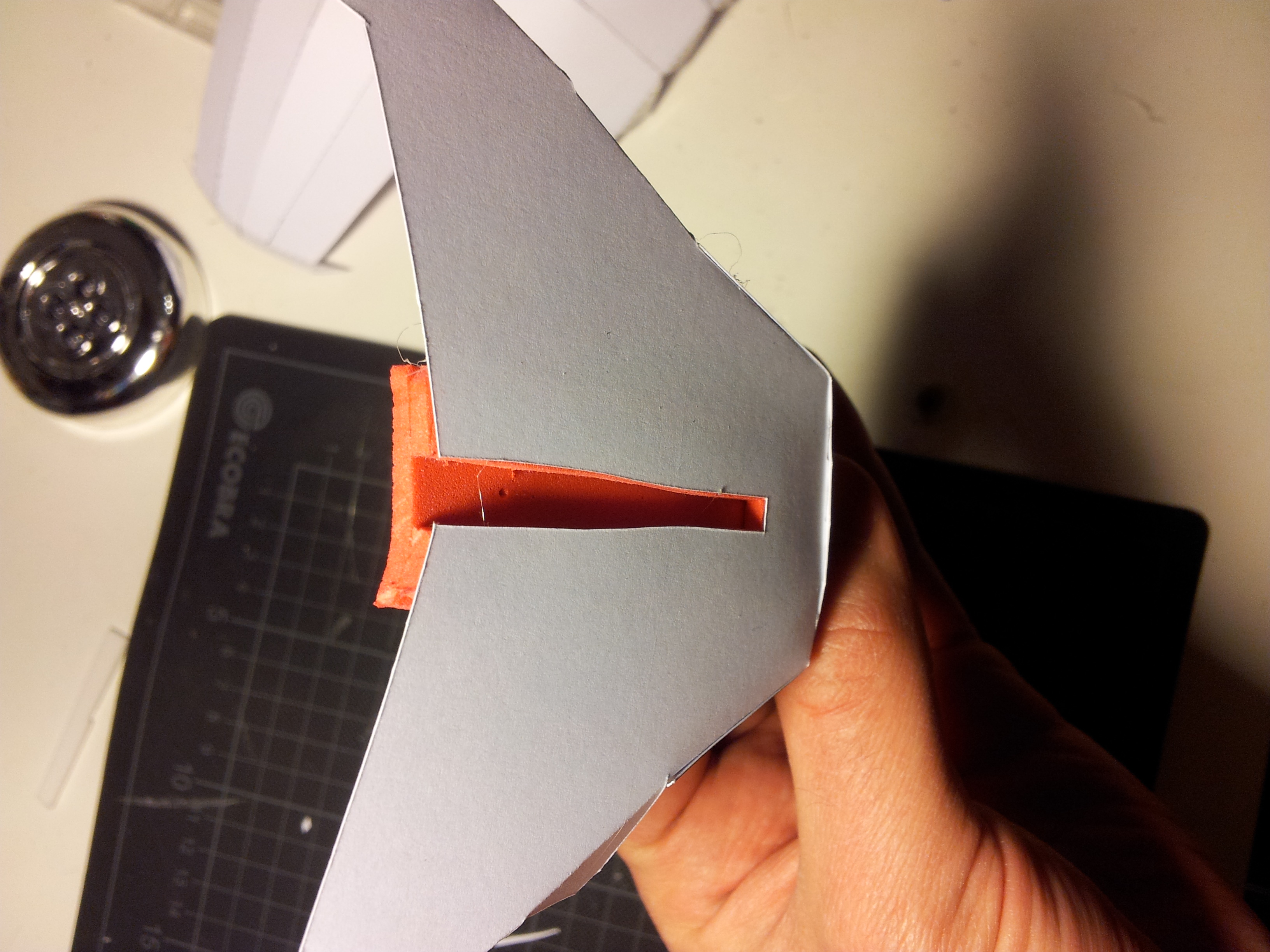

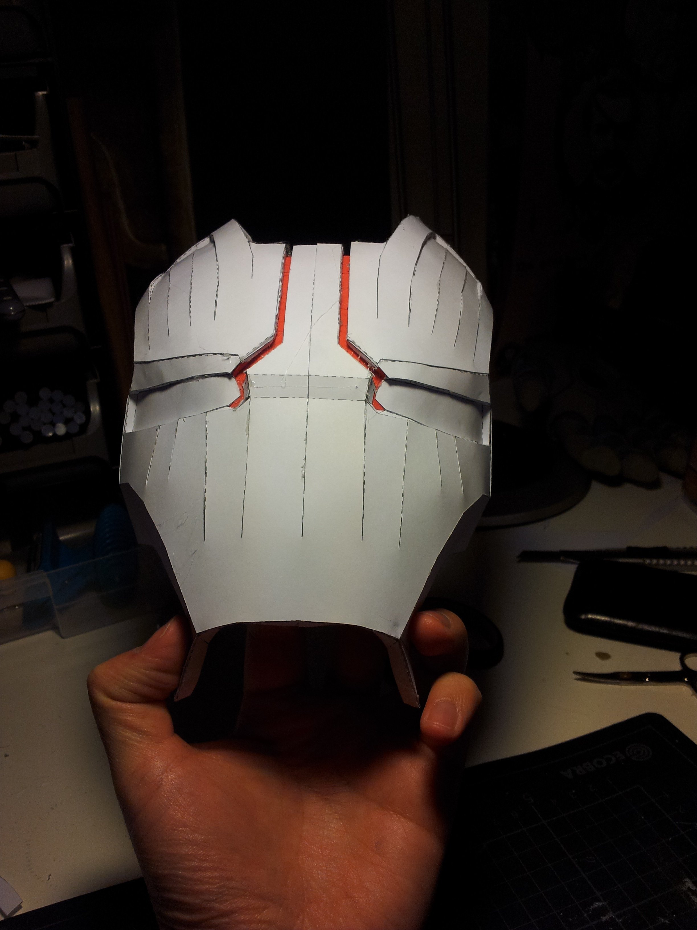

- traditional Pep on 160gr paper.
- used 3mm foamies to help with the details.
- hotglue

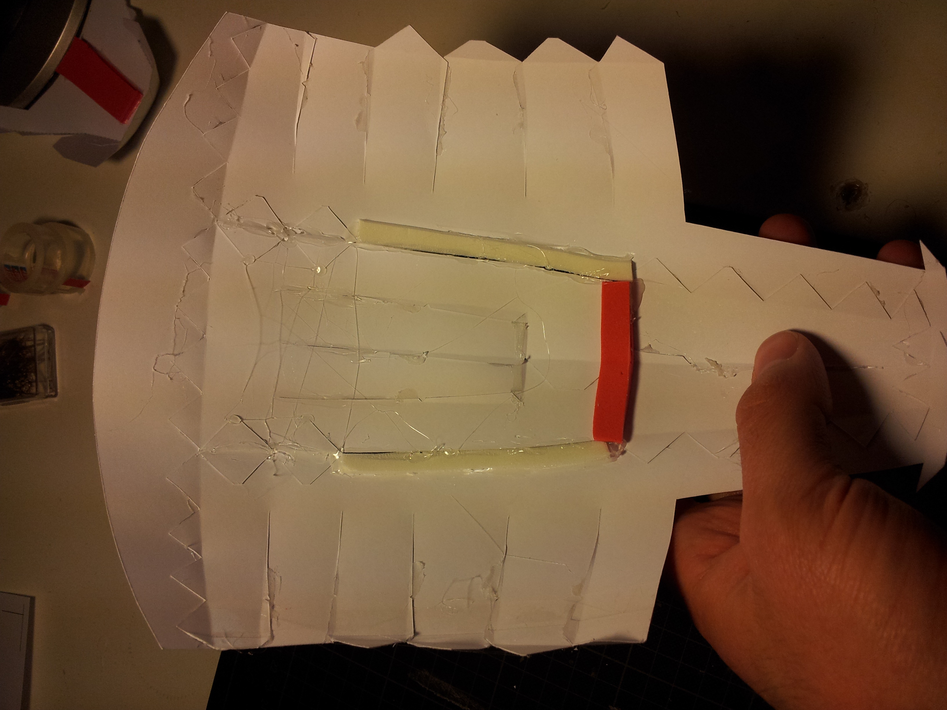

So my first MK42 was done with paper in a medium thickness. I put the pep-file together using hot glue. My idea for the little greases on the forehead: using 3mm foamies to ensure the exact space in between them. A picture might help understanding:
as you can see the greases are pretty accurate this way and you save yourself the trouble with the tiny folds on this thing. The only downside: sanding this area is tricky. You don't want to sand on the foam. On the other hand: since you can get this accurate on the first try, you don't need to sand a lot. I used this trick in other places too.

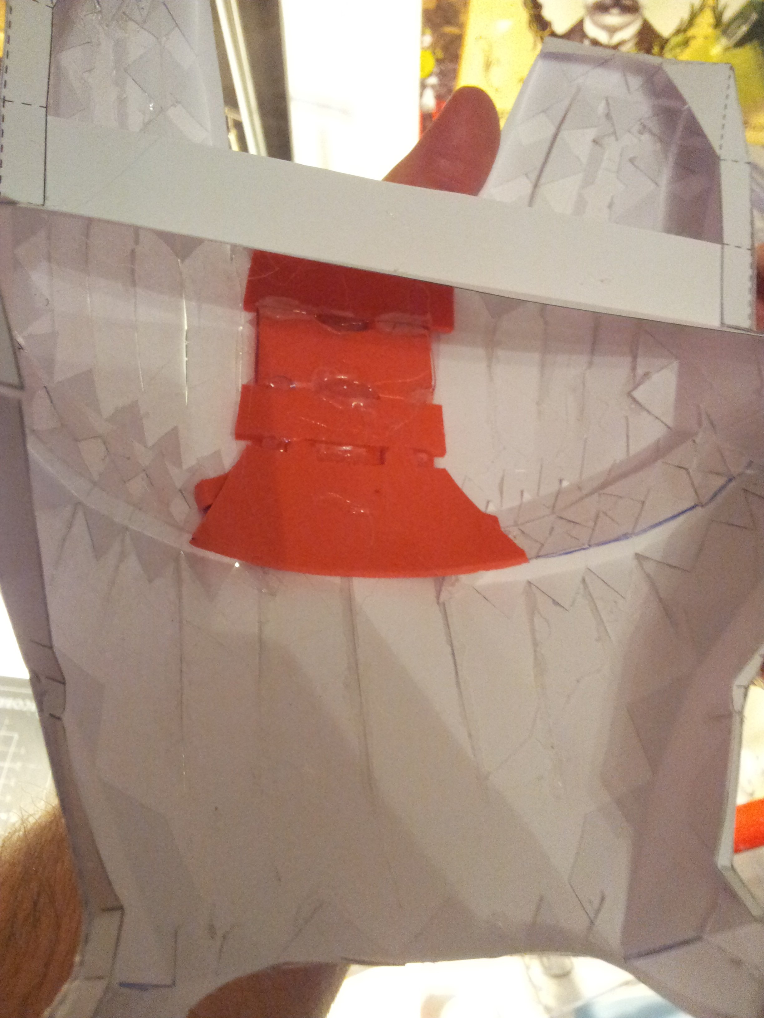

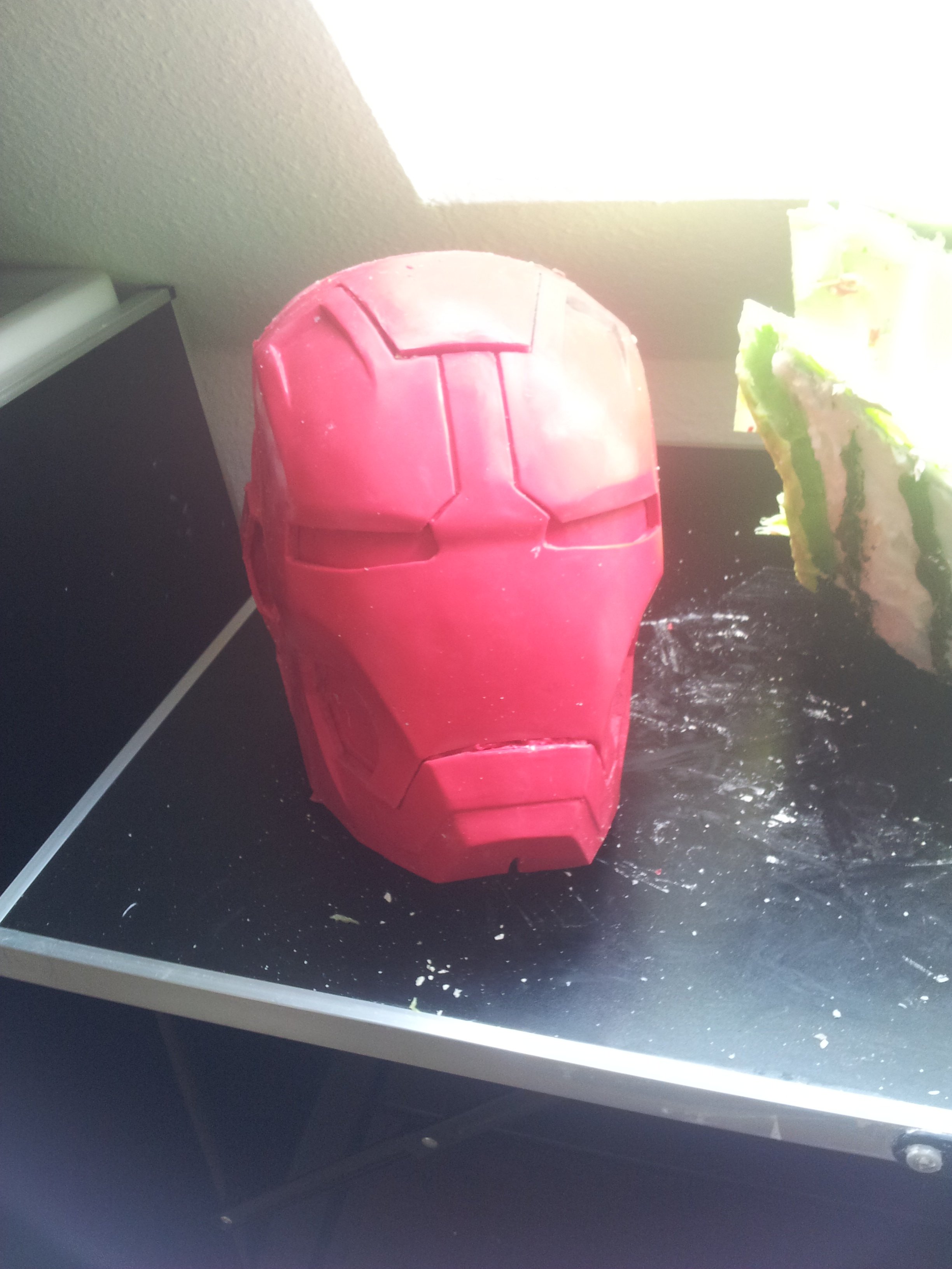

After finishing the pep work i had to harden it. This would be the step where you use Epoxy Resin. I wanted to try something else. Acrylic Resin. It kinda looks like plaster but it isn't. Look it up, it's pretty cool stuff. Also works really great of bond work later. But first... my fail: Since i used medium thickness in my paper... it warped like hell:
I tried to save it but in the end the warping destroyed the symmetry and it was just frustrating... so...
First try - first fail. But I'm not one to give up. the problem was: the paper soaked the moisture from the Acrylic Resin and warped. So i had to make the paper waterproof at least from one side. I could either use non-water-based glue... or laminate the paper.
Second try
- Normal 80gr paper
- laminating sheets
- again 3mm foamies and 5mm foamies for the edges.

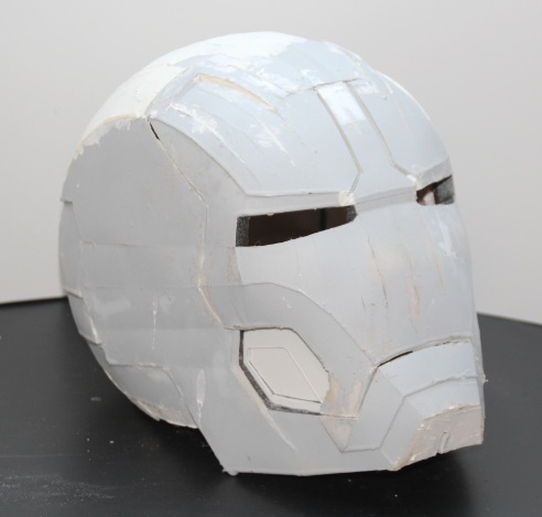

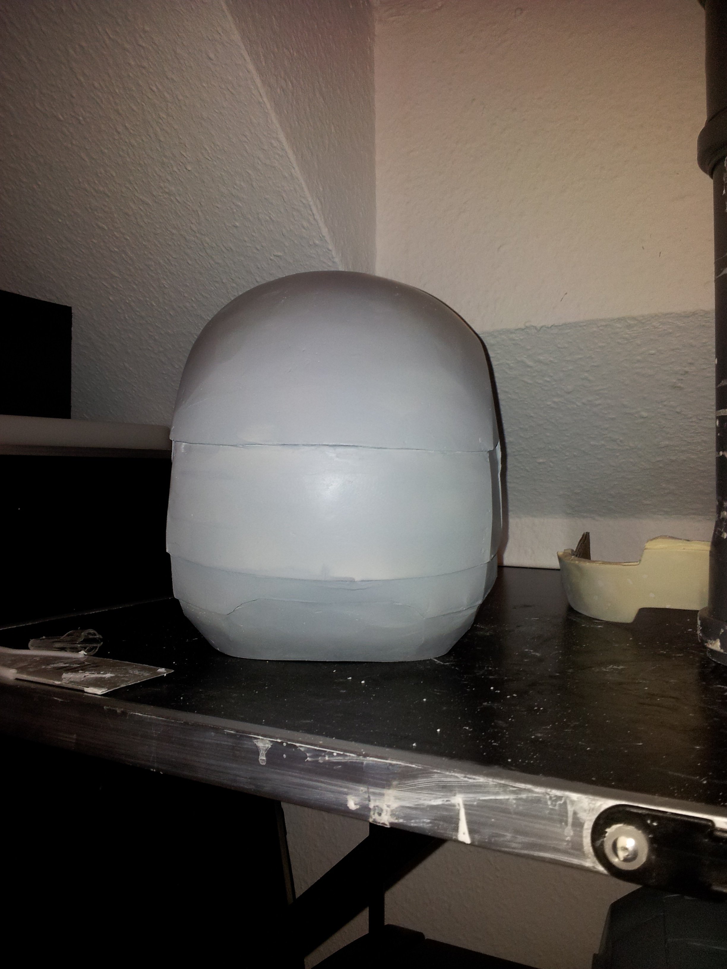

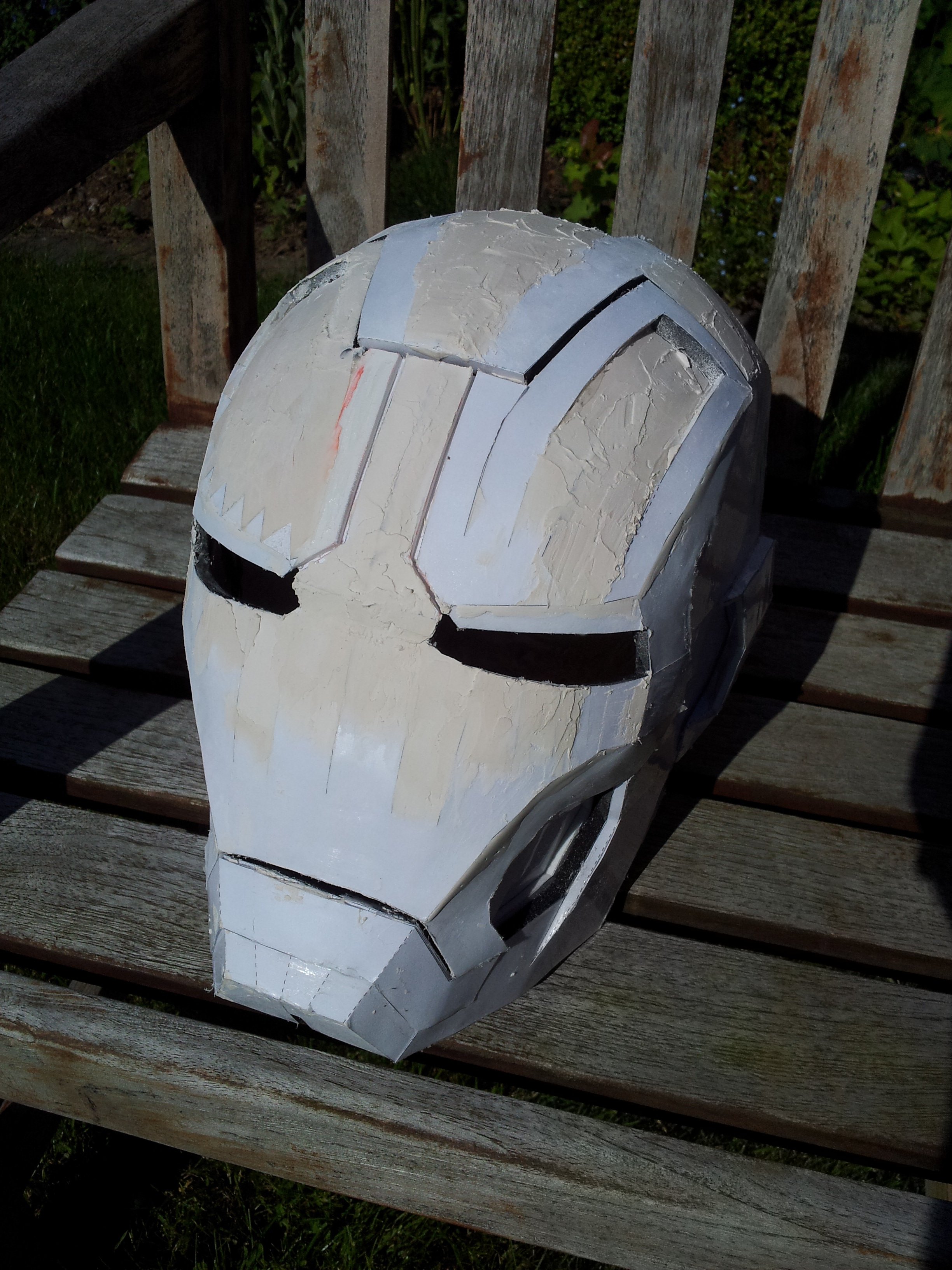

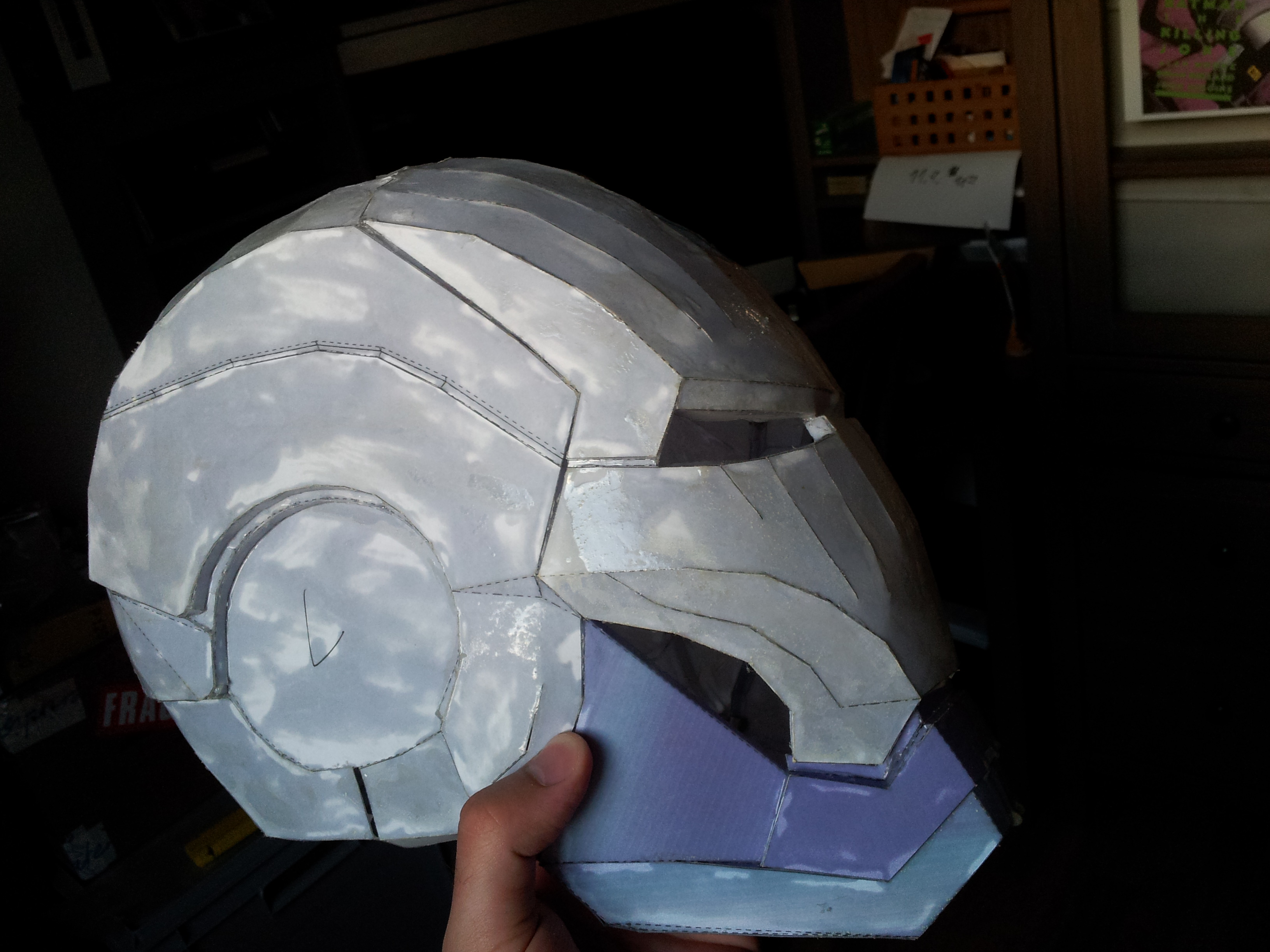

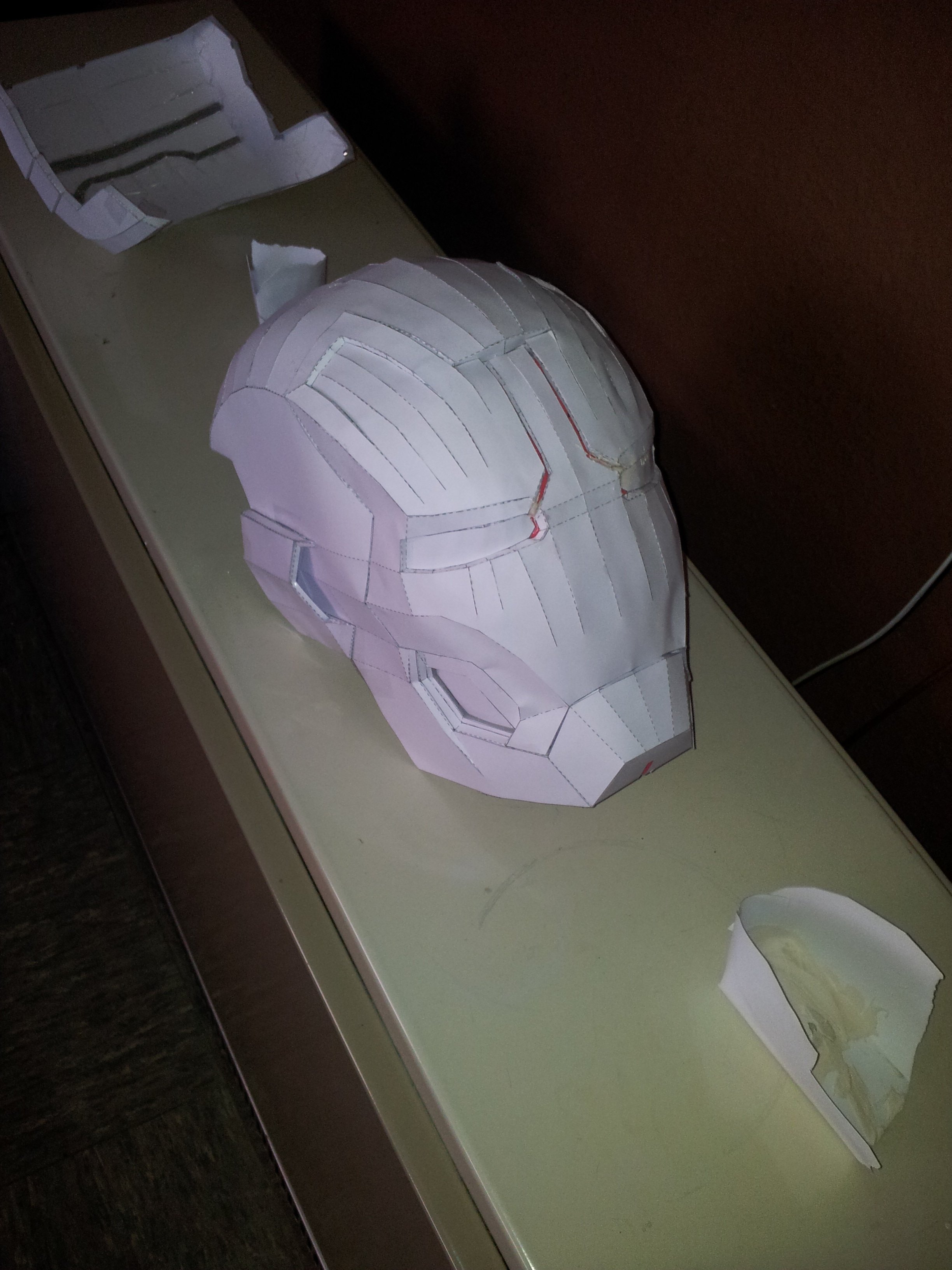

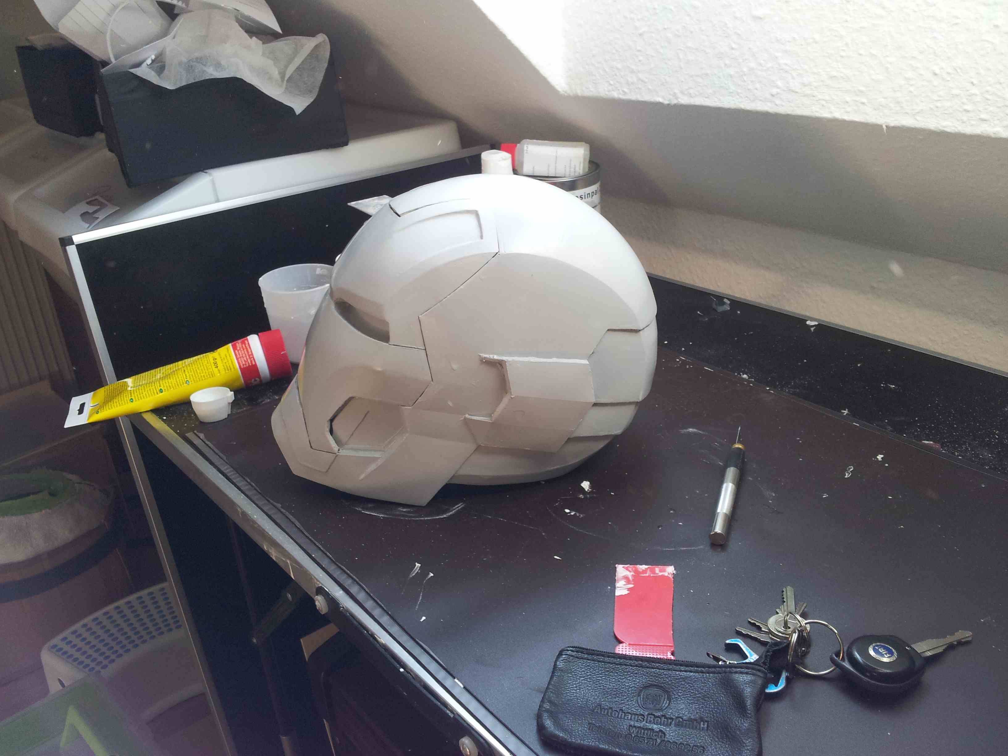

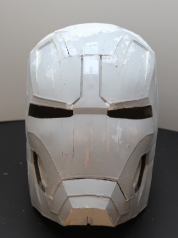

I went with the laminated paper option. That means I printed out the pep-pages and laminated it afterwards... but before cutting. The laminating foil bonds with the paper so don't worry about it peeling off. There are different thicknesses too. Choose one that is not too thick.
The result looked like this:
using laminating foil on the pep project had proven some pretty cool advantages: you have very good stability without having to use the thick paper that can be hard to work with. Also: due to the tension it holds its shape even when you deform it temporarily (my helmet fell down). All of that ensures for a clean pep-build. Note that the picture was taken after the first acrylic resin treatment, that is why there are white specks on the front. That being said. This way there was no warping! Awesome! Here are some pictures from the inside:

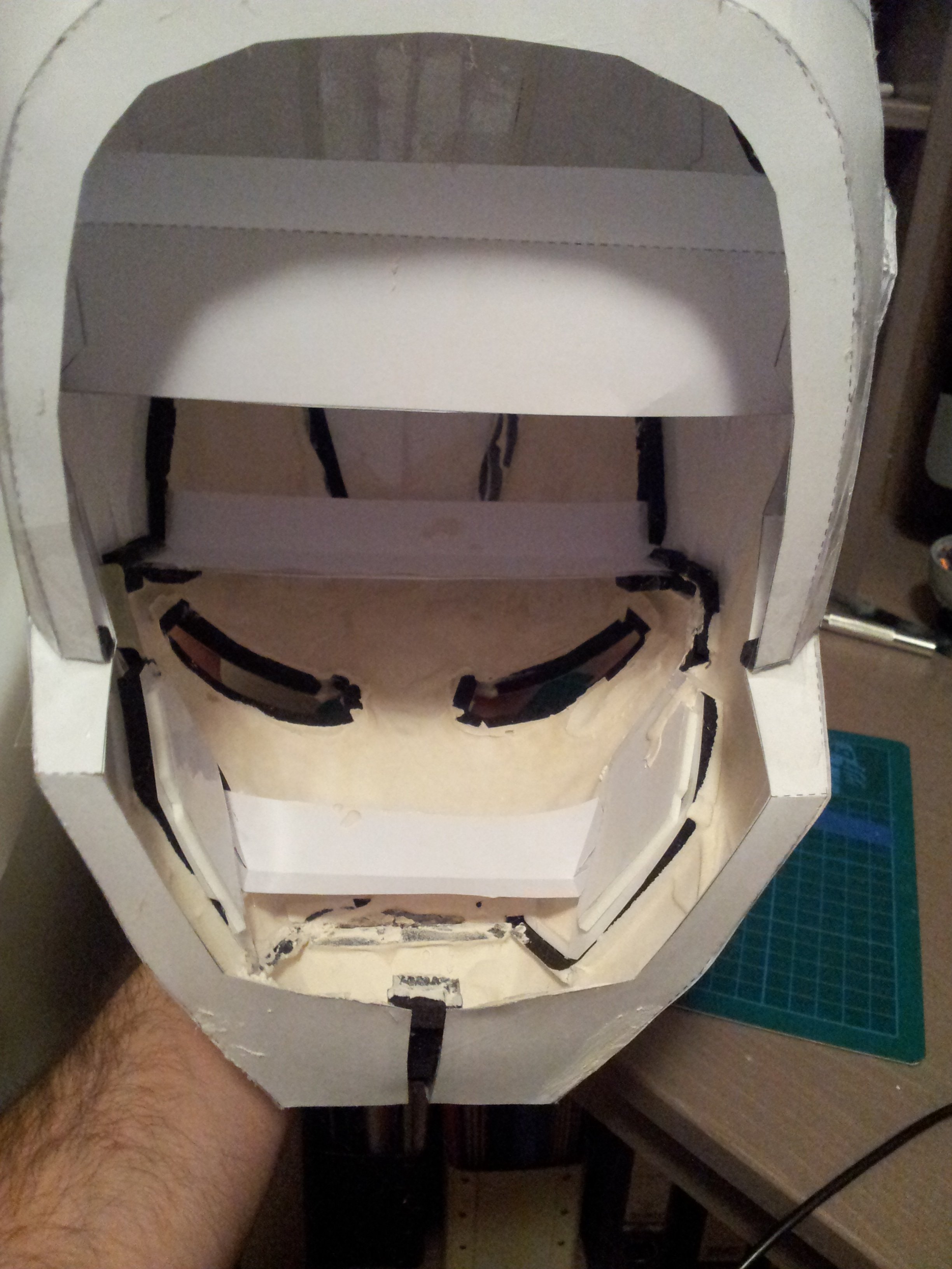

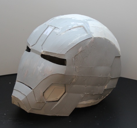

Now, that was something i could work with! Even though this time the scaling went wrong and the helmet was way too big for me. But that didn't matter. So I started working on it. Then there was the disadvantage i noticed: When you sand through the laminating foil you rip off more than you want. So sometimes you have to remove whole pieces from the original paper model... looking like this:

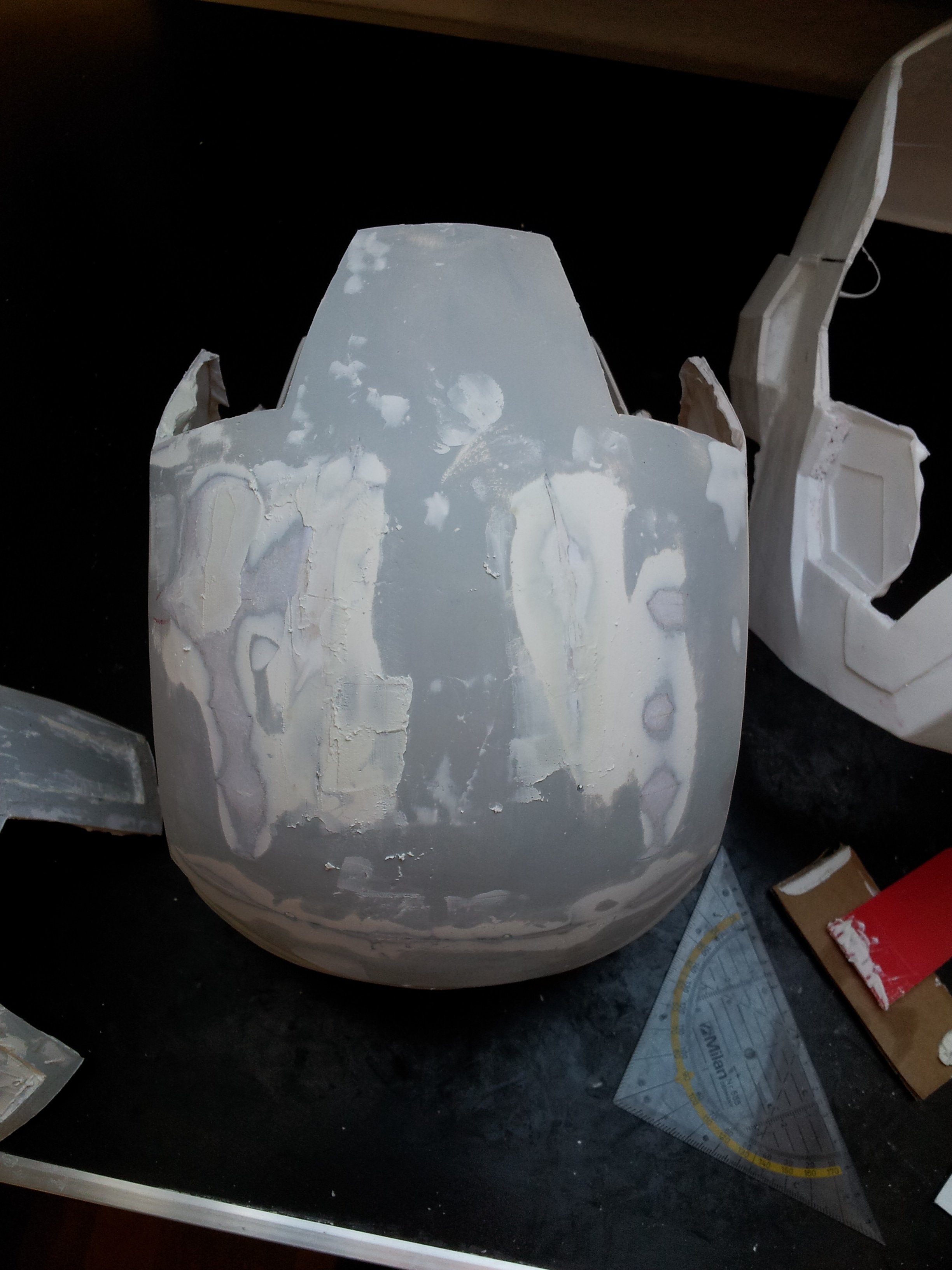

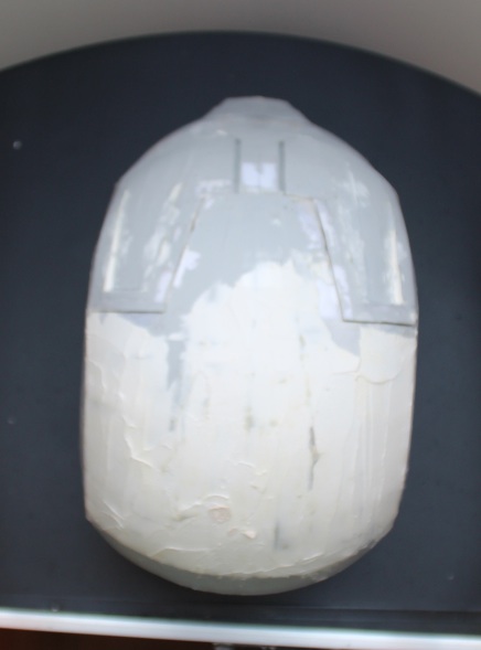

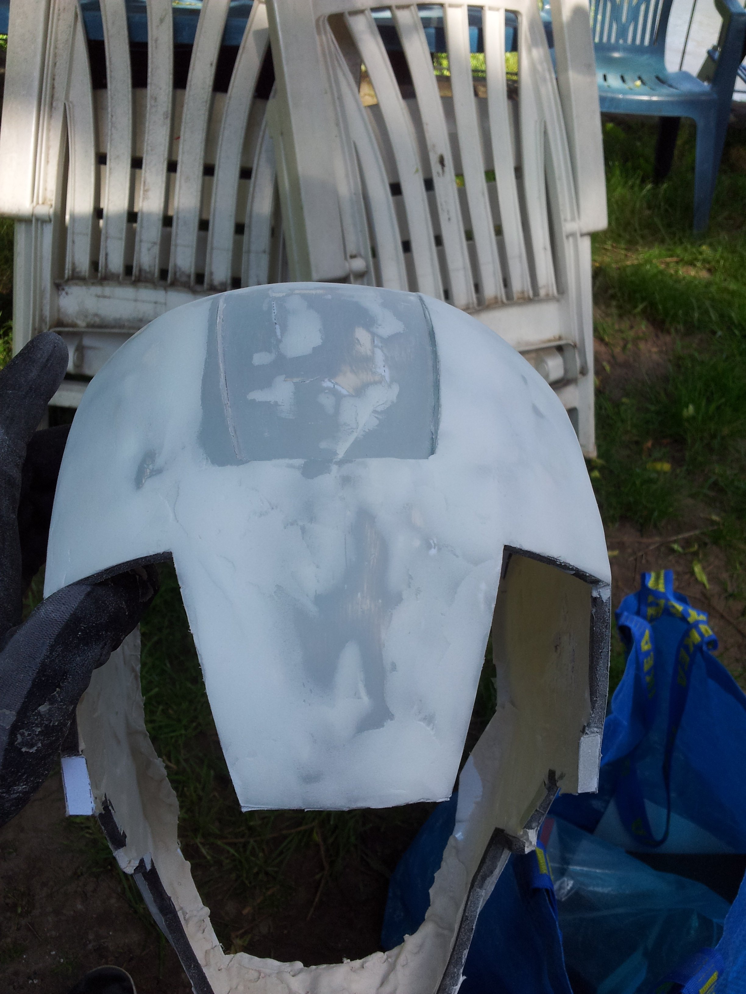

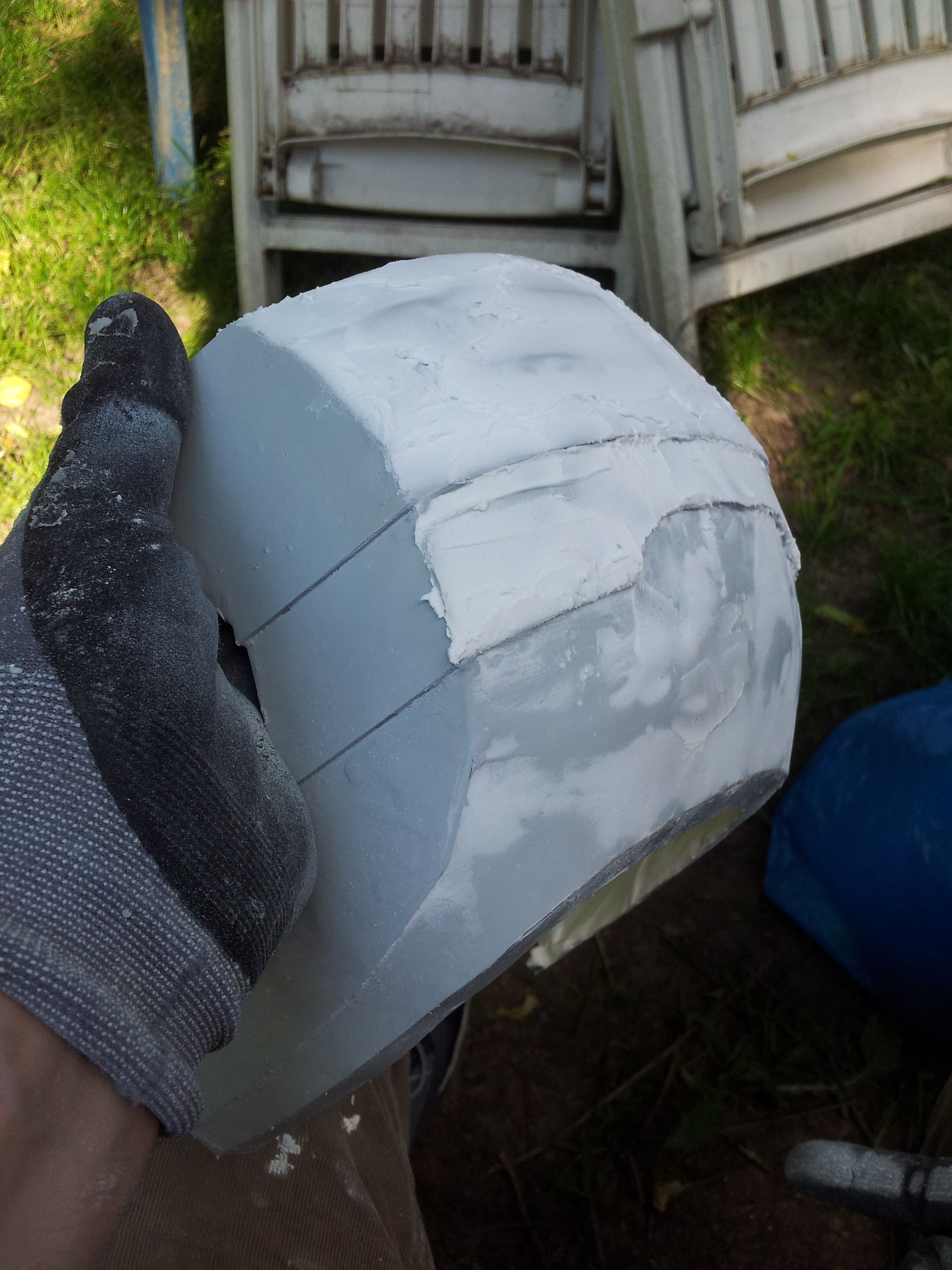

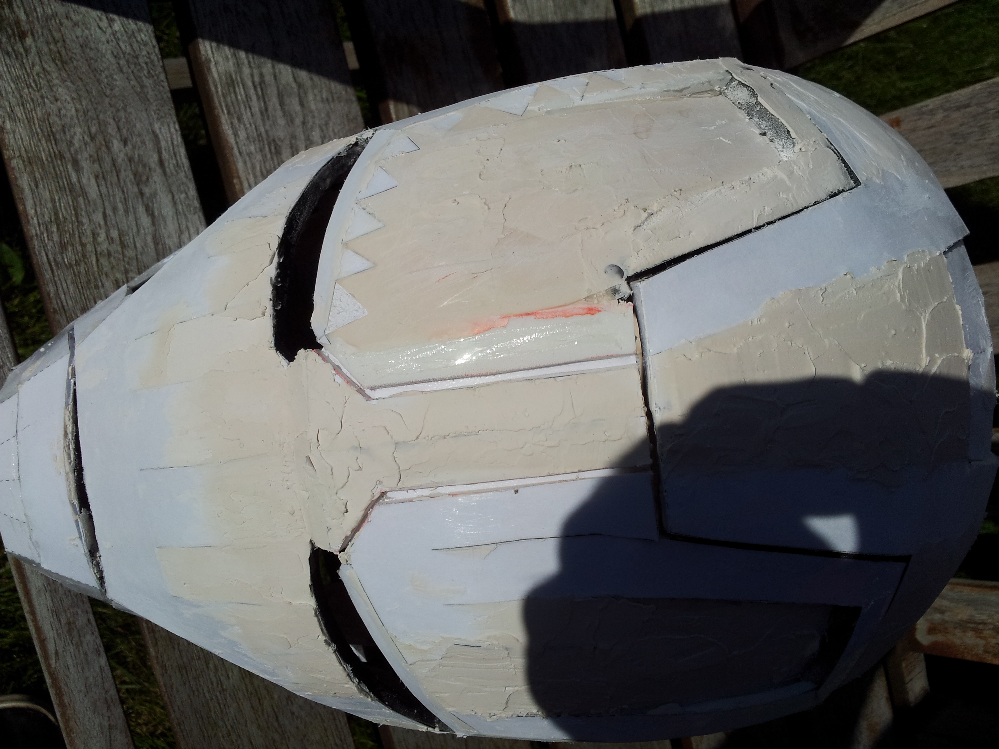

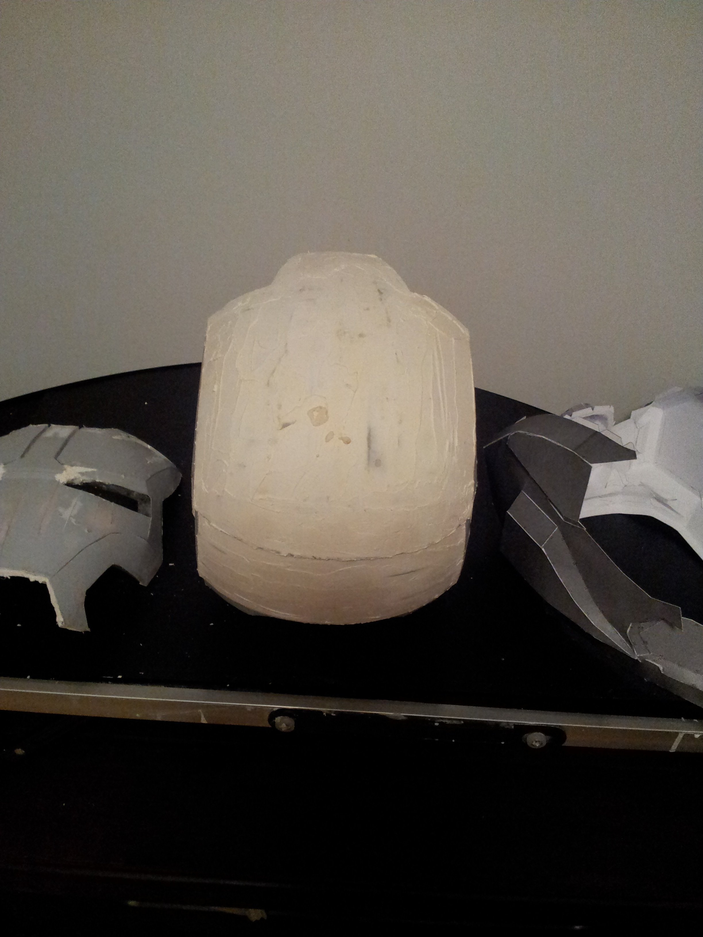

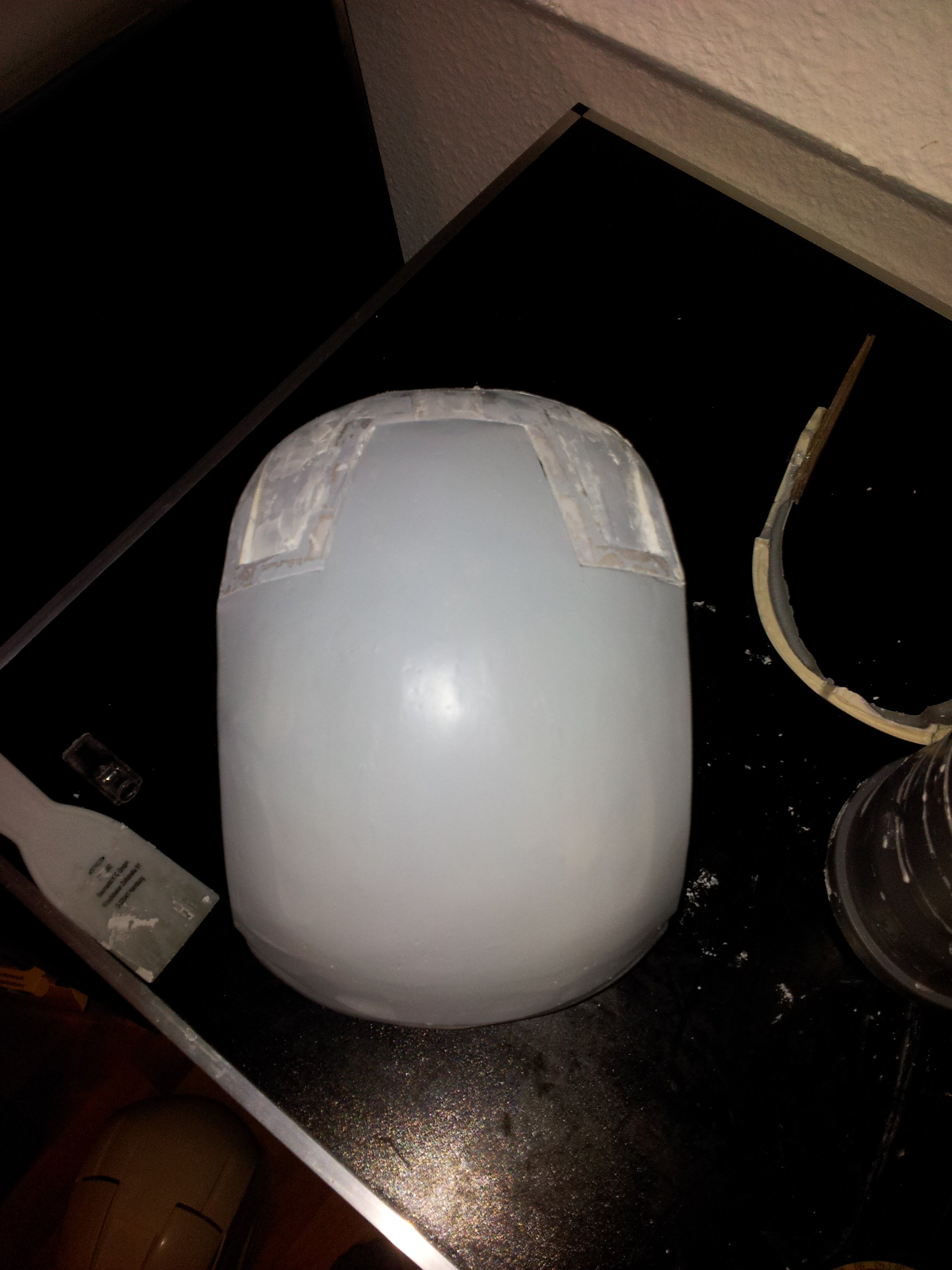

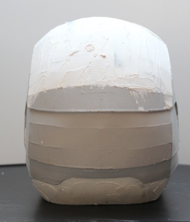

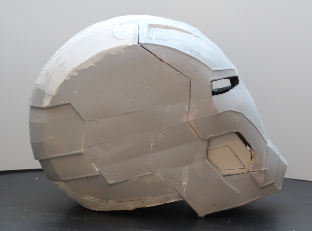

That was a little setback but nothing that some bondowork couldn't fix. Since the paper was very thin that wasn't such a big problem. Note to self: next time laminate only one side of paper and use a medium thick paper again.
I had to deal with that problem in some places so I had to to some bondo-work. Speaking of which, since that stuff is not good for your health and I was looking for alternatives. I found some woodfiller. Like the name says: It is used to fill holes in wood. It has very small grains and has a very fine consistency. It's also pretty hard once it hardened (doesn't take long... 20 minutes for 3mm thickness). It is not toxic and can be sanded pretty easily. Awesome stuff. I stocked up on that instantly.

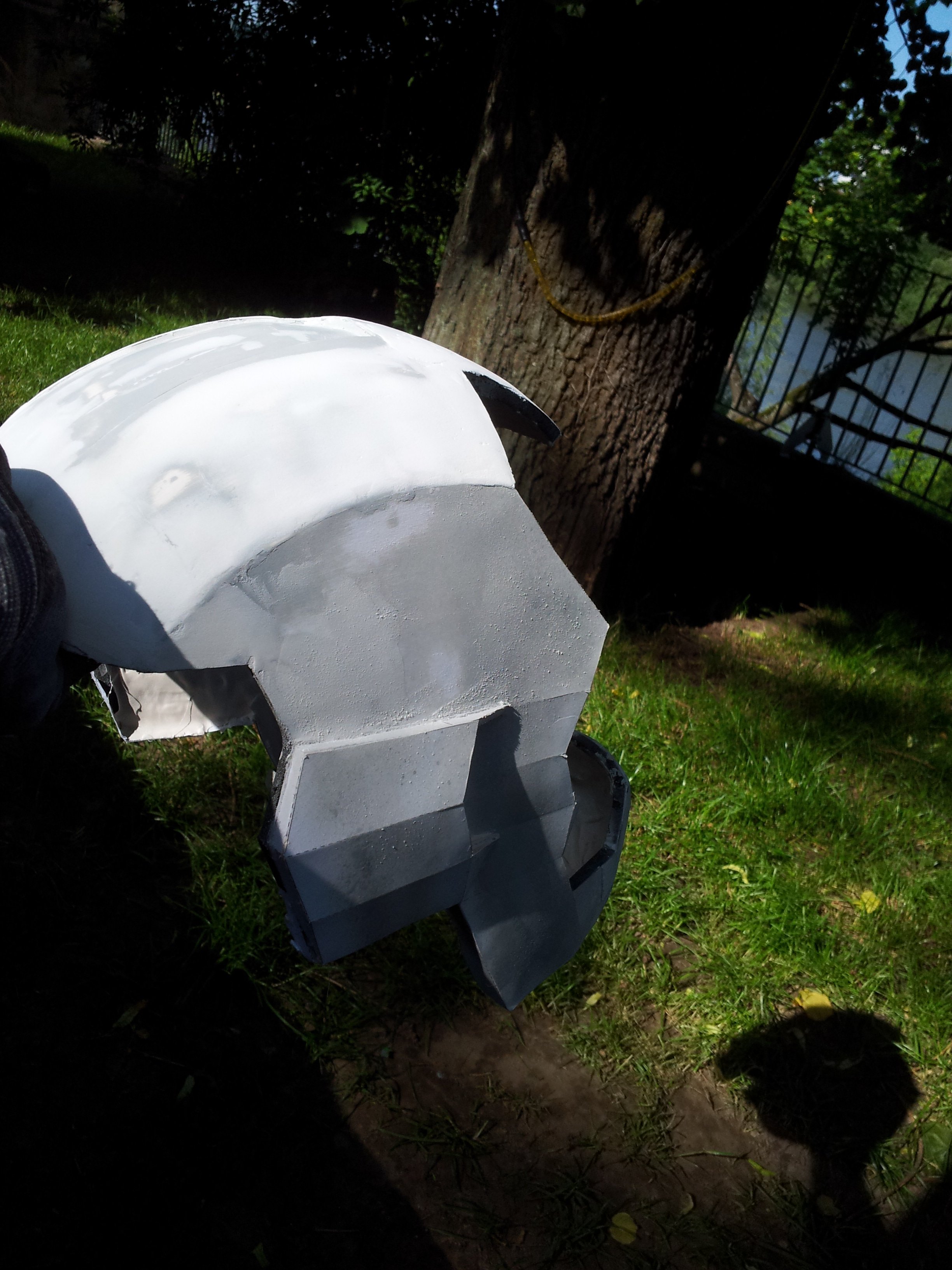

After sanding on the laminating foil proved to be a bigger pain in the A** than I thought: I called it a day and went ahead and painted it:
2013-07-09 18.07.02.jpg2013-07-10 17.54.06.jpg2013-07-10 17.55.26.jpg2013-07-05 16.32.49.jpg2013-07-10 17.54.38.jpg
It looks okay but not perfect. It still has some small bumps and imperfections but I am done with this helmet. I might consider doing a run for people who are interested and wanting to work on it a little themselves. It is for pretty big heads. I will post some more information on that later.

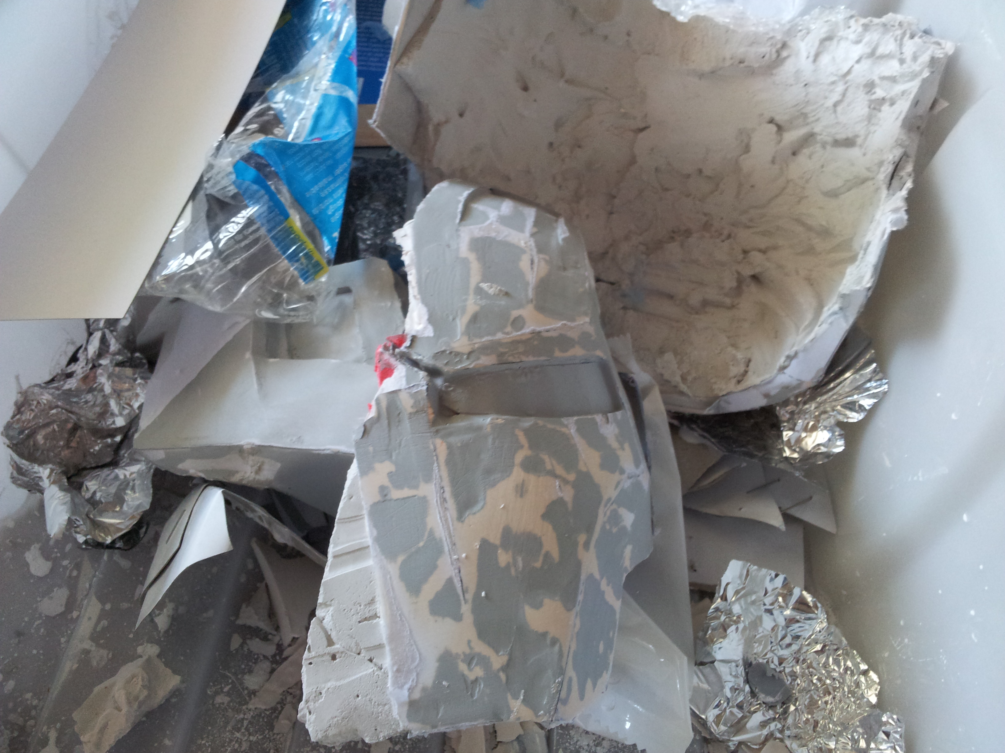

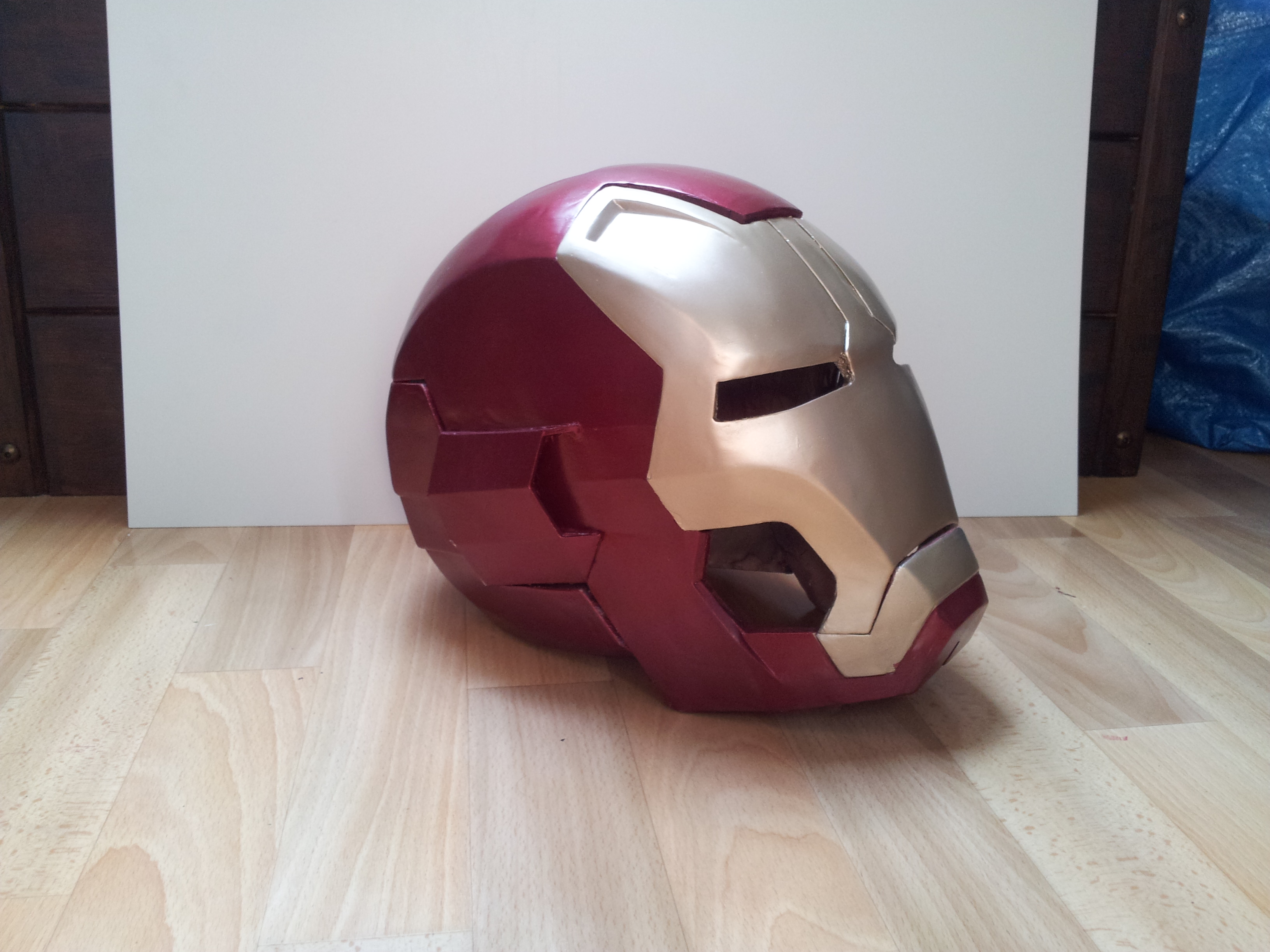

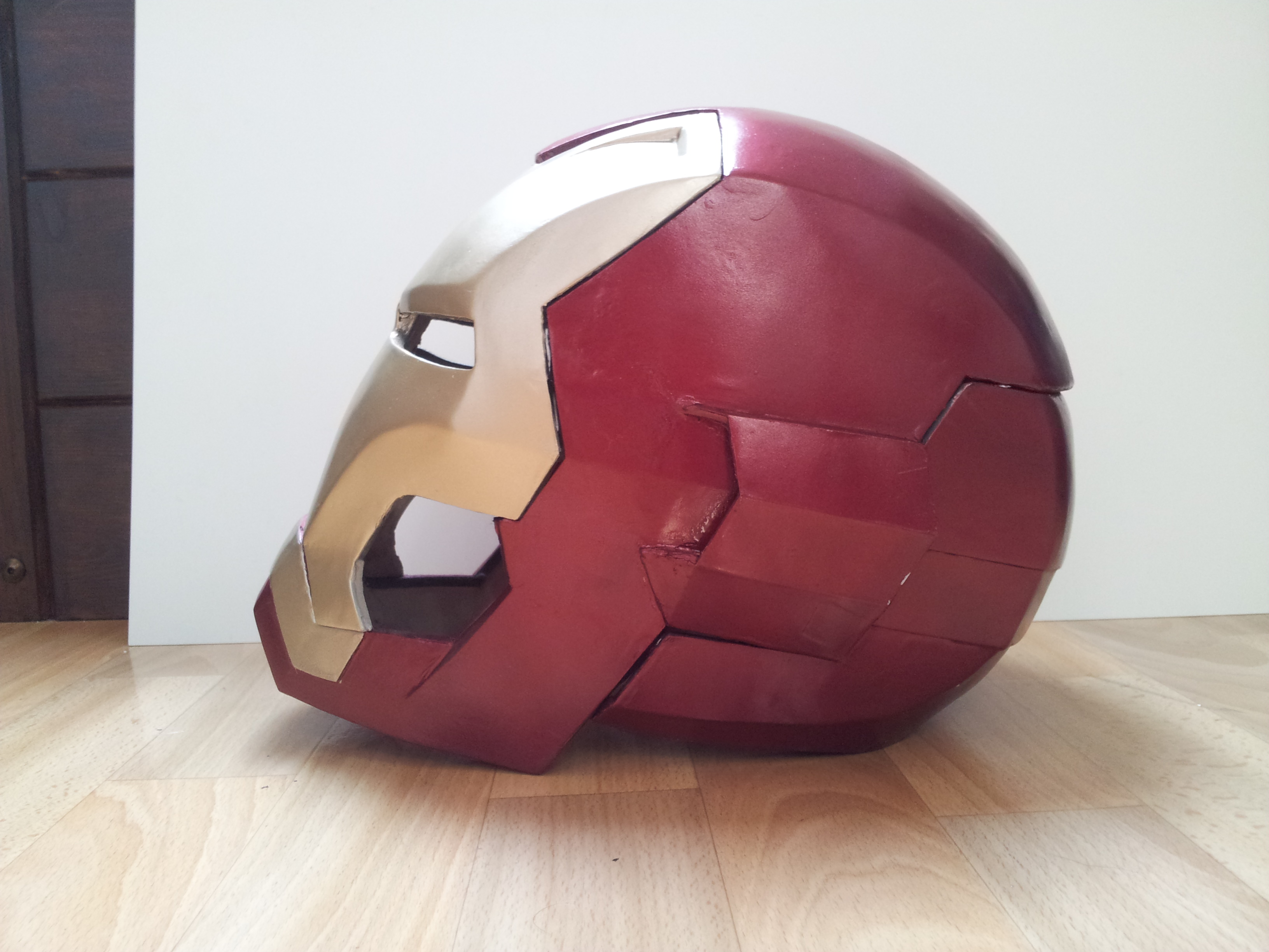

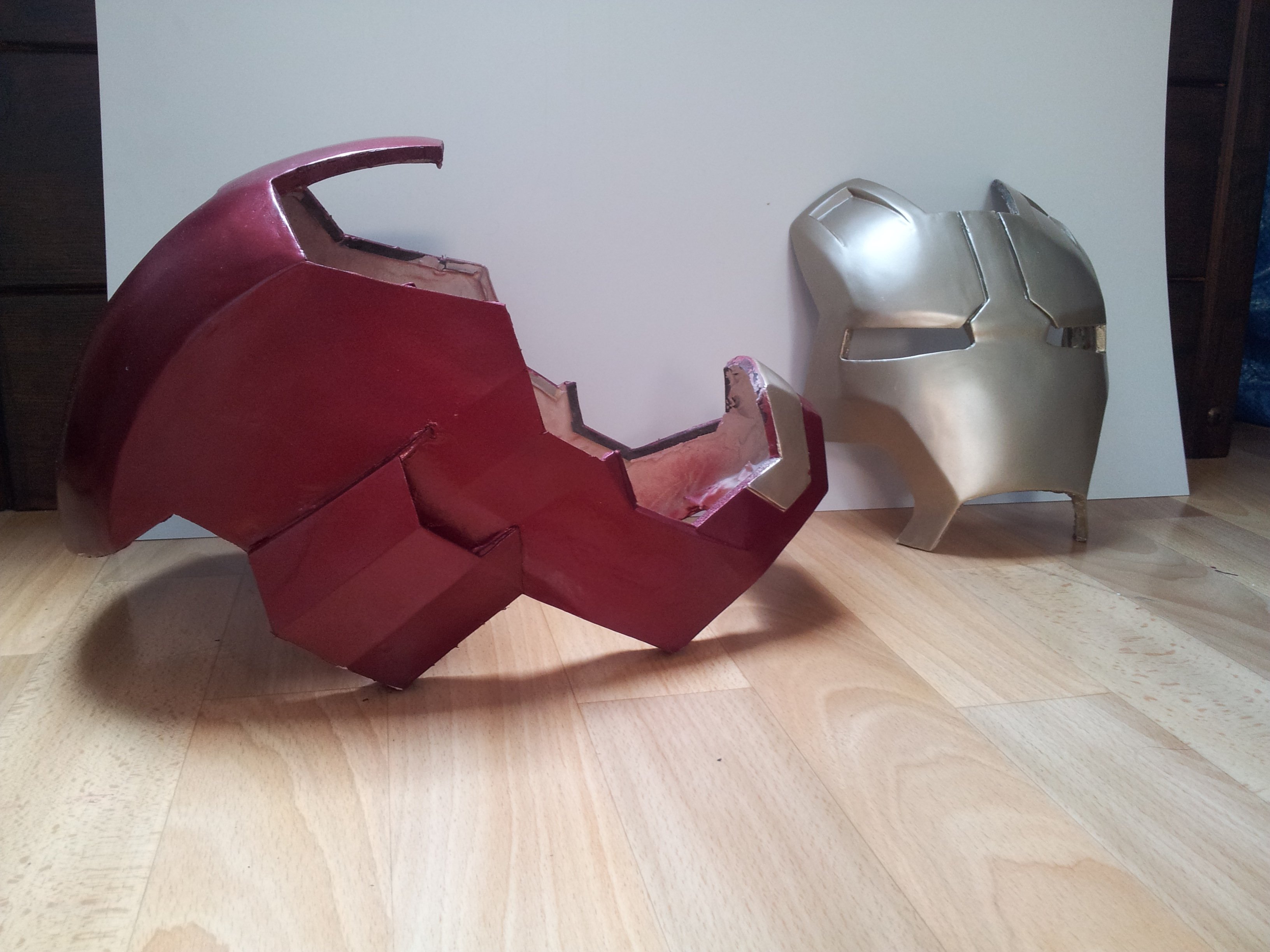

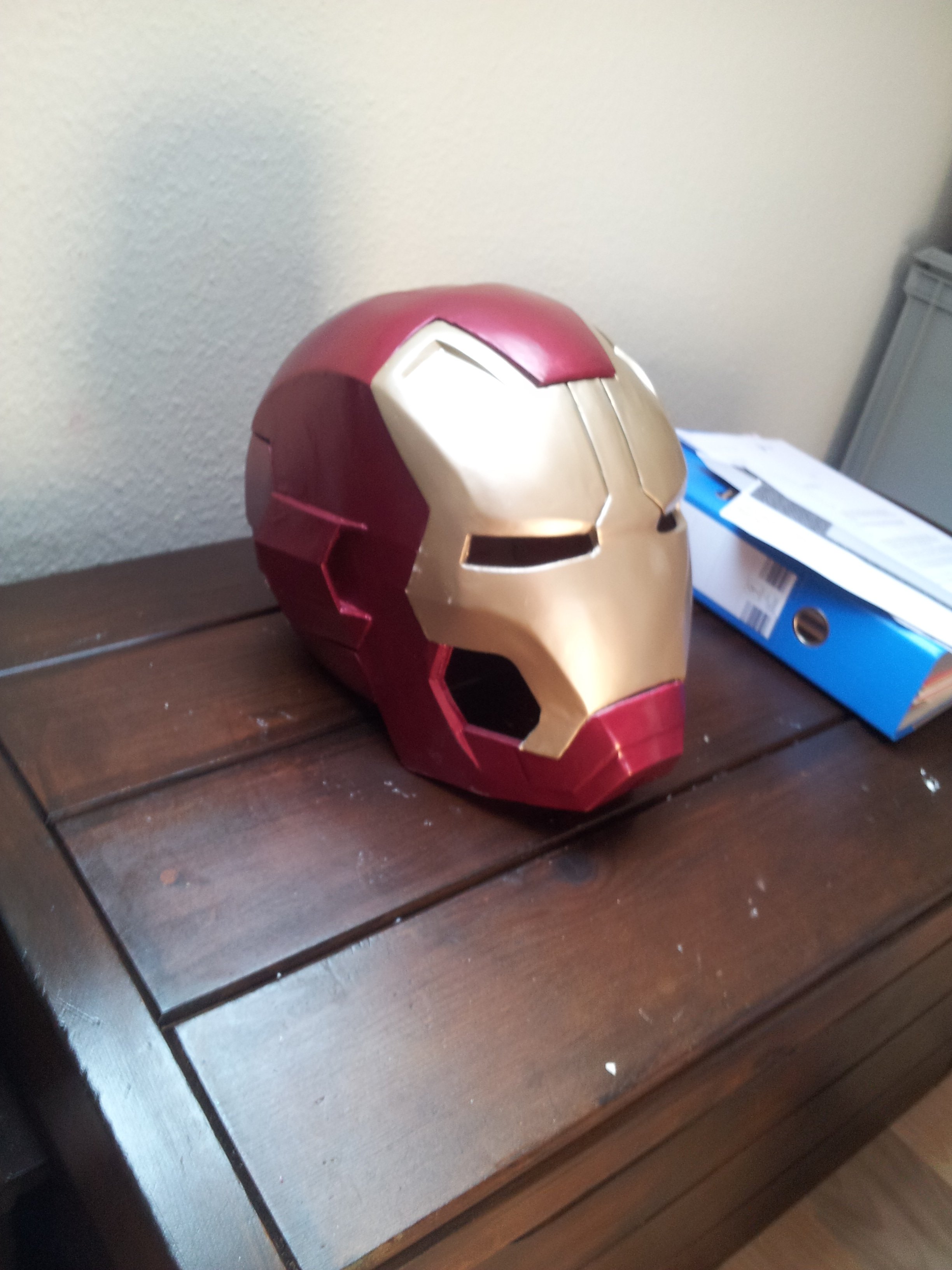

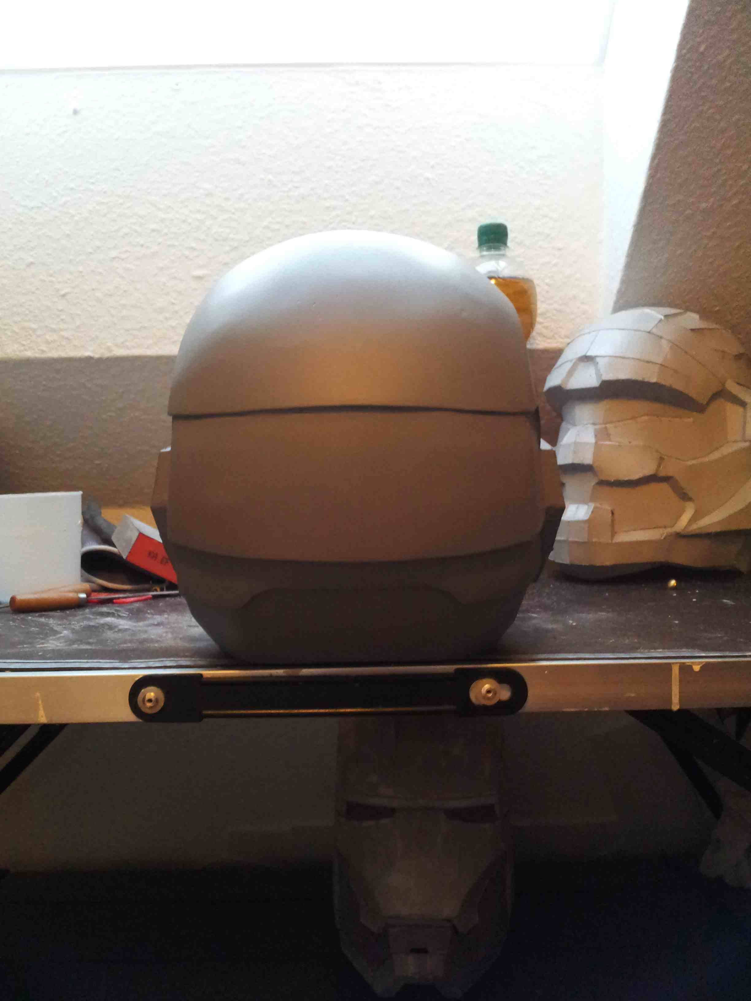

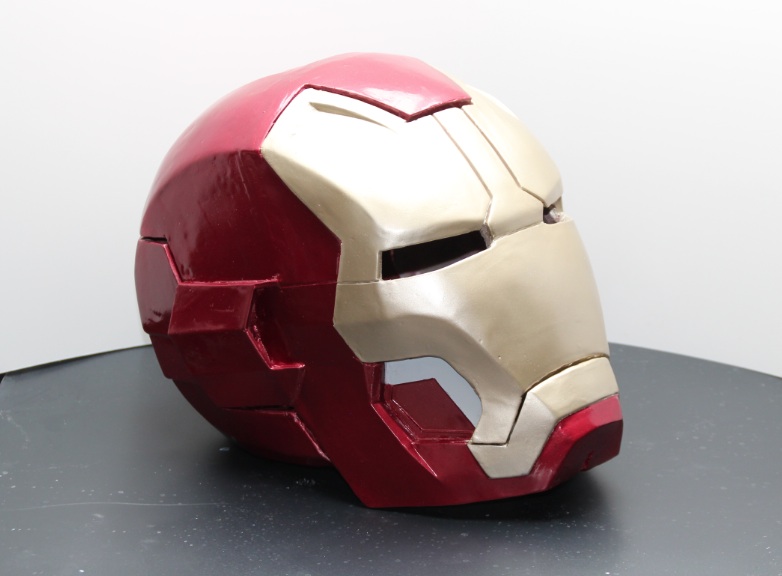

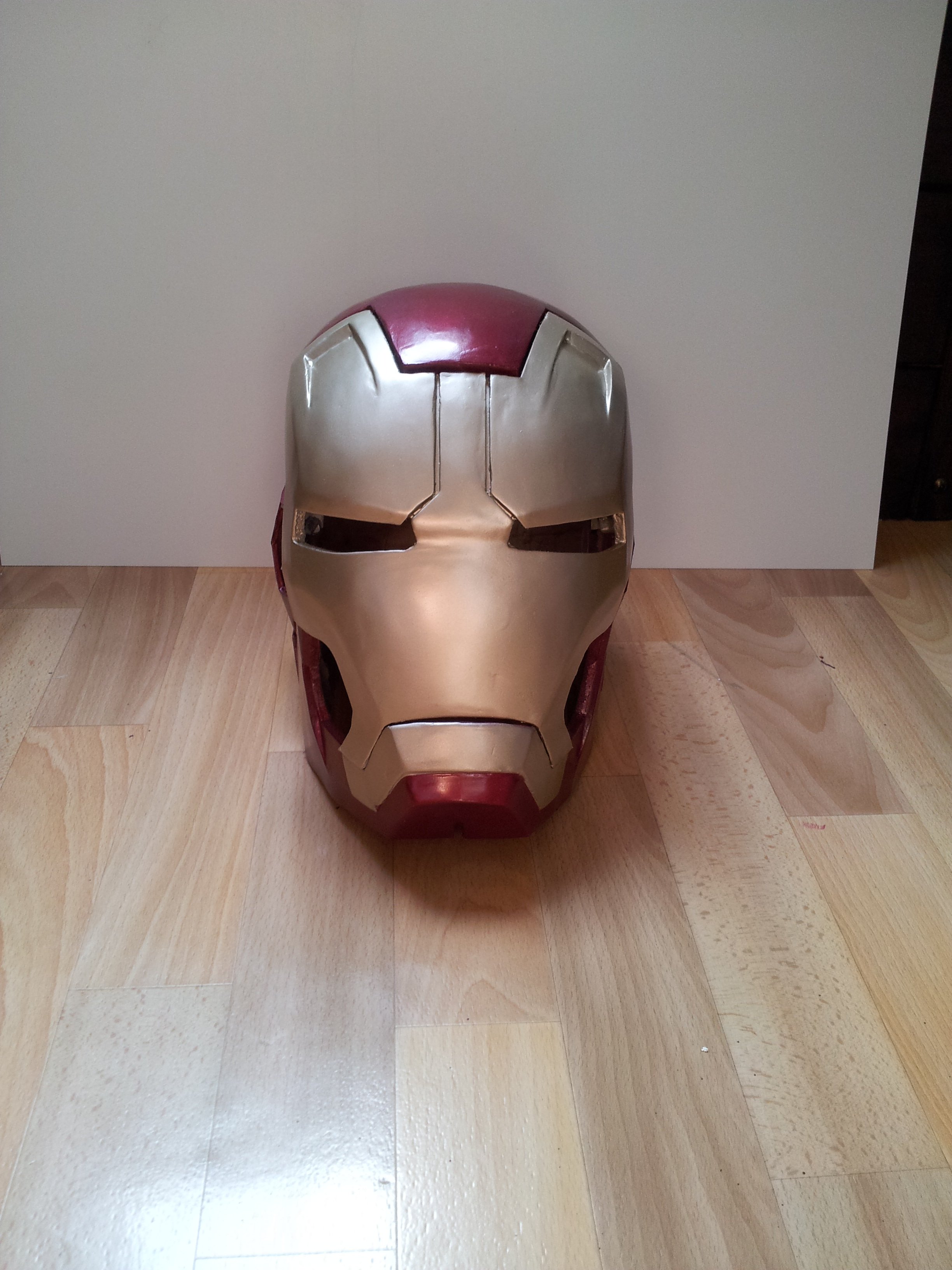

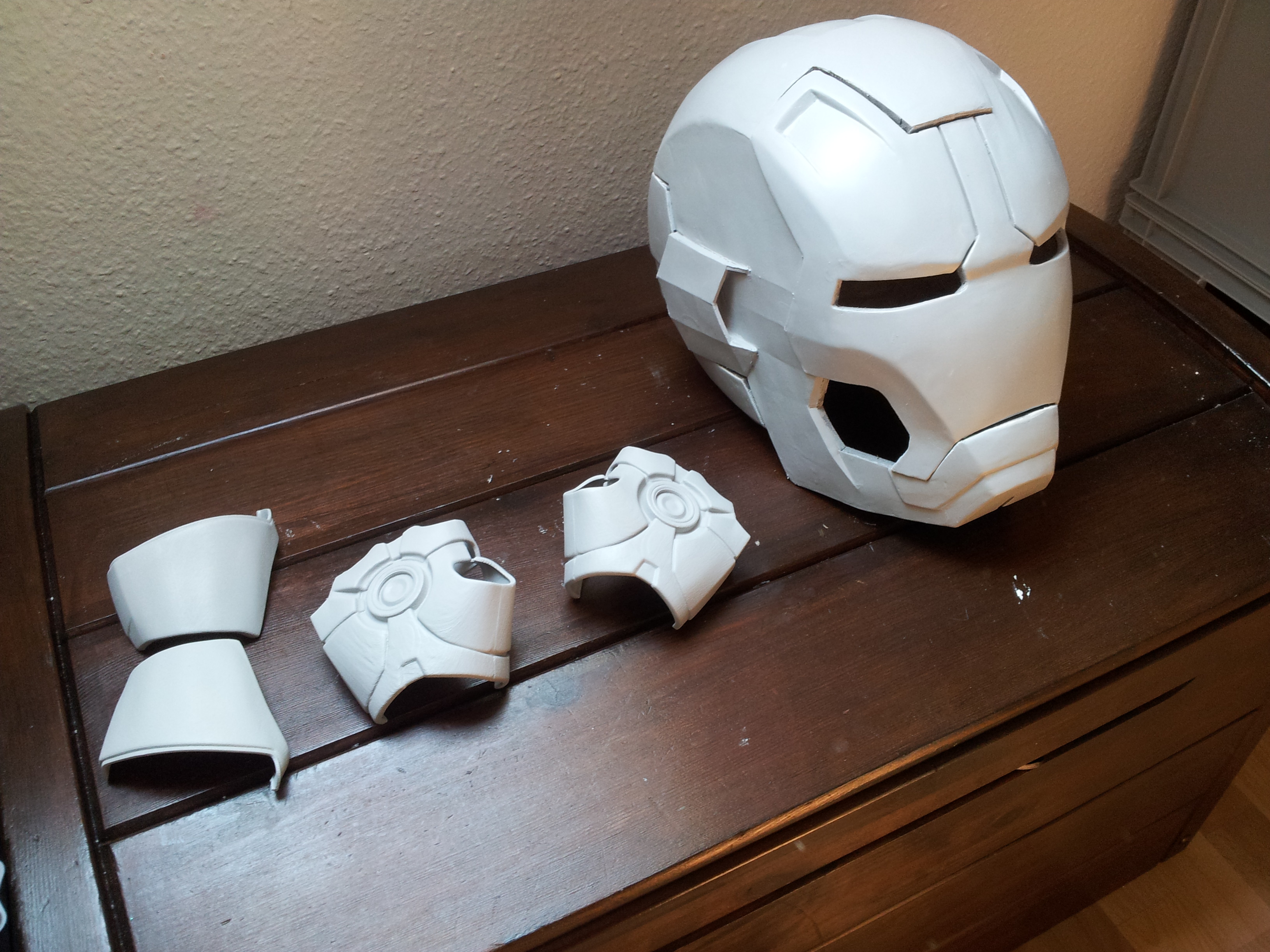

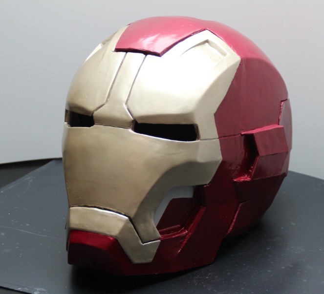

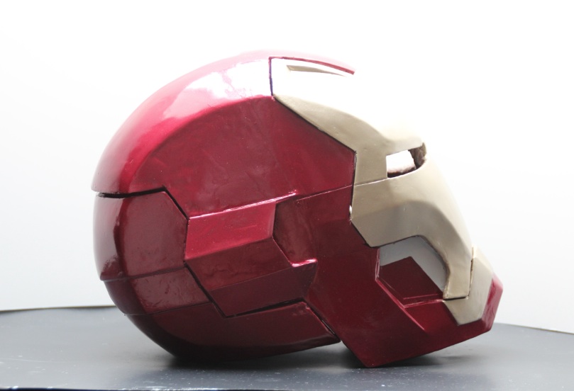

After some problems figuring out how to properly mold I finally pulled my first cast and I'm planning on doing some more next week. This is what i got so far. I probably should have sanded a little more but I got too excited ;)
2013-08-07 14.28.56.jpgironback.jpgironfront.jpgironfrontleft.jpgironfrontright.jpgironright.jpg
Next up is the smaller version.

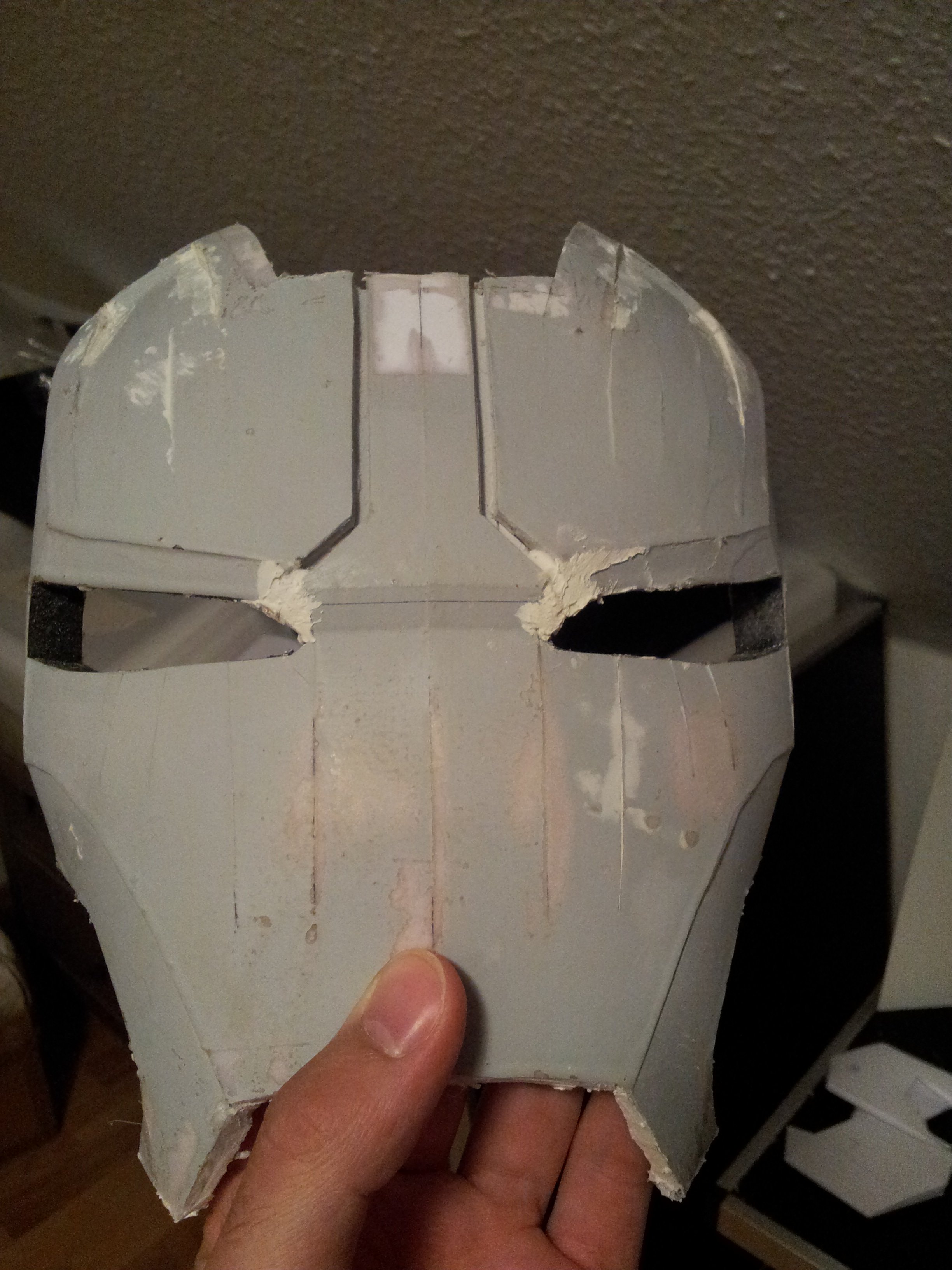

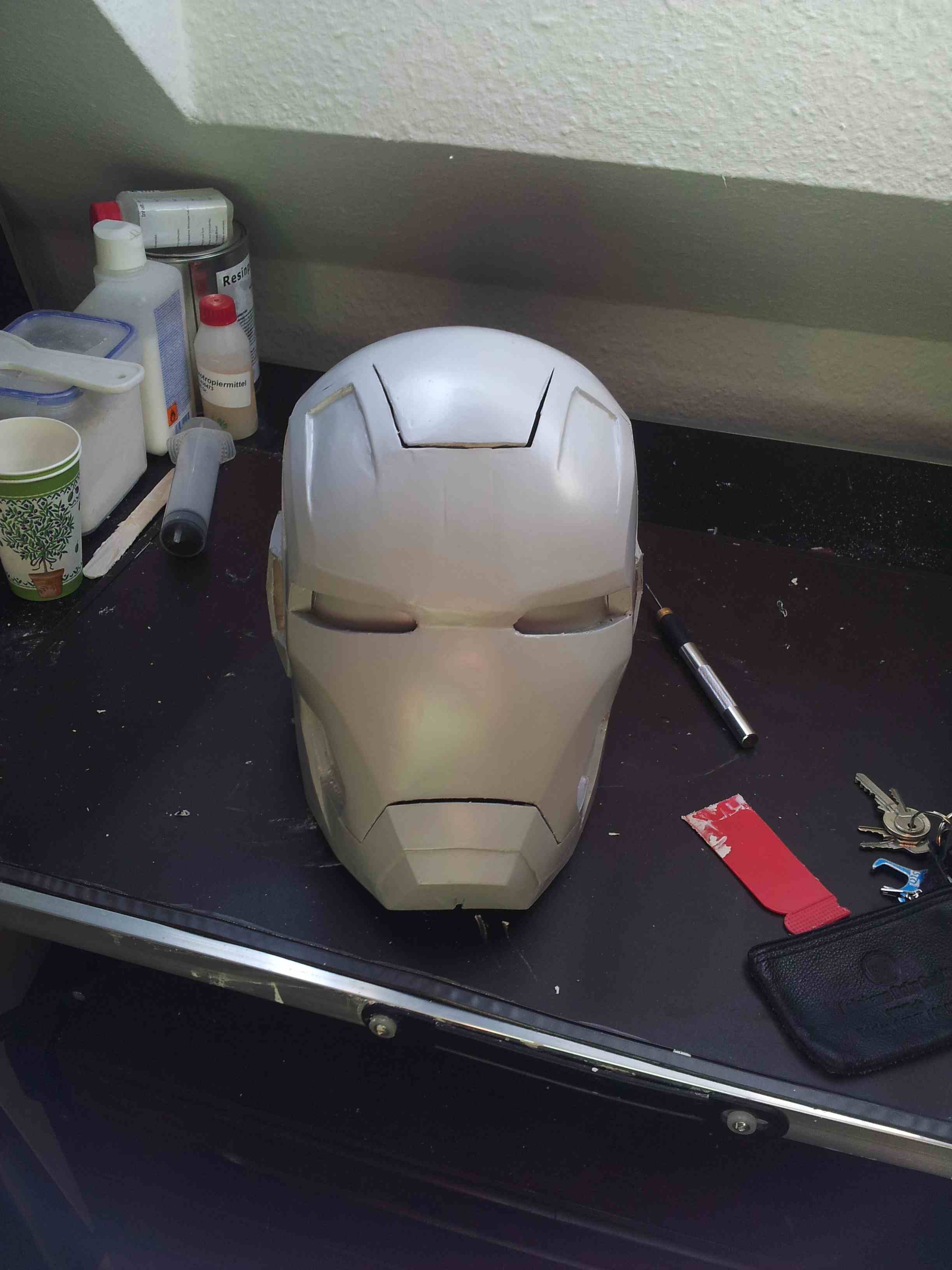

The next time I only coated the thicker paper (160gr/m2) from one side. Which meant i tore the laminating foil in half and put it through the machine with the paper. This way I had one water resistant side (inside of the helmet) and one side that would be easily worked with... sanding and applying 1K-Putty. So i assembled the pepakura and resined the inside with Acrylic Resin. Then i brushed a light coat of it on the outside. Since i tried to be as clean as possible during the pepakura stage... I don't have to sand as much. So I primed it to be able to see where there would be the most work. This is what I came up with:
As you can see, i applied some 1K-Putty lightly in some of the places very lightly. Sanding this stuff is a charm and you end up with a very smooth finish. Also: I used polystyrene-sheets in some key-spots (like the underside of the jaw) to ensure that there is no warping. That results in a very symmetrical build.
The ears are still missing. I am going to put these on in the very last stages.

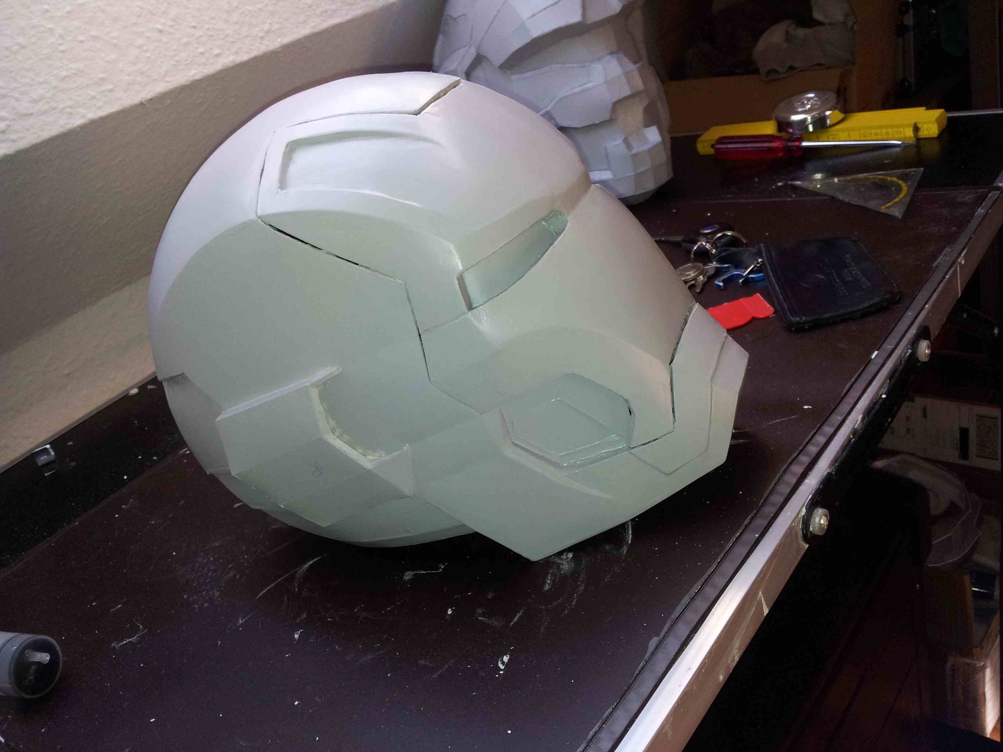

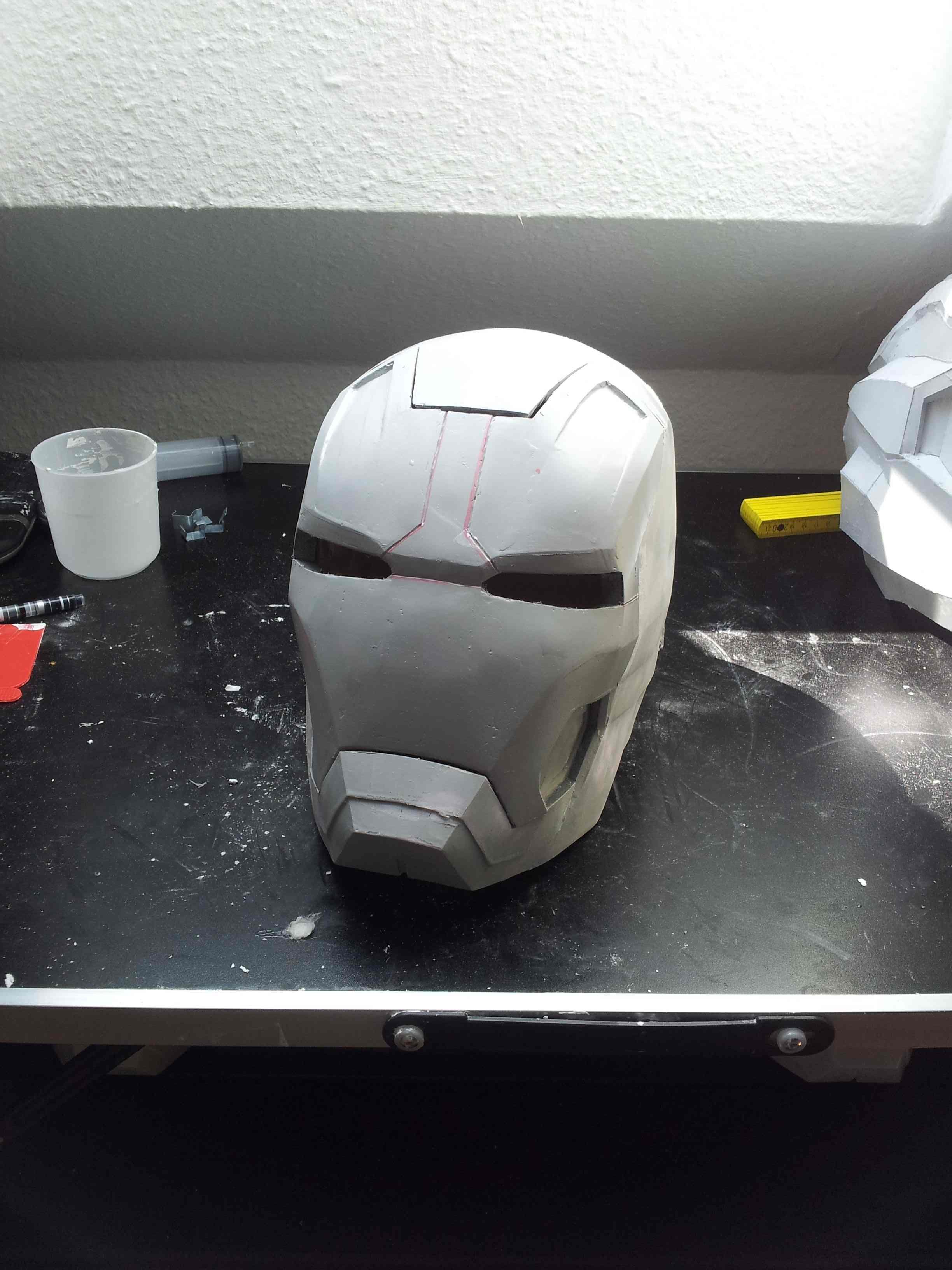

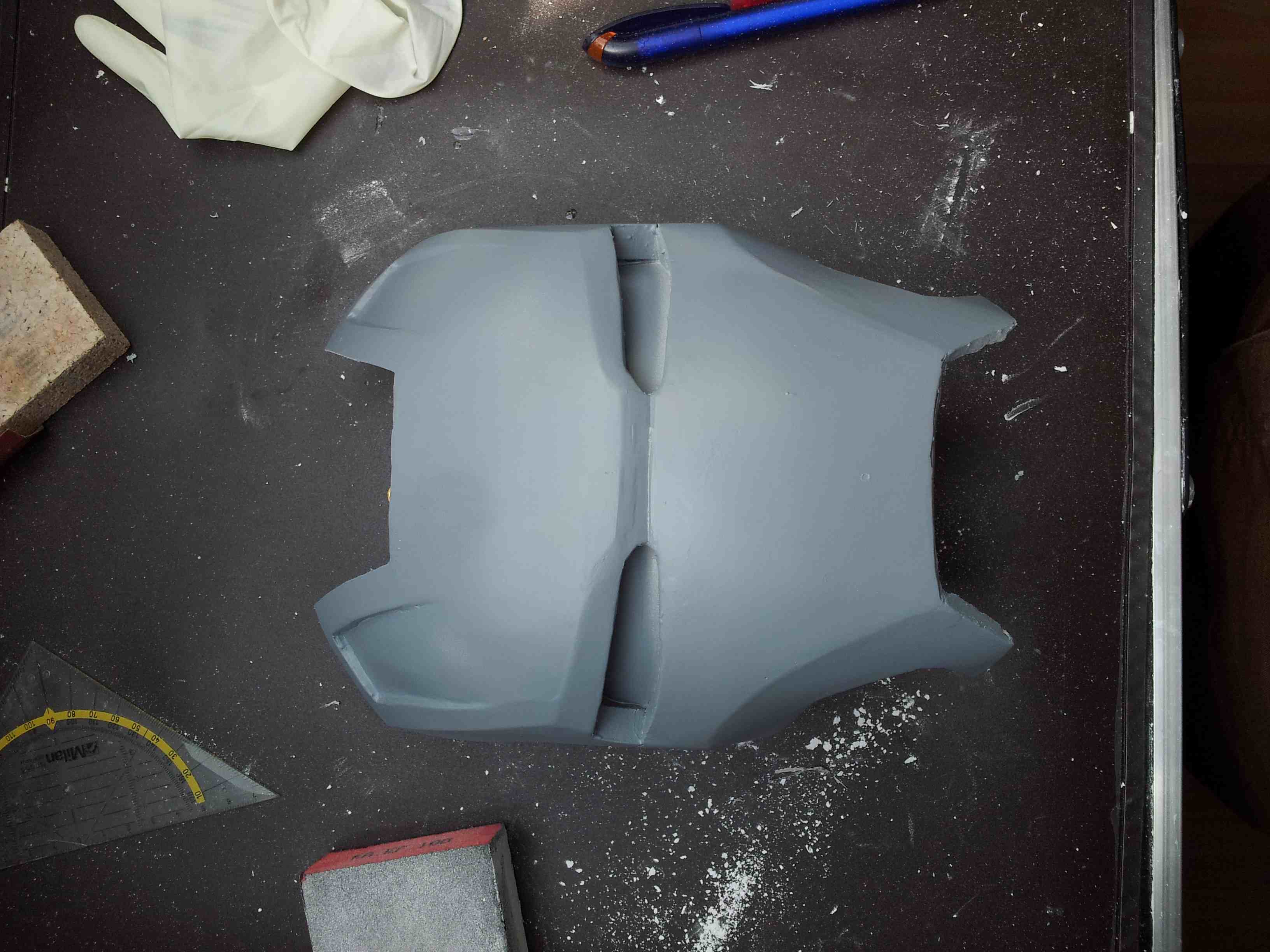

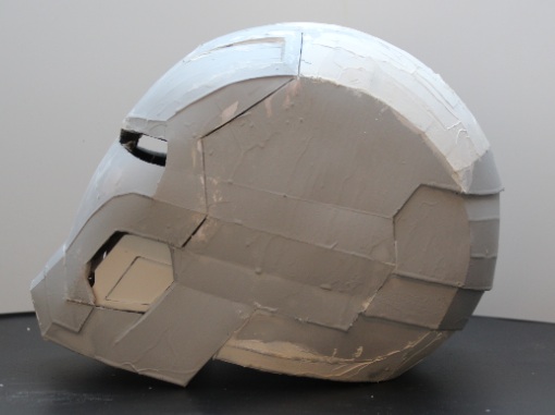

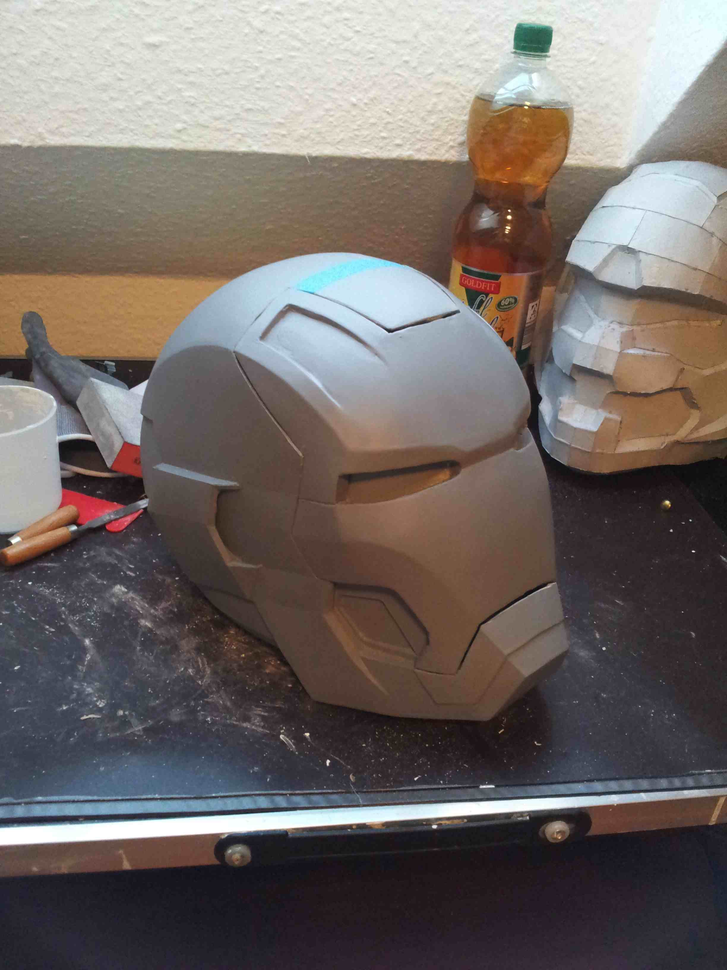

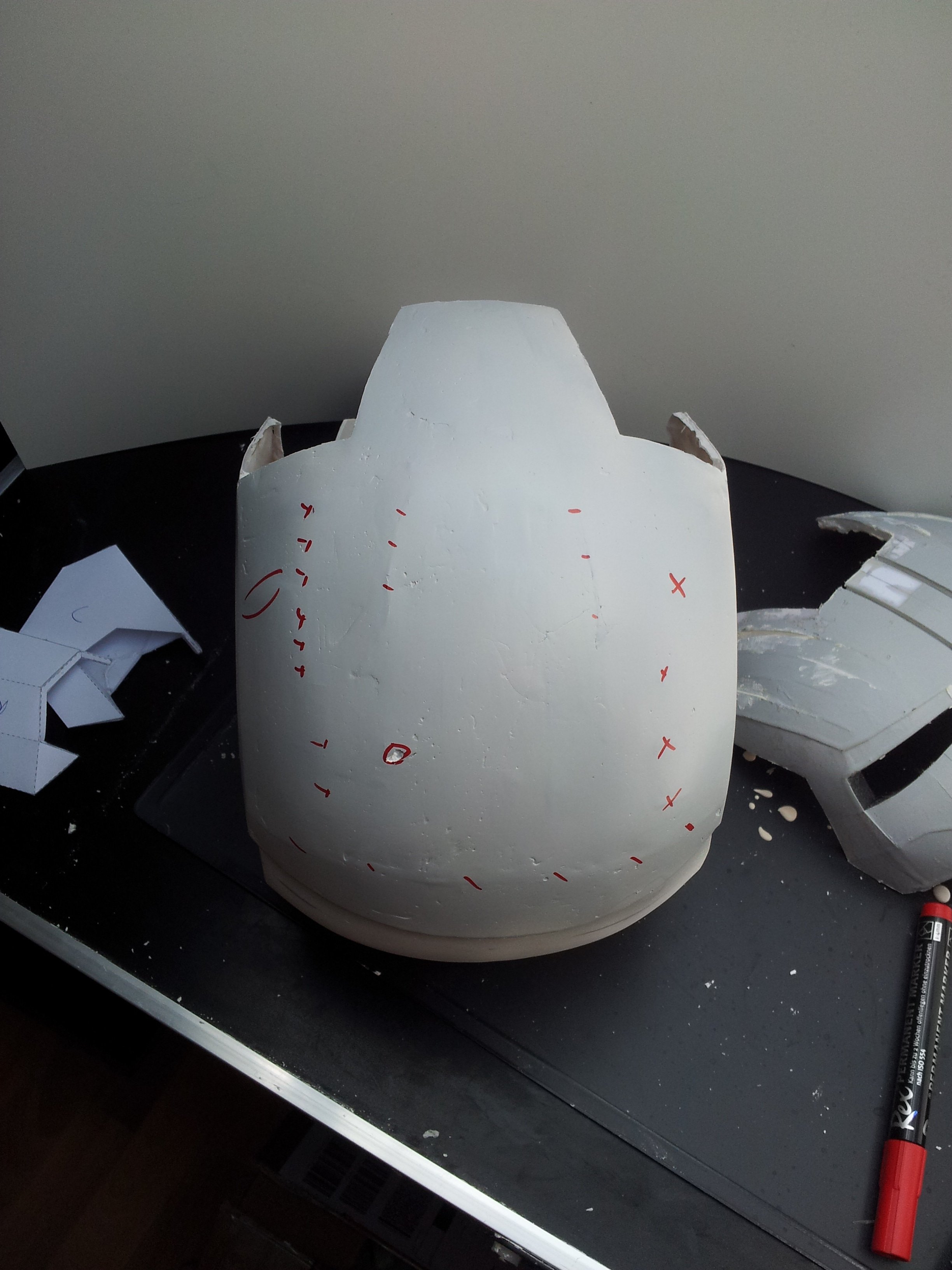

I had some time to work on my second helmet. I needed to sand the thing down and work on the eye section.

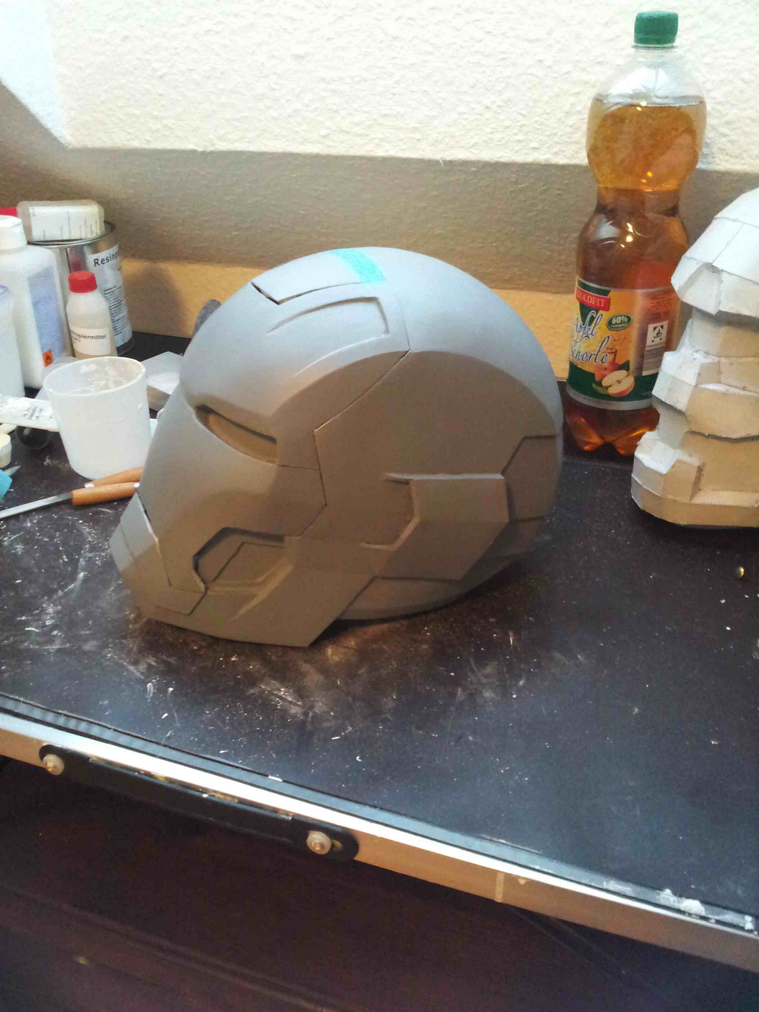

After that i put a light coat of primer on it to see where it needs more work. I marked some imperfections and areas that needed some attention.
And after sanding again...
2013-08-16 23.39.06.jpg2013-08-16 23.39.19.jpg2013-08-16 23.39.30.jpg2013-08-16 23.39.39.jpg
The problem I had with breaking through the layers of paper while sanding no longer occurred here. So I guess only using the laminating foil on the inside of the paper-model its the way to go. Good news if you don't want to work with the usual resin. So much for the Iron Man helmet today.

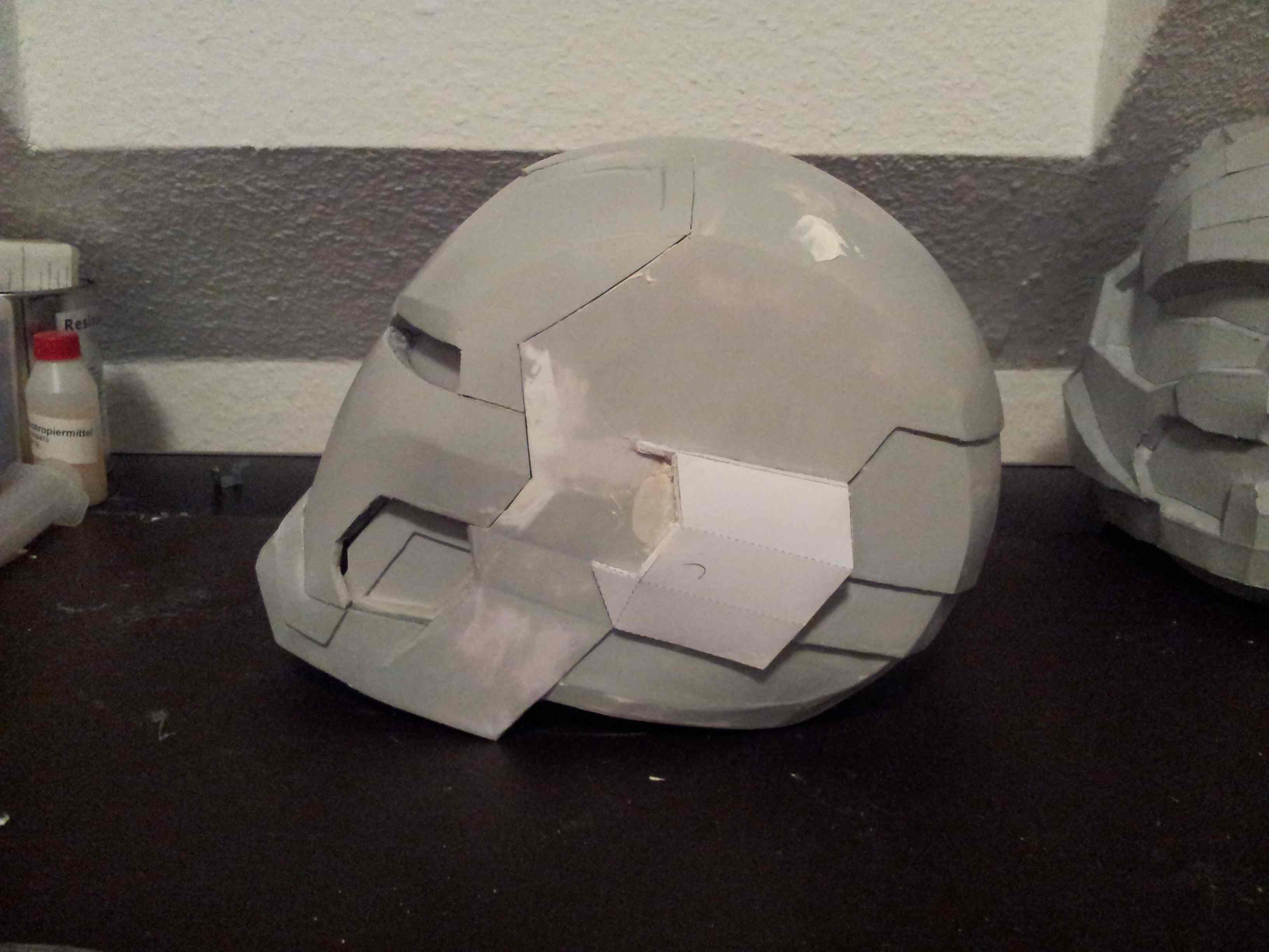

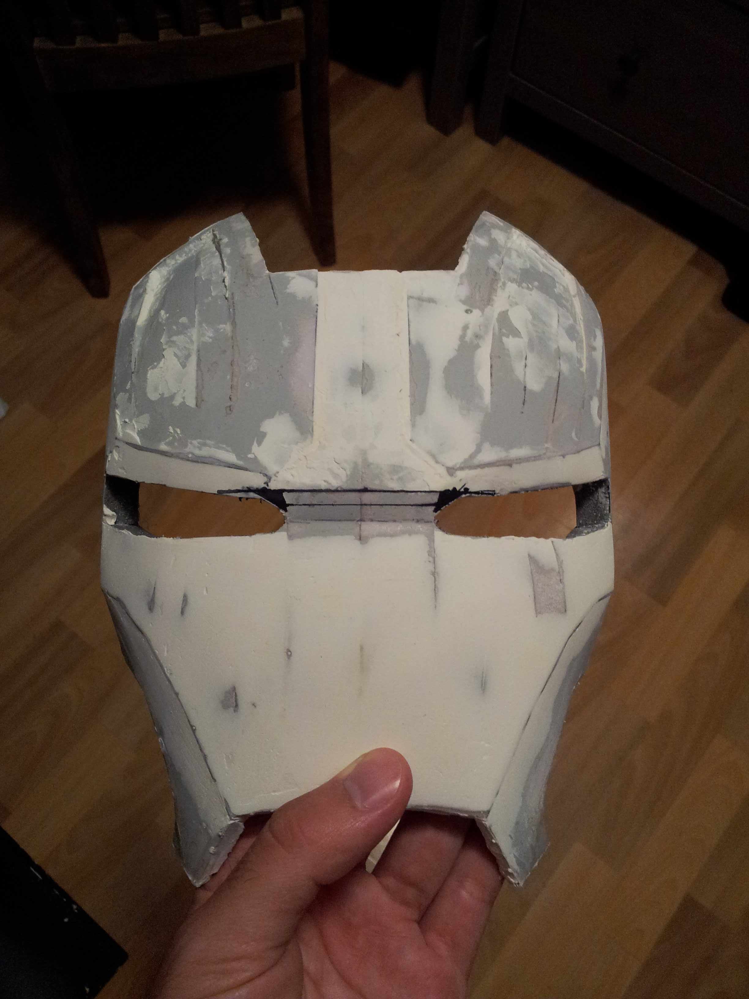

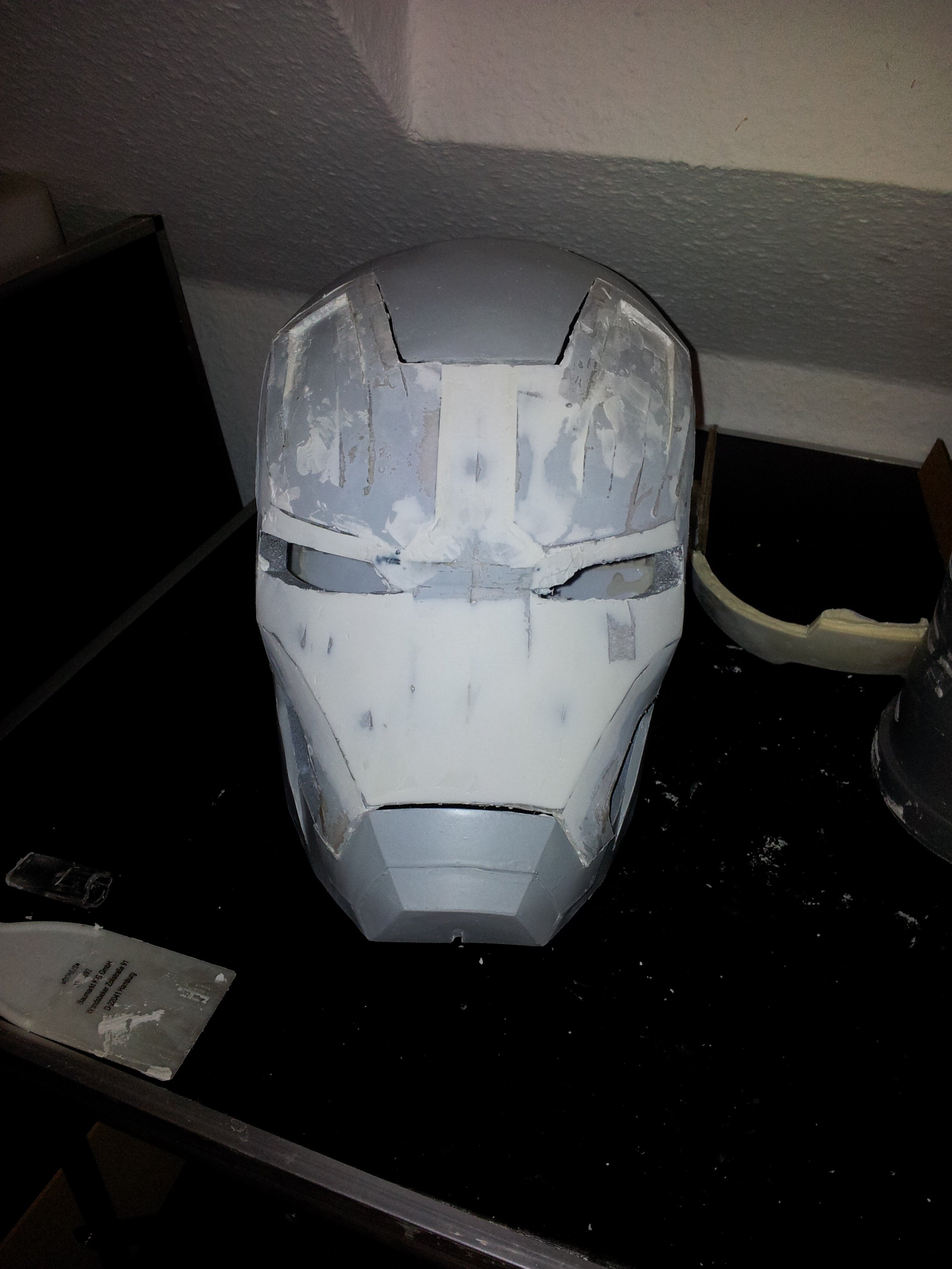

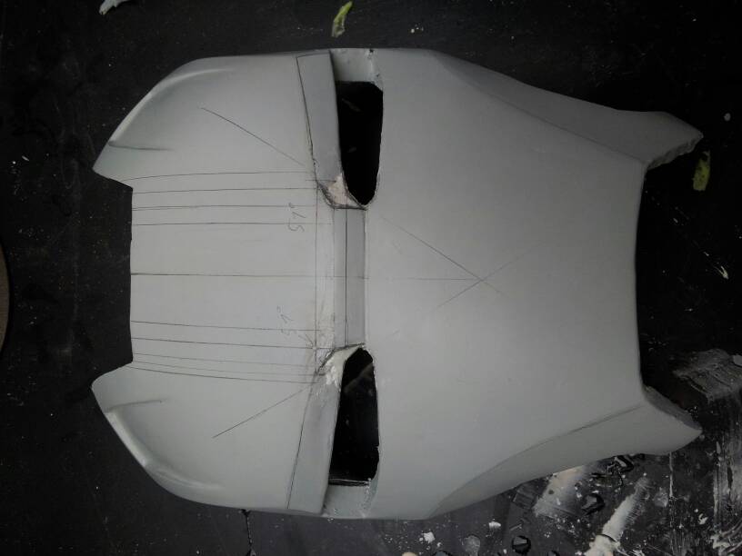

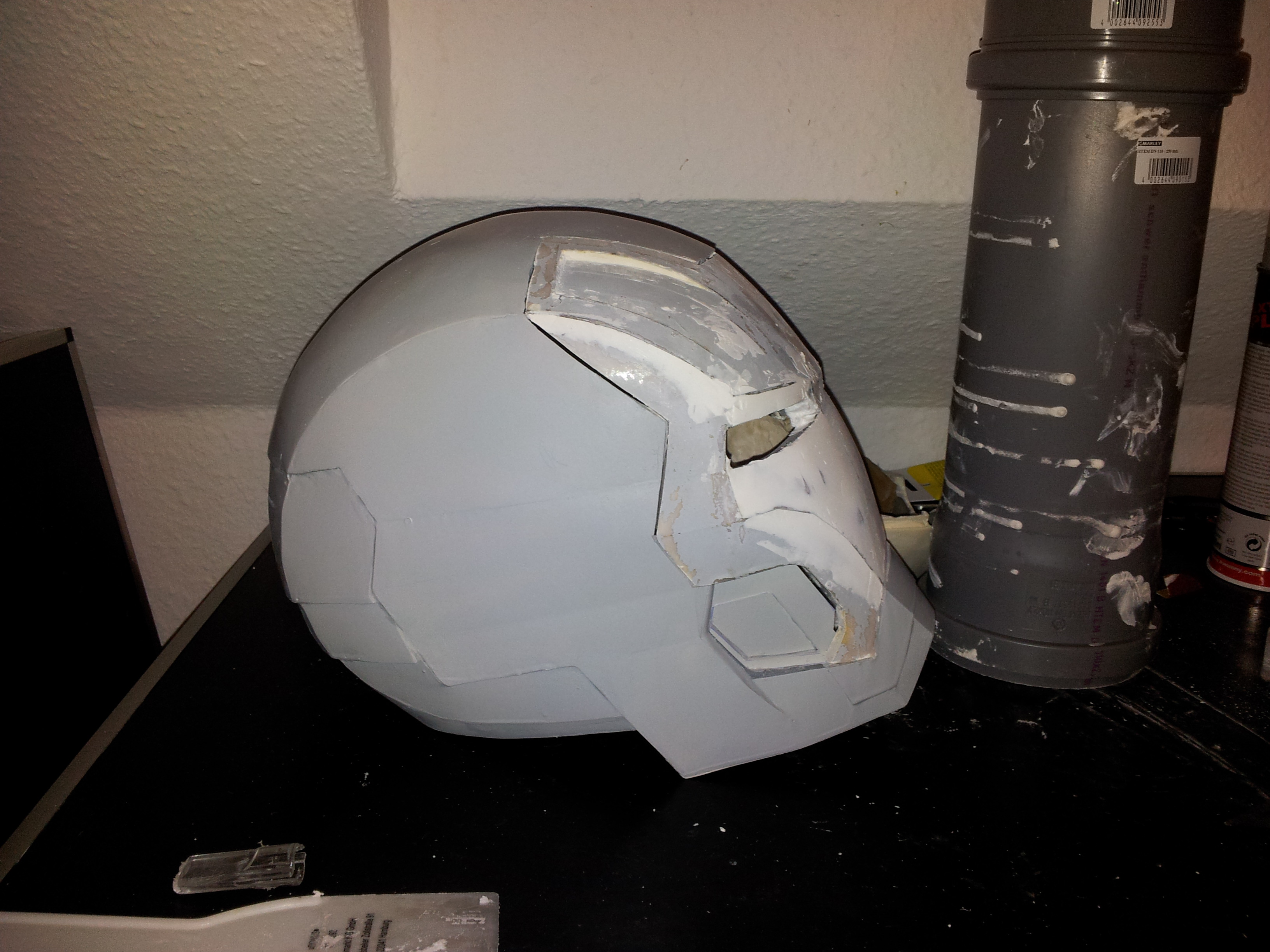

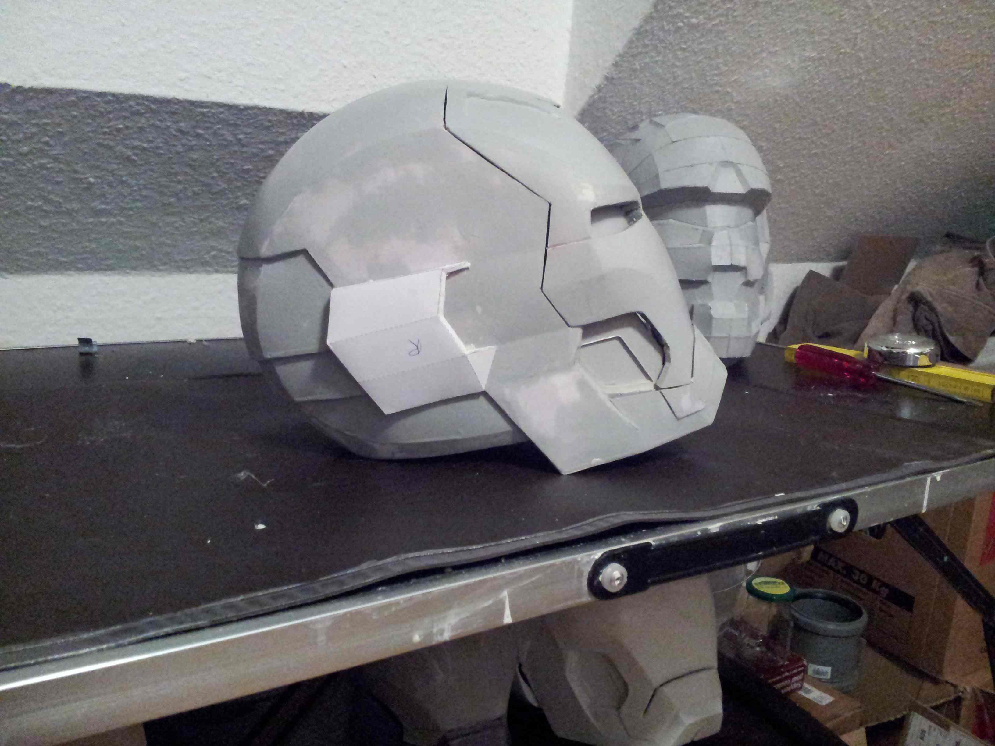

Small update: I started sculpting the eye-nose section. There was a gap there that needed filling. I gave it a quick sanding and cut the angle i painted black here. Maybe I get the time tomorrow to sand the Faceplate down.
Some small update. I got some work done on the faceplate. I think the "eyebrows" look good now. Still there are a lot of imperfections and spots i need to work on.

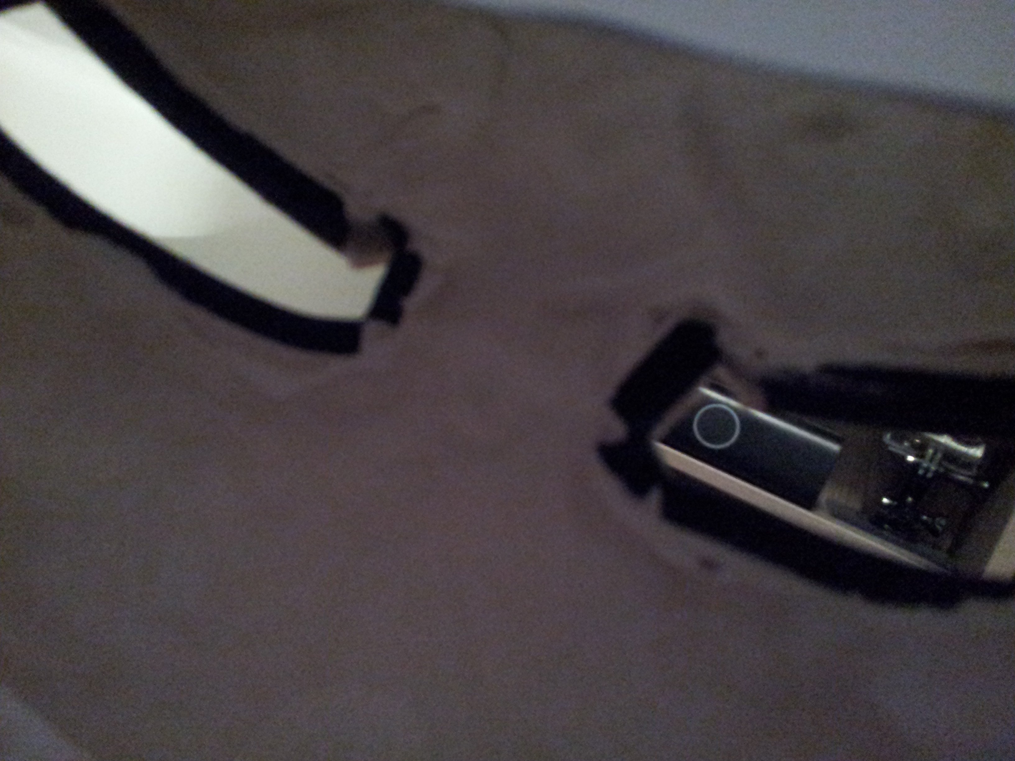

and a small test run for the LED-eyes:2013-08-20 22.01.08.jpeg
And I got around to install the ears. I had to install them before I filled them up with Acrylic Resin so they would be able to bend a little and adapt to the shape of the helmet. looky looky:
Now my concern is, that eyes are too deep. Should I work on that? Maybe I can get some feedback. Until now this has pretty much been a one-way street. Or is this forum fed up with Iron Man builds?

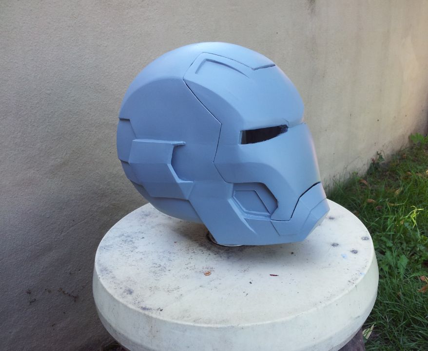

I had some time in between today for sanding:
We're getting there... Now i made a little mistake sanding right between the eyes. It's not as symmetrical as I want it to be... so some minor fixing is in order. But so far, this has the potential to look good I think. If only the days had a few more hours...
So the next step was getting the eyebrows and "nose" symmetrical. For that I pulled out my geometry knowledge from 6th grade... and I drew some lines to get this right...2013-08-22 12.43.22.jpeg
Some sanding...
Priming to see where this was going...
And again from the top...
And the result:
Now there is some fine tuning necessary. I am still contemplating if i should put the dent on the top of the helmet in or not. The dents on the forehead and on the temples will be added after molding, using a rotary tool.
Some feedback would be cool. Dent on the head yes or no? some other suggestions? How are the eyes looking?
