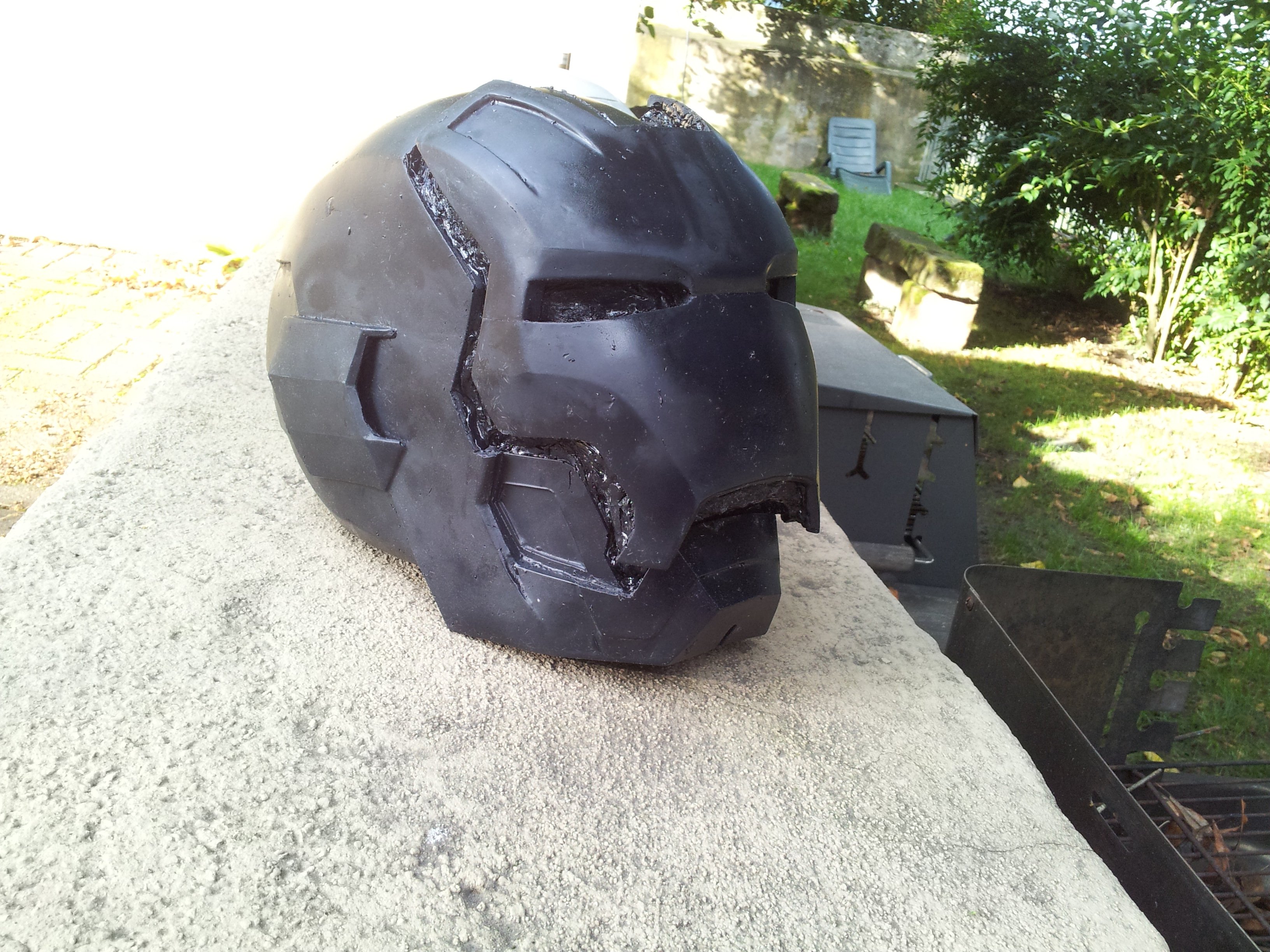

Okay guys... the last update has been a while in the meantime I have been pretty busy. As some of you wanted to see if a helmet could be slush casted: I made a quick mold with silicone caulk and molded the faceplate testwise...
The mold was not very good but the resin captured the detail just as good as polyurethane.
After I had finished the details I made a real mold using the right silicone and the result so far is this:
For easy disconnecting the faceplate I had separated it from the main helmet in the molding process already.

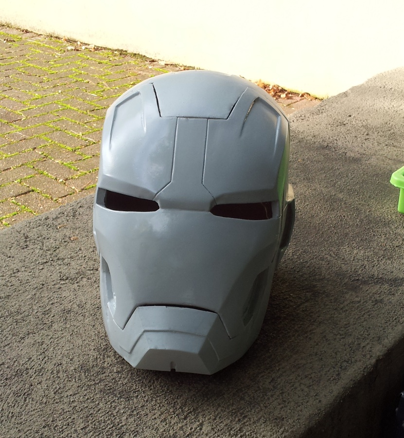

After I cut it up, sanded and primed it, this is what it looks like at the moment. I took the picture while the paint was still wet :facepalm
