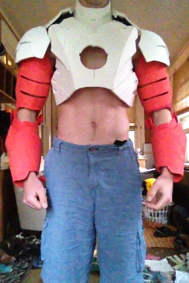

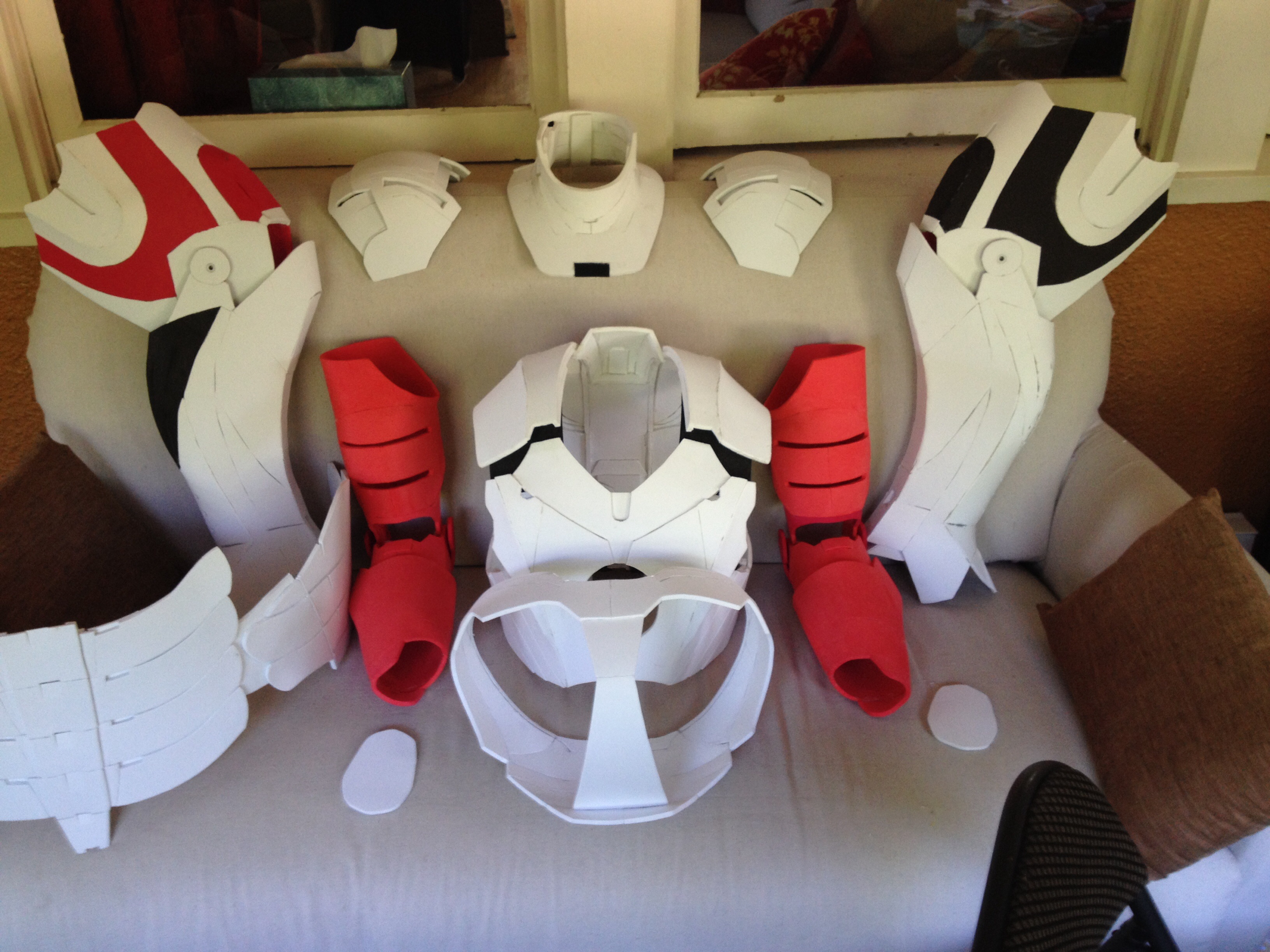

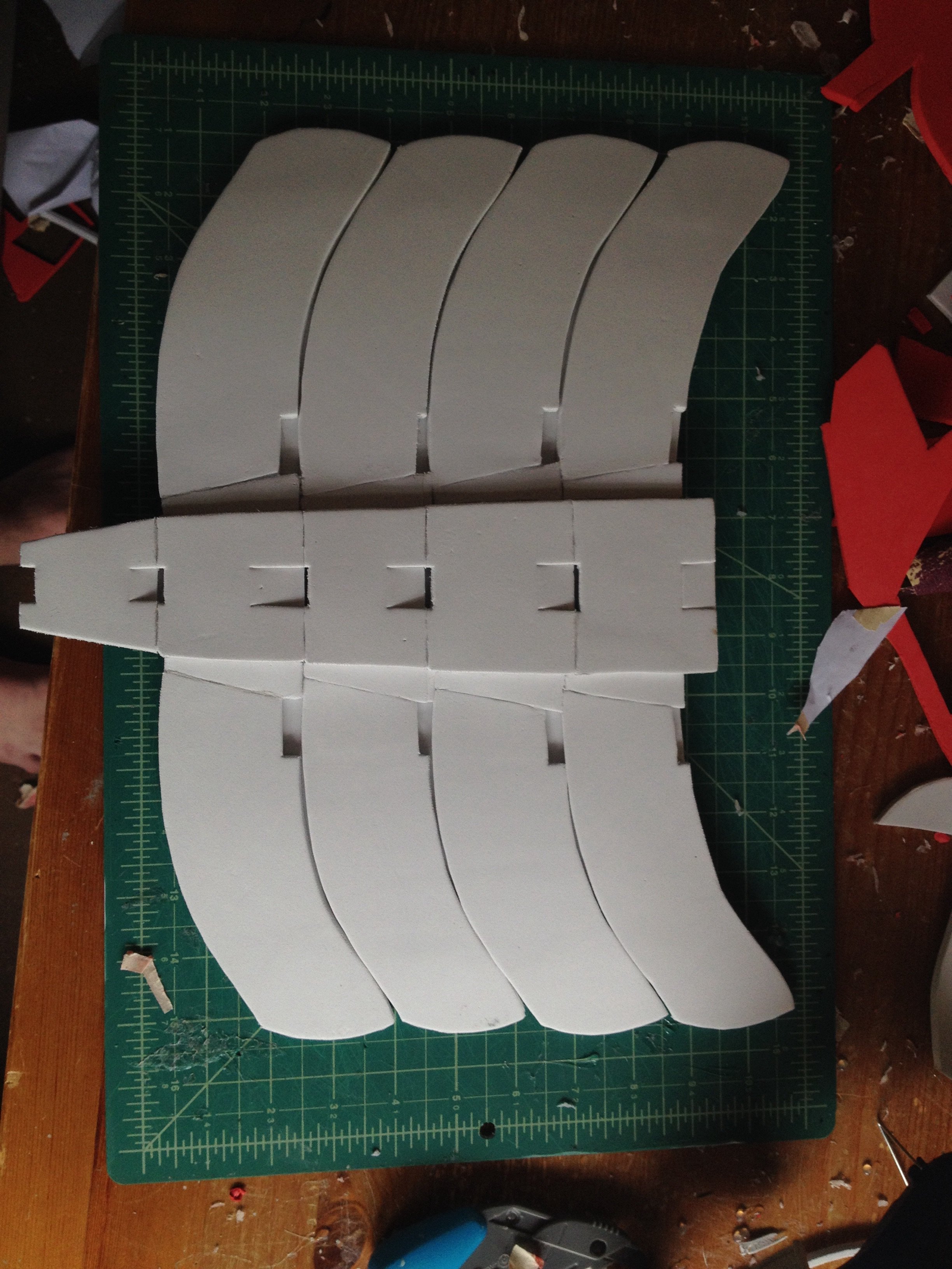

95% done with the pelvis! Gonna remake the abs tonight. Anyone know how to get those frickin abs to stick under the pelvis? Also, concerning the hip pod, the socket on the leg has a much smaller arc than the cod pieces space for it. May not be a problem but I really am getting concerned about how this will all be strapped up on me. Also, any brand/type suggestions on the spandex undersuits or whatever is best used. I haven't seen much on it in the forum :/
Thanks all! Almost there....

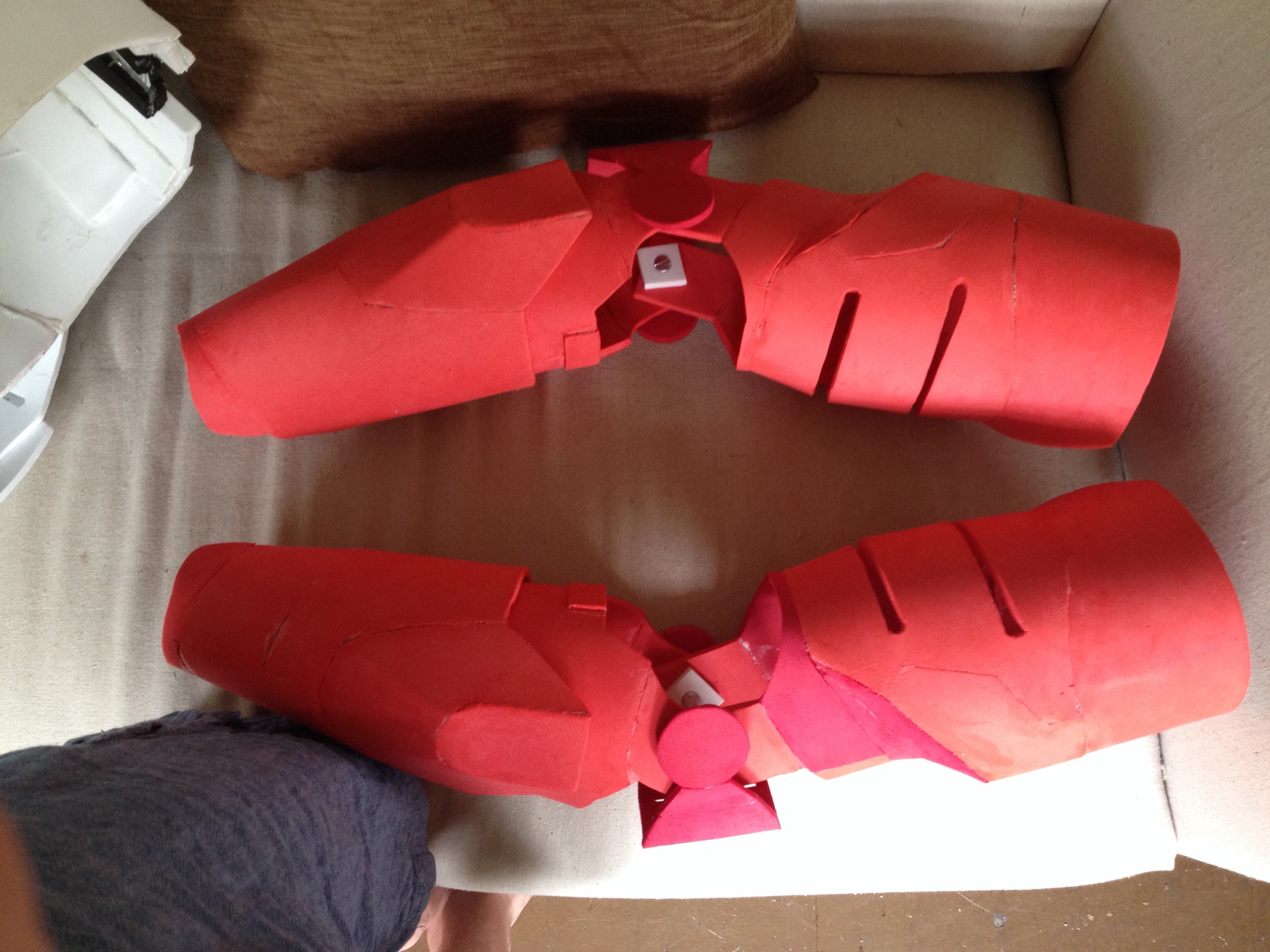

Cool! Thanks, how did you connect the arms/shoulders.Not sure how to do things for your mark but here's how i've done my strapping

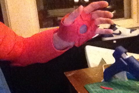

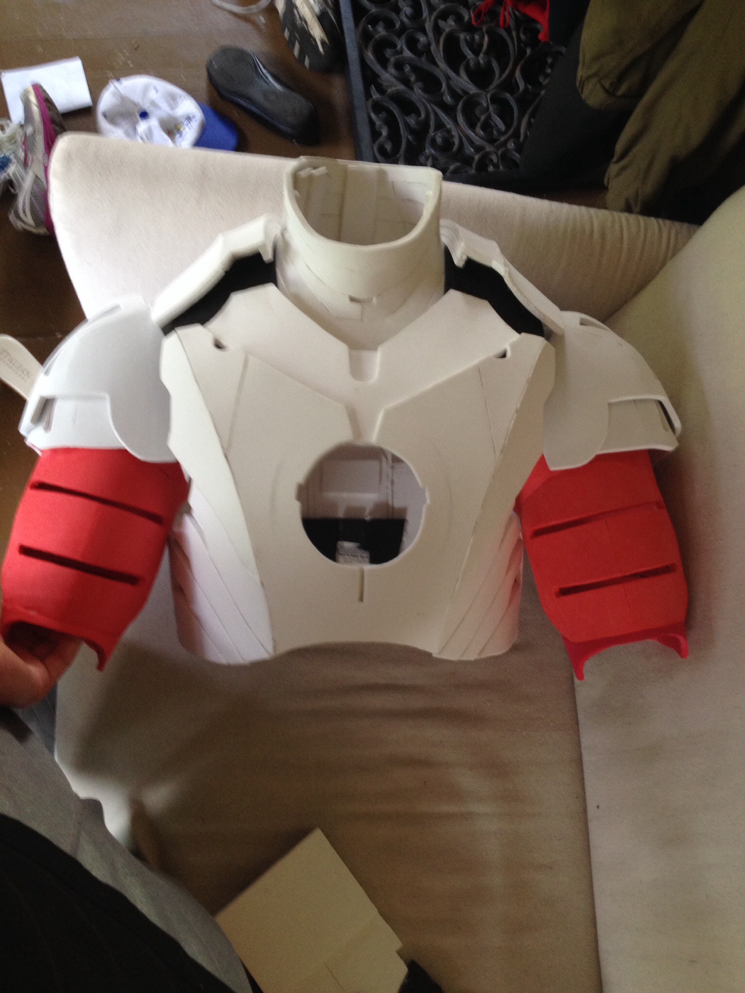

Thanks. And I'm trying to figure that one out as wellGood and clean work) i like it):thumbsup
but, where is helmet? >__<
will wait a result.)))Thanks. And I'm trying to figure that one out as wellI was 3d printing the thing at first but the pieces just required so much time at my school where the printer is, and the pieces just kept failing and even the finished ones were fill of mistakes which I don't have the time (or resources, really). I've heard the dangers of making the helmet last because you would run out of steam but I'm the type of person that doesn't give up when there's only one thing left to do
