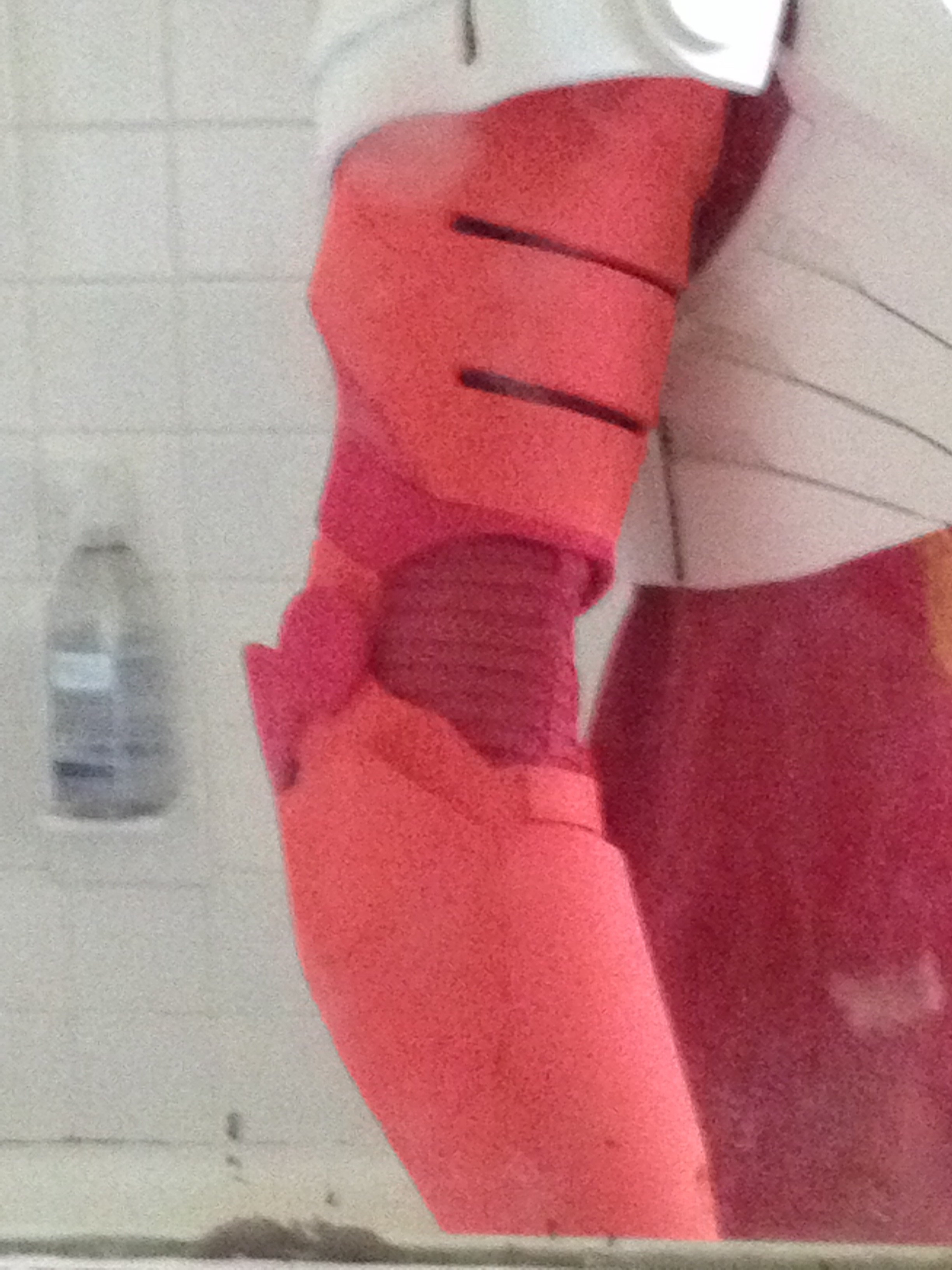

Thanks and here's a slight little update I dremeled some lines into some 2mm foam and stuck it under the arm to see how it will look purely as a test and I'd say it's a start.image.jpg Thanks!

Going to test scale some boots tonight if I get a chance, but first I think I'm going to try to make some gap covers. Here's one of the sections. I'm planning to attach it to the thigh and have it be able to slide into the back of the calf. I would love some advice for finishing this thing up, especially wondering if there is an iron man red color spandex suit it would maroon work? Finally, the fingers are being a huge pain and are frustrating me to the point if almost quitting and buying flipping 300 dollar or whatever gloves. Any ideas. Thanks for the good words.

I went with a black compression top and trousers (think that's what they're called anyway, tight jogging stuff) in the end for mine. It'll be visible in some areas (under the arms, etc) and I thought it might be a lot of hassle trying to colour match reds so black was as good a choice as any. Other people may have different experiences with some colour or product recommendations though.

Thanks. Here's the back leg cover. 2mm foam, a unified piece but slightly flexible, slightly. The idea is for the curve to be enuf for my leg to fit into but also so it can slip right under the calf piece. Probably won't be able to sit down in the suit, but that was expected. Hope that those hospital visits when I'm done aren't too taxing on my legs ;P and with the fingers is that they're getting too long. If I scale down much more there won't be any room left for the conduit, which is crucial. So the way the fingers are now you can't even bend them because of the right angles on the side of the fingers..... should I find new files? Thx

The covers are looking good, might try something like that myself.
With the fingers I get what you're saying. For length I just went off template a bit and cut them down till they were fitting a bit better (mixed up the pinky and third finger of course which made things interesting). I ended up making the middle section slightly narrower by cutting out a section of the bottom of it, gives it a little more space for parts to hopefully slide past each other.

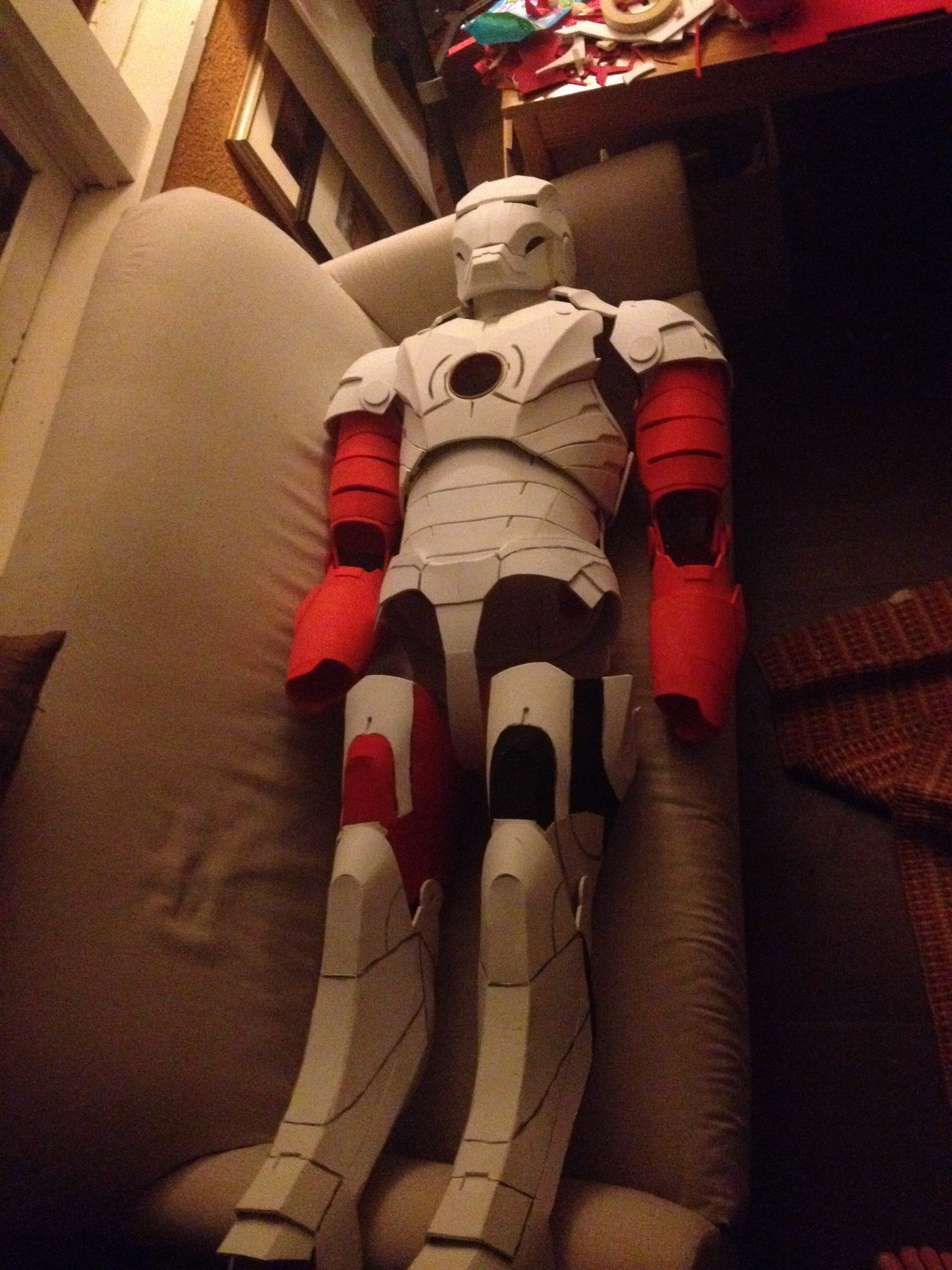

Hey guys. Ive basically completed the helmet. Decided to magnetize the jaw, it was the best option available. It comes on fine but my constant determination for the most accurately sized helmet possible are finally catching up to me. When i slide it on, everything looks fine, and it isnt even very tight, but on the ears it bumps out a bit, not a lot, but changes are necessary for it to look good. The ear area was difficult for me to build but i eventually decided to throw a little square of 2mm foam where the ear section is and then put the ears on that. It worked well enough, but now my ears push the sides out a little. Anyone encounter this problem or have any ideas.? My plan is to get it very rigid with epsilon and just manage my way to squeeze into it, which shouldnt be that hard, but either before i do that, or in addition, im going to cut thru the 2mm foam that the ear doesnt require to stay in place, hopefully granting me that last crucial bit of space. Heck, maybe i should just tape my ears flat to my head every time before i suit up Also heres a photo of basically the whole suit placed together:)
