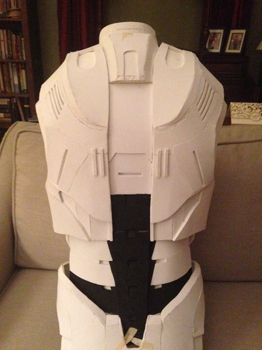

Hey rpf-ers,
I'm new to this forum (actually, forums in general) so I apologize for filling the site up with threads of stupid questions :facepalm Figured I'd finally post a progress thread on my Mark III foam
suit so here it is! And please I'd really like to see some feedback on the quality of the foam-work, good or bad! Also, this is my first build.
I think this would benefit from smoother cuts (scalpel blade etc) and a little heat treating to fix the form, but apart from that it is very neat.
Definelty could have used some heat-forming, but I haven't a heat gun nor the money to buy one, as most of my funds need to go towards the ridiculously overpriced smoothon epsilon, along with paint and primer. Is it too late to heat form, and I'm guessing you're talking about the lack of curvature in the chest plate? Thanks for posting, and "neat" like cool or "neat" like clean? XD
Heat guns in England can be bought quite cheaply for around £25, they are kind of essential for foam work. Buying an expensive finishing product (like episilon) before buying basic tools is a bit "horse before the cart". It will trip you up at some point. My advice if you will take it? Buy a heat gun as soon as you can (or even borrow one for the job).
1: You can heat treat EVA foam at any point while unpainted. Treating after painting risks ruining the paint job (but it can be done if careful).
2: Several areas need curvature, not just the chest. If you look at your reference material, you will see that although Iron man is pretty mechanical, the armour has an almost organic flow.
3: Neat as in clean.
You are on track for an awesome suit!

Wow. Startin to realize how awful the chest piece looks.... It's far too tall and again has zero curves. My first chest plate attempt was accidentally melted by a heater that normally was never on, and I'm starting to WANT to melt this one, but I'm not too keen on disconnecting the back from the chest and then remaking it, but I think it would look overall much better if did.
In my opinion you should finish the other pieces of the suit first. Then look at all the pieces together...It may look way better as a whole. It may not be accurate to what you wanted, but it could still be a cool, unique take on the armor. And if you get to that stage and hate it, then you can just redo the chest and be happy :)
