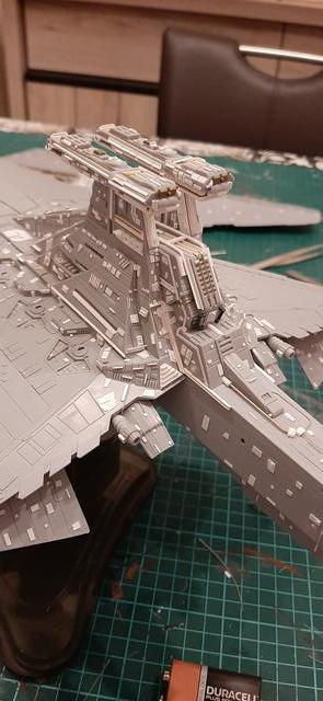

Hey guys! Time for some juicy updates!!!
Part XV: Finishing greeblies, lights, lights, fiber, lights, lights....
K, like the title suggests I finished the 'chipping' or 'adding greeblies'. Its not as much as my two 'idols' ;). But its good enough for me and I'm happy. Every zone that received extra detail was handled with the same amount and effort. So no slacking at the end.
My total amount is just less dense compared to more hardcore people, but hey... this is my FIRST one.

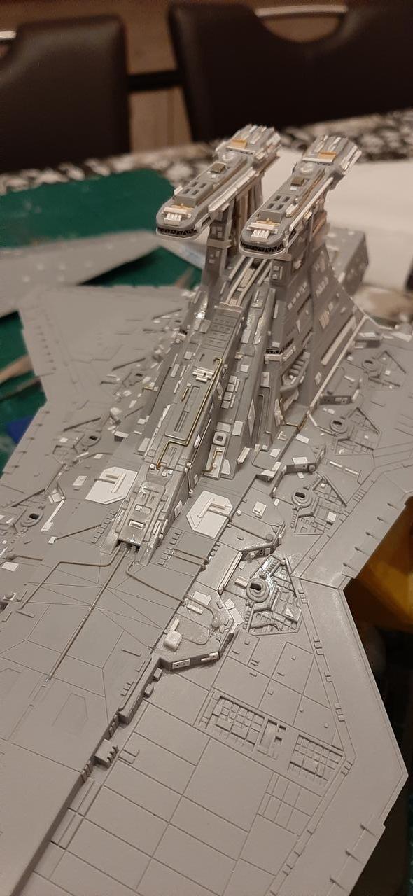

So to start of I finished adding details to the upper hull and lower hull. And even added a few to the trenches. Some pictures ...

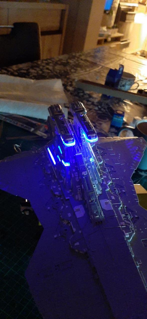

Snuk in a quick command tower light test...
I really like this shot:

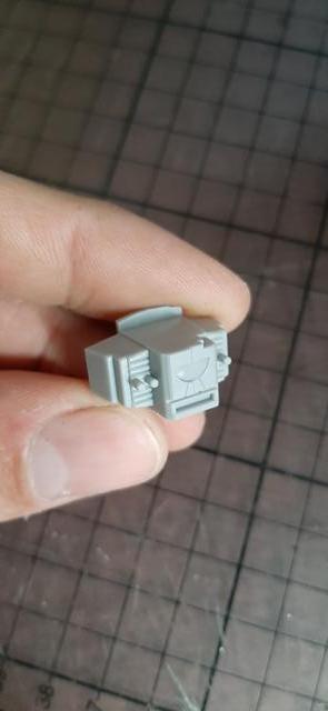

I also tackled the 'nose'. It had almoust no detail and was in dire need of some, I went with antenna's and sensors to give it a more interesting look.
Some might be to long though, any toughts? I might shorten them a bit. It also received some fiber optic holes.

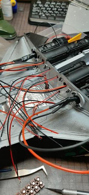

So electronics. Its a bit of a b***h to tackle. I still need to paint, but I can only paint when I put in all my fibers, and those require some management for the other pieces that need place. So I started of by spraying the engine well black, and the tail gray and installing my engines. this gives me the opportunity to handle the huge amount of wires that come out of the engines.
This in turn gives me an overview of the room left for fiber placement, the custom side hangar etc.
So I started by installing my engines:

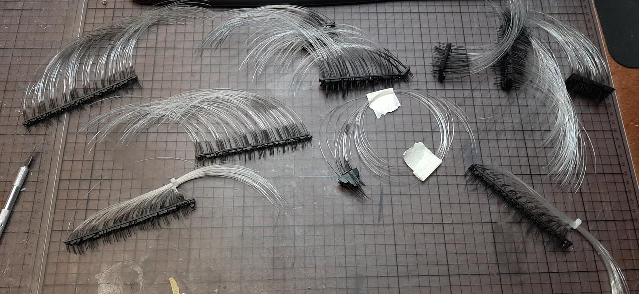

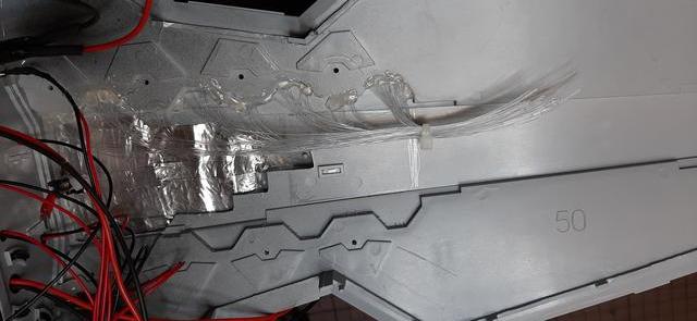

I was about to start cutting and soldering when it hit me that I wouldn't be able to reach the fiber behind the turbo lasers. So..... I did that first (its kinda an avalanche effect. Now this turned out to be going very smooth and I am SOO HAPPY with the result:

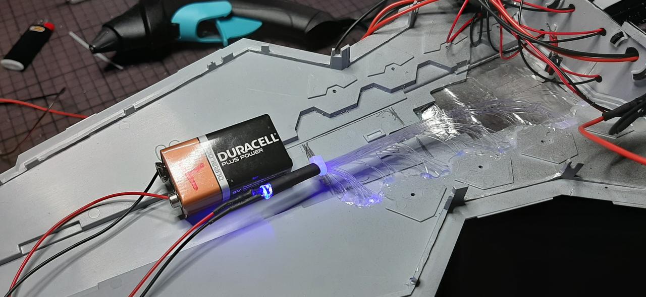

I secured all the fibers with hot glue on the inside and placed&cut them one by one to reach the middle part of the Hull.
There they are binded together, cut flush and stuffed in heat shrink (which isn't used to shrink but as a tube) together with a blue led.

I'm a big fan of those nose antenna - I really like that. You could even add a smaller aerial to go on the far right side one so it looks telescopic
I like the details you've added. More doesn't necessarily mean better.
Keep the updates coming

I'm glad you like them, a dish sounds a good idea. I'll see if I can make a tiny one.

Thanks for the nice comments! Talking about fiber... I had a day off. Started 8 this morning just finished.... (no breaks just ate something at noon)
My back, fingers and neck... aaarghh.. but its done! :p. I added wood glue at the back to hold them in place, so that tomorrow when I try to route them and find place for the leds they will stay put.

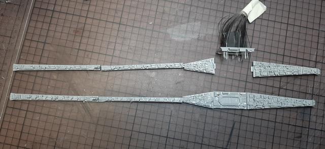

Part XVI: Primer!!!!! <----------- PRIIMMEEERRRR

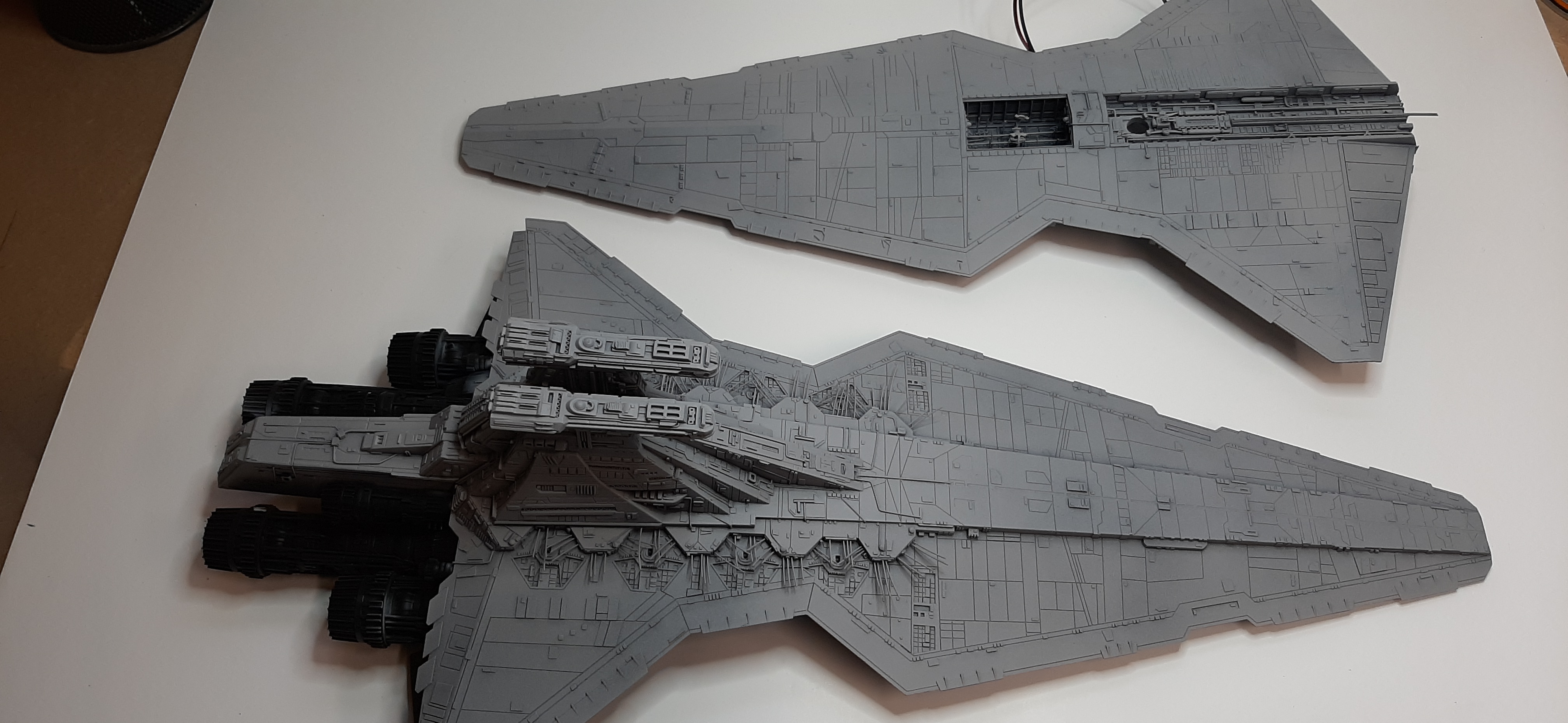

Hey guys! So I came to a point where I had some choices. Either I install everything and try to paint later, or I primer/paint first and then install.
Now me being me I went for the middle road. Priming - installing - painting.
Now I do not own an airbrush nor do I want to buy one for the moment ( I plan on doing so soon cause this hobby is really sticking on me, and I love it)
Due to this I tried something out with my primers. I have a can of 'citadel black' from Games workshop. And a can of Vallejo Gray. Now these two have properties that gave me an idea. The citadel black covers really really well and is a fine layer. The vallejo needs long passes to really cover and is really really fine. So I tried something out, I wanted to use the primers to get my base color. So no more basing after just detailing, I also didn't want it to look plastic or 'toy' after painting. So some kind of non-uniform coverage.
This took a while but here are the results and I'm sooooooo HAPPYYYYY. I'll let the pictures speak for themselves.
Just in short what you gonna see here:
-All trench parts primed in black front and back.
-Hull front and back primed in black.
-Hull front and back passes of grey but I waited longer at some parts and went over some others rather quickly creating a uniform surface.
Also I only sprayed from one angle giving the whole hull some really subtle shadows, adding to the size illusion (In my opinion).
-Trench parts got 4-5 passes from gray really quick from one angle only, giving deep shadows and a 'darker' look.
Now some of you pro's are probably gonna say 'wth this isn't pretty) but i really really like it.
note: i didn't take out my reflex camera but I did put my parts on a white background, with a light. Reflex camera is for finished shots :).
the blacks:
The gray passes In my 'want to be airbrush technique':
Full res picture:
I hope you like it, I'm writing this as its drying, next up is installing all the fiber and then closing her up for finish painting!
-Hopli

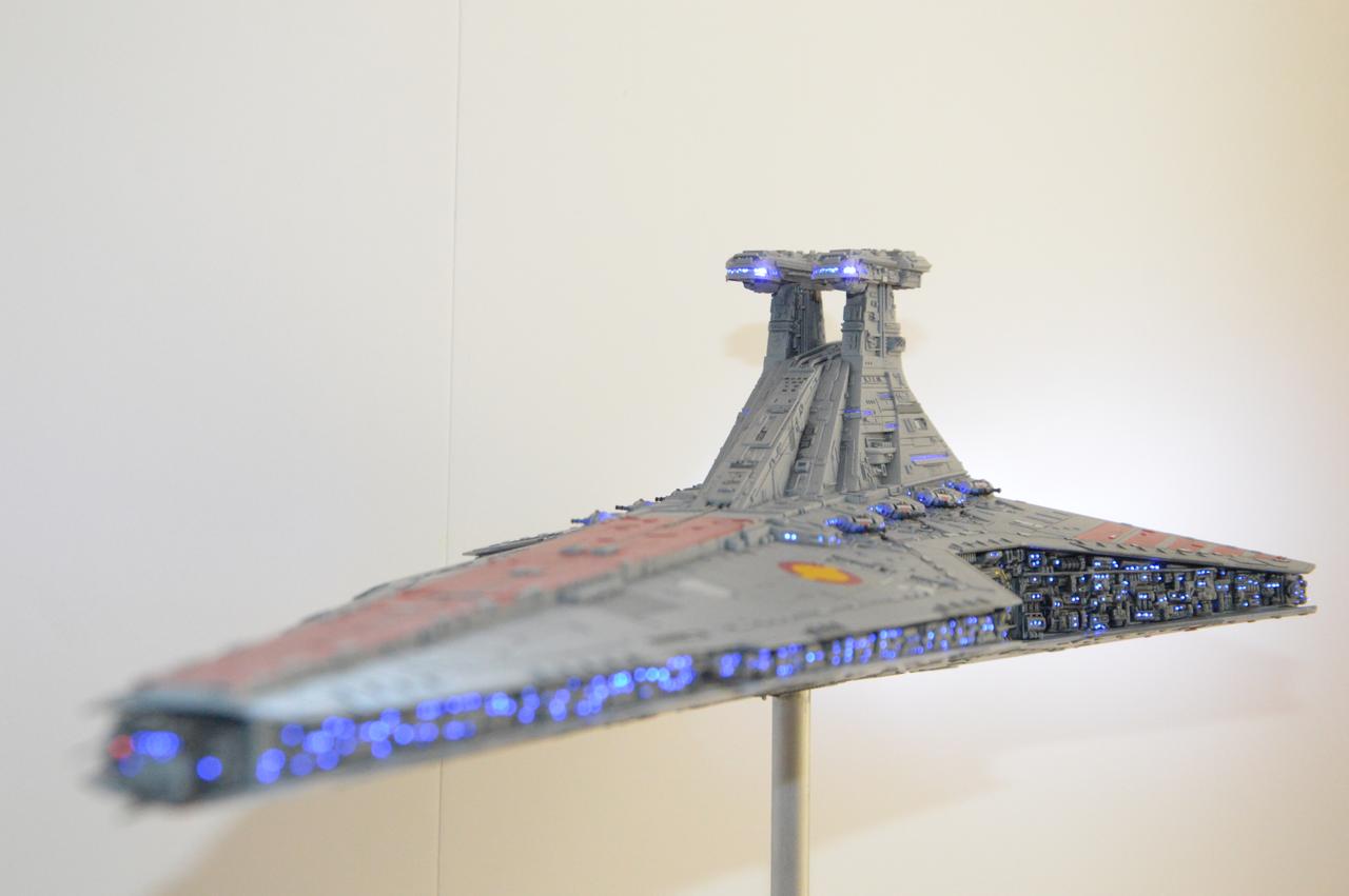

So yeah! The final part is here.
Part XVII: Finished.
So picking up from where we left off.

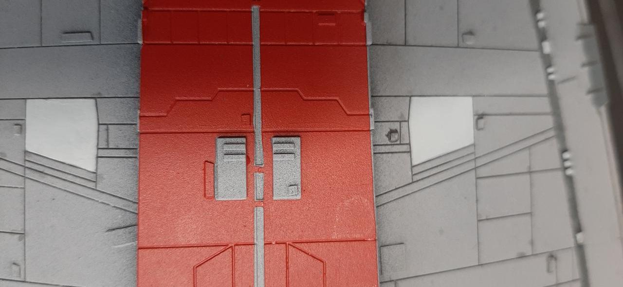

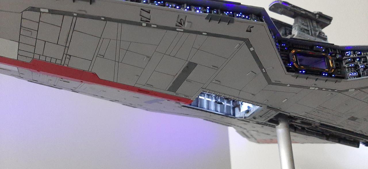

I started by adding the decals. The decals where solid but I applied 20+ layers of softener to get the 'painted on' effect.
Then I re-painted and washed the side trenches with a darker color followed by the first haircut!
After that followed painting, dark panels, light panels, panel line wash (I didn't have thinner so this was a pain to do but I like the effect).

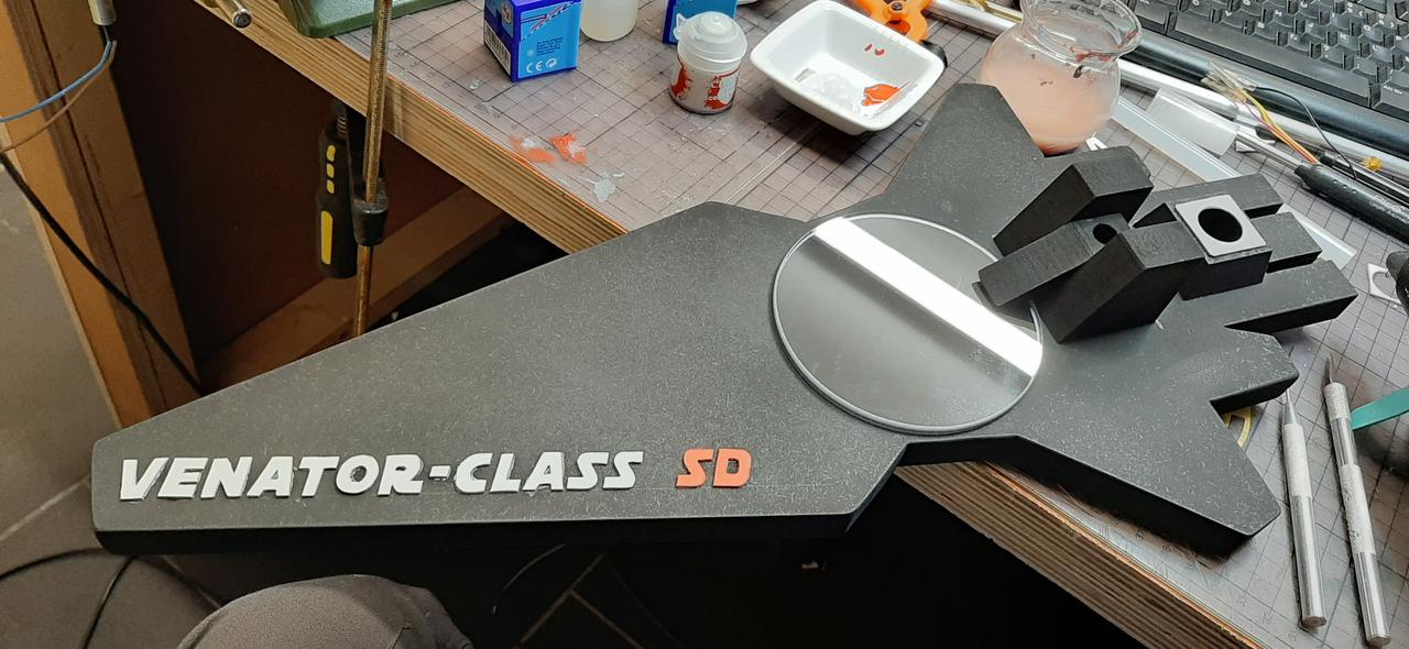

Finished pictures in a sec, first I needed a base to put the model on. I decided on a black MDF piece in the silhouette of the venator. The tube holding the model up would come out of the bridges, with a mirror in front to admire the bottom hangar when viewed. Also a integrated switch to enable the lights and an easy connection to a 3v-12v adapter (I bought one that is adjustable cause one led flickered with my 12v supply but is fine with my 9v).
Then we are done!
I'm not a professional photographer and I don't have a good light setup, these are the best I could do. I have an ex colleague who is very good at this and will help get me some finished professional pictures when he has time.
I hope you enjoy and thank you very much for everyone following and commenting it has been a great motivation to keep this project going.
Its not perfect, but I'm proud and very happy with the result.
