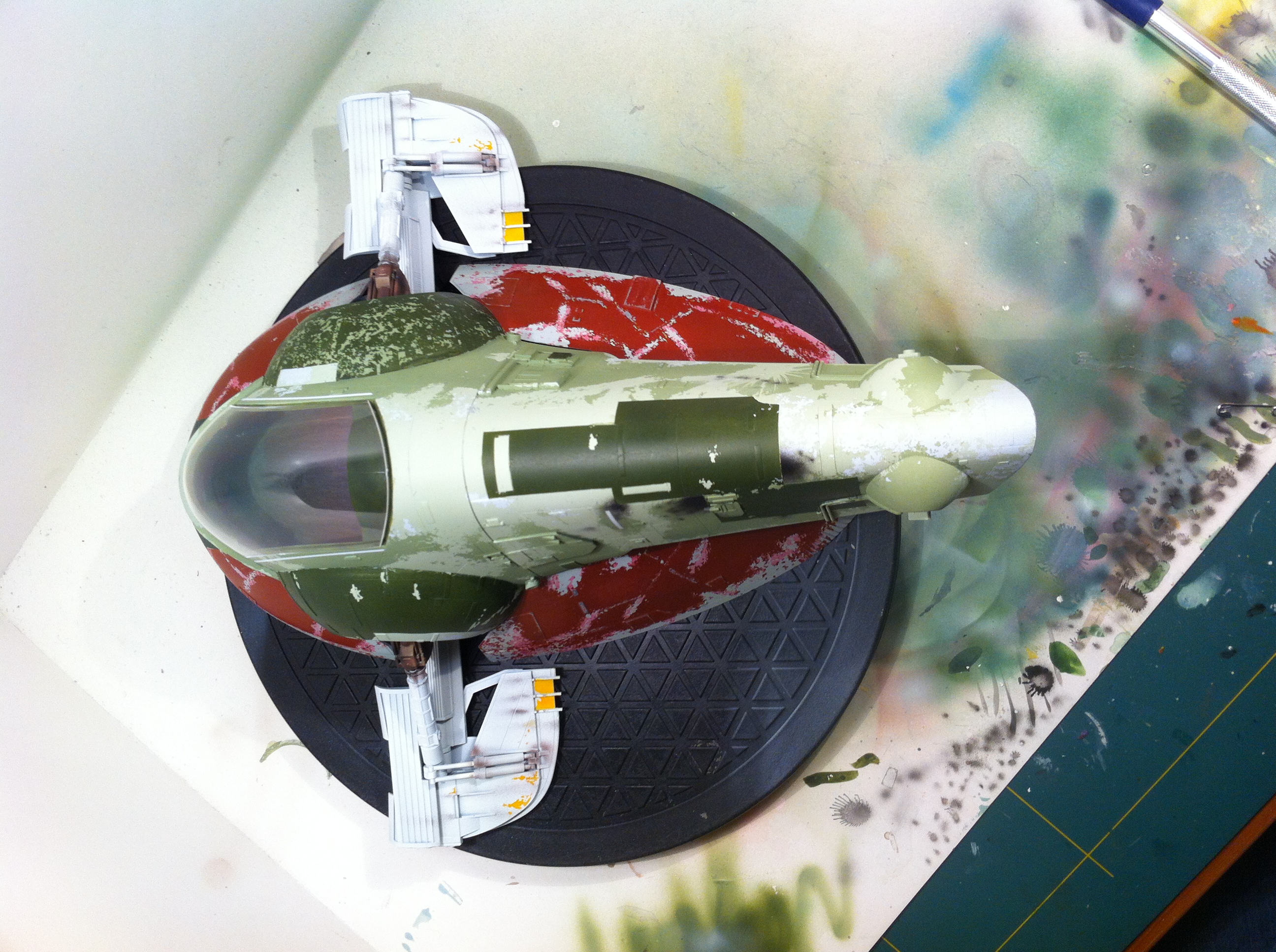

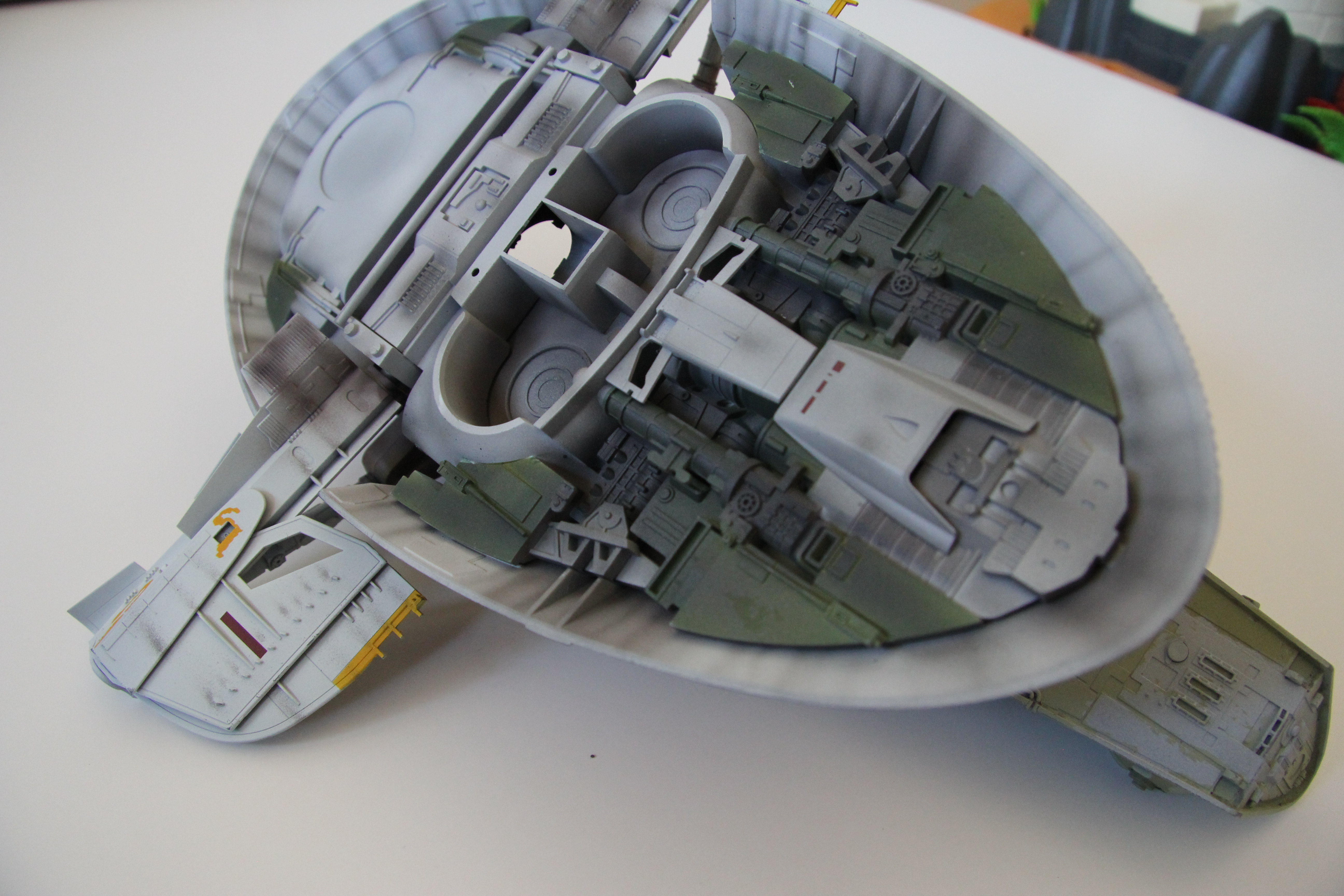

Having fun with the spraygun! forgot to take photo's while working. A lot of work, building up layers from light to dark.
I'm sorry mit pictures are rotated. they're okay on my mac, but the side puts them on there side every time. (double click on them will show them okay btw)

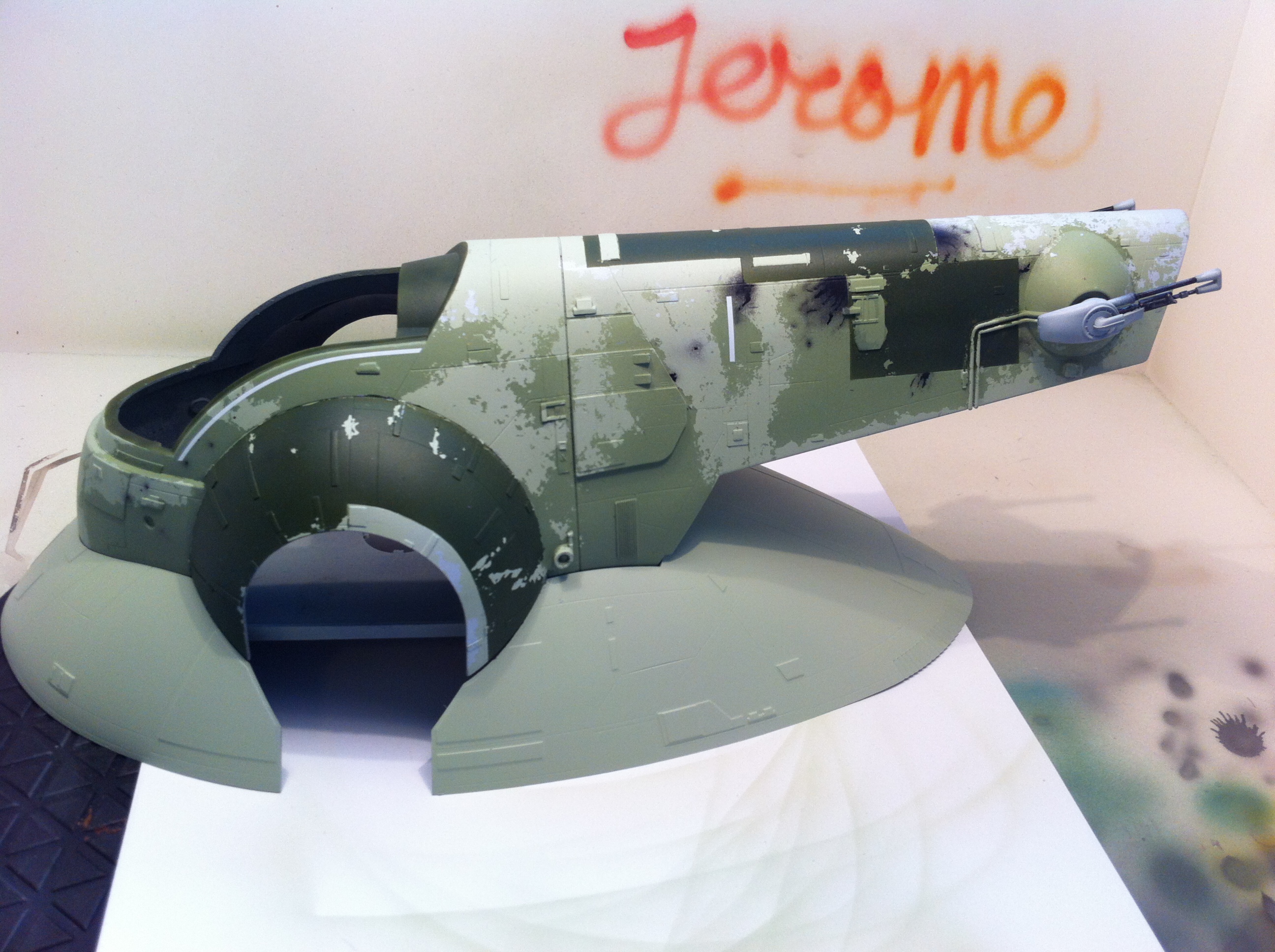

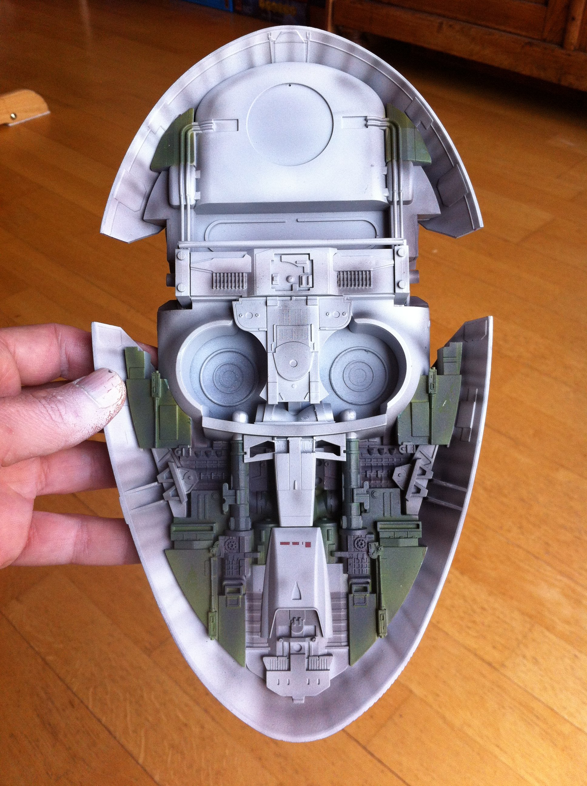

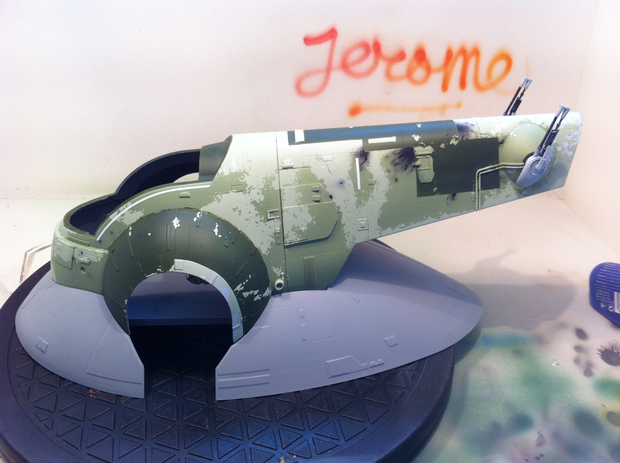

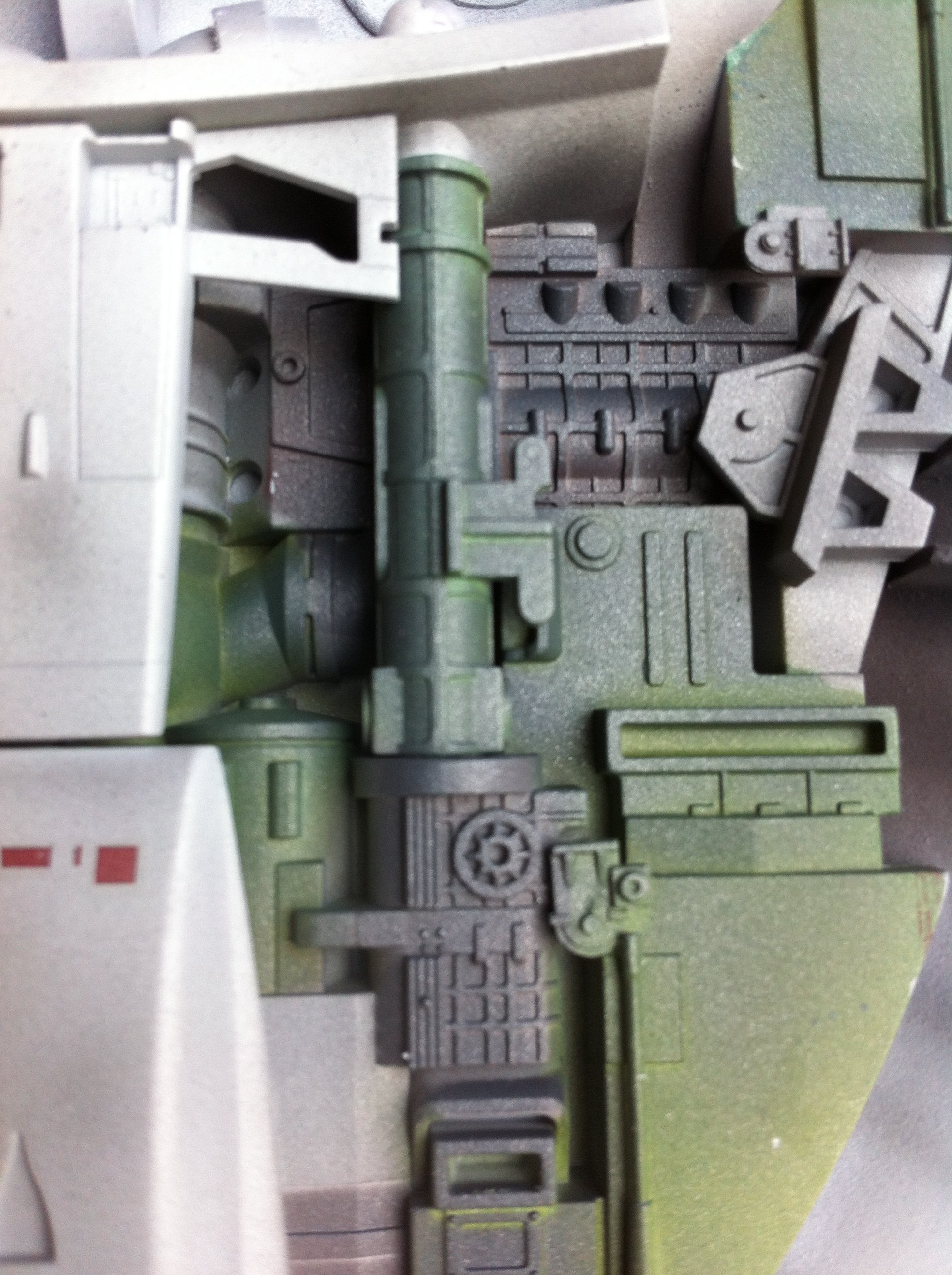

Sprayed the whole with a mixture of white and aluminium, to get a bit of a glitter. Sprayed some parts separatly since I thought it was easier to spray without them allready fixed.
Masked the green areas. Sprayed Olive green mixed with yellow. Then made the color darker/greener with blue. Sprayed over it again unevenly, to get different shades of green going on.

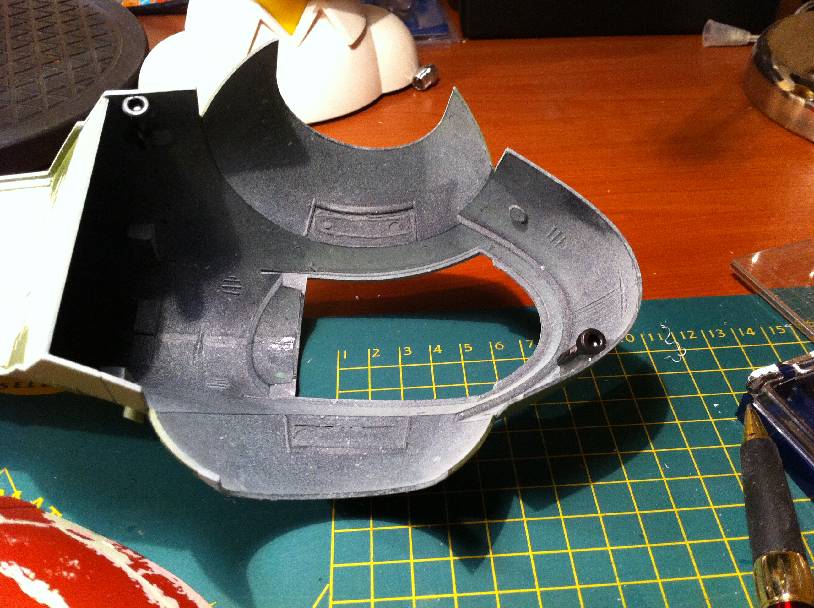

Then masked the parts that are dark grey/black. started of with a brown layer, then added black and neutral grey to the mixture to make it dirtier. Also used that mix for the wheatering on the skirt.
Placed the separate pieces on to do some wheatering (forgetting this would make wheatering stop suddenly)
Sprayed some alluminium lightly over everything to get the metallic back a bit.
give these pieces a lot of the aluminium mix. Will be wheatered more after the wings are on to blend them nicely.

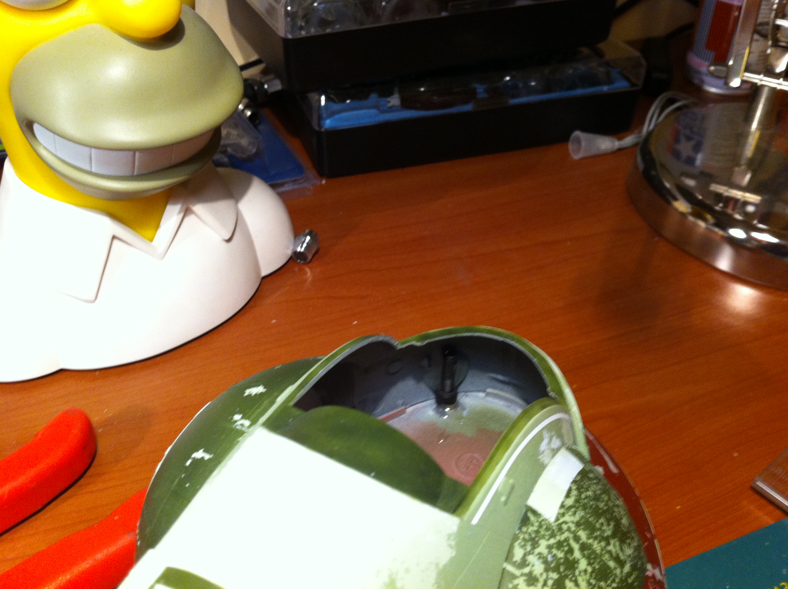

Isn't that a sweet spot for a lightswitch? Will not glue that part on. Will place to magnets on the back of these holes to hold it in place.
Lots of colors going on!

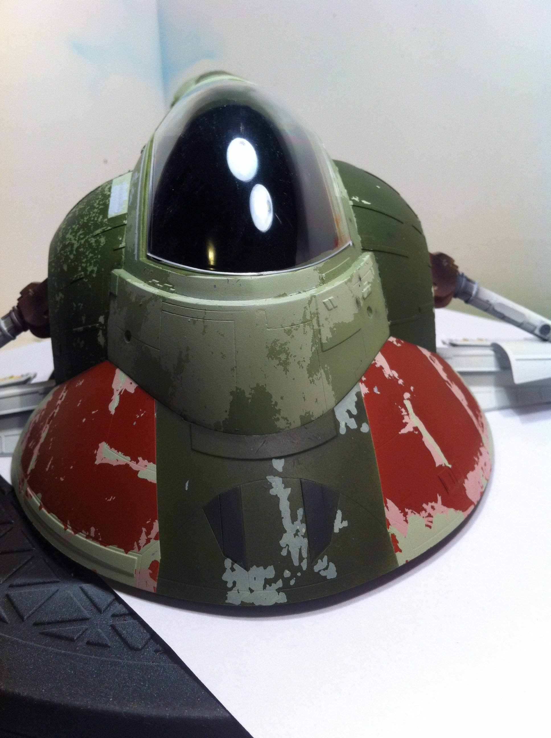

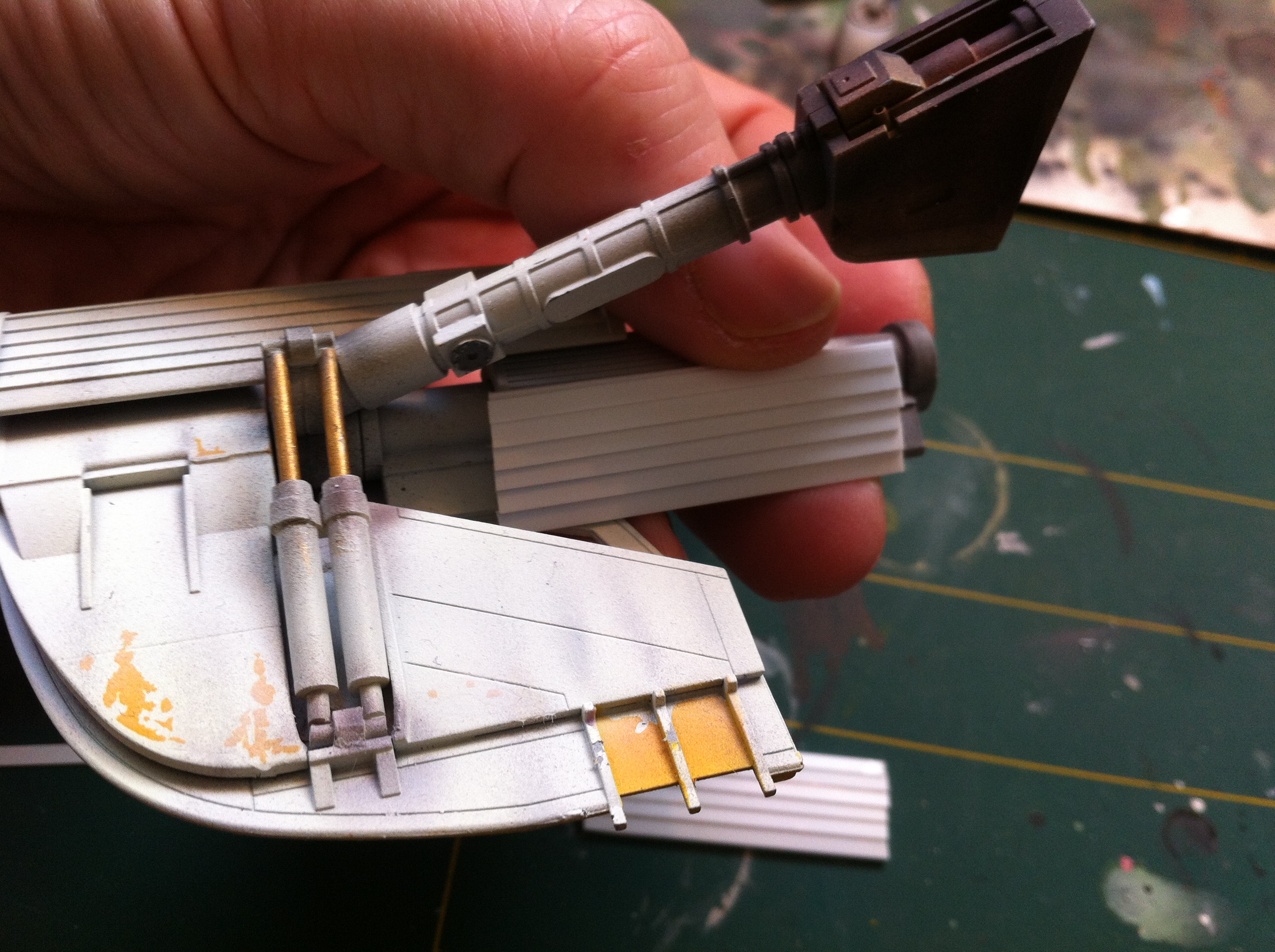

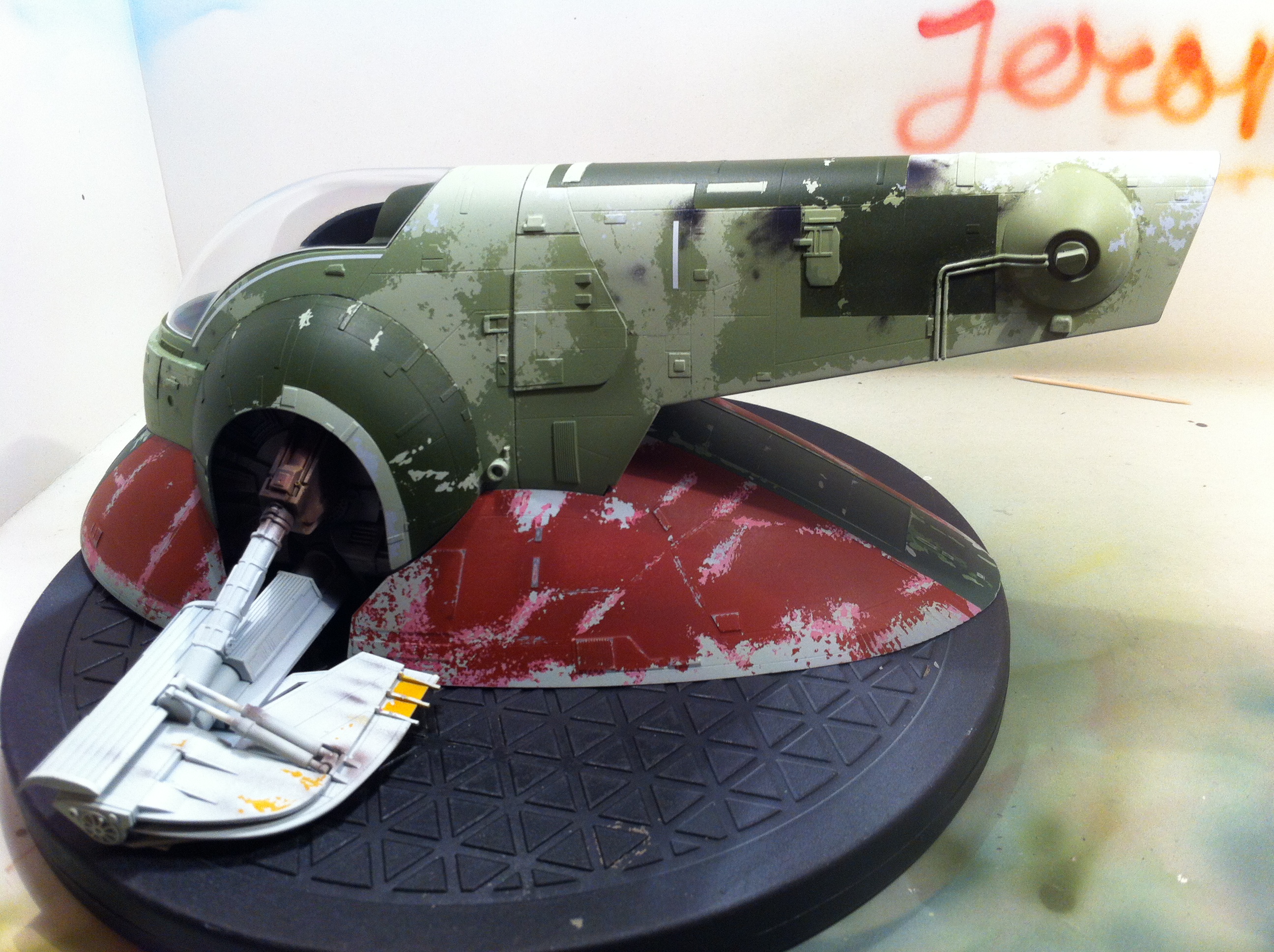

Decals were fitted and wings sprayed. Some yellows weren't decals so had to mix the right color to match them
took the canopy out for the first time for a first look of the assembled ship. Saw two threads where it broke (not FM I believe, but better save than sorry). Don't wanna get scratches on it so after the shoot it went back in the bag.
Re: Fine Molds Slave 1 build. Taking it slow to get it right this time.

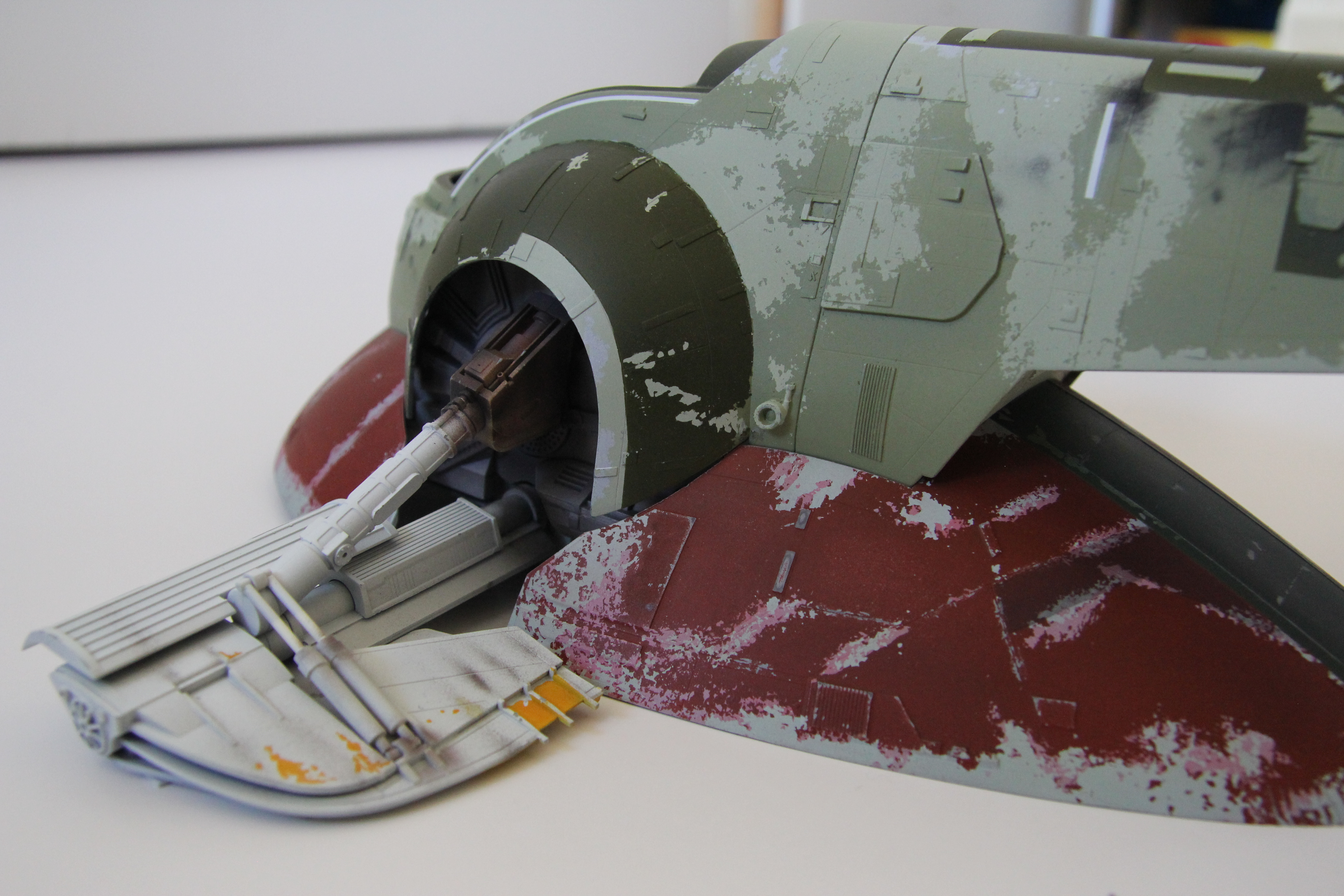

Was looking at yesterdays pictures and noticed that the colors are way of compared to the model when taken by my Iphone. Especially the red is represented way to red, while it is more of a brownish red.
So i did a little shoot with my canon to give you all a better picture of the colorschemes.
Here's a photo for reference. Wings still need more wheatering. Airbrush cloughing up all the time with the black paint.

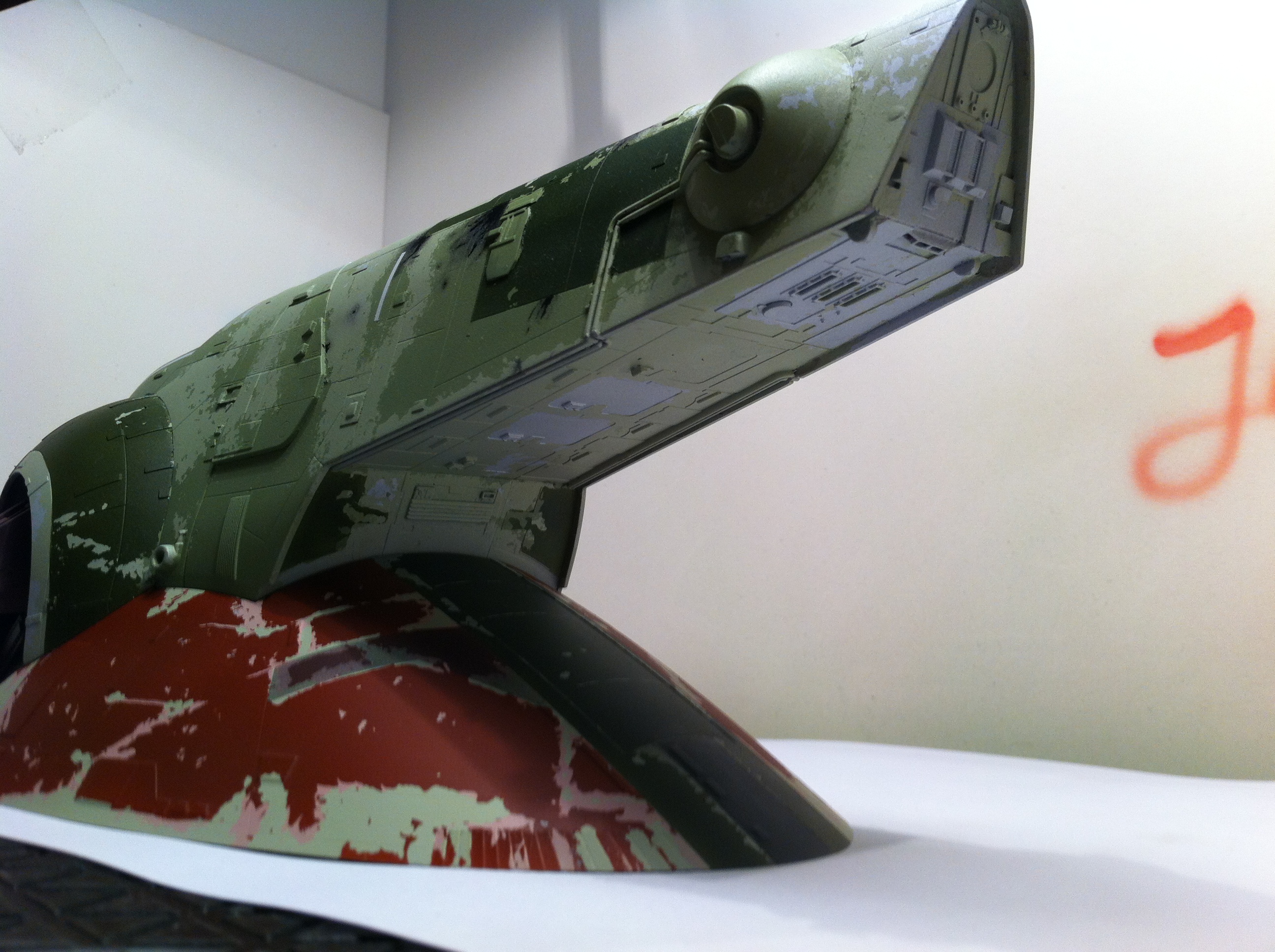

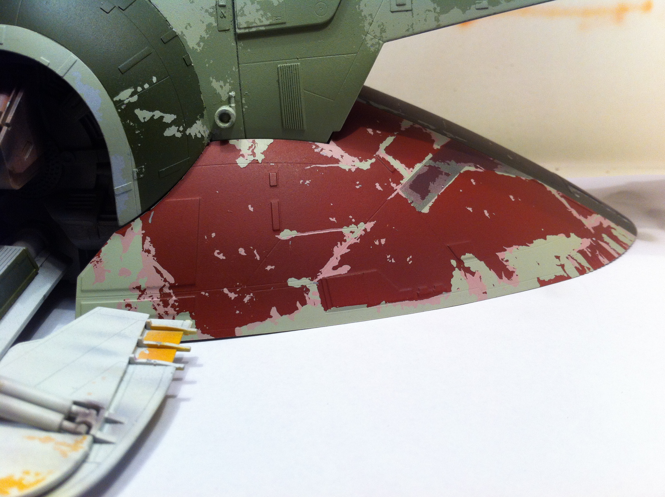

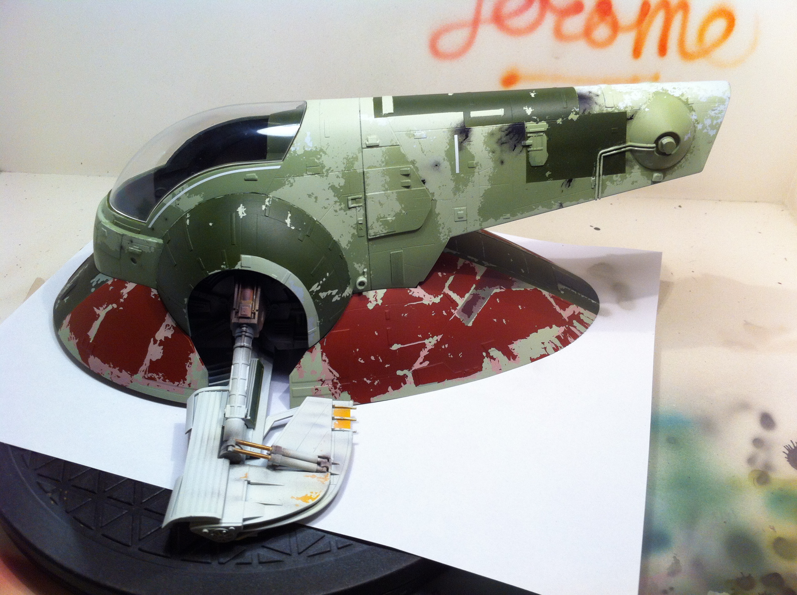

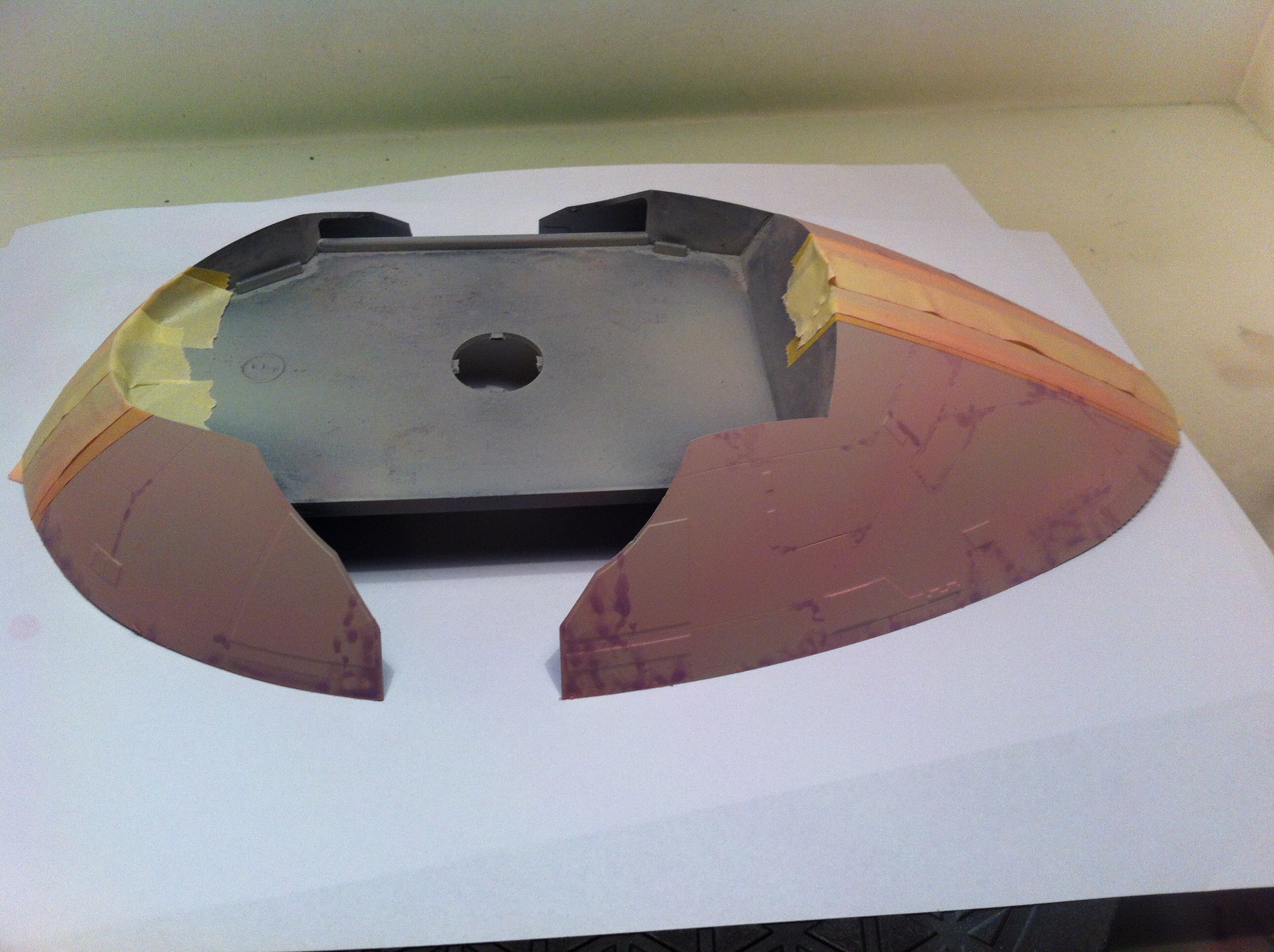

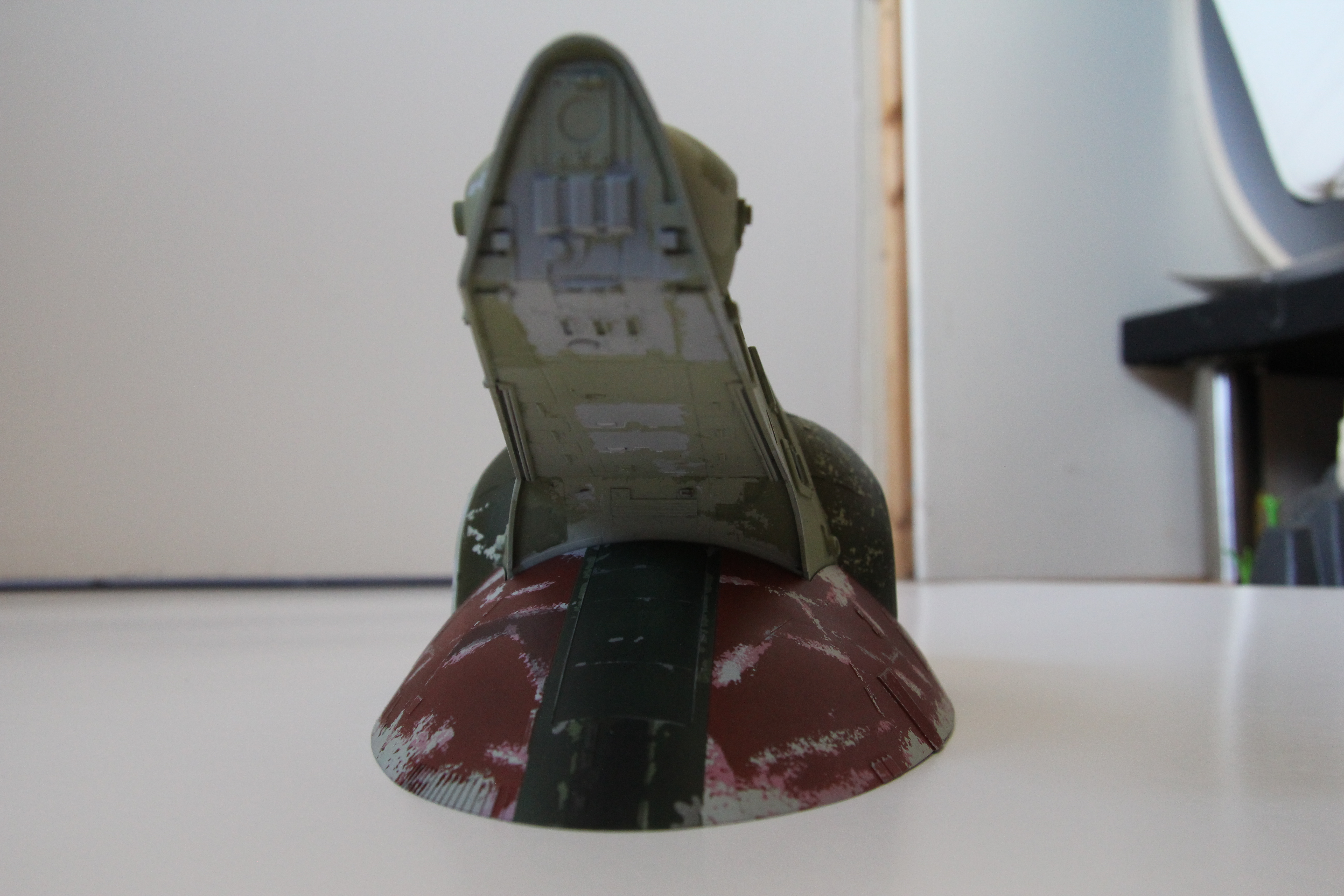

Have you ever have the feeling something's wrong about your build and you're not sure to take the step to do it again. I did with the hull (twice) and doing it again improved my skills in masking and making it look more like the studio model. Only problem was: The skirt stayed in the 1st stage and the more I looked at it, the more I disliked it.
Remember my comment on the pink? It's just to much in your face.
Aside from that, my masking with the sponge wasn't that great in my opinion and some panel wheatering I just missed.
So today I cleaned the whole skirt (getting better in that too, took my about an hour) and resprayd and -masked it all over again.
I kept the tone of the pink way down this time and added some drops of yellow to give it a different tone.
So here's the result, thanks for watching.

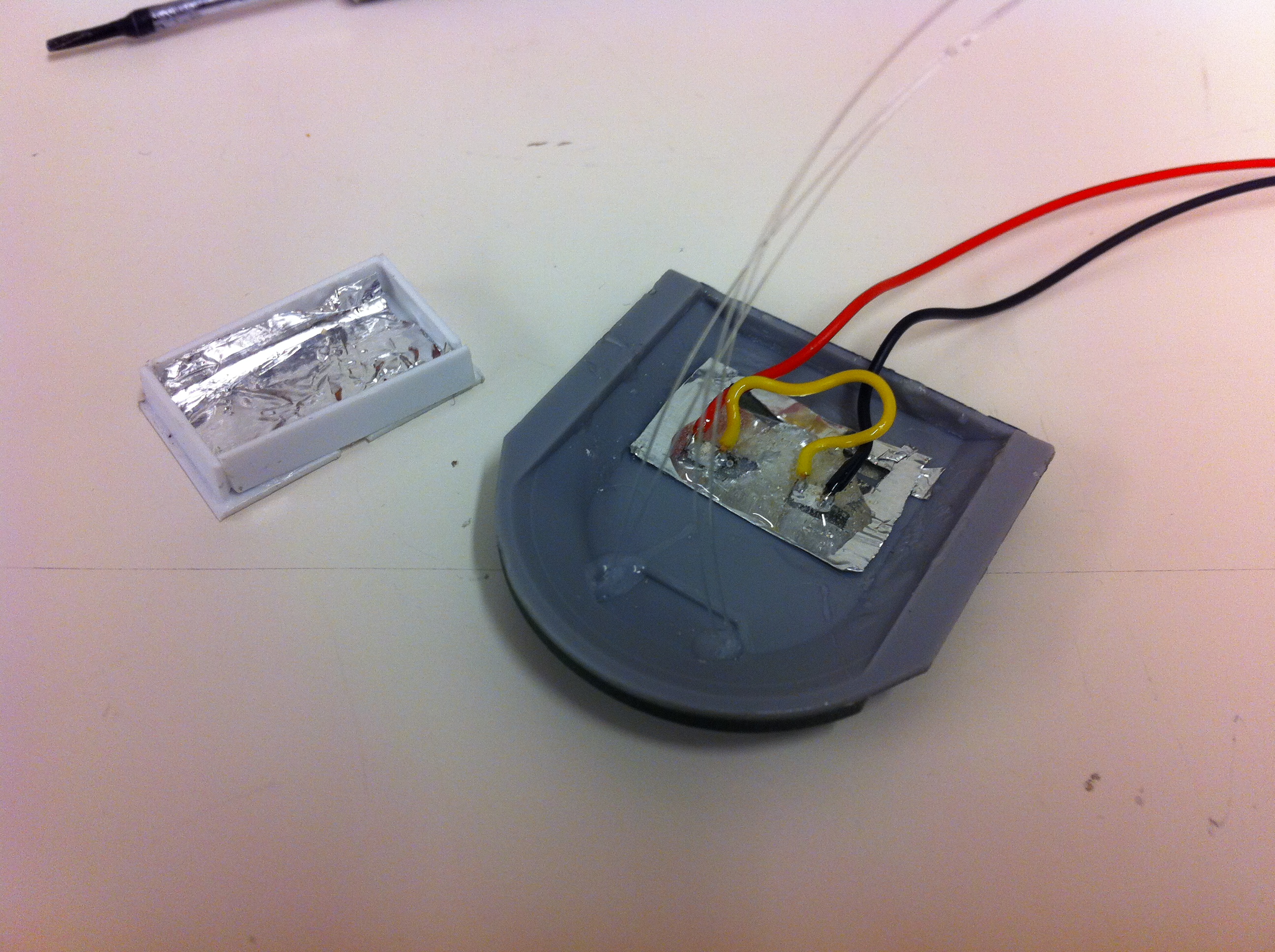

Quick update:

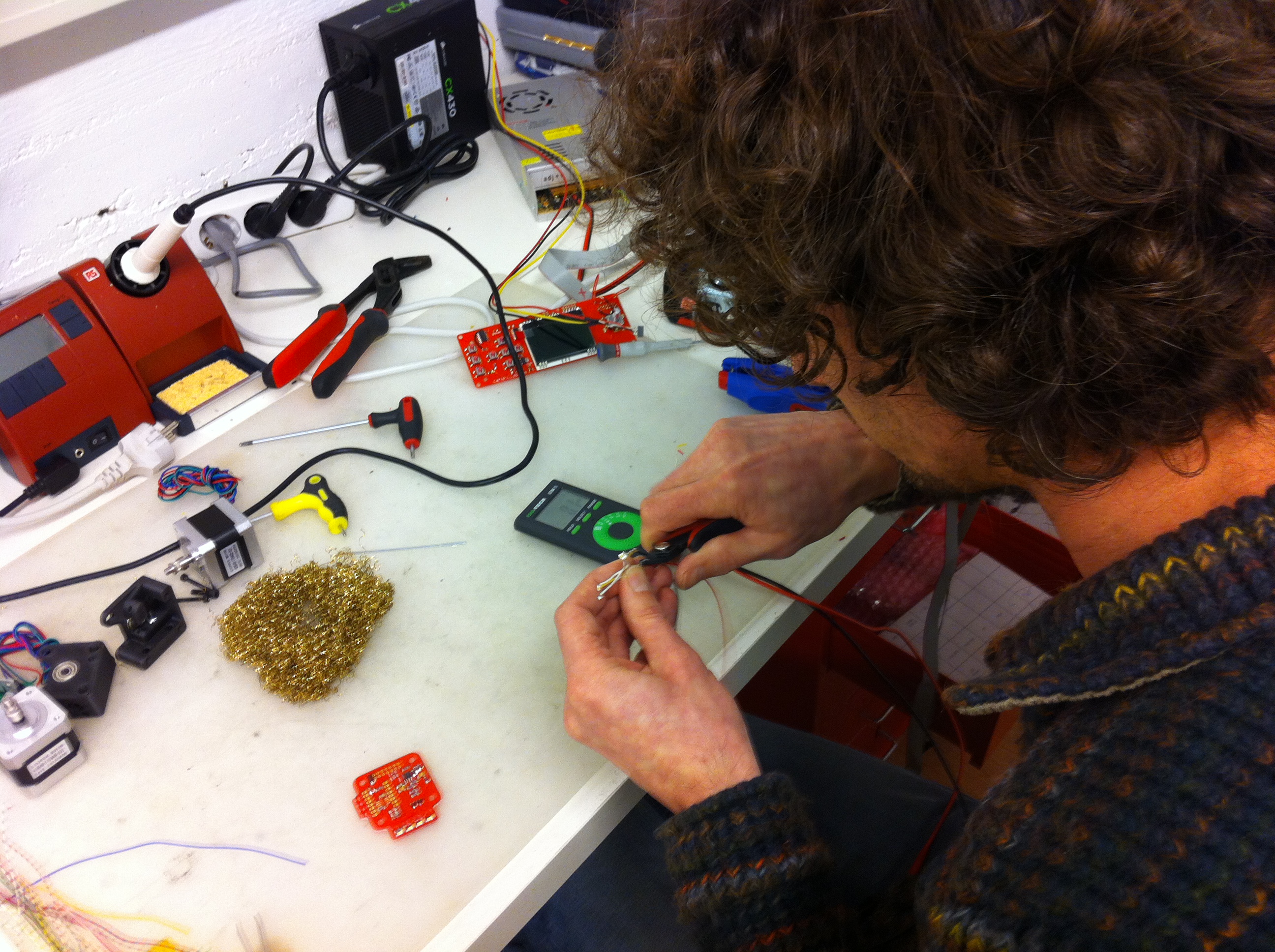

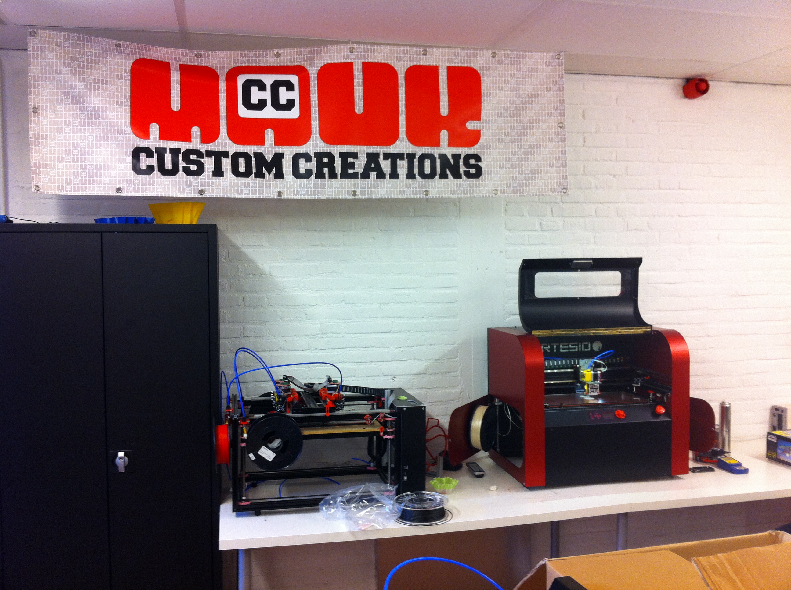

Went to my best friend Jos who builds 3D printers from scratch. ( check out: http://www.mauk.cc/webshop/ )
Talked him through my plans and he ordered the stuff I'll need to light this ship
Jos doing some soldering for me

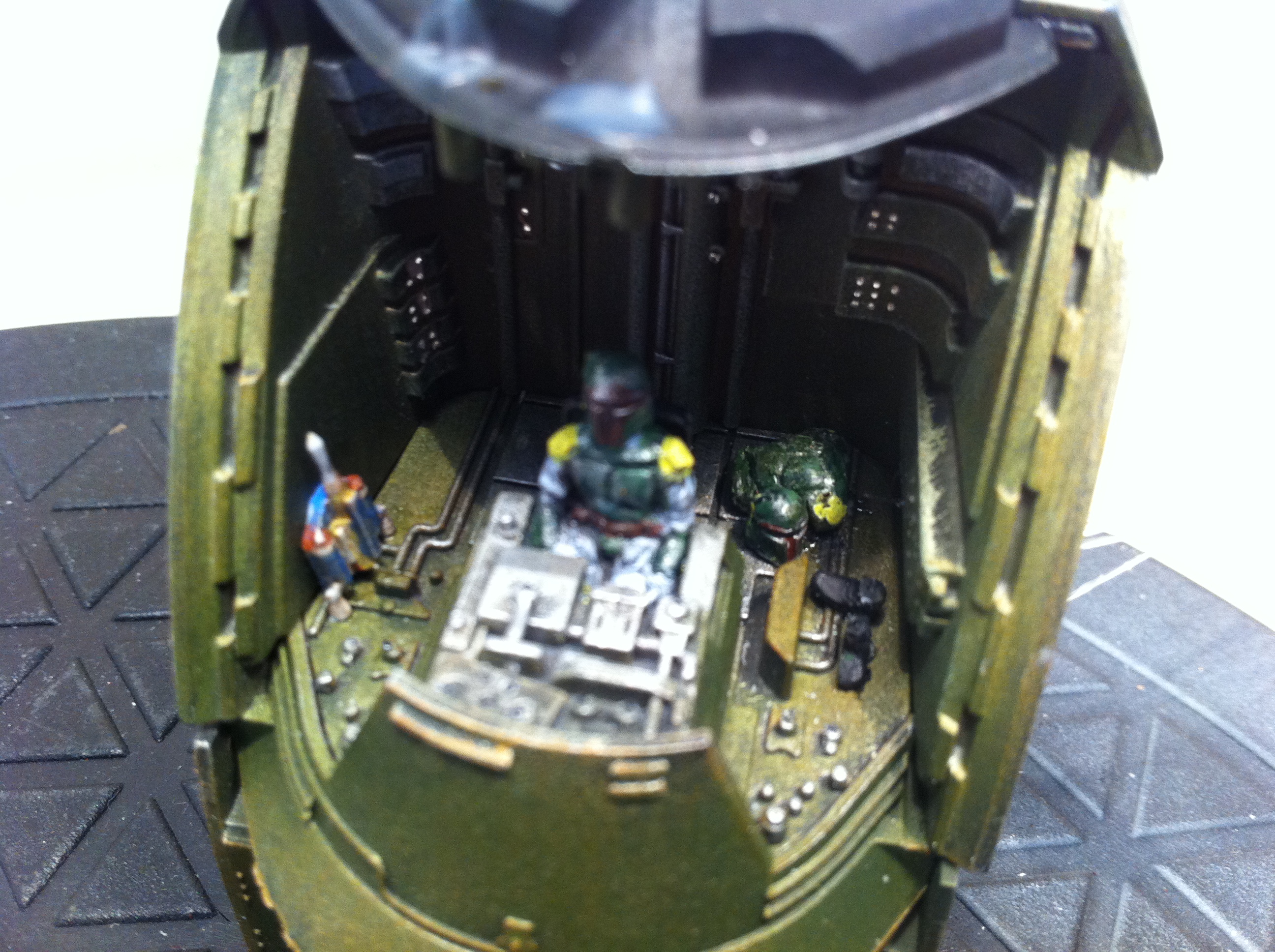

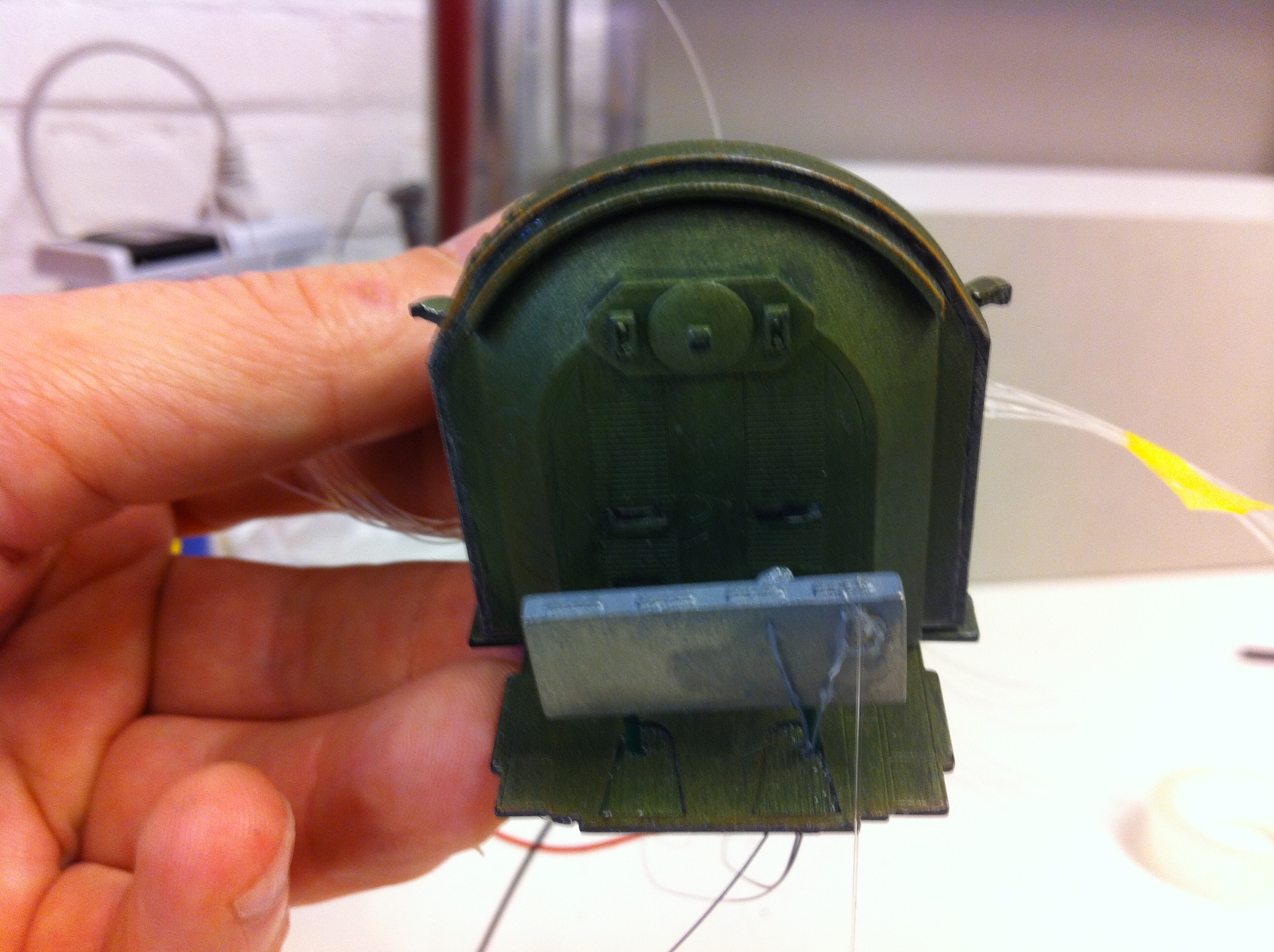

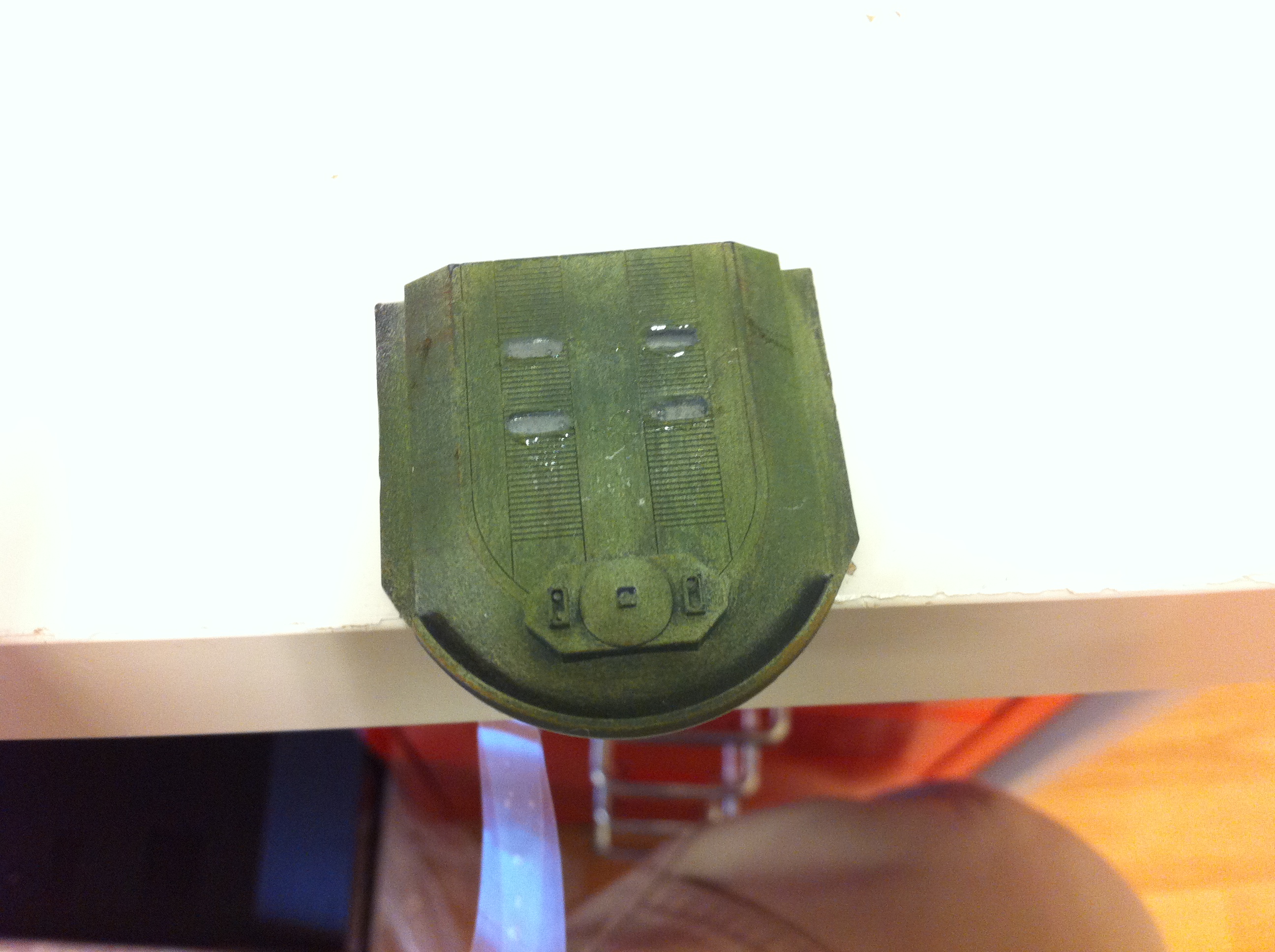

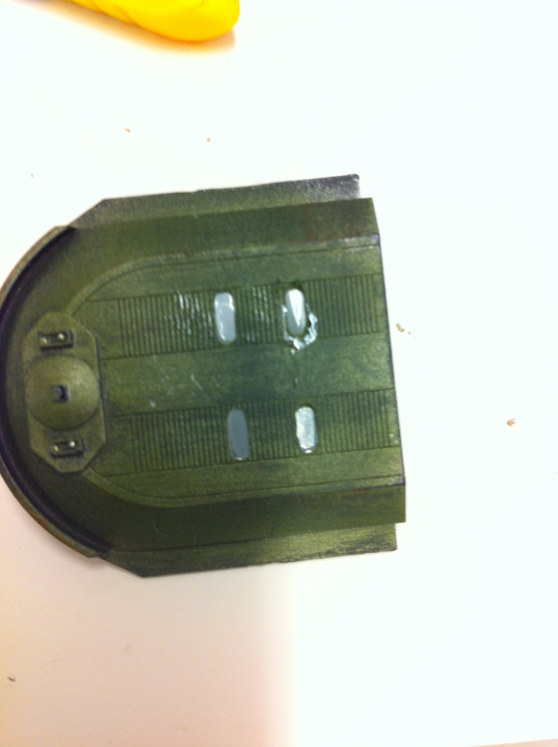

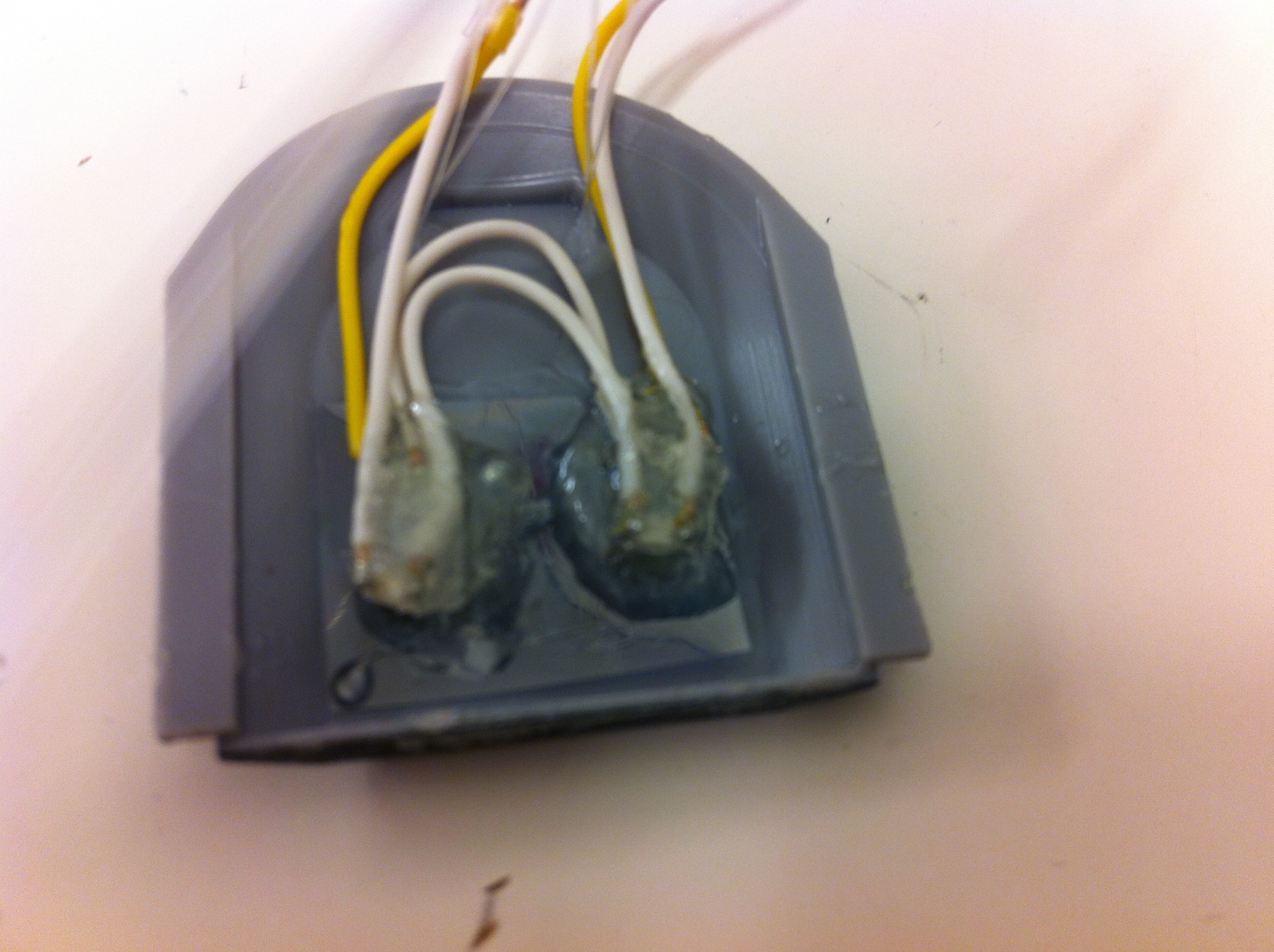

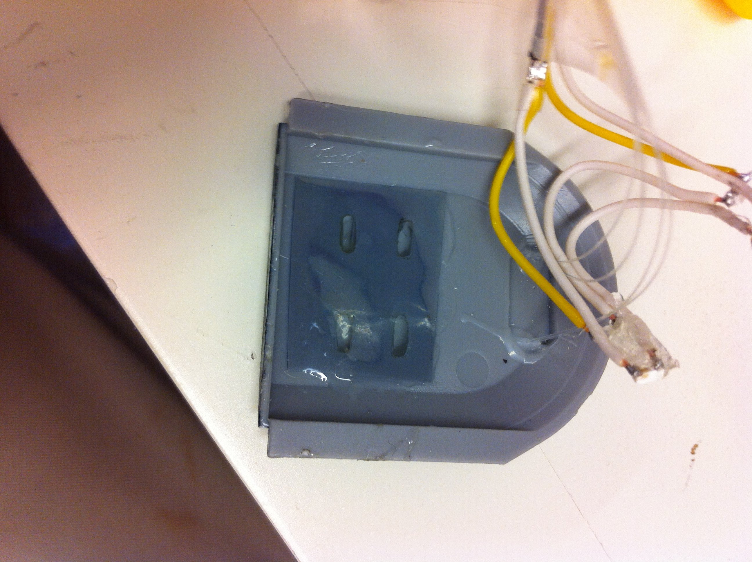

1st attempt we tried to put 4 LEDs inside to light up Han Solo. I made for holes star wars style (rectangular with round edges)
Turned out to be tricky and when I finally did I blew the LED by wiring it wrong... But we do everything twice on this build for experience so we had another go, but with only two. This was making everything fit much easer.
Jos had a great tip: use epoxy as glass for the lights. bit of plastic on the back and then filled the holes with a drop of epoxy. Instant glass in 20 minutes!
1st try looked a bit messy.
2nd try only two lights and in the mean time a constructed a little lightbox for it.
After a test the unit could be glued together (better not blow those LEDs again)
Forgot to make a photo while they were working but here it is put together (well allmost)

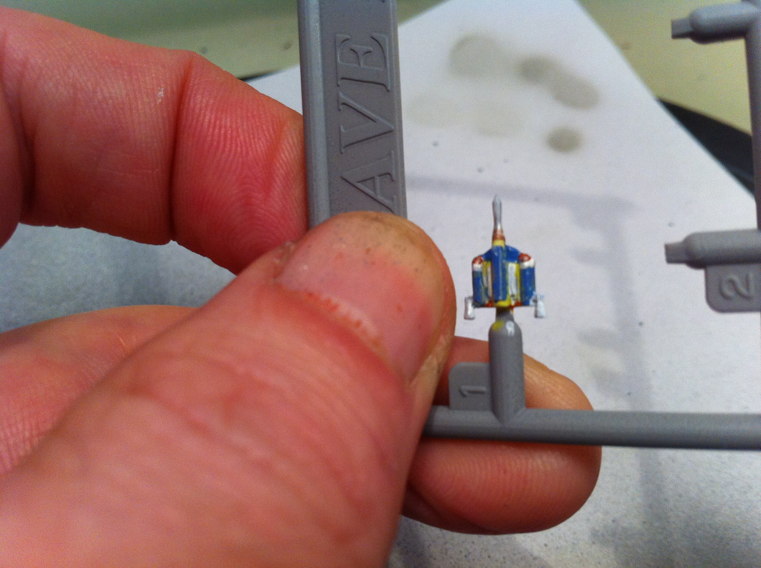

oh last thing: found the little jetpack for the standing Boba. Gave it a quick paintjob, but will give it to his brother, so he can throw it in a corner of the cockpit.

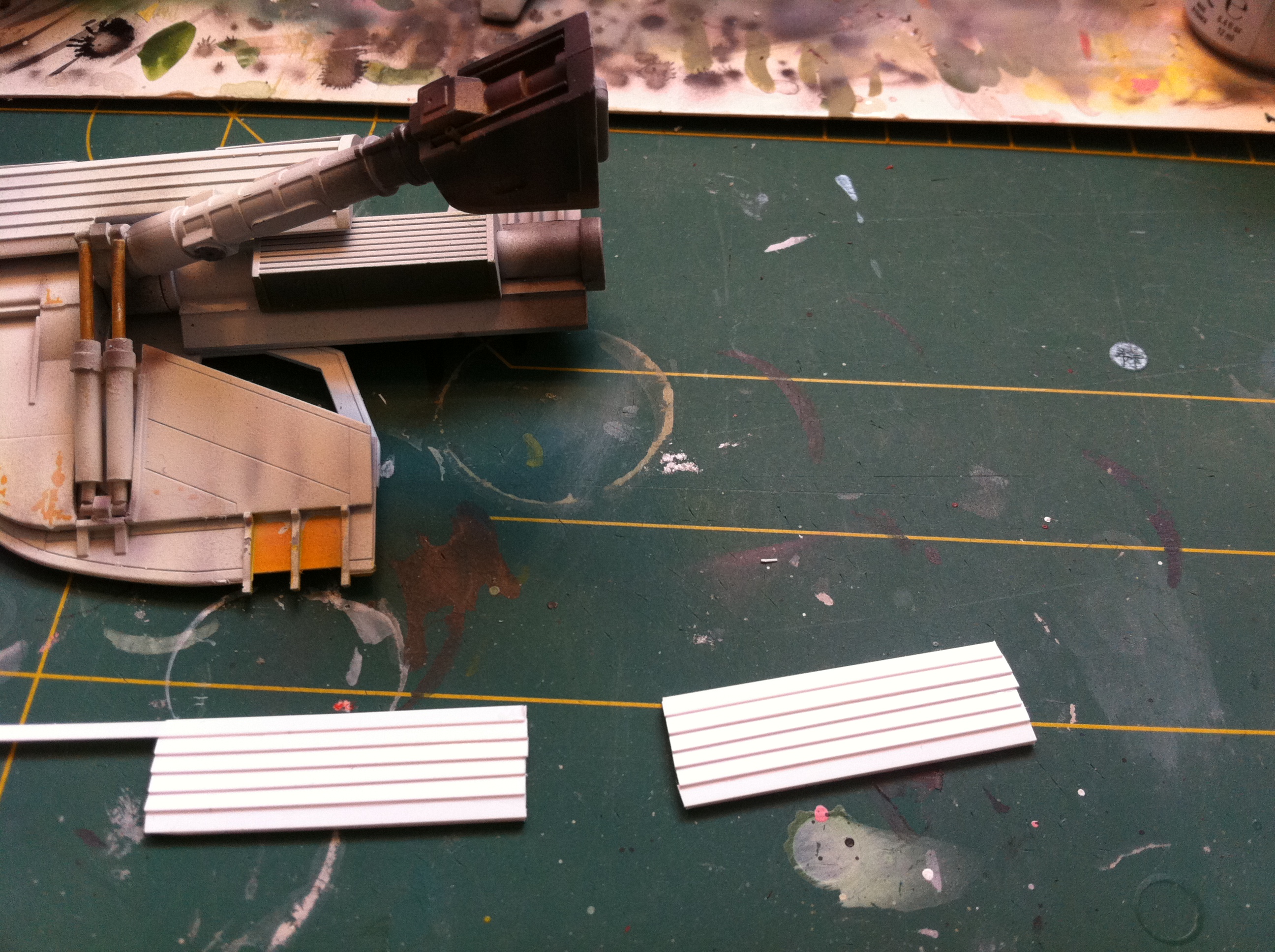

Quick update:
Noticed this week one of the wing flaps is just completely missing on the model!
Once I noticed it started bothering me more and more.
Didn't wanna build it because wing is allready painted, but after a second look I thought it wouldn't be that hard to put it on there in this stage.
Ship is build up by scraped parts anyway, so a slight difference is just adding to the story.

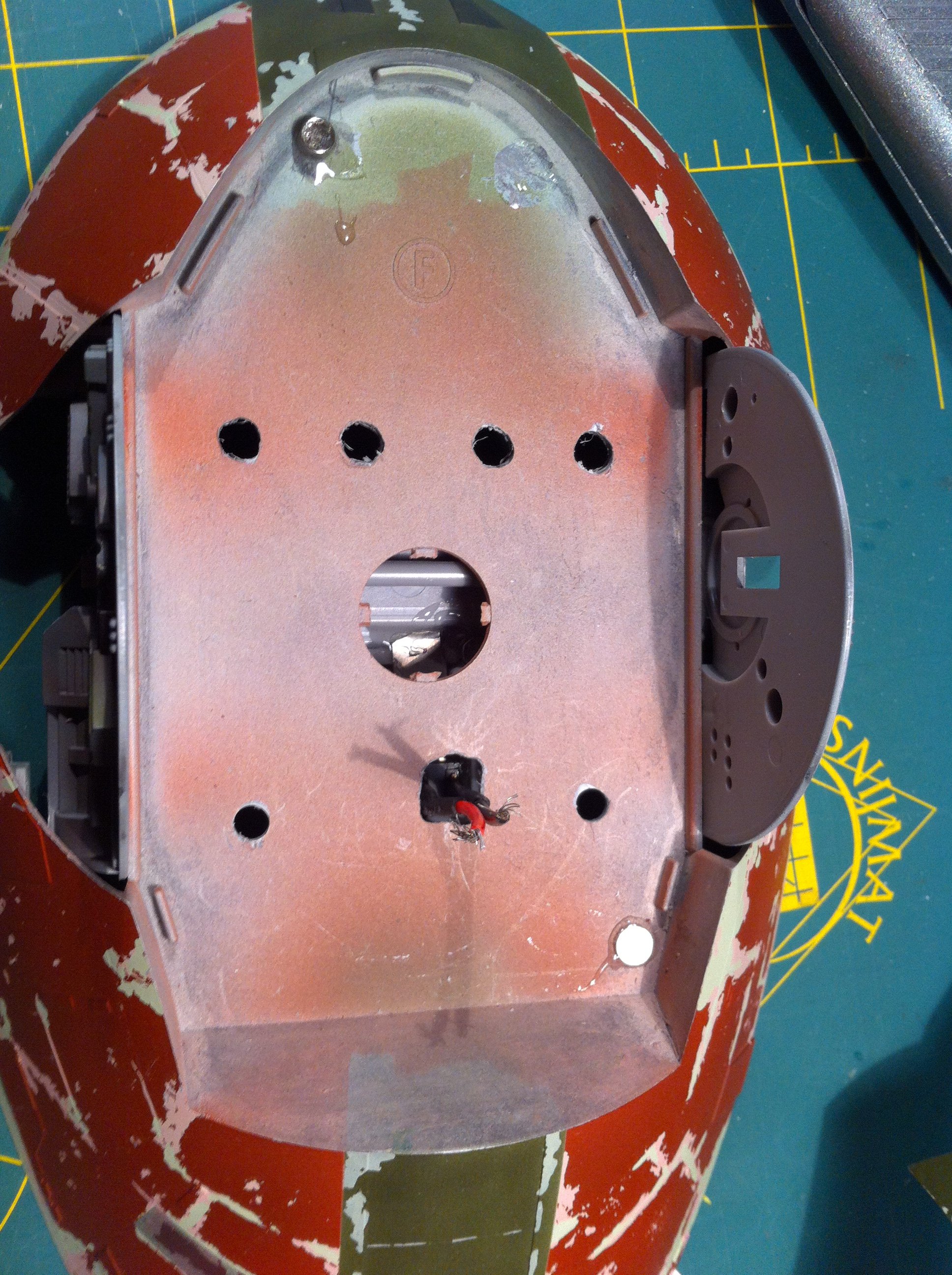

Stayed there anyway to tackle some other stuff: Drilling holes for the engineLEDs and glueing magnets for the switch and canopy.
glued some M4 bolts to the canopy and 2 magnets to the hull.
Tried to do it to pretty, but that was to fiddly, so eventually went for the easy, but sturdy way:
1st I tried to fix two metal parts to part and had two magnets behind the big holes on top. Did work: plate didn't fit nice because of epoxy and it didn't hold well all together.
so I decided to fix the magnet to the part and glued a part of a break-away knife to the skirt.(yes I did dull it before glueing it on to prevent injuries).
Works perfect!

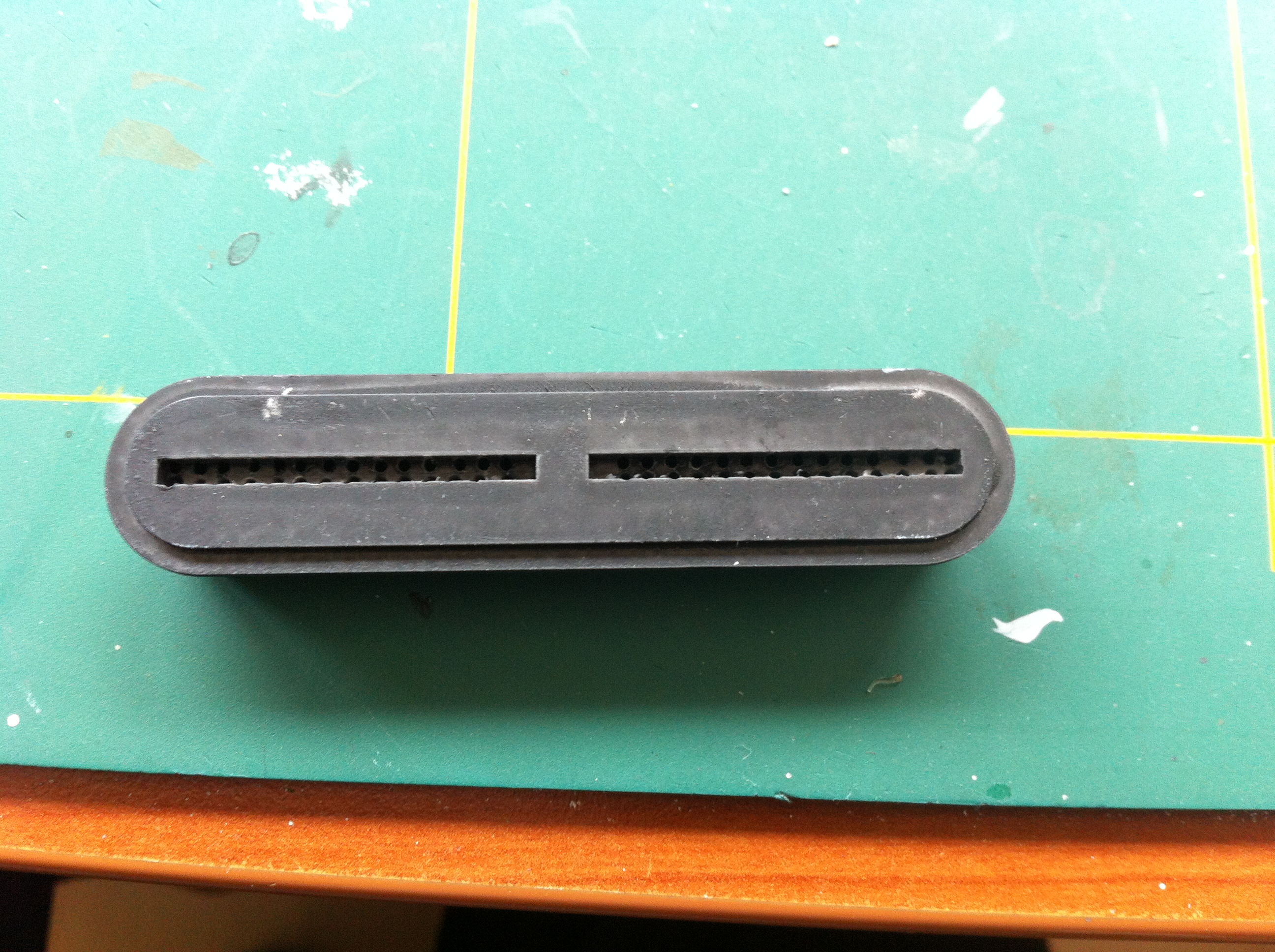

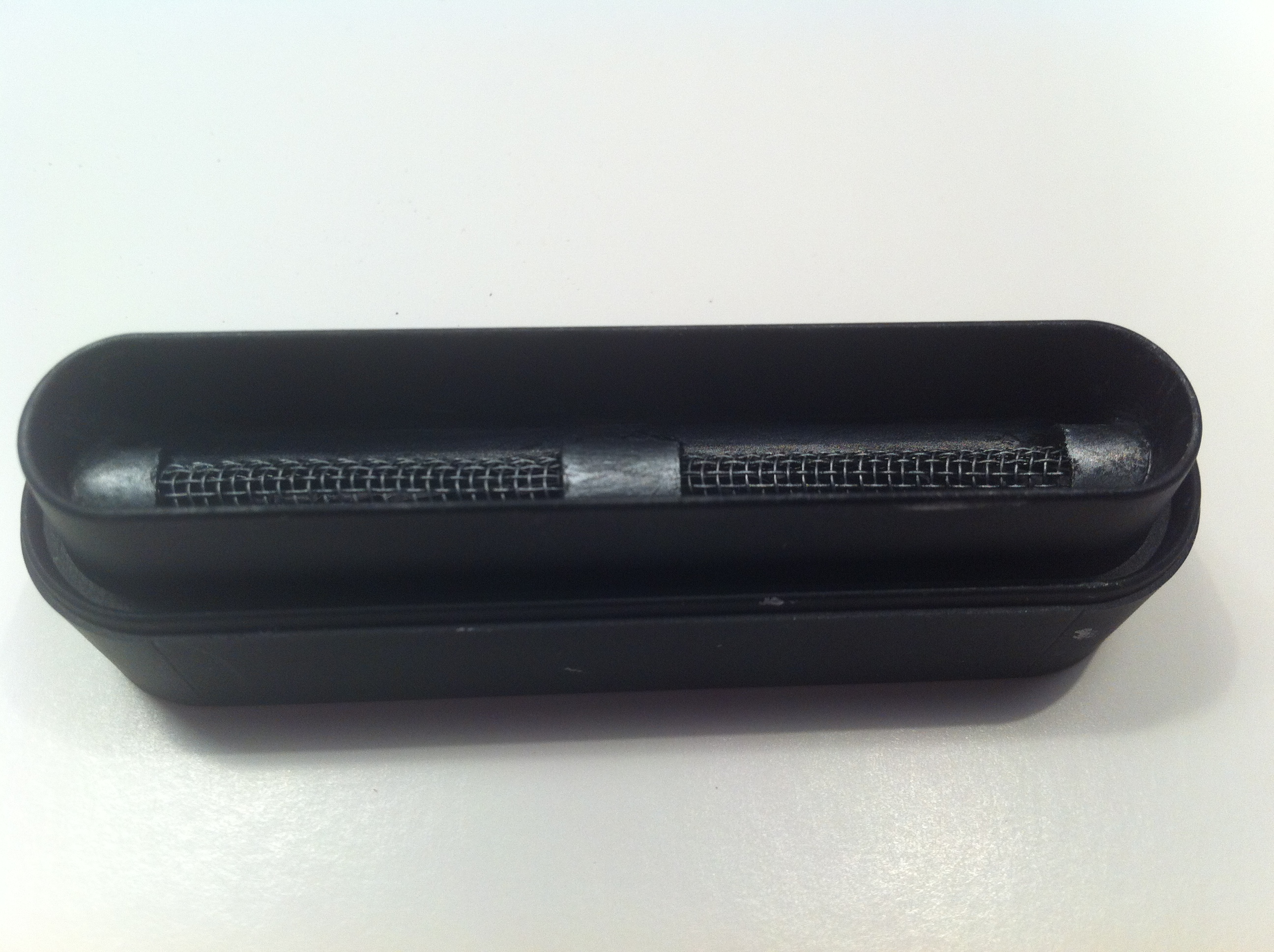

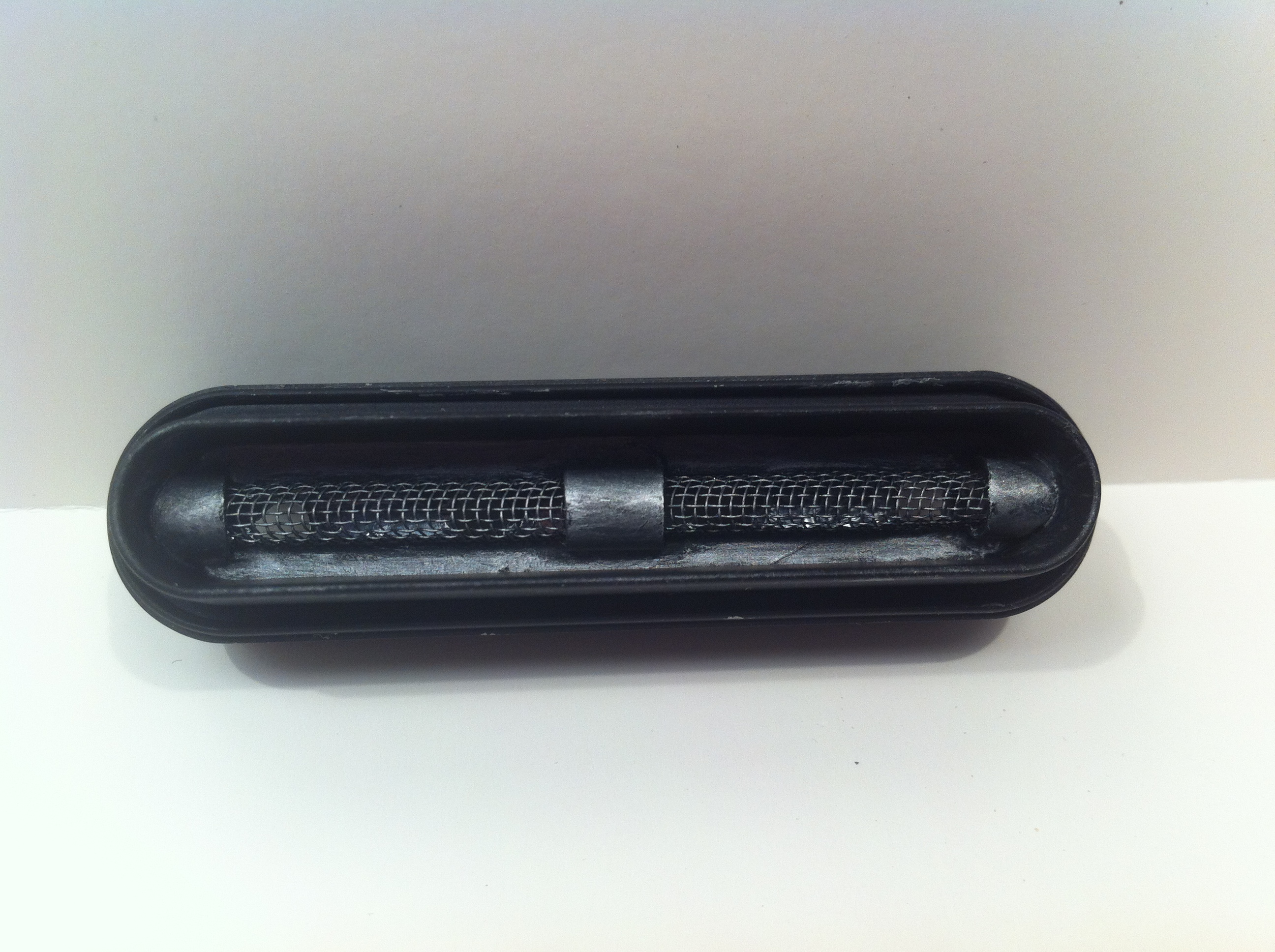

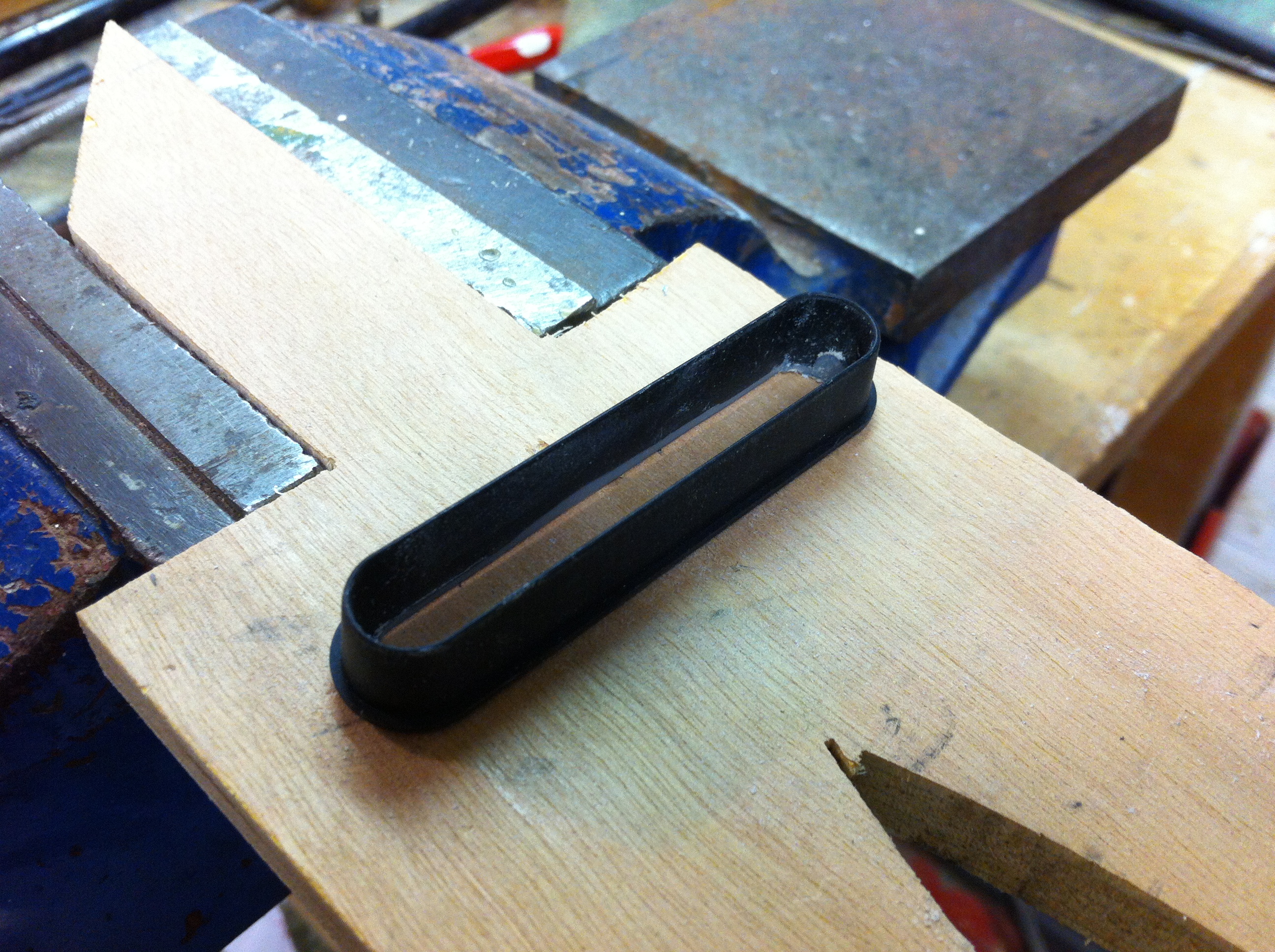

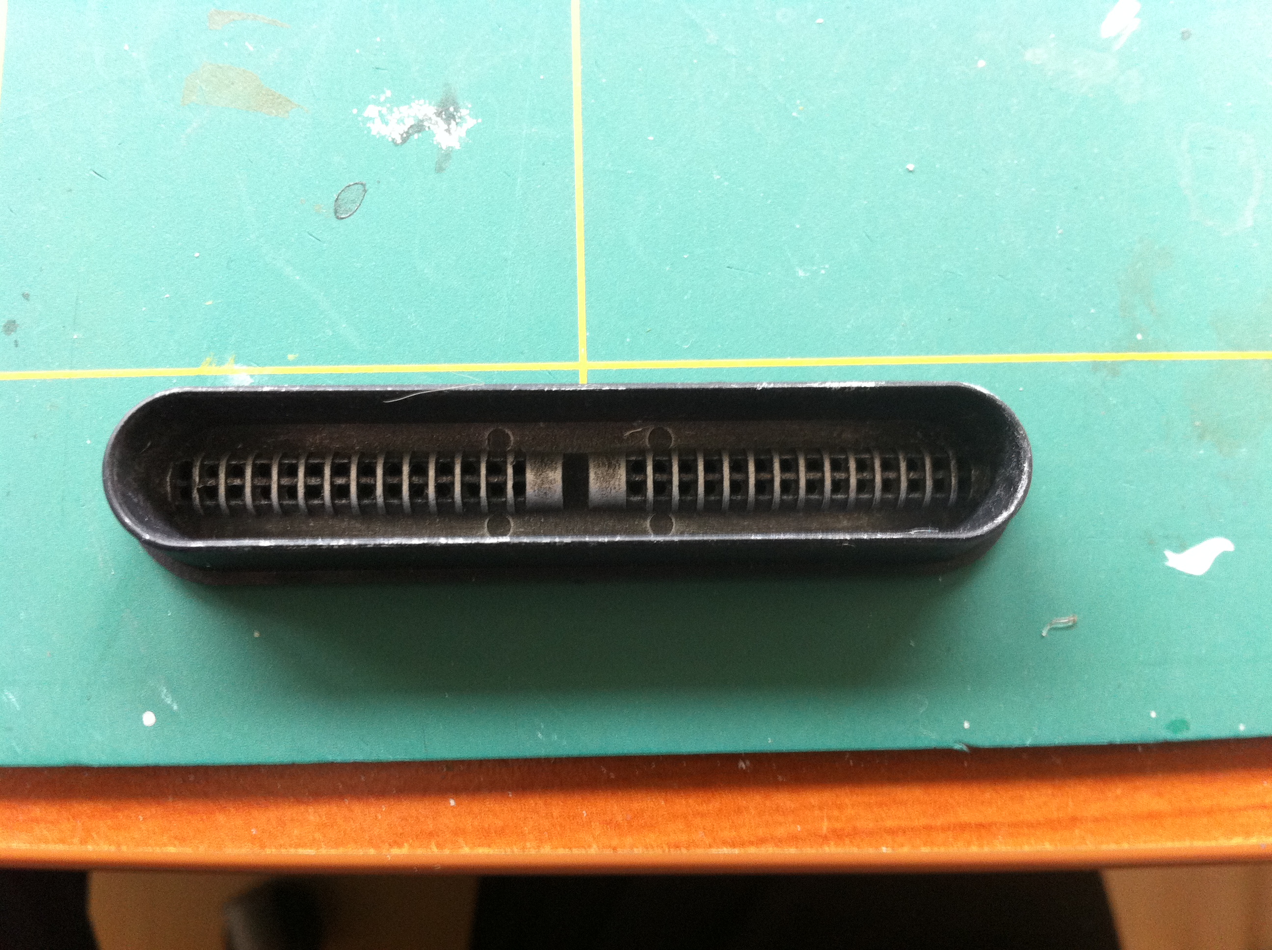

Then I went to my father's workshop. Without him I never would have the skills and dedication to do this (thanks dad). Could take the jigsaw home since he had a spare (thanks again dad).

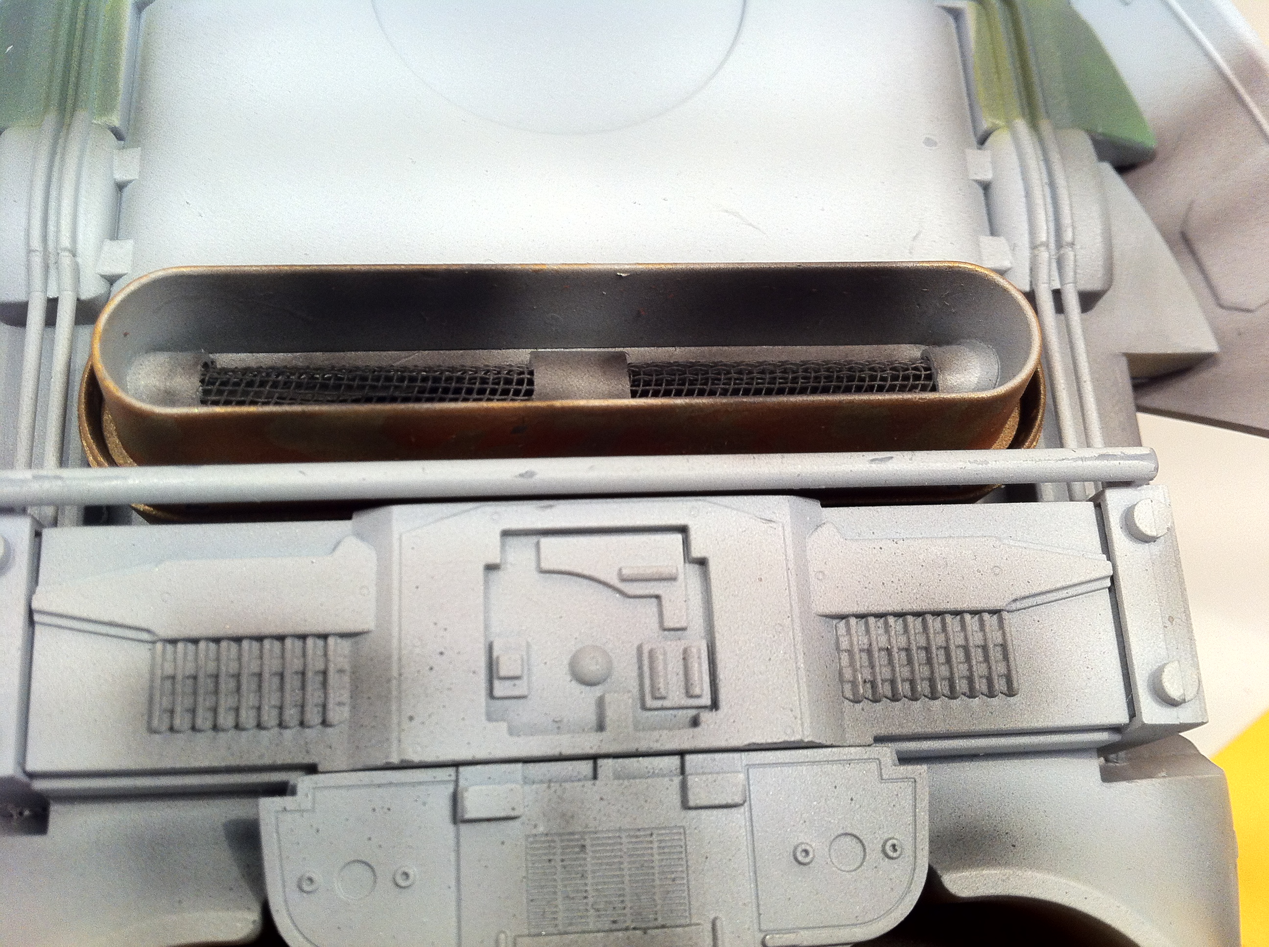

Took a jigsaw to remove the bottom part of the rectangular engine. Filled and sanded it clean.

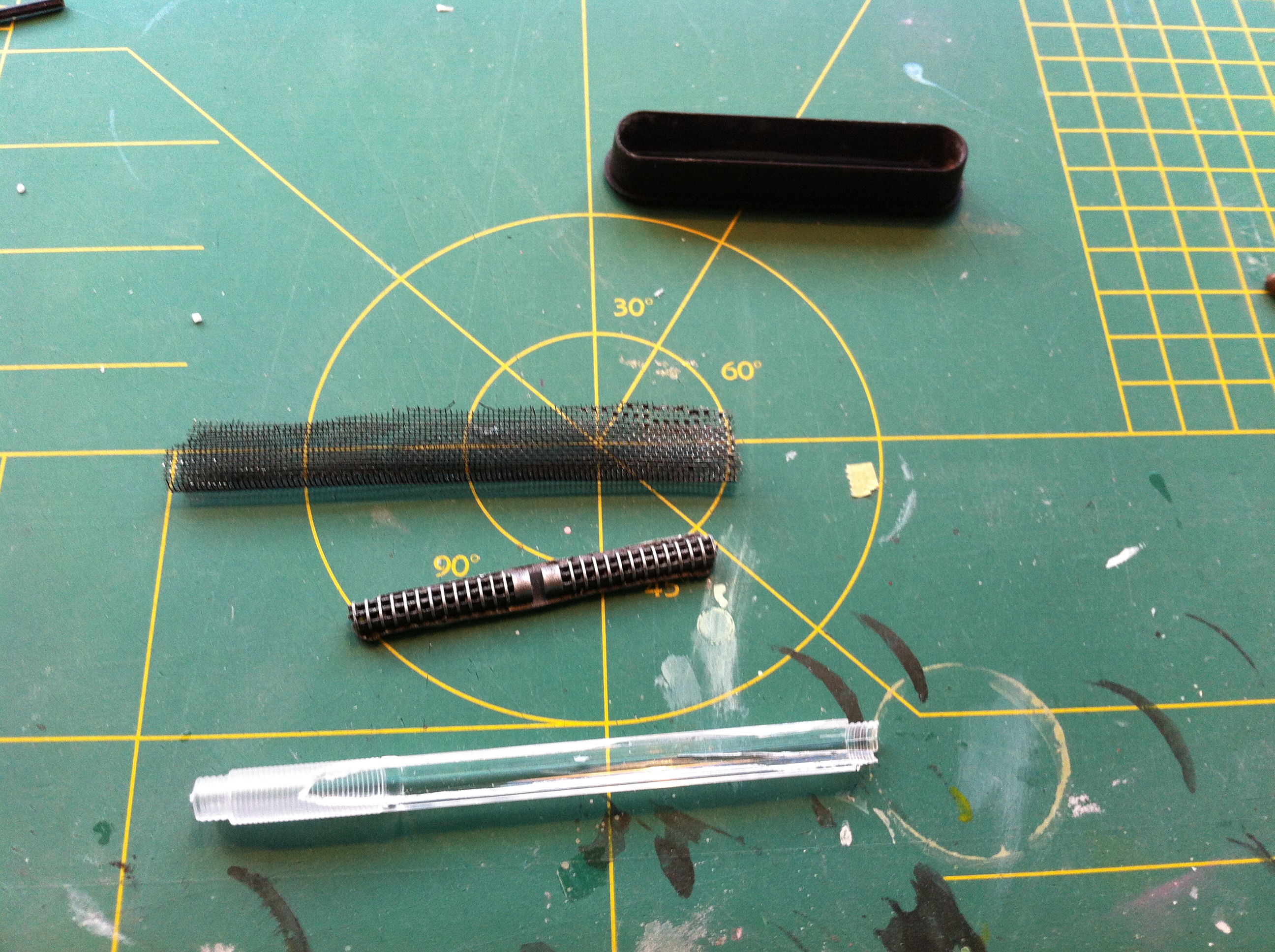

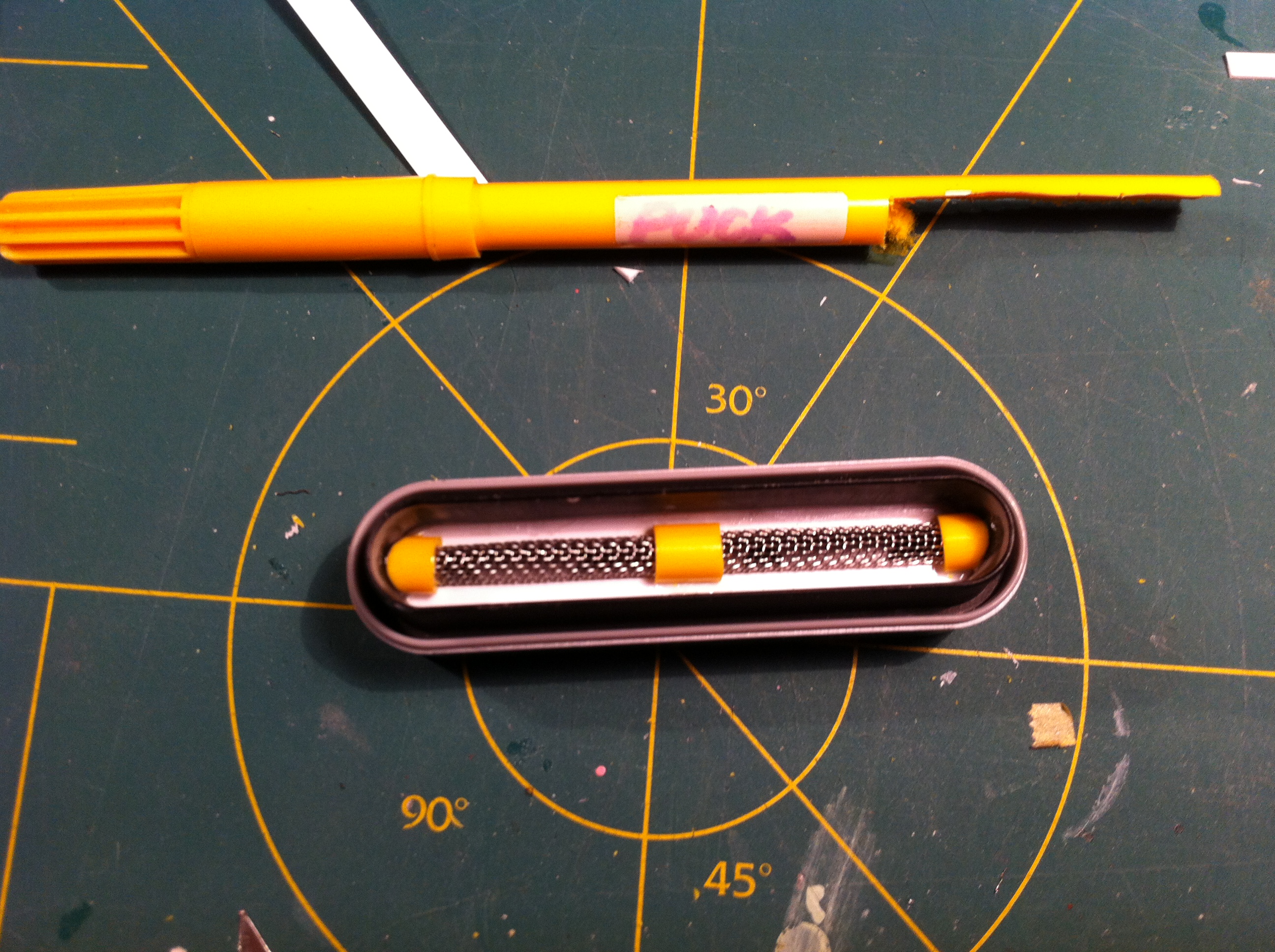

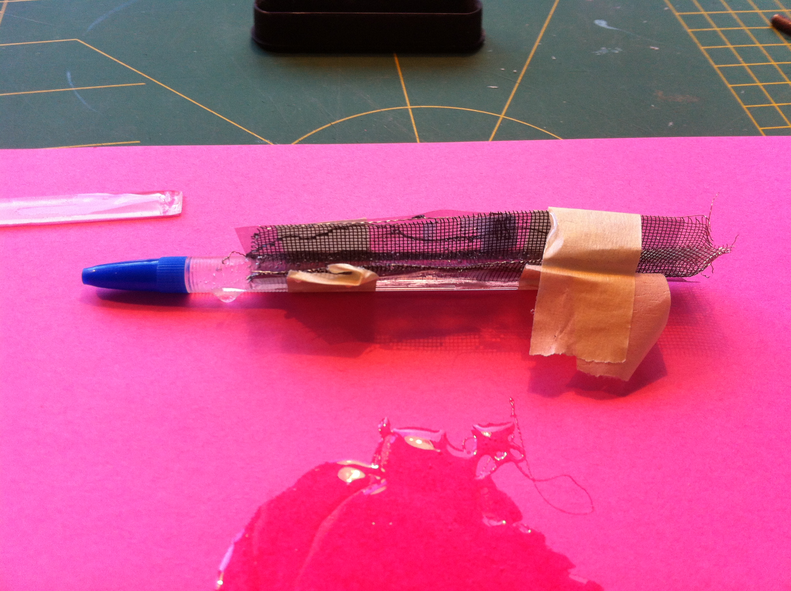

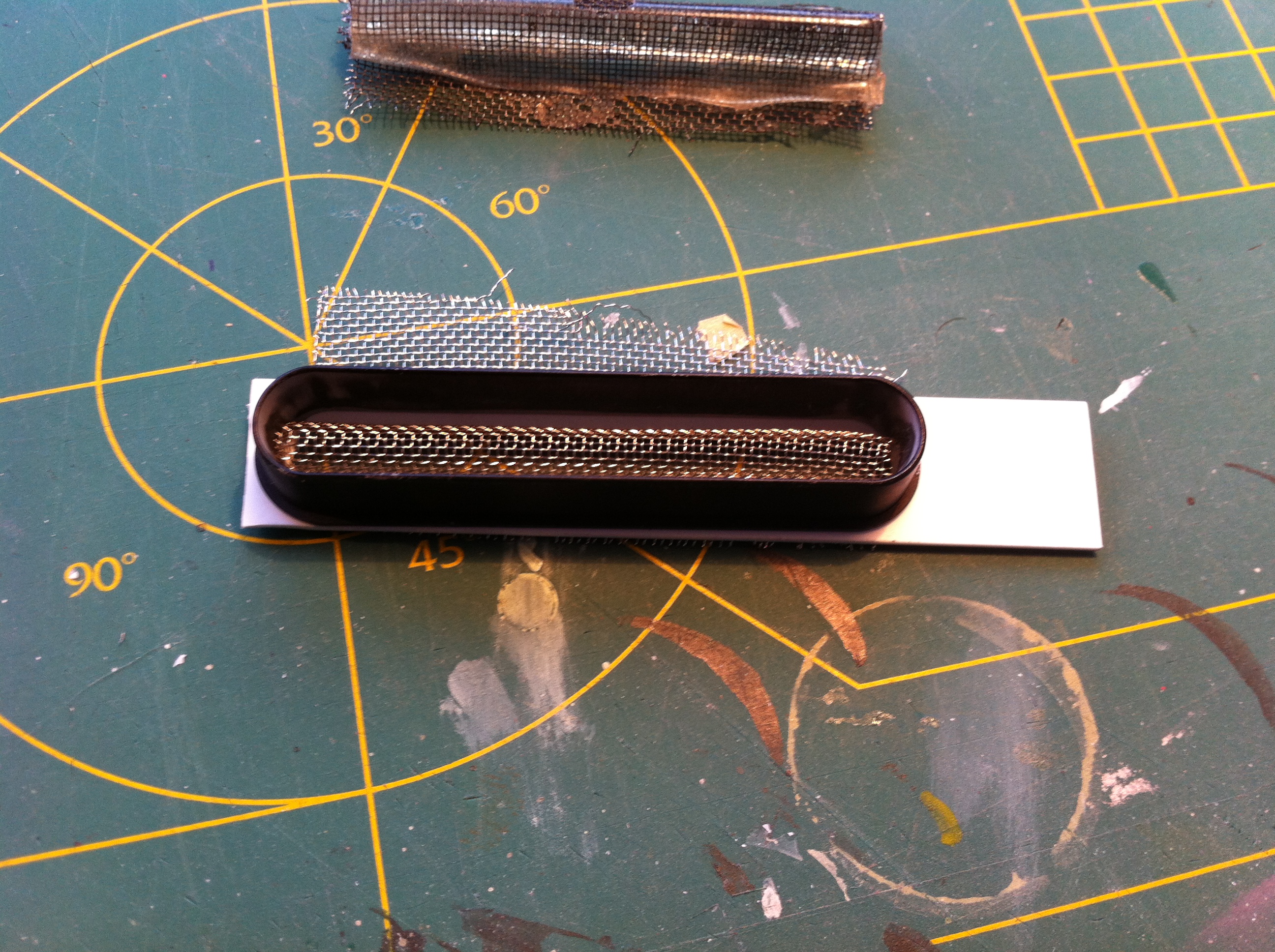

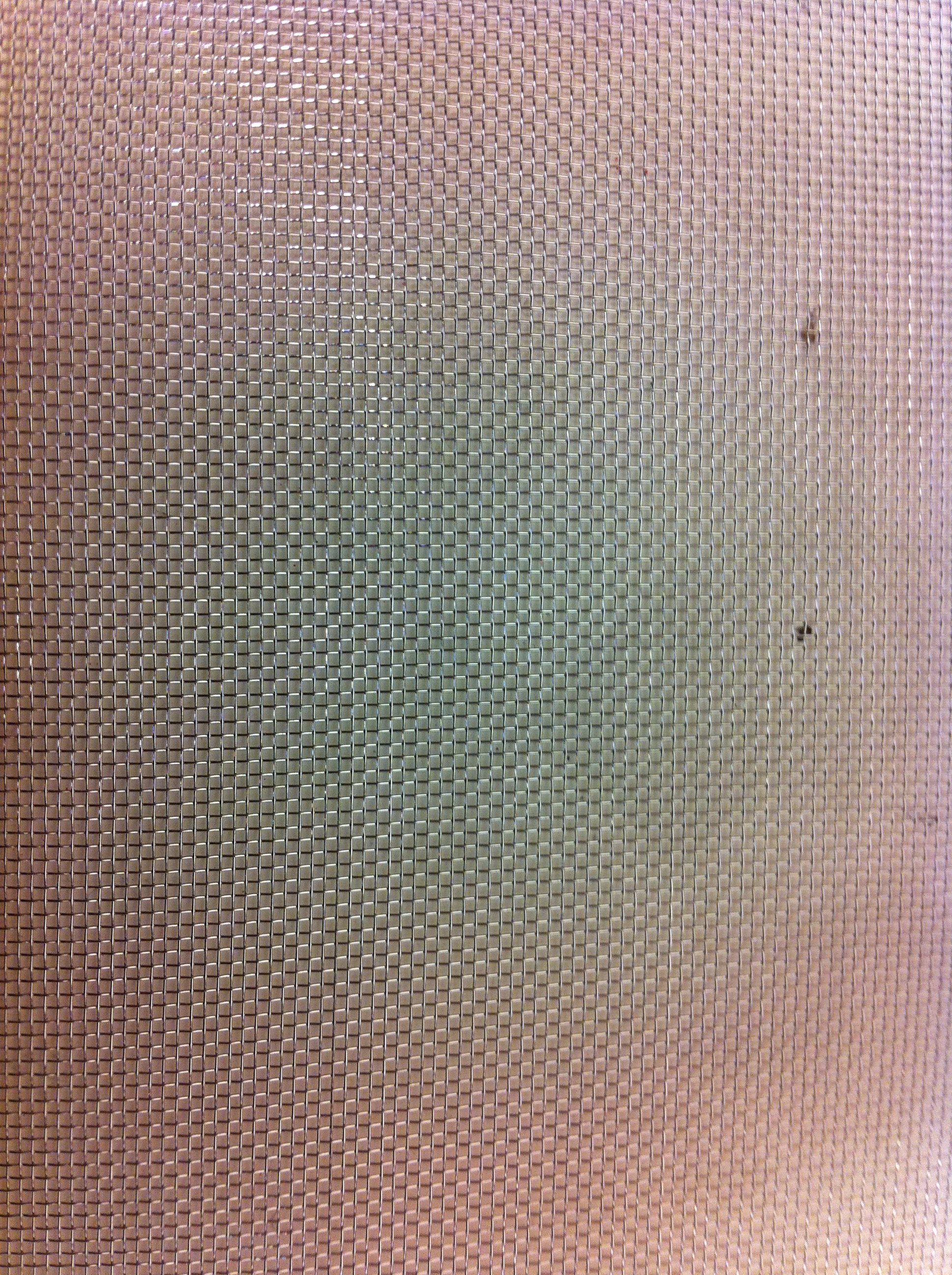

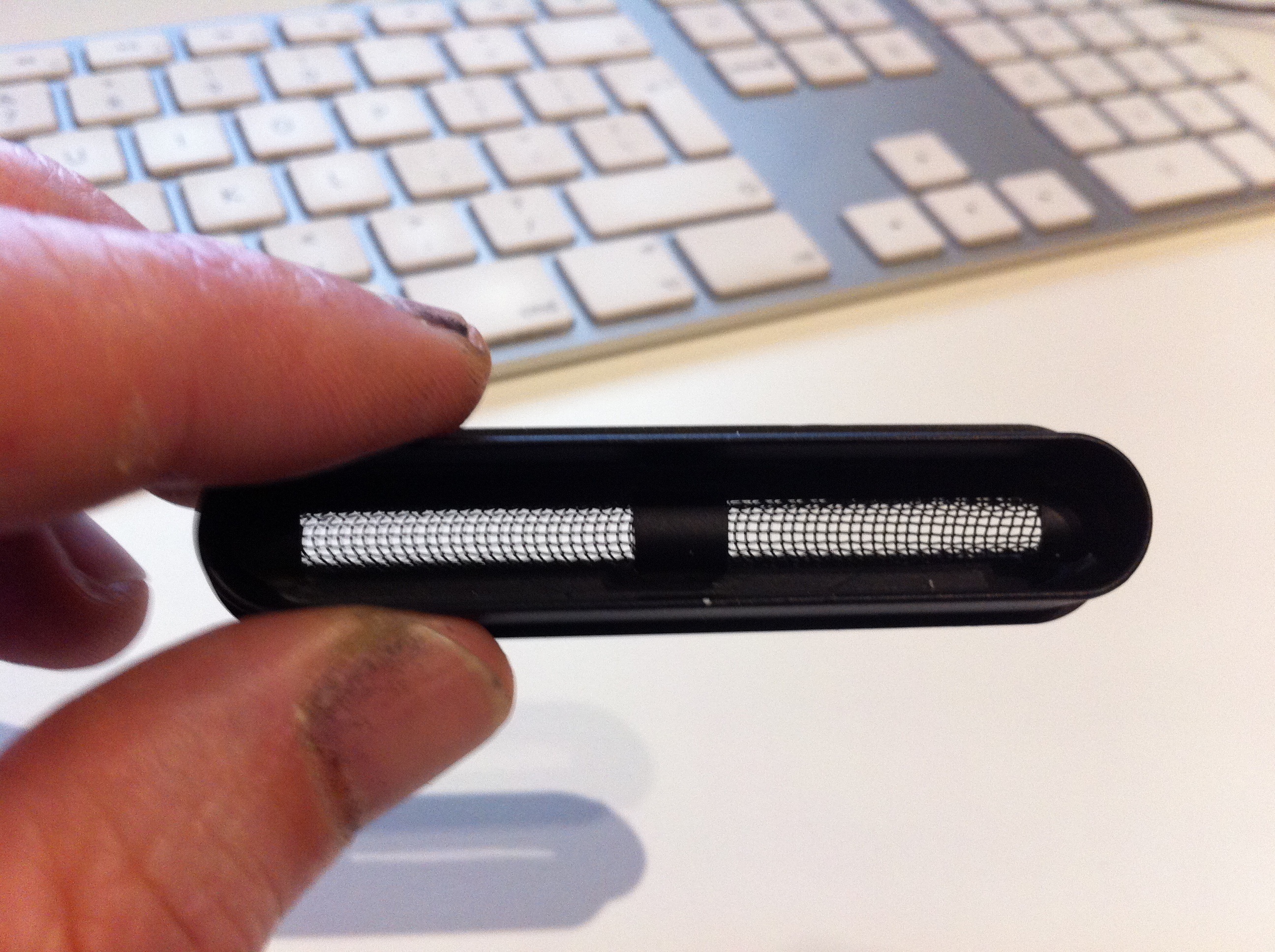

Did a lot of trial and error on the rebuild. I knew I wanted to make it out of this material. What's it called, a sif? Found a splatterguard, where the material is nice and even.
Cut it with my Stanley knife (it needs a new blade, but great for making straght cuts).
Curled it around one of my files and made a contraption out of an old pen to cast it in epoxyglue.
Lot of work, not the desired result, so threw that idea away.
So this is what I came up with:
Two styreen strip on the back, the grid in the middle. To make the details I needed some round thingies. Took one of my son's pencils (thanks Puck, he hates yellow anyway).
Glued it together and sprayed it with black primer. Really like how it turned out.
View attachment 444949View attachment 444951View attachment 444950
Still have to find a way to diffuse the lights somehow behind that grid, since the epoxy wasn't working.

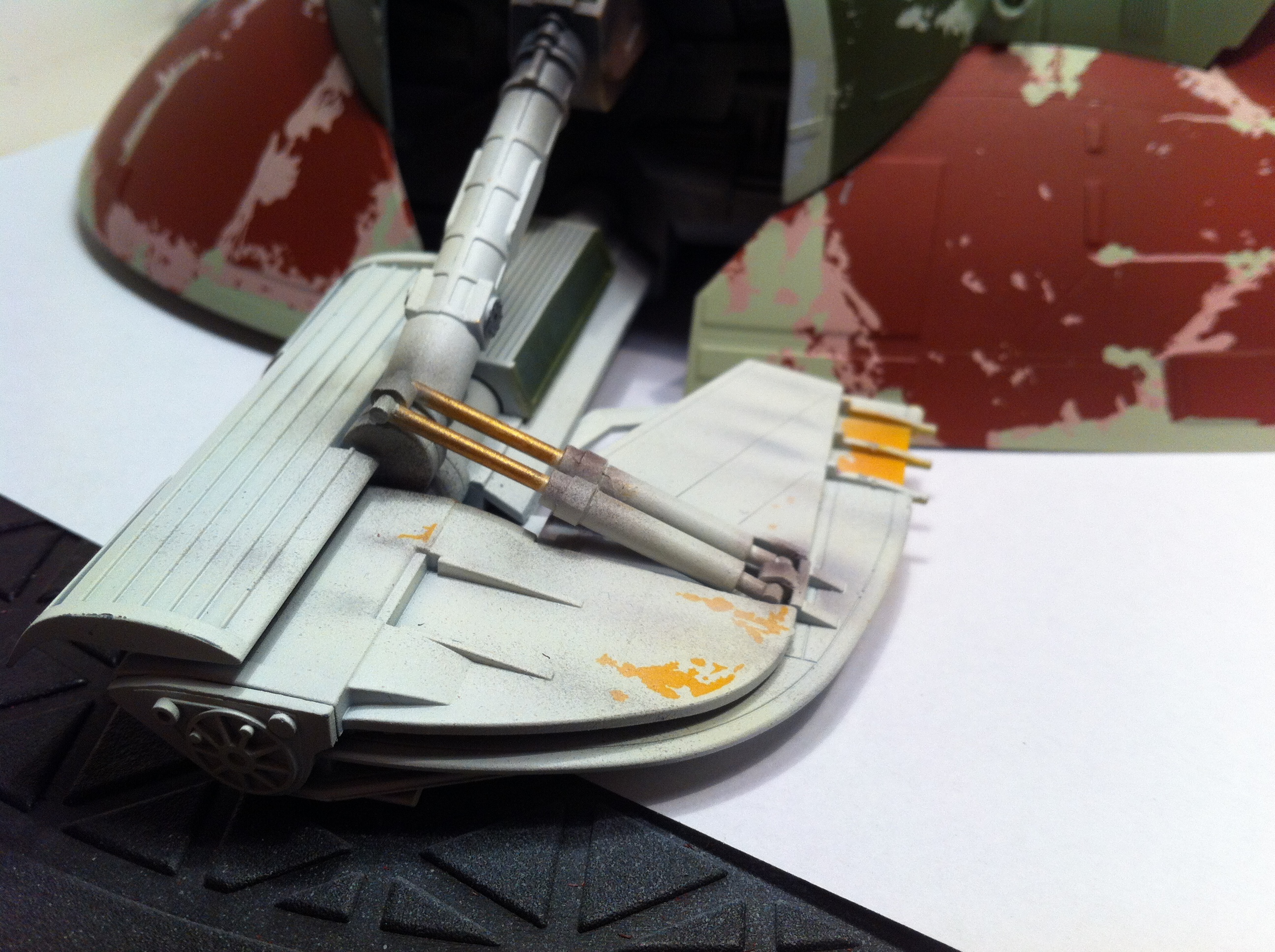

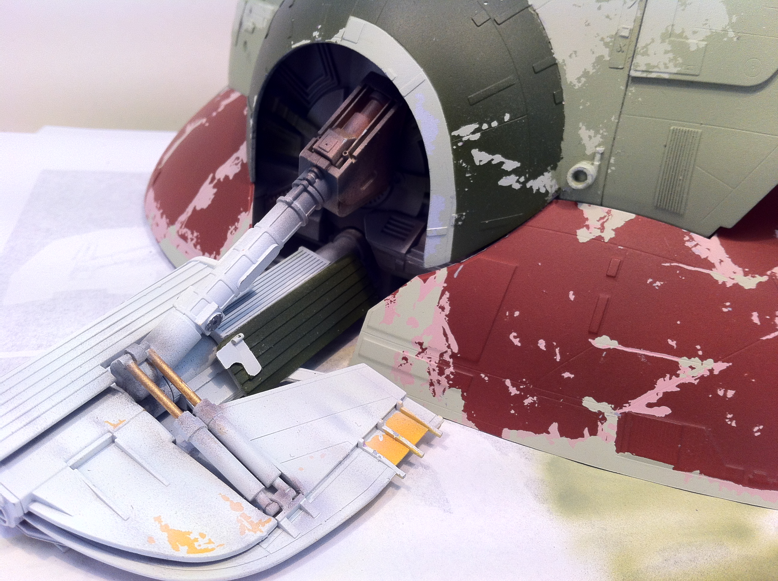

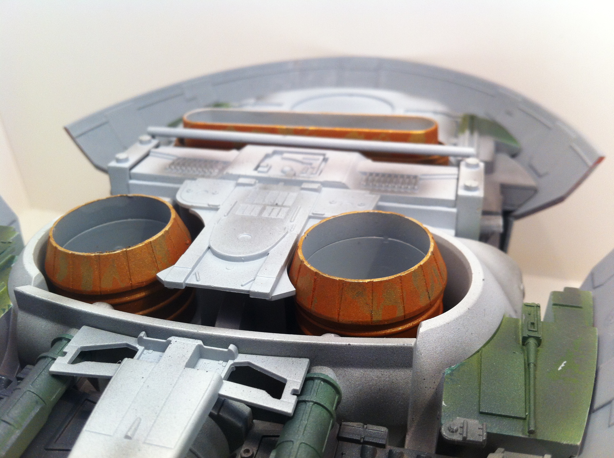

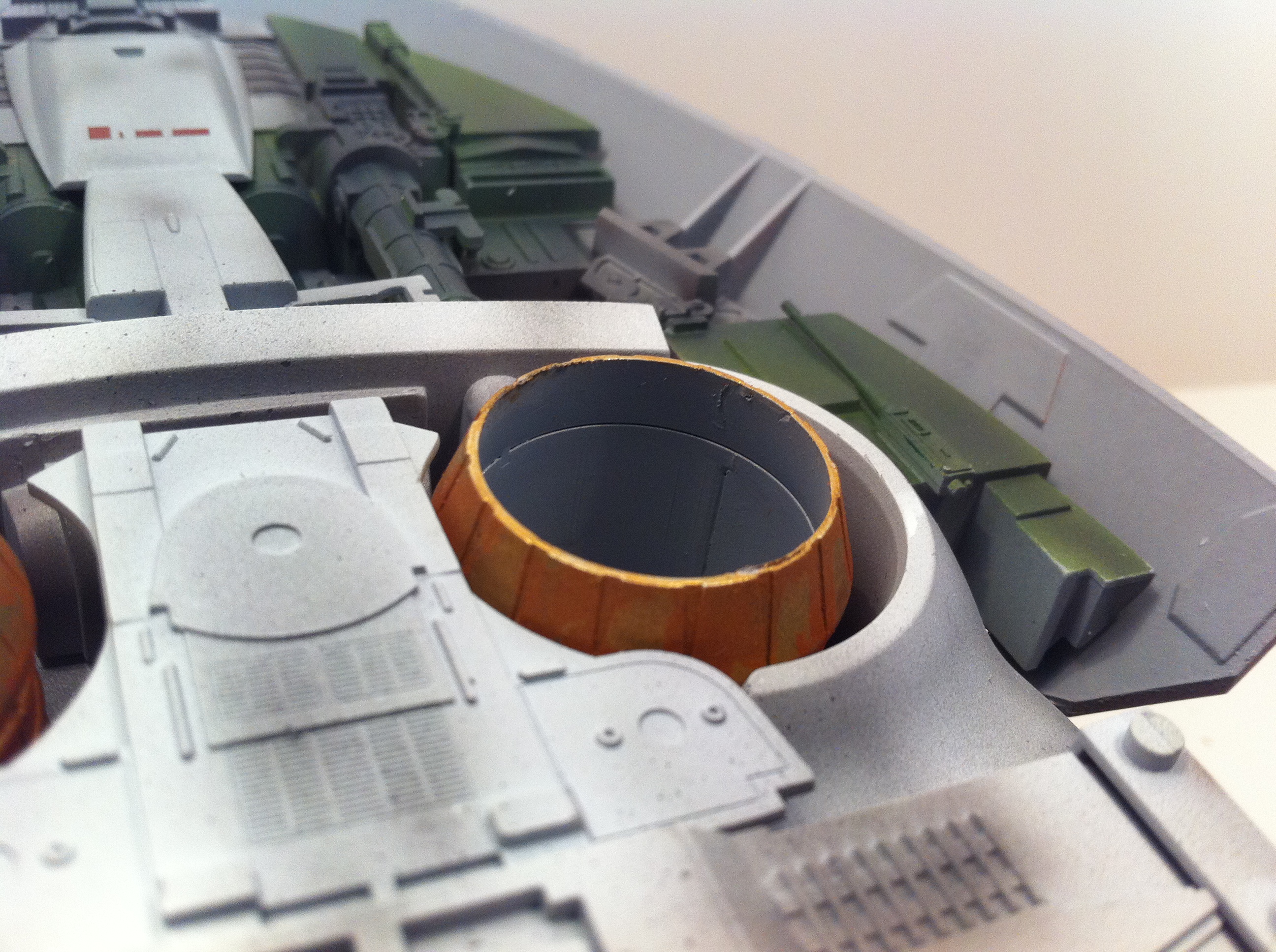

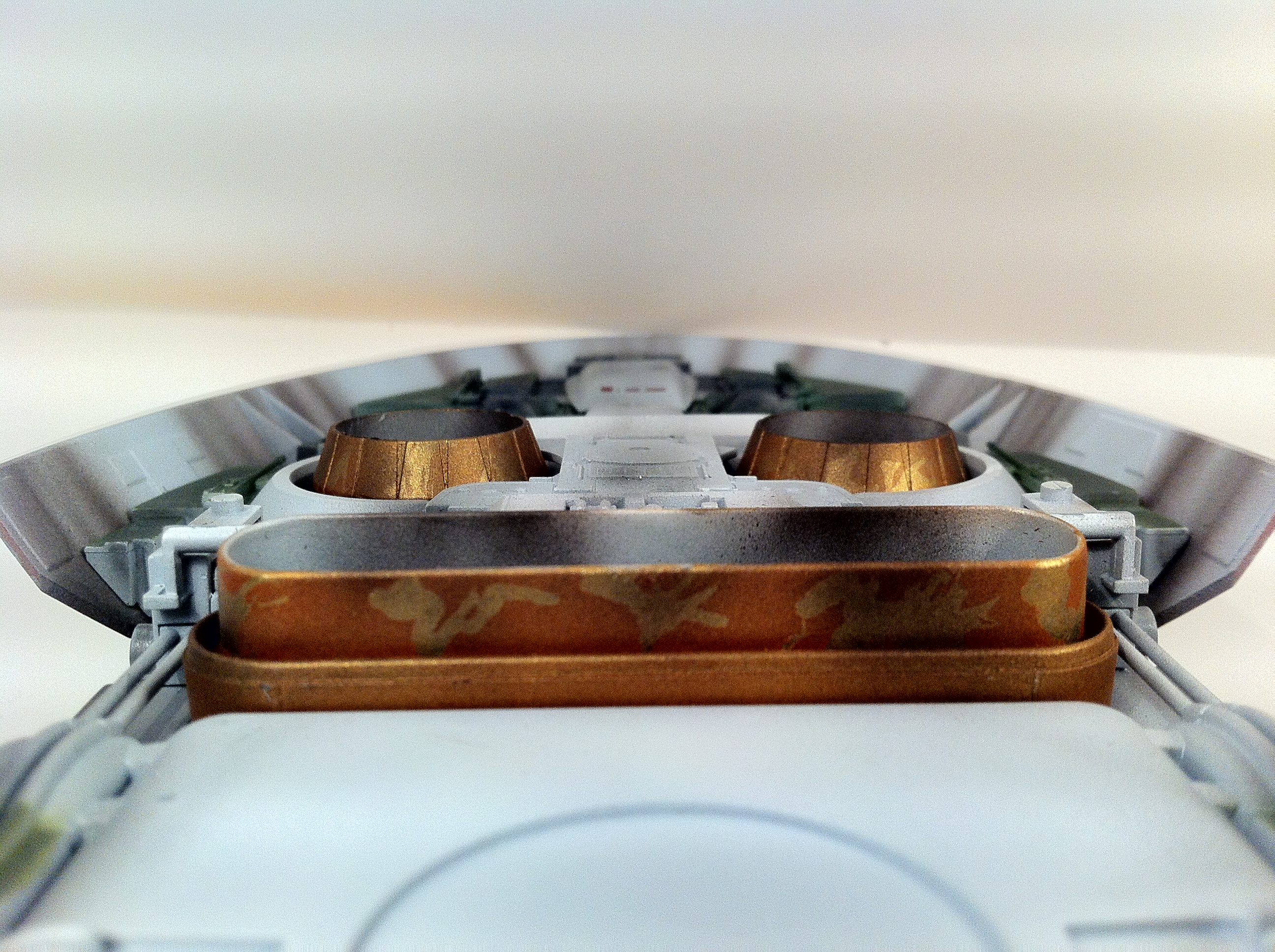

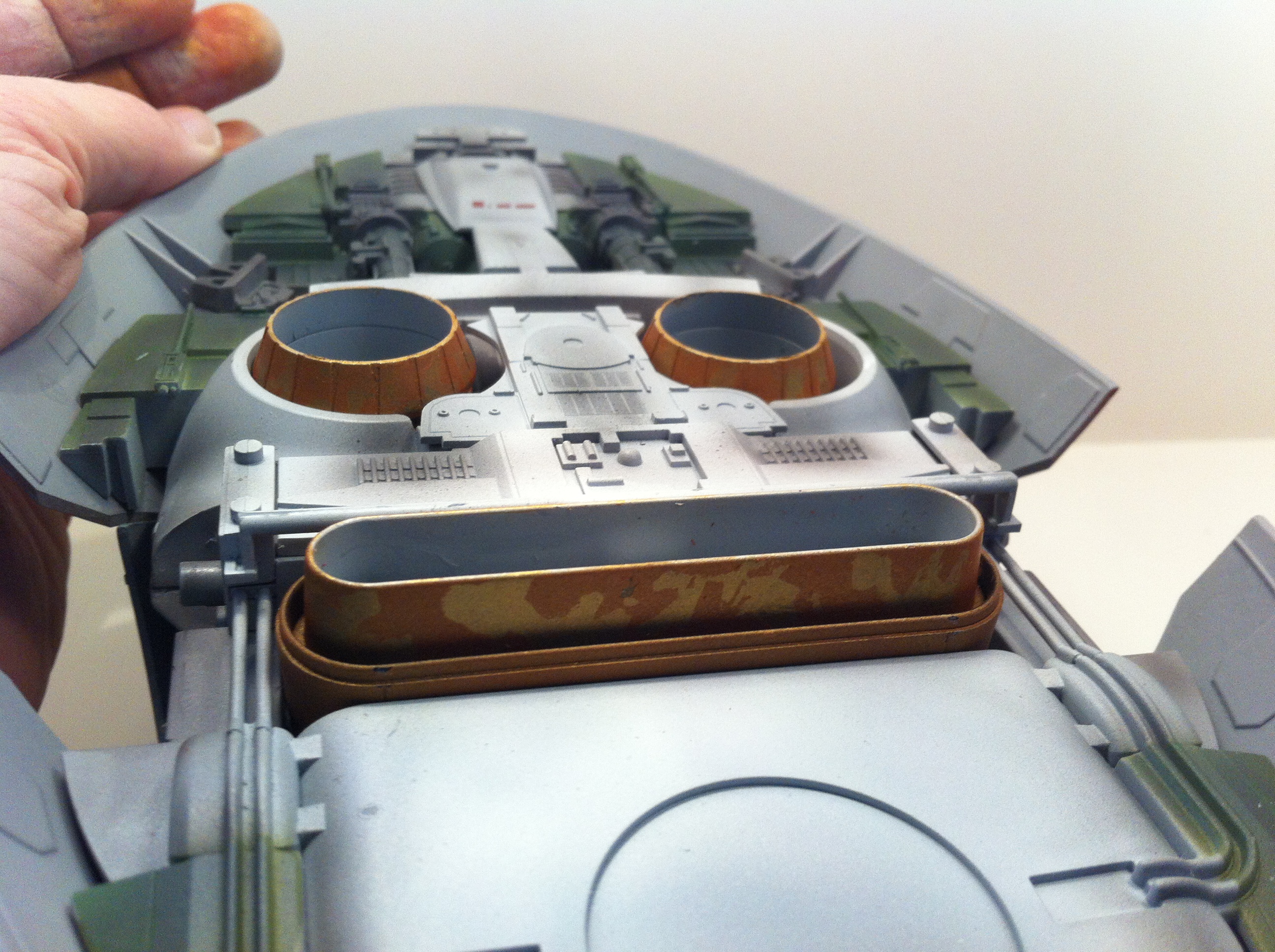

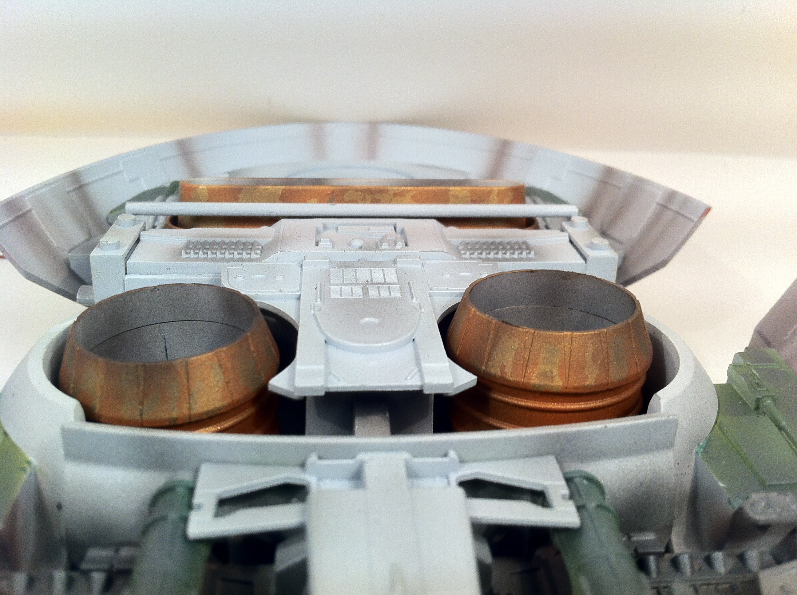

Painting the exhausts.
started with a coat of brass, then masked and mixed what was left in the airbrush with some brown to get the copper look for the second layer.
Still had to weather the underside of the skirt again. So I did that. Then I gave the exhausts a burned look.
Still no lights as you can see. Can't wait for those engines to light up!
Thanks for watching.
