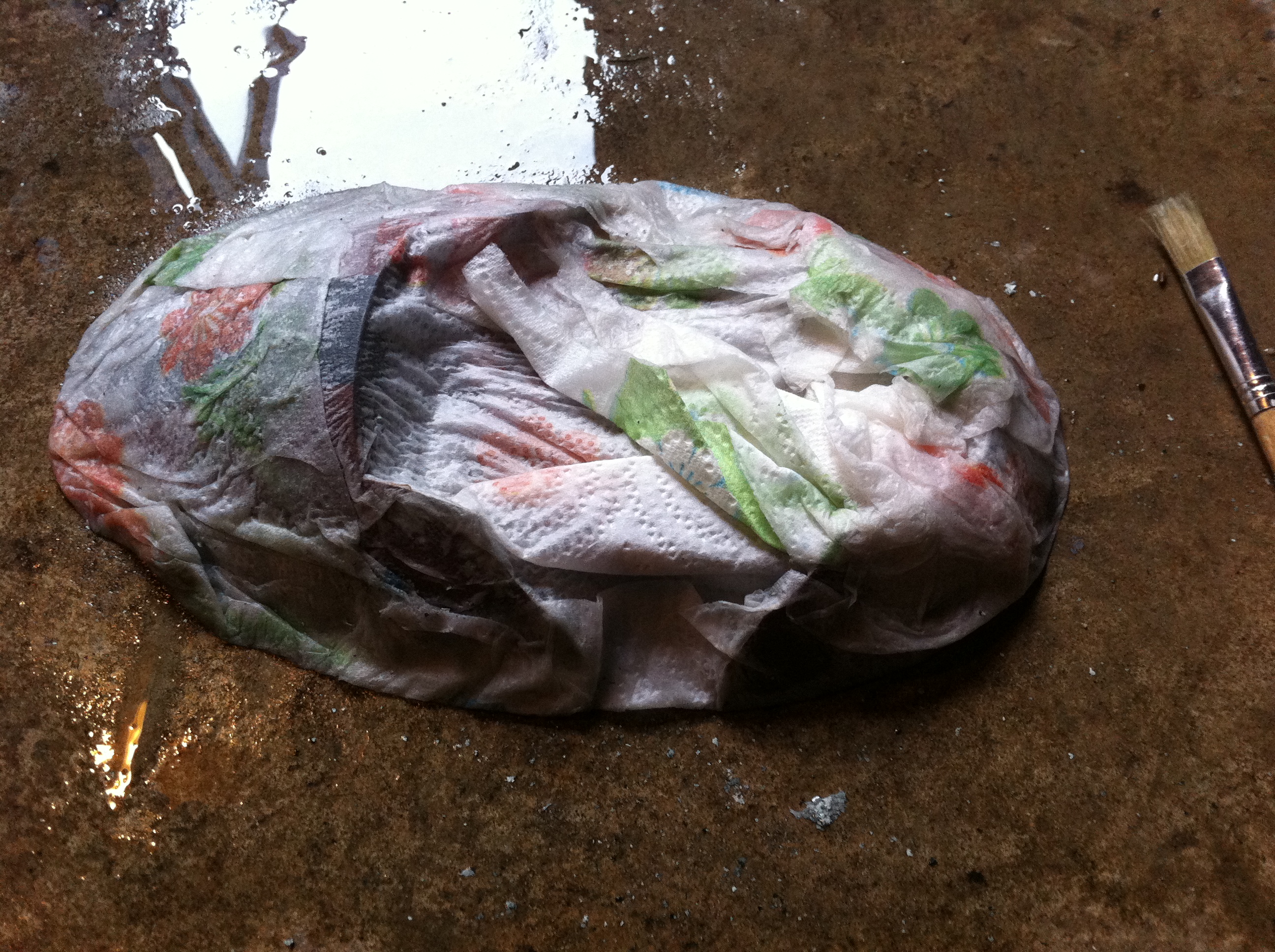

Found a Great thread on a thinner available here in the Netherlands. Active ingredient: 2-butoxyethanol.
After soaking it in with a brush and leaving it wrapped in kitchenpaper, the ugly layer came straight off!
It only had some problems with the citadel chaos black prime coat.
Anyway. After 2 hours of soaking and brushing a now have a clean canvas to work on!

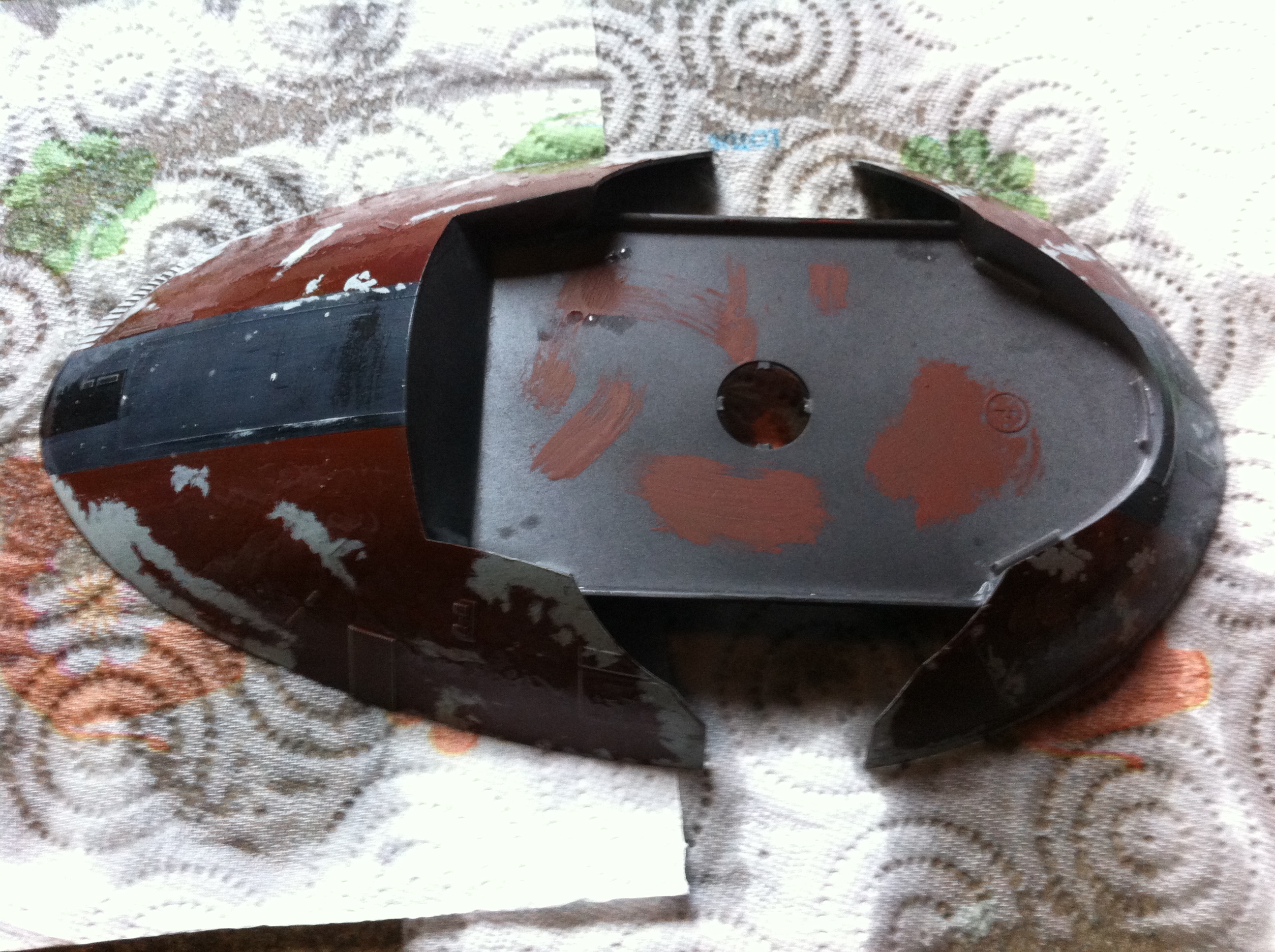

Stripping the paint of the hull, the skirt and some other parts

As said, the chaos black didn't come off completely. Kinda like the wheatered look it gave.
The small hull parts didn't have the black prime coat and were clean in 20 minutes!

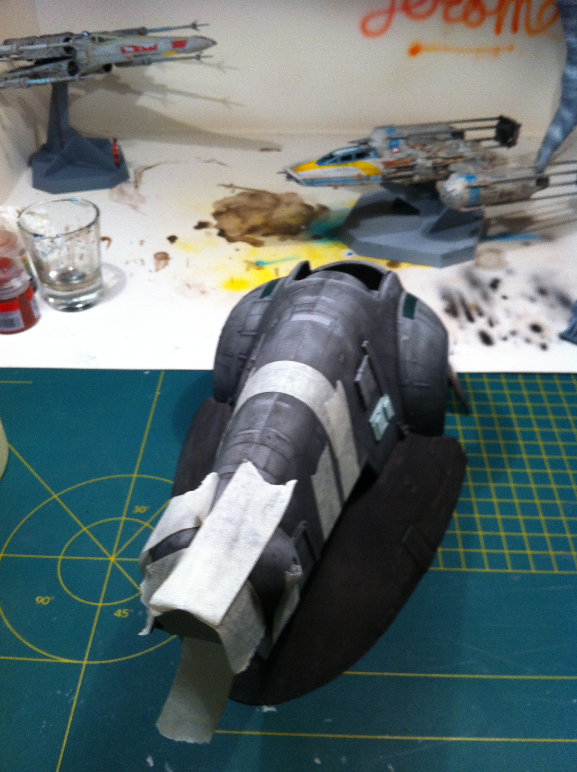

Laying the foundation and doing the 1st masking with Maskol and sponge.

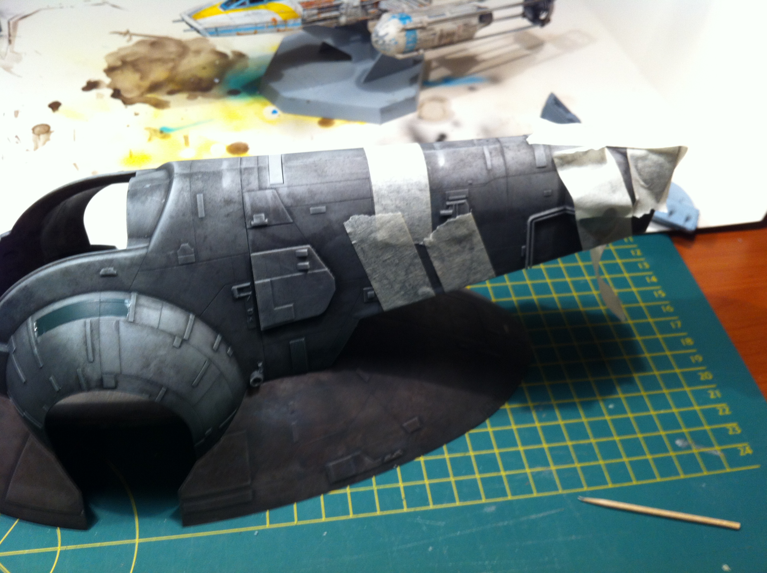

knievel
Re: Fine Molds Slave 1 build restarted - advice welcome
Hull is done! So much time is going into masking everything off layer by layer. But it feels like X-mas once you can take it all off to see the result.
colors are a little off on the pictures.

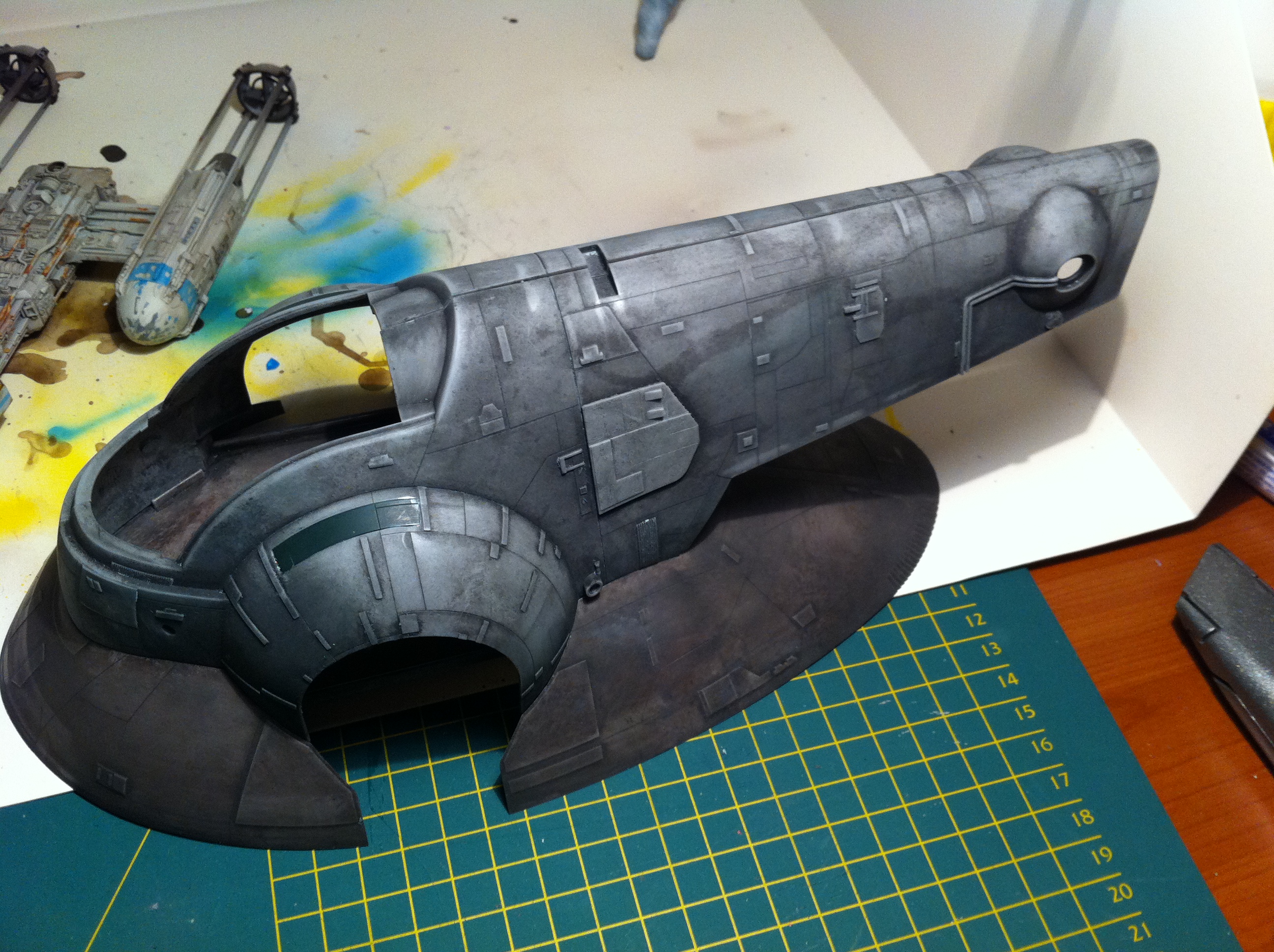

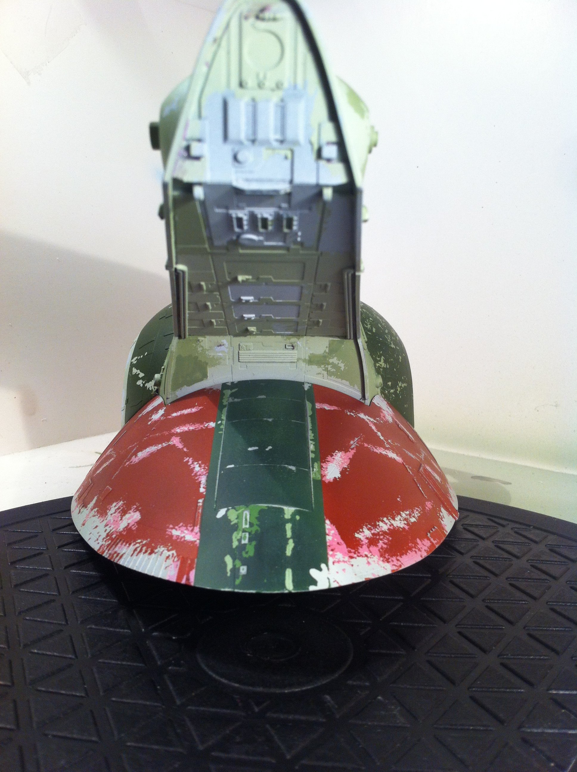

Not pleased with how the colors came out in daylight. Dark was to dark, mid to yellow. So I stripped the paint... again... to do it once again.
This time going for pale green as base and olive green as the dark green. The mid green is a mix of these two.
Much more in balance now.
Skirt came out okay. Strange to put the pink layer on it. Was wondering at what mission Boba Fett decided pink was the right camouflage. Or did Mrs. Fett choose the color?

GF
Looks really good, the colors look spot on, would be great if you can post all the paint colors and brand you used. I assume you applied the pink color last using a sponge no maskol?
Gerardo
GF
BTW that's not a camouflage pattern but a very beat up and scuffed up spaceship, that's the impression I got when I first saw the ship, I never thought of it as a camouflage paint job, basically the pink is color showing threw the top layers of chipped paint.
Gerardo
blakeh1
The chipping effect looks great. As mentioned above, the pink is just a layer where the paint has eroded off. I always thought of as something like a rust repair/bondo type thing you'd see on cars before they get repainted
knievel
Gerardo
started with a layer of light grey primer. lightened it up with Vallejo white. then used Vallejo pale green and olive green for the three shades of green as mentioned before. skirt was treated the same way: grey primer, then the pale green. Masked it and applied the pink. Then masked over the maskol layers again before aplying Citadel Red Flesh. The ramp were masked of with tape during the proces.
After finishing the red layer, I masked it of the spray the ramps. builded it up in layers and masking of some part during the proces to get some green chipping effects on it too.
finally is lightly sanded the edges of all the raised panels to wear them down again and make them stand out, instead of dry brushing them (as said here, the paint is come of this aged ship, so it seemed logical to do it like that).
BTW was only kidding on the pink ;-) I like to make to make up stories in my mind while building. It makes it easier to make it realistic when you imagine what's the story behind it. Looking at the dark green panels that look fresh and new, with the smoke/oil still on the edges, I imagine something blew up and had to be completely replaced. The only salvaged part was the door thingy.

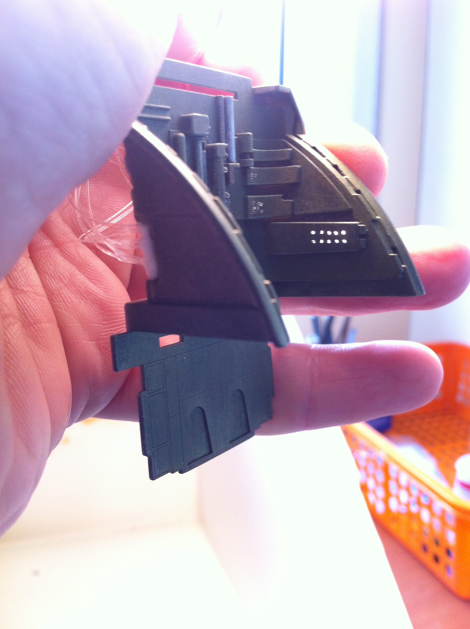

Freestyling with the lighting. Made some panels that will have some nice flashing once the fiber optics are connected.
Boba Fett was painted 3 year ago There are 2 in the kit. Also a metal cast Han Solo in carbonite. Would have been better if it was in plastic too: Trying to think of a solution to make it float in the passenger room and it's quite heavy. Think of making 2 triangular shapes to place it on. Since the deck is lower than the window, you'll probably won't see them.
allready drilled three holes in the metal to have some LED flashing on the life systems.

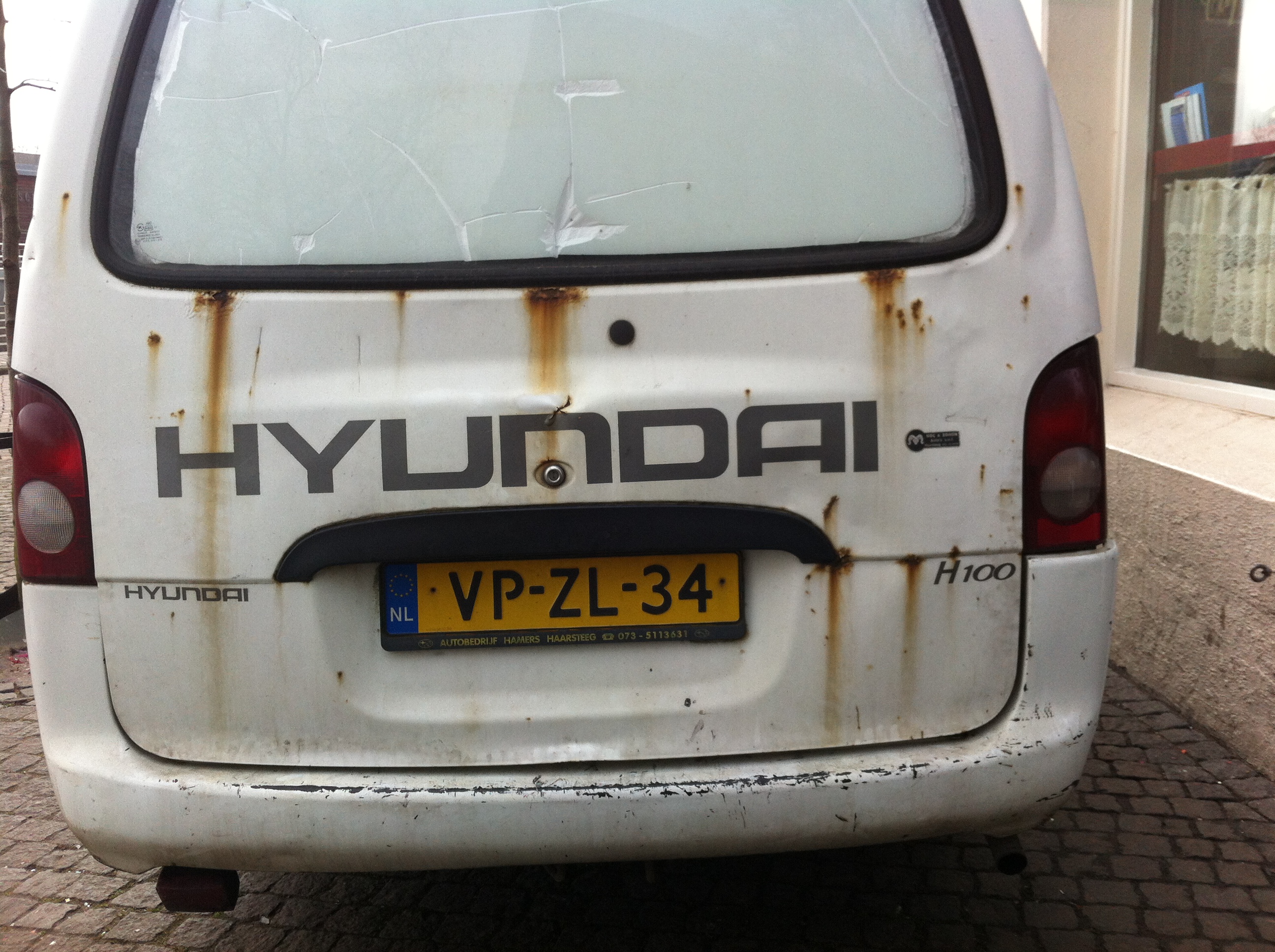

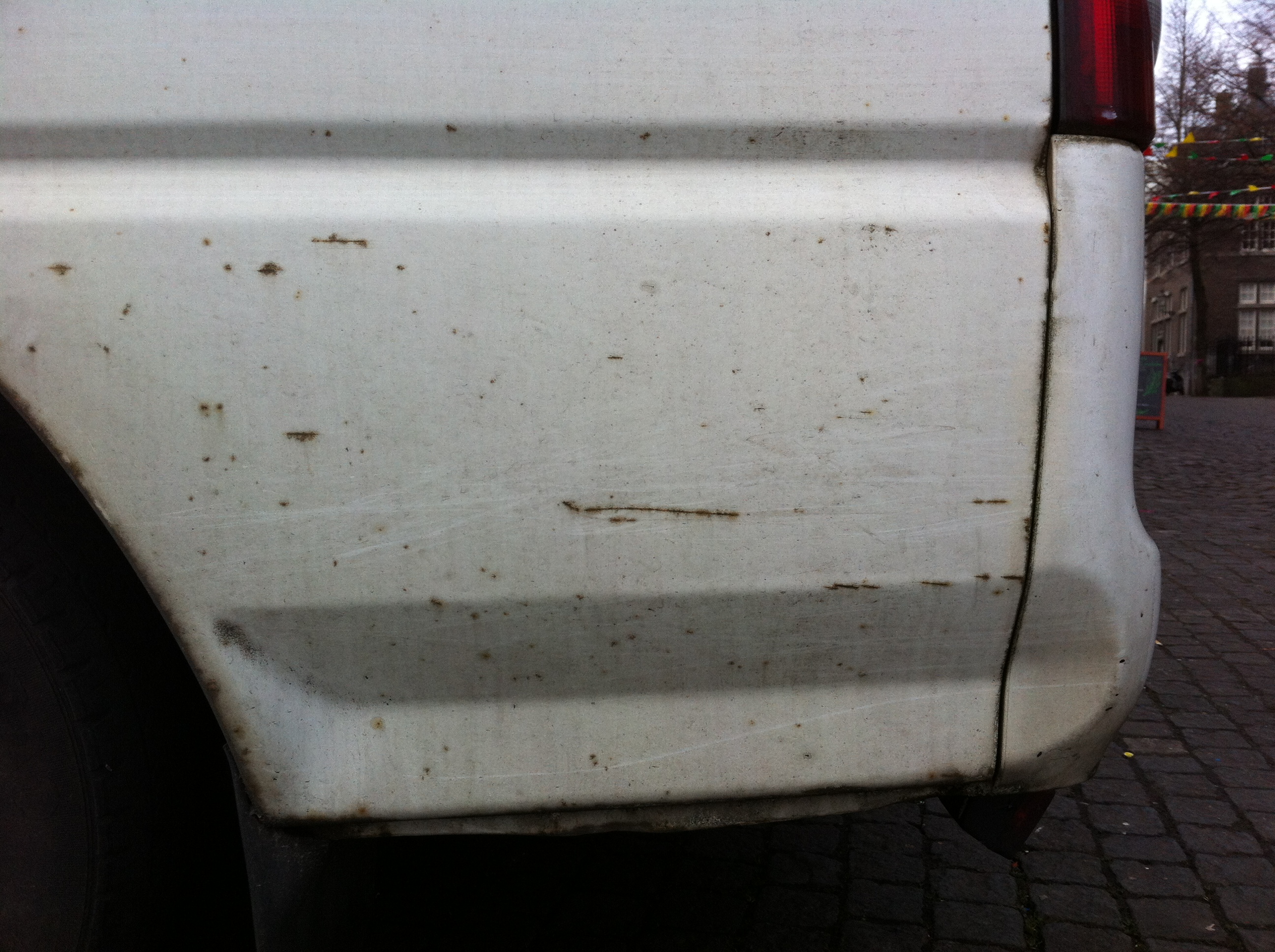

Saw some nice wheatering on a van this morning. Might use it as reference some day.
