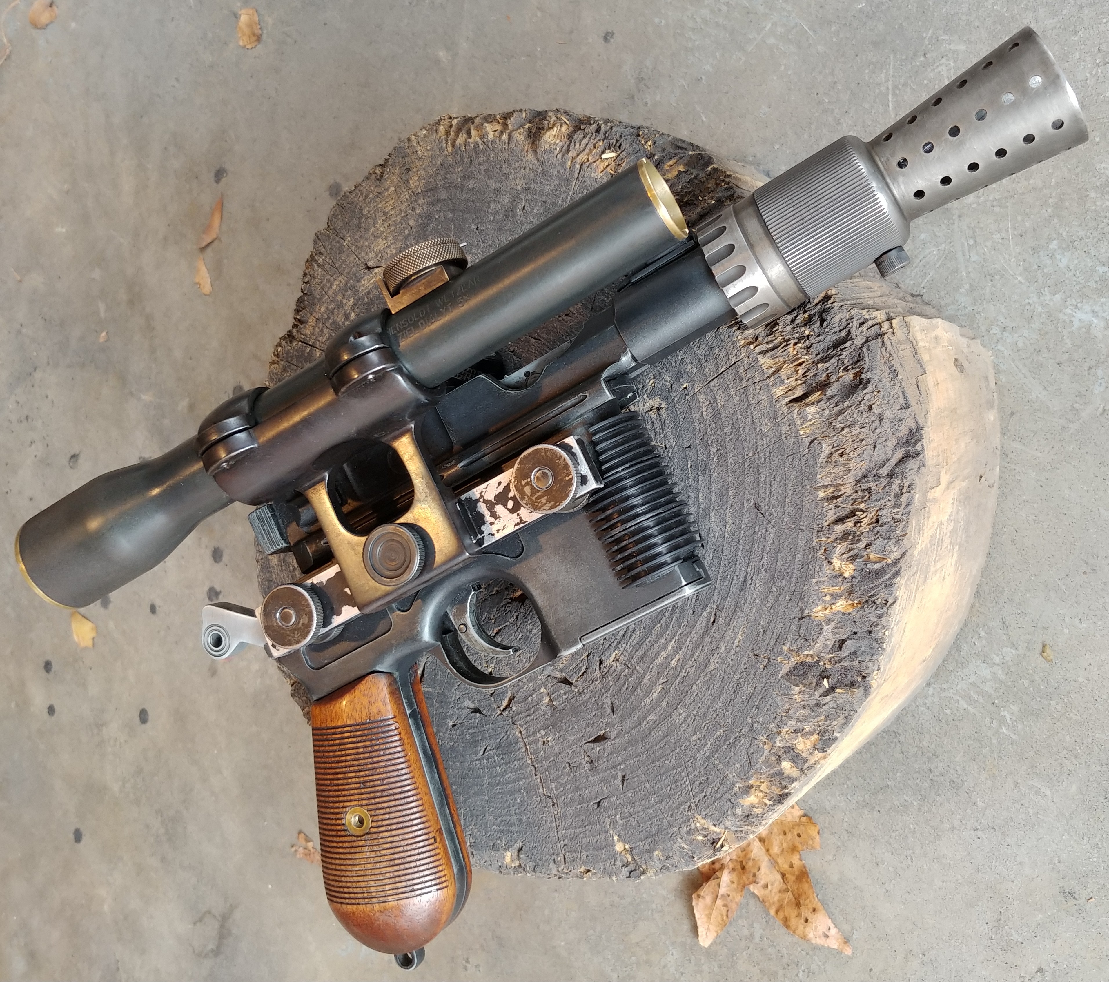

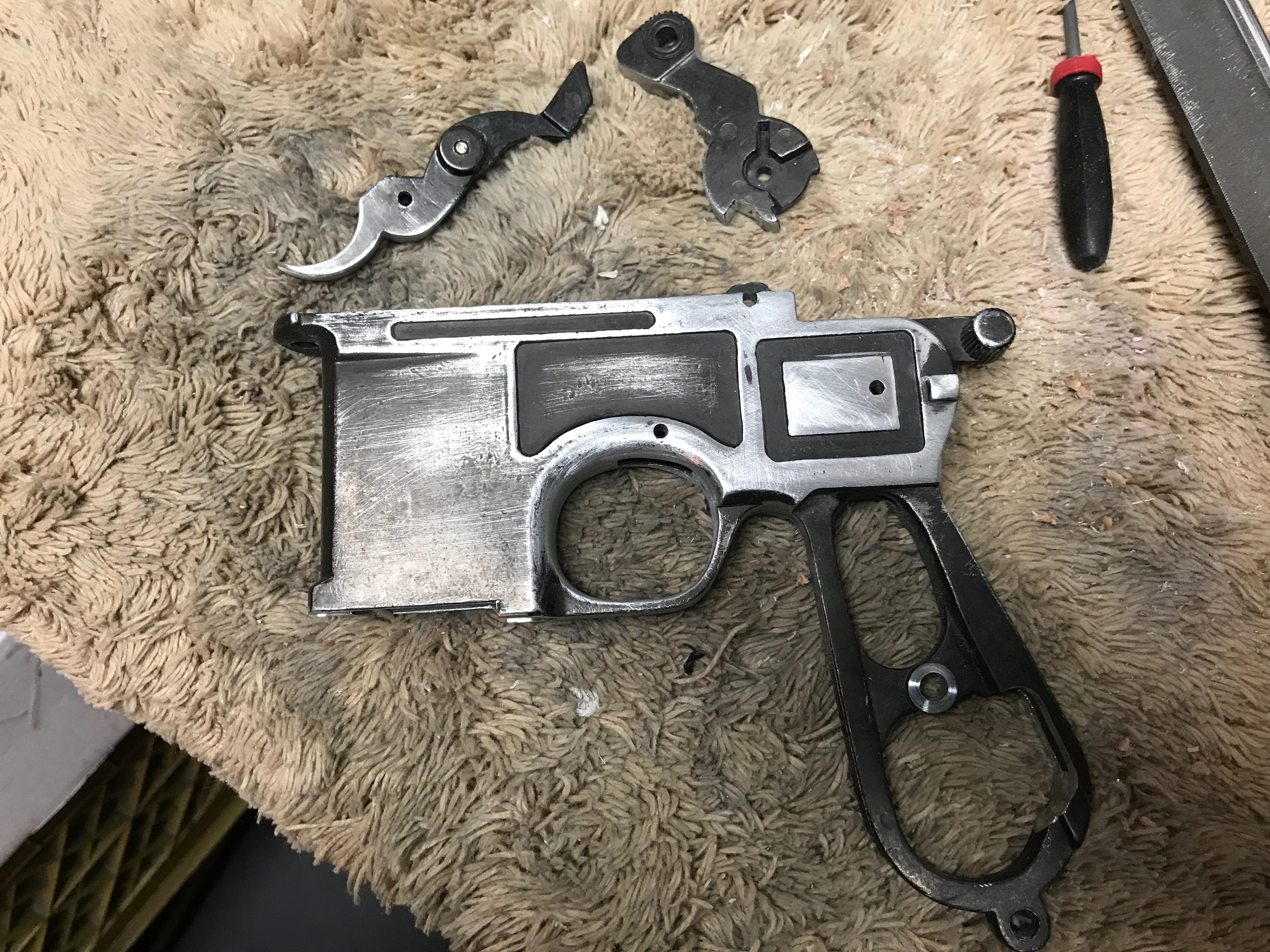

For me the Han Solo DL-44 blaster is my favorite and one of the most iconic. A good friend of mine bought me a Field Marshal ANH DL-44 kit with all the steel parts! So here's Chris's beautiful kit, pre machined, as it came out of the shipping box along with Dark Energy Creations pewter T track and machined radial engine pieces. My goal is a hero look for display!

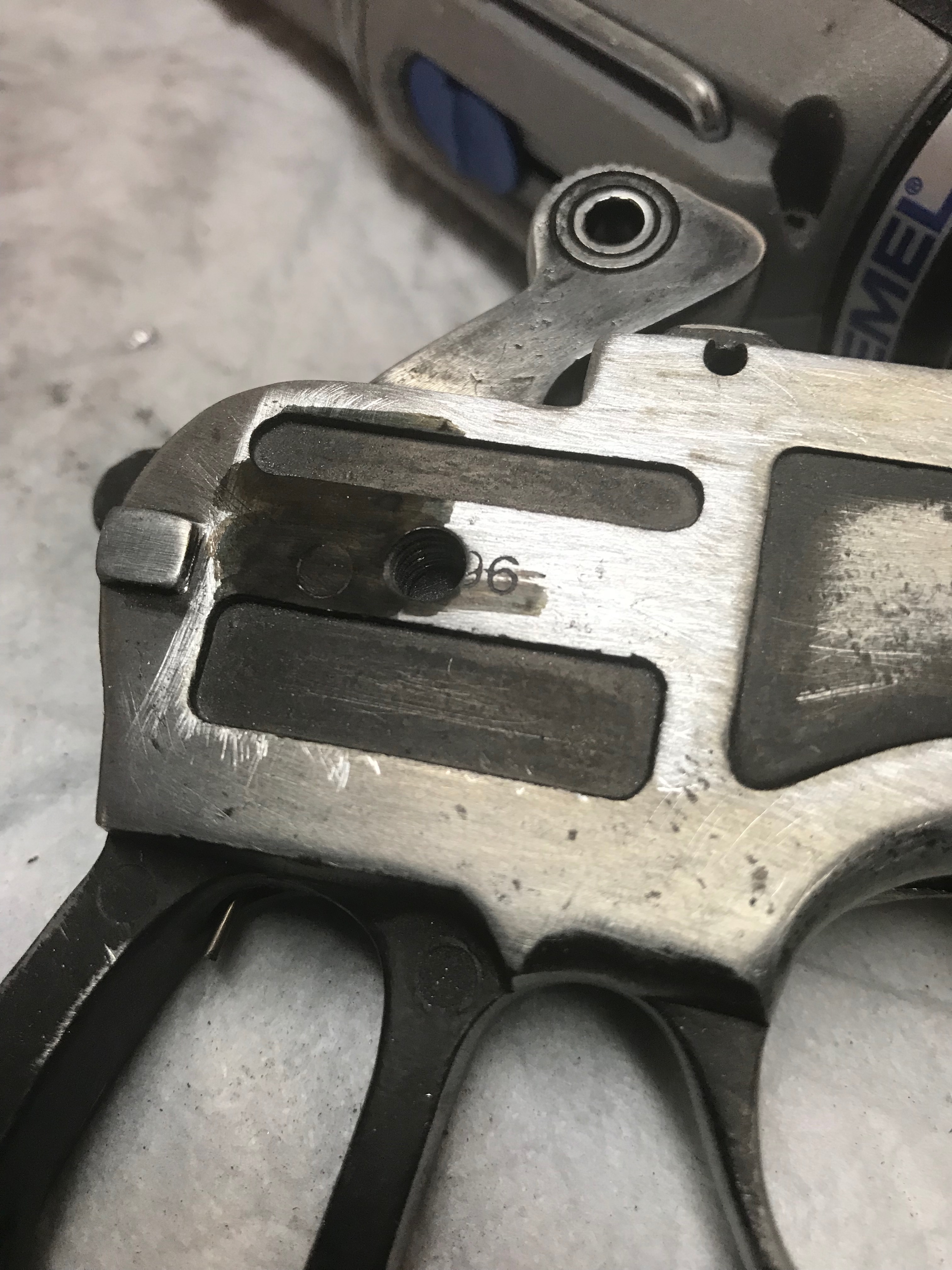

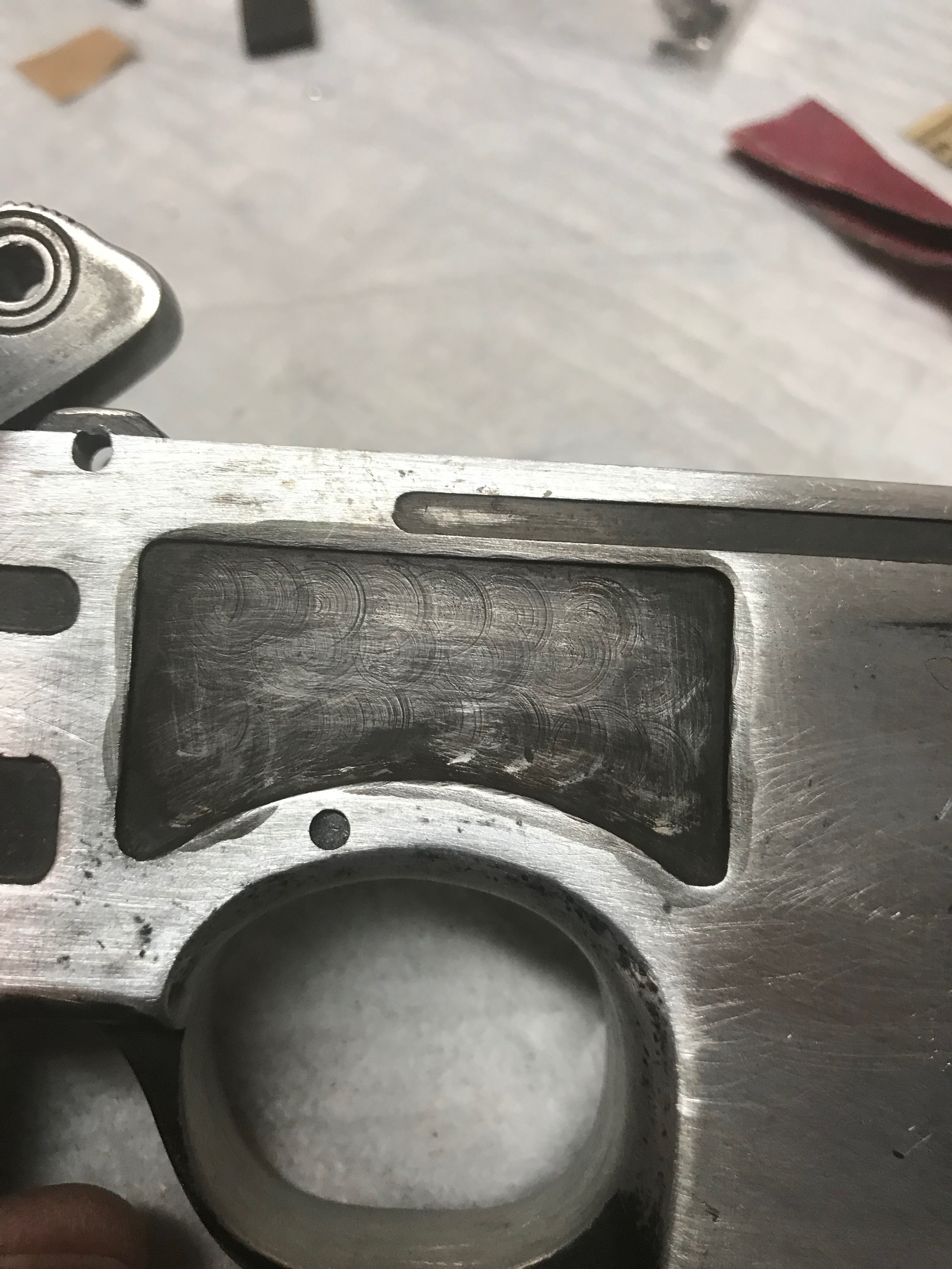

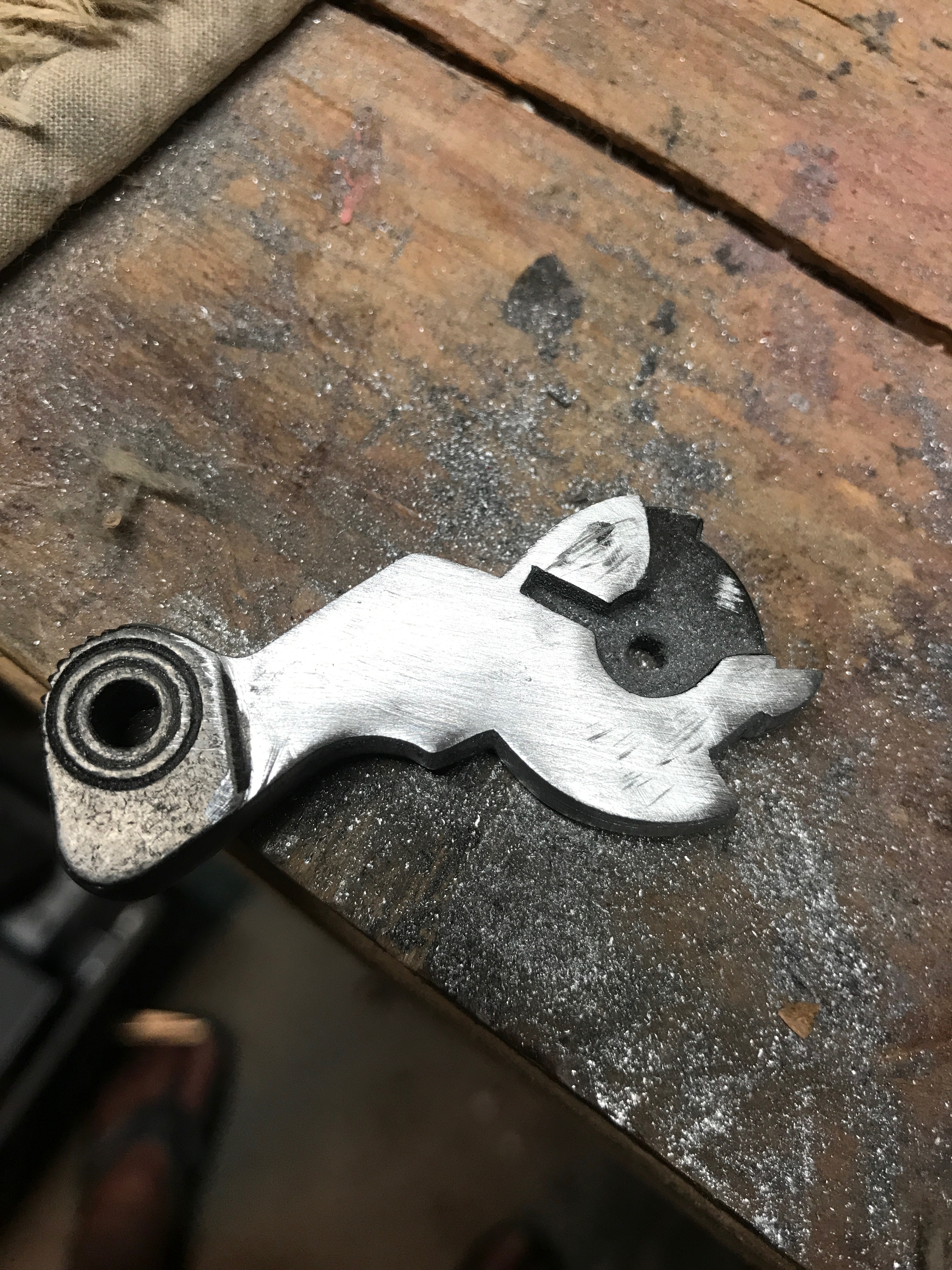

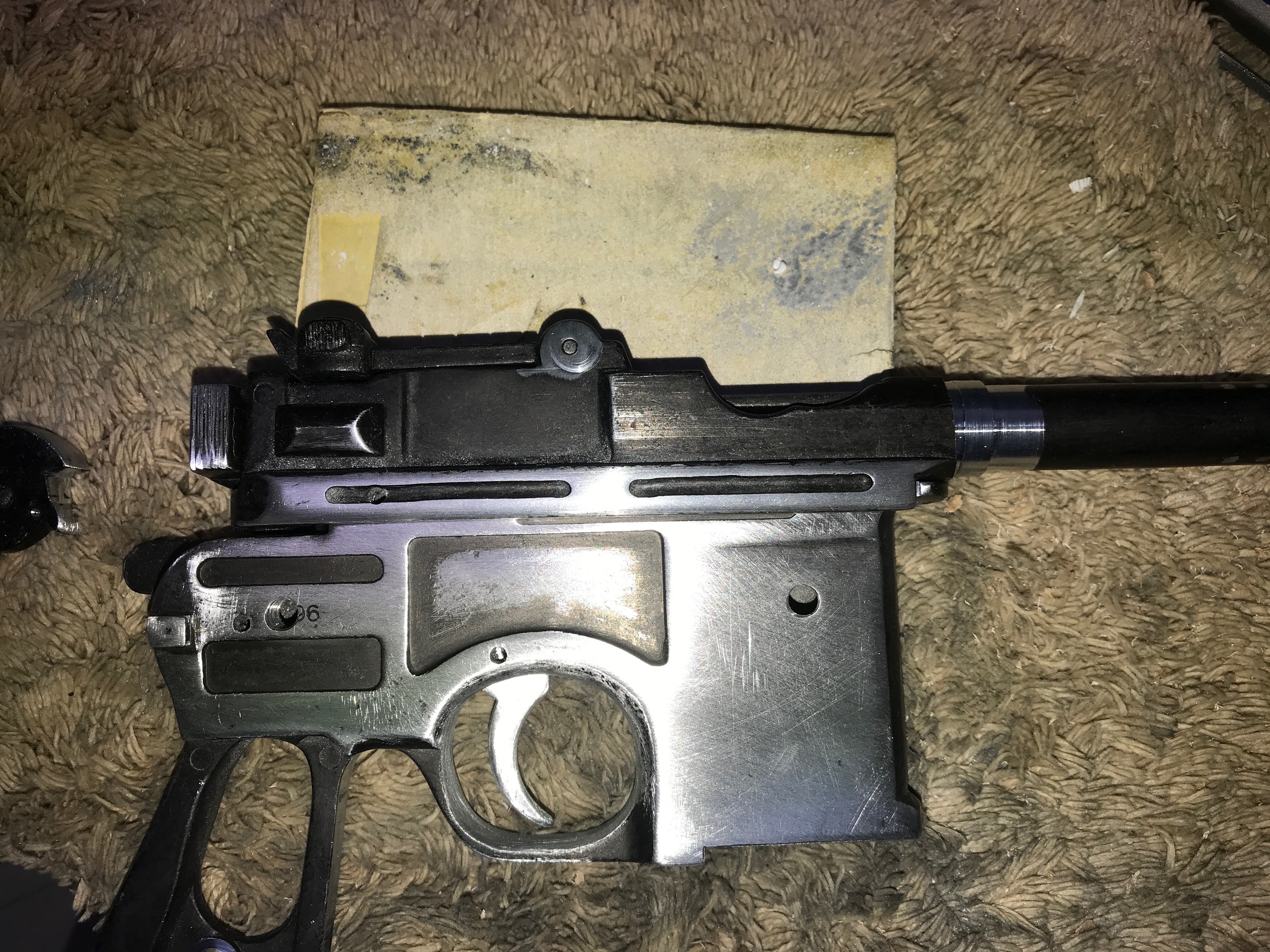

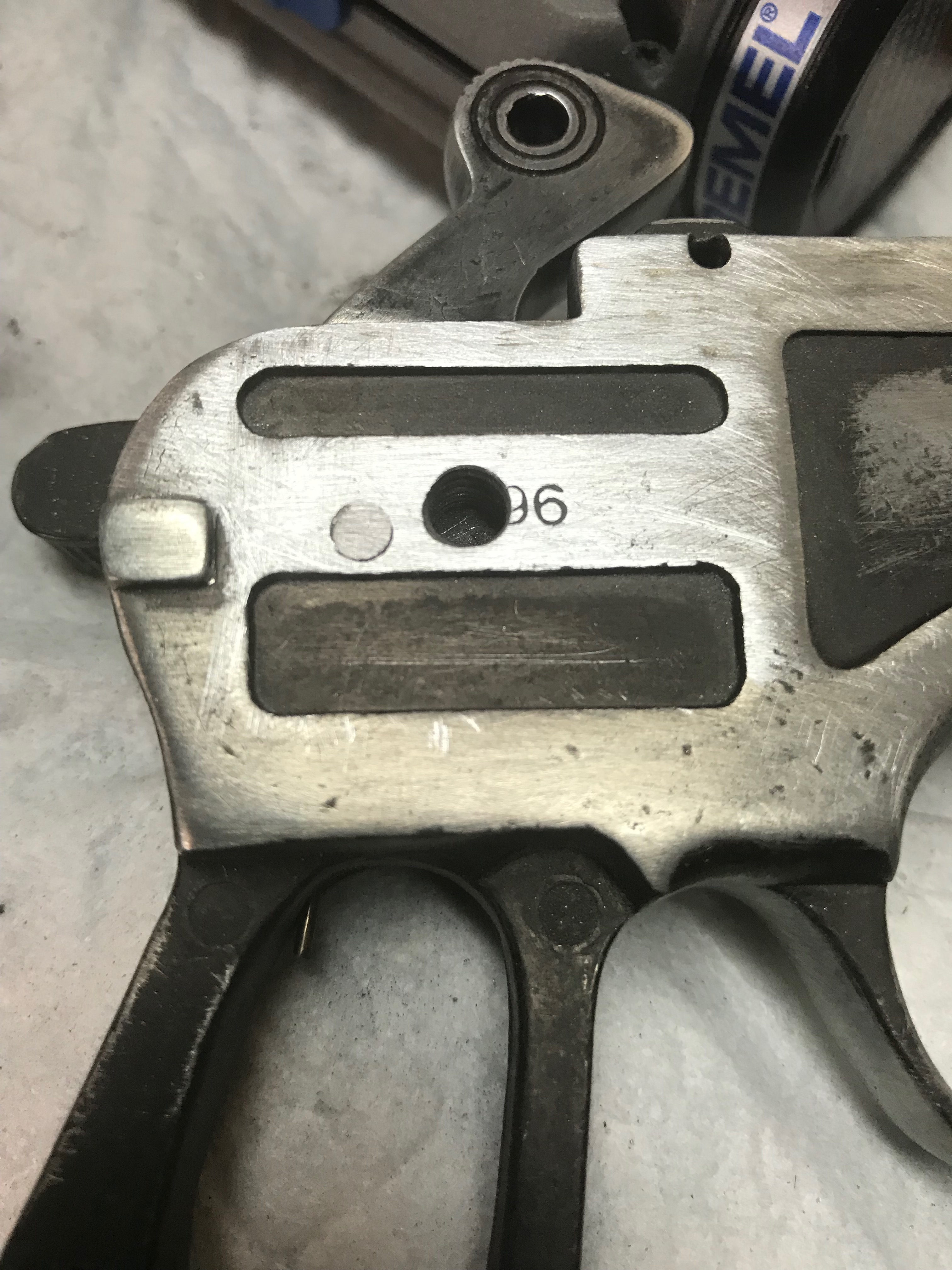

After disassembly, I wanted to smooth out the casting dimples & seams, remove the DENIX stamped lettering so this looked closer to a real C-96. I've followed many of Scott J's builds and enjoyed DiggsBarklightr's "No Filler" build and thought I'd give this a try...
Denix logo removed & casting dimples

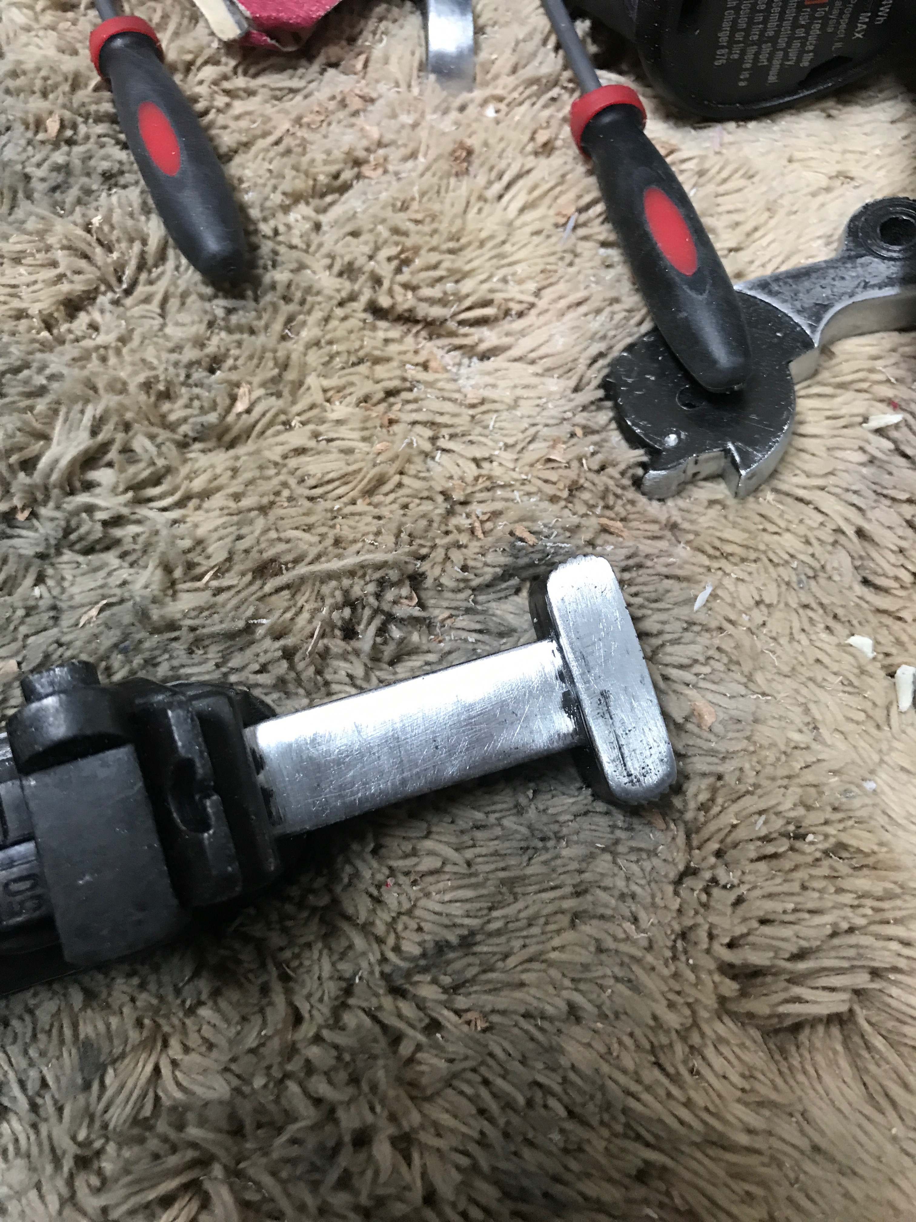

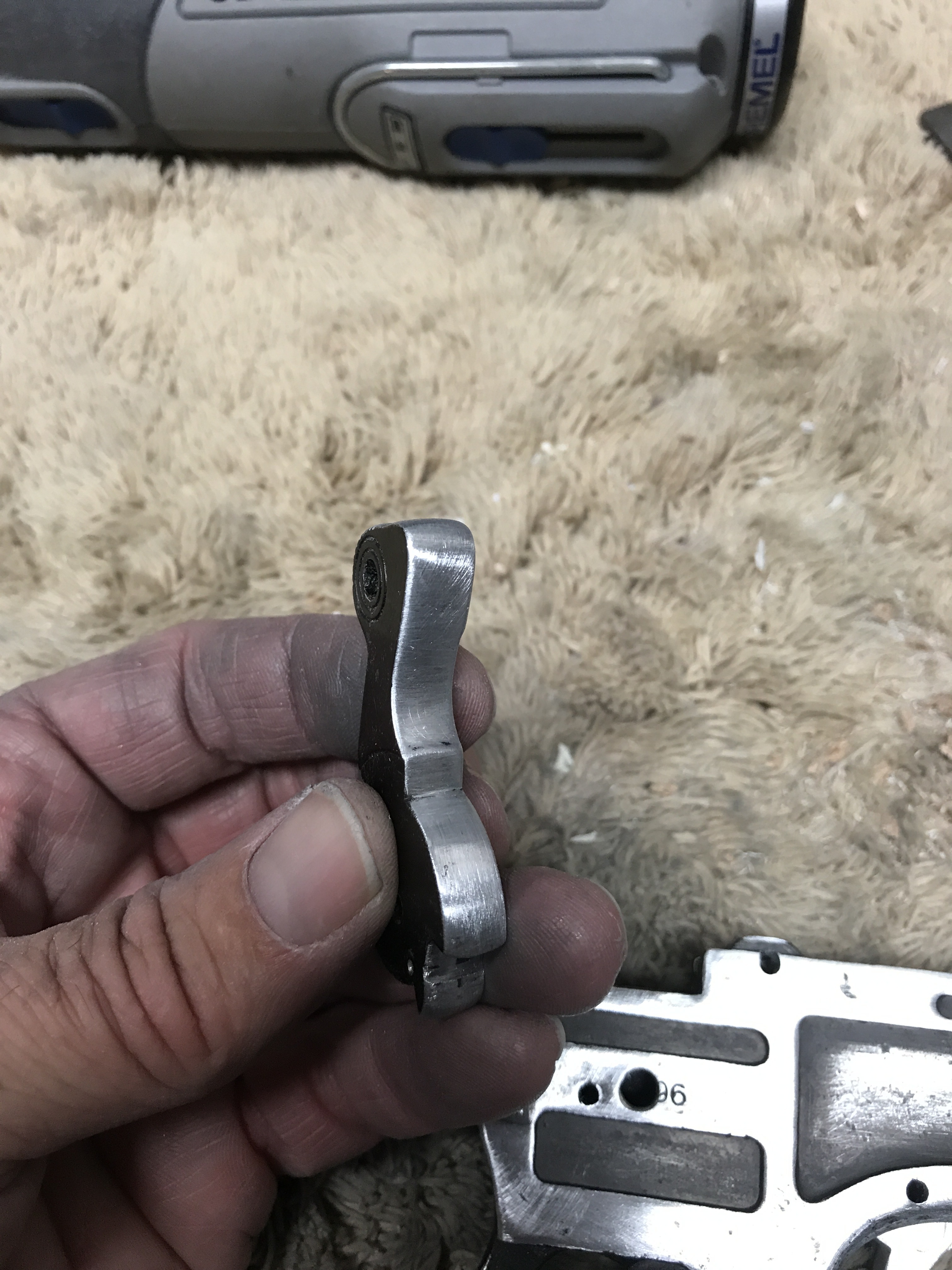

Hammer seams removed & knurling detailed
Put the trigger on a diet - this isn't done, it still needs a little work

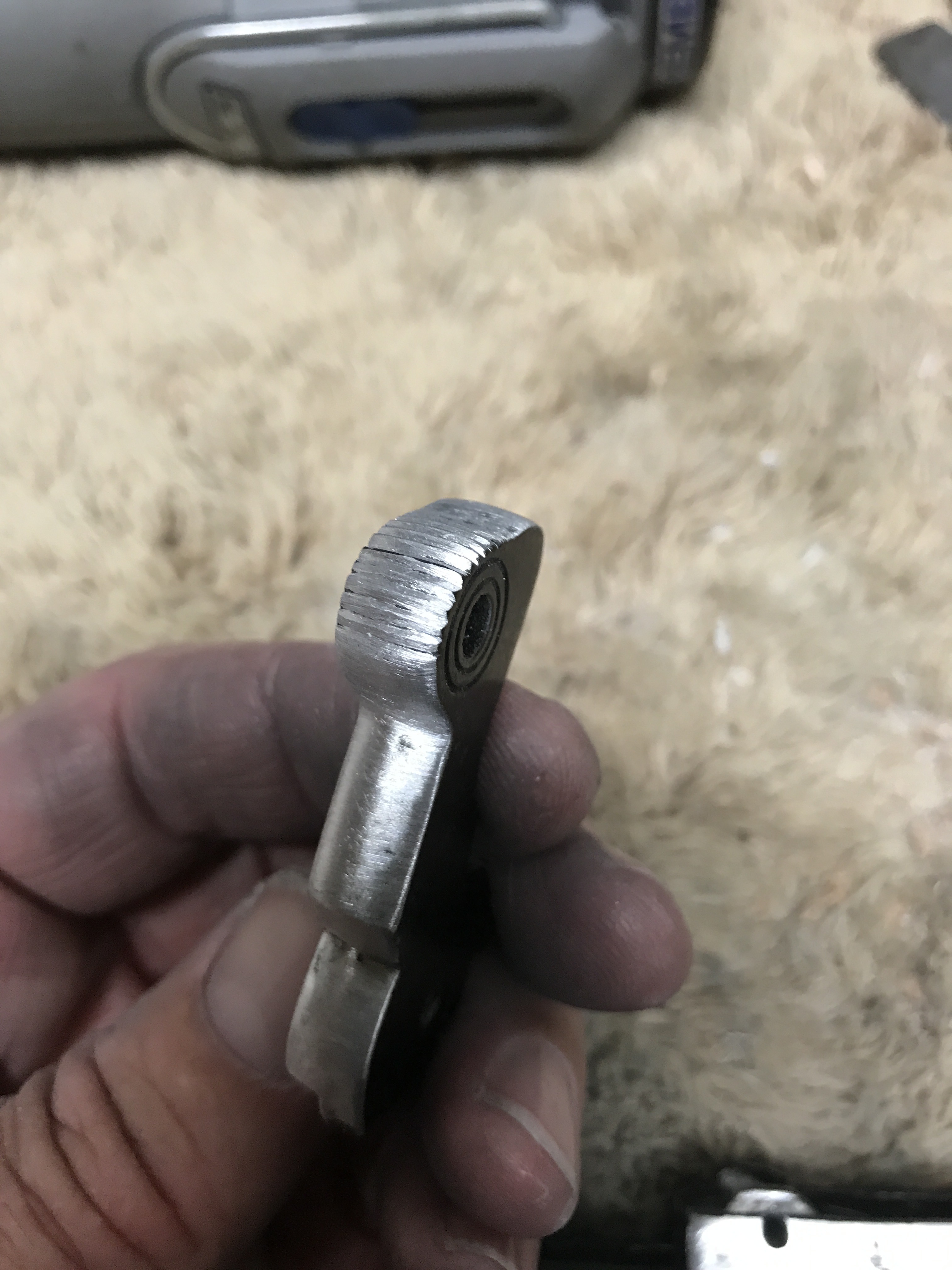

Hammer dimples removed

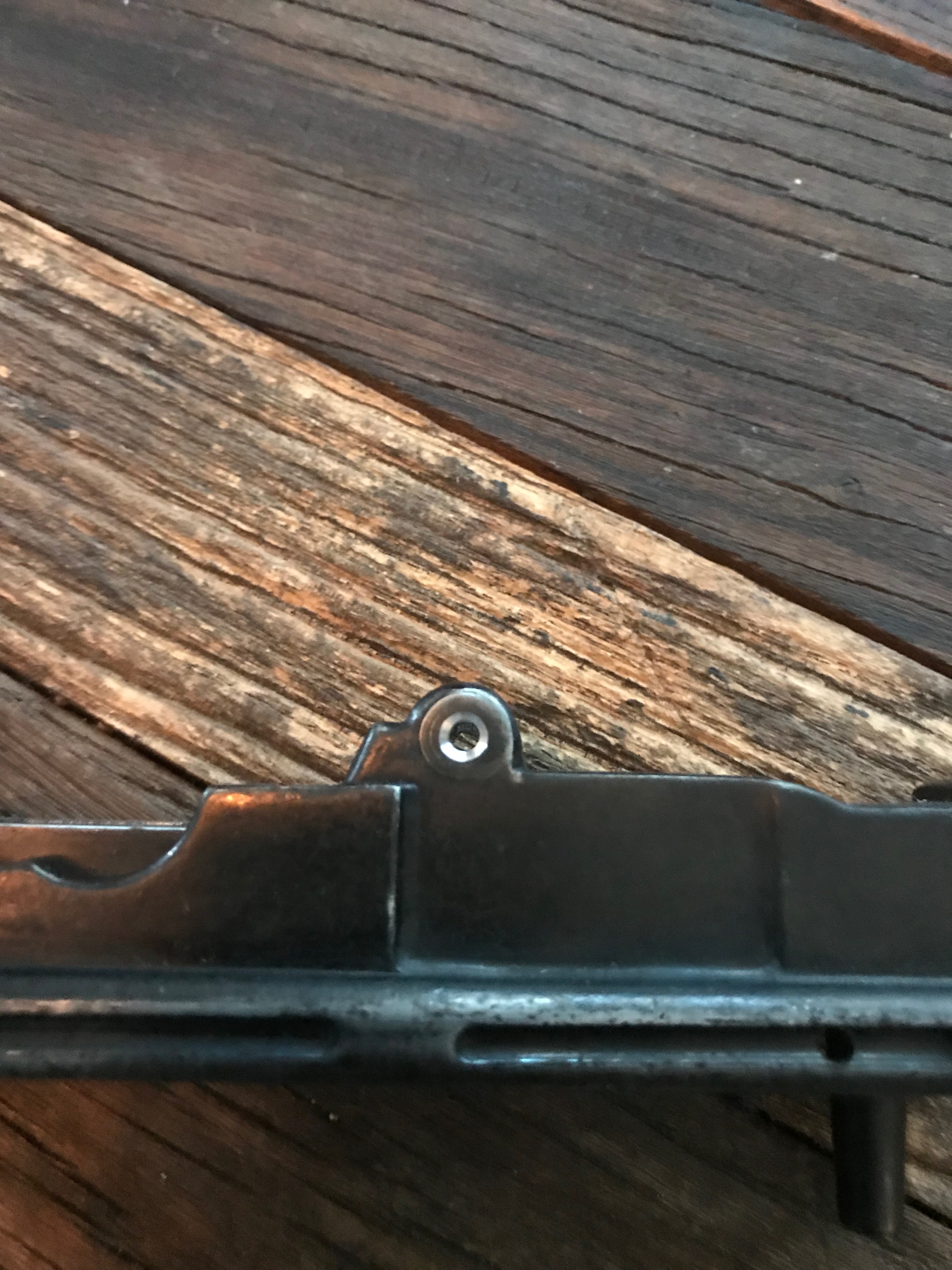

Upper dimples removed

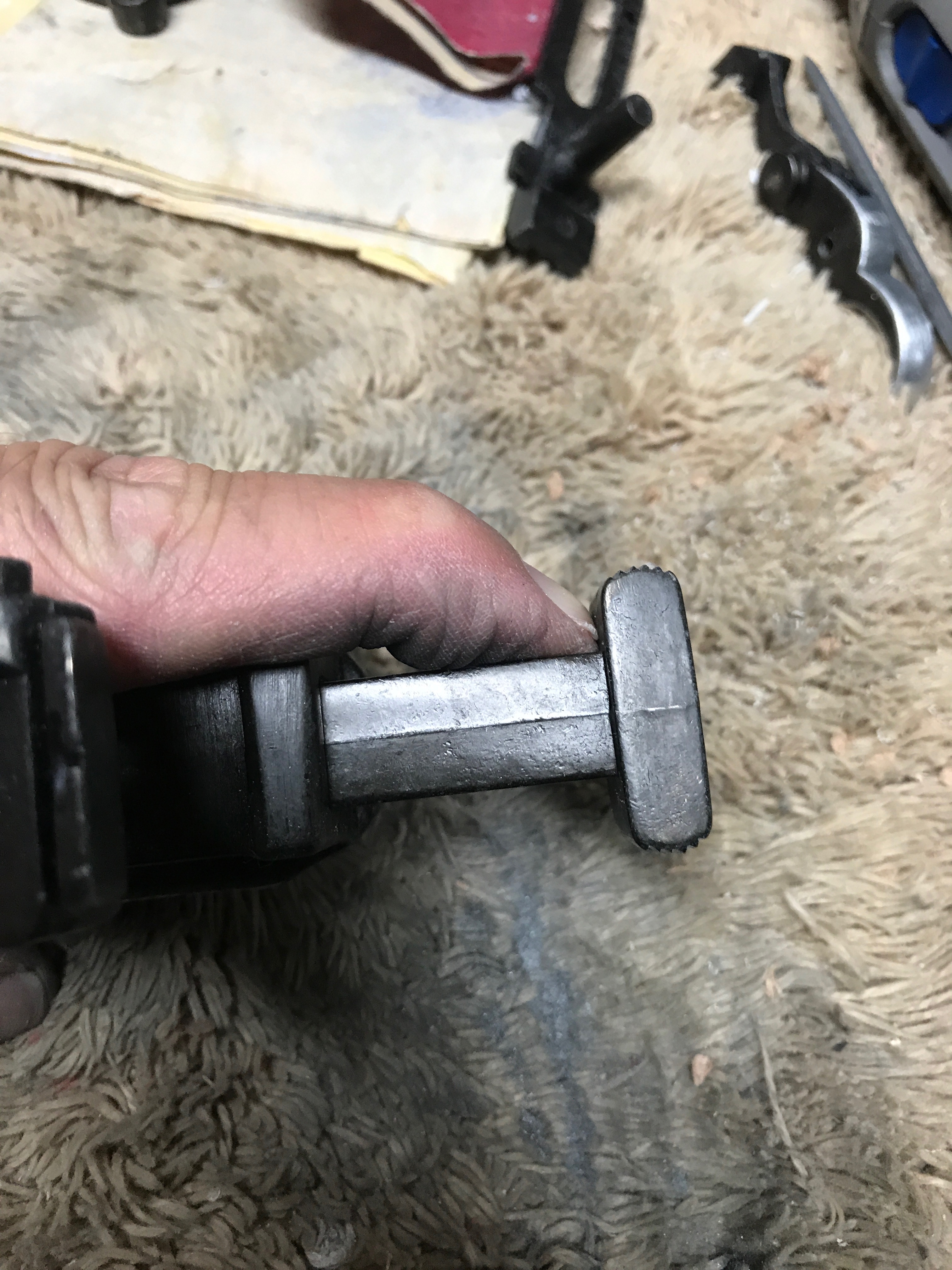

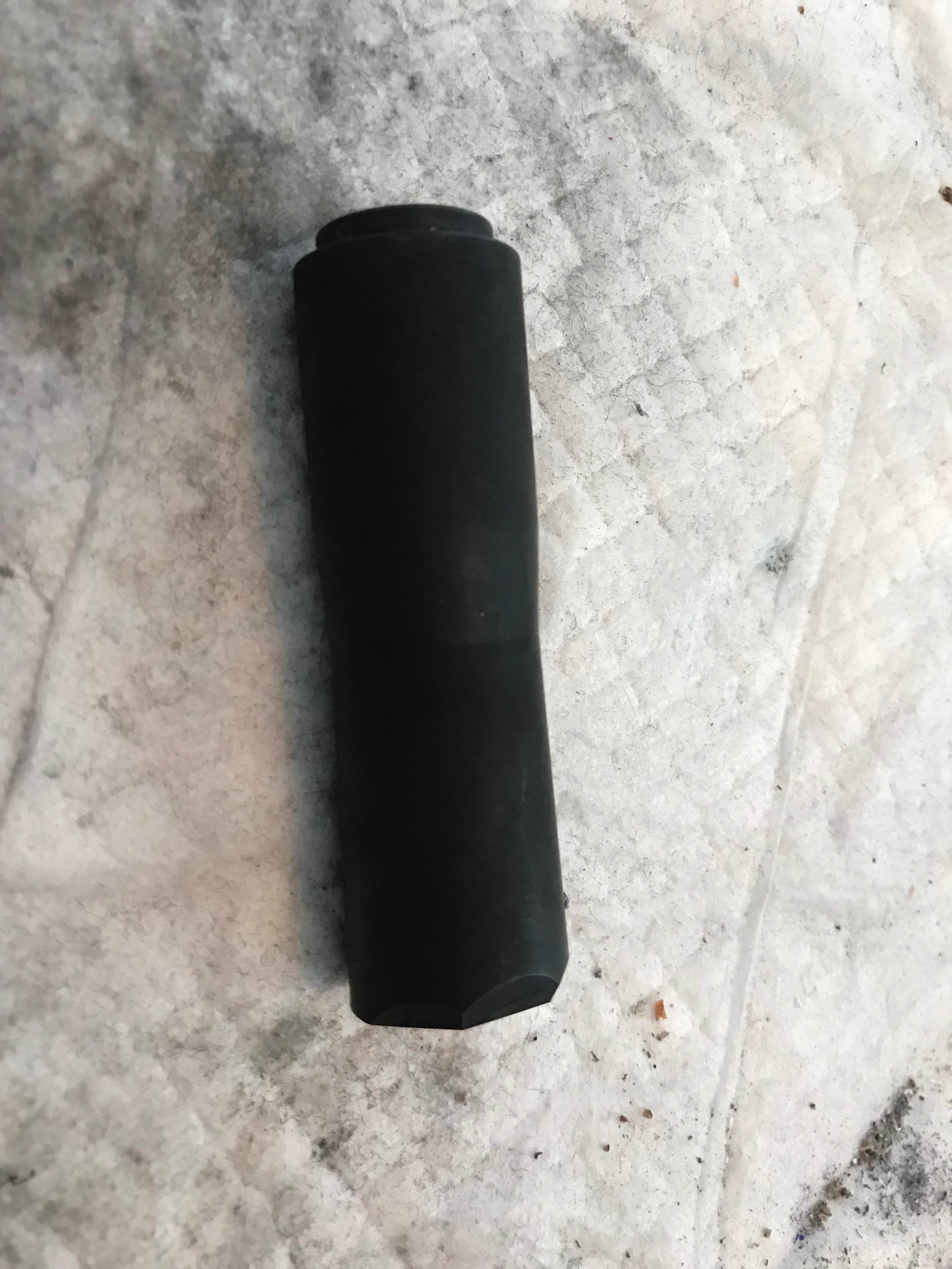

Casting seams removed in the bolt
Bolt knurling detailed
I'm happy for my first few hours of work. Ordered Birchwood Casey Aluminum Black and will go by the sporting goods store today to pick up the Birchwood Casey Aluma Blue for the steel parts!

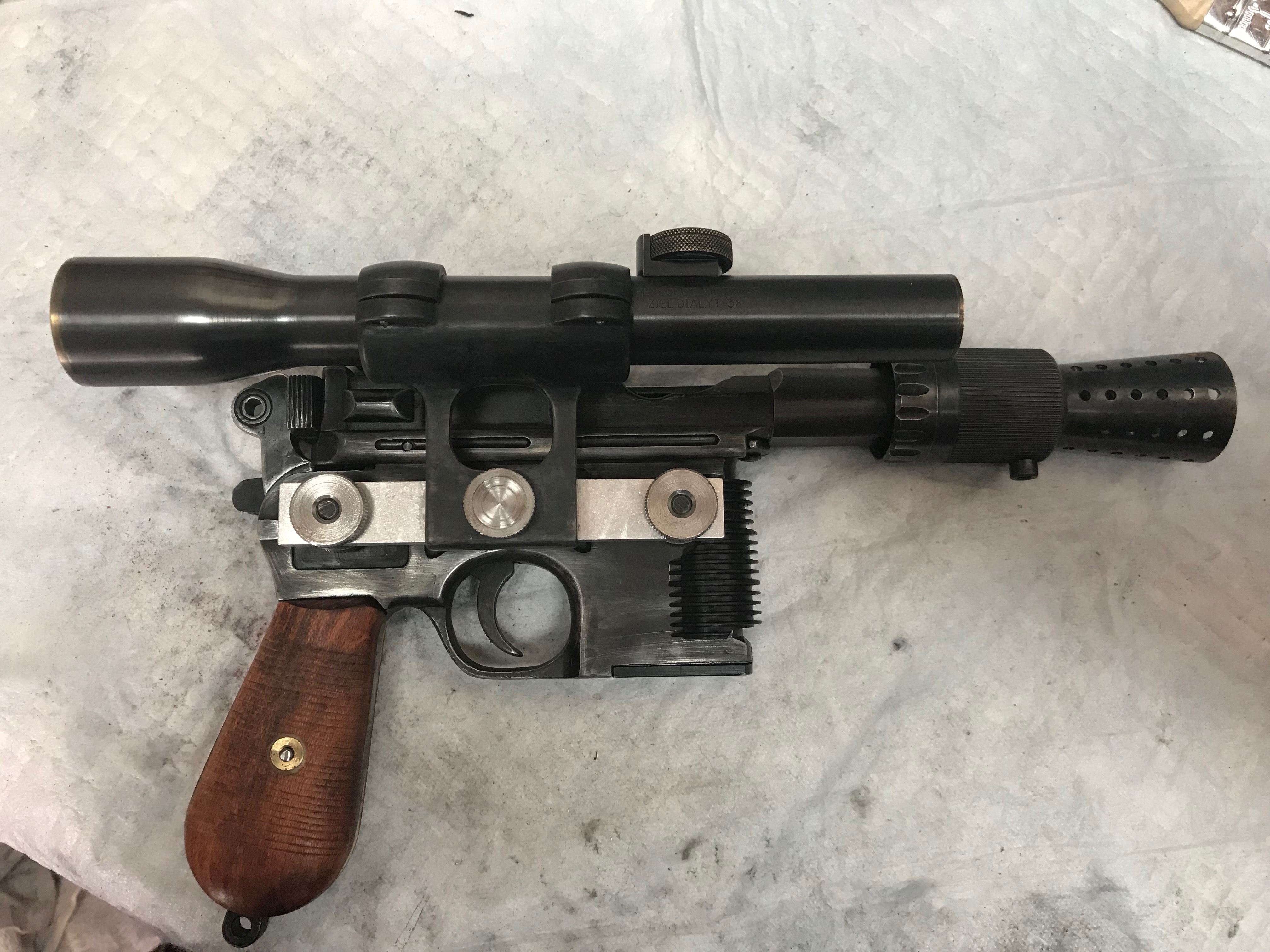

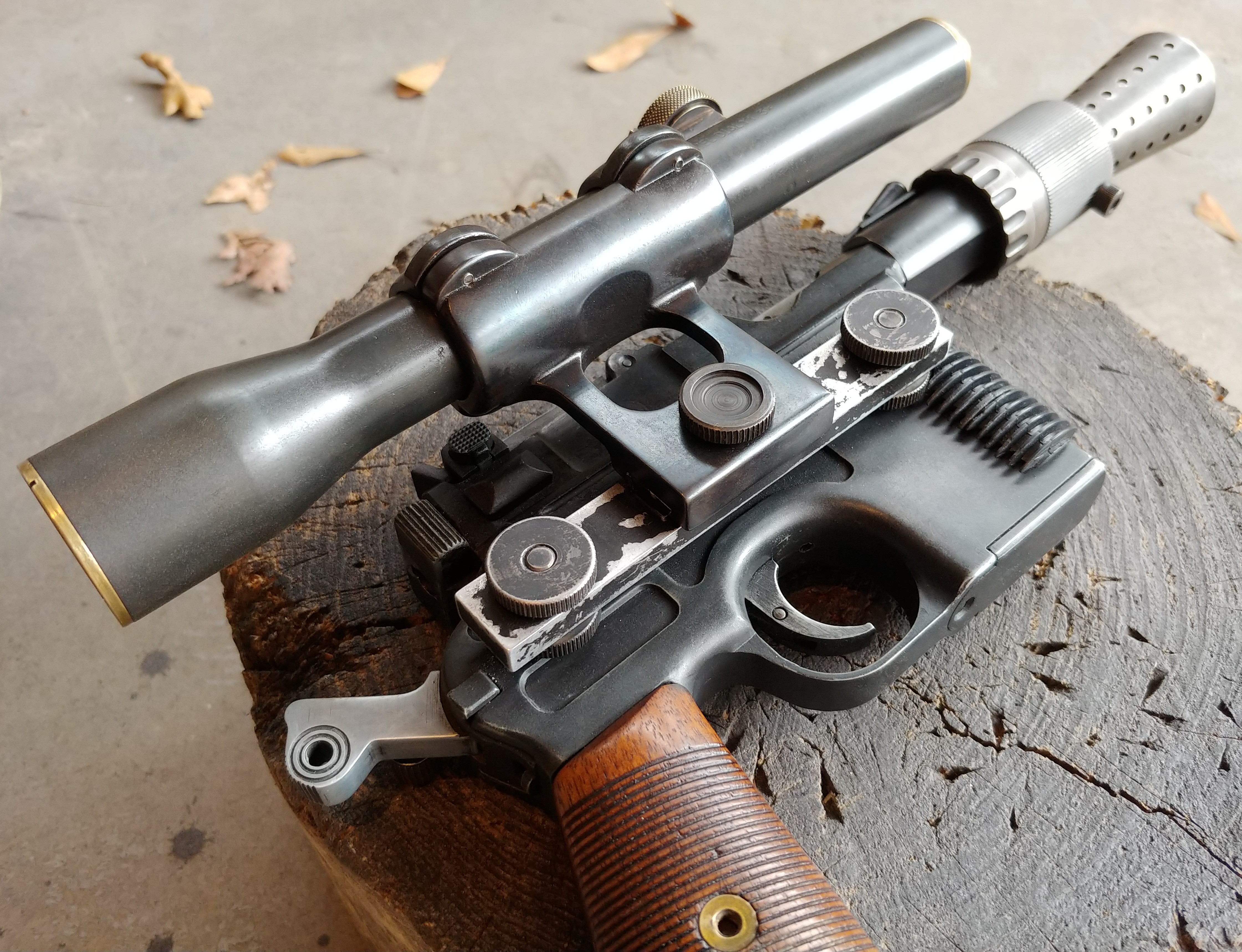

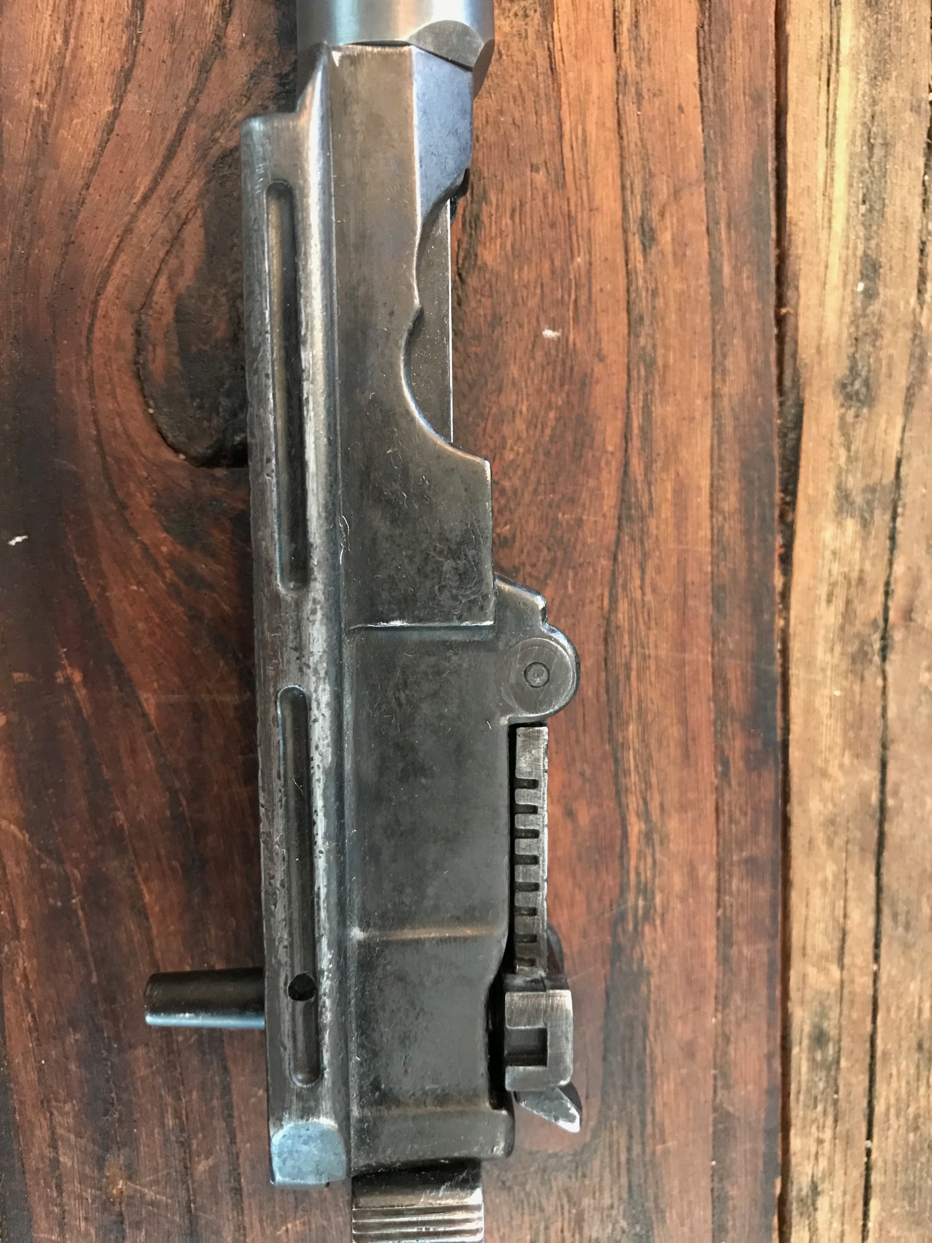

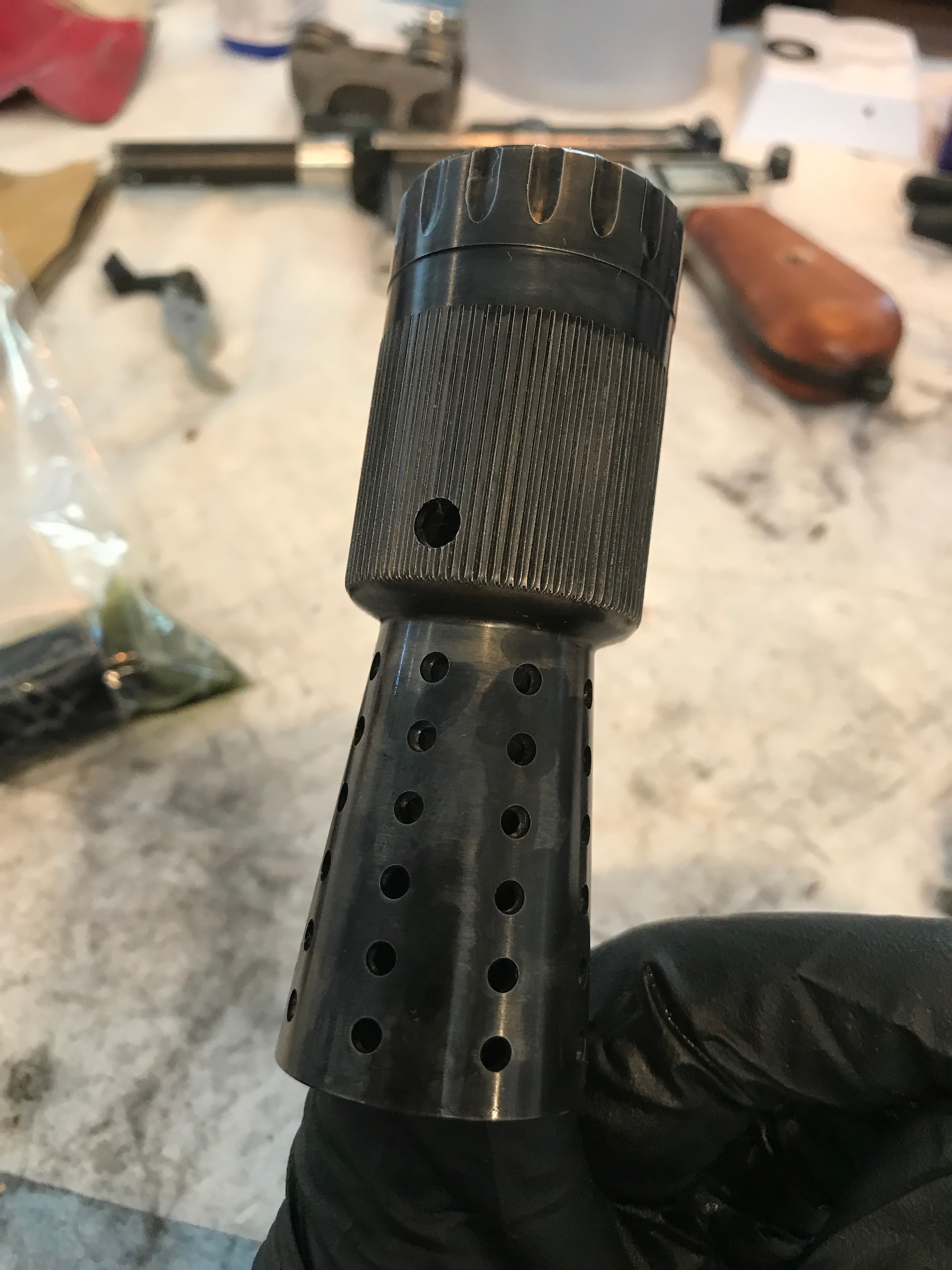

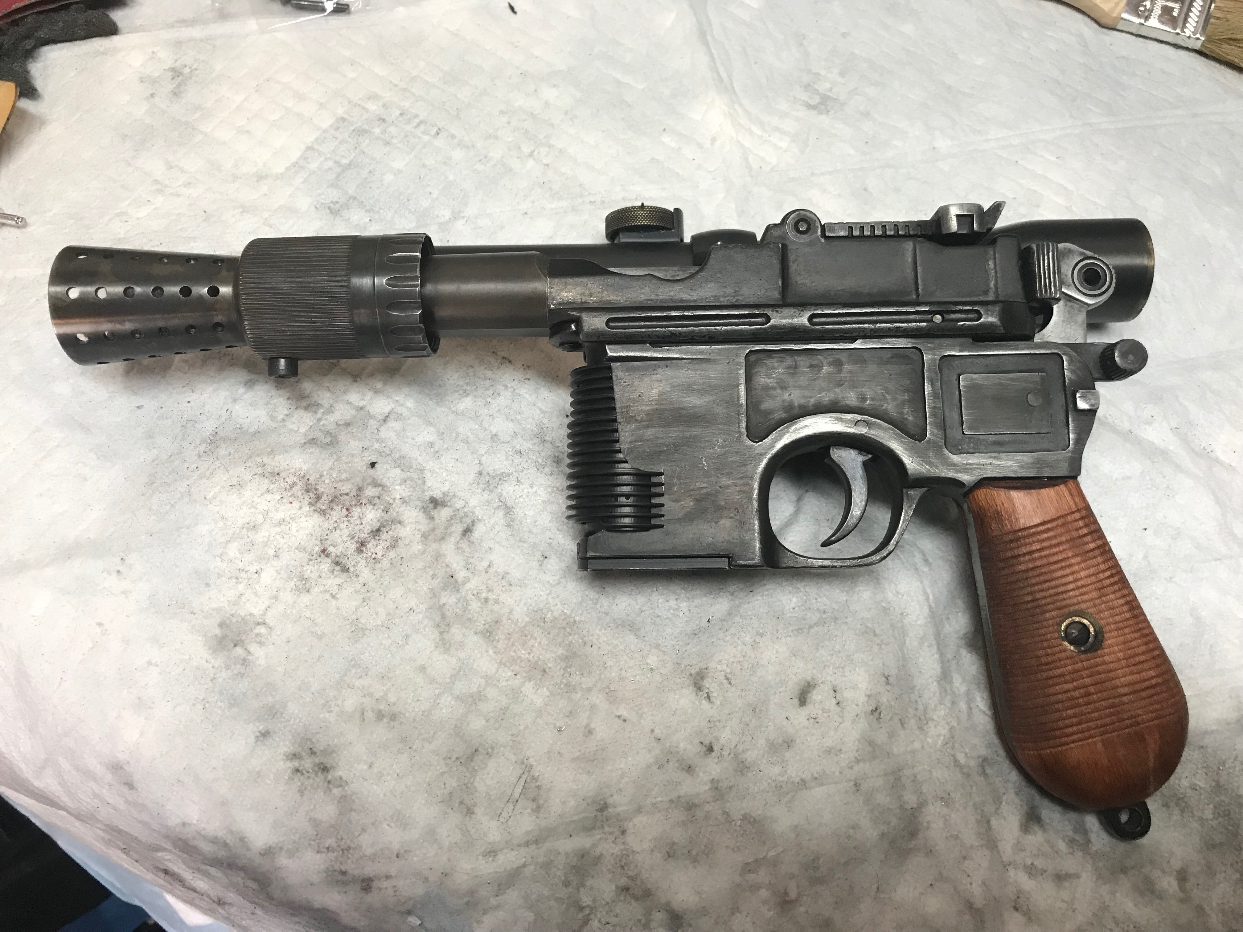

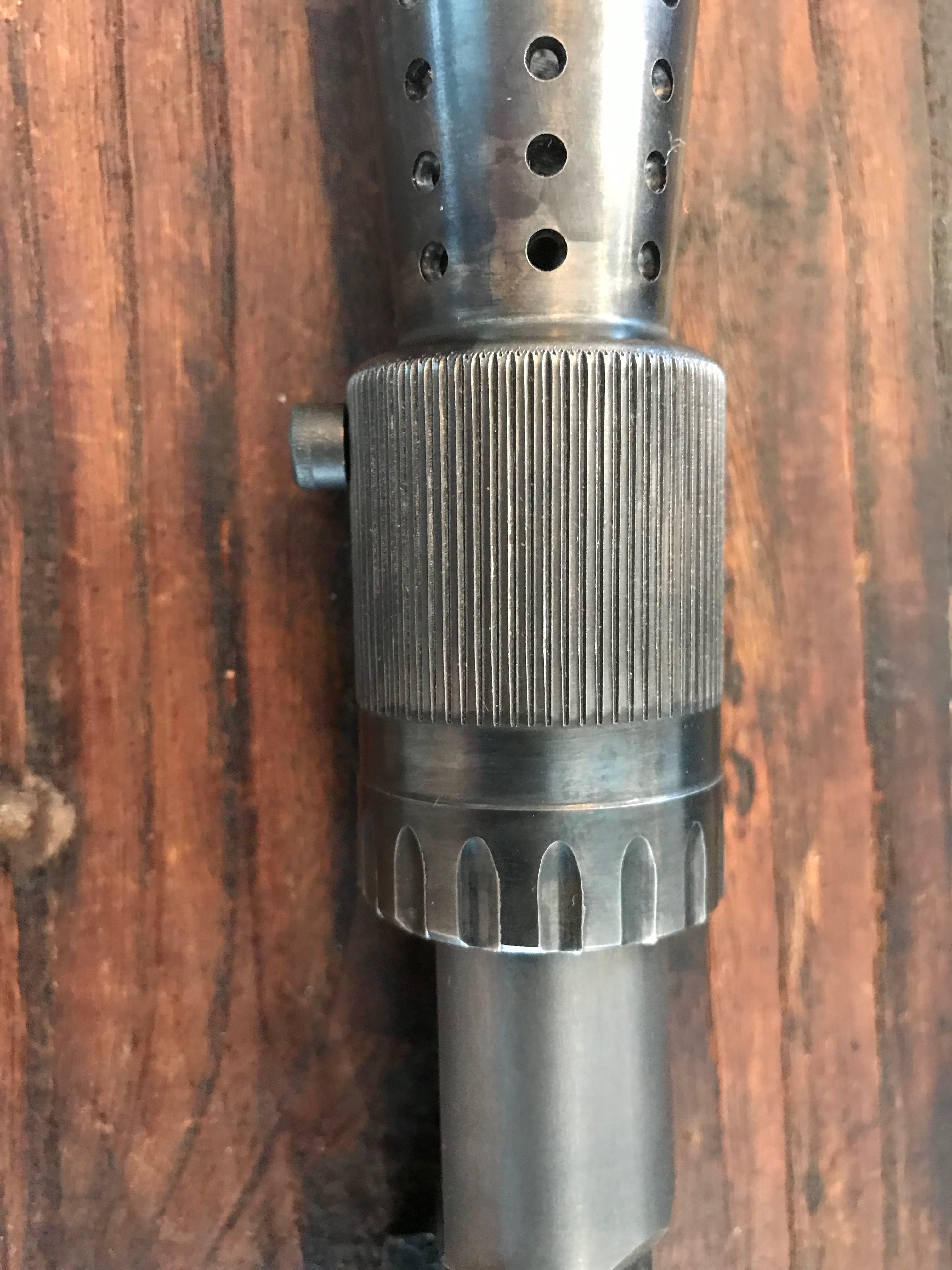

Made some good progress today - Blued the barrel, flash hider, upper, trigger, hammer, and touched up a few things.

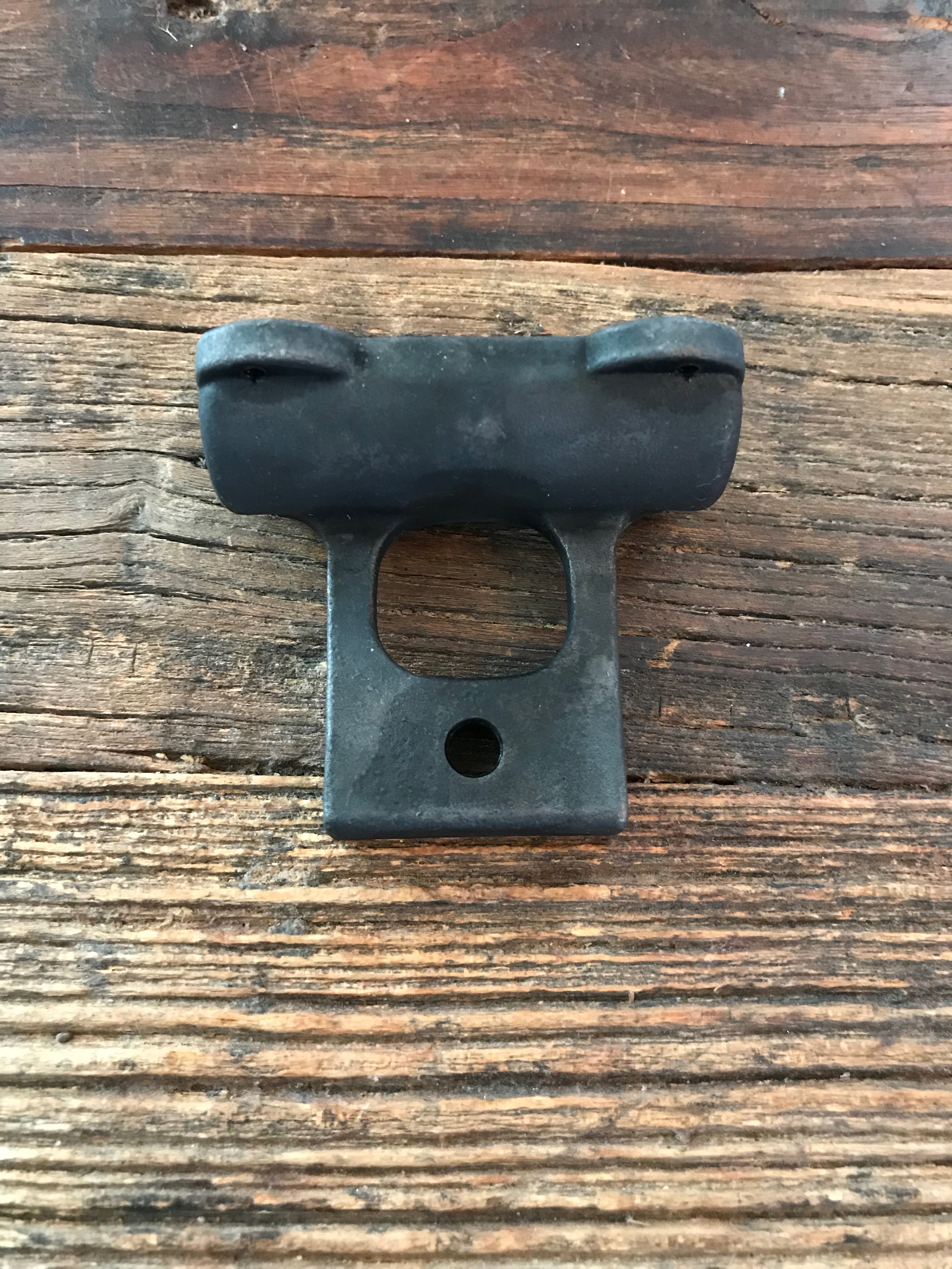

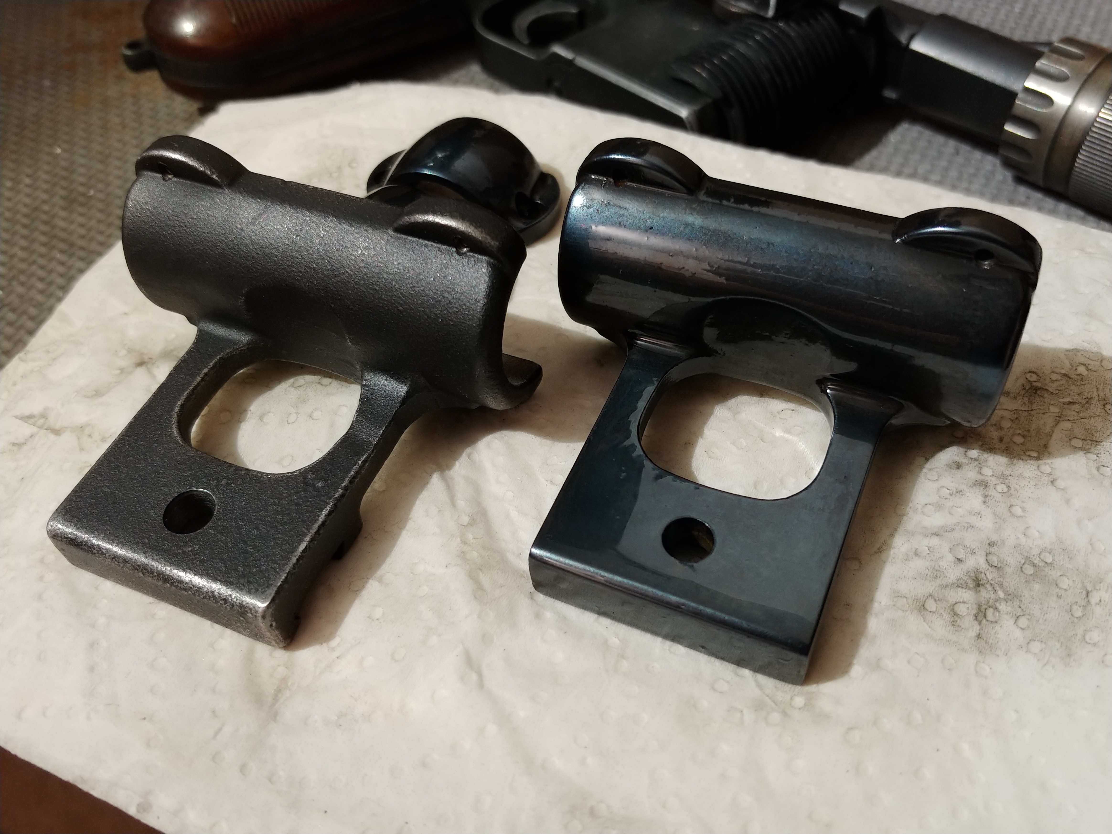

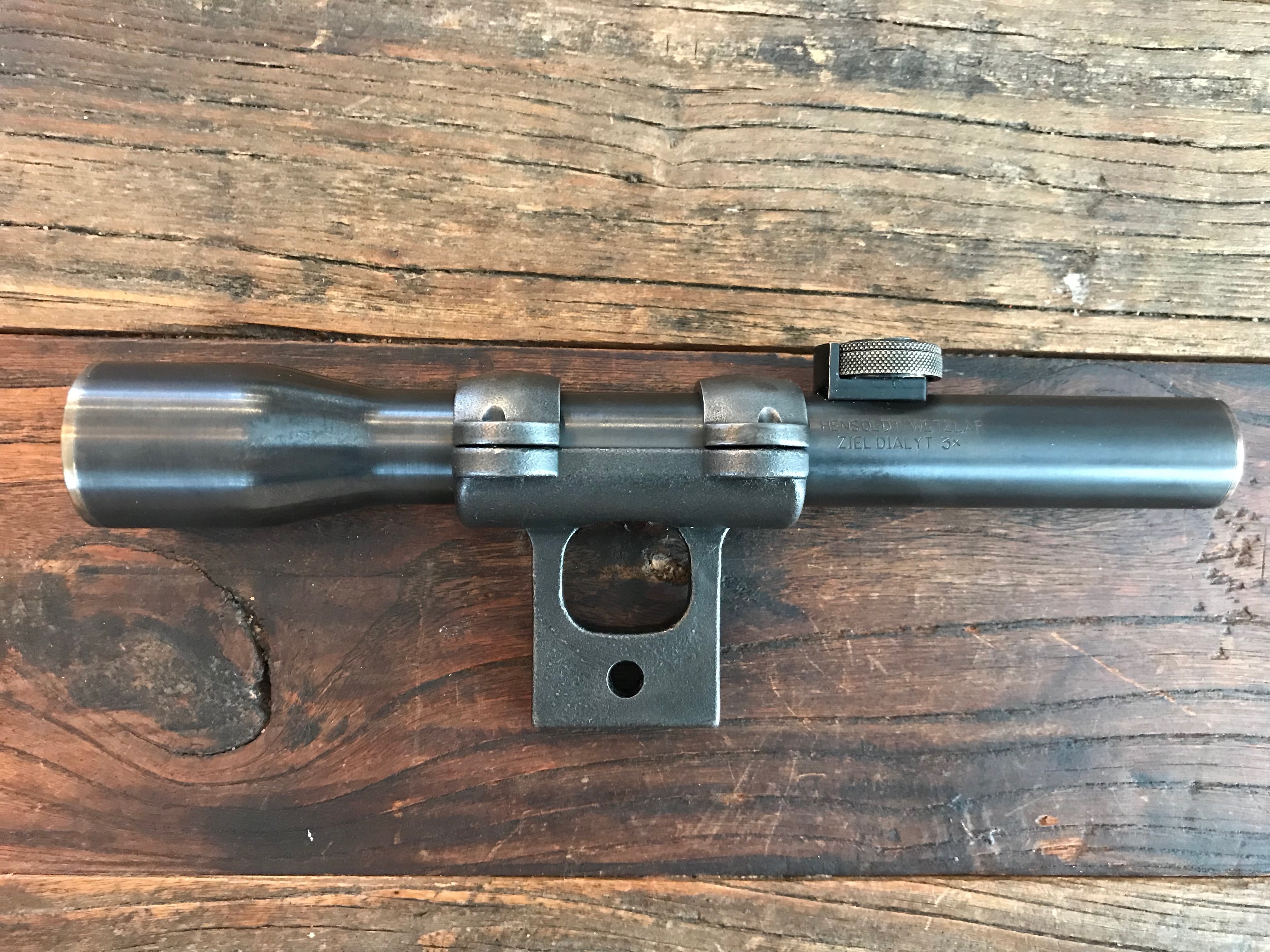

Thanks Russ! I decided to disassemble the scope mount and sand out all the casting grain to a smooth texture, then reblue and oil.
Get ready for a lot of sanding. I did that to mine, it was worth it, but it takes some time!

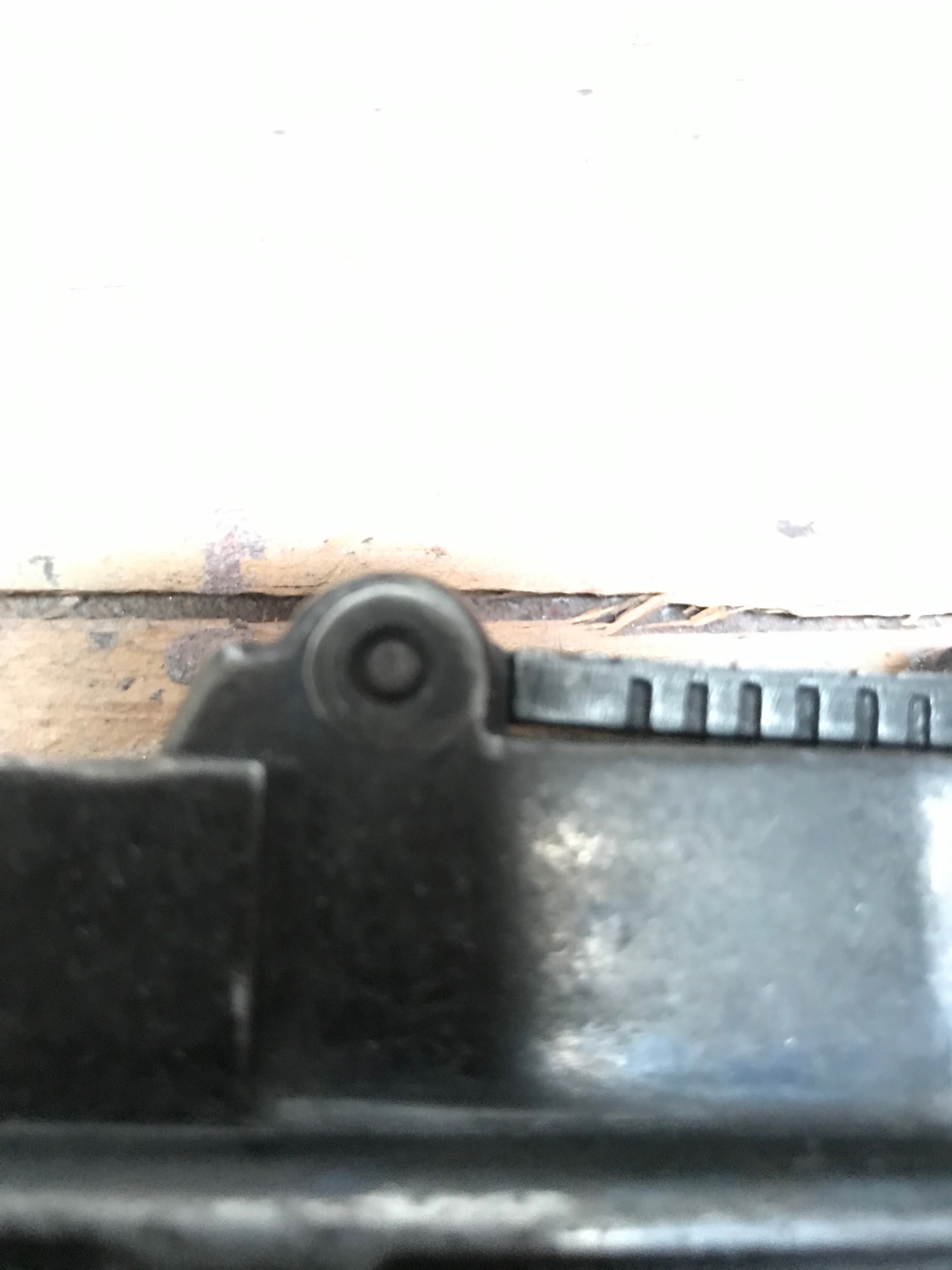

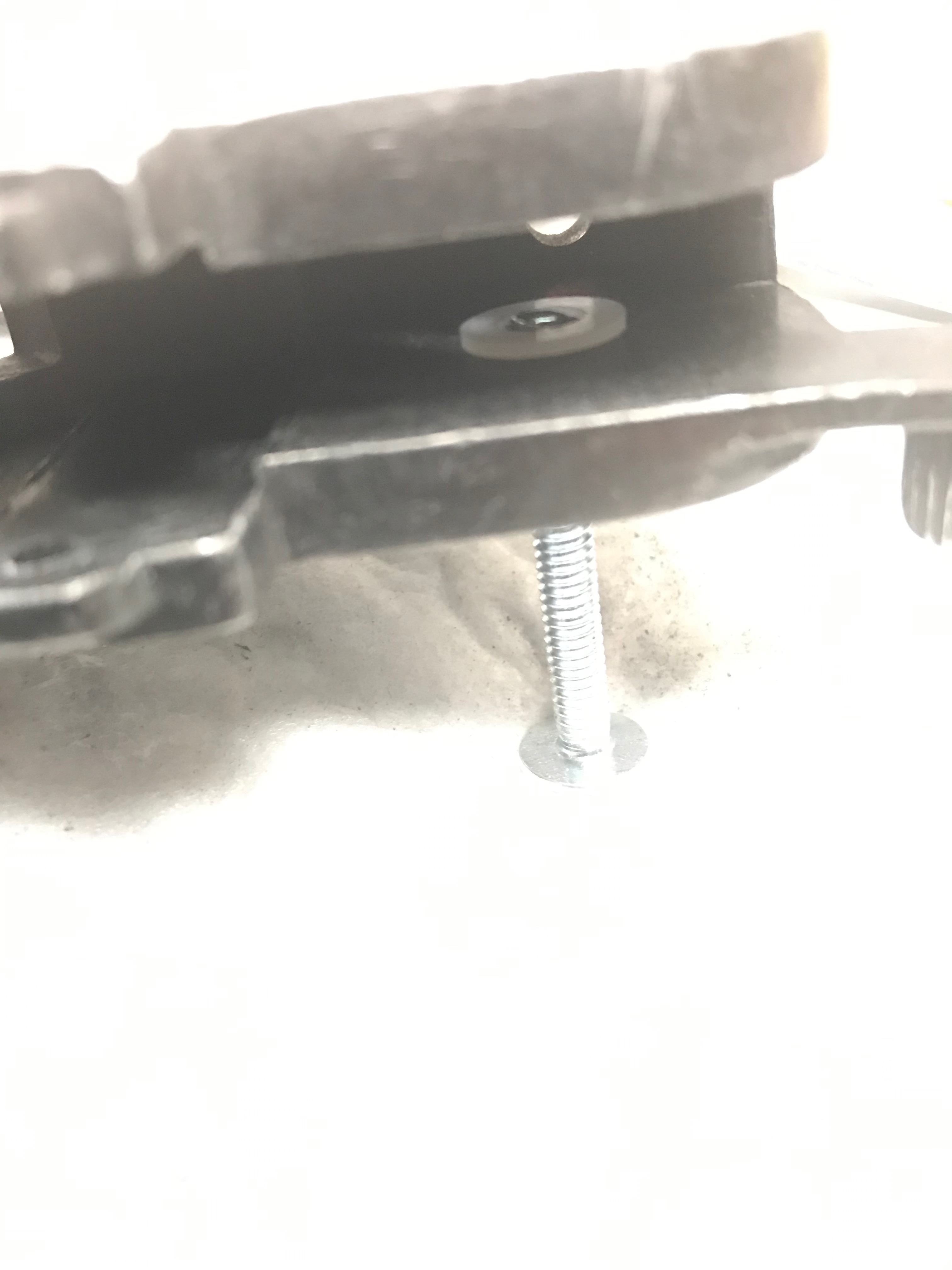

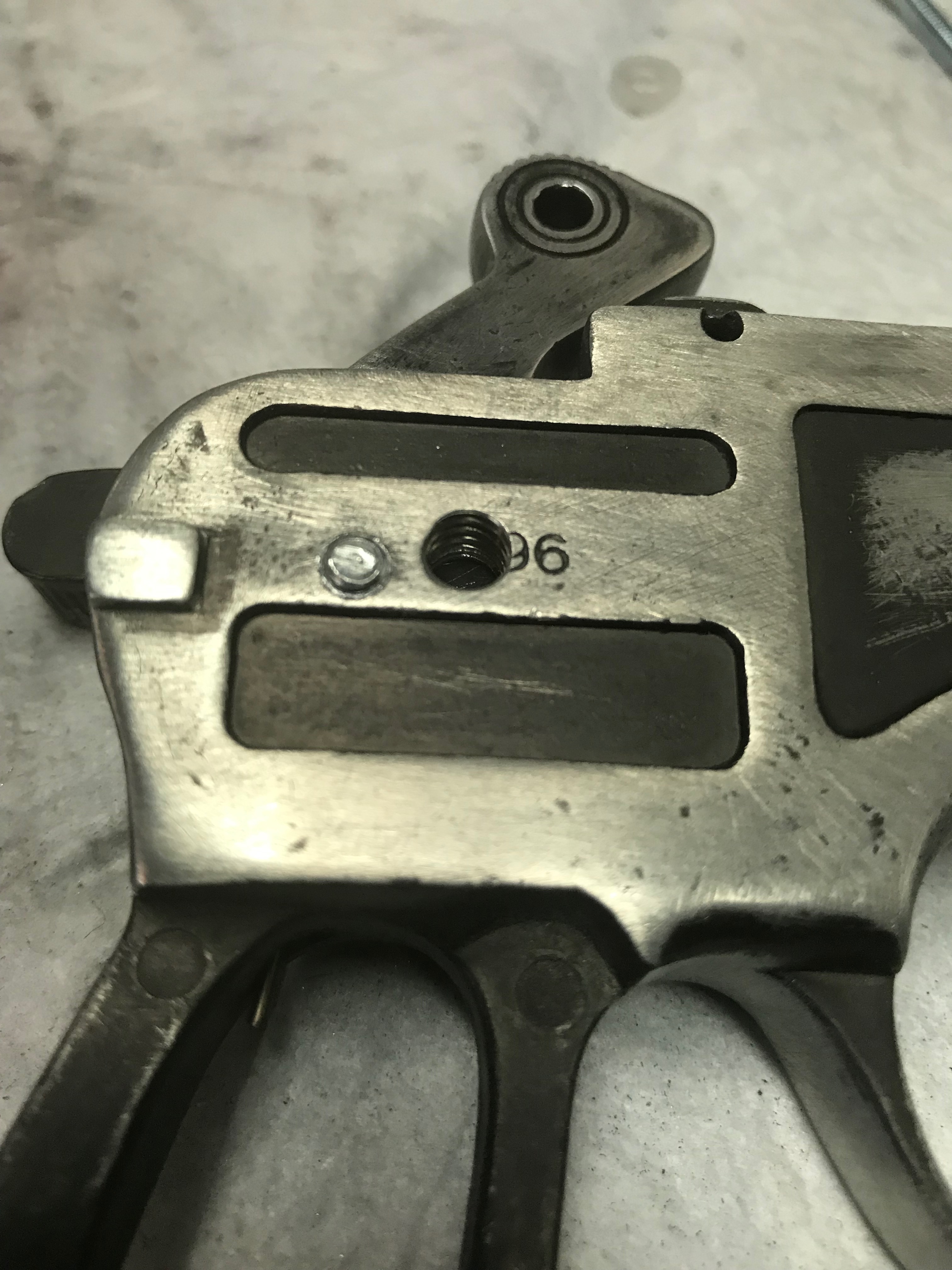

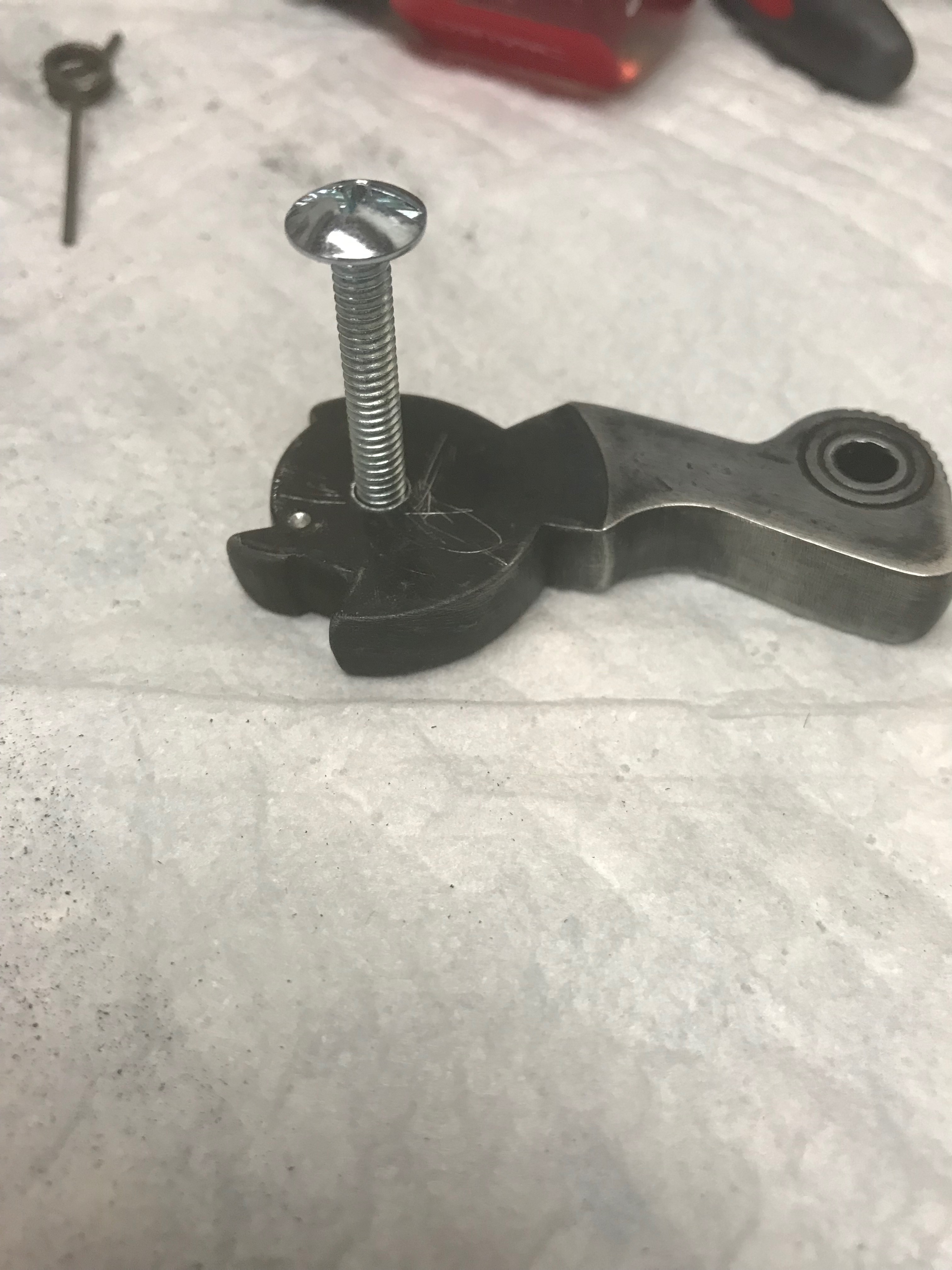

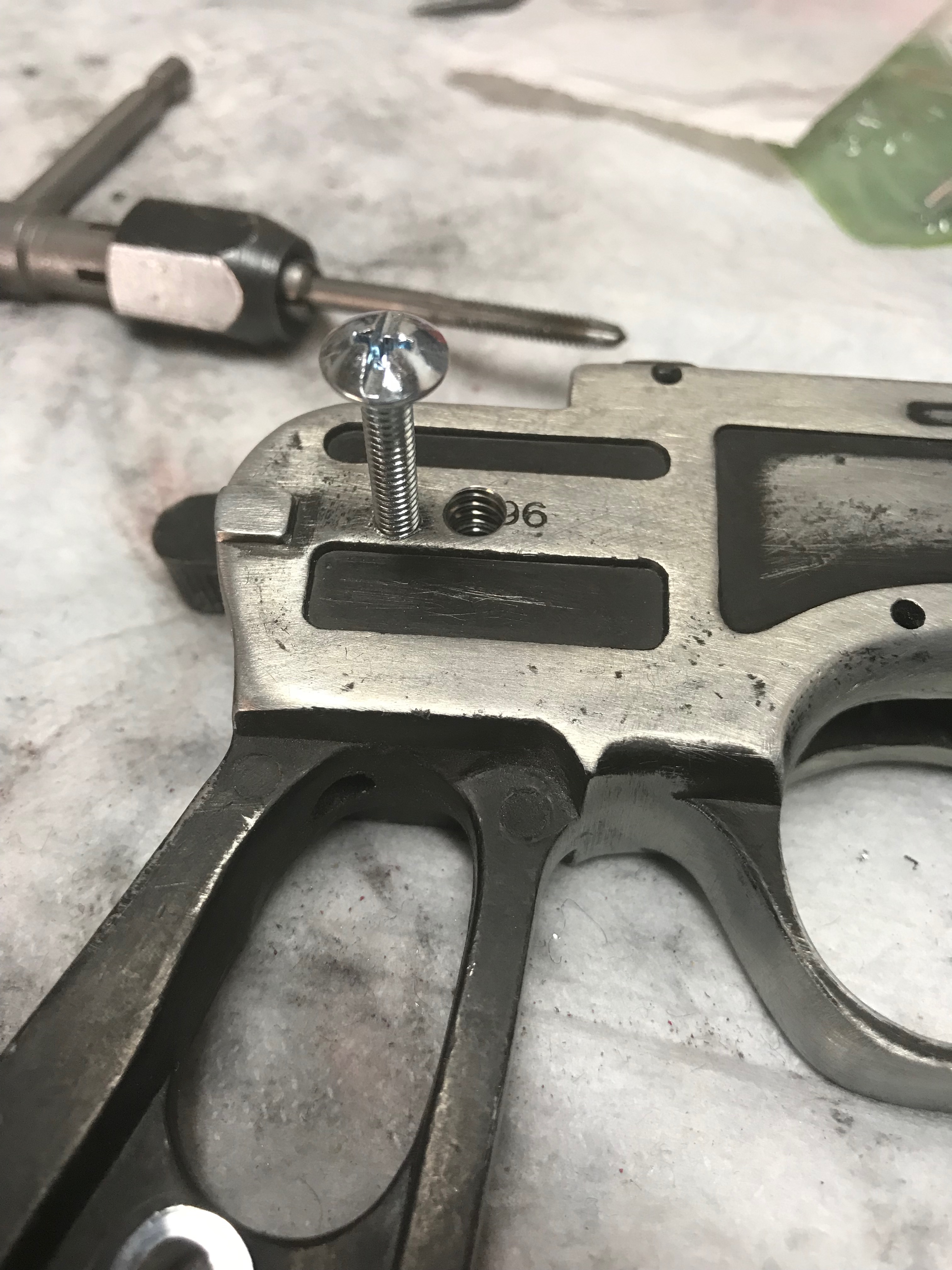

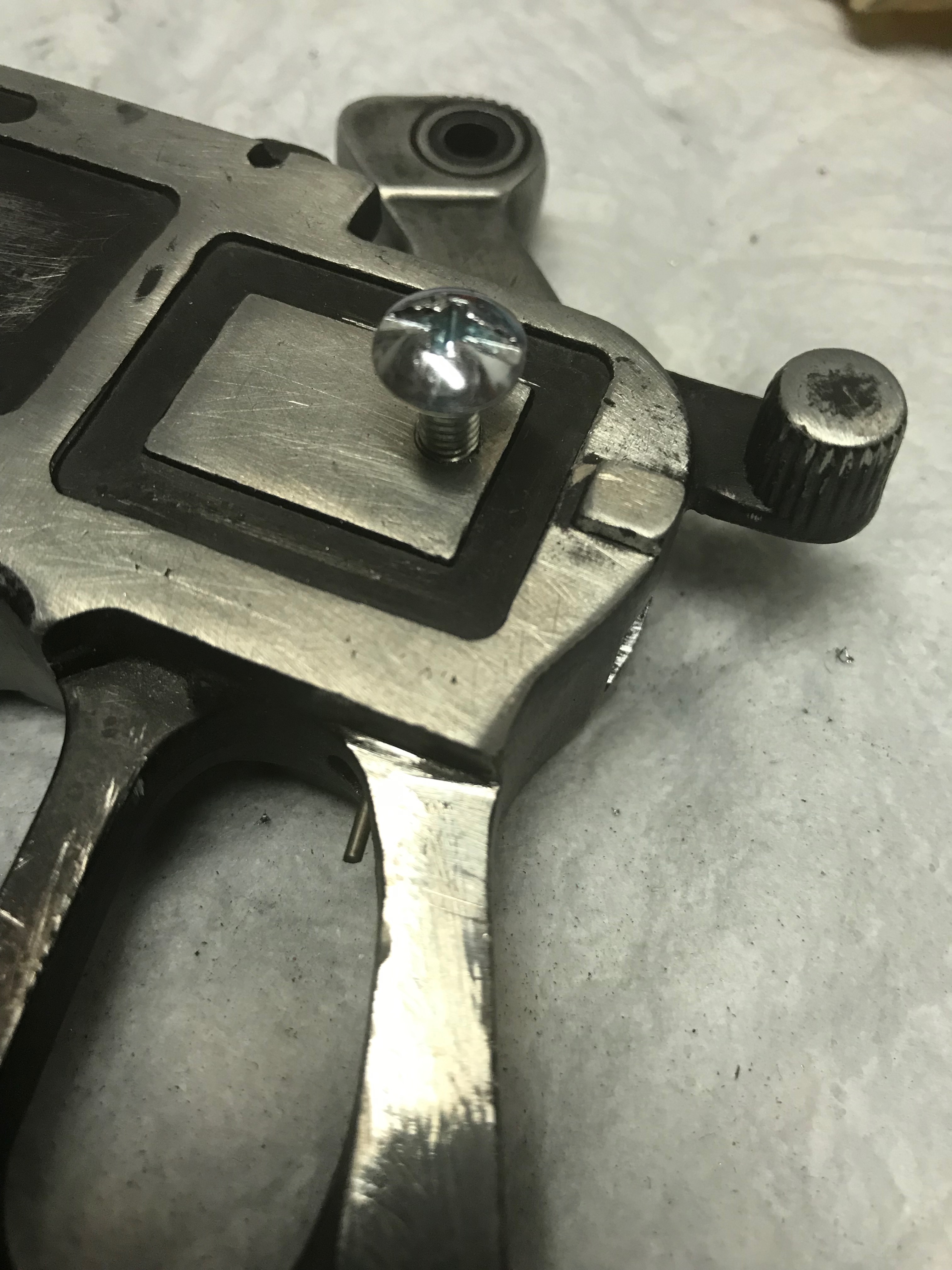

I tried DiggsBarklightr's screw vs. pin and it came out pretty good!

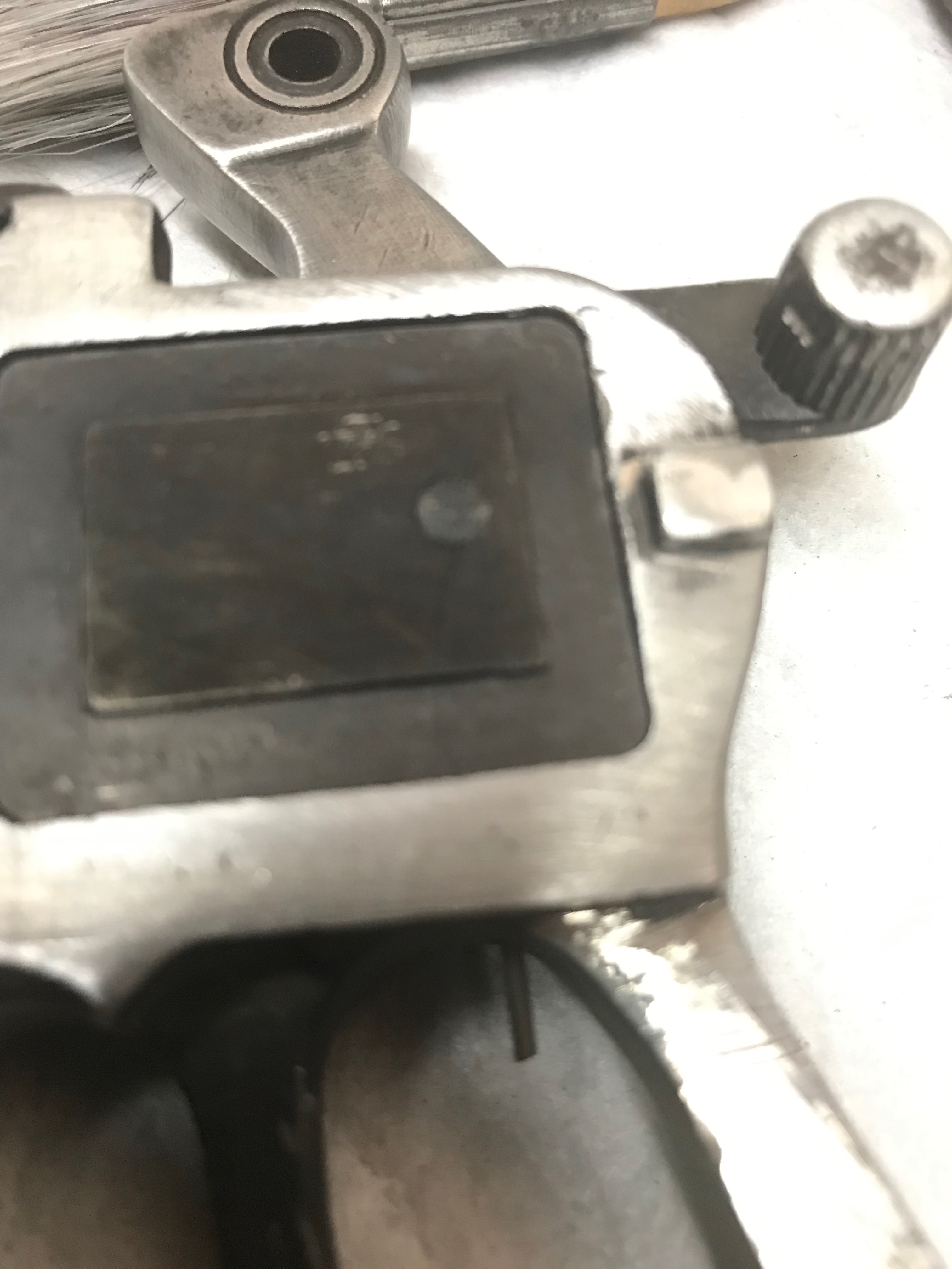

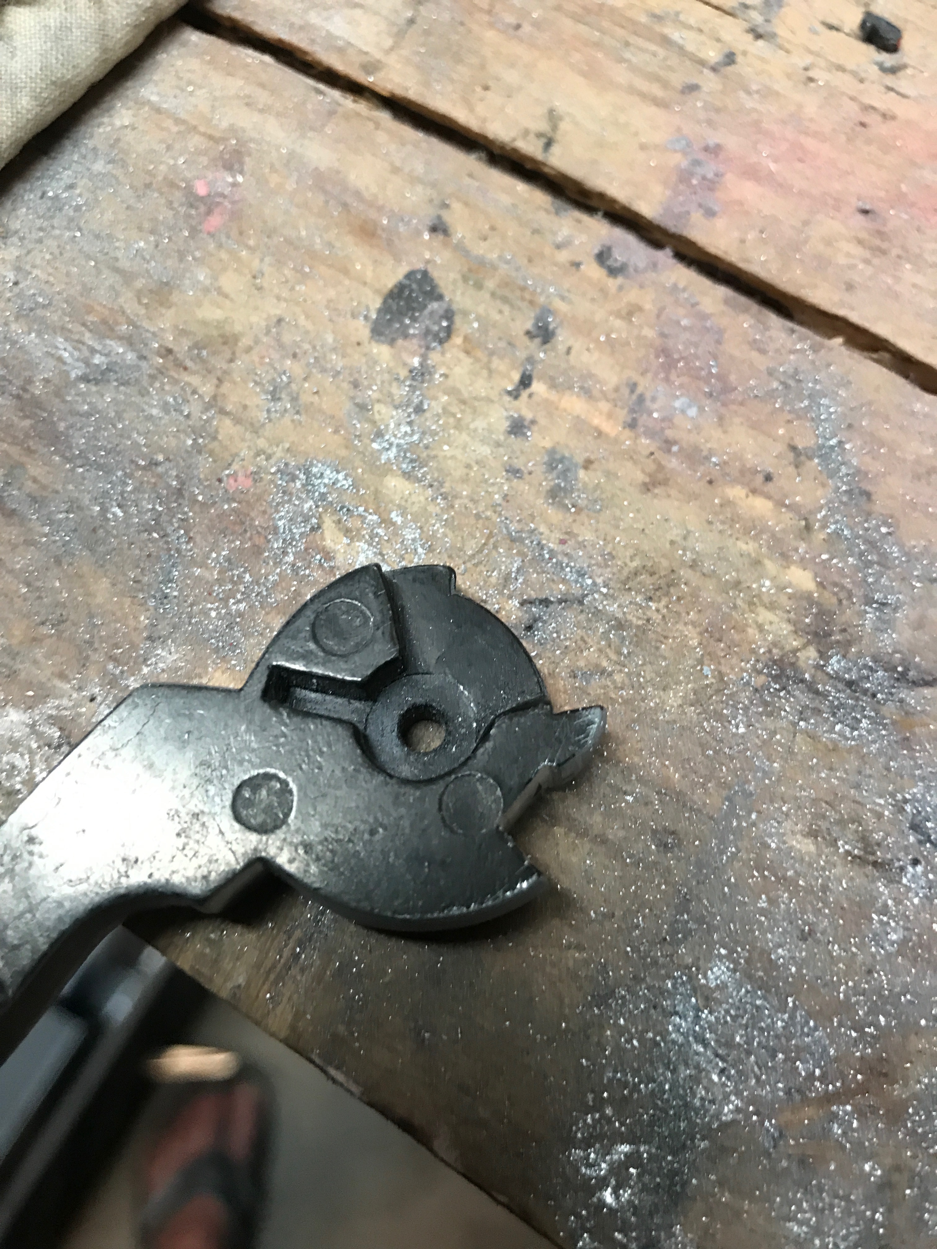

Opened up the hammer hole

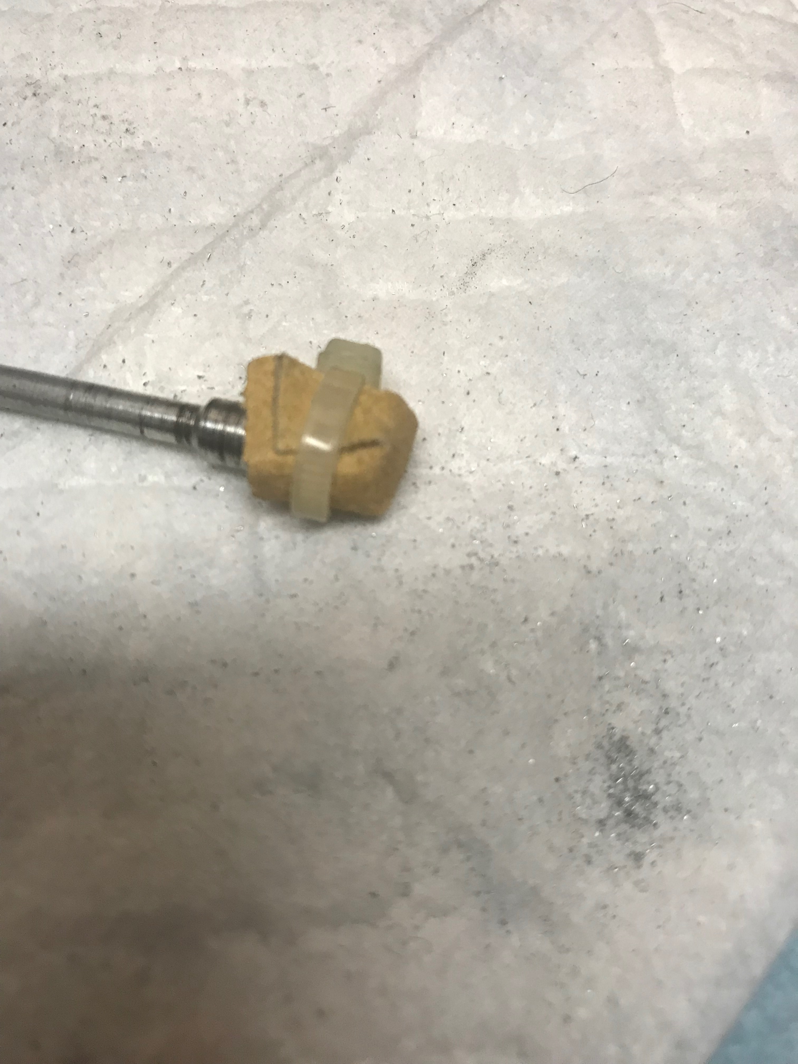

Denix hammer was a little sloppy so I used a teflon washer to take up the slop
Ground off the screw

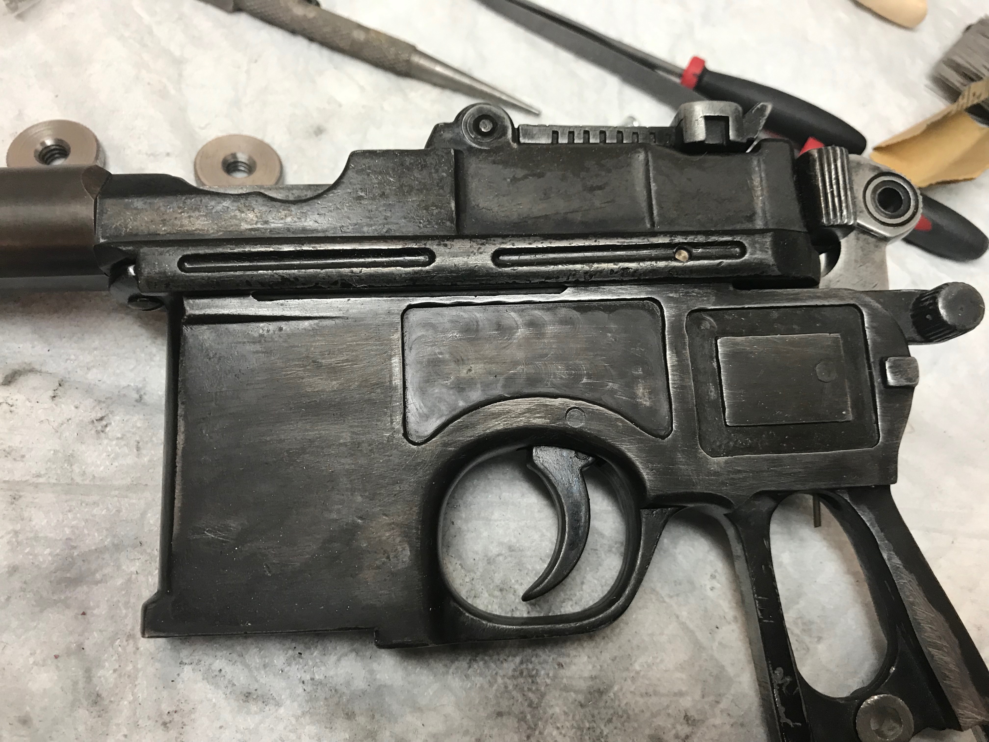

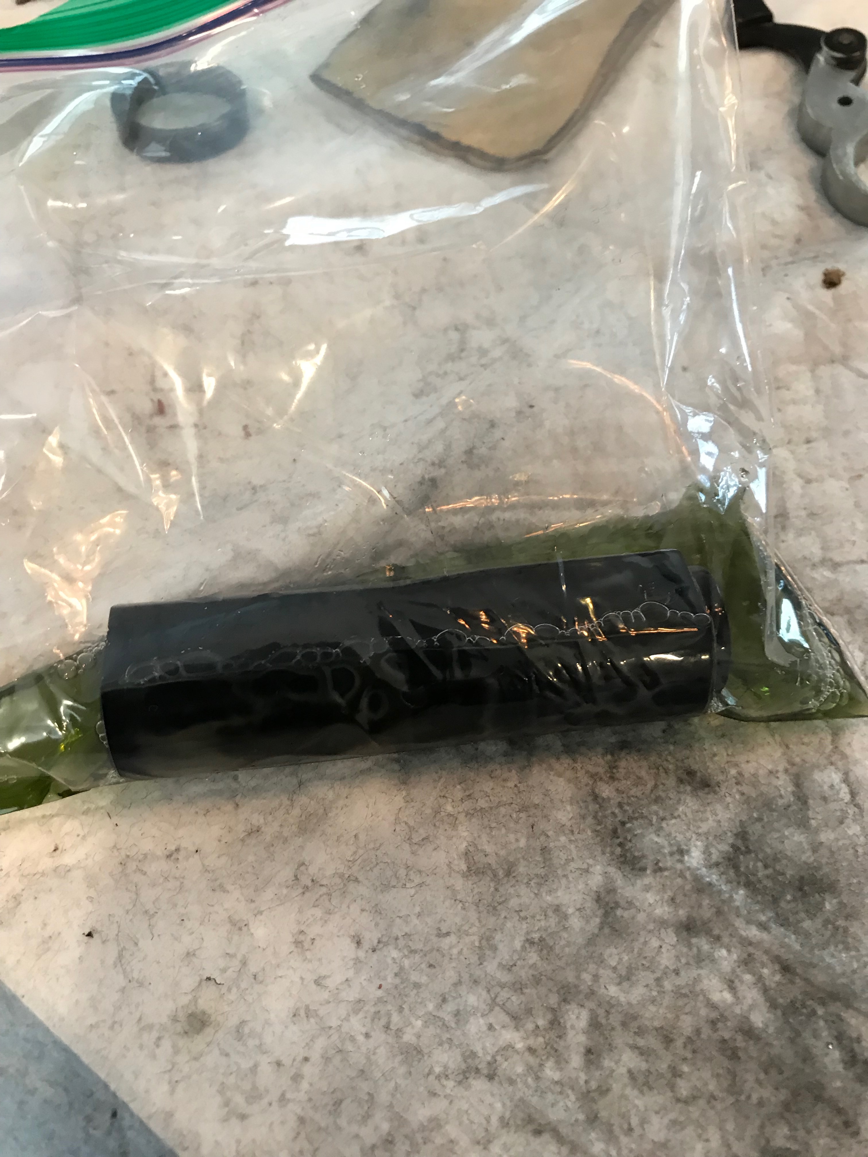

Test blueing

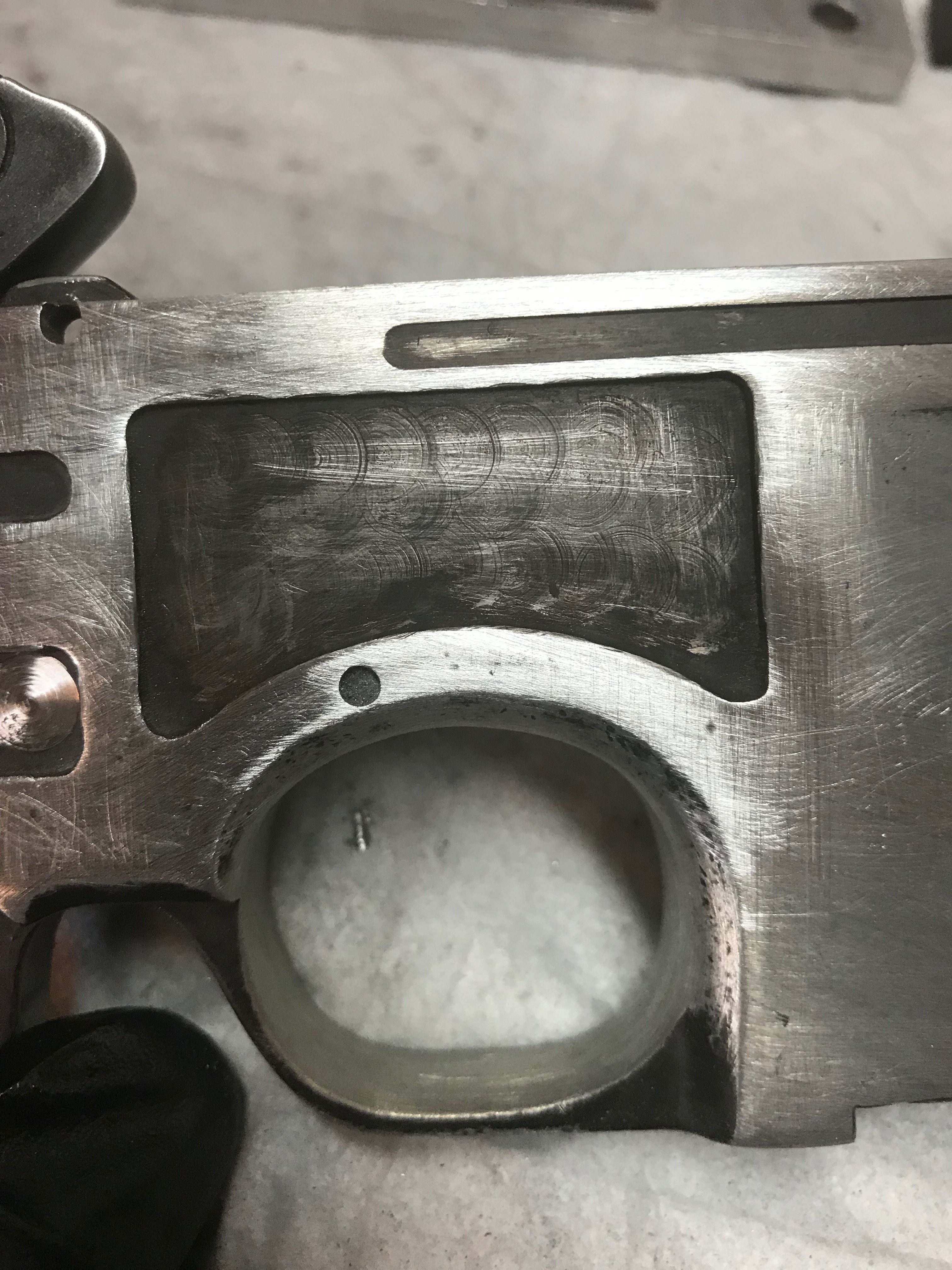

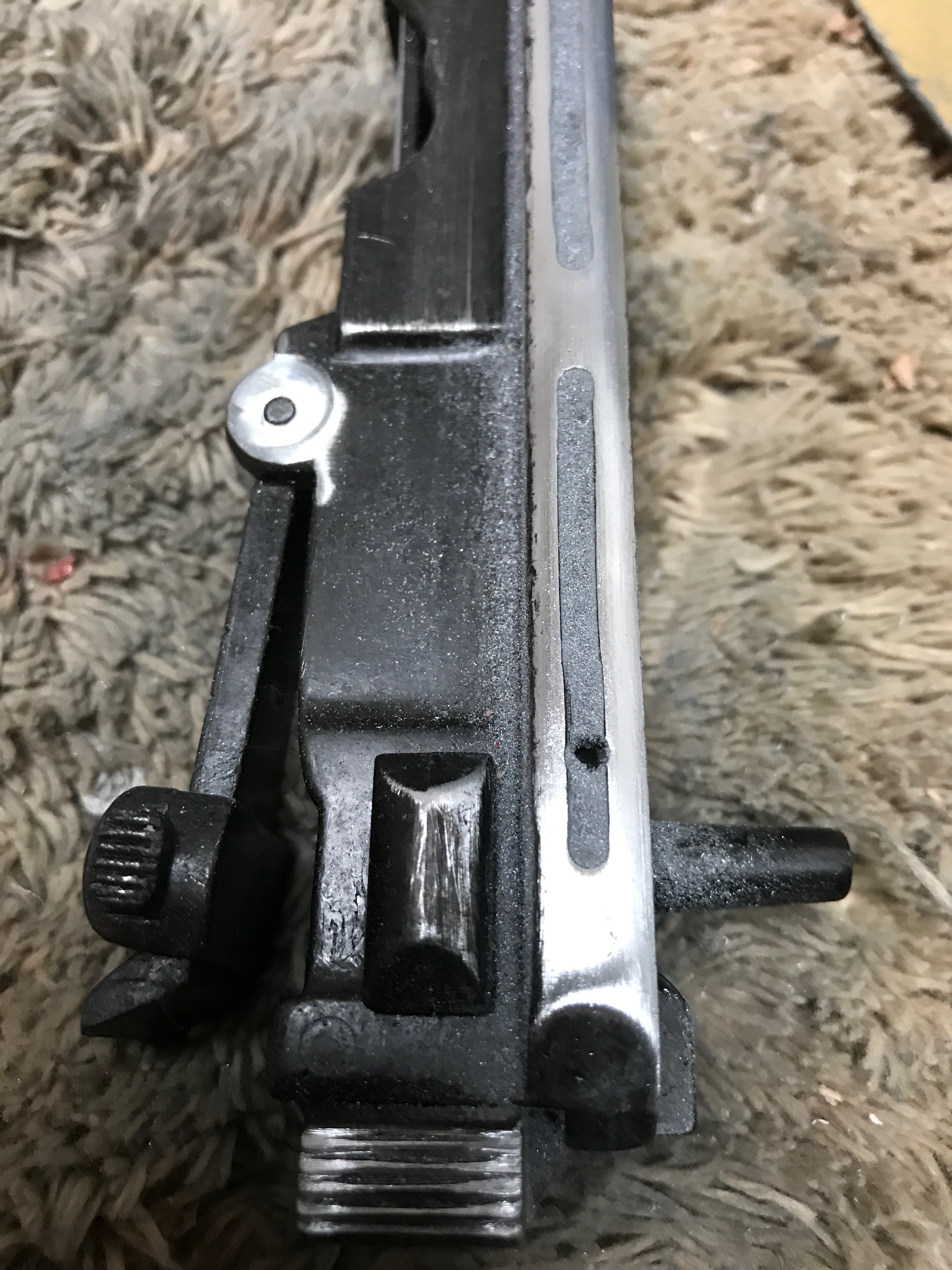

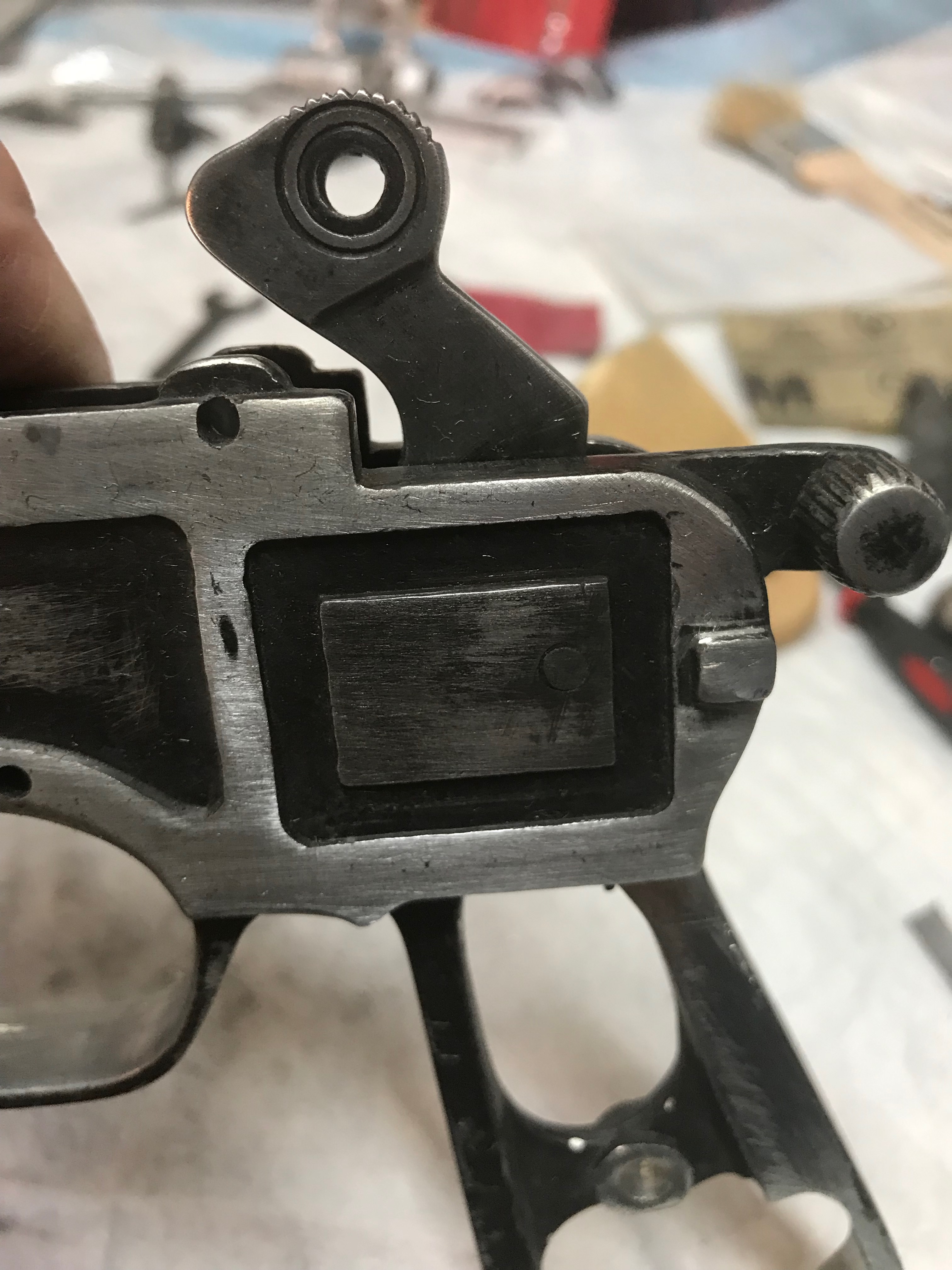

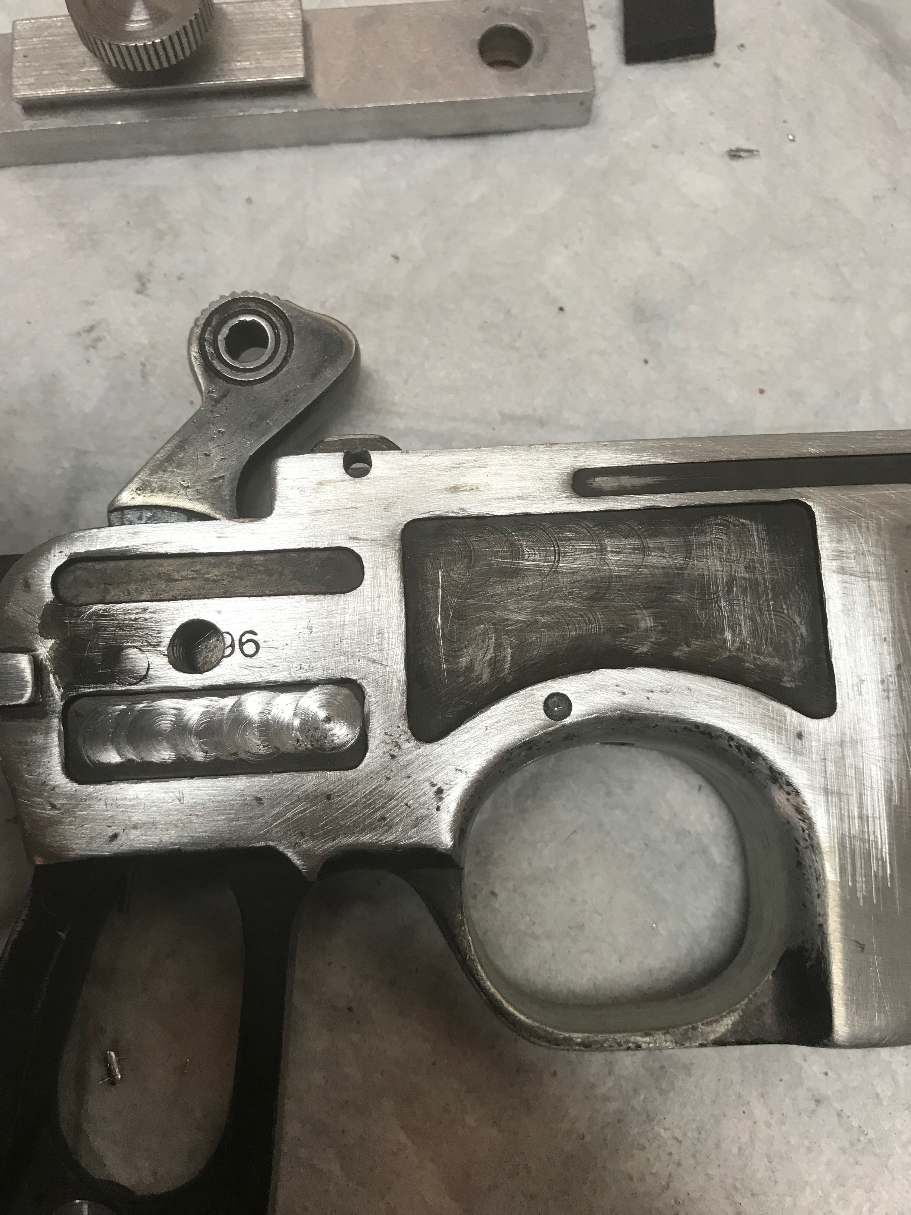

A little steel wooling

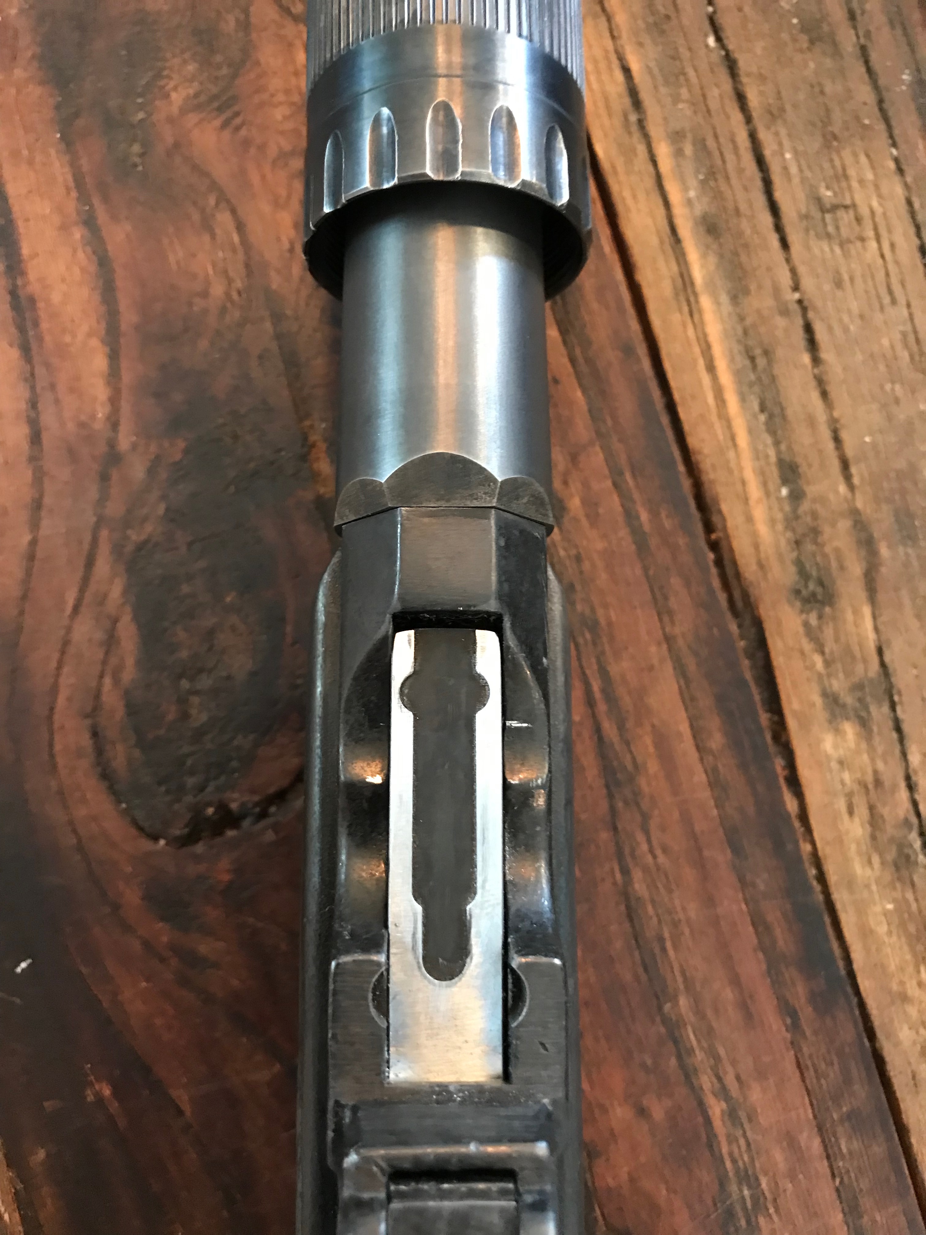

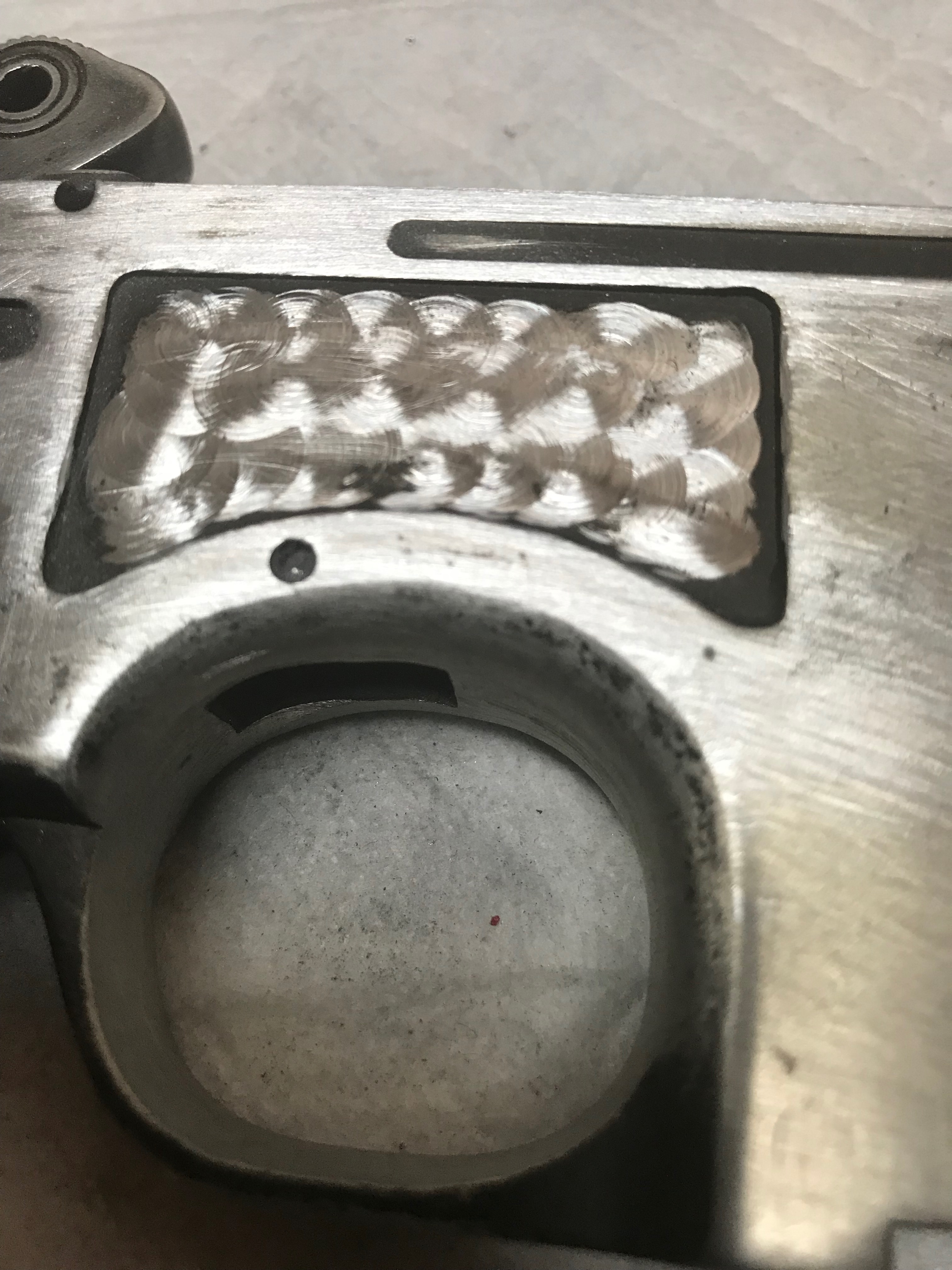

Tried the same type of idea DiggsBarklightr's used for the faux milling marks
Test blueing

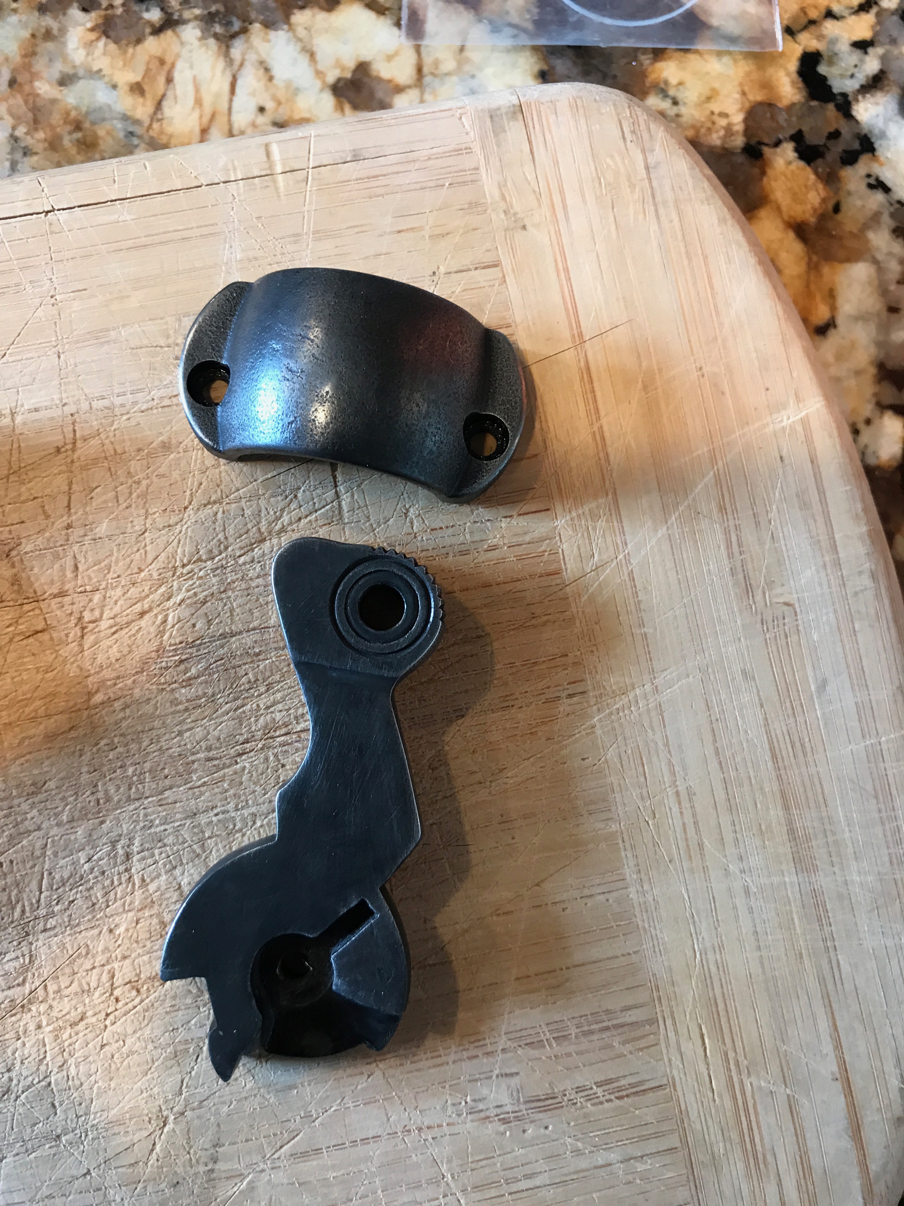

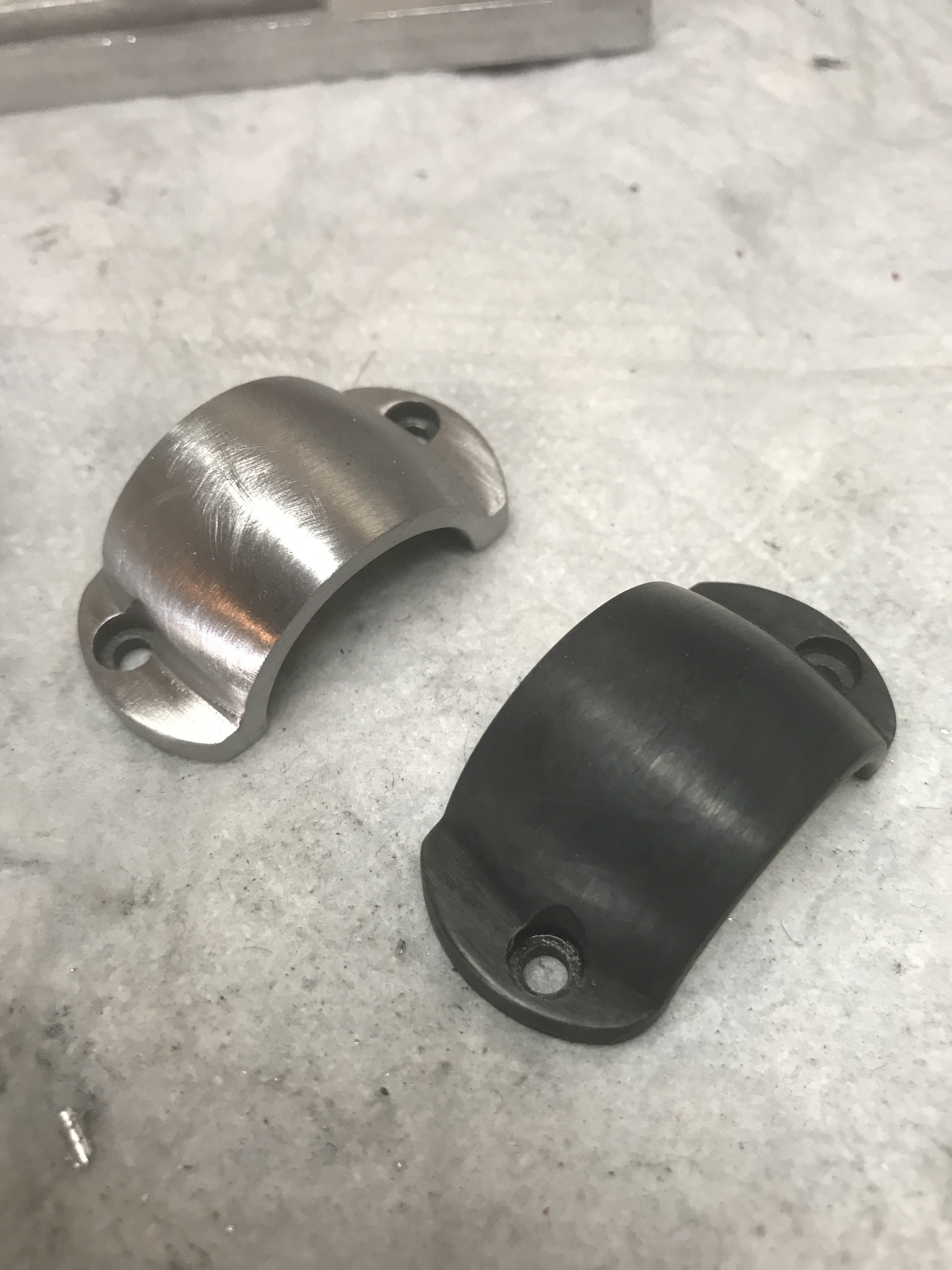

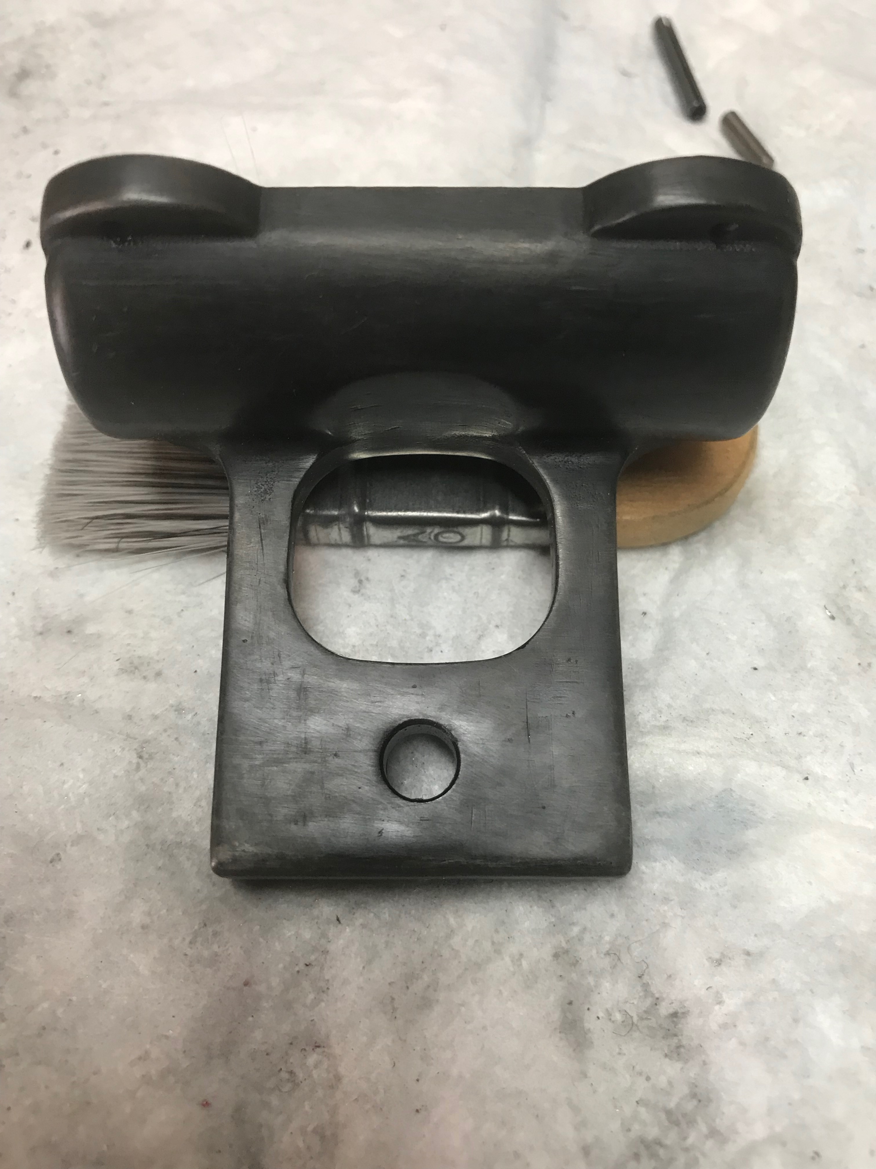

Sanded the steel scope rings - PITA!
Blued and oiled
Few shots of the faux milling

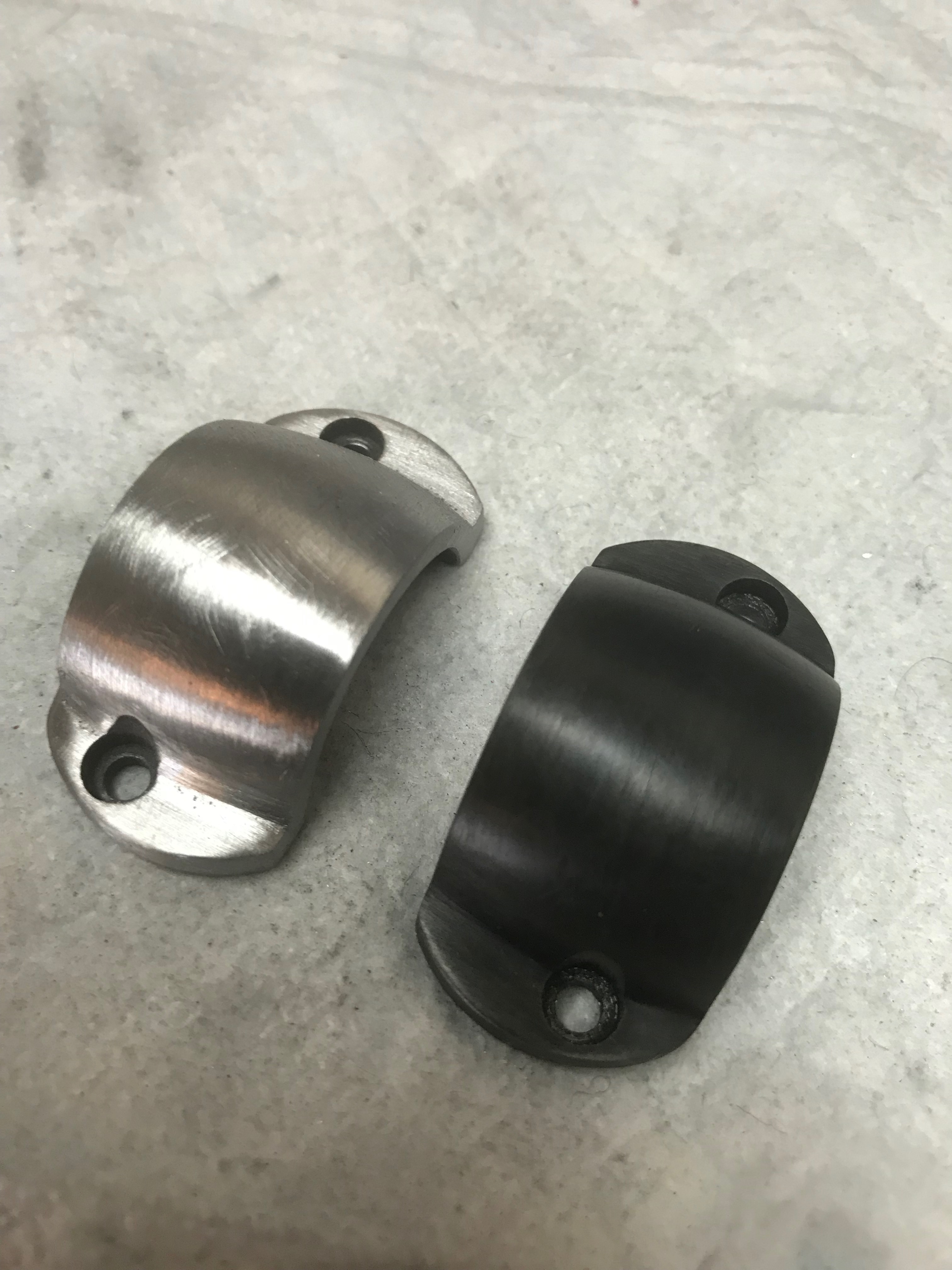

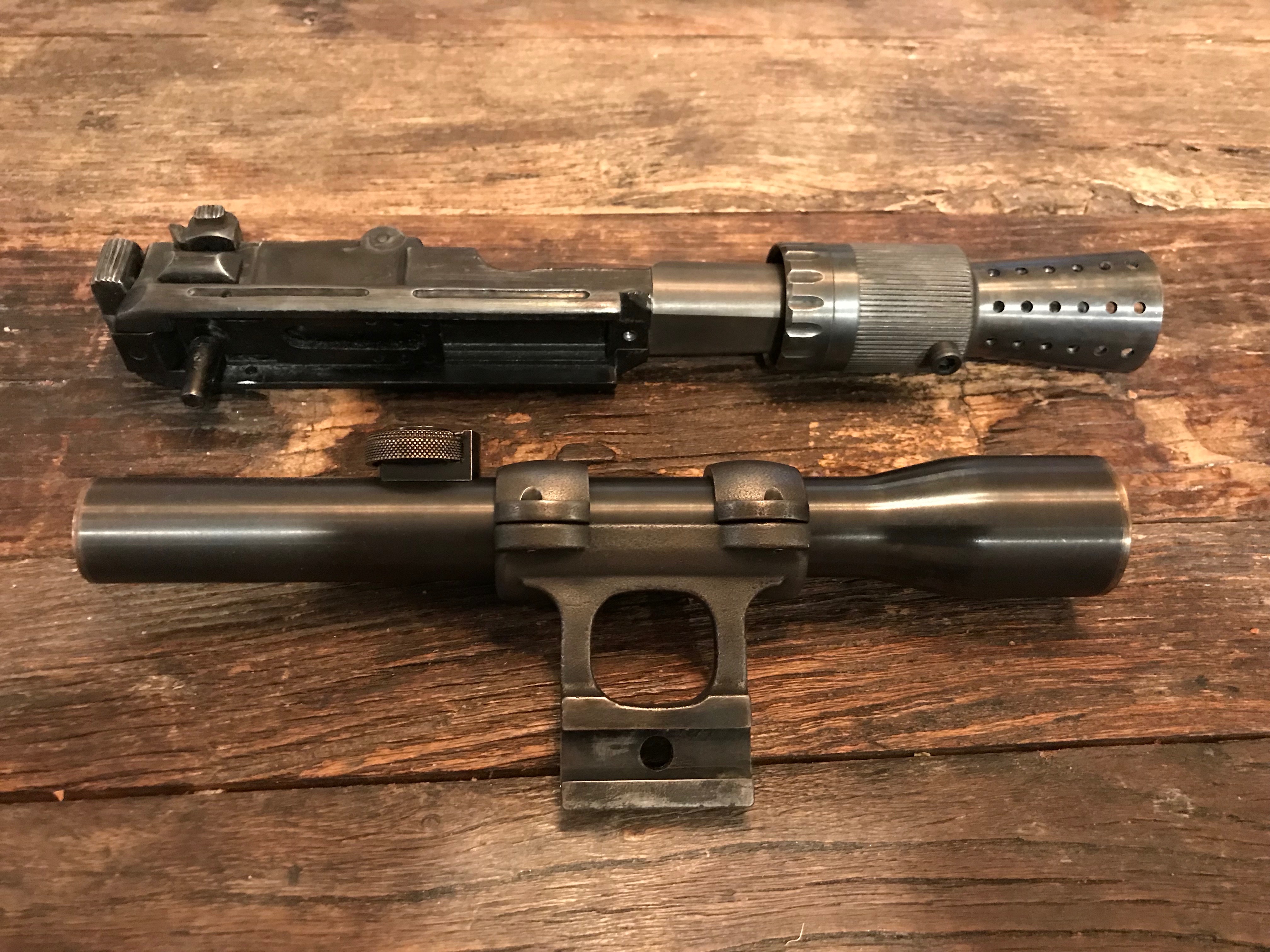

Scope rings next to upper
Scope mount sanded, blued, and oiled - looks way better than the cast look!

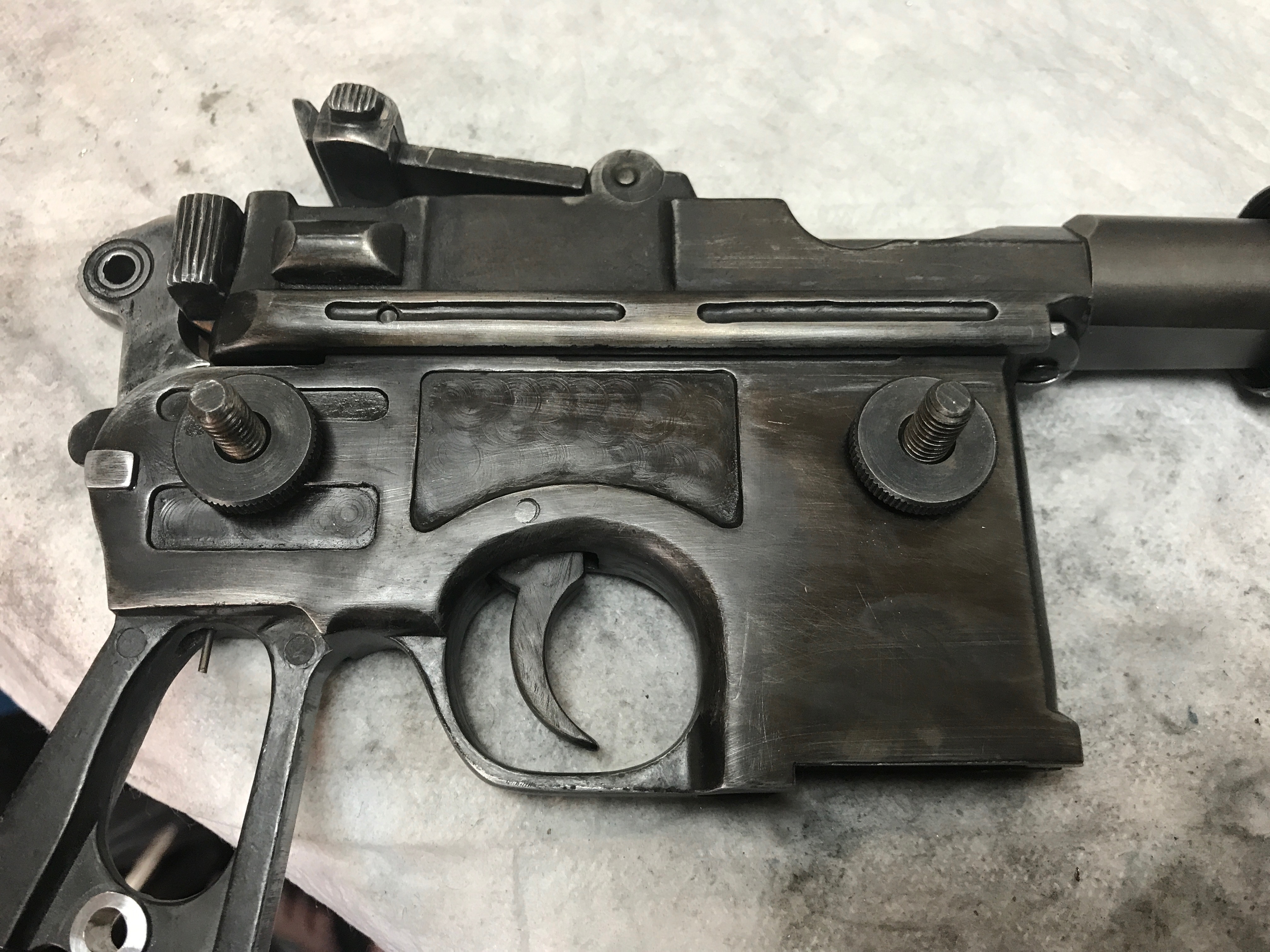

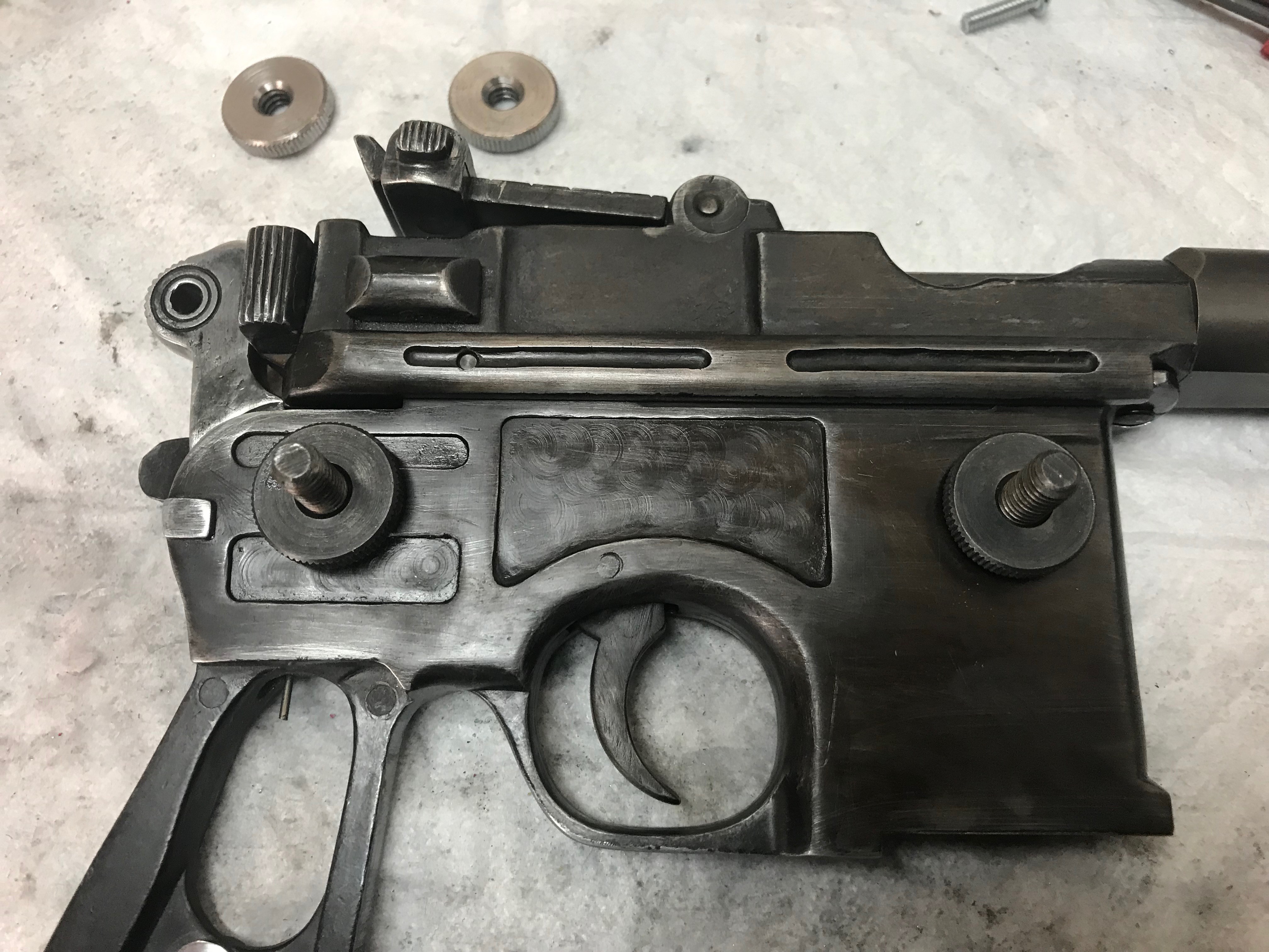

It's coming along

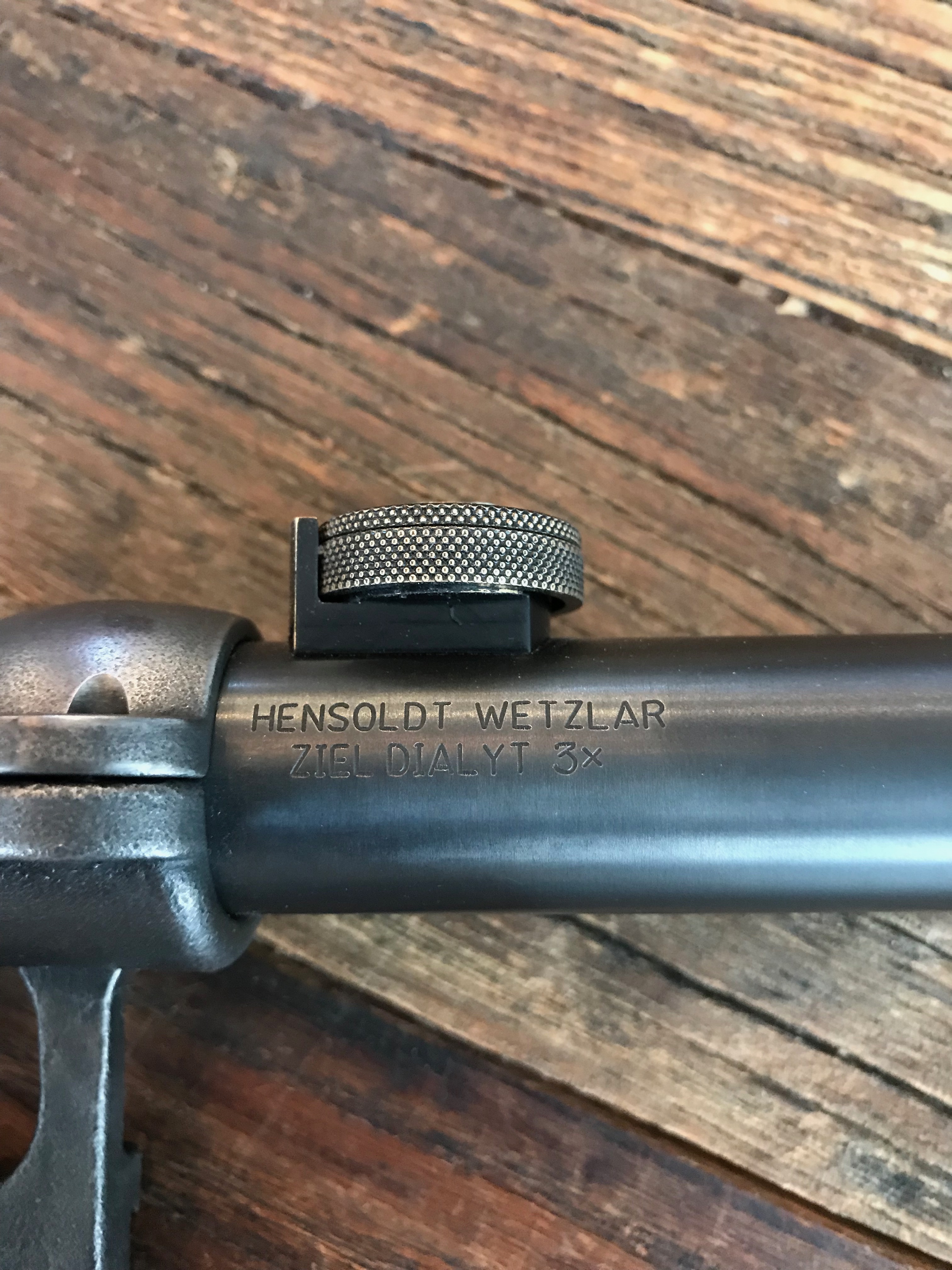

Thanks Dann, with the aluminum blueing that will be pretty easy. I bought Scott’s stencil kit for the scope mount rail and thumb wheels, so I’ll work on that too!
