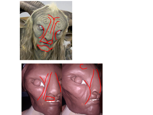

I think that the nose needs to contour upwards into the left and right spirals, at the moment the bridge is meeting ^ <like that in the middle, it should be more consistent in width going upwards.
the upper eyelid should extend down and around to signify where the lower eyelid 'meat' comes across from - and there is an extra line of flesh to add between the eyelid extension and the nose.
Was trying to find a video for you yesterday, spent 30 mins but no luck :C Basically was demonstrating adding tiny balls of clay to build the areas up (it will look holey and crap) but its a quick way to get the primary, then secondary forms in the right place - WITHOUT being too precious about the nice surface you've made xD
Re: Fauno, Pan's Labyrinth, full body sculpt. Head sculpt in progress PG 3
Thanks, elro, that's a good catch about blocking. I'm REALLY happy with how the nose looks now that there's the deep groves on either side and the eyes moved out. Symmetry is next!
As for adding the clay/the video: probably more helpful to someone working with WED clay! This is done in Monster Clay so making it smooth is as simple as can be. It's a great material for blocking out.
